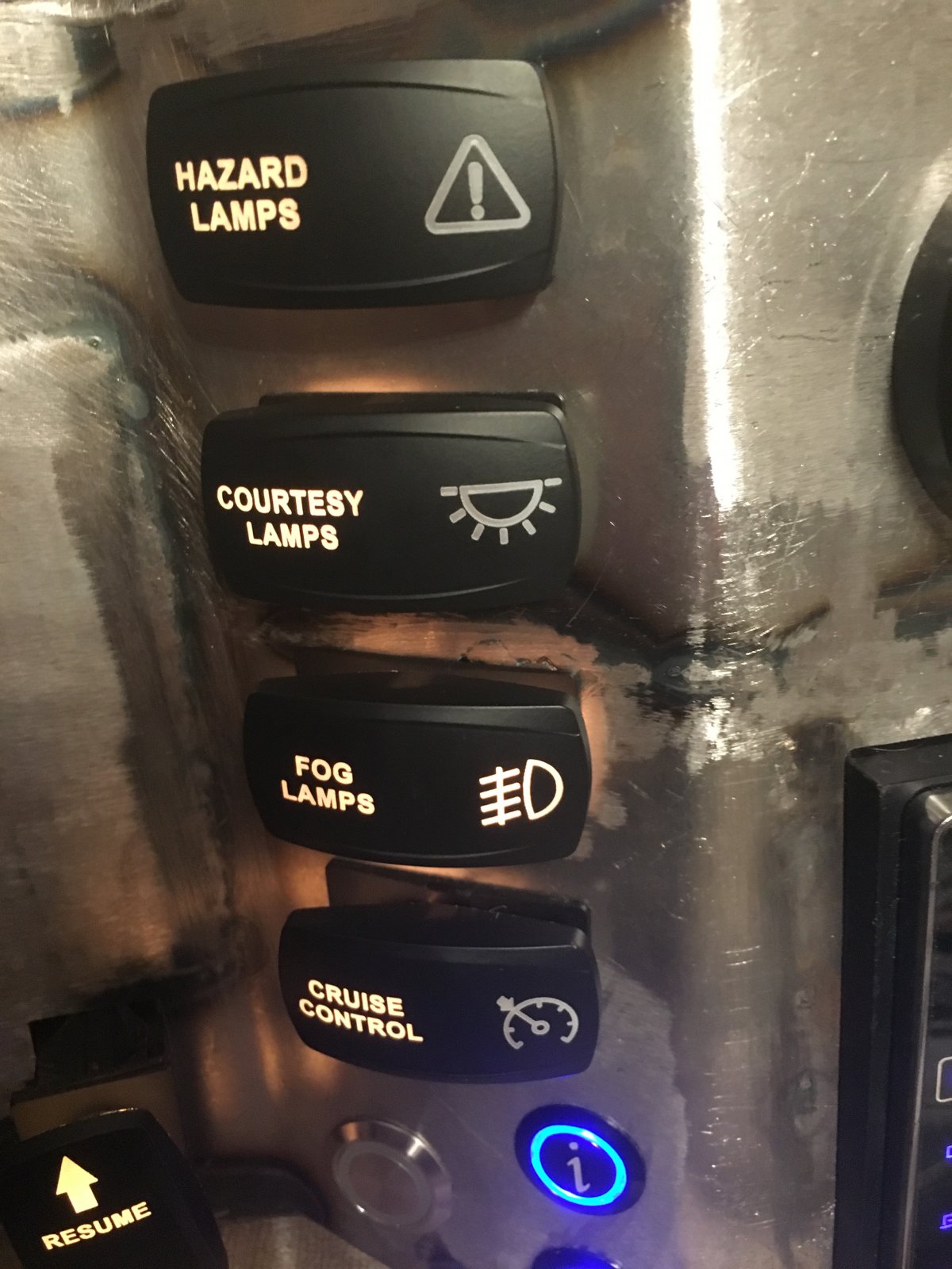

Only one issue remains... Fog lights. I didn’t realize that the fog light switch is actually a momentary ground trigger for the BCM. It will not work with a throw style switch as I had installed.
Luckily, I was able to source a proper Carling momentary switch from only one place in the US that had it. I will run a fog lamp jumper from the fuse box lighting plug into the BCM patch harness, to the dash. This way I will get illumination at the actual switch when the fog lights are on as my indicator the way the factory designed it.

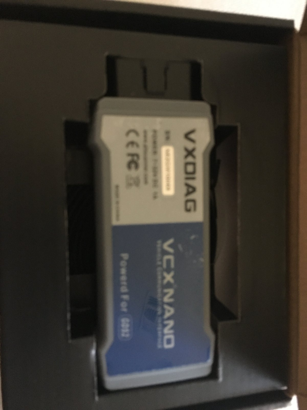

My VXDIAG MPI came in yesterday. Anxious to test it...
Brian74
I'm interested in hearing your feedback/opinions of the vxdiag.
I have an old laptop that ran Windows 7. Apparently the MPI interface version of Tech2 depends on what Windows was popular at the time. TIS2000 works well on XP. Tech2Win works well on Windows 7. GDS/GDS2 works well on newer systems. I plan to build this old laptop on a dual boot Win7/10 to run Tech2win, HPT, and my AIM program.

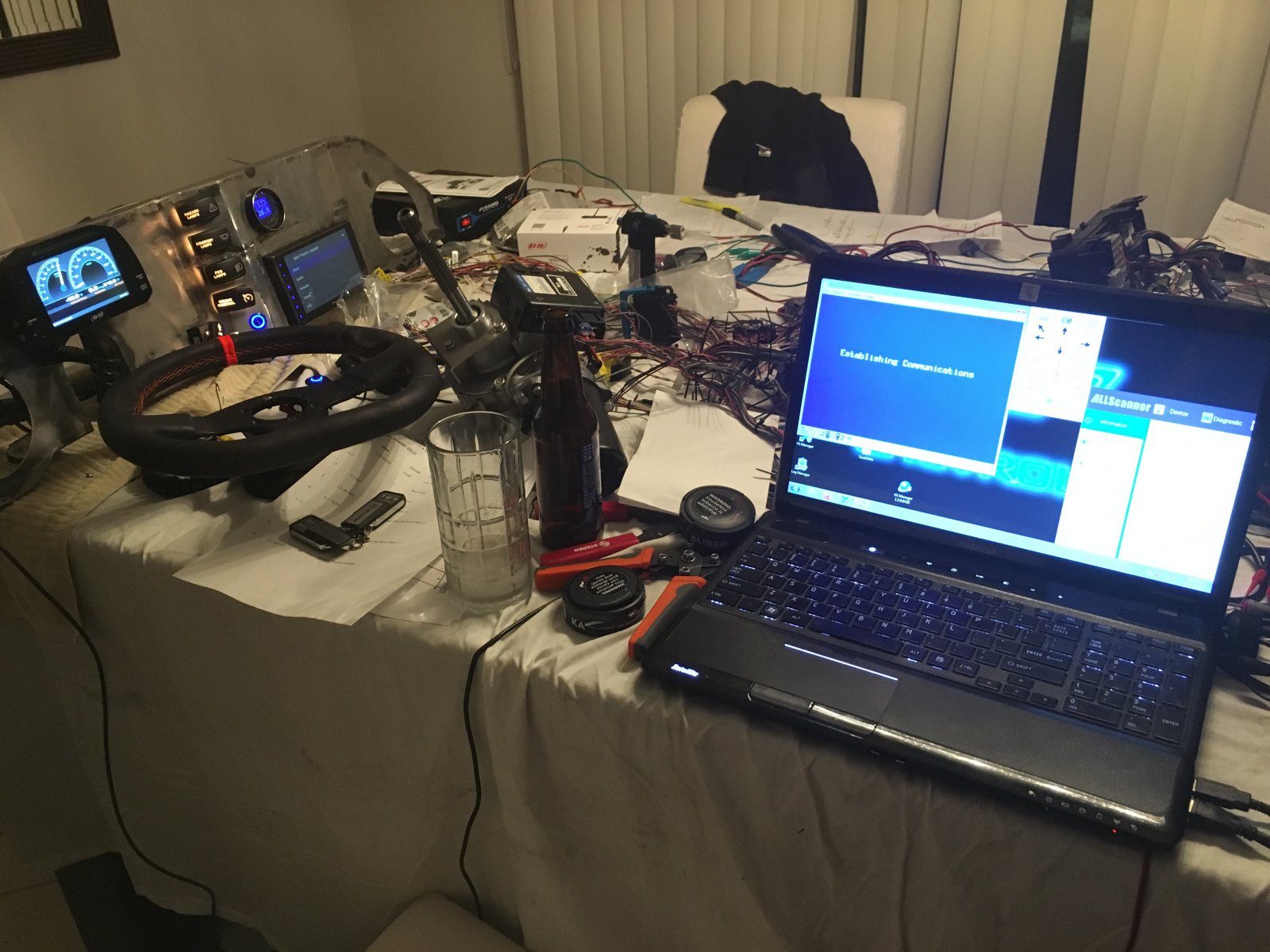

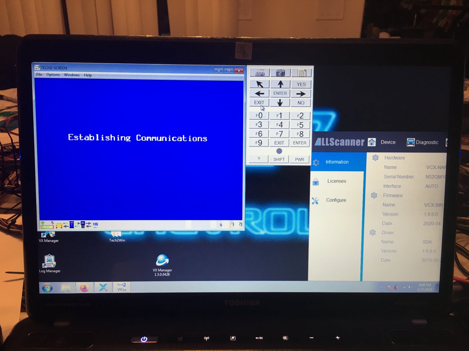

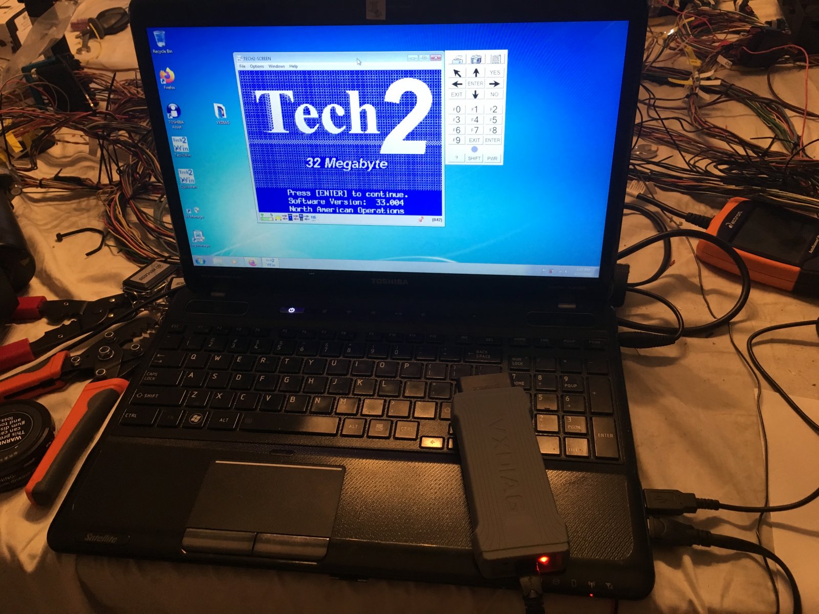

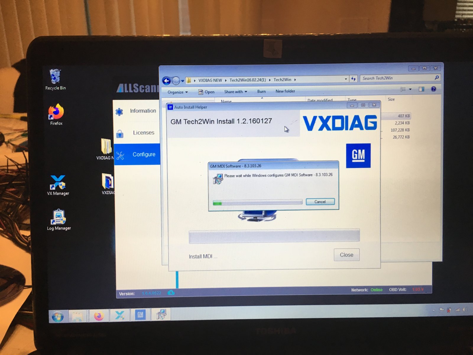

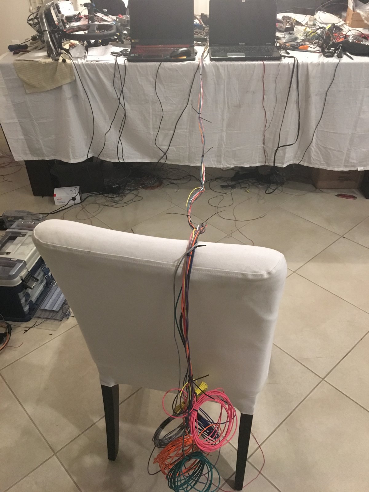

Well, I started out this morning with no clear expectation, but a goal of being able to hook up a virtual tech2. I took an old laptop I had and bought a 500 gig SSD. I partitioned it and installed both 32 and 64 Windows 7. Of course I also had to install the laptop drivers. It was a process; to say the least.
I first tried to run VGDIAX on Win 7/64. I got the virtual tech2 to come up, but every time I tried to connect, I got a CANdi error. I installed a 32 bit version of Windows on a 2nd partition after reading that tech2 will not work on a 64 bit machine. Still got the same error though.
Pulling my hair out at this point. I did a few hundred Google searches, and realized I was missing a certain driver that was not included in the install package. I found that driver.

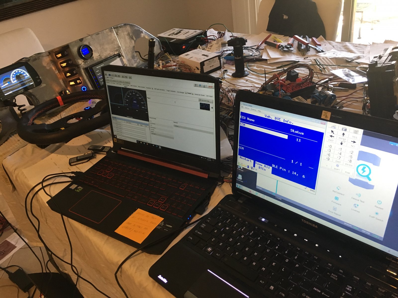

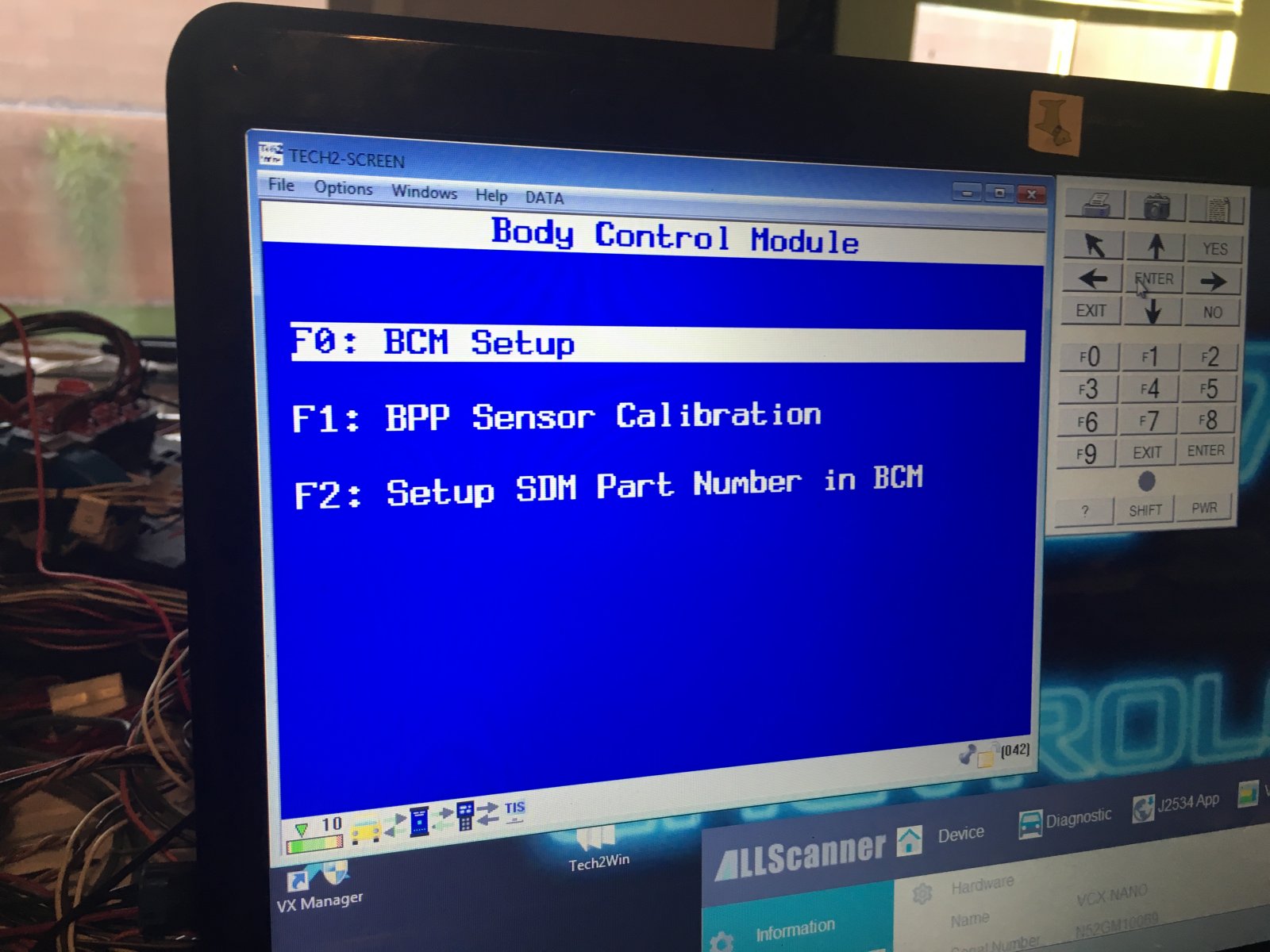

Fired it up in one last-ditch attempt. Holy ****. I have coms now. I can turn on any circuit from the BCM with the click of a mouse, read inputs/outputs, reprogram my brake pedal sensor, VATS, ect. Things just got WAY easier.

Dont buy the tech2. Buy the VXDIAG GM module ($110) and set up a laptop running 32 bit Windows 7.
Now that I’ve figured out the software, I can send you or anyone else a list of what’s needed to get it up & running.
Its unfortunate the guy who sells these doesn’t provide very clear instructions.
Can it do a clutch sensor learn? I'm thinking it might be one of Arks last ditch efforts if the fuse box thing doesn't work.

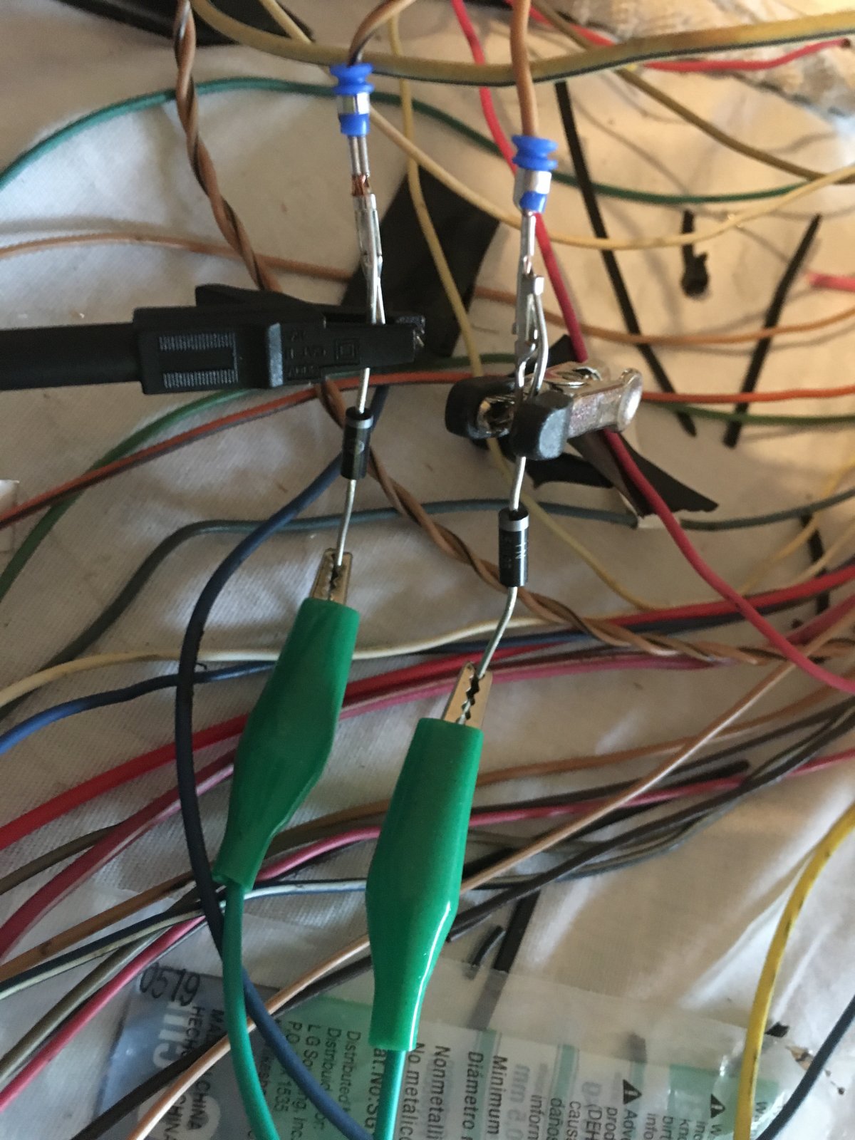

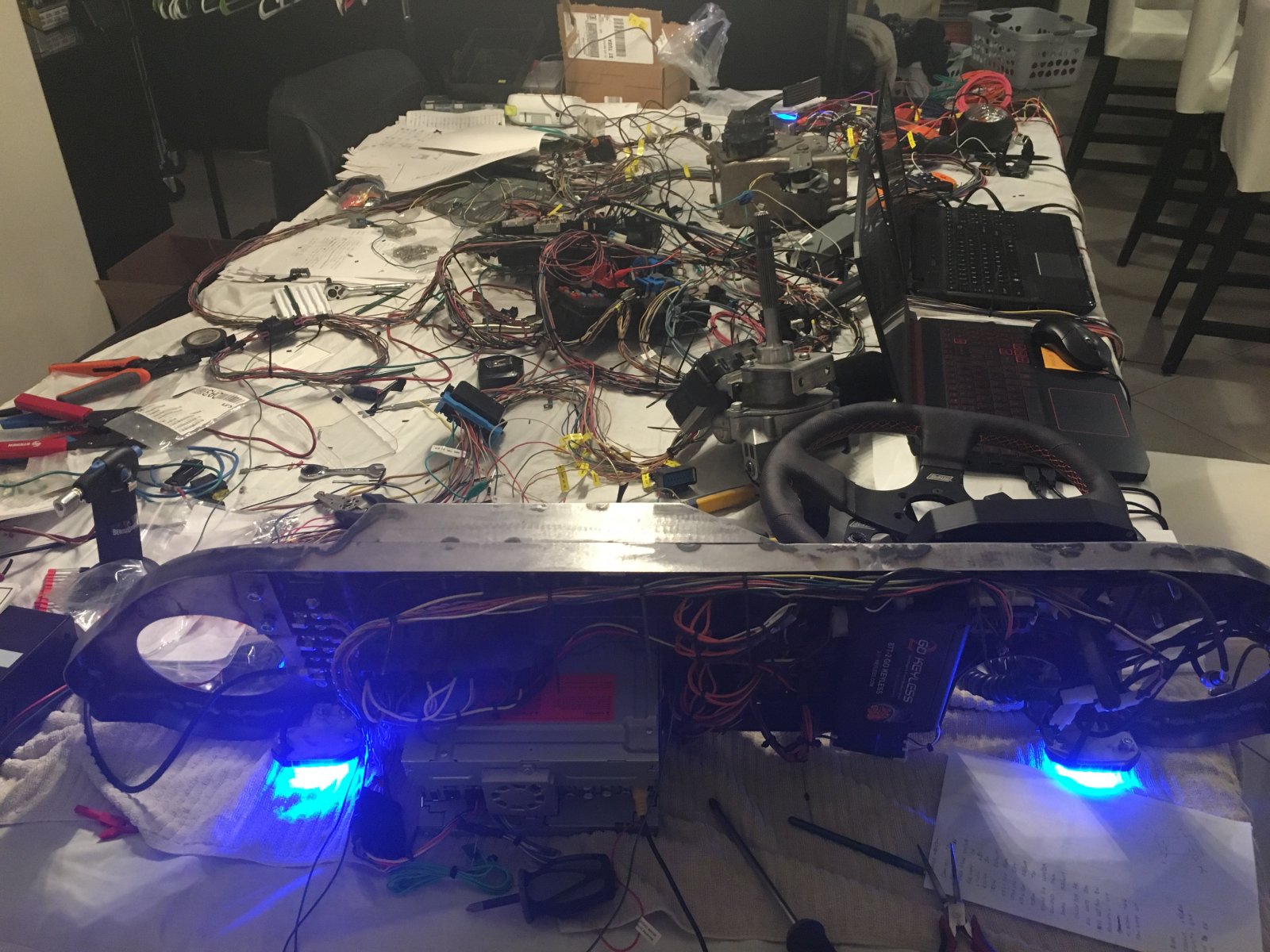

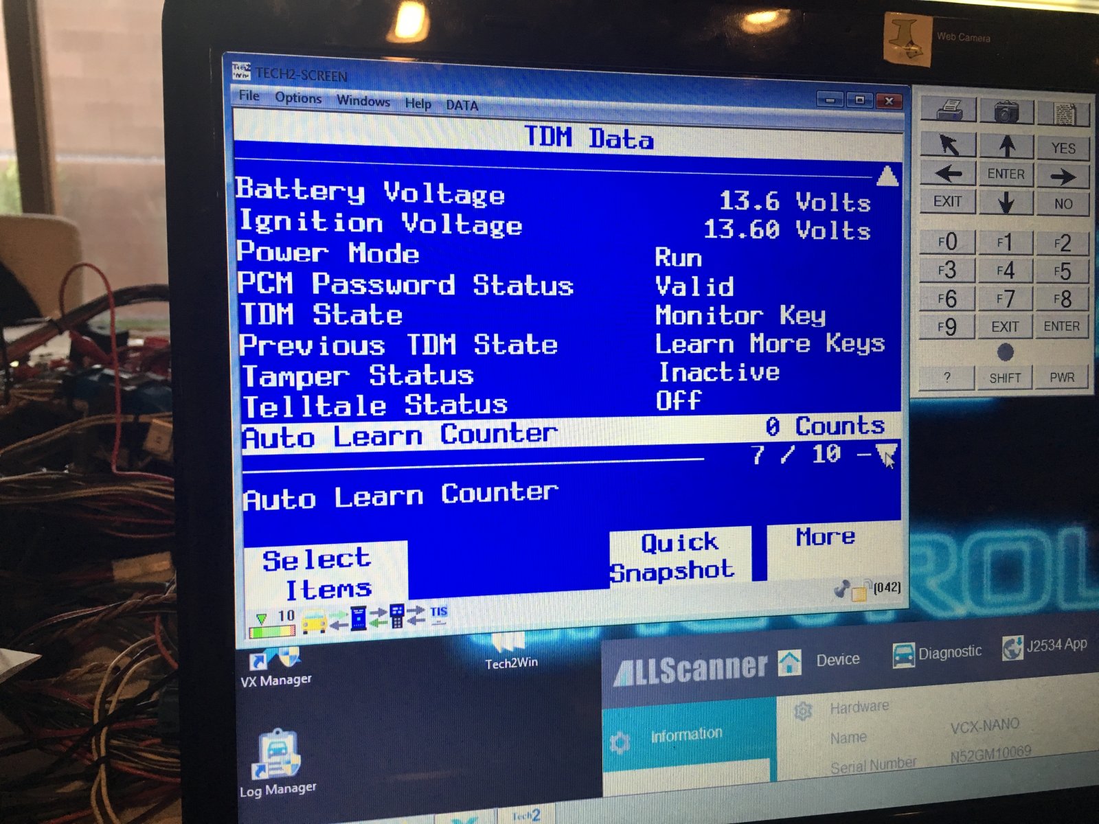

I kept having issues losing connection data from the DLC with the key on. I traced it back to the AIM causing some sort of interference to the CAN bus. I researched a long while to no avail. Then I got the bright idea of adding a couple diodes between the AIM & CAN bus. It worked.
Every function on the tech2 is working great.

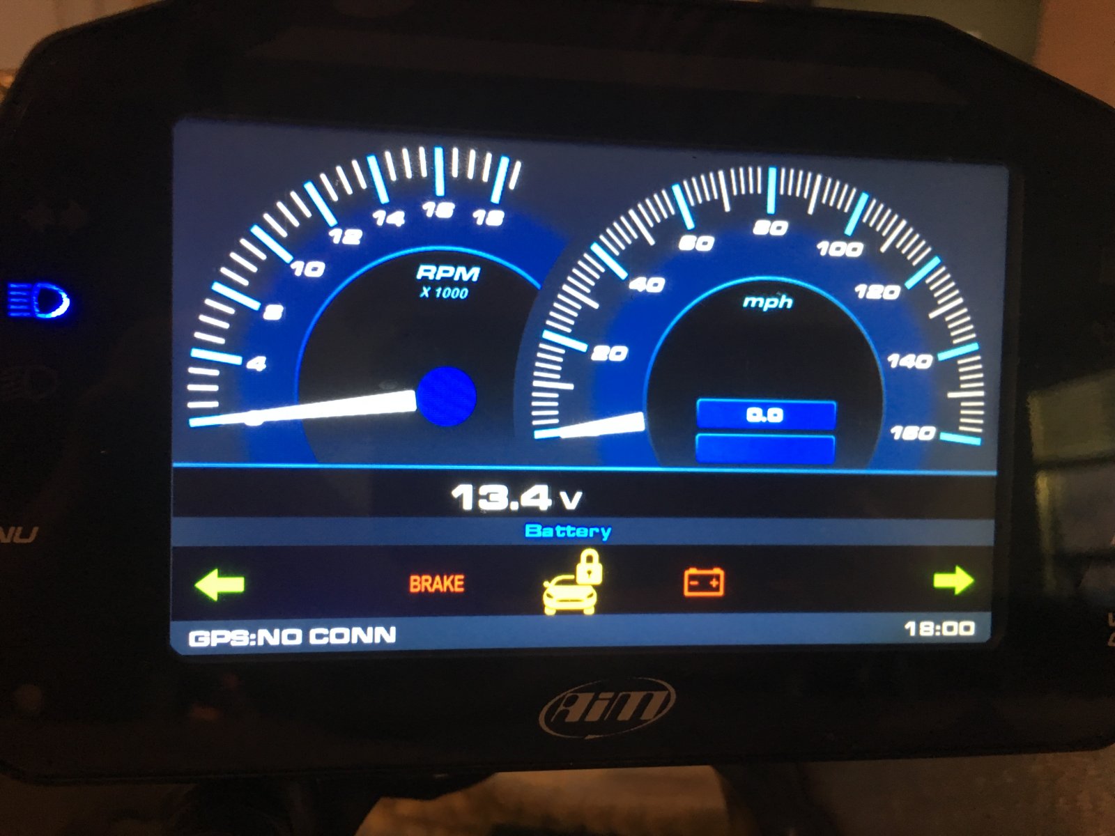

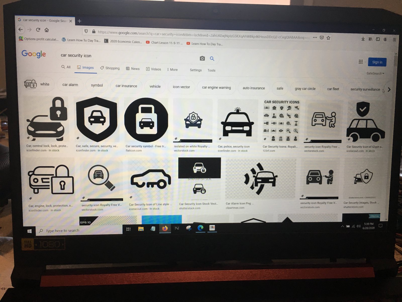

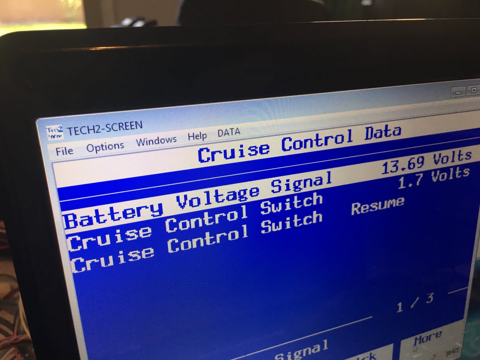

Its super easy to get lost in there. I played around with the AIM a bit by adding some icons to the display while triggering the signals through the BCM with the tech2. High beam, turn signals, anti theft indicator (added custom icon), coolant level, batt, park brake indicators work. I even got my cruise control resisters right, because its registering the proper modes thru the tech2 based on switch positions.

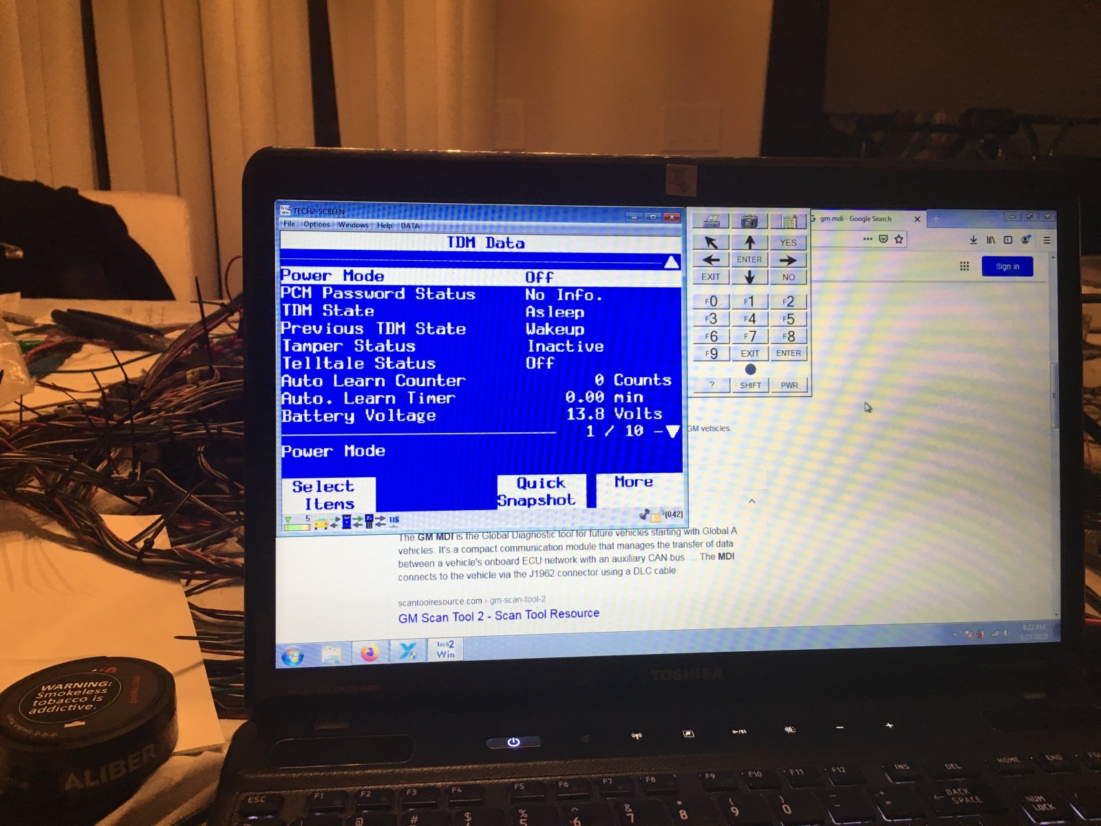

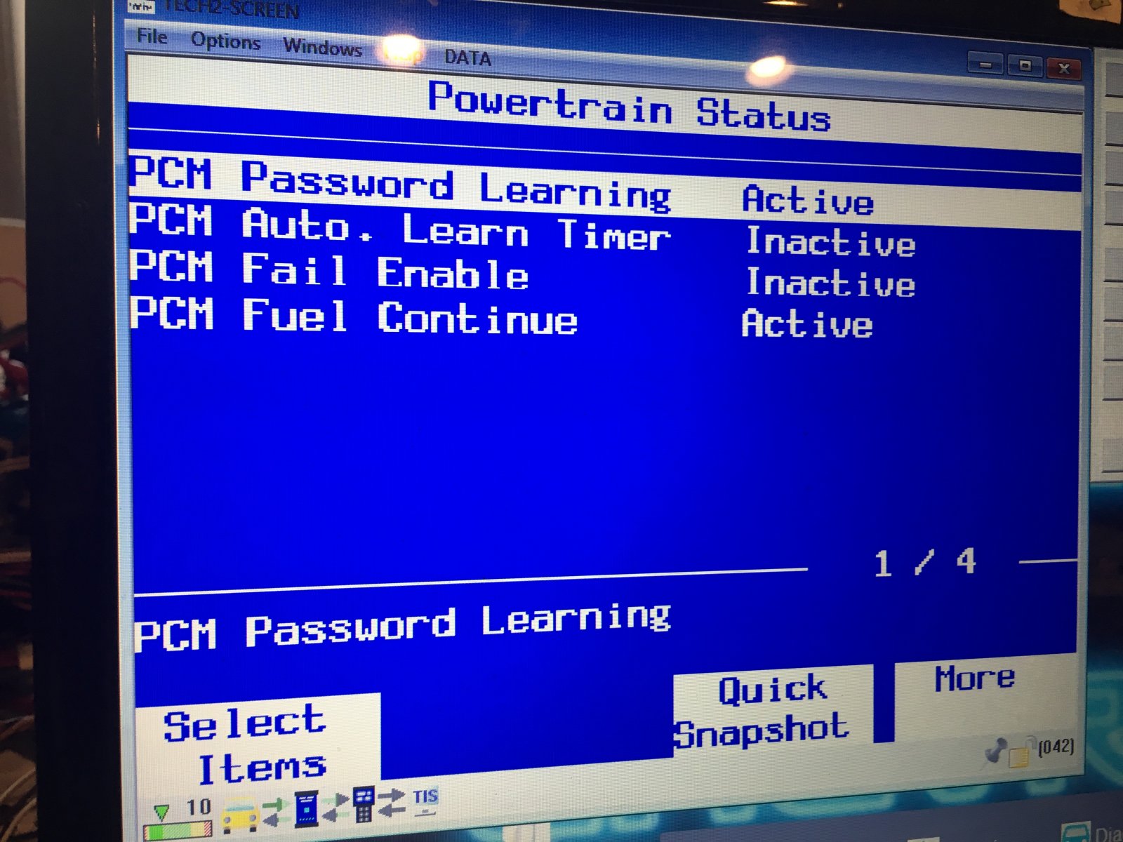

I went to do a VATS relearn (as my TDM is from an 06), and to my surprise it has already learned this new key and TDM and enabled the ECM.
I still have some wiring to do, but feeling pretty lazy at this point.

I’ve been working on things in the evening after work. I recieved the proper momentary grounding Carling switch for the fog lights and ran the wiring for it. Works as advertised now.

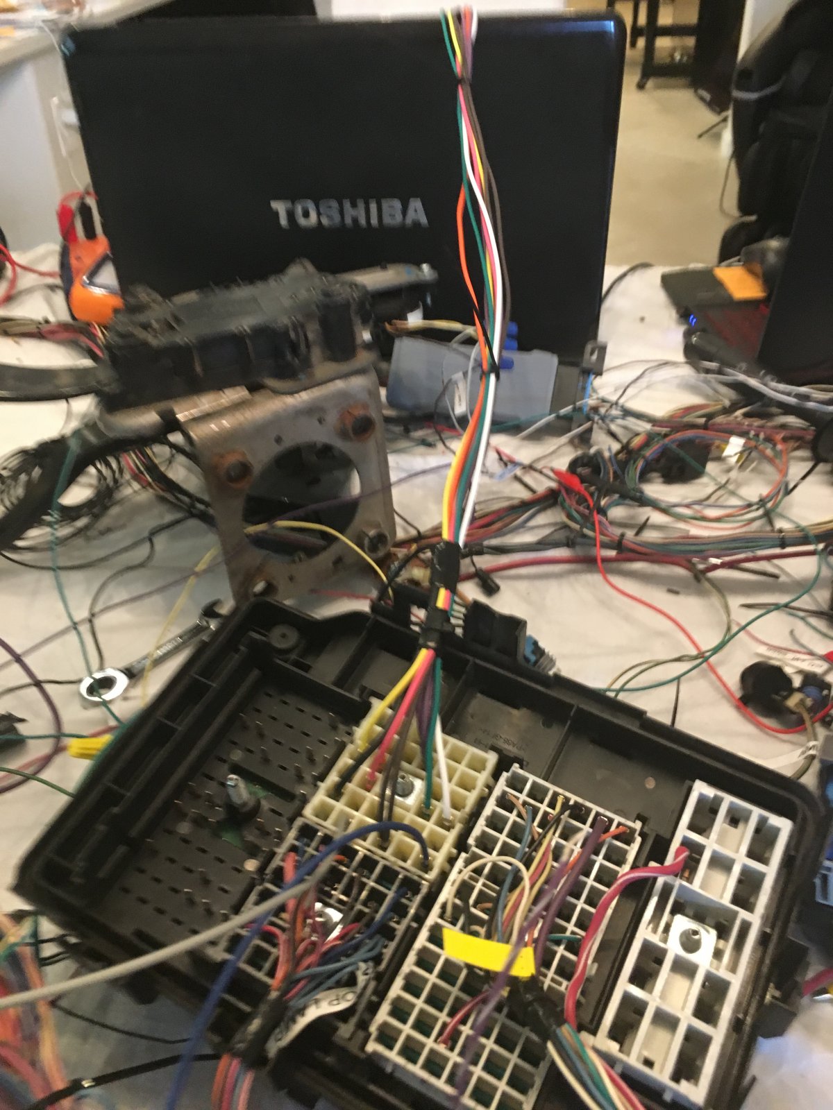

4 day weekend ahead... I’ve still got to finalize my dash to body harness connector. I’m having one last issue with the Aeroforce gauge not liking the diodes on the CAN bus that the AIM does like. I am considering moving the diodes over near the AIM, but waiting for their tech rep to talk to one of their experts as to determine if that’s a good permanant design decision. Not all that impressed with the Aeroforce gauge anyways; quality-wise. May instead put in an AEM wideband gauge. Using terminal blocks on the dash afforded me the opportunity to make future design changes.

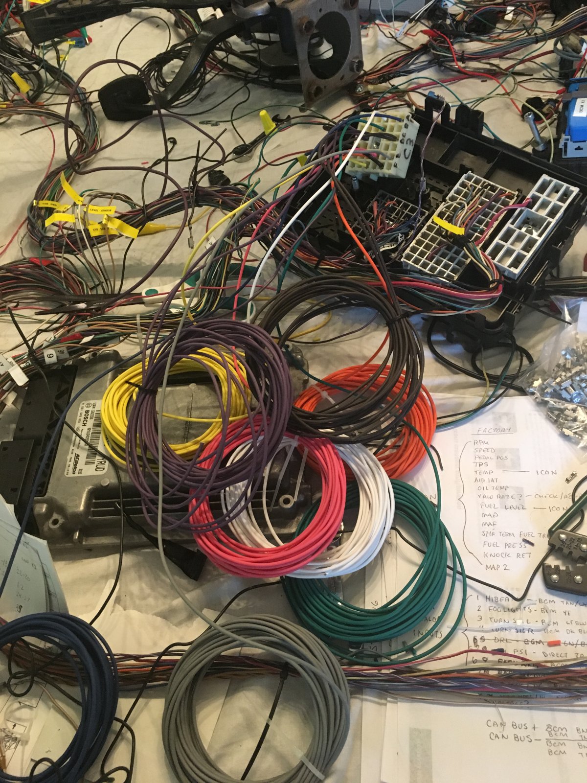

I completely rewired the lighting plug at the fuse box with a nice long wire run that I can modify as needed for all of the forward lights.
I hope to do a temp install/mock-up this weekend in order to ensure proper measurements on the harness, as well as form tape the harness for proper bends, and mark the frame for harness retaining tabs and ground lug locations that I will weld in later. I also need to run the communication cable for the GPS module and AIM channel expansion. I may add some channel wires for a wideband O2 sensor as well for future use.
Once that is done, I will pull the harness, add the remaining few connectors, and wrap it.
