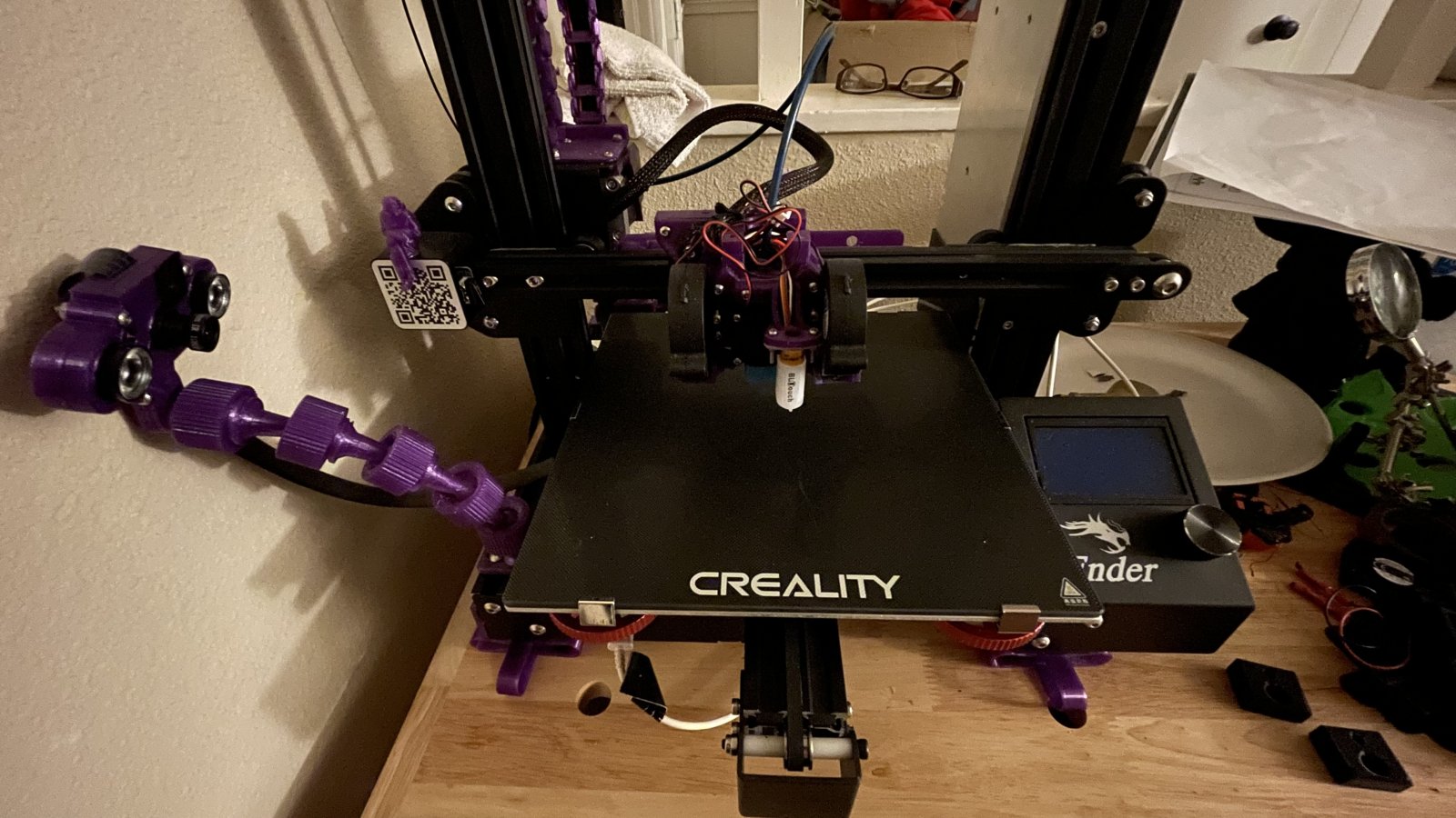

What material did you print? I love how you integrated the zip tie channels, that's probably the cleanest application of a zip tie as I can imagine.
PLA+. I am already thinking about upgrading to a hotter direct drive extruder to run PETG.

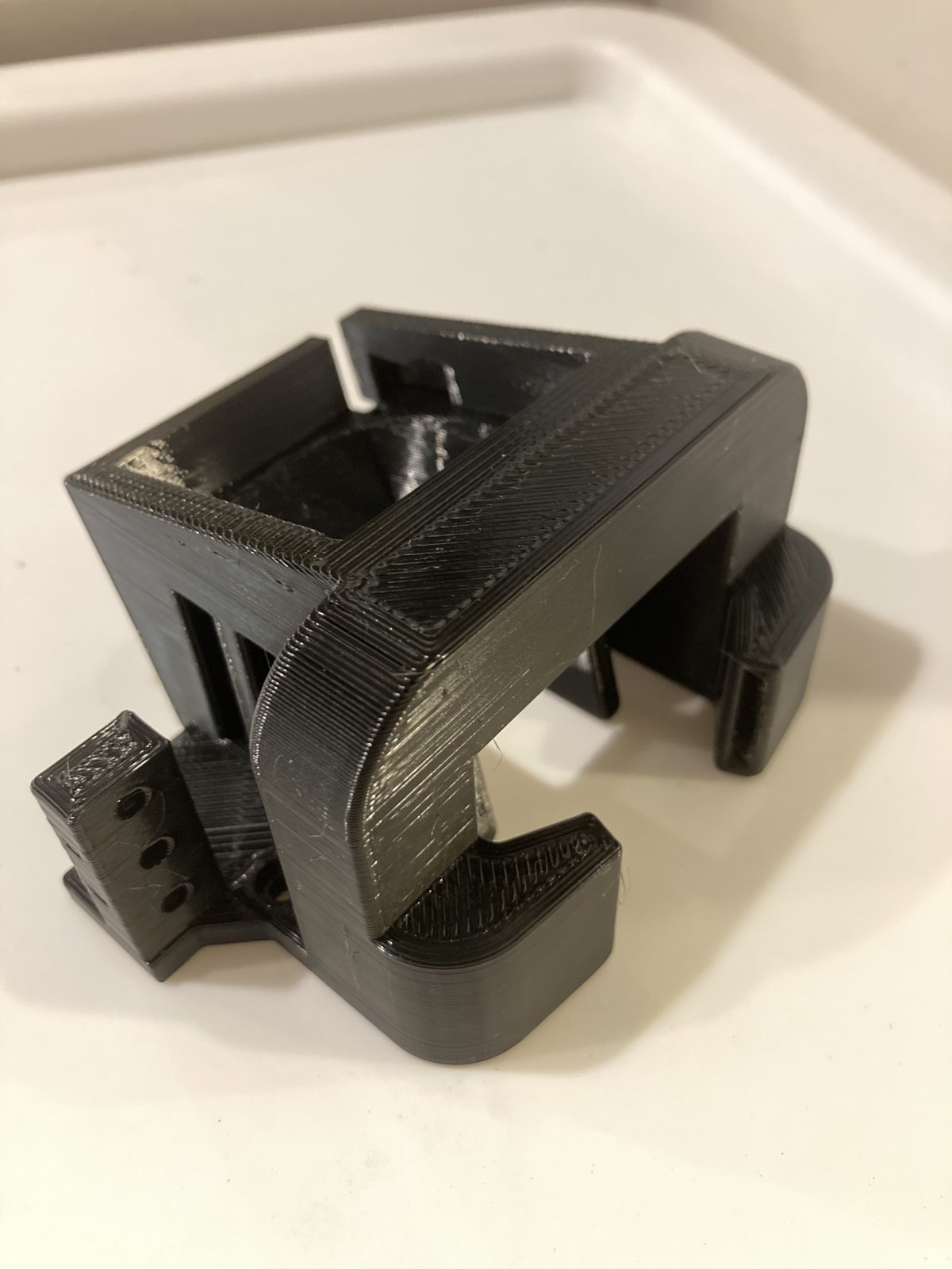

I decided to try my hand at PETG today, as I dont feel that PLA may be suitable enough for the heat & direct sunlight here. Took me 8 tries to get the extruder temp, speed, and 1st layer height. Then took a few more test prints to get bed temps and good proper bed adhesion. Once you know what to look for, its easy; but **** it sure is time consuming…

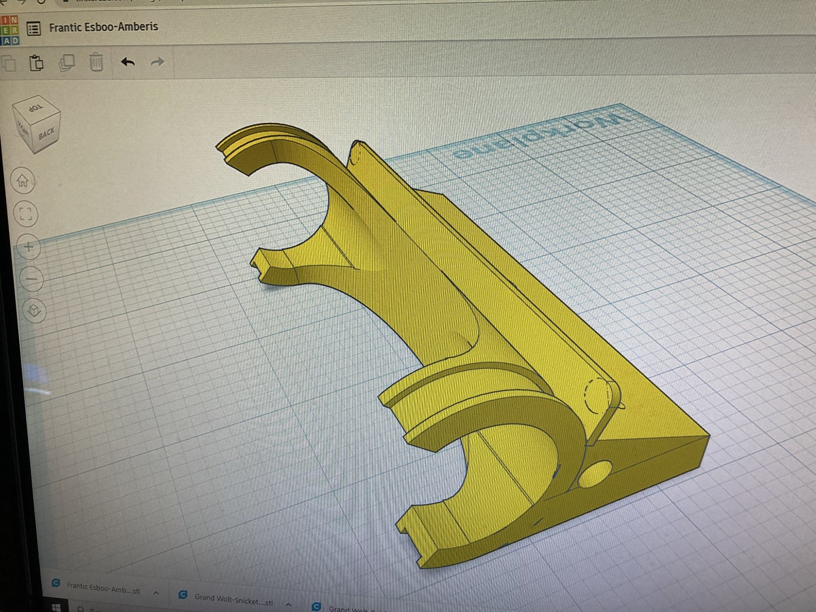

Once I got everything tweaked, I started another LED light bracket. Its printing as I type… I also redesigned the bracket slightly for aesthetics & functionality and added a glare shield to make the light source non-visible from standing eyepoint.

PETG is a different animal than pla for sure. Once you get it down you'll probably never go back though. I think the only real benefit to pla is the ability to easily paint it. Temp settings are higher and you don't want your part cooling fan very high if on at all, the only time I turn it on for PETG is if I have lots of overhang or gaps. If you do set your fan to turn on, make sure it doesn't turn on until it's several layers in or you can get the warp and bad adhesion. Also, make sure you wipe down your bed with rubbing alcohol or acetone between each print with a CLEAN rag. I ran out of my roll of paper towels and was foolishly using the same one to clean between prints. I started slowly having adhesion and warp issues and spent days tweaking settings getting closer and closer to no avail. After cleaning with a fresh towel all my troubles went away. On the bright side all that tweaking made my prints better than ever. Haha. I slice with Cura. If you'd like to see my PETG settings let me know and I'll send them over to you to try out.

I am super impressed with PETG. Once I got the 1st level settings tweaked, I was able to resolve the lifting issues by raising the bed temp. This print is just about done and it looks just as clean as my PLA print. I will do a side by side heat/stress test on both of them tomorrow.
I also think the PEI sheet metal bed is the way to go. I’ve read so many bad reviews about glass that I am surprised anyone even bothers using glass anymore.

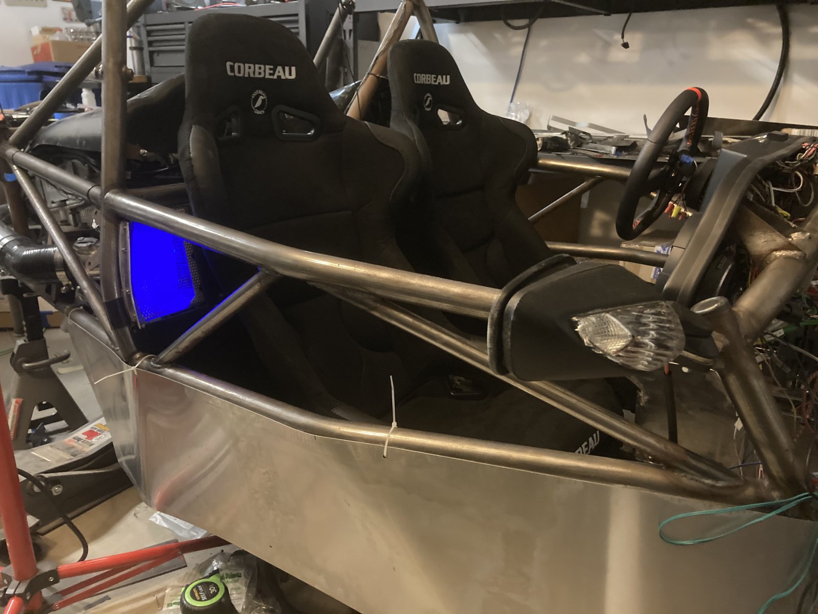

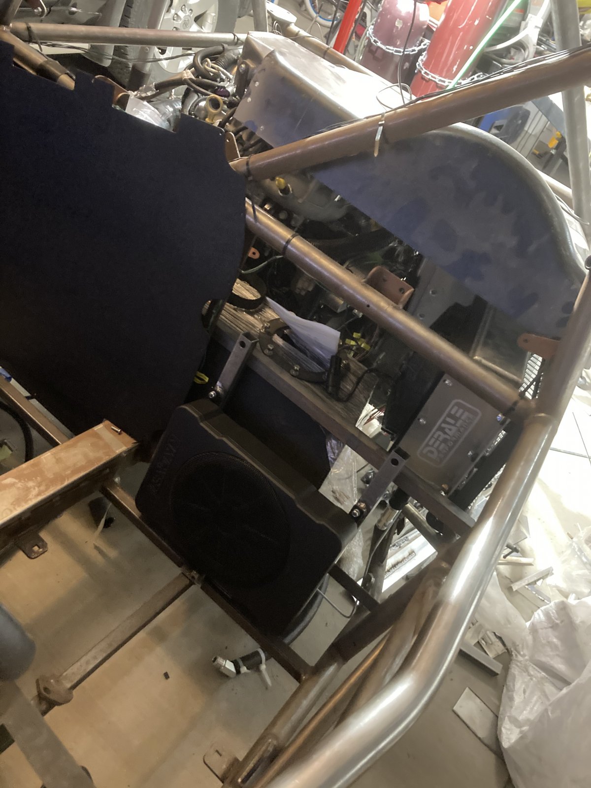

Today I was ambitious. Worked 10 hours straight.
Welded in the subwoofer bracket.
Installed the sub
Installed the seats
Installed the amp
Built out the dash
Installed the dash
Cut the cowlings & installed the rear speakers
Fired everything up. Wow, the stereo sounds freaking AWESOME. I will need to dynamat the firewall because the sub pounds the living hell out of it.
Have a couple very small issues on my dash harness to fix still, but everything is looking good. These new headlights are **** amazing.

Is there any reason that you left the original hood cowl mounts and the cobalt gauge cluster mounts on the frame?
Brian74
I bent a couple of the cluster mounts out of the way for my dash. I use the cowl mounts to confirm alignment. Haven’t really found any pressing reason to cut them off yet.

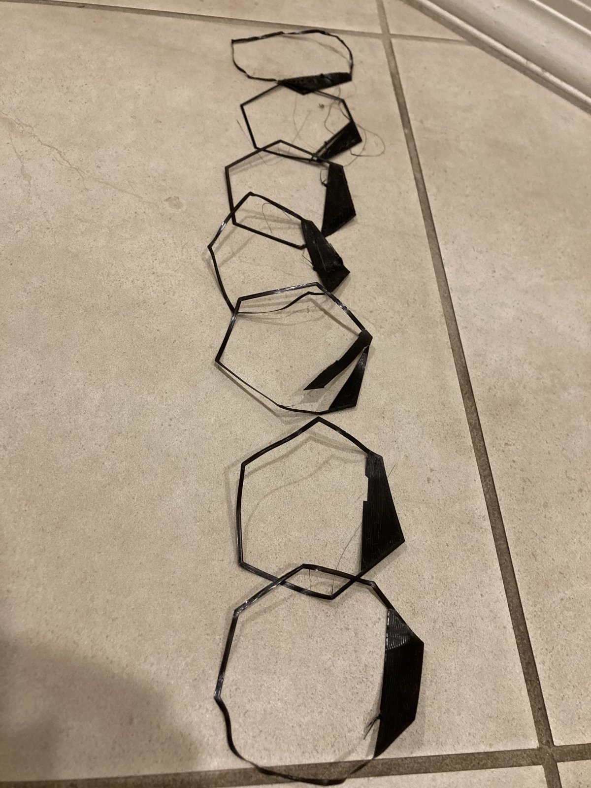

Last week was an ass pain trying to get calibration prints, much less my designs to print. I realized the issue was the filament had taken on too much moisture. Threw the filament in a dehydrator and then to a dry case I made.
Spent a some money on some printer upgrades, based on what I’ll need to run ASA.
This week, I started playing with nozzle sizes and layer heights. The PETG is once again printing well. I also have a few things I need to print prior to upgrading.
I also experimented with the PETG using a .8 nozzle tonight and some different layer heights. I printed out draft 6 of my courtesy light mount in .8 with .6 layers. Wow…solid and unbreakable; freaking military grade.
