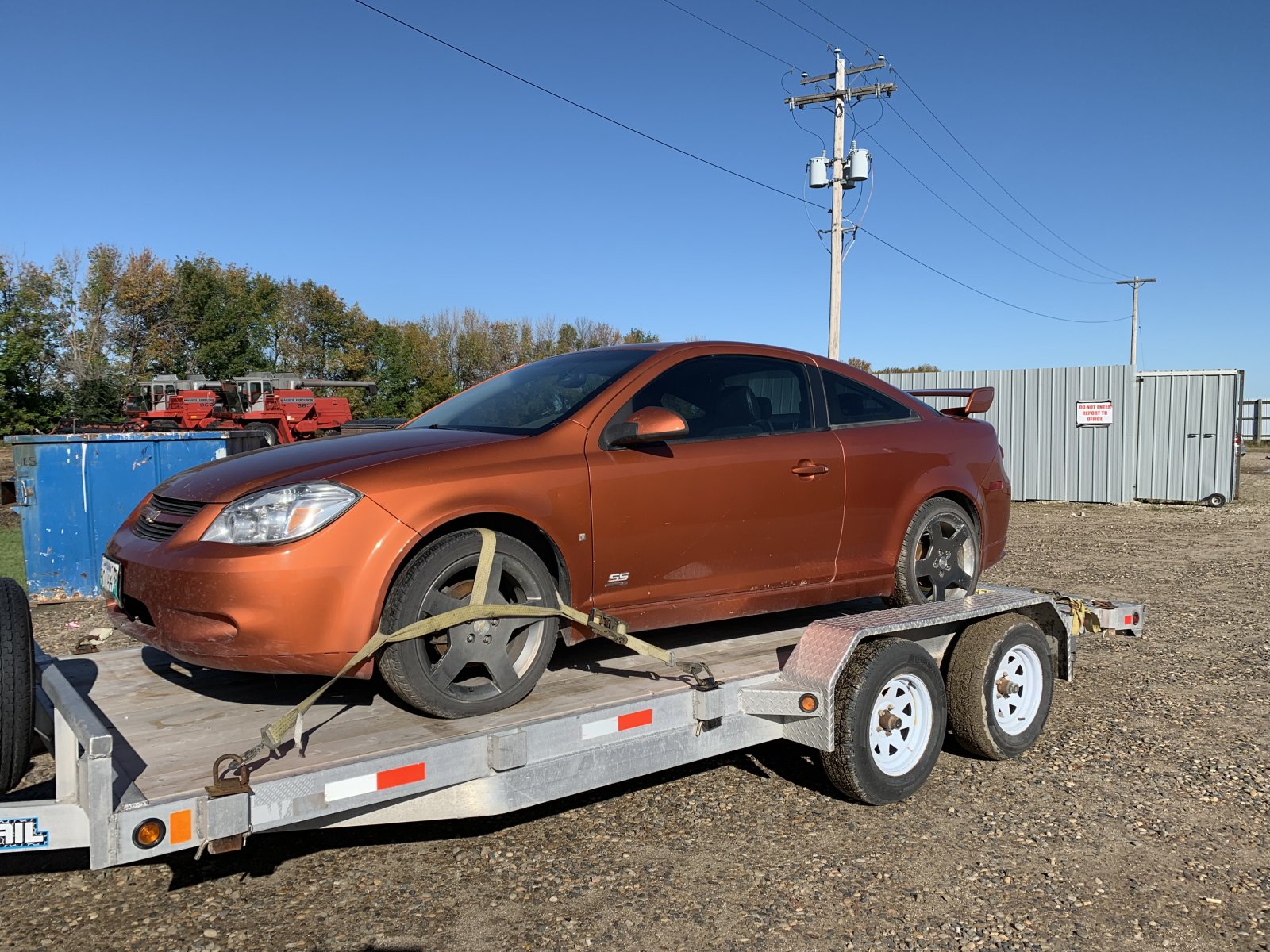

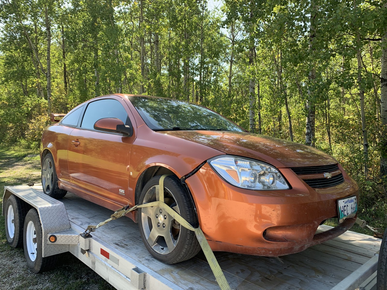

Well I was able to acquire the 06 SS Supercharged. Turns out it was a young lady’s car and it’s in very good condition except for the lower spoiler in the front where she made contact with the ditch pushing the rads back against the engine. With a slight tug back some clearance was achieved a turn of the key and she fired right up sounding sooo nice. Right up onto the trailer and she’s mine!! Overall the car looks to have been very well maintained.

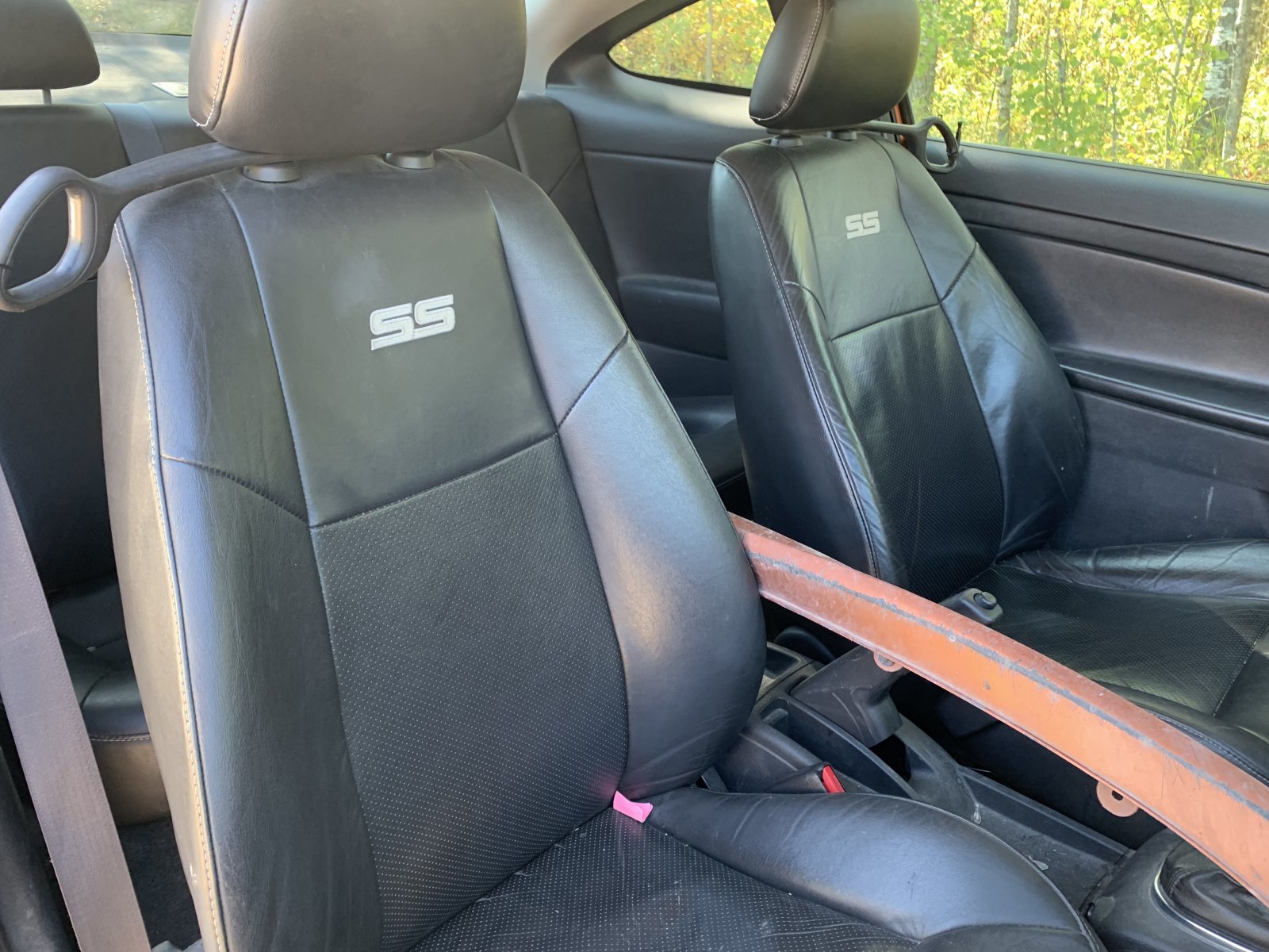

Great donor. Leather seats and the interior looks excellent. Should be able to sell many parts to help recoup the cost of the car. Guessing it has an auto trans? That should sell pretty easily if you are still considering installing a manual. You will need the clutch pedal and hydraulic setup. If you are required to have a hand brake, make sure to keep the whole set up. The ECU will need to be reprogrammed to eliminate the trans controller. You're off to a great start!

Yes it is a very good donor! It’s a SS SC 5 speed standard. This will be my goblin car but I also have an 08 sport with a 2.4 NA Automatic that’s a daily driver. So I’m going to “Up grade” the Sport. Looking forward to getting at it.
