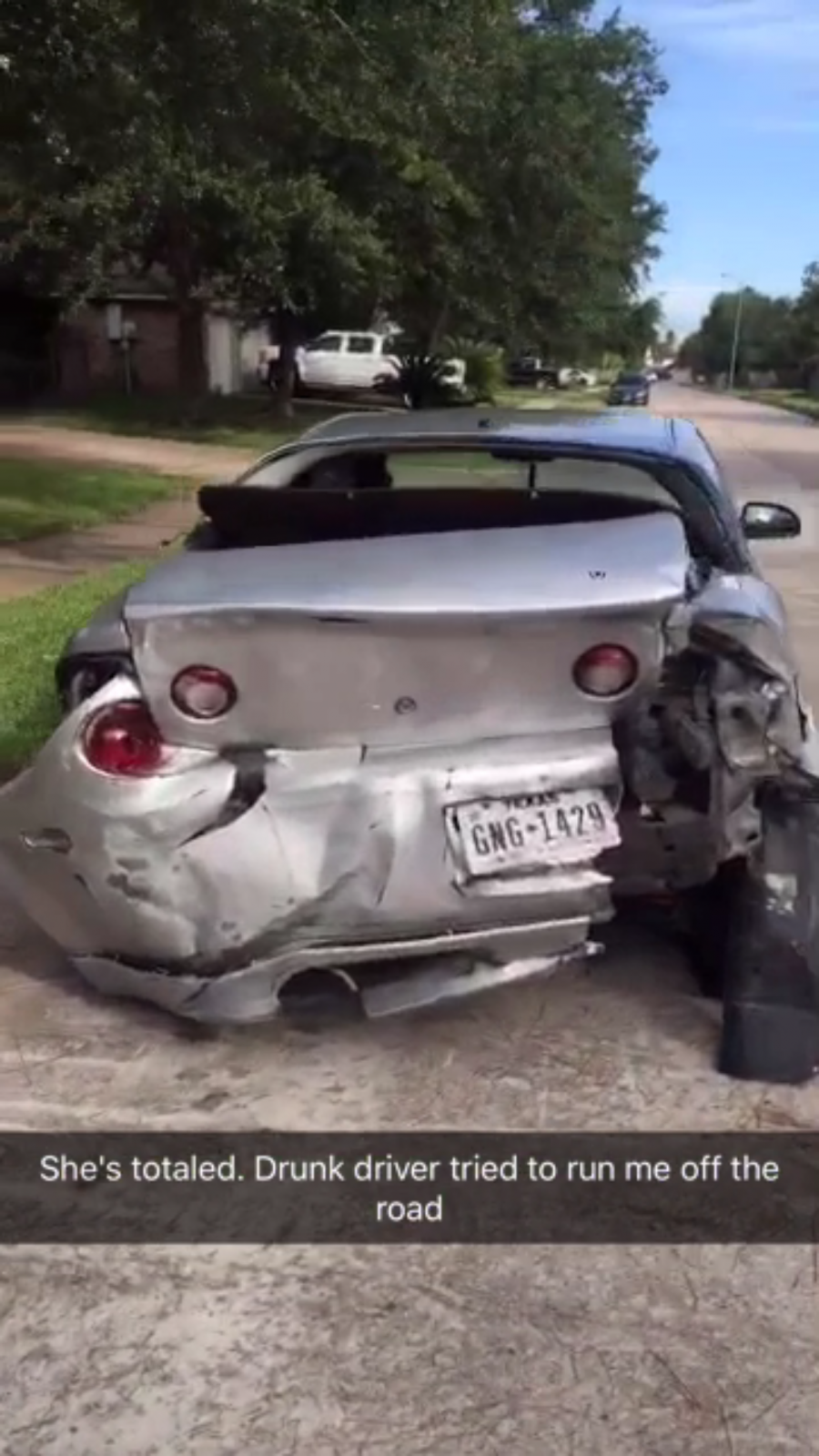

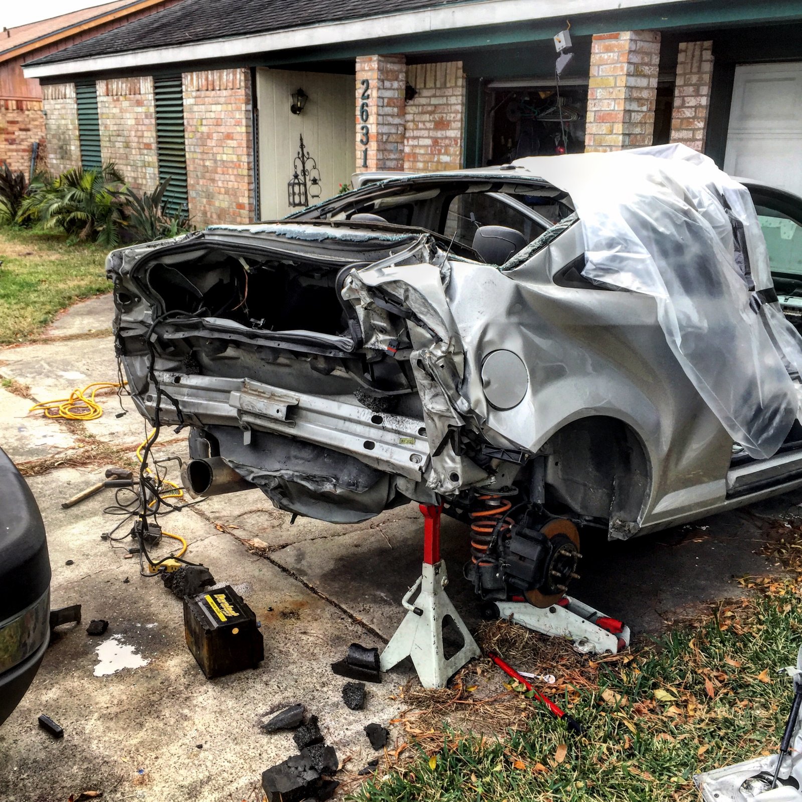

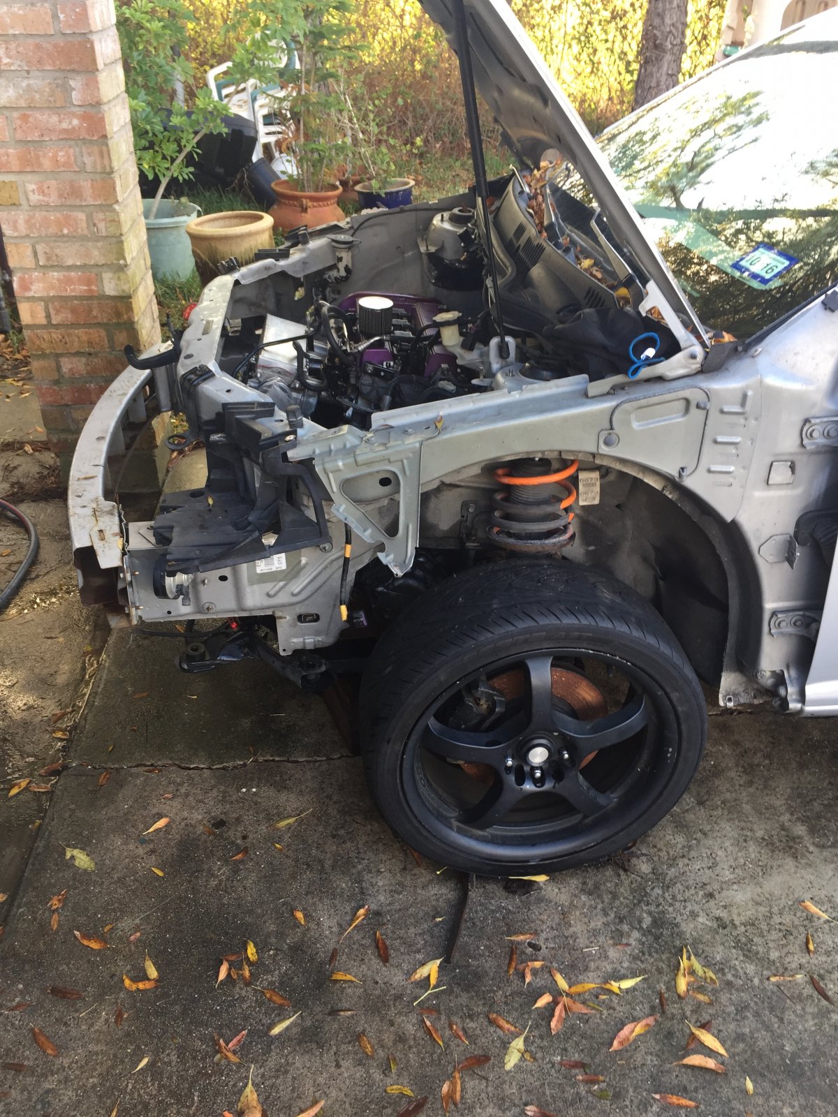

new build. Just ordered my frame it's gonna be a dark purple (will post pics) soon. My 06 cobalt ss was totaled by a drunk driver so I found out about df goblin so I pulled everything out of the car and painted it..

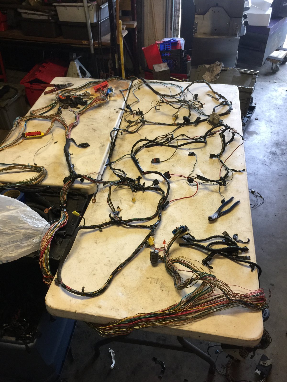

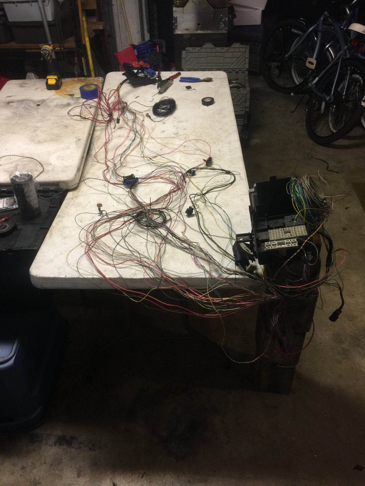

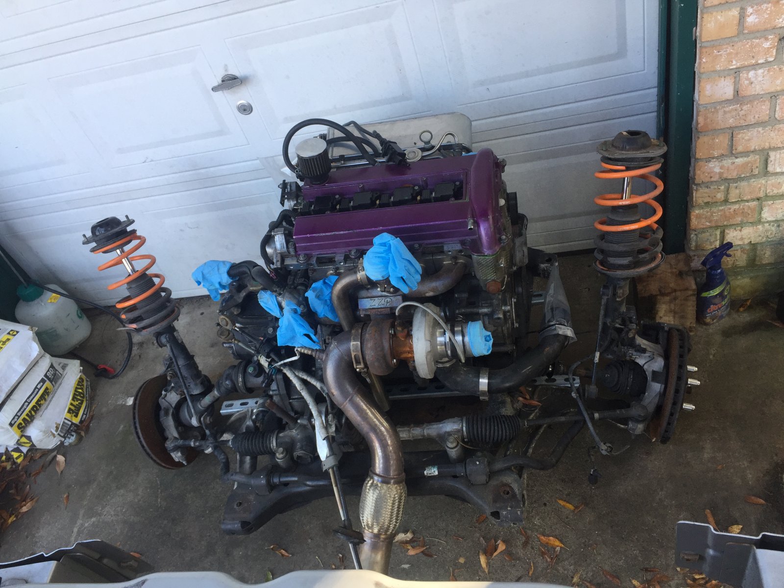

subframe is out and I've painted most of the parts already now I am working on wiring it's a bit different from the videos they have posted but if you have the money I would say send it to them and let them do it. I'm on the last video of the wiring I maybe have a few hours left. I'm going to try to get it done this weekend cause I will be on a turnaround starting Monday

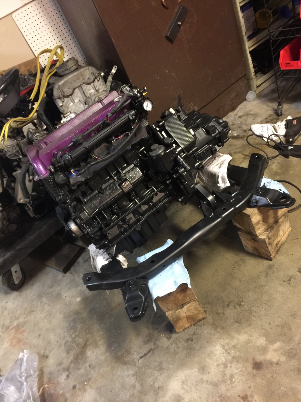

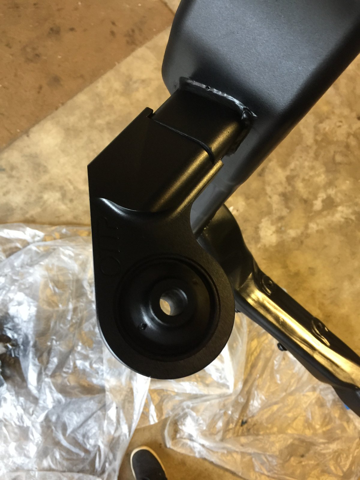

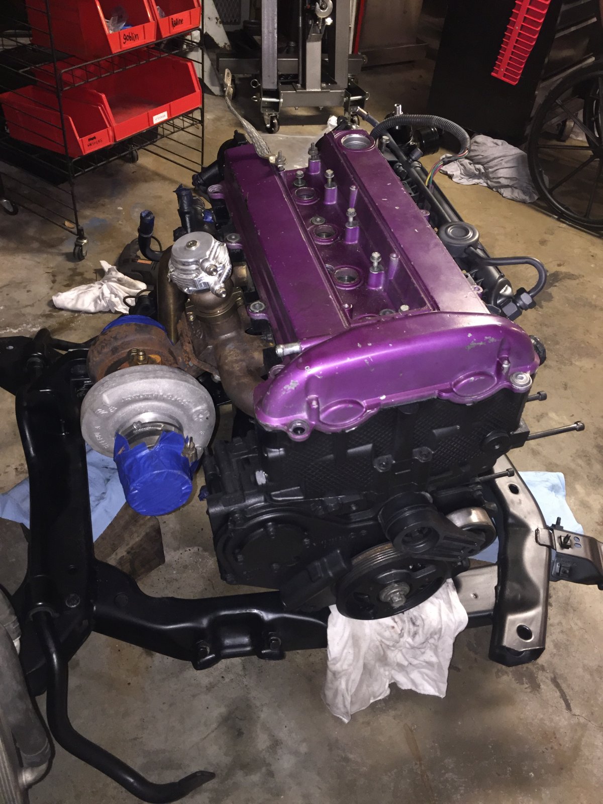

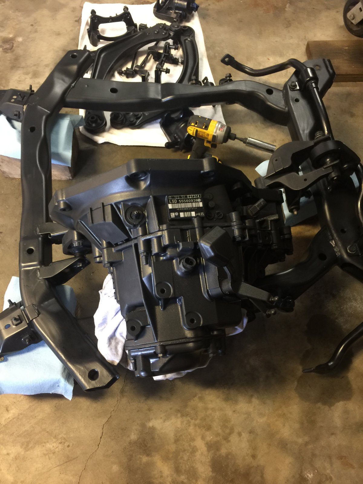

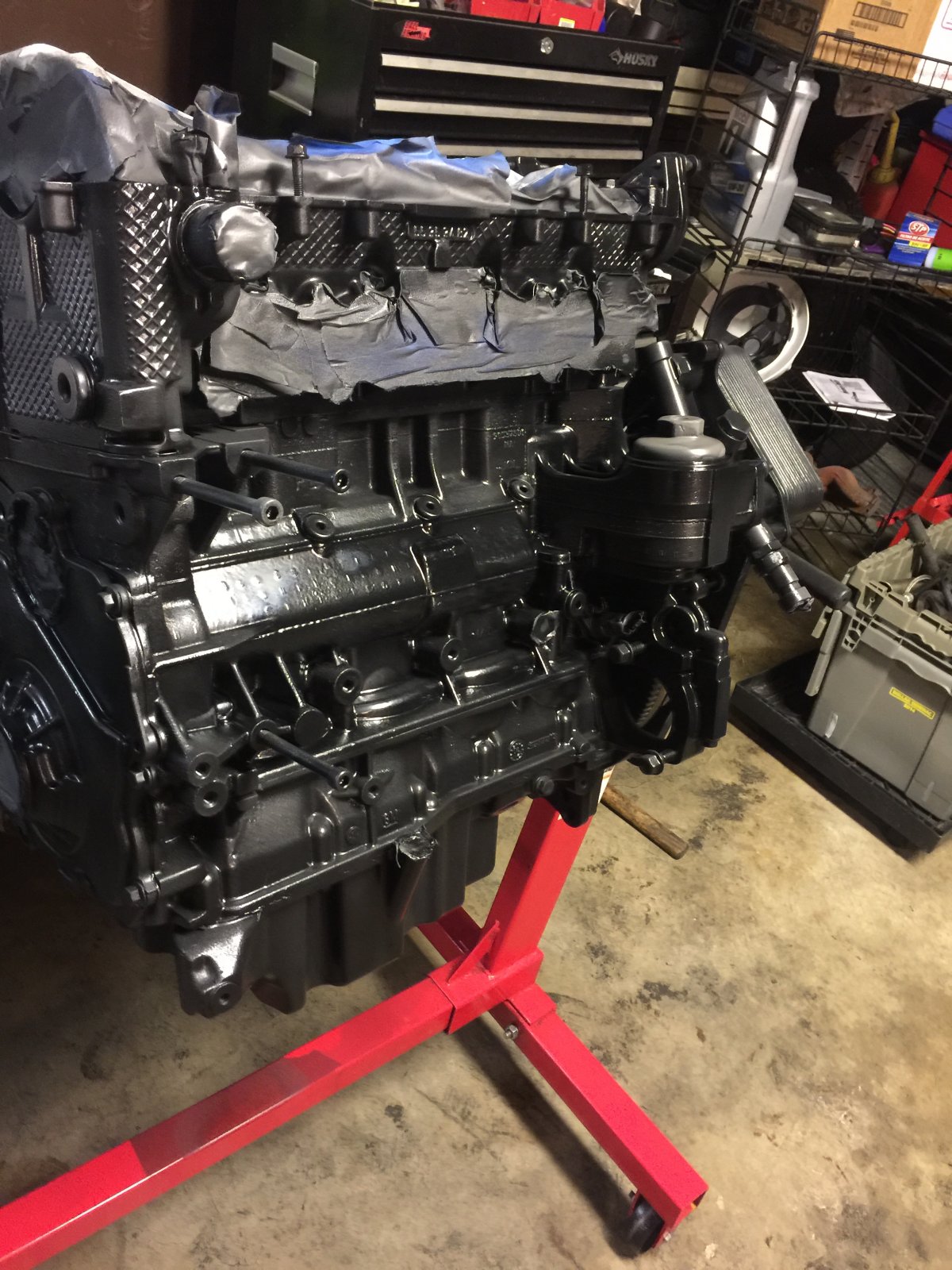

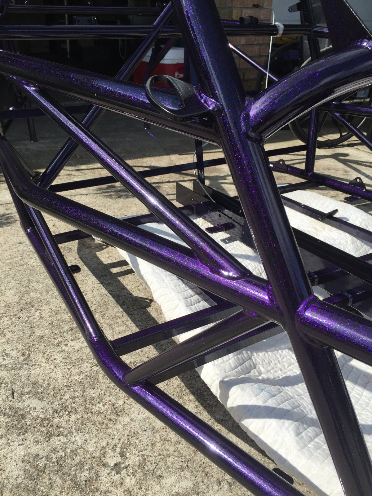

Stacked the subframe yesterday. I've been slowly painting the motor and trans and all the other parts. I finished the wiring harness I'll have the guys at df kit car look at it to see how many extra plugs I have haha. Frame should be here within a week then I'll start slowly putting it together.
canyon bolieu

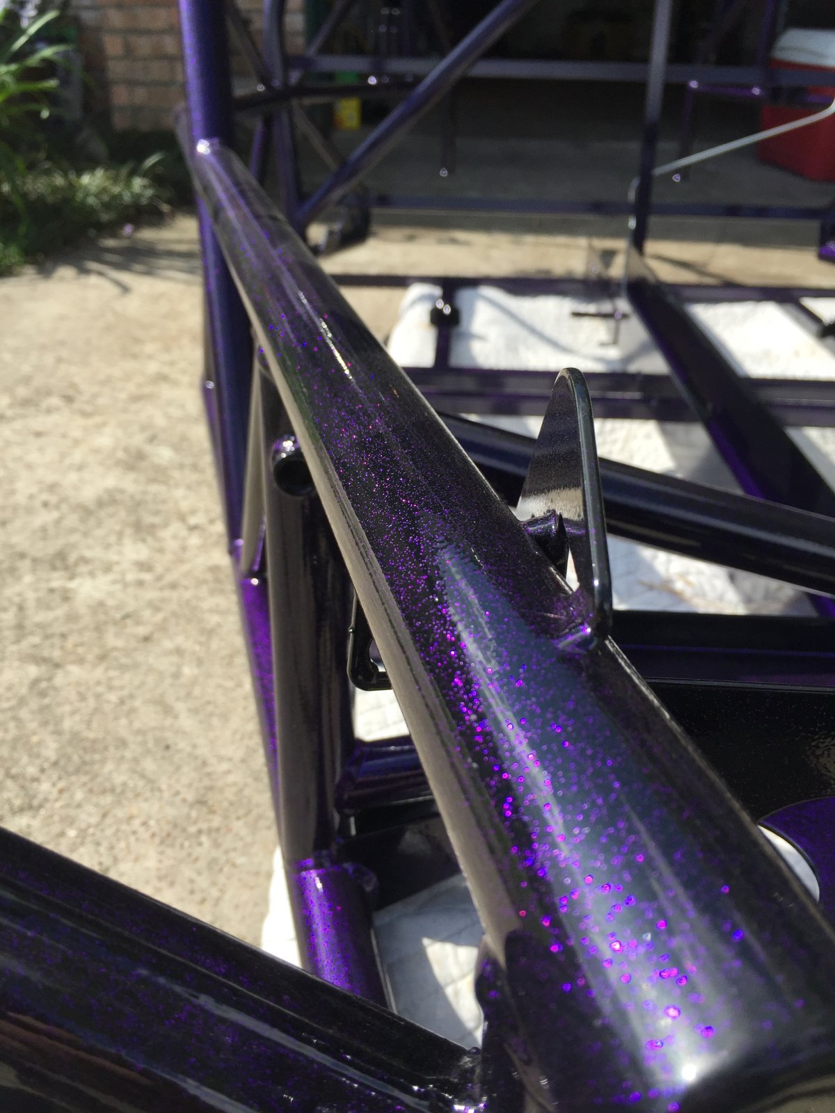

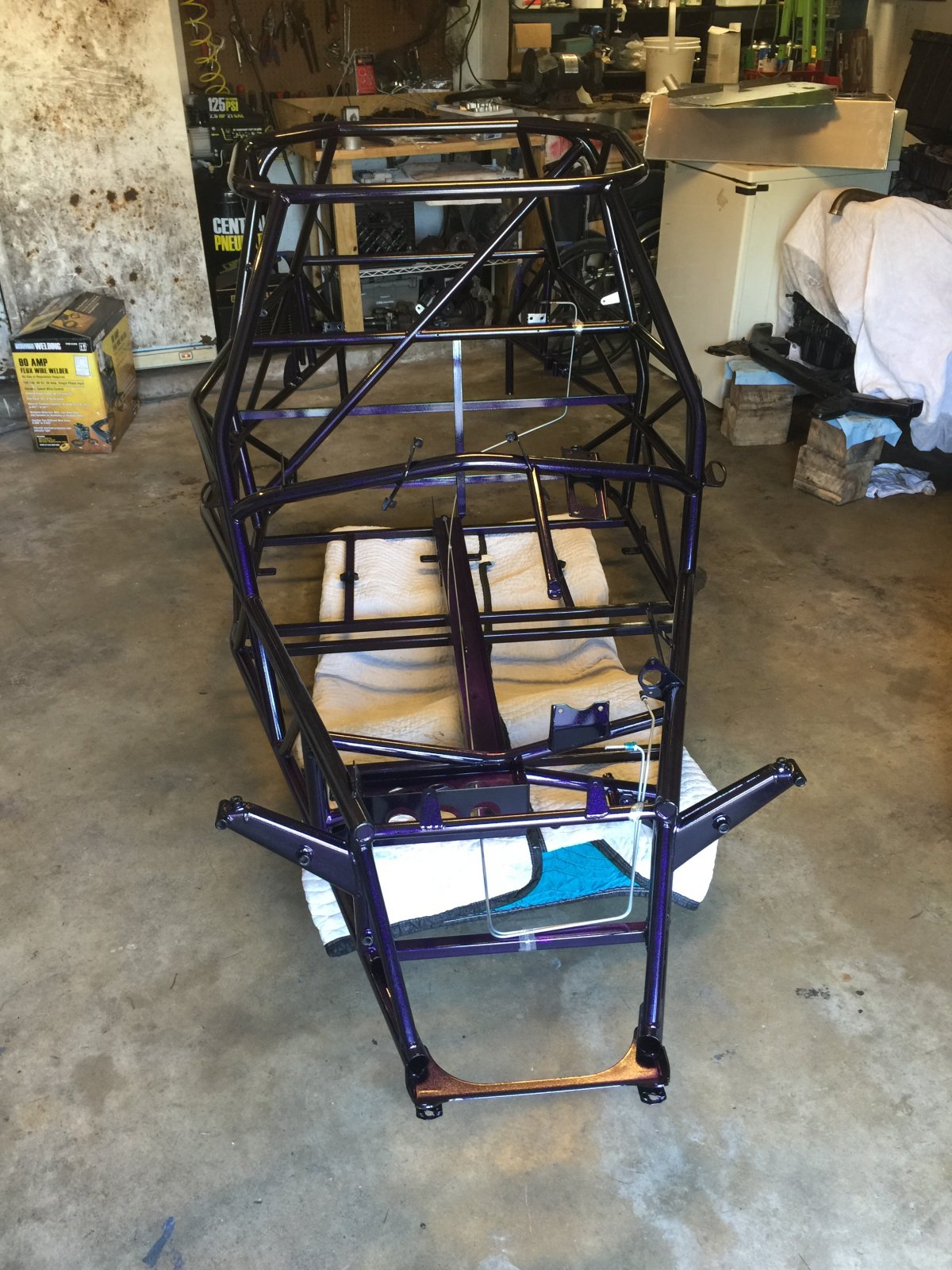

Well the frame has arrived with stage one and stage two, the color came out beautiful better than I thought it would. Just went to Louisiana for a job but once I get back I'll start installing piece by piece taking it slow. The color of the frame is disco purple.

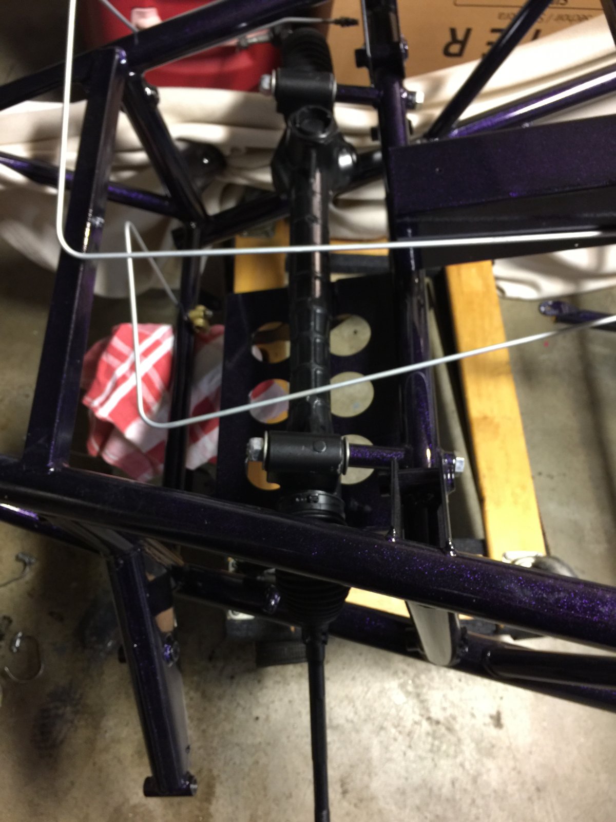

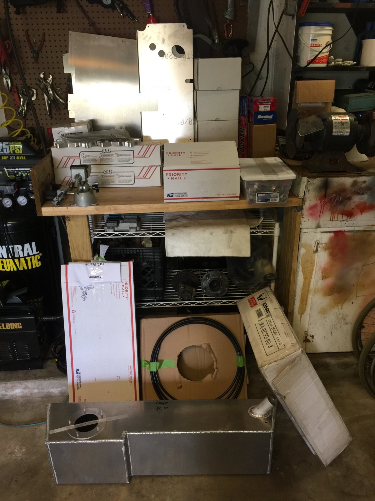

Well just got back from Louisiana today so I decided to see why I could get done in a few hours. So I installed the brake t's, steering rack, and one of the cooling hoses... that cooling hose whooped my ass hopefully the next one is easy I'll find out in the morning I guess!
Tomorrow I will be dropping off the sheet metal to get powder coated along with a few other pieces. And I still have a few more to sand down and paint like the pedal boxes the intermediate shaft and pedals not sure why I painted the calipers and literally everything but those few and they are the first pieces that get installed ‍♂️♂️♂️

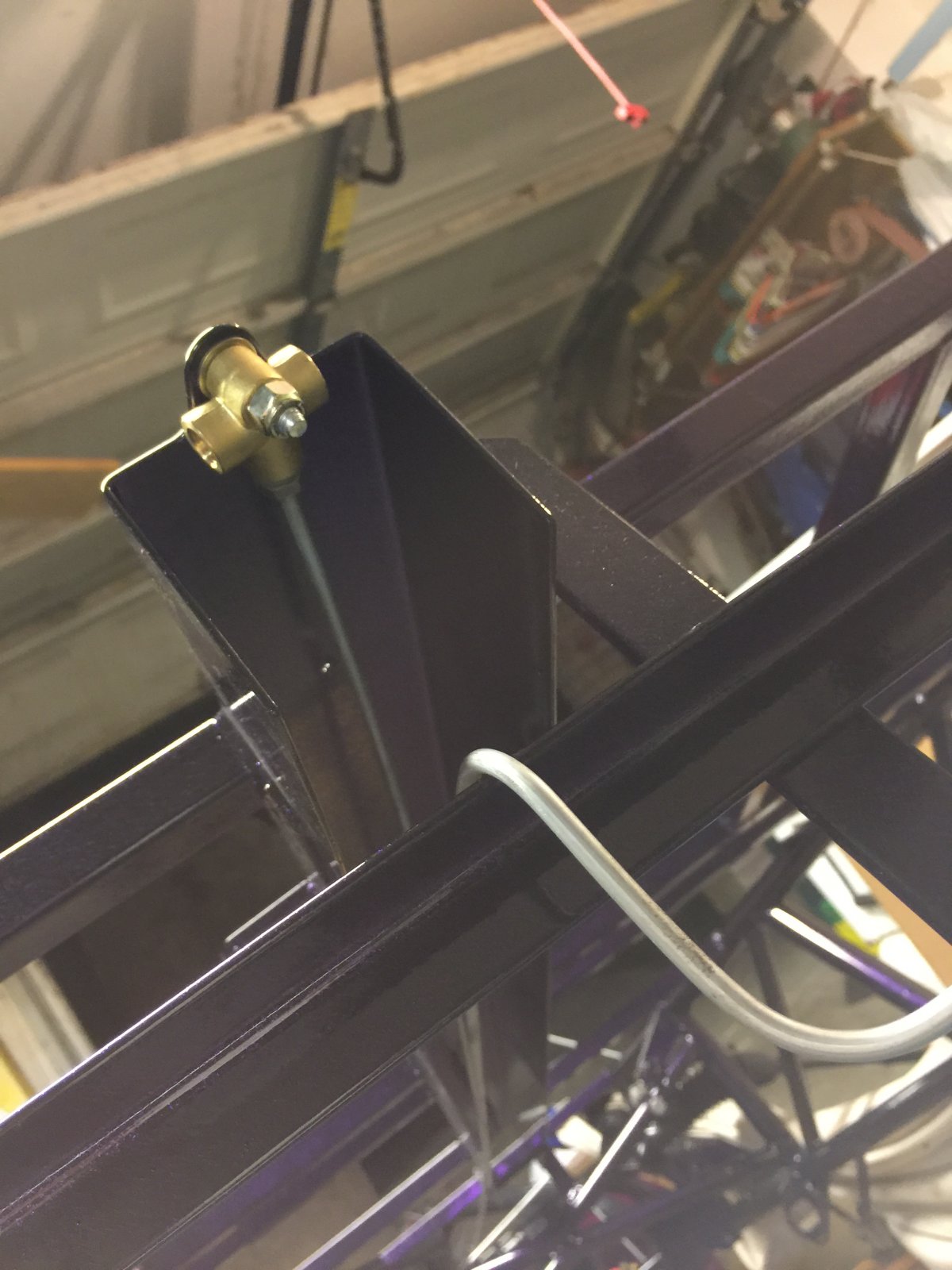

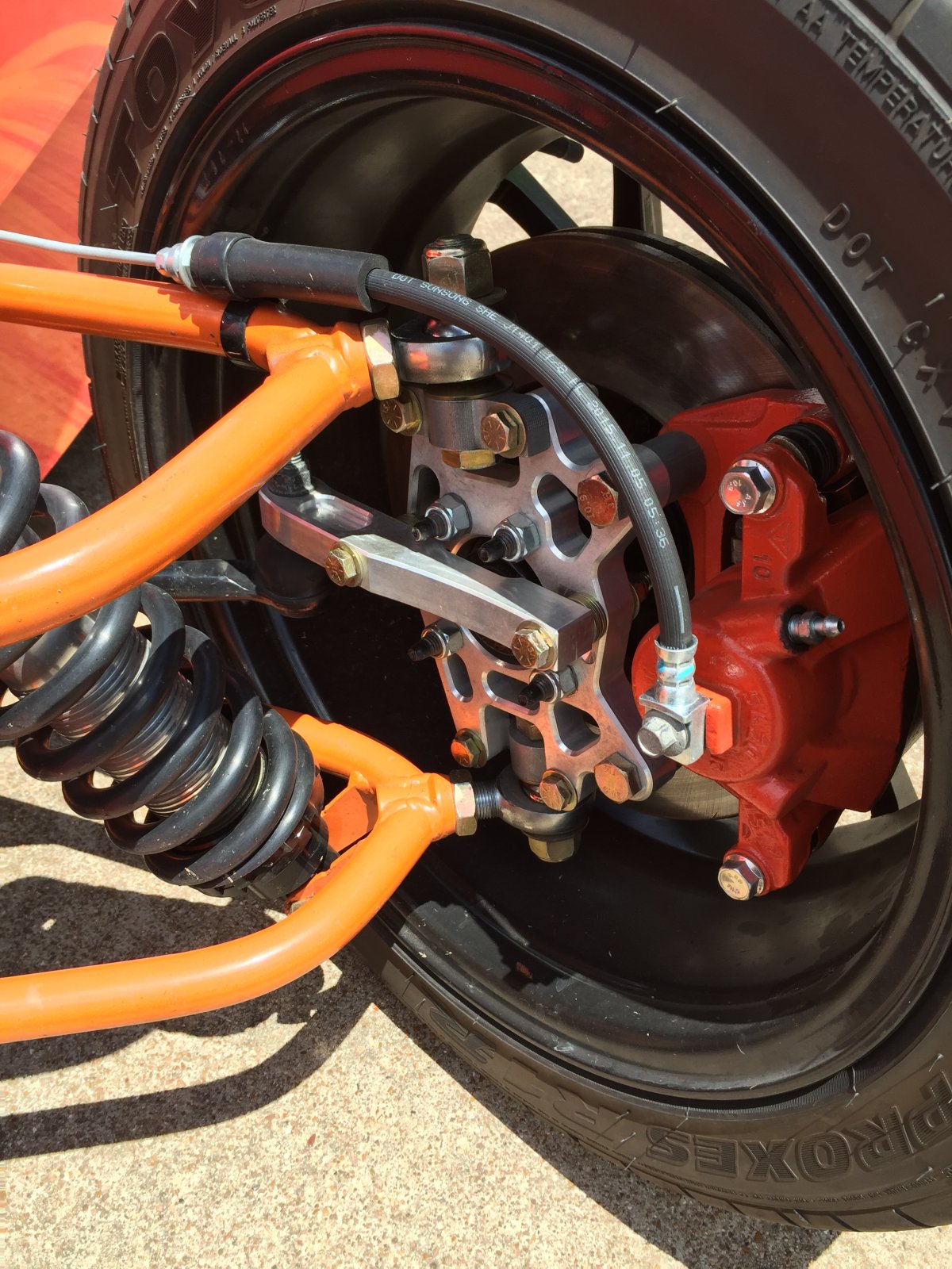

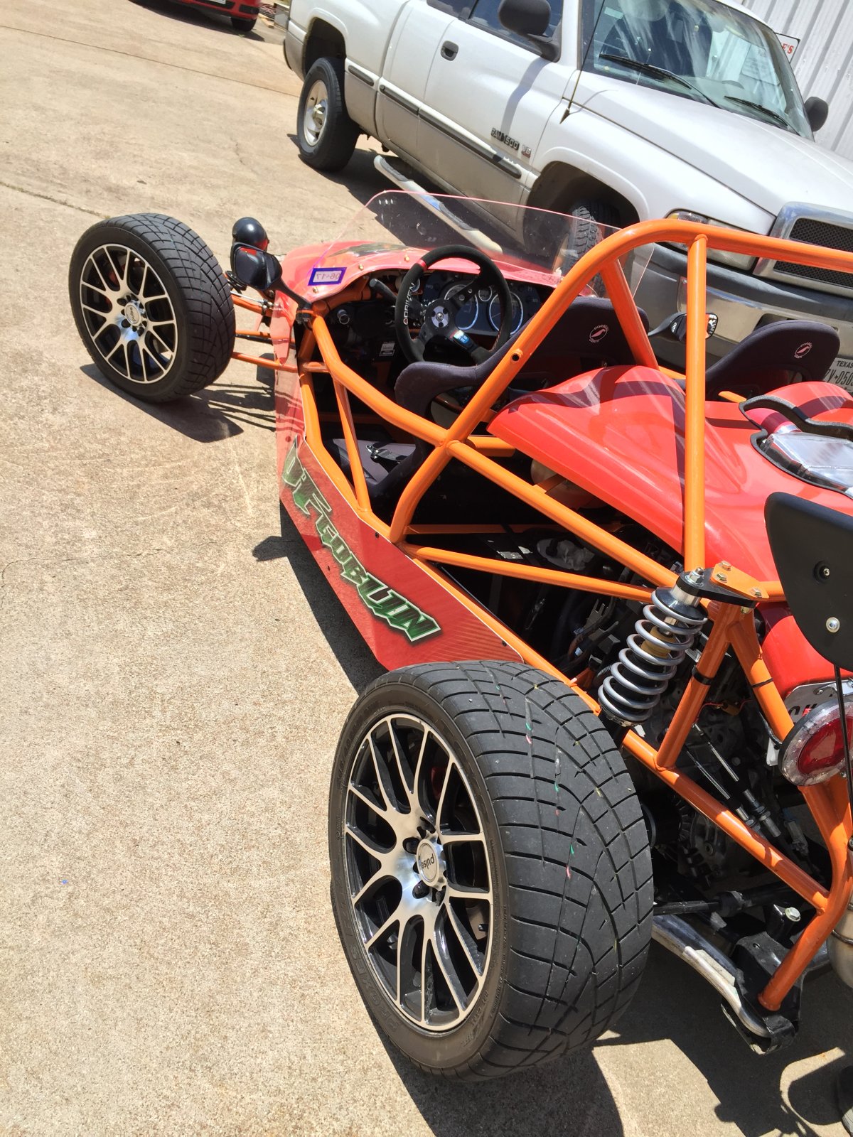

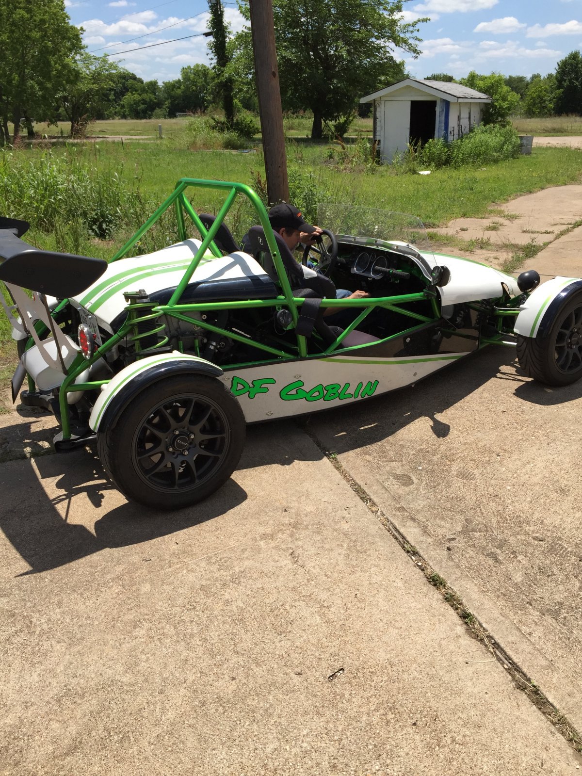

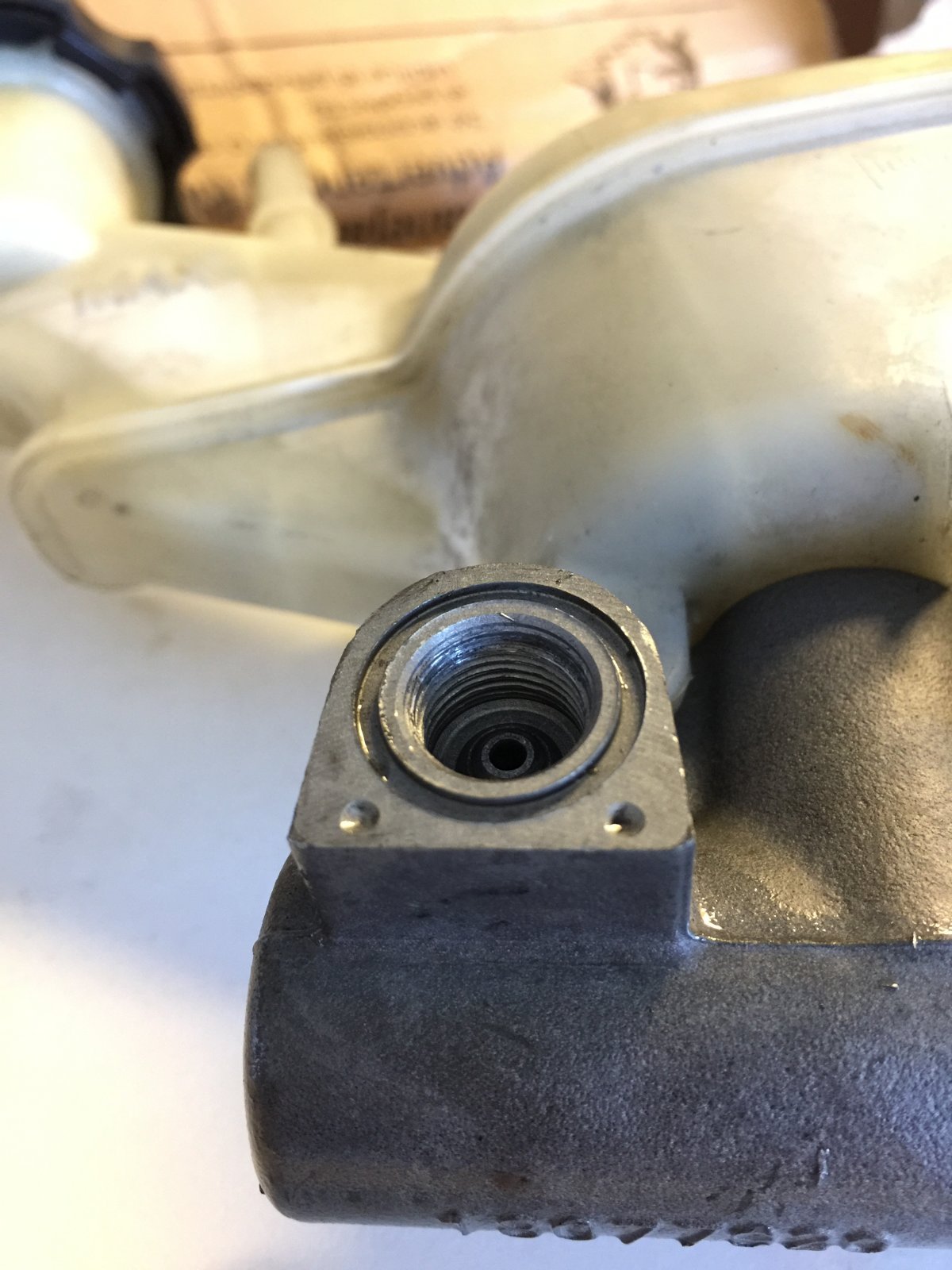

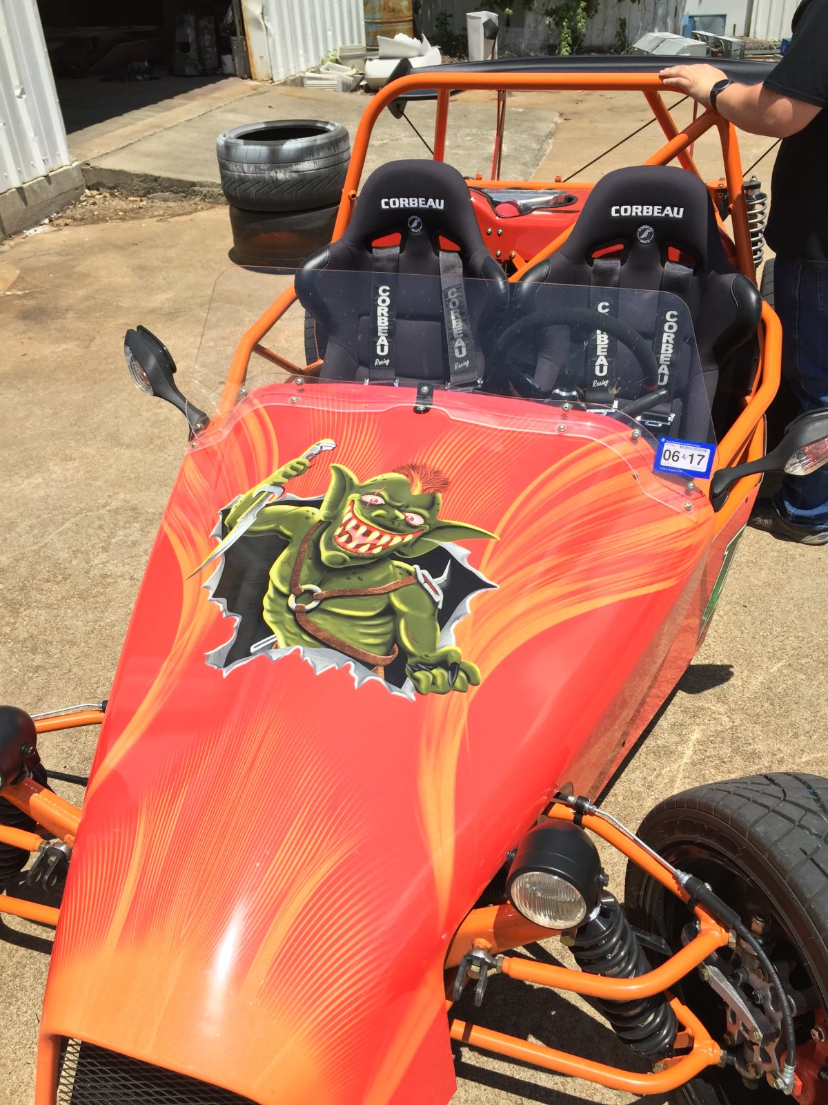

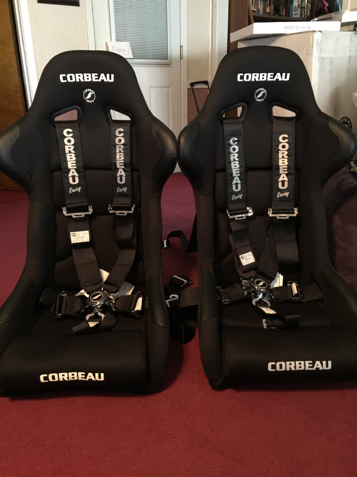

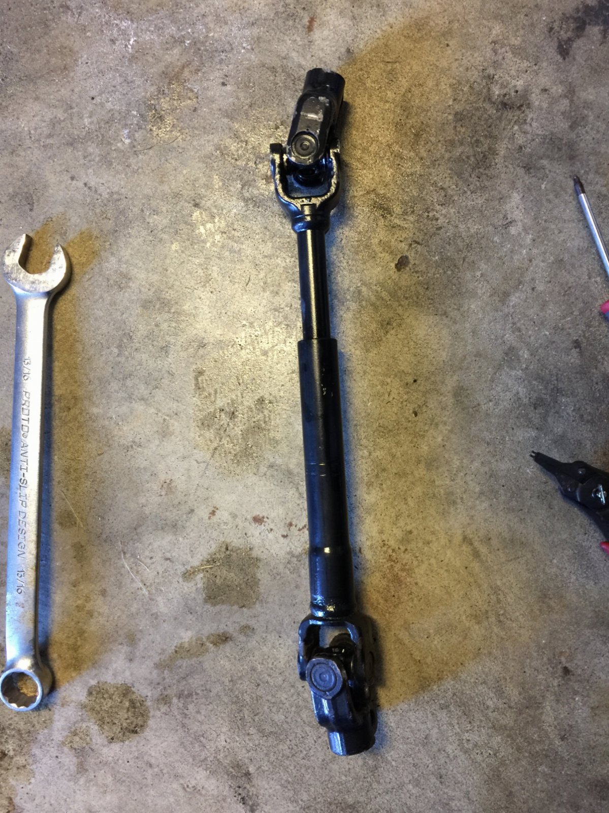

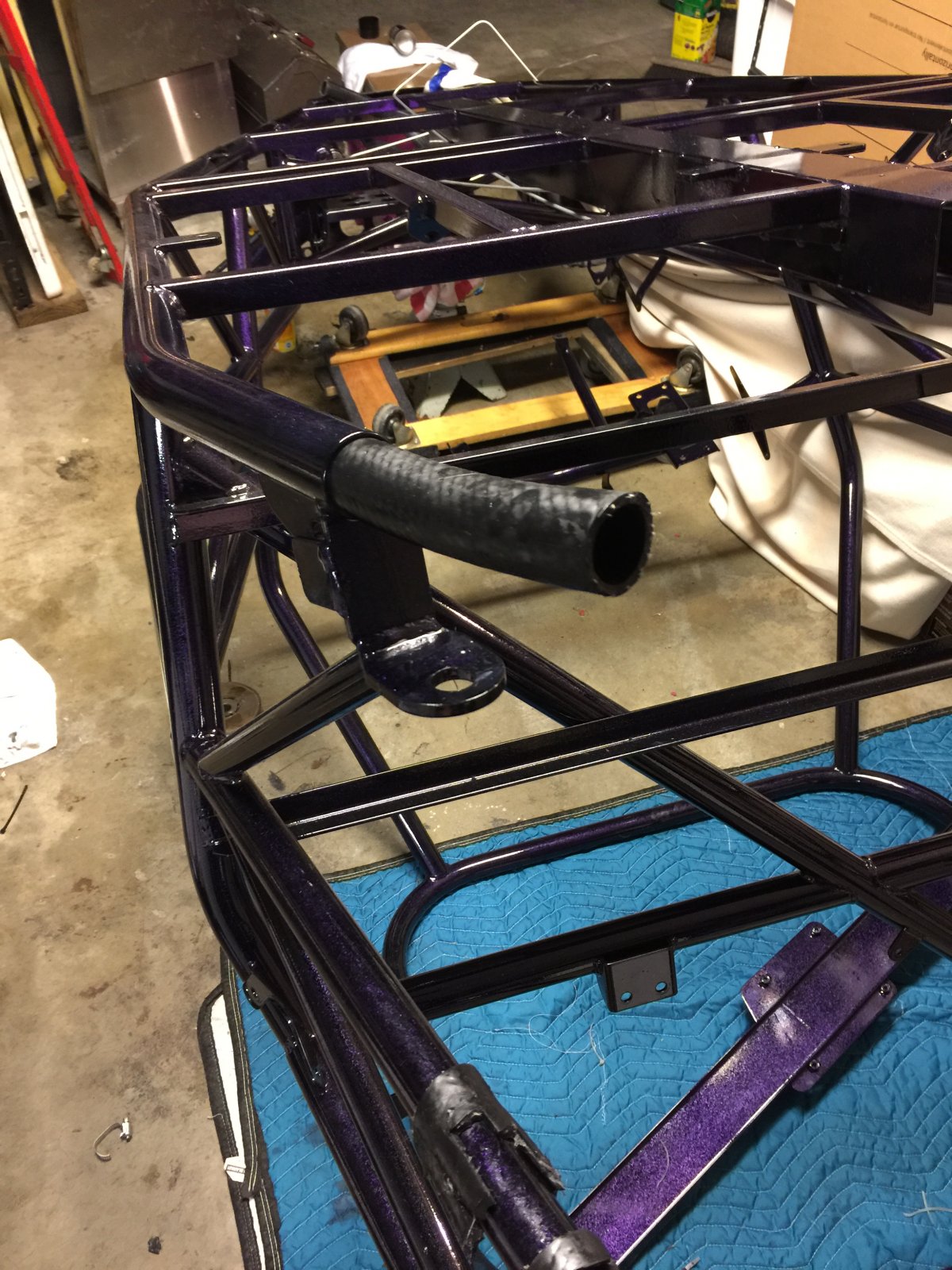

Okay so I did get the other hose in the next day I just never posted on here. That's probably the hardest thing you will do on this car so just prepare yourself use lots of small zip ties and get you a gallon of astroglide or ky jelly cause she's a tight fit lol. So after that I tried to install my steering shaft and the lines to the master cylinder and found out the steering shaft is seized and the master cylinder is stripped so that's was great. But I also took a trip up to red oak to see the shop where the magic happens, I rode in Lonny's turbo goblin and got to drive the p2 I believe. There's so much cool stuff they are working on and there's a lot I had no idea about on these goblins. Got my seats from them also and went ahead and ordered the coilovers with my stage 3 kit

My steering shaft was frozen solid as well. I used my hydraulic press to very slowly compress it until the cross bolts would slide in. A floor jack under a workbench would work as well.
I literally did it about a 1/16" at a time and checked constantly because if you get it too short I have no idea how you'd stretch it back out. Maybe with a slide hammer but dunno.
