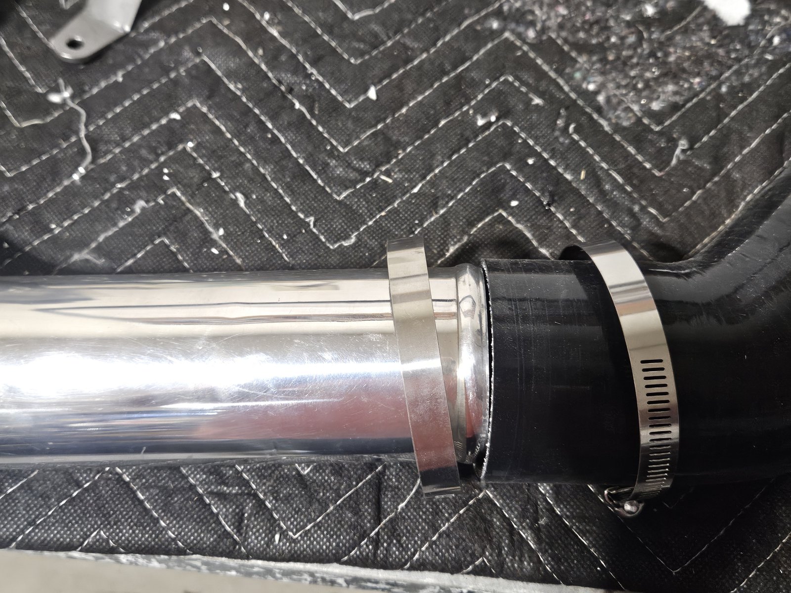

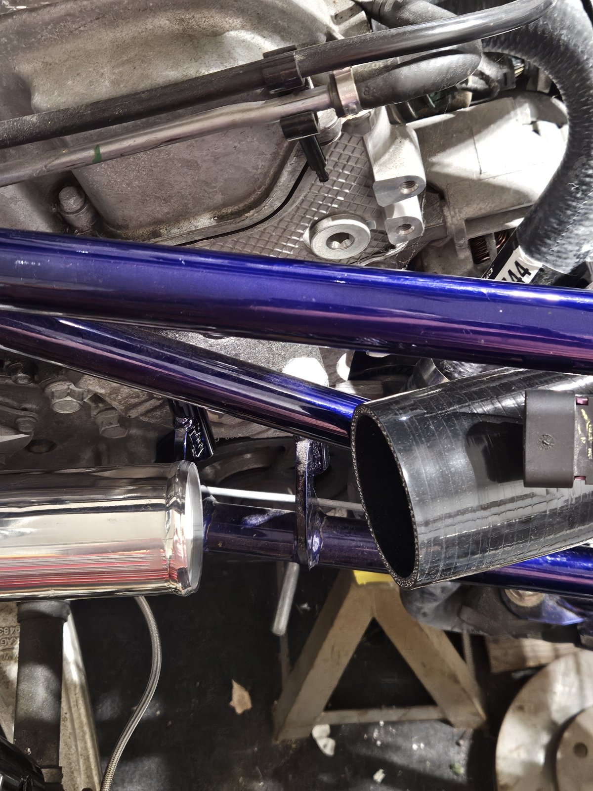

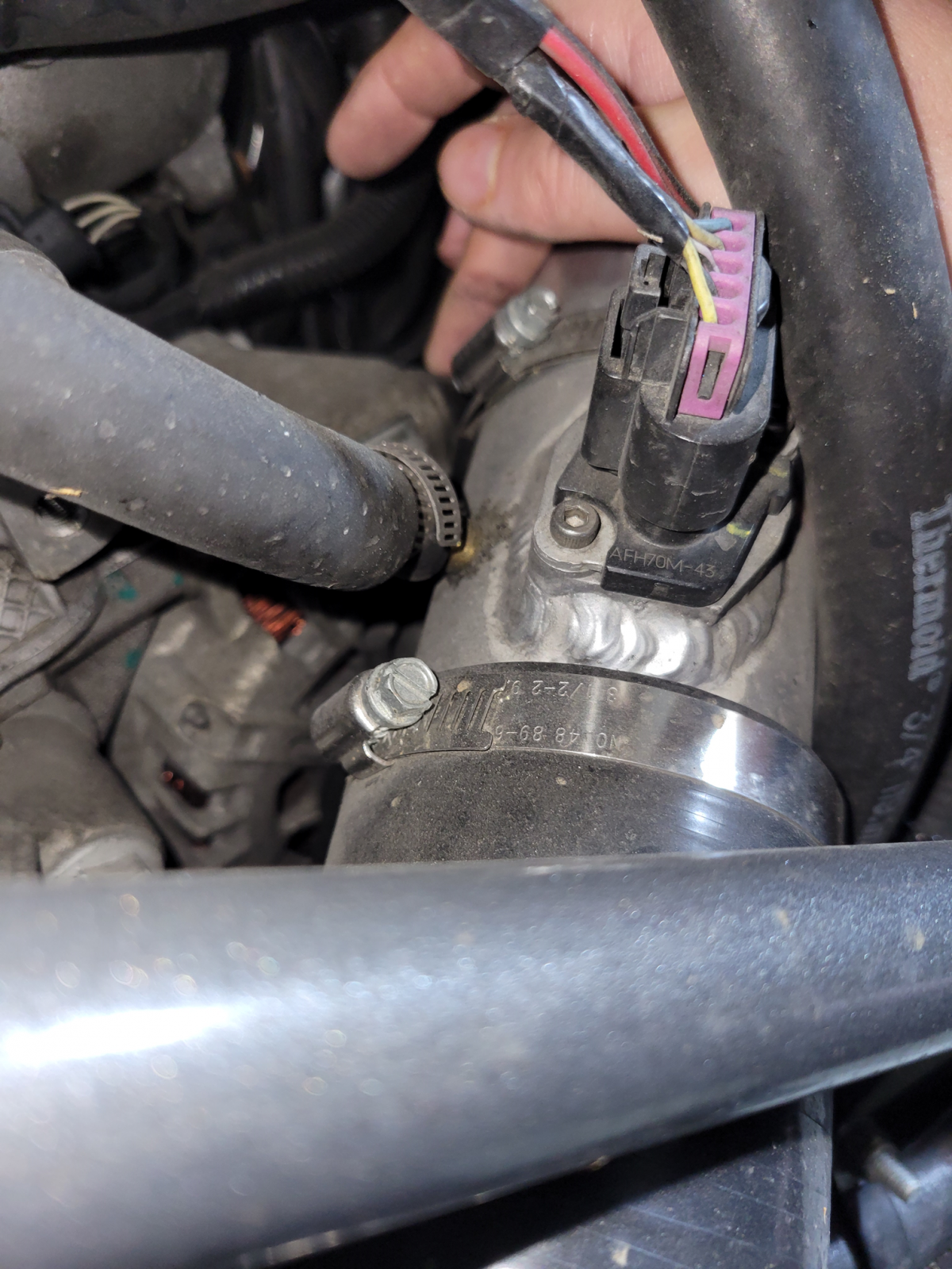

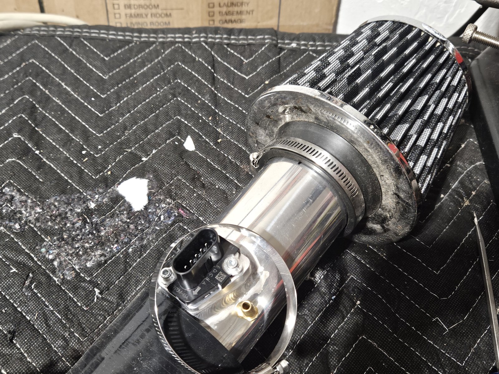

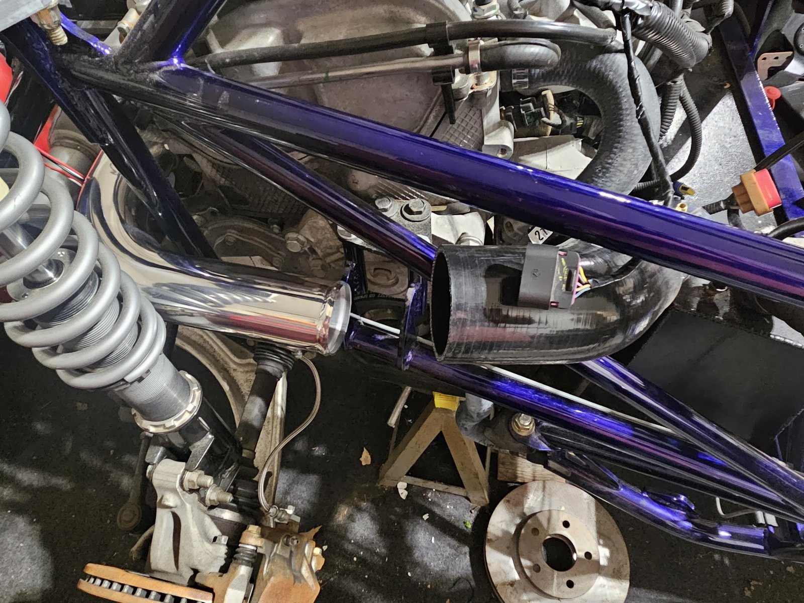

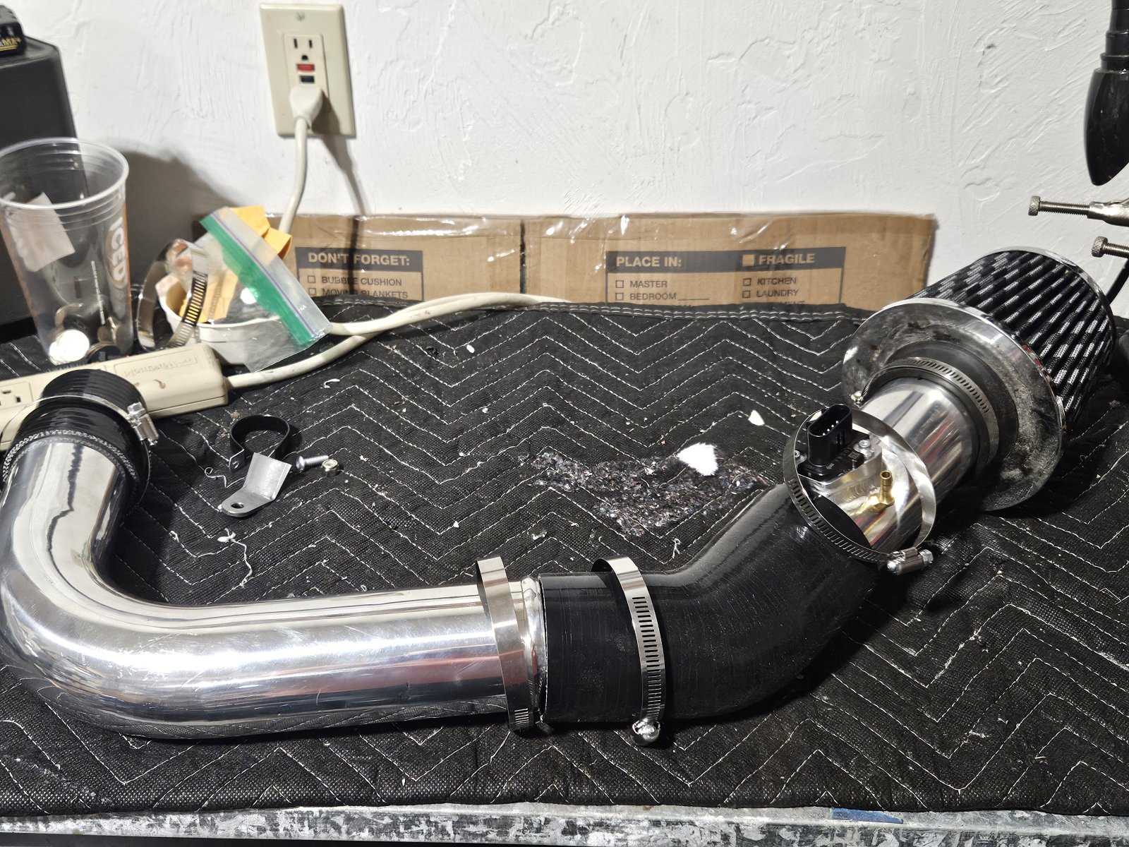

Ok after first start I'm motivated like Tavarish to wrench every day. Tonight after a late start I'm mocking up the air intake to the turbocharger. Does this look correct to you? I've got pictures from Adam on my bulletin board and it seems right.
Also, is there a good way to make sure that the pipes are pressed all the way into the silicone? I'm almost touching the rear coilover but I've got room on the fitting to the turbo itself.
49321
49322
49323
49324

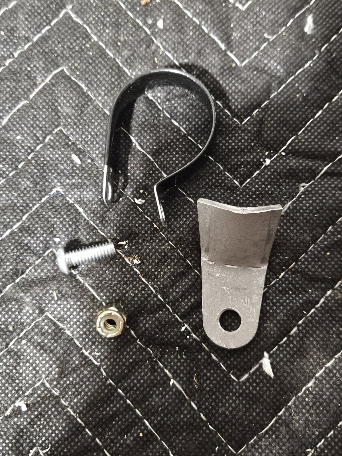

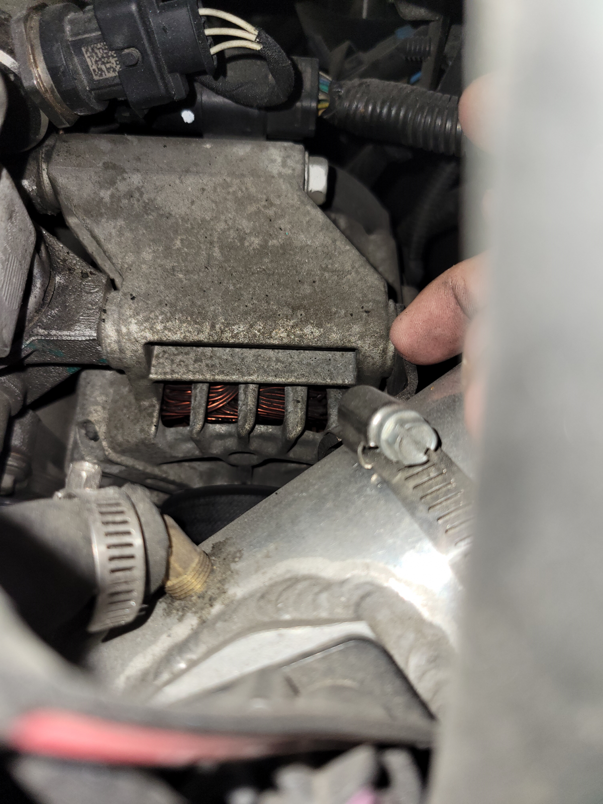

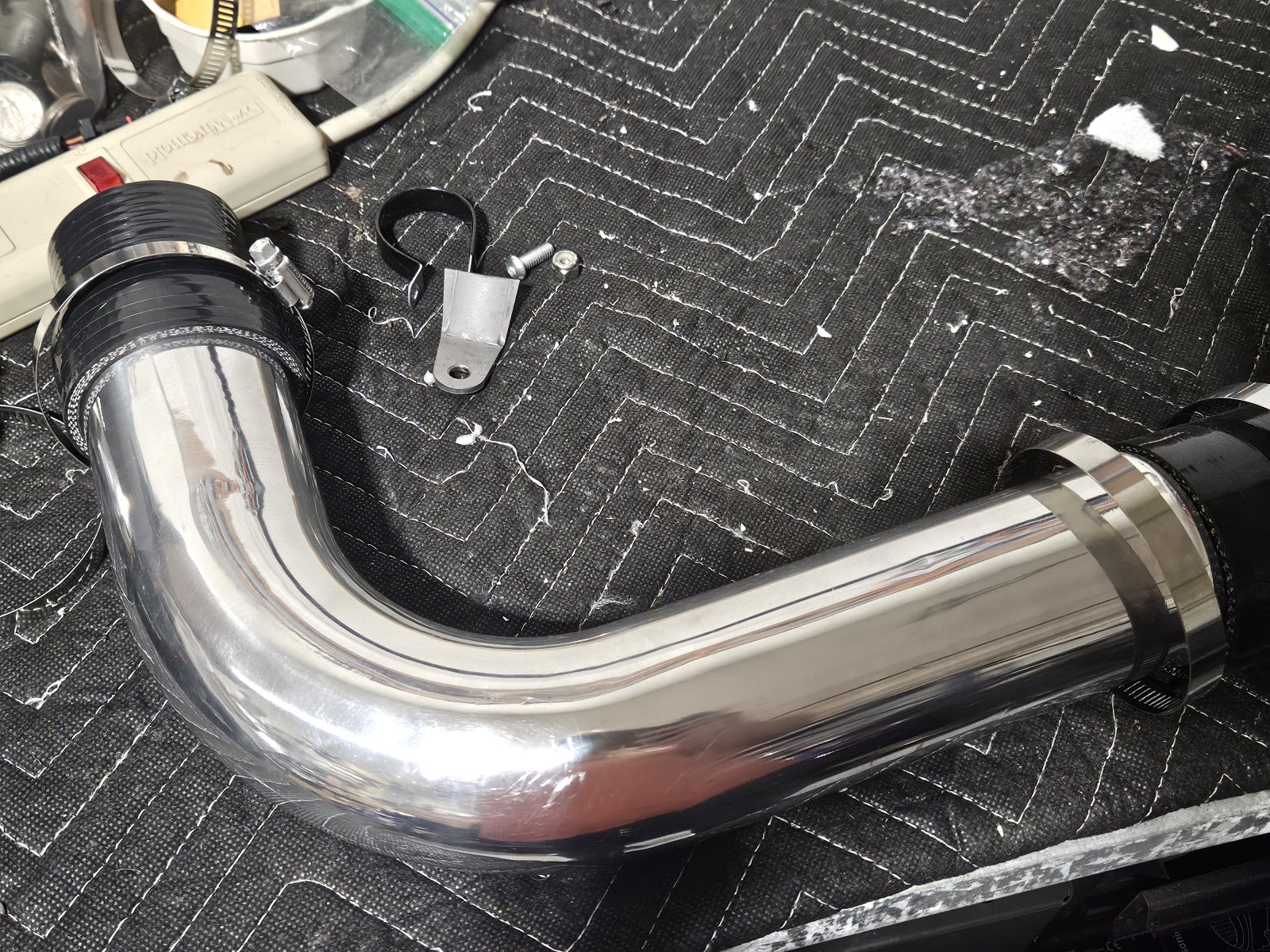

Also looking for thoughts on where the coated clamp and metal tab go:
49326
49327
Would you happen to have as photo of this? I'm having a hard time visualizing that in my tired head... :-D
A very difficult thing to get a good picture of... this is the best I could do. The tab bolts onto the alternator, then a hose clamp secures the intake tube to the tab. The coated clamp is used elsewhere.
