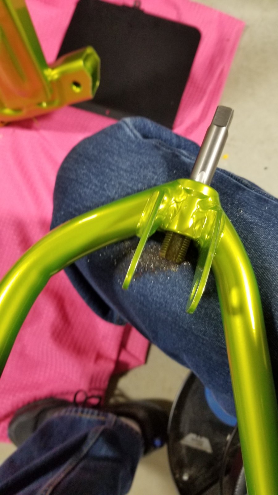

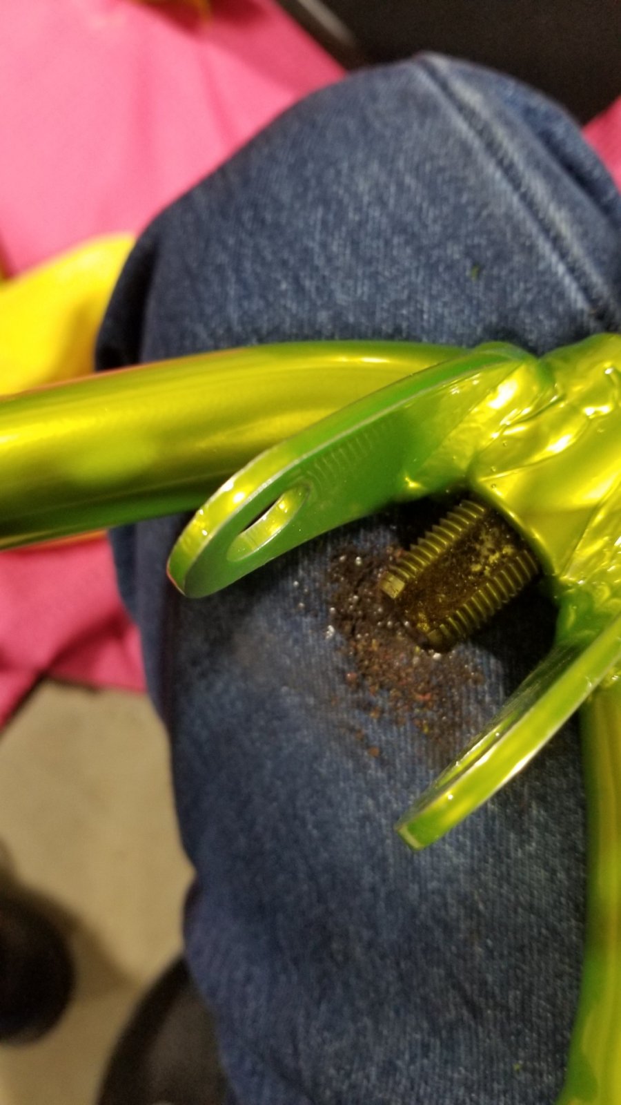

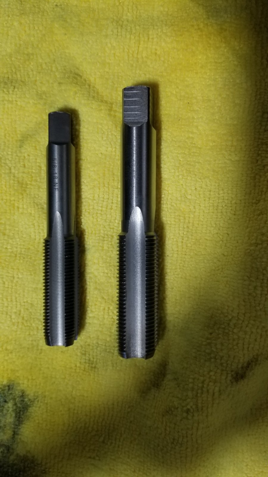

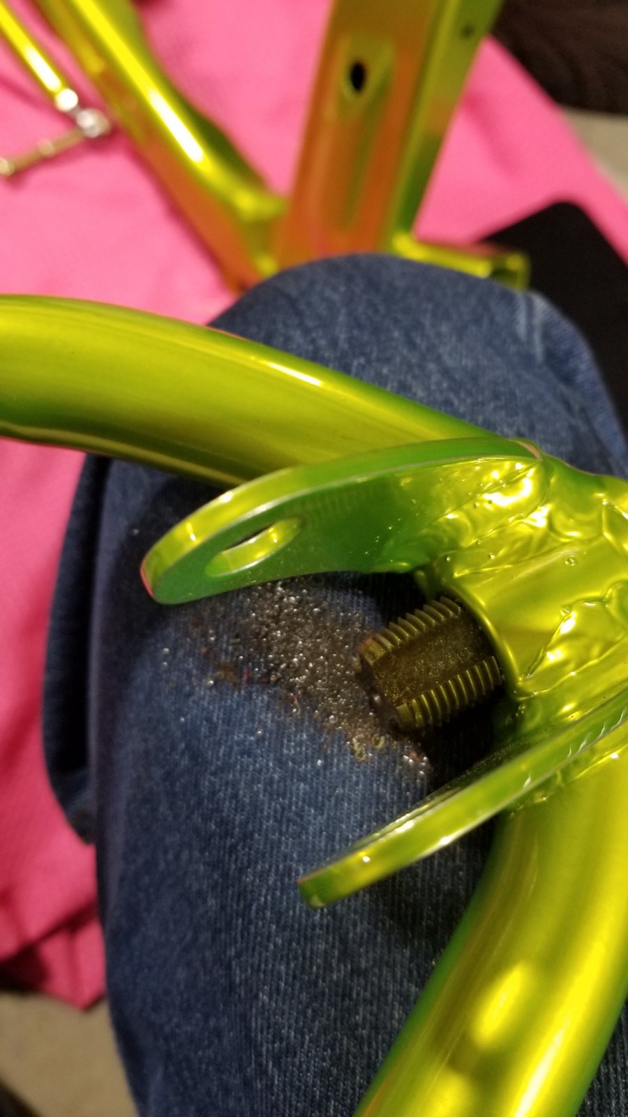

Little tech tip. It's a good idea to "Chase" all the threads on your Goblin before you build. The front A Arms are a real good example. The "spuds" that are threaded are machined before the are welded and the welding can cause some distortion in the threads when the arm is fabricated. There may also be rust that has built up inside along with sand and some powder coating. It will make it a lot easier when you go to adjust your suspension. The Taps needed for these are larger and not in most tap and die set. You will need a 5/8-18 NF and a 3/4-16 NF They are not expensive I bought them at my NAPA Store It only took them a day to get them and they were around $10-12 dollars each Look at the pictures and all the debris that came out of mine. I chase every thread. Cuts down on cross threading and makes life much easier.
