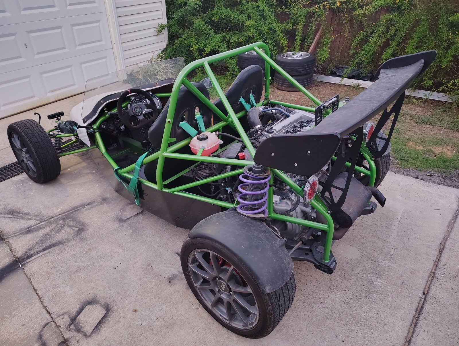

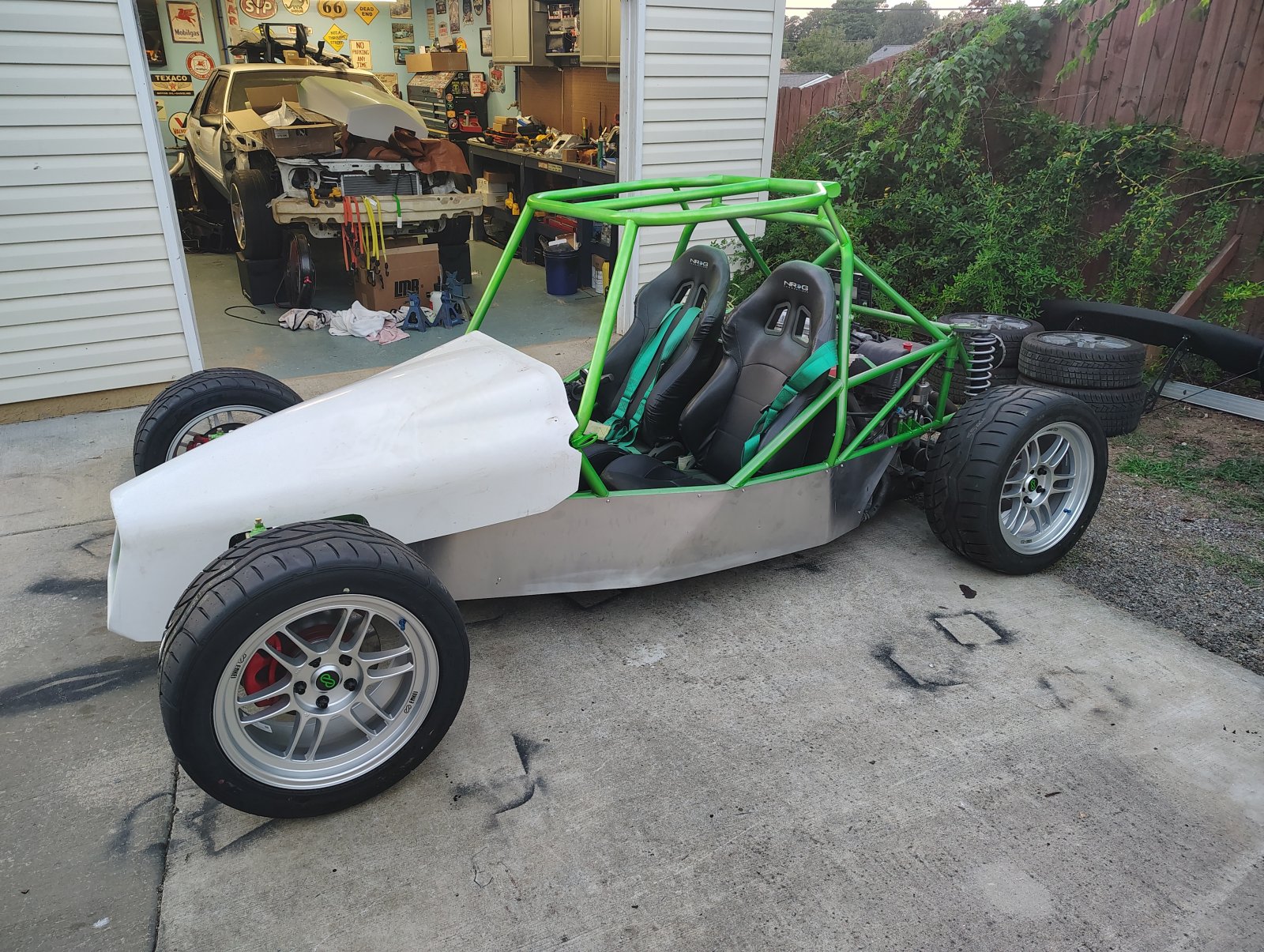

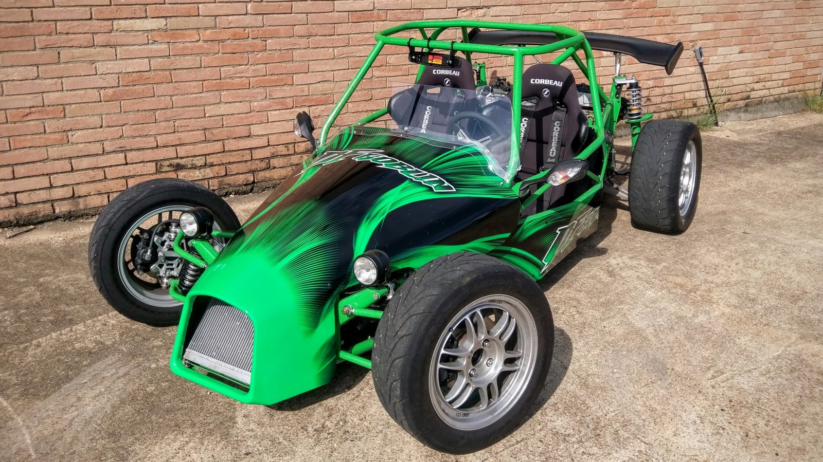

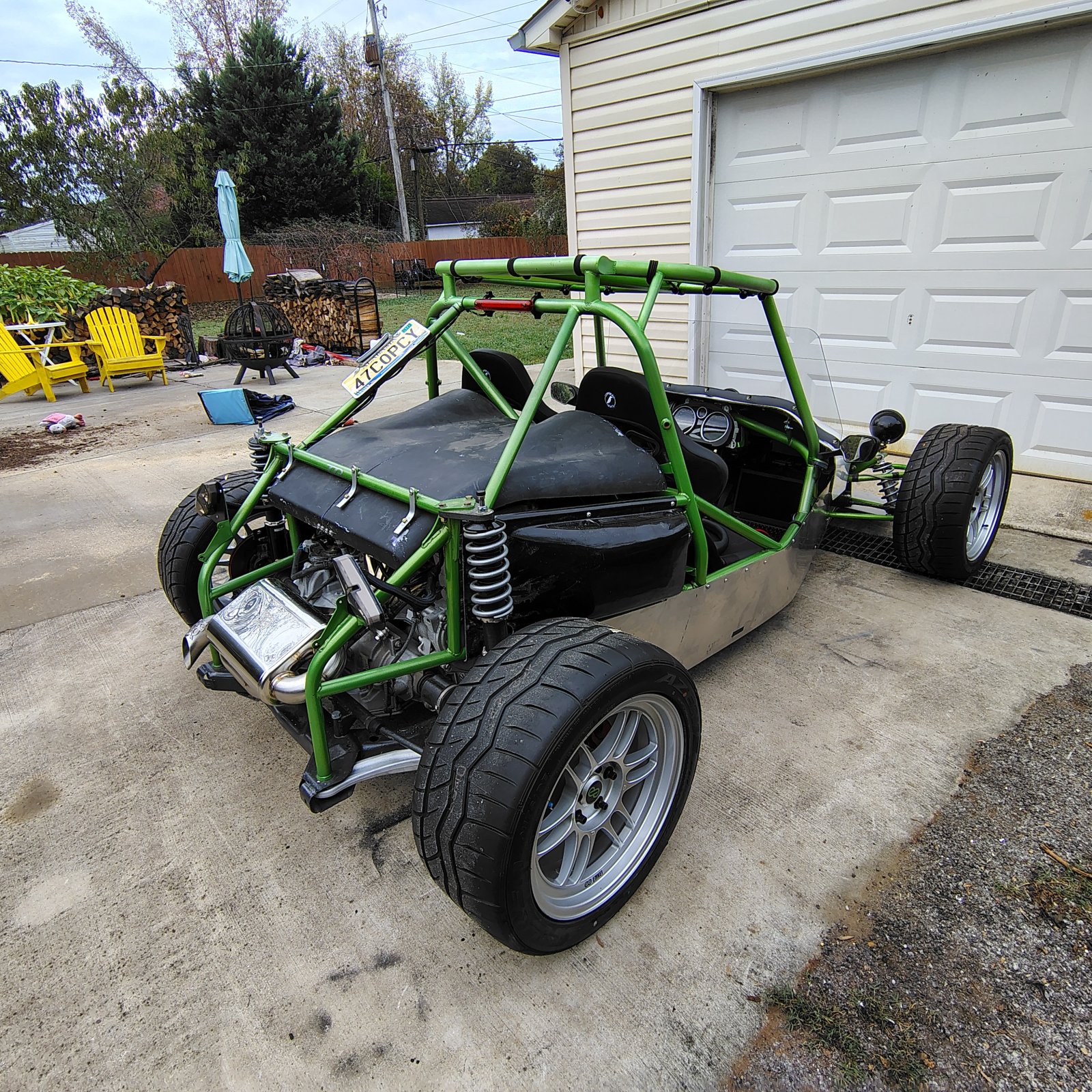

Here's what #19 looked like when I bought it (I didn't know it was #19, until I started looking on this forum and through all of Rich's build records I got with the Goblin):

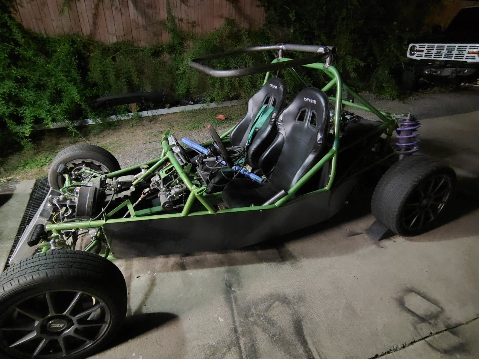

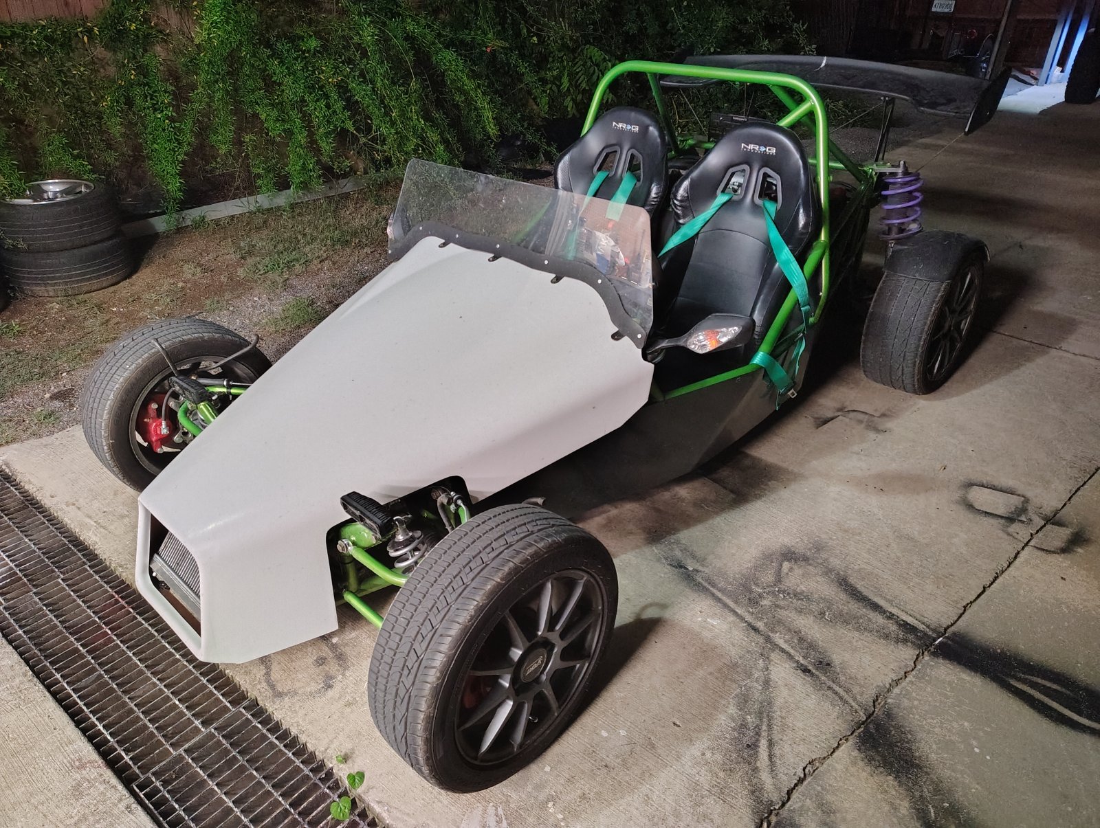

This is what it looked like at 8:30pm, on Sept 15, 2024, sitting in my driveway, after driving it home for almost 2 hours. I would like to say that the POS seller I bought it from totally lied about everything. Said he had owned it for over a year and it wasn't finished when he bought it. Said he and his dad finished it and got it looking like it did when I bought it..... :confused: But once I found Rich's build thread, I discovered everything he said, was all lies...
52762
Here's pics of the next morning, before heading in to work:
52763
52764
52765
52766

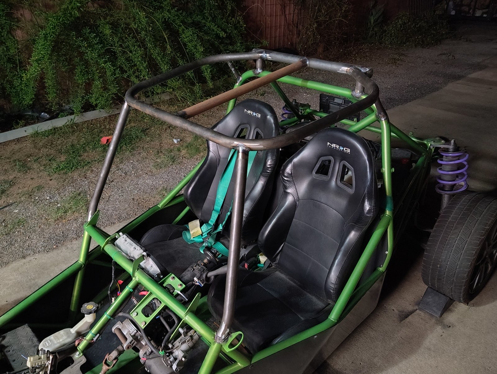

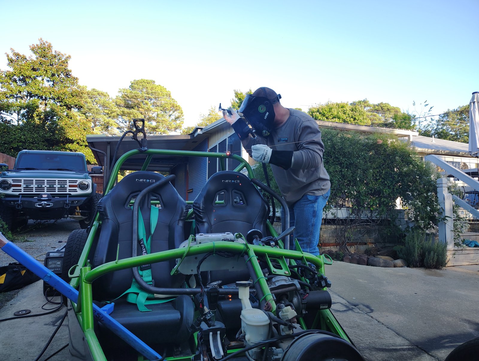

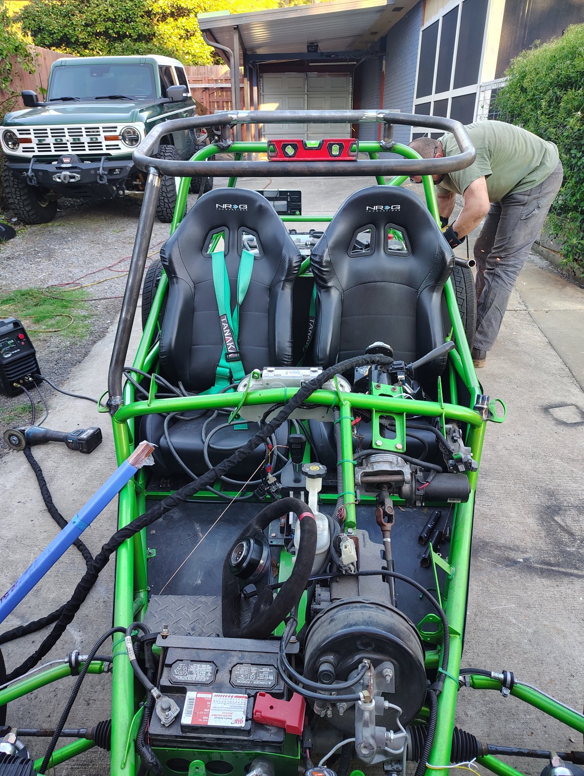

So, seats first! I'm 6'5" and 250lbs. I fit in the NR-G's Rich installed, but they were worn out by the time I took ownership. I ended up getting the Corbeau Seat, DF Big Guy Mounts and Corbeau Harnesses from Adam @DF. It took a while for the seats to show up, so while I was waiting on them, I decided I wanted a track top, (not a fan of the city top/frame), so I order the Halo from Adam and got a local mobile welder to TIG it to the Goblin!
52767
He raised it up 4" since I'm a tall guy and this is a custom add-on!
52768
52769
52812
52770
52771

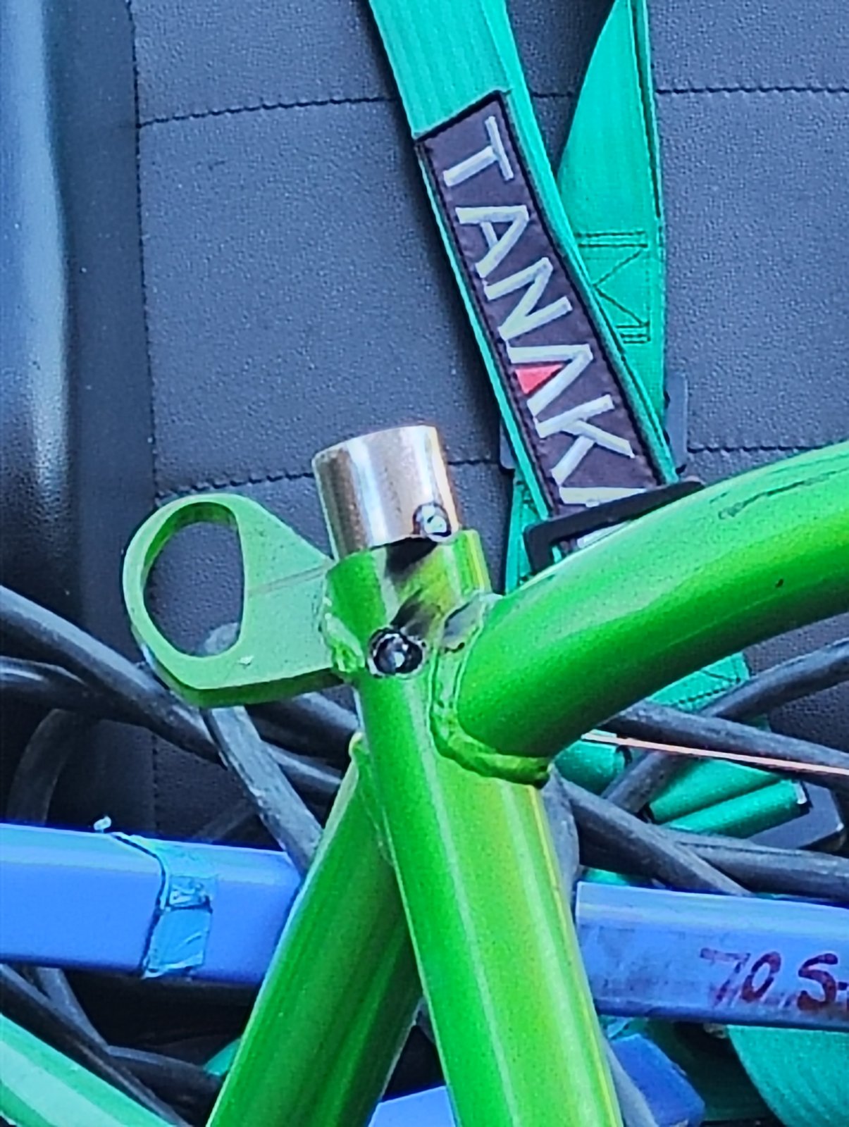

Took the welder about 8 hours to do everything, over 2 days. Once he was finished, I started mixing spray paints to get it close to the Granny Smith Metallic Green to match the rest of the frame... Finally found something that looked good.

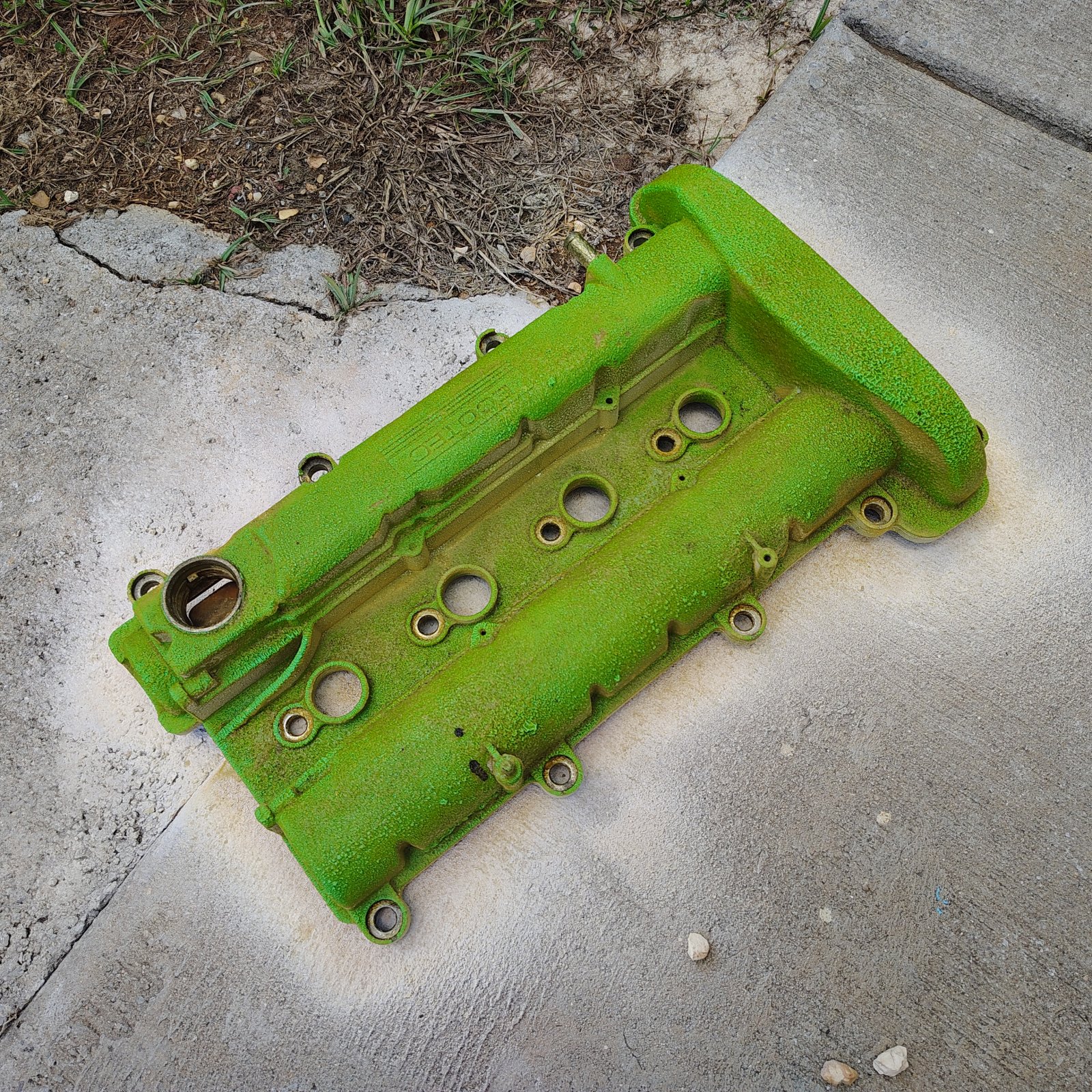

And a light few coats of this, Krylon Fluorescent Green.
52774

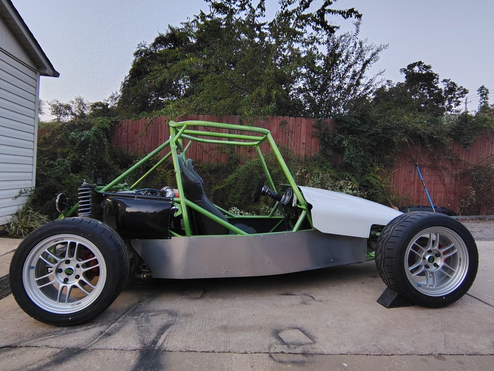

I topped it off when a Gloss Clear Coat, but over the cold months and being covered up, the shine isn't as nice as it used to be, but at least it's covered still!

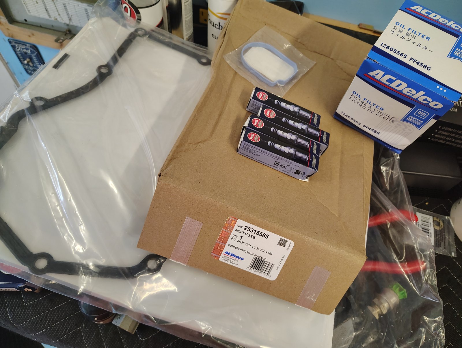

I had parts coming in left and right!
I got some tune up parts, oil and filter, gaskets, etc

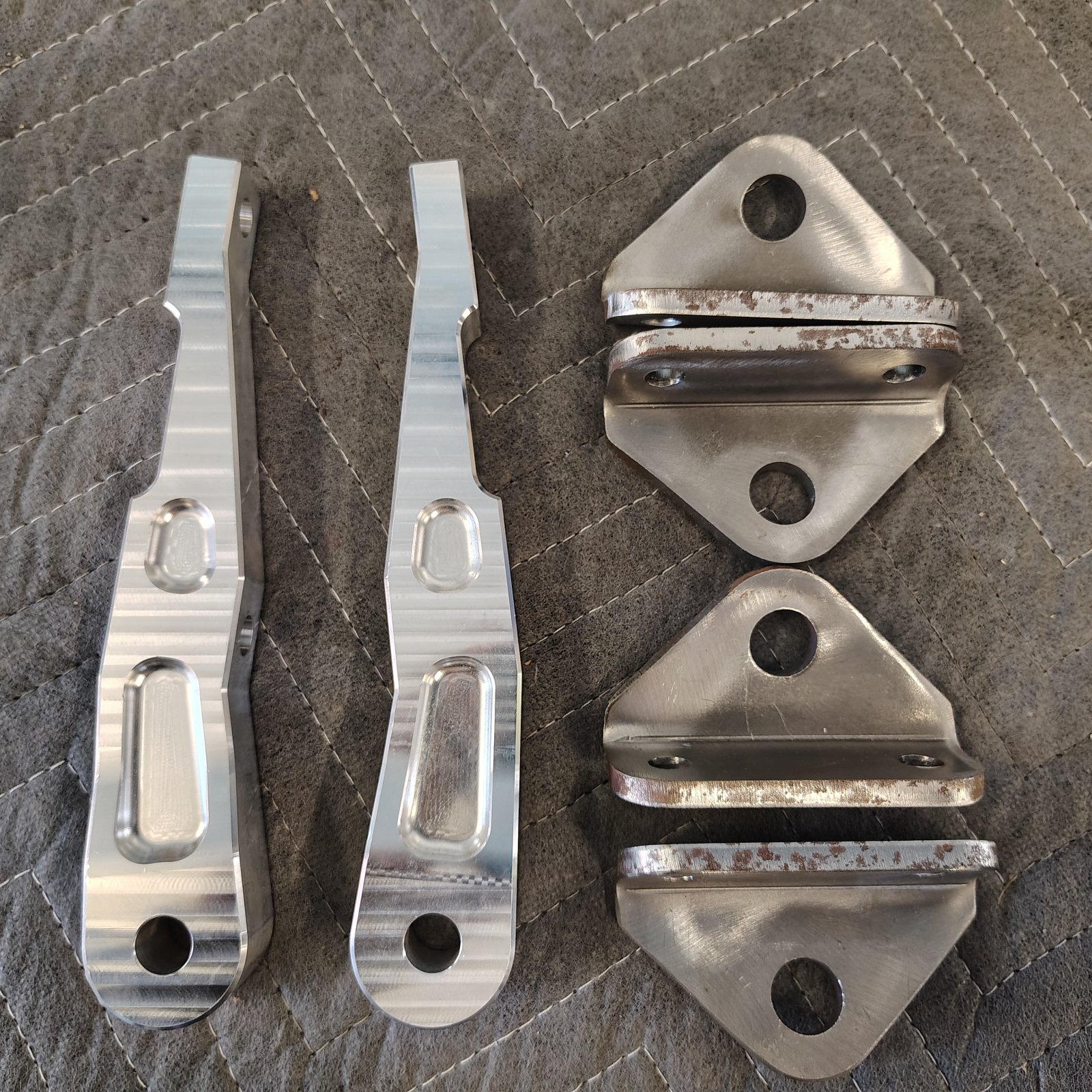

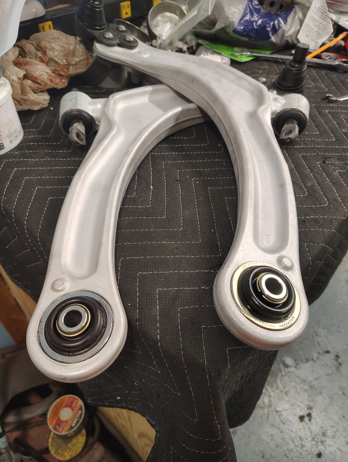

New SS Aluminum Lower Control Arms, with the MOOG upgrades!
52775

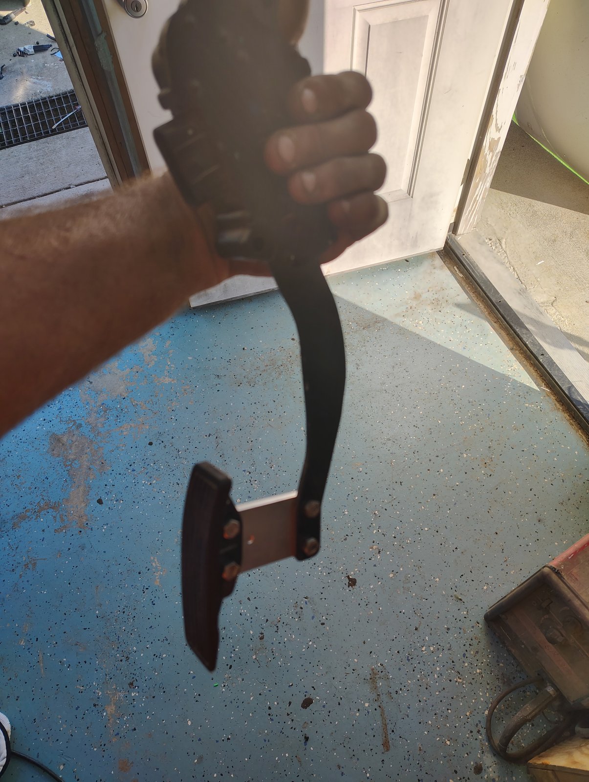

I forgot who made it for me, but one of the members on here made me a gas pedal extension out of aluminum stock.
52776
52777

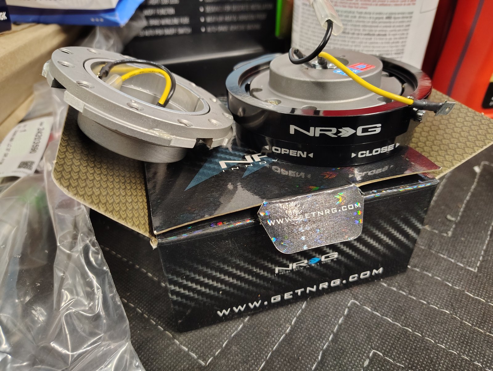

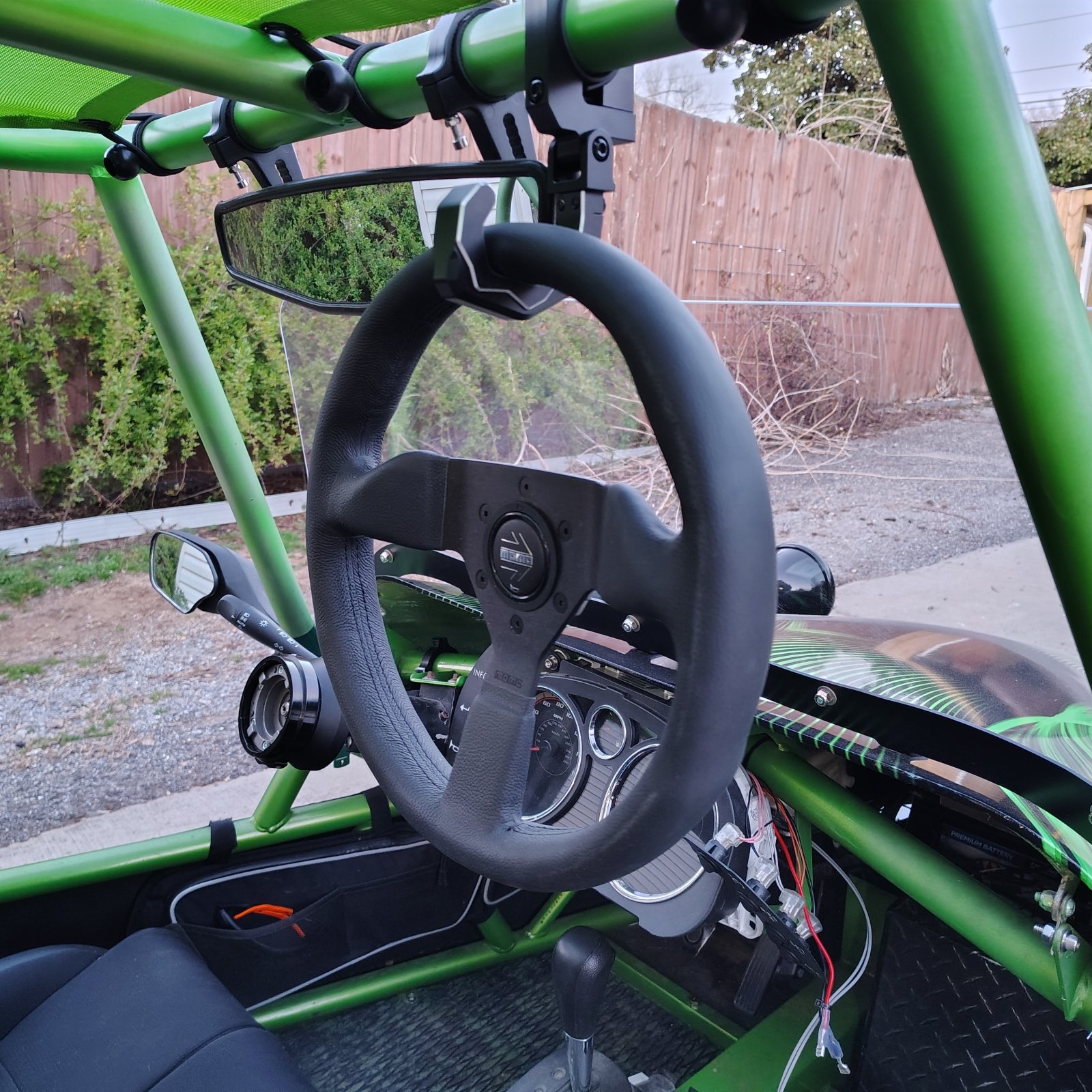

NR-G Steering Wheel Adapter and Quick-Release.
52780
52781

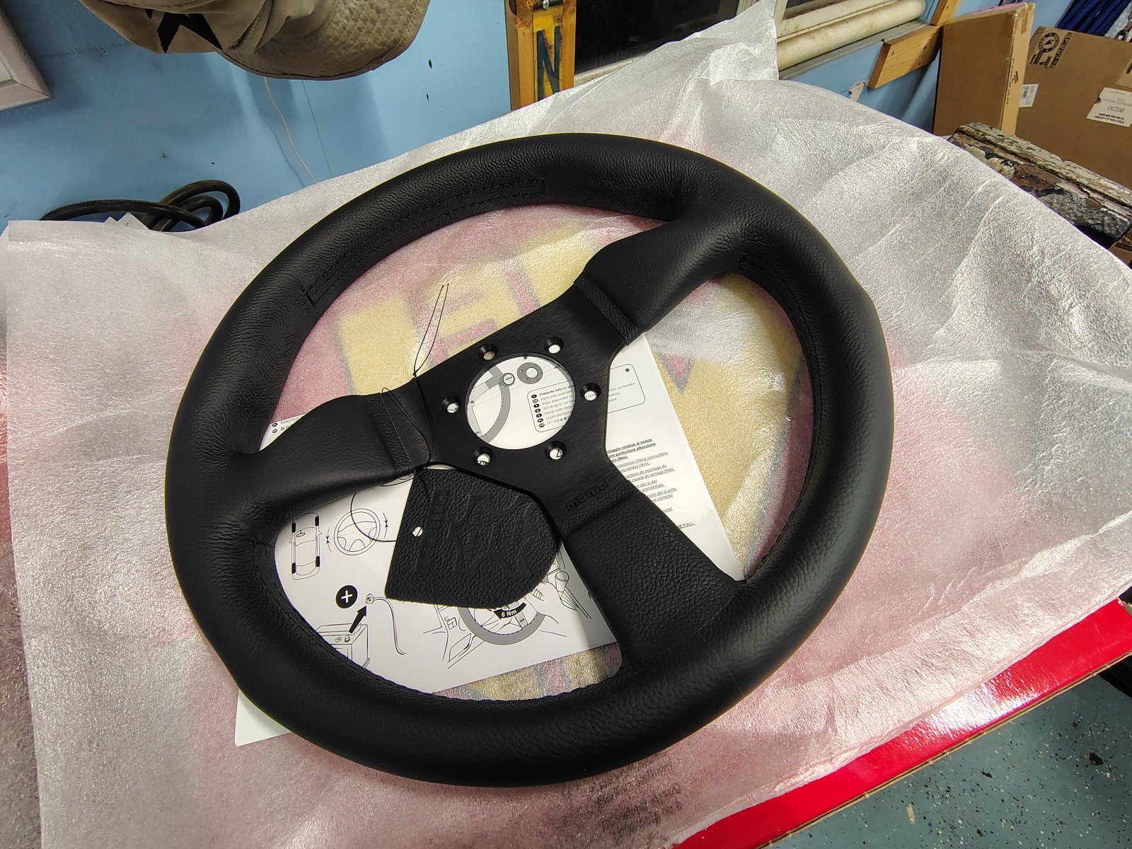

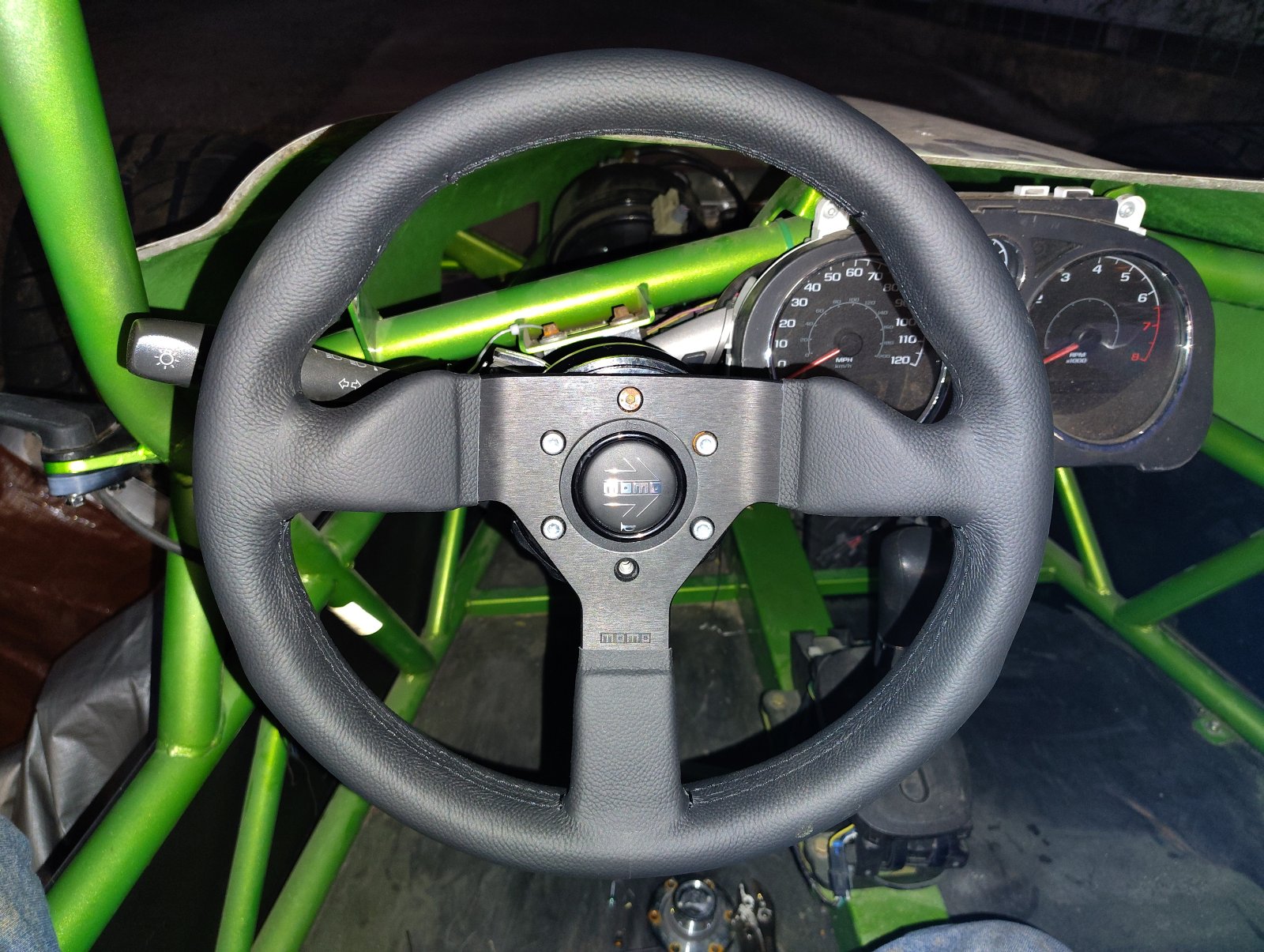

MOMO Monte Carlo Steering Wheel
52782
52783

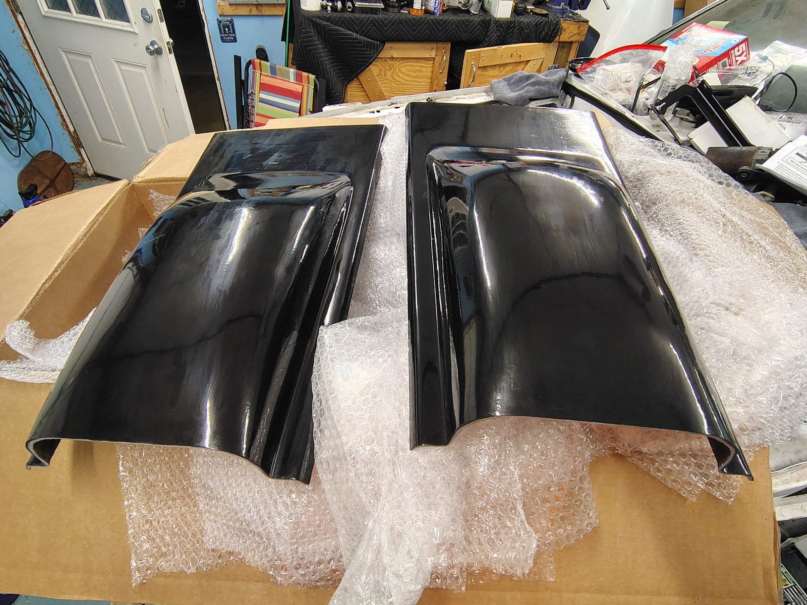

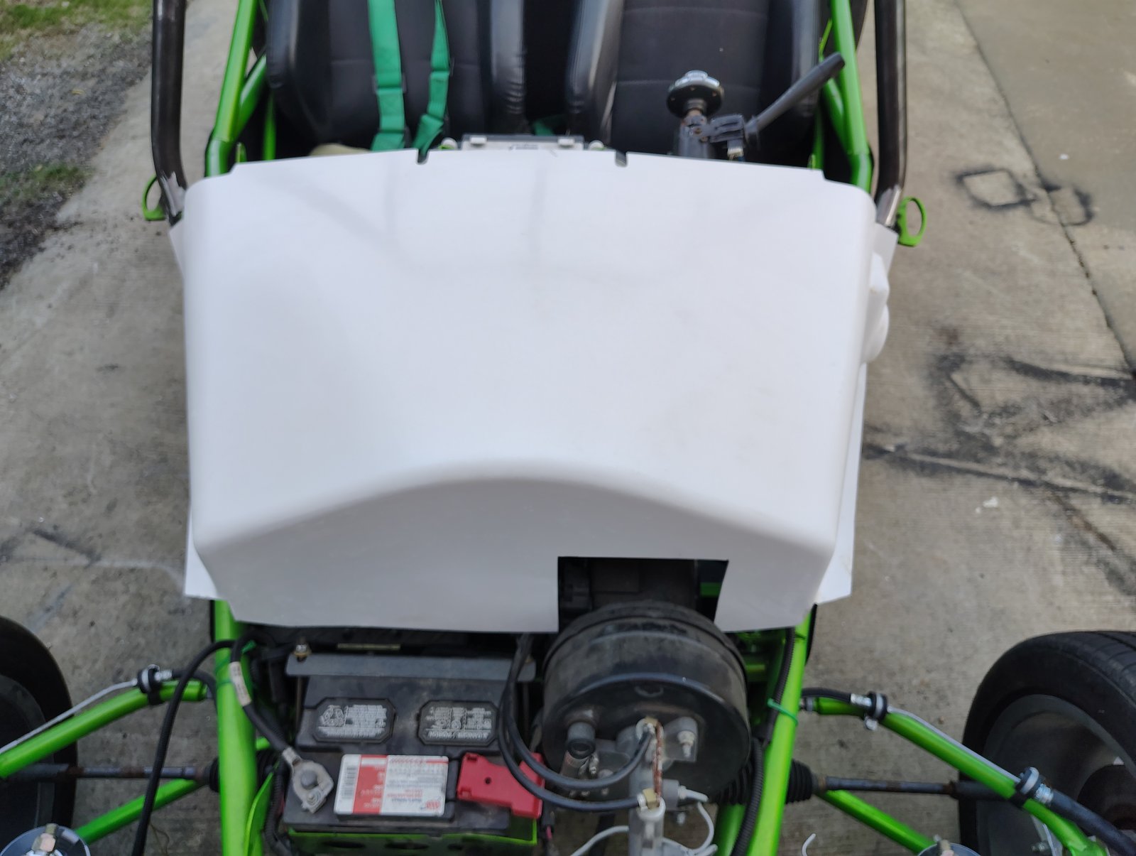

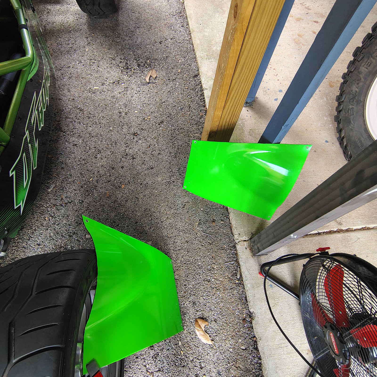

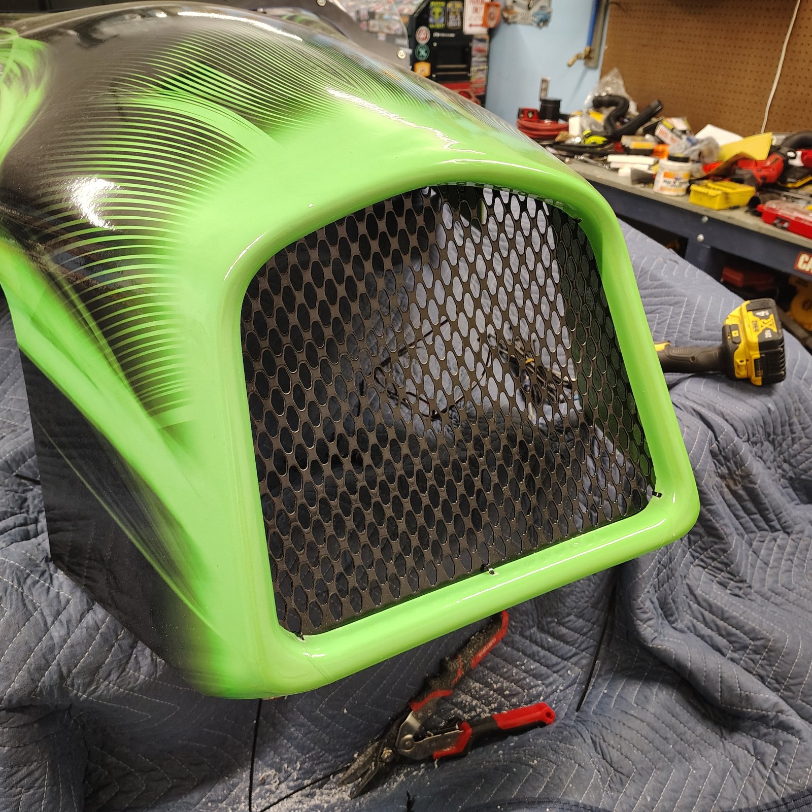

Ordered and received these custom fiberglass side scoops, along with some 3D printed stuff from @Jmar1622
52785
52786
52787

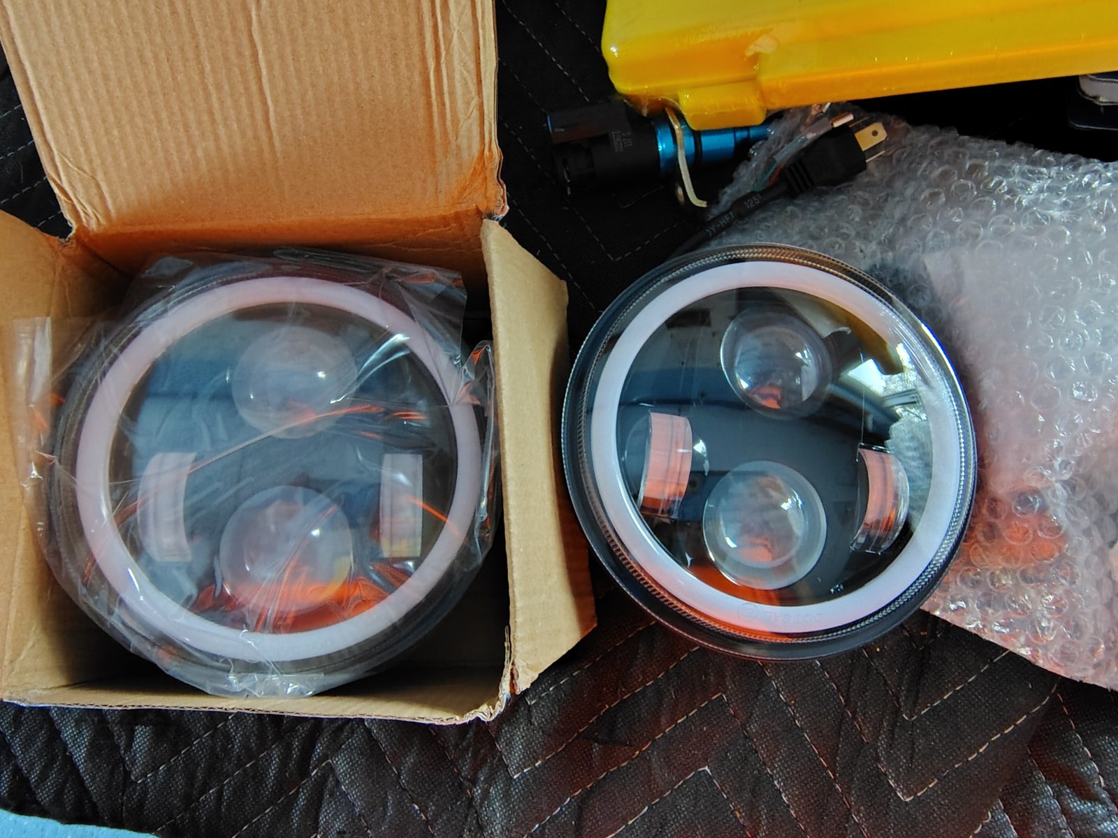

Ordered the amazing LED Halo Headlights and Buckets from Amazon!
52788
52789

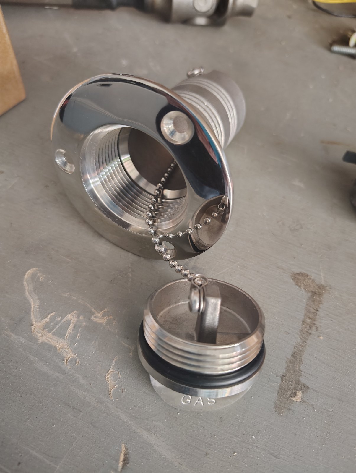

A Marine Gas Filler Neck.
52791

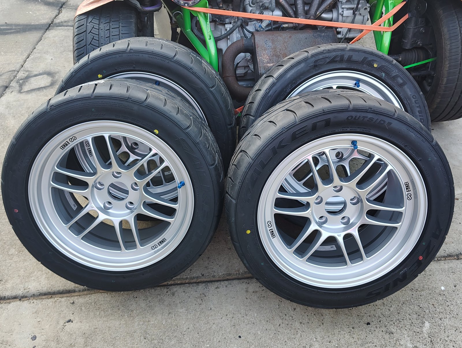

New 17x9 Enkei Racing RPF1 in Bright Silver wrapped in 275/40R-17 Falken Azenis RT615K+
52792

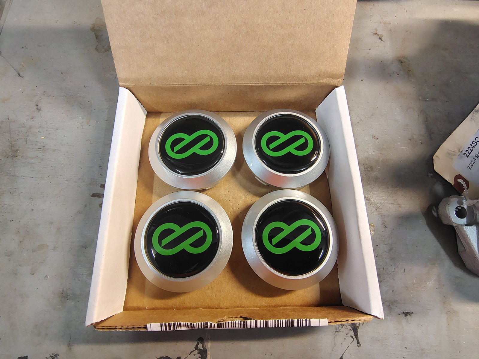

Some custom Enkei Center Caps
52793

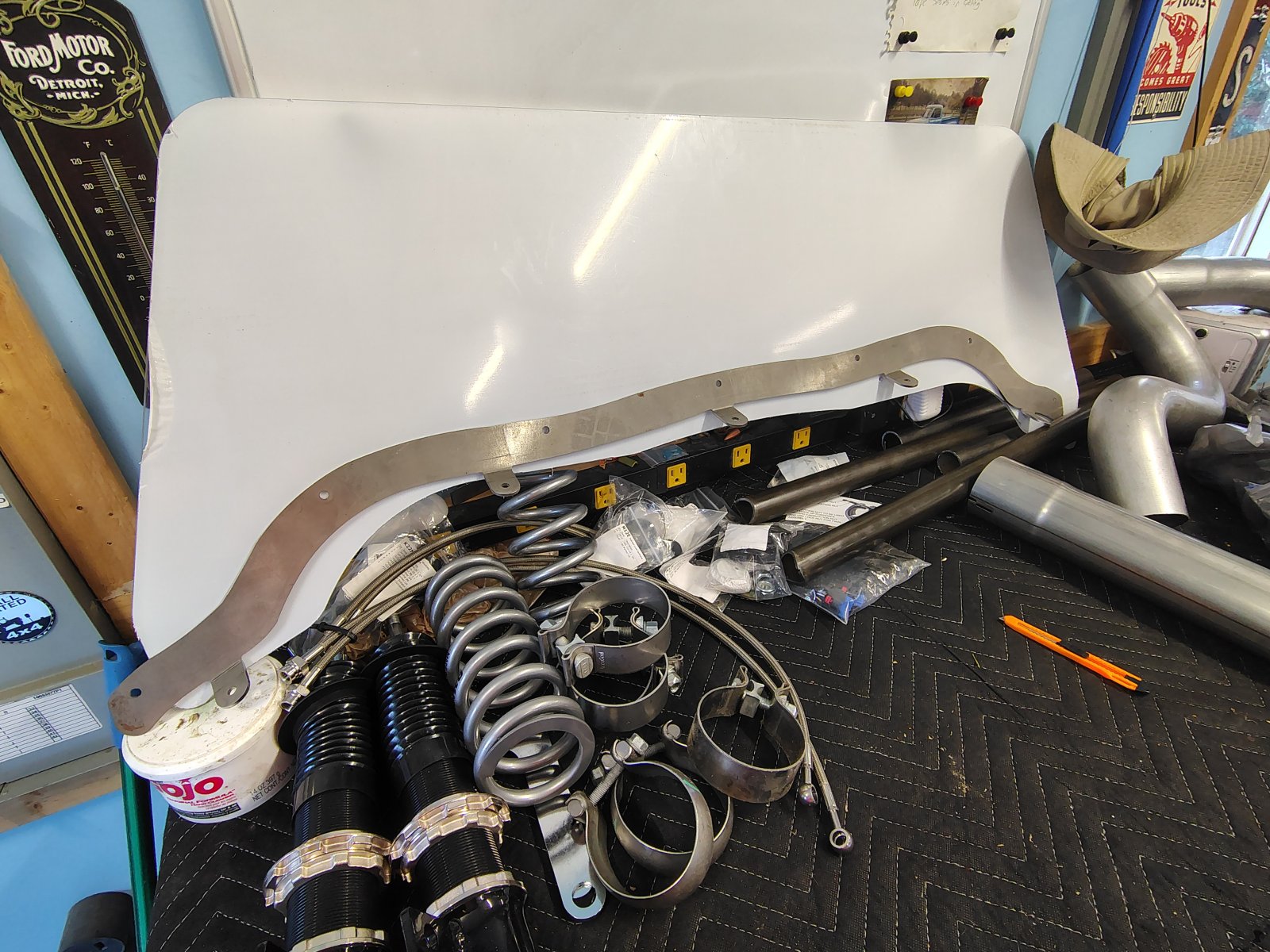

I decided to upgrade to the BC Rear Coilovers too!
52795
52796

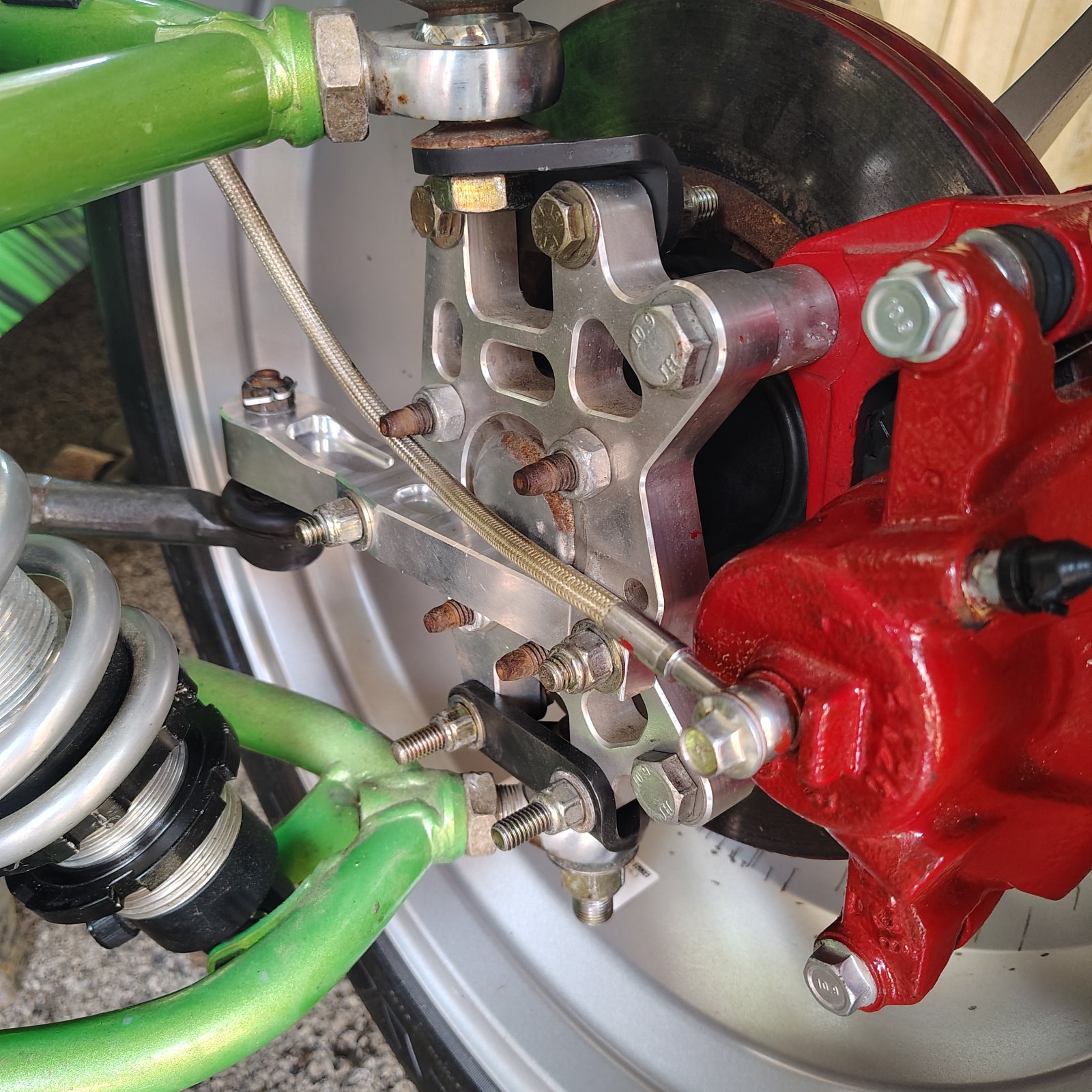

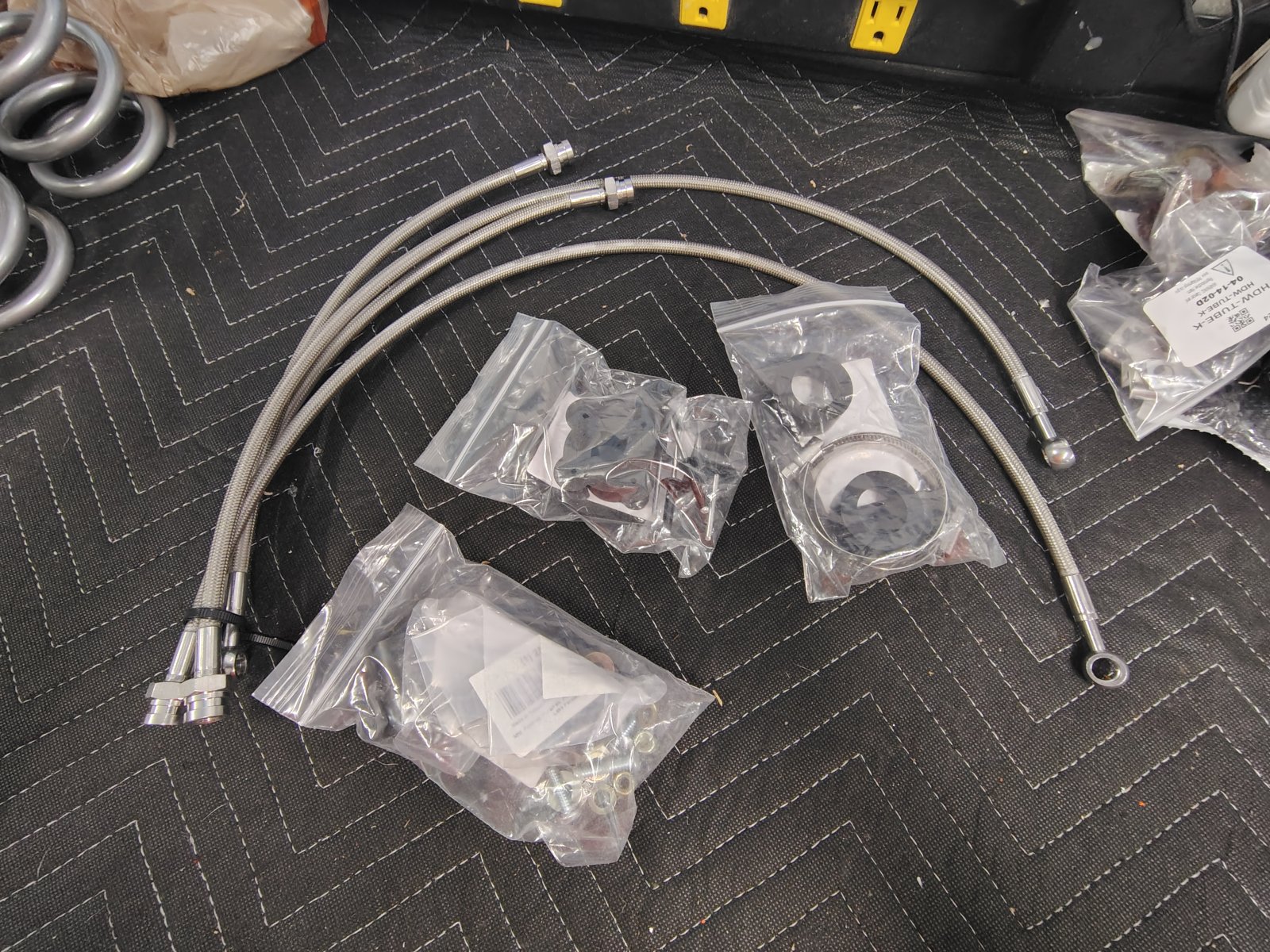

I upgraded to Stainless Brake Lines
52797

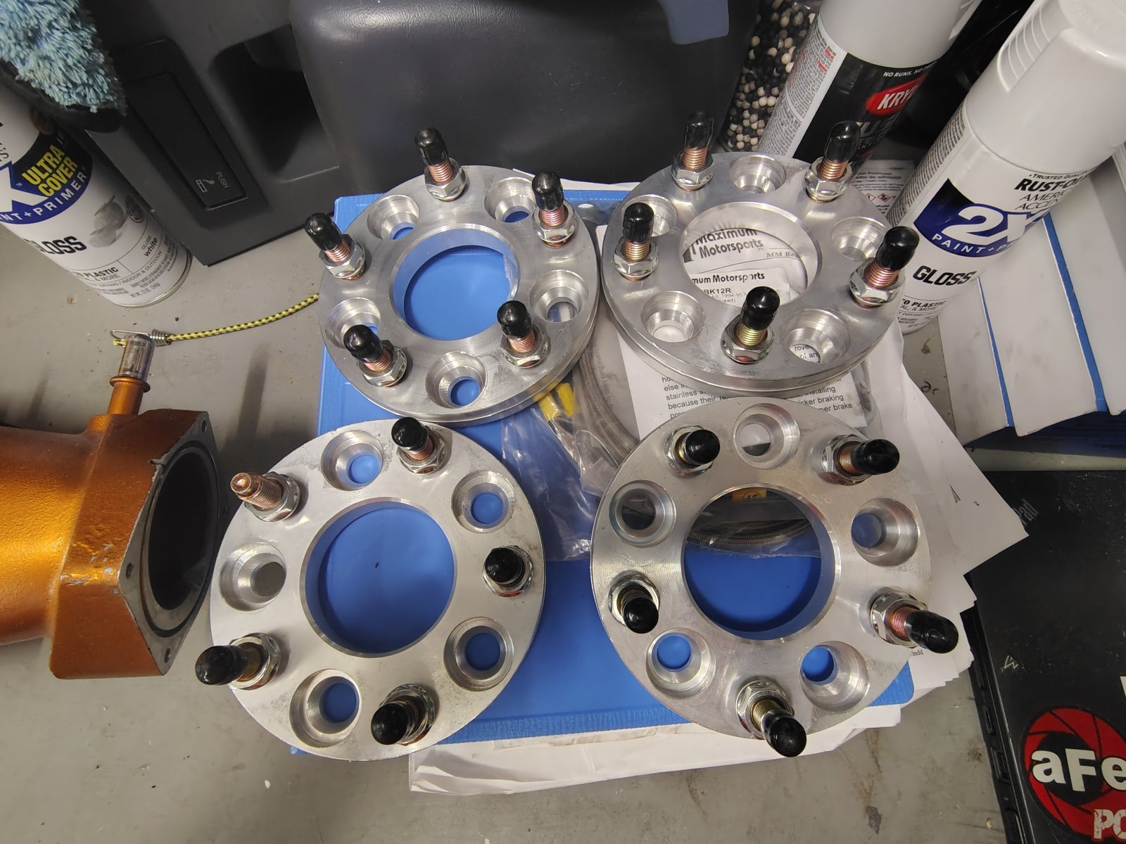

I had to get some 5x110 to 5x4.5" Wheel Spacer/Adapter - Thickness: 3/4" from Custom Wheel Adapters
52798

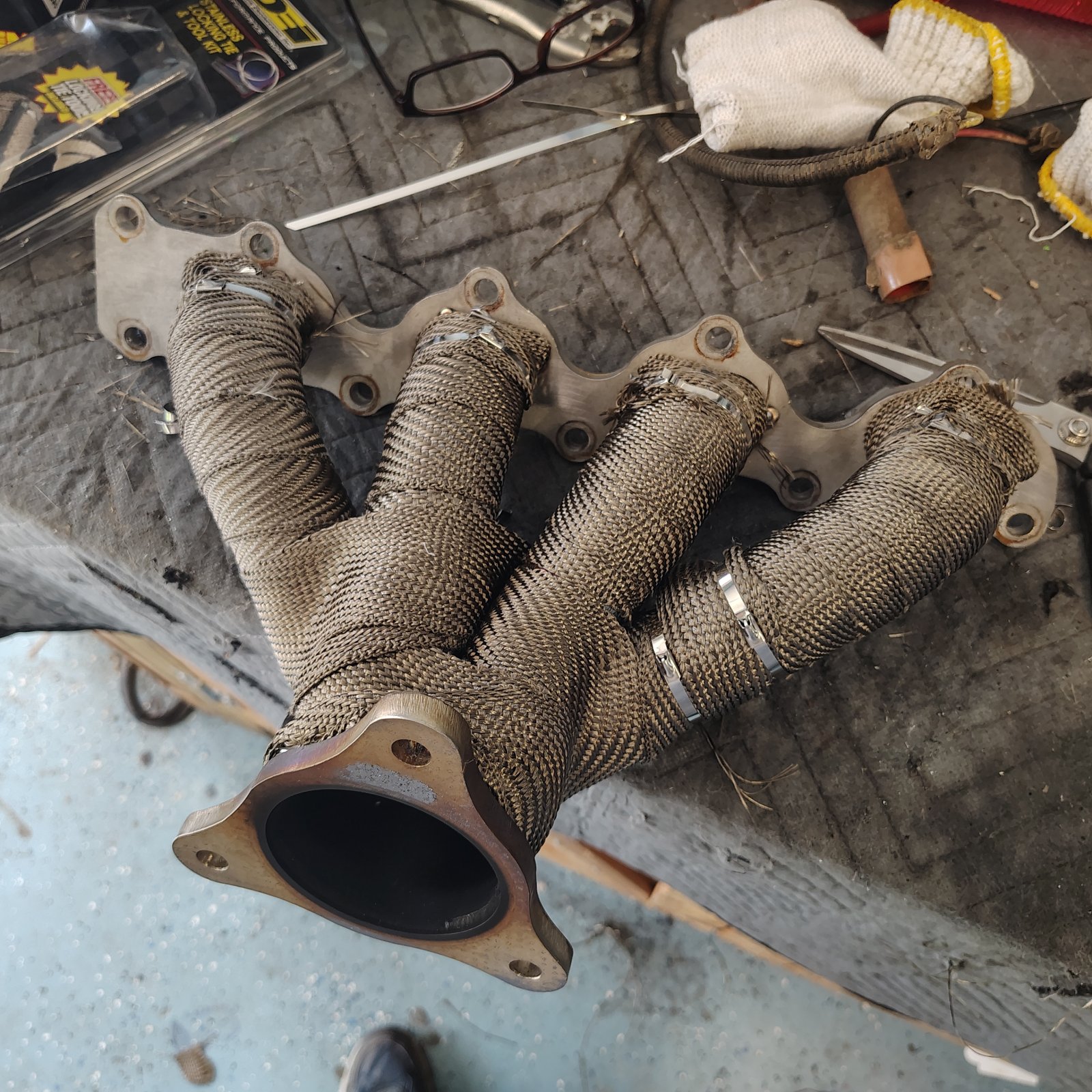

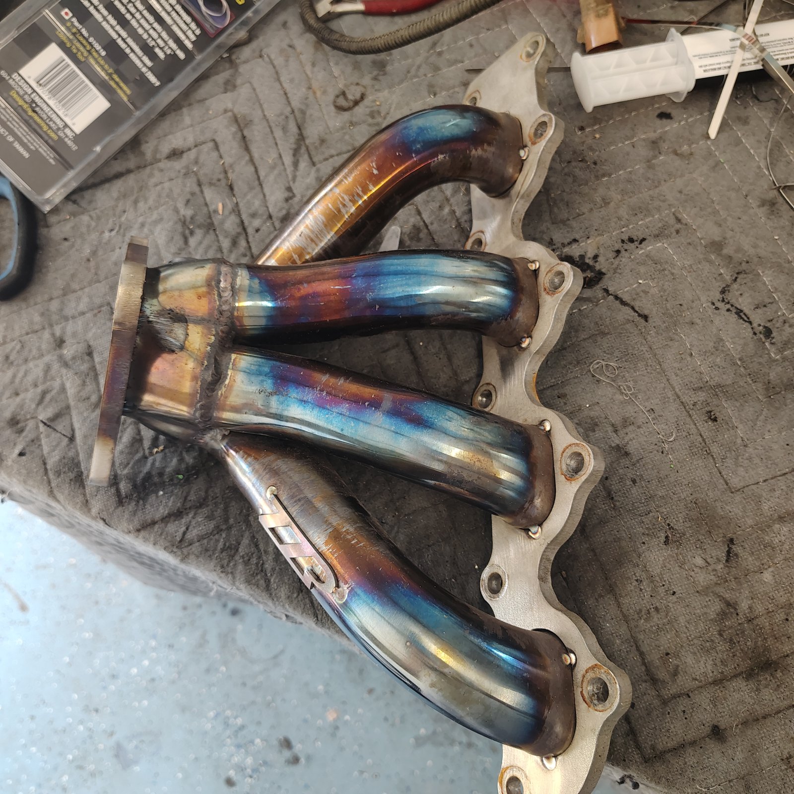

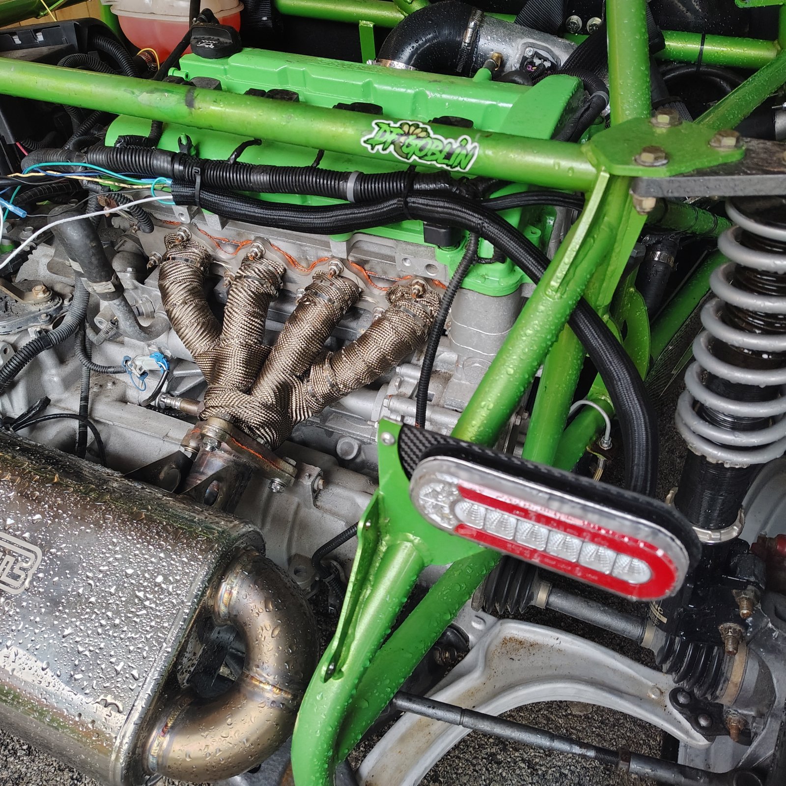

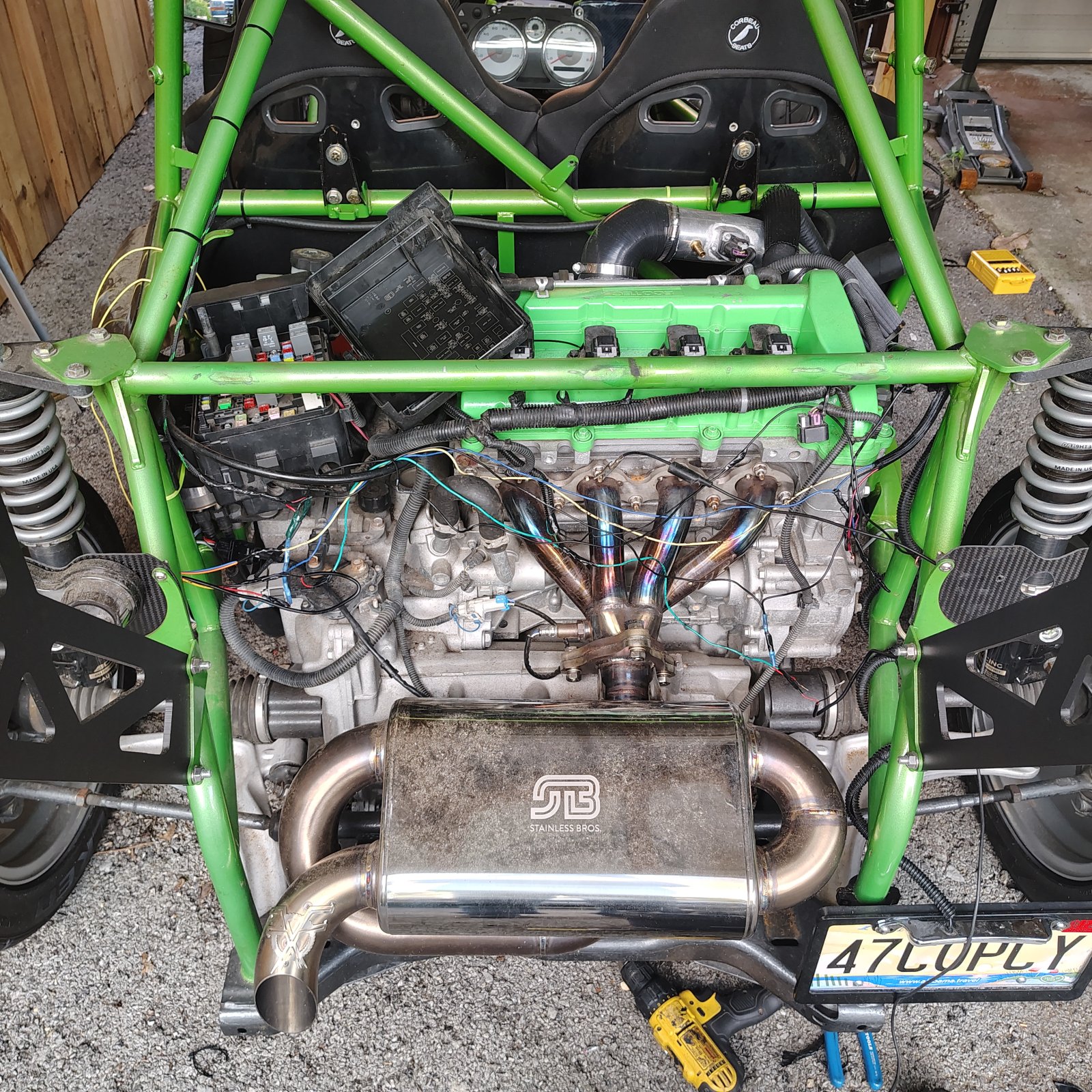

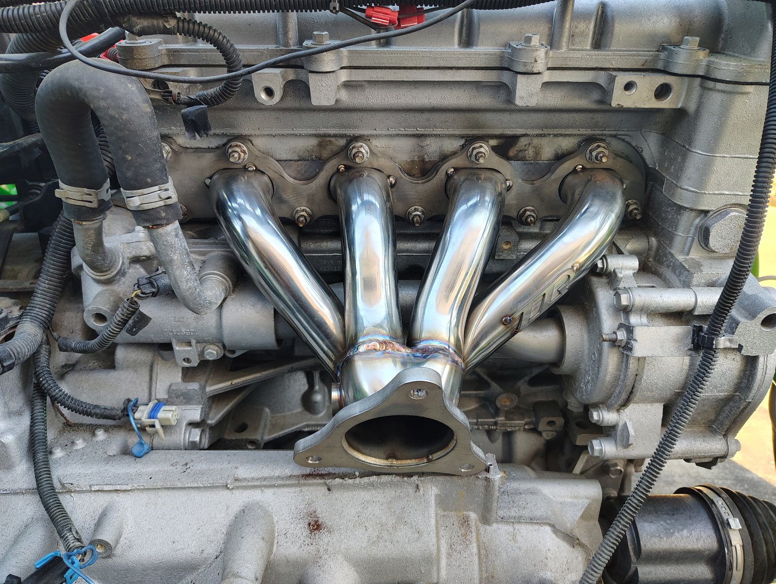

Someone put an old ZZP header on it, but it was disgusting looking, so I couldn't pass up a new shiny stainless ZZP header for $100!
52799
I also wanted a different looking muffler, I thought and thought about it and then I pulled the trigger on this Forever Fab Dual Muffler:

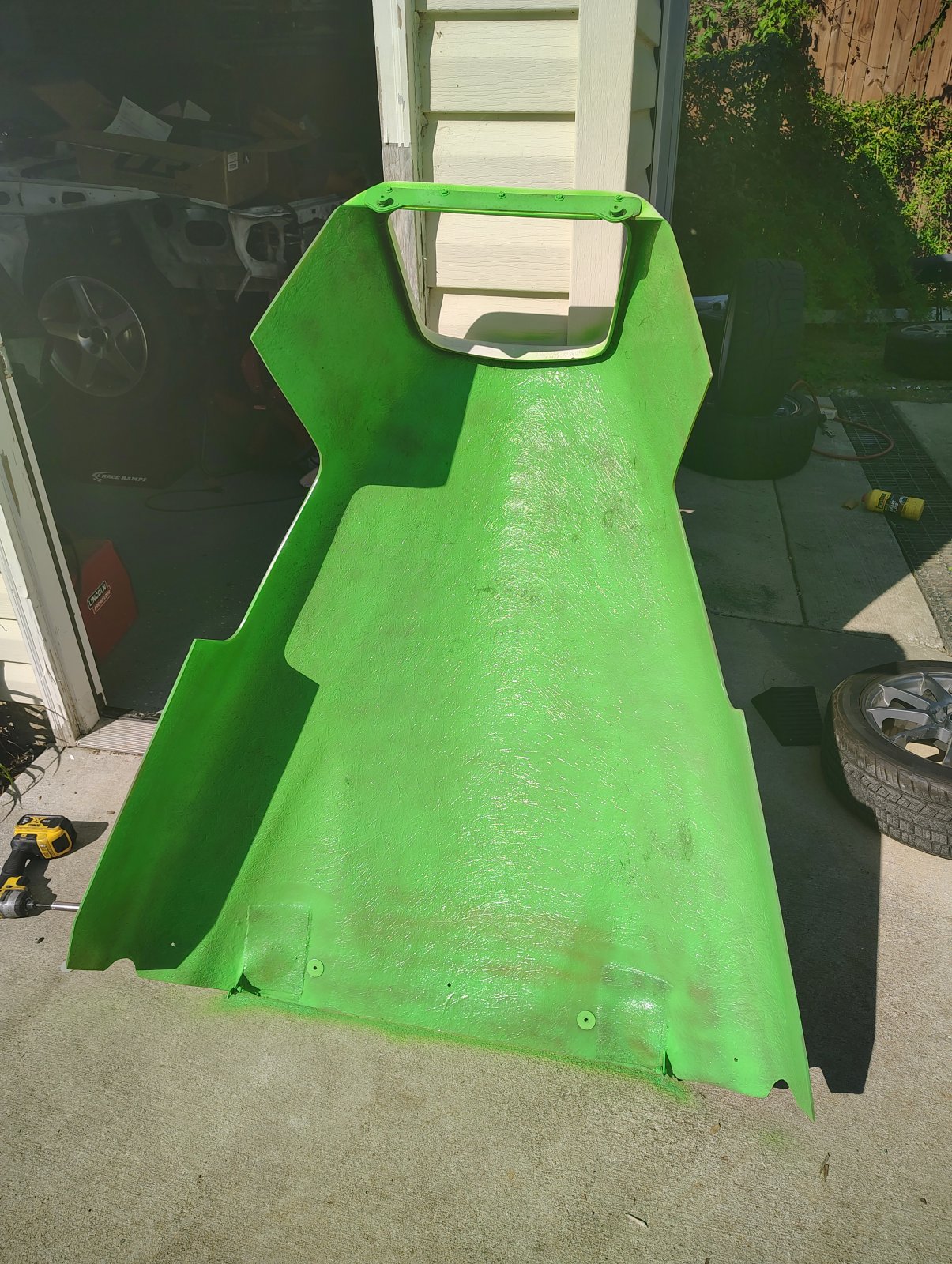

The underside of the replacement hood was tan fiberglass, so I sprayed it Mopar Grabber Green.

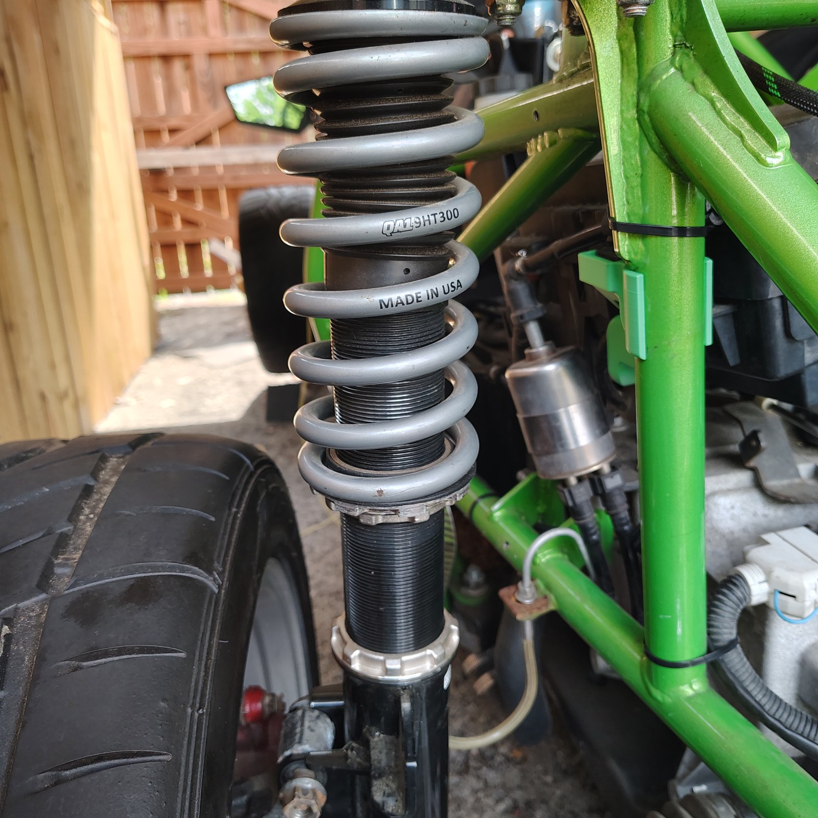

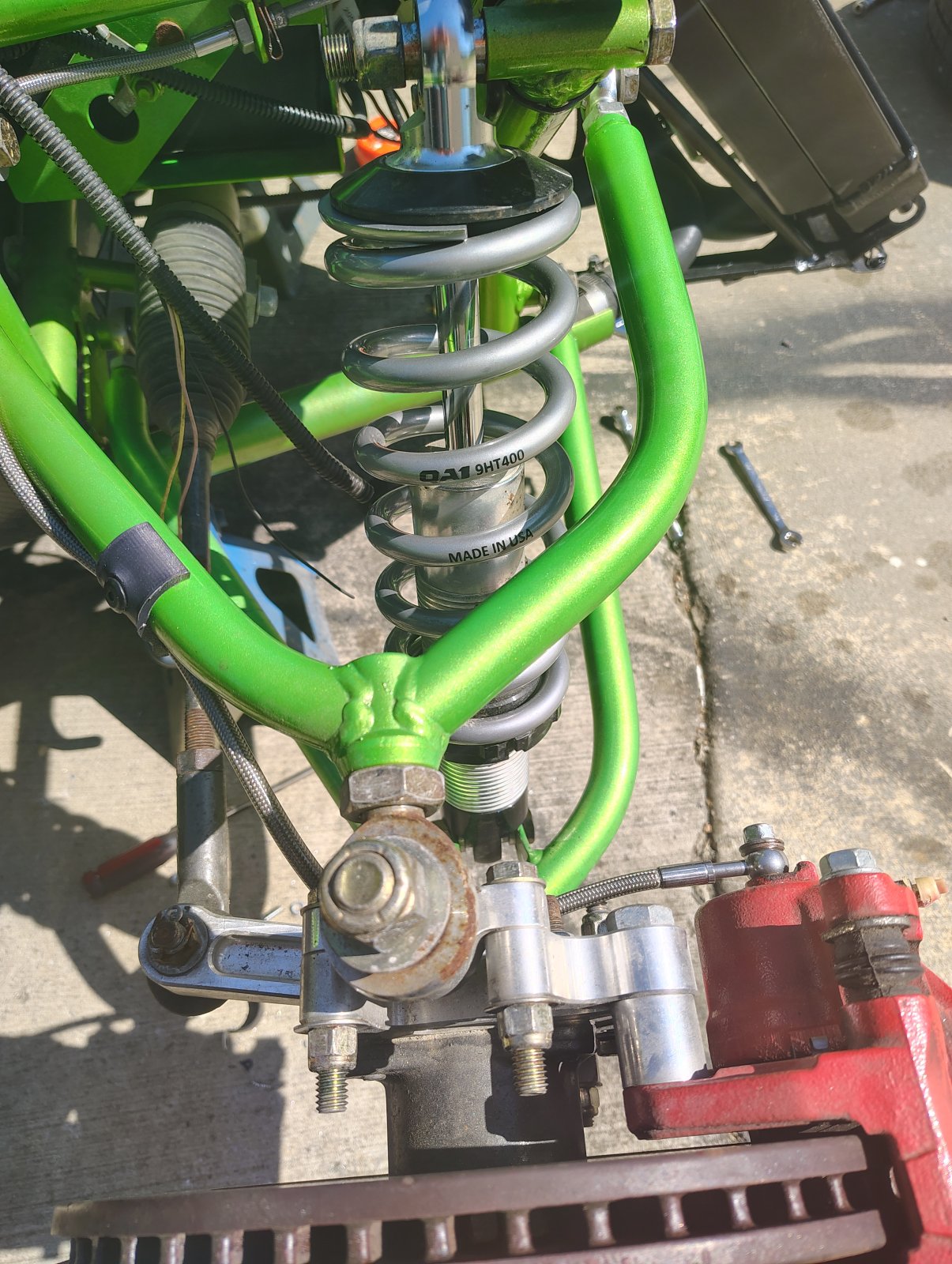

I installed the rear coilovers and did what everyone recommended, 400#'s in front and 300#'s in rear
52804
52805

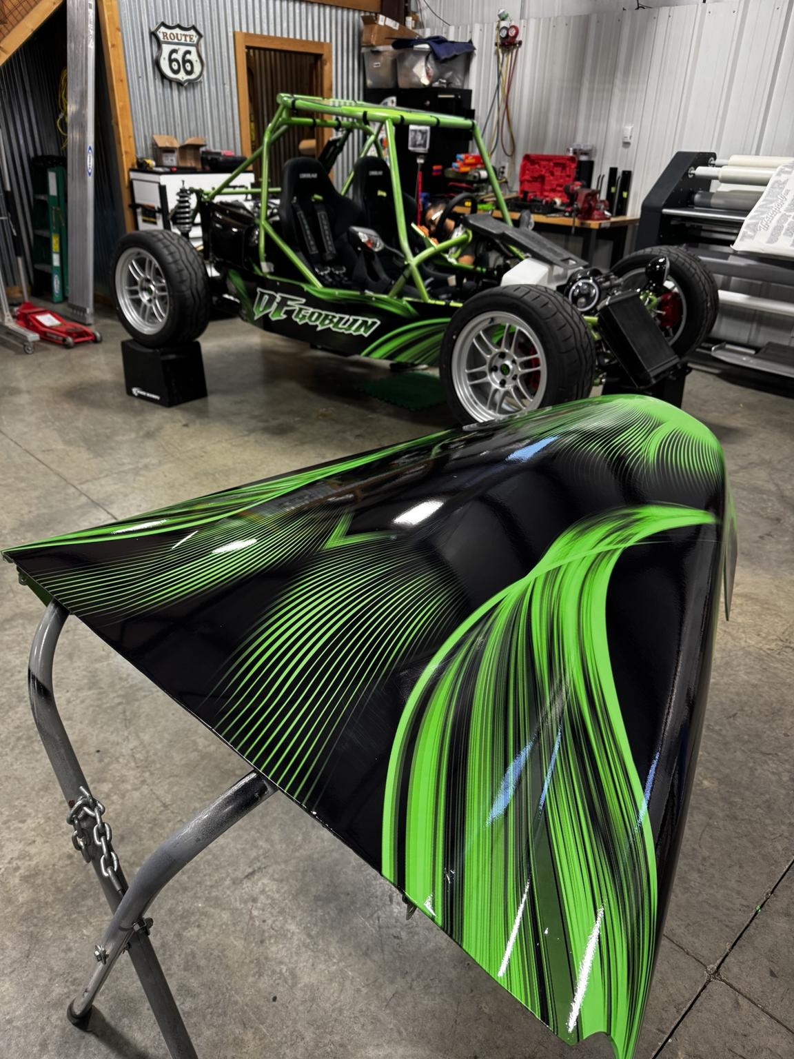

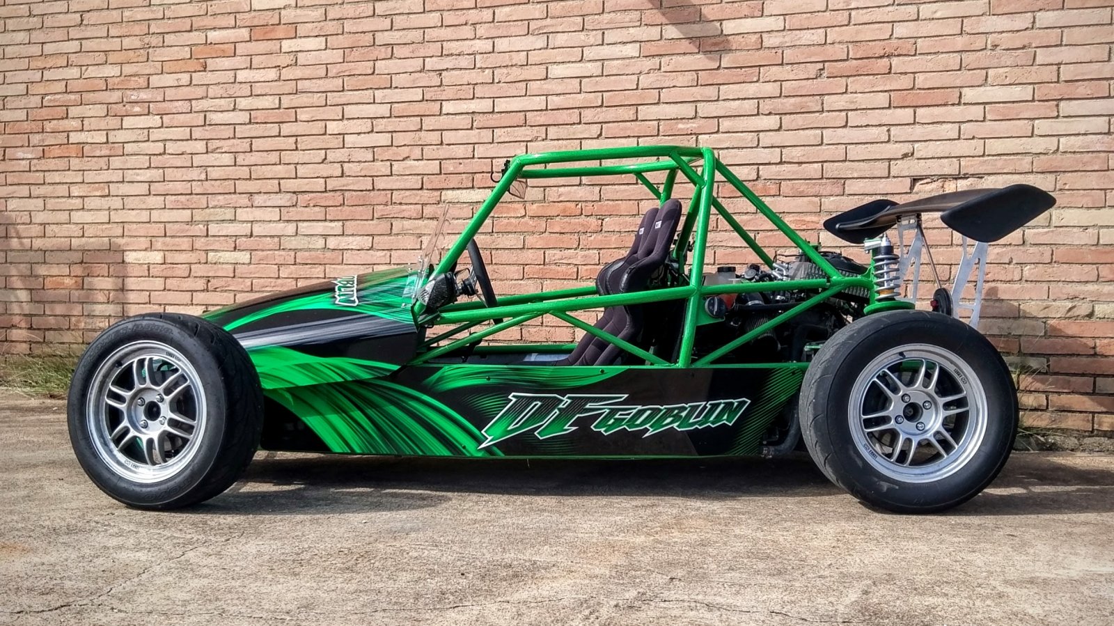

I wanted a cool looking Green/Black wrap on the whole car. I talked with Adam about their P2 Prototype, (which is also where I got the idea for which wheels I wanted to use), here:
52806
52807
Adam got me in touch with their wrappers in TX, Car Wrap City. I emailed them and asked for some minor changes on the wrap above, plus I asked them to add vinyl for the custom scoops and they emailed me this:

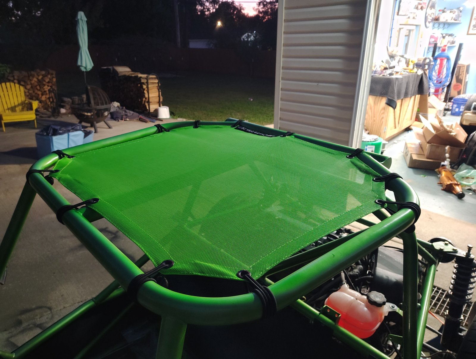

Installed the new Shadeidea.com top sunshade.
52813

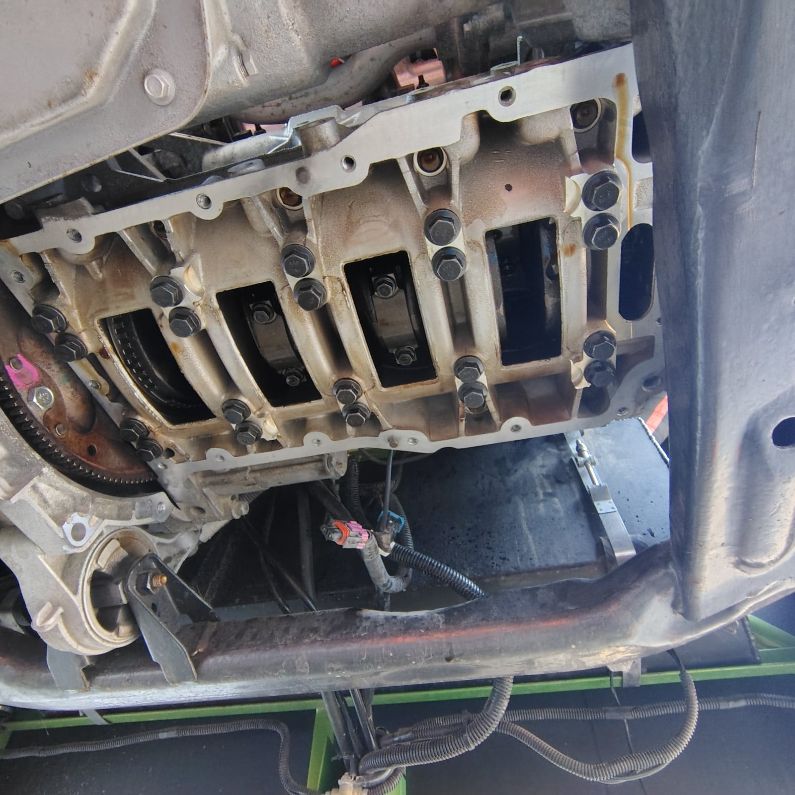

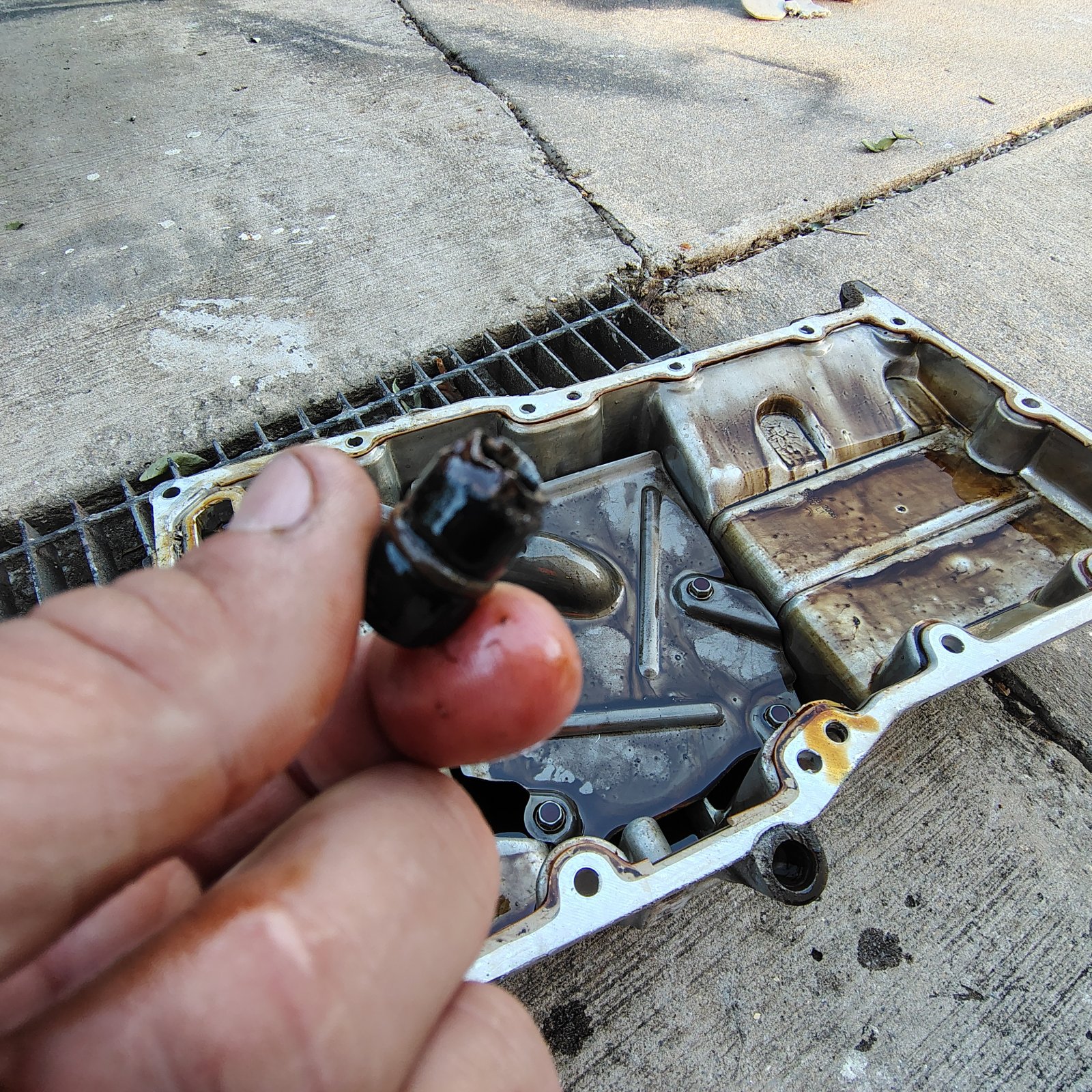

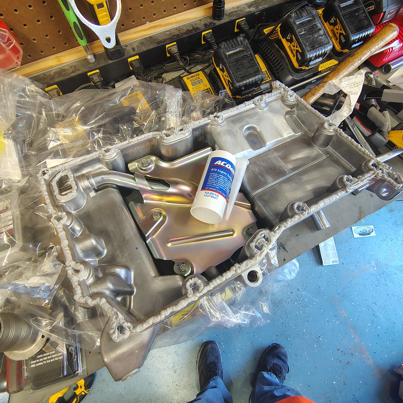

I went to check the engine oil and the dipstick tube came out with the dipstick and the tip of the tube broke off in the oil pan... I tried and tried to pull it out, but it eventually fell in the pan... So, as much as I didn't want too, I dropped the pan. The old pan was kind of grungy looking and a new AC Delco pan was cheap, so I ordered a new one, new dipstick tube and some AC Delco RTV to install it!
52820
52821
52822
52823
52824
52825

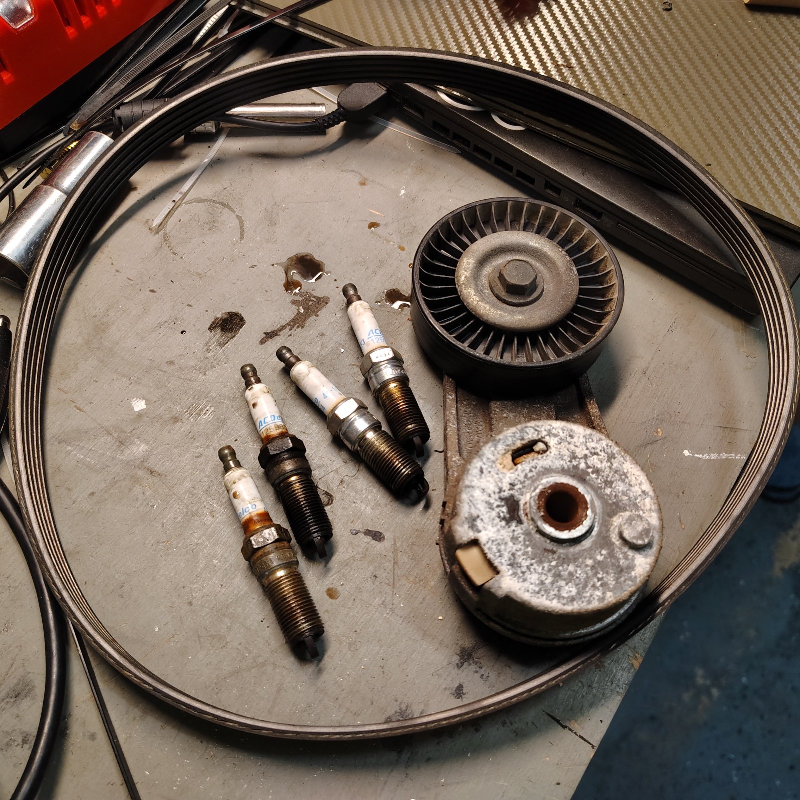

I replaced the plugs, idler pulley and belt. Old junk in pic! 2 of the plugs were rusted!

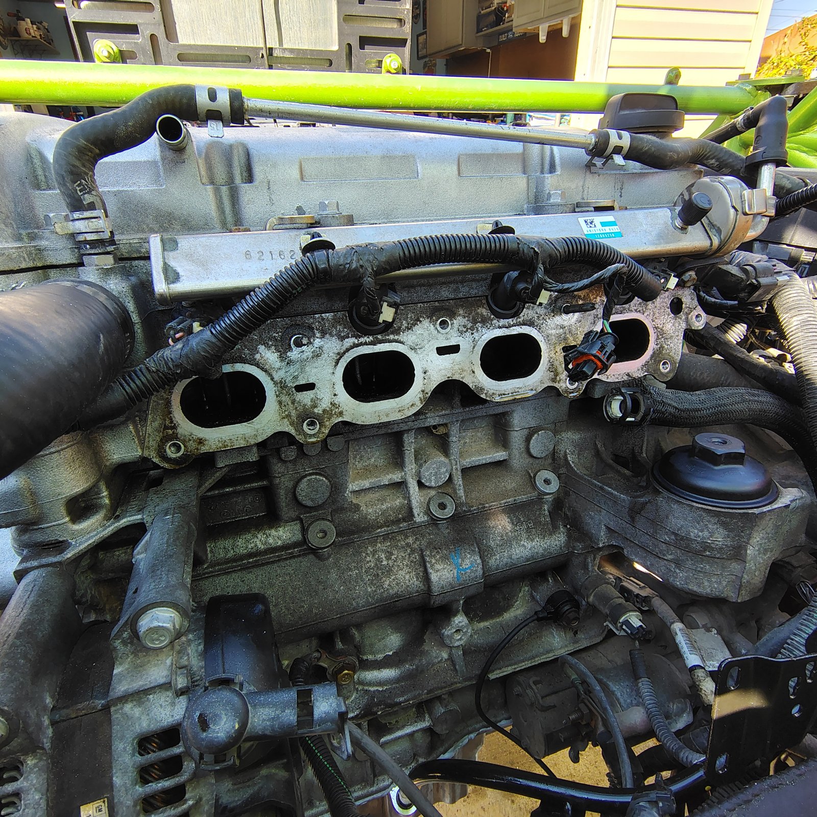

I also changed the oil filter and replaced the gaskets/o-rings on the intake manifold.

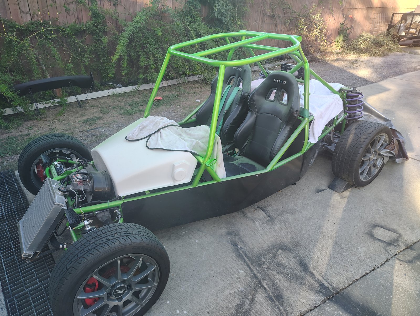

Pics of the DF Seat Mounts.
52814
I installed some Green/Black Boat Decking for my non-slip floor pads.
52816

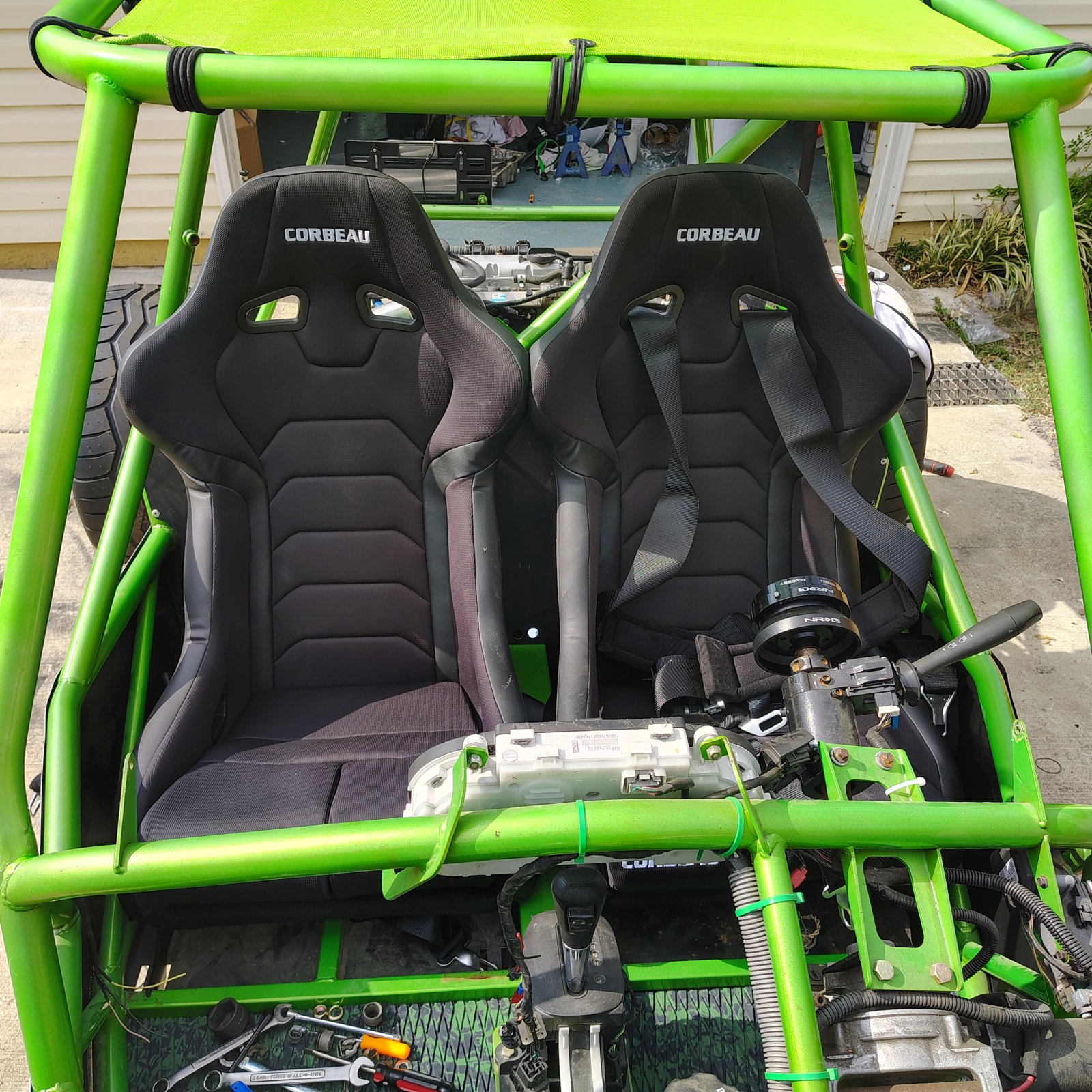

The Corbeau Seats installed.
52815
52830

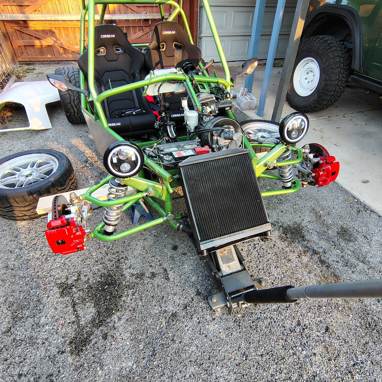

I sprayed the radiator with High Heat Black paint, because that aluminum was sticking out awfully bad... I also installed Talon's Splitter.
52828

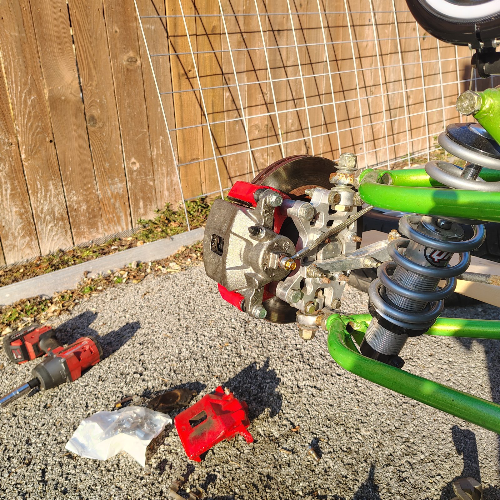

The right front brake caliper was sticking/freezing up, so I just replaced both of them and painted them red, to match the rears. I remember reading in Rich's build thread about the caliper sticking. It eventually just quit releasing...
52817
52818

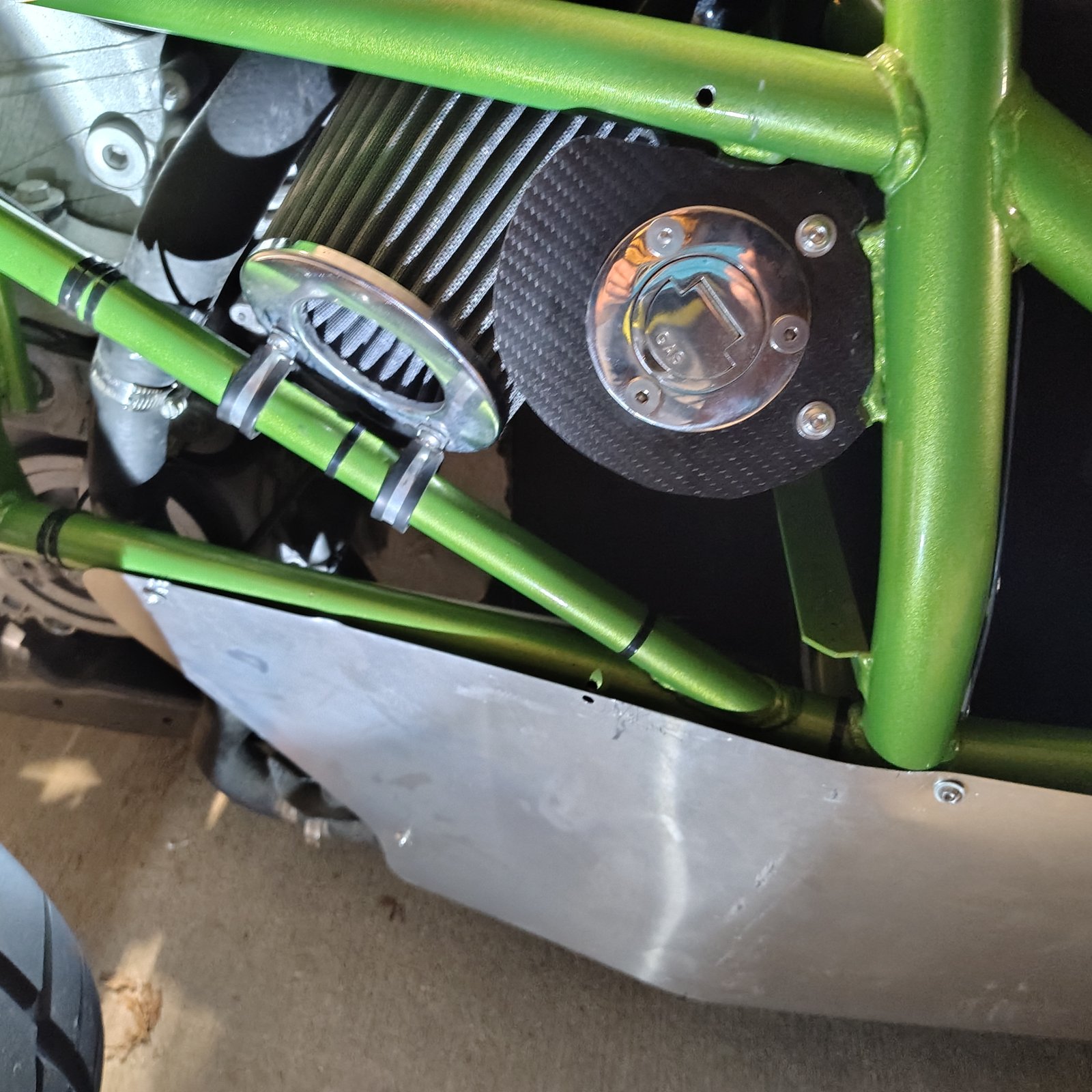

Made another Carbon Fiber mount and installed the Marine Gas Filler
52831

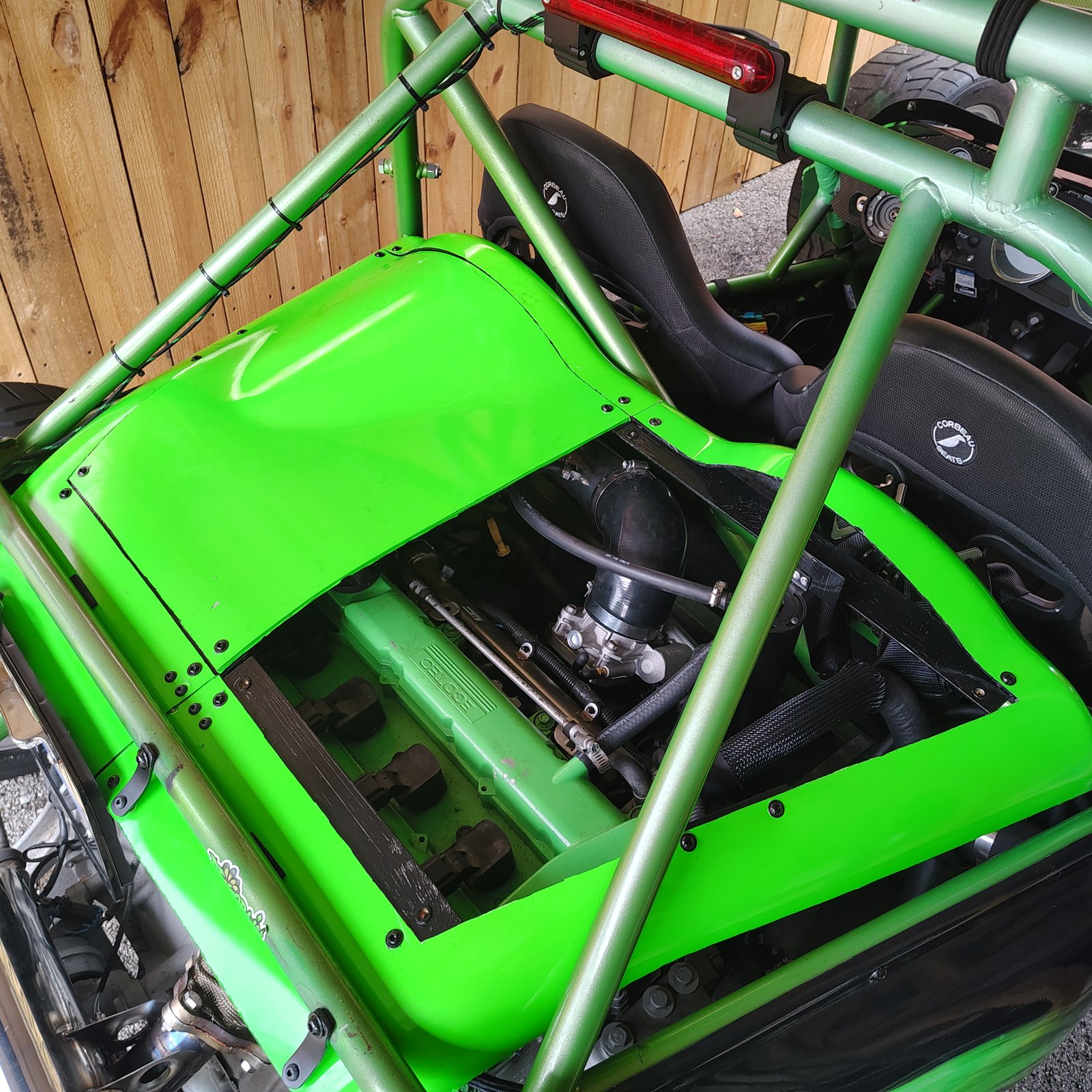

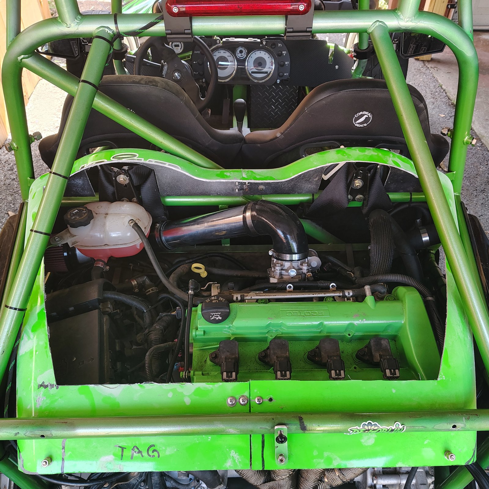

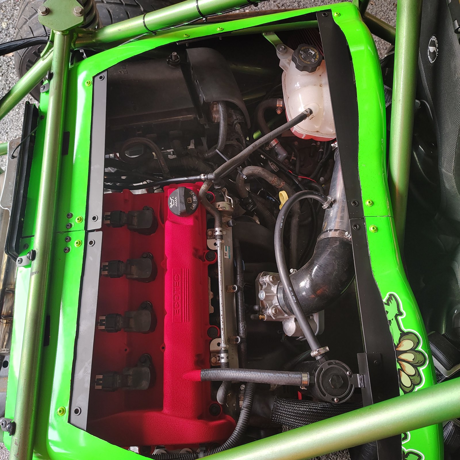

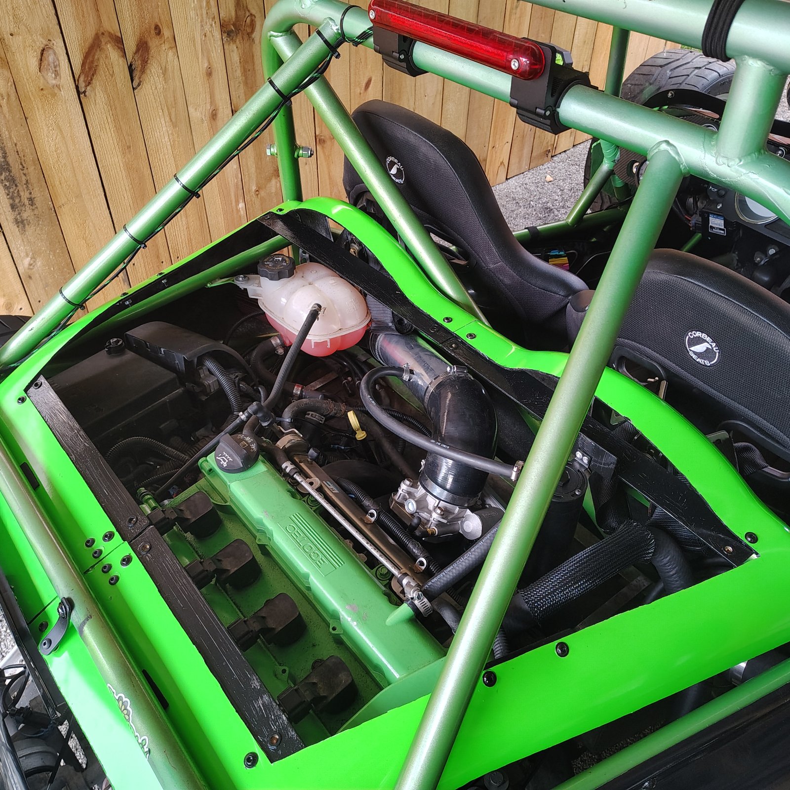

Fabricated some aluminum brackets and installed the rear engine covers.
52832

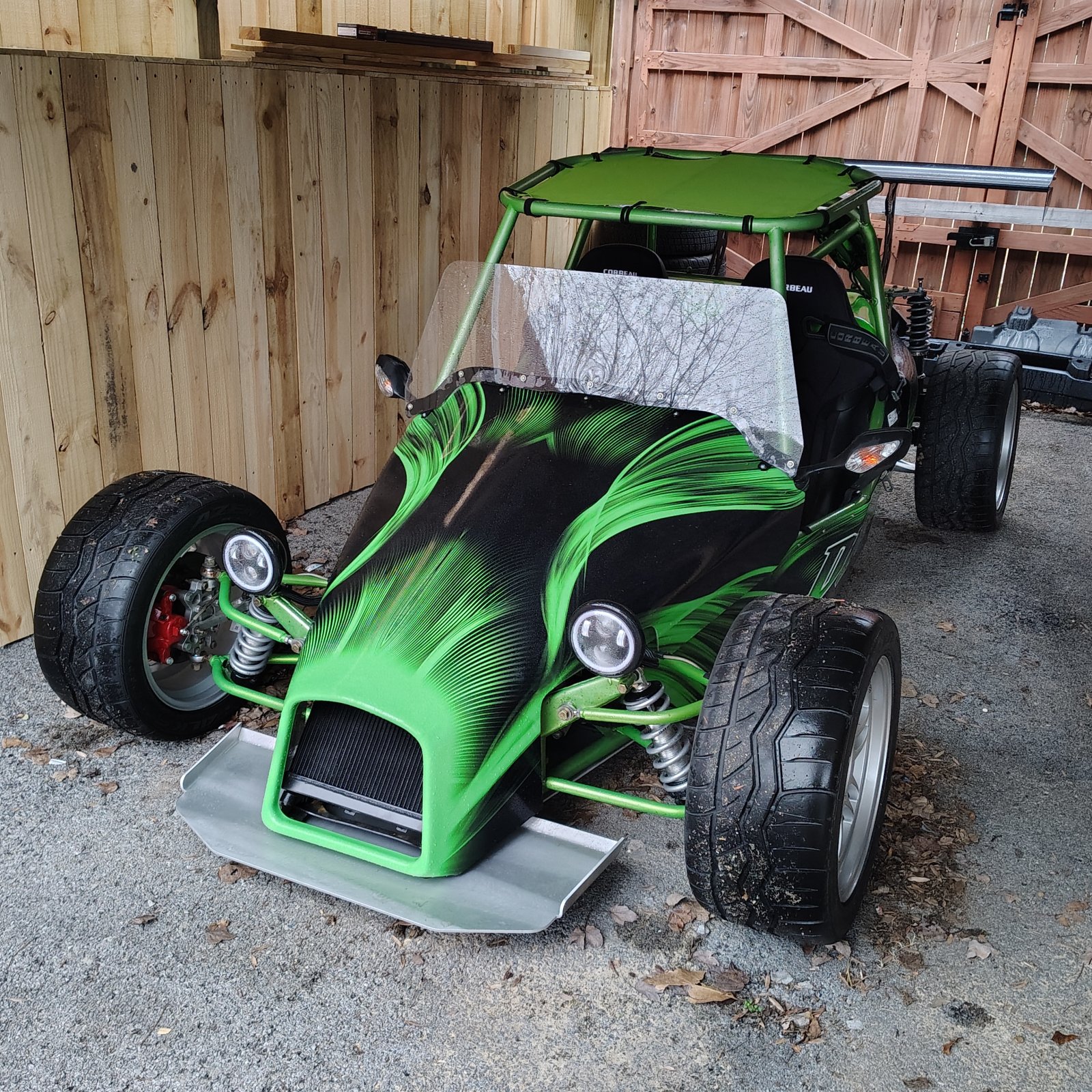

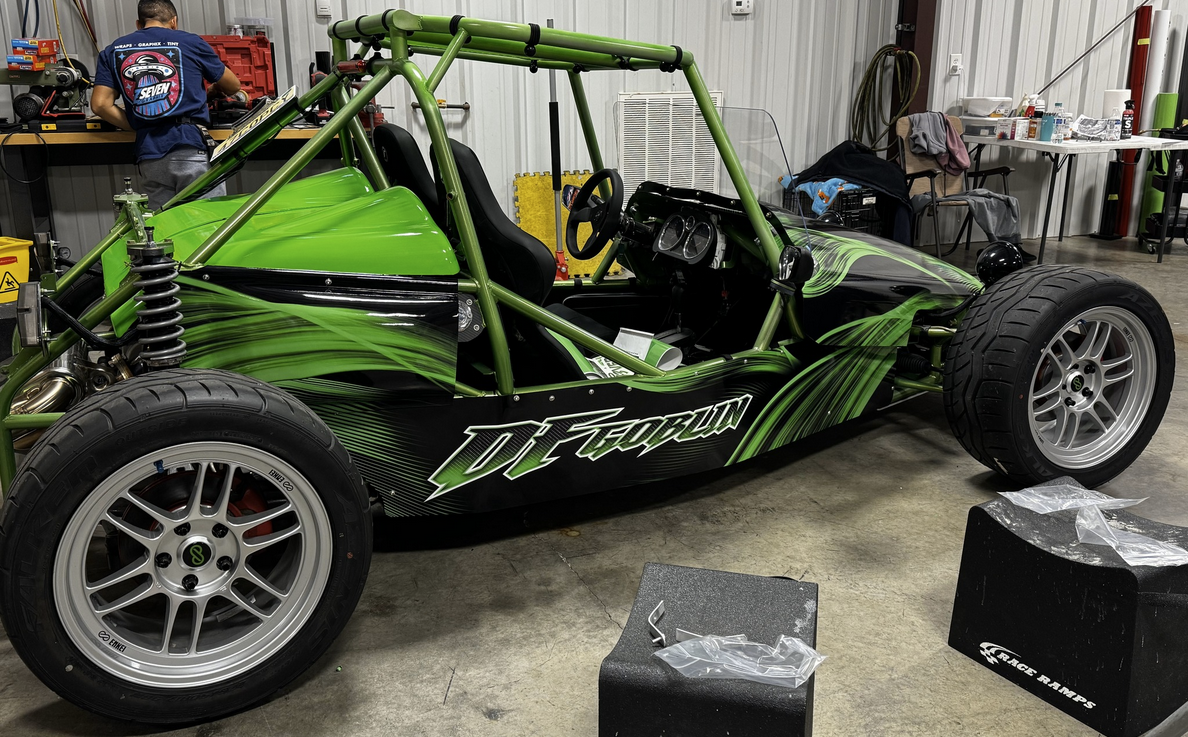

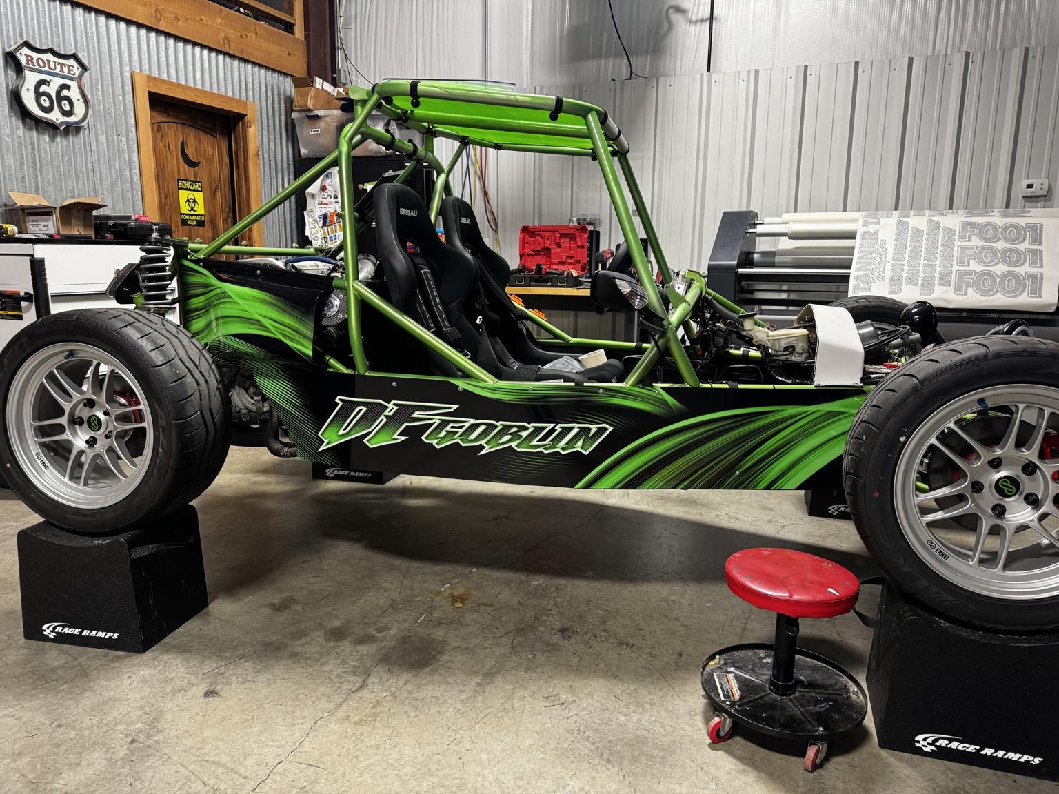

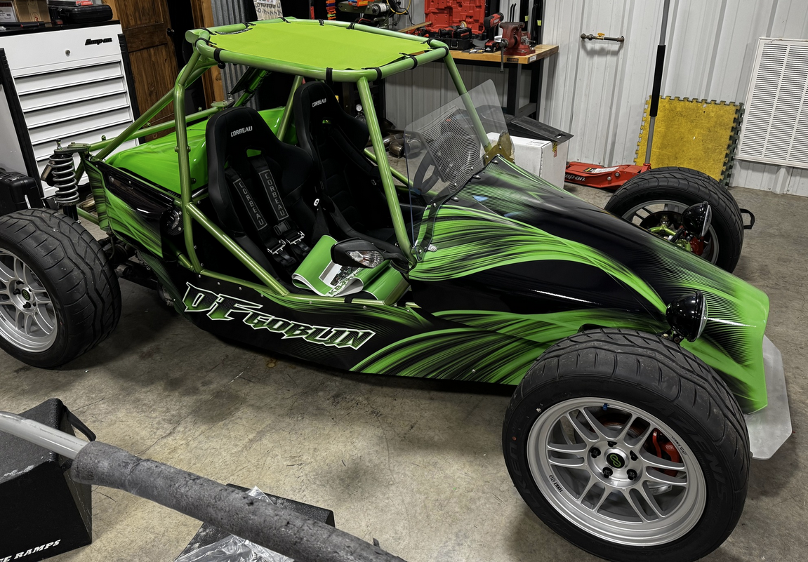

OK, now it's around the beginning of November, when I took the Goblin to the wrapper about an hour away from me. Was a chilly ride, but not too bad. First week of December, he sent me these pics:
52833
52834
52835
52836
52837
December 7th, I picked it up and it was a cold, cold ride home! Back it under the carport and went inside to thaw out!
52838

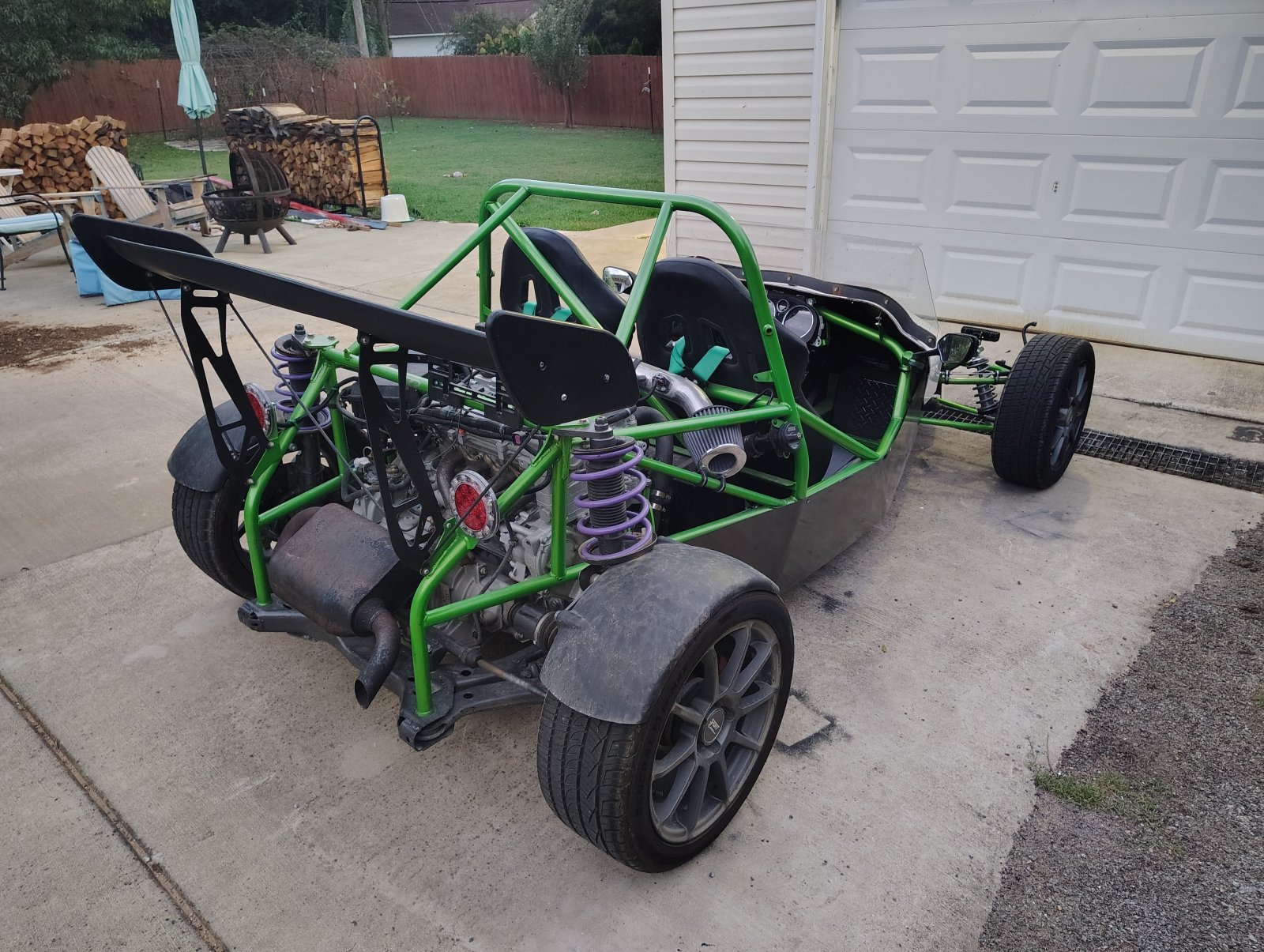

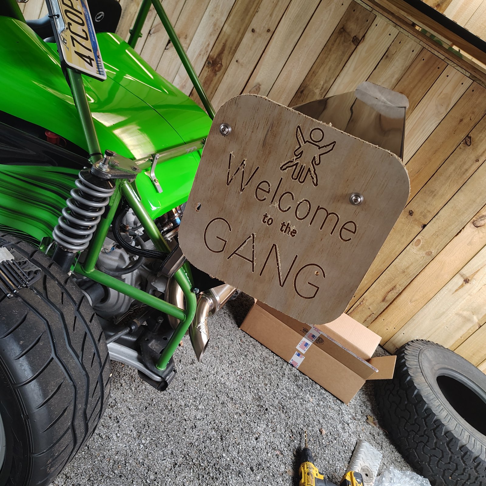

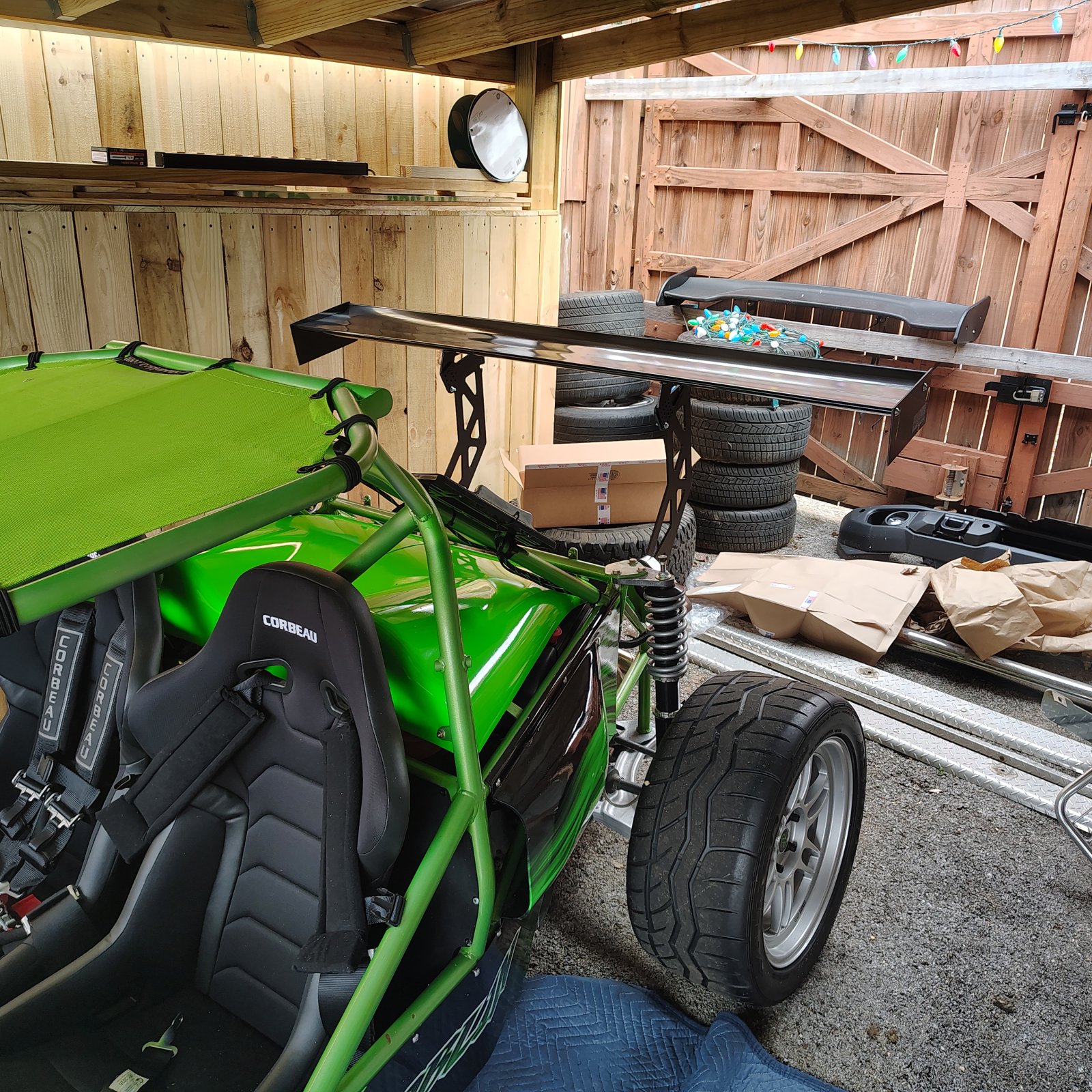

I order the Nine Lives Racing Rear Wang while the Goblin was gone. On December 14th, it arrived and although it was freezing outside, I installed it!
52839
52840
52841

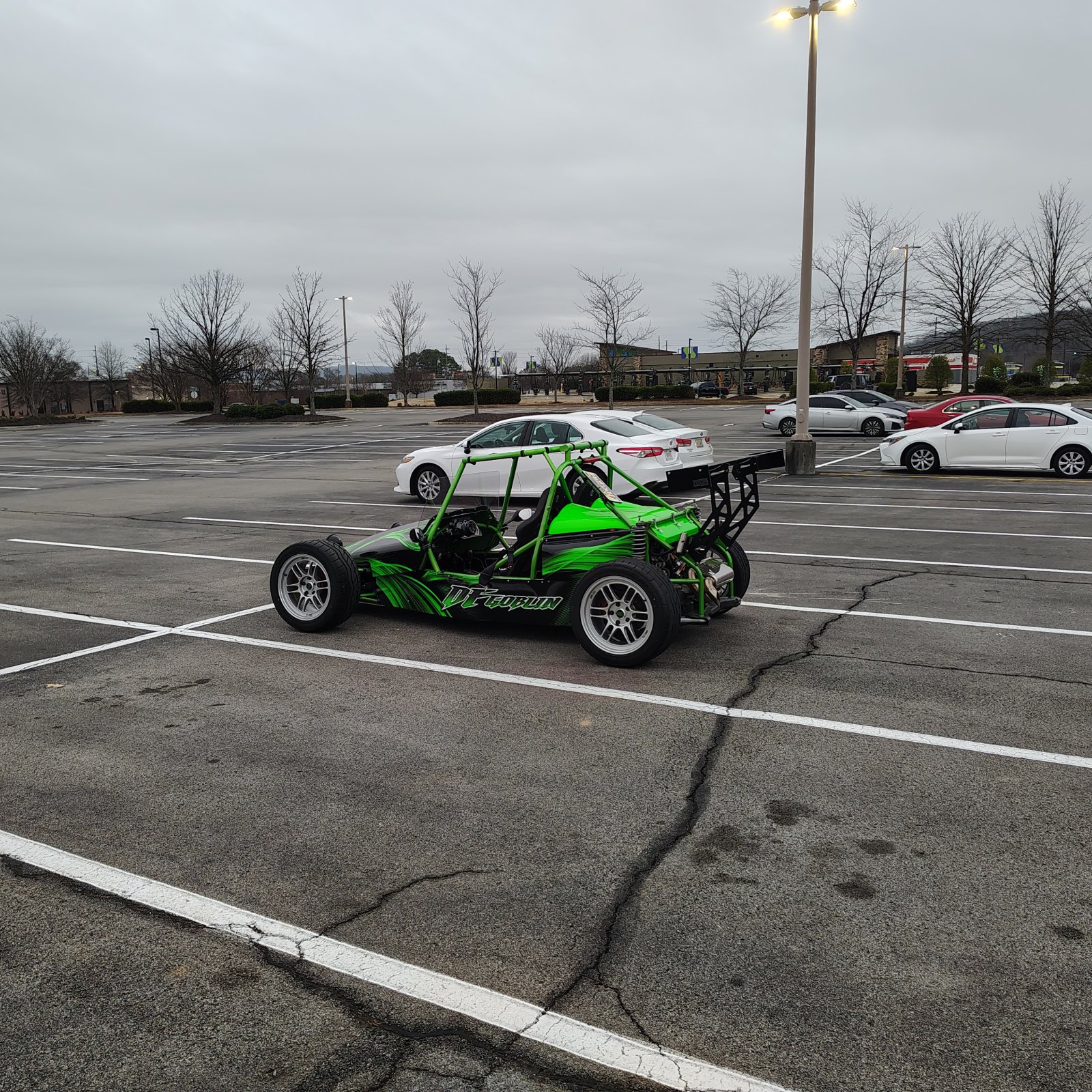

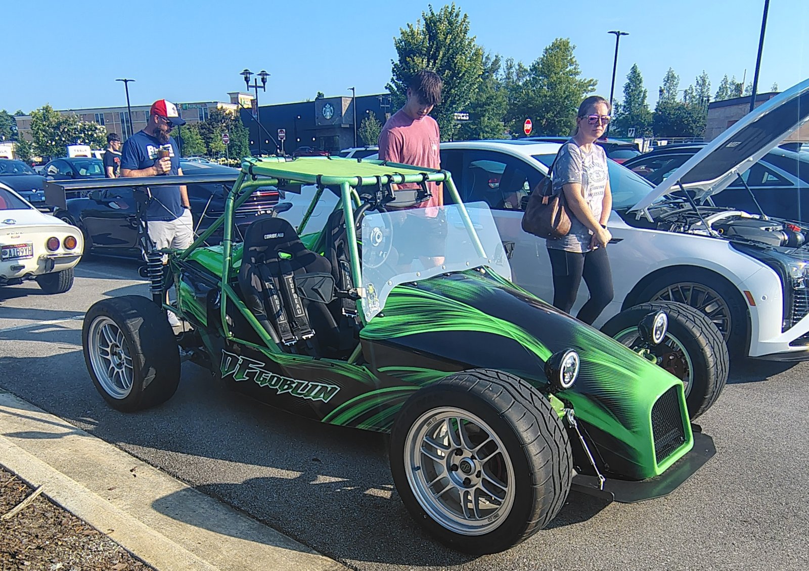

Same day, there was a car show, about 30-45 minutes away. I went to it, this was the 4th time driving it. It was another freezing ride out there! I didn't win a **** thing.... :(
52842
End of January, I said, it's nice out, I'm going to drive it to Lowe's (5th time driving it). Drive there was good!
52843
Drive home, not so much....
52844
52845

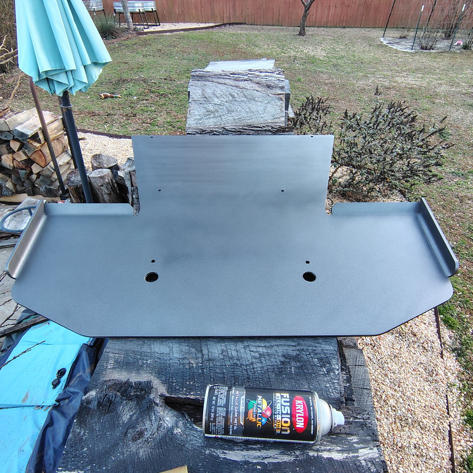

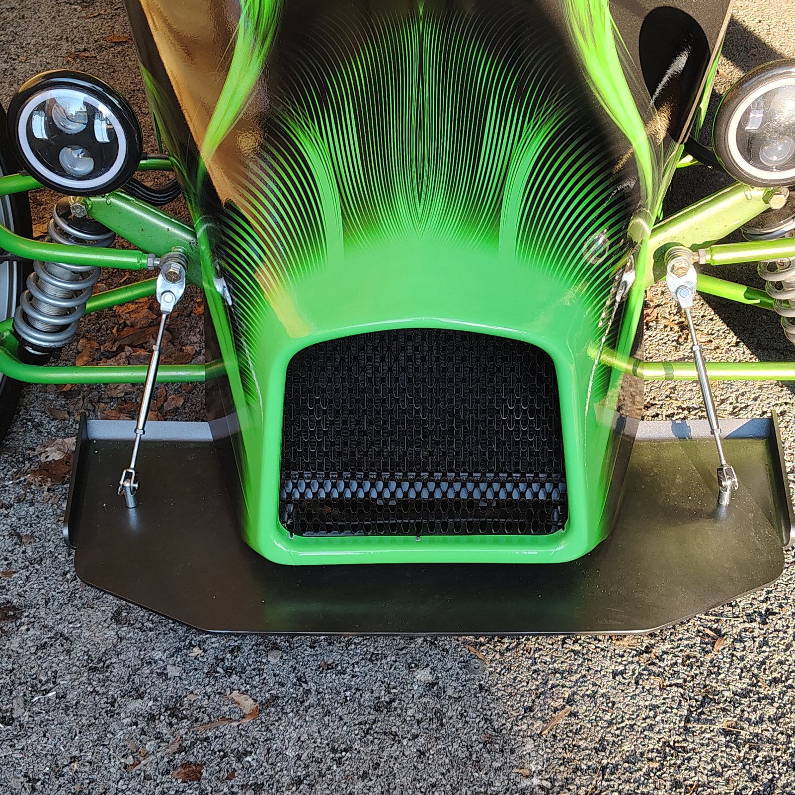

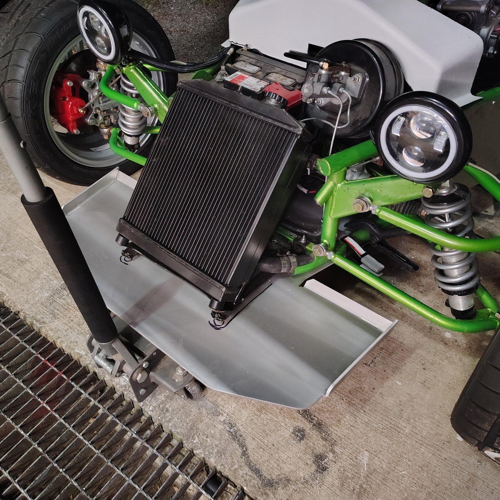

February 1st, I removed the splitter and painted it Krylon Metallic Dark Metal, to somewhat match the 9LR Rear Wang?
52846
Reinstalled the splitter and reinforced it with some steel flat stock bars!
52847

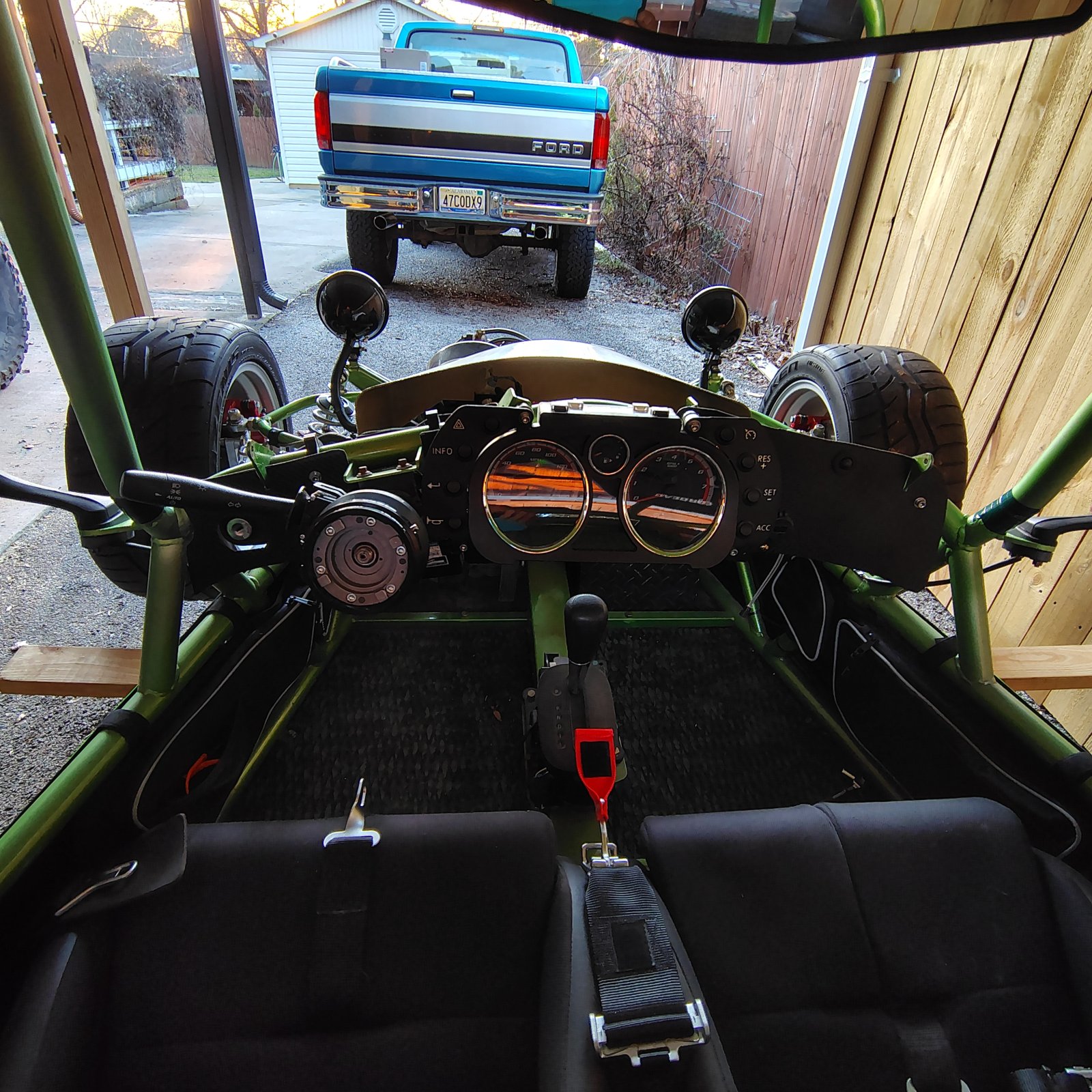

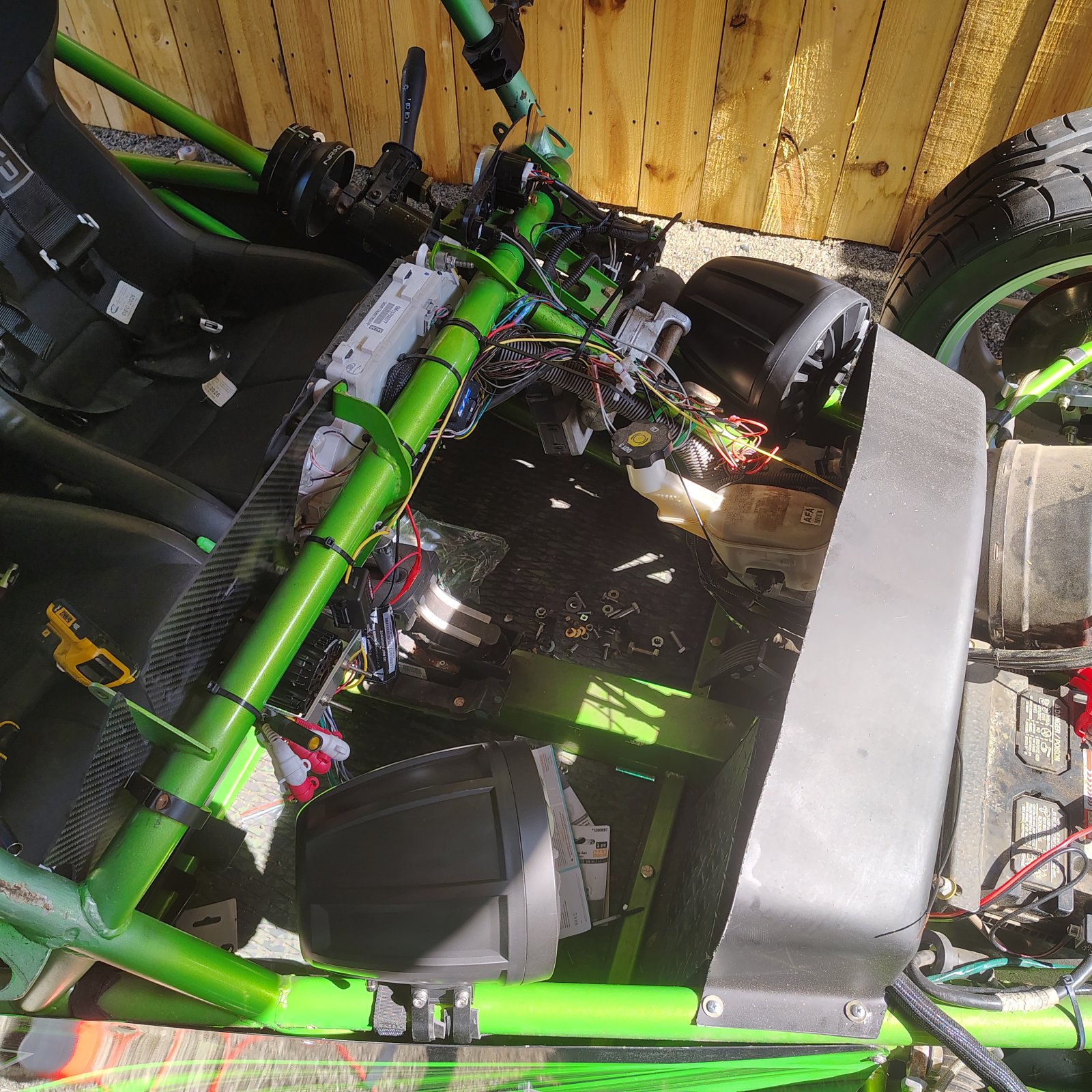

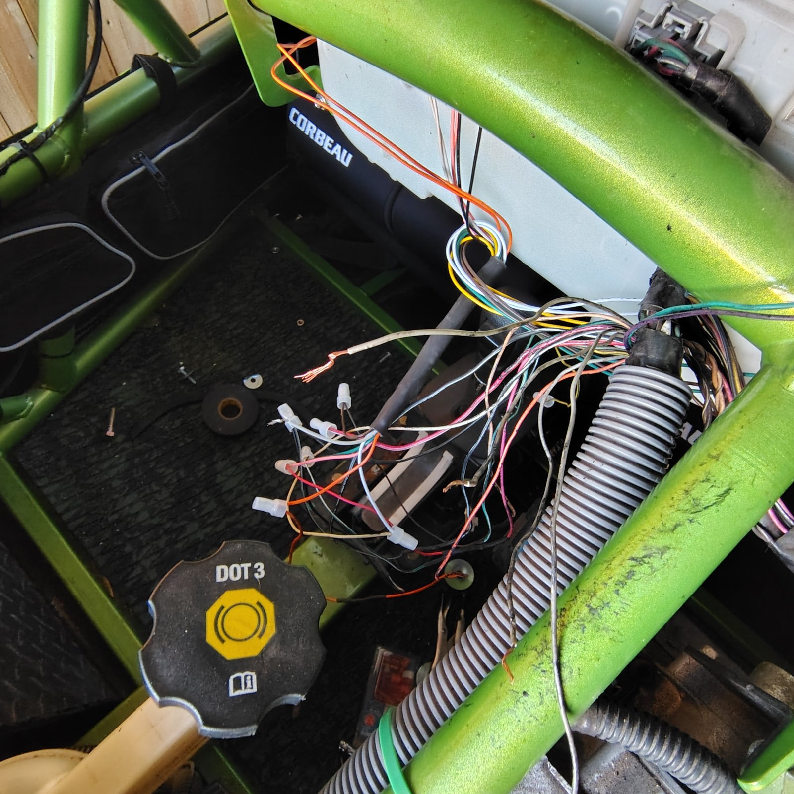

While the front hood was removed, I cleaned up the dash wiring a little better.
52848
I finally installed the DF Dash Button Panel upgrade.

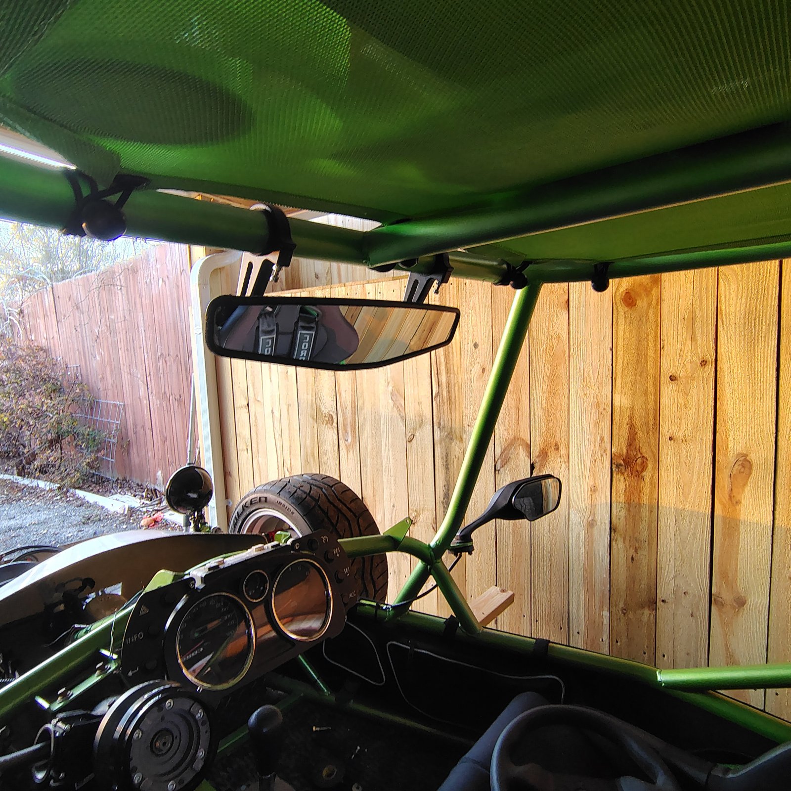

Installed a UTV Rear View Mirror from Amazon
52850

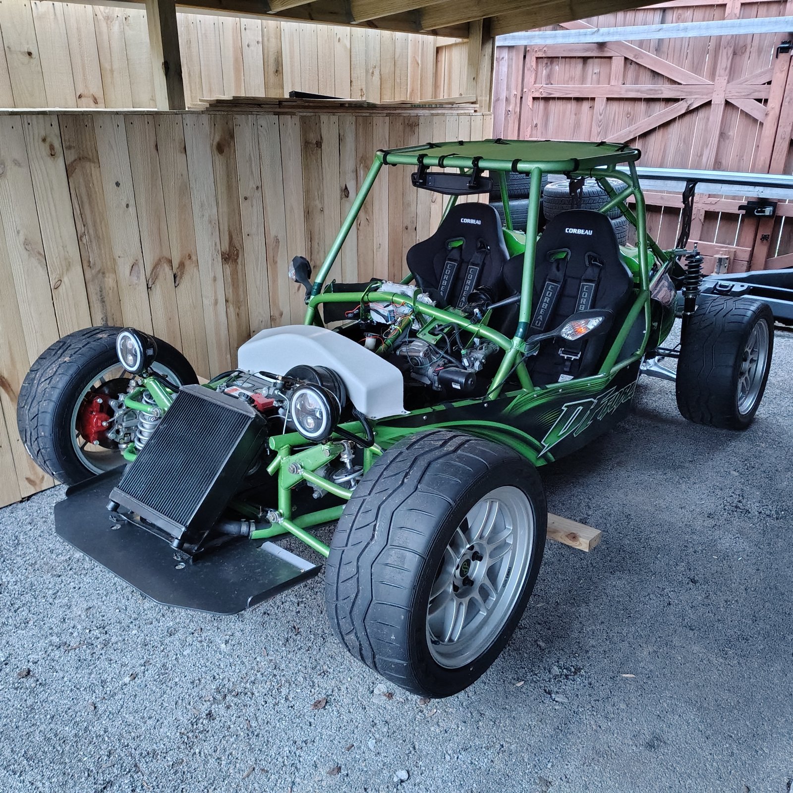

Decided that I wanted a nice, thick radiator screen. Ordered some cool looking Black screen from Amazon.
52853
Made a rough template of the nose opening onto it.
52854
Used some Black zip ties to secure it to the nose. I tried to line it up evenly and honestly, it turned out very nice!

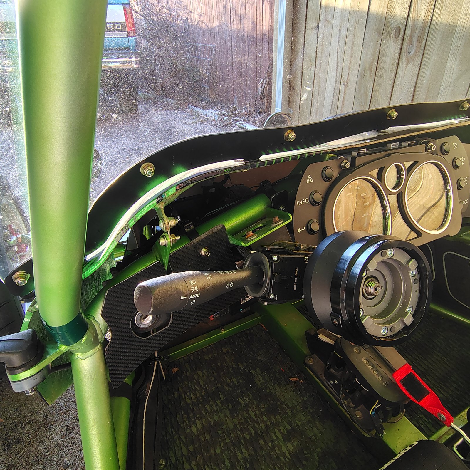

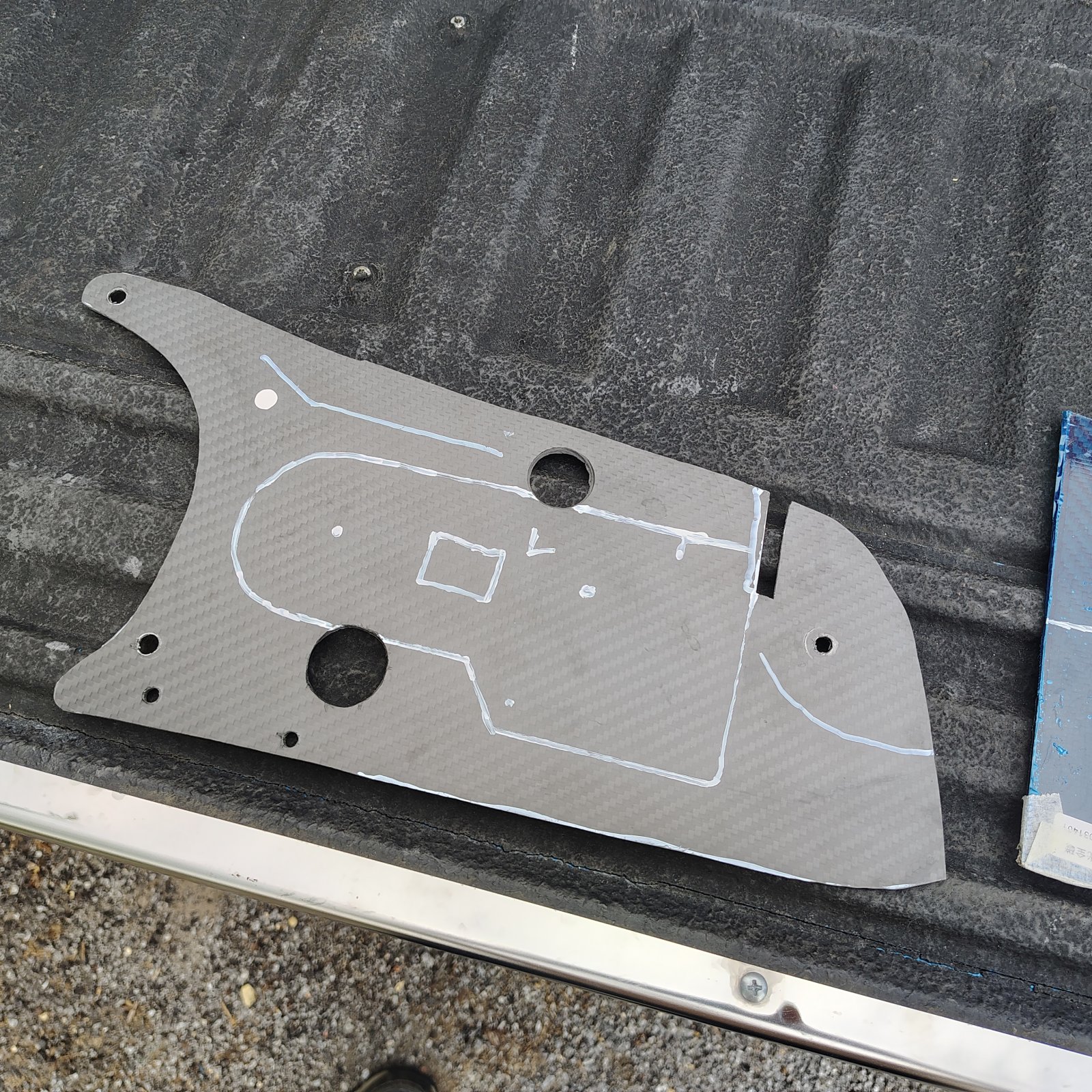

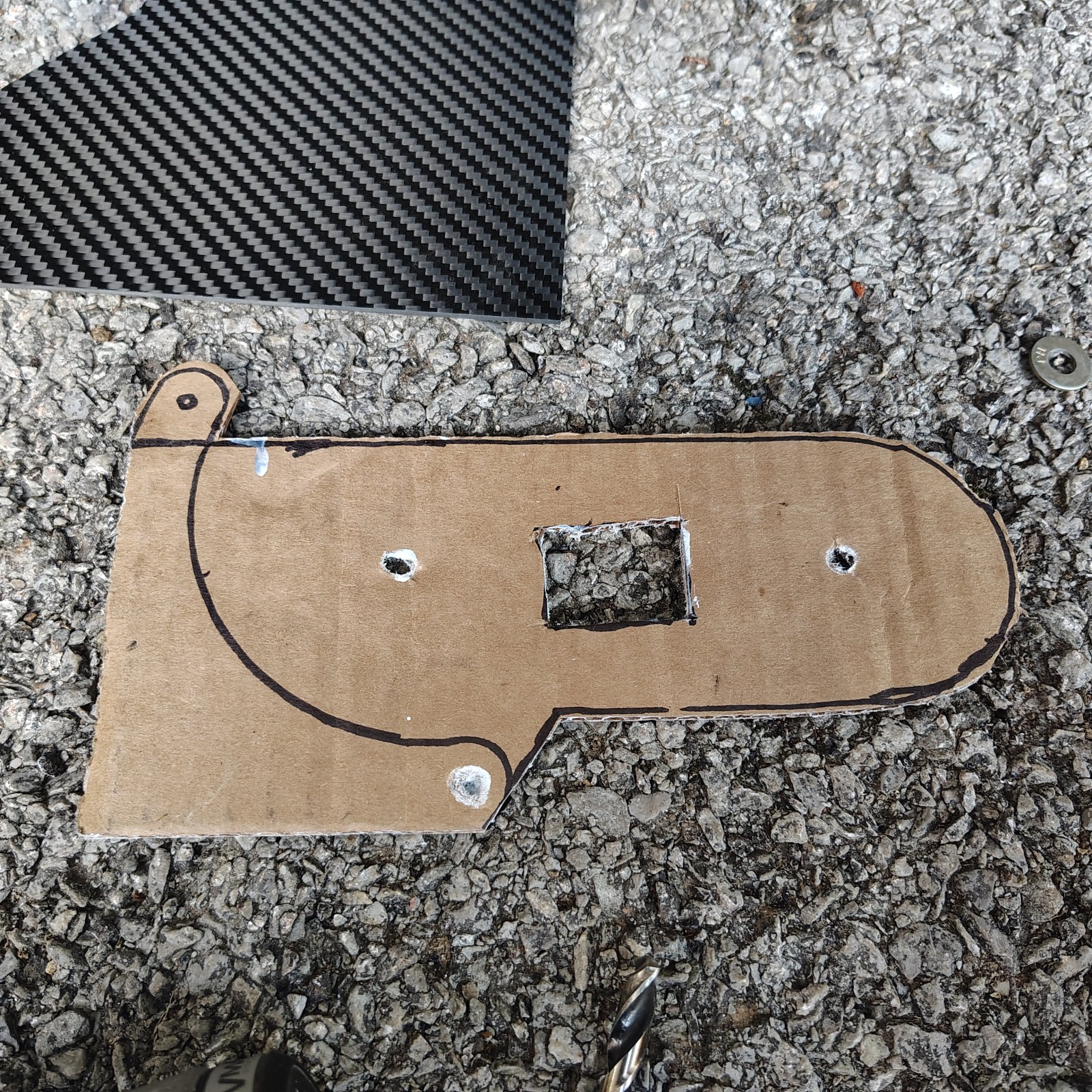

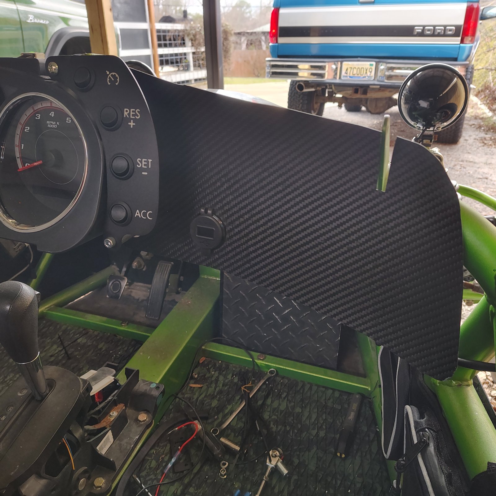

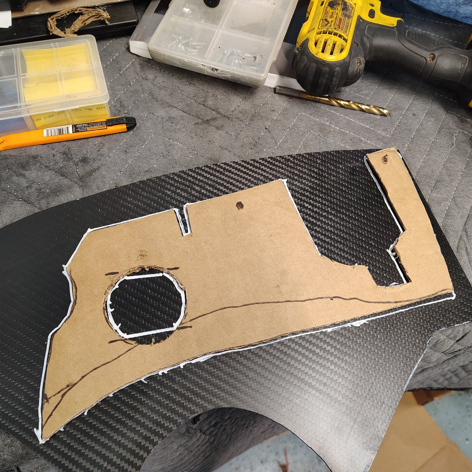

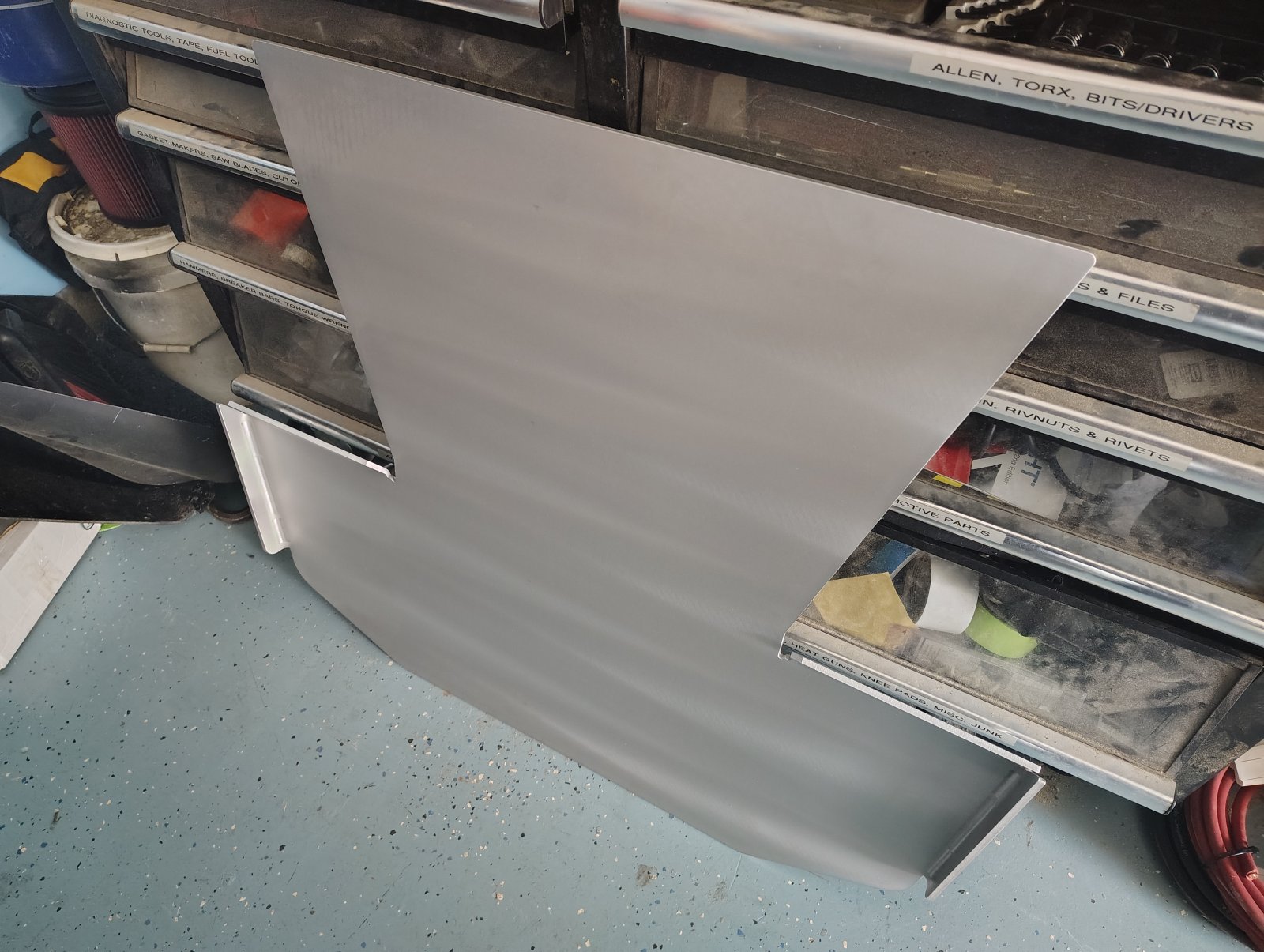

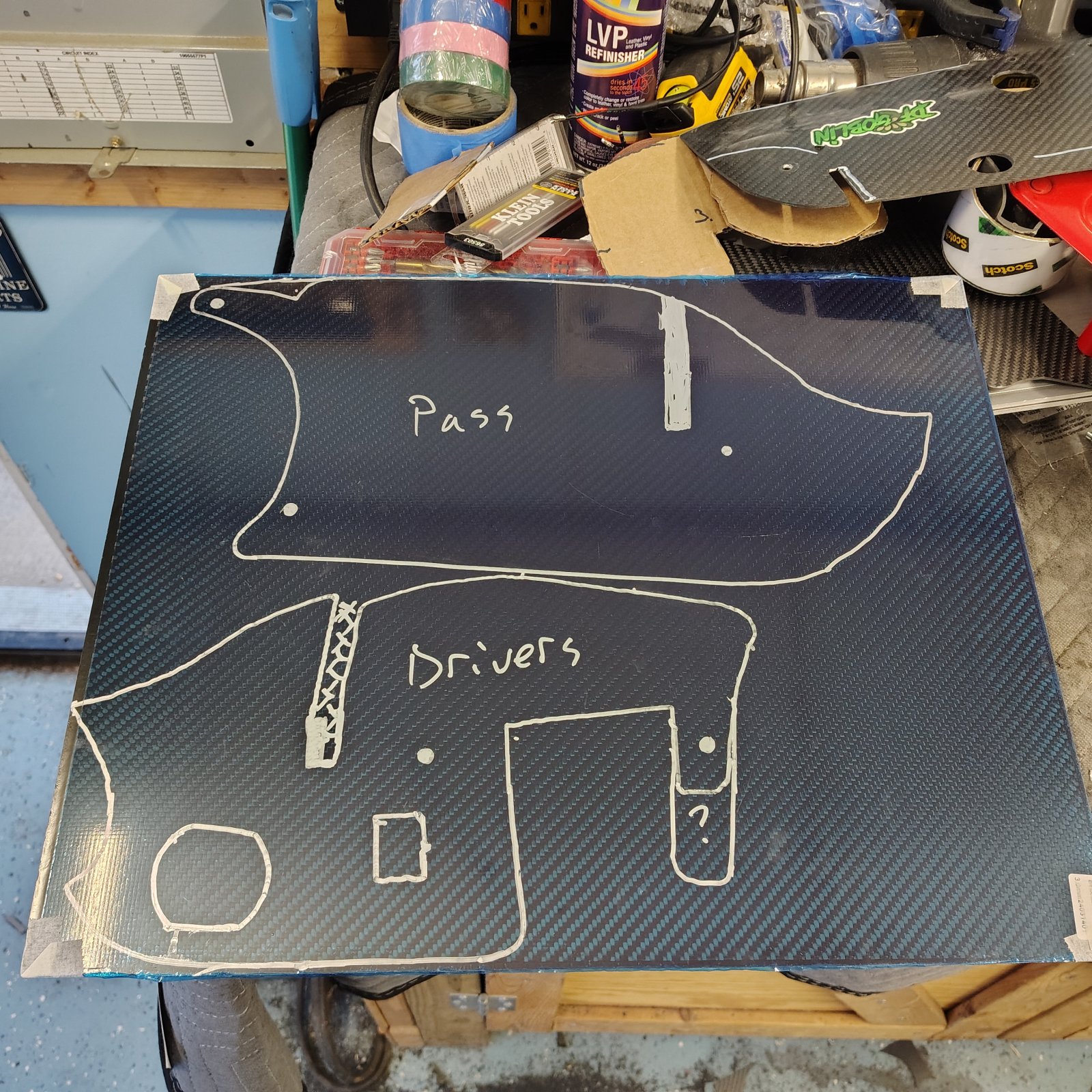

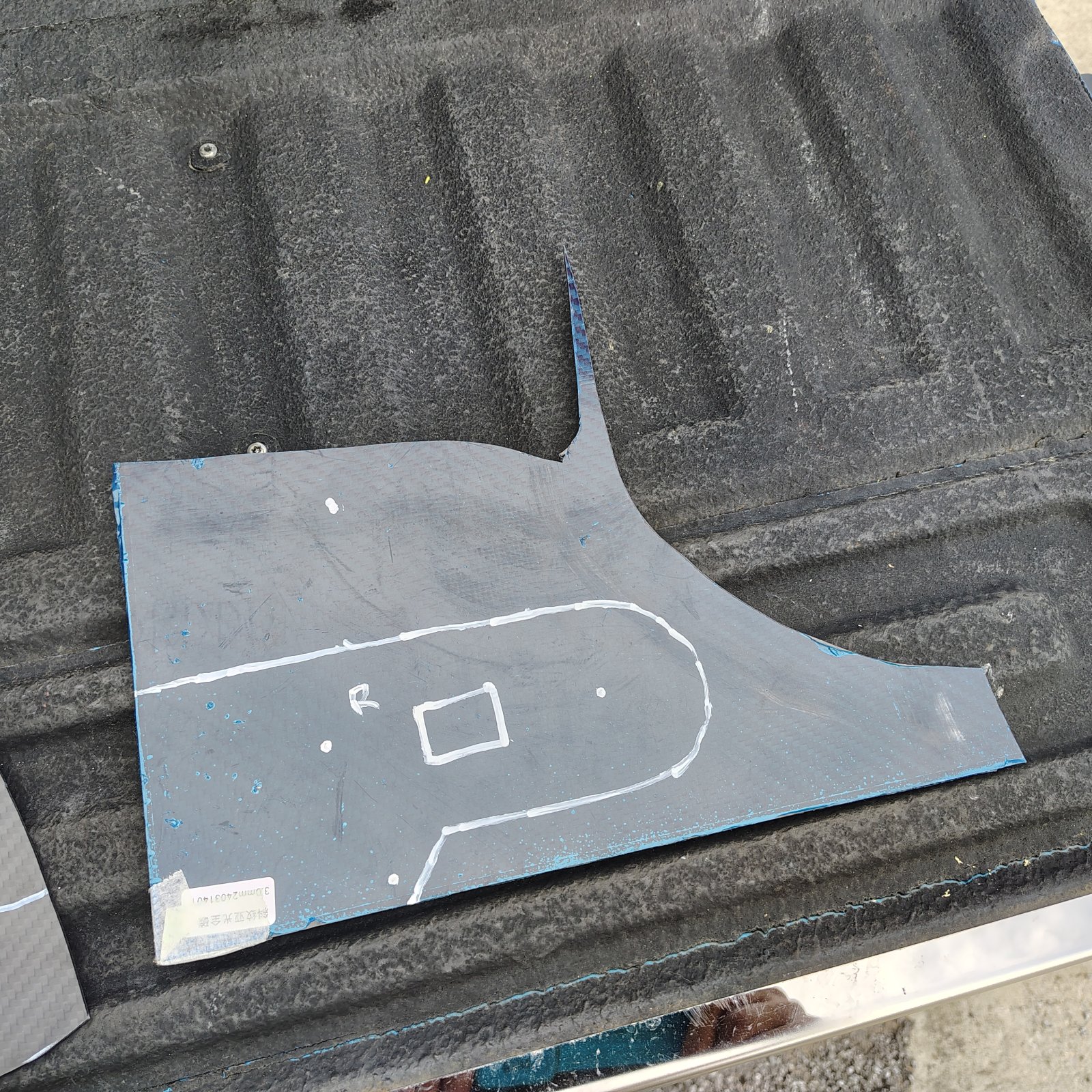

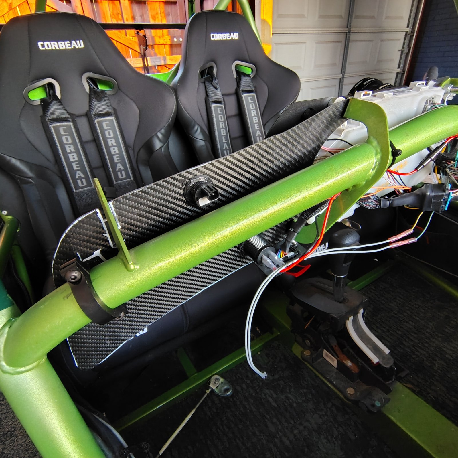

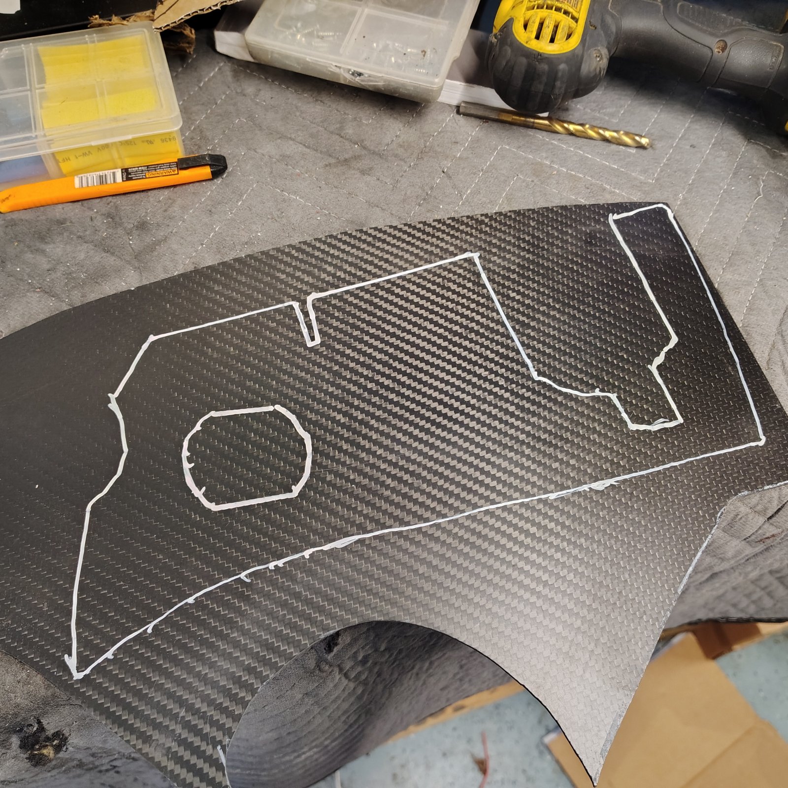

I decided to order some more Carbon Fiber sheets, to "build" a dash. It was a huge learning curve and I wasn't happy with it... I removed it, only to redesign it later. Here's the first version:
52857
52858
52859
52862
52860
52861
52863
52864
52865
52866

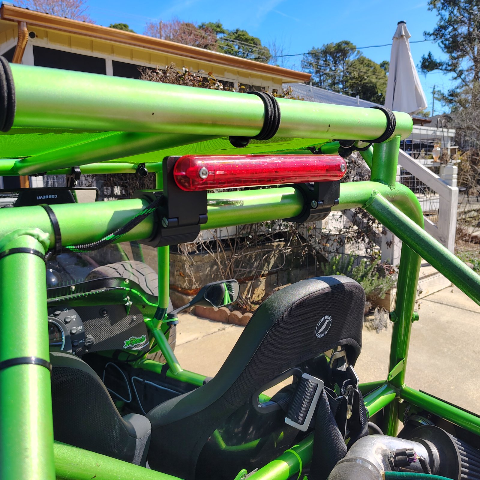

I also added a 3rd Brake Light, with some Amazon mounting clamps.
52867

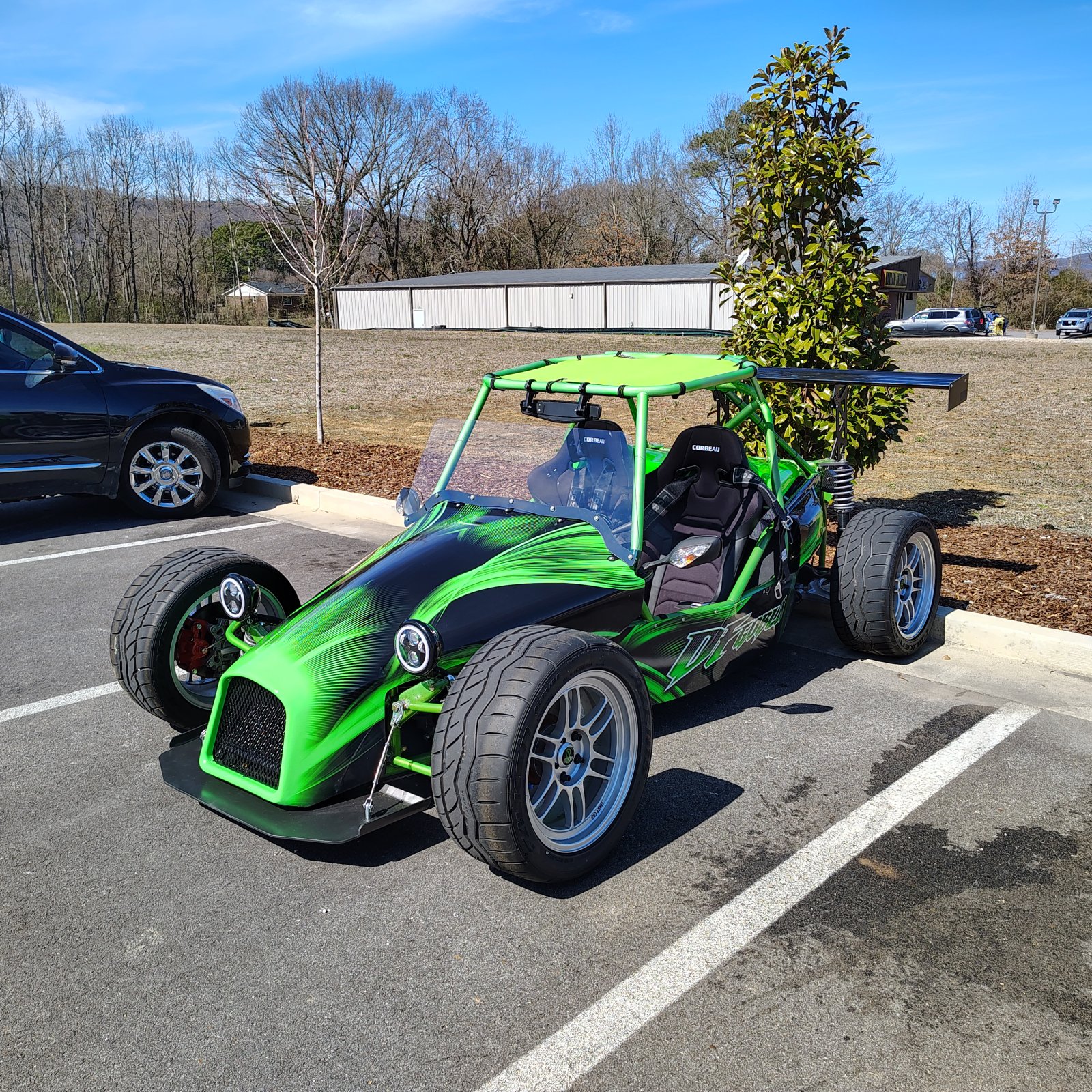

March 1, 2025. After Cars & Coffee. It felt awesome all day and I think this was the 5th time I had driven the Goblin. I thought I was done with it in this pic, but I was definitely wrong... I also thought it was sold in this pic, but the guy never called me back... :confused:
52868

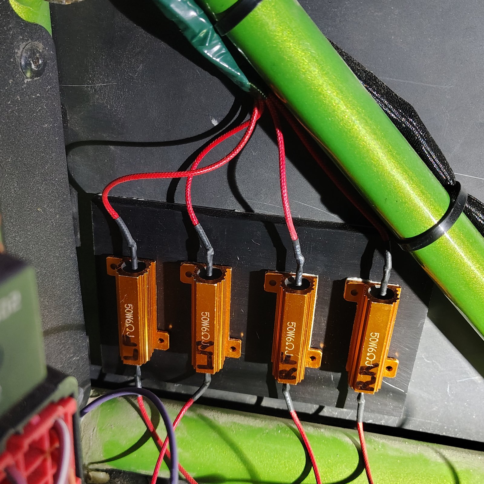

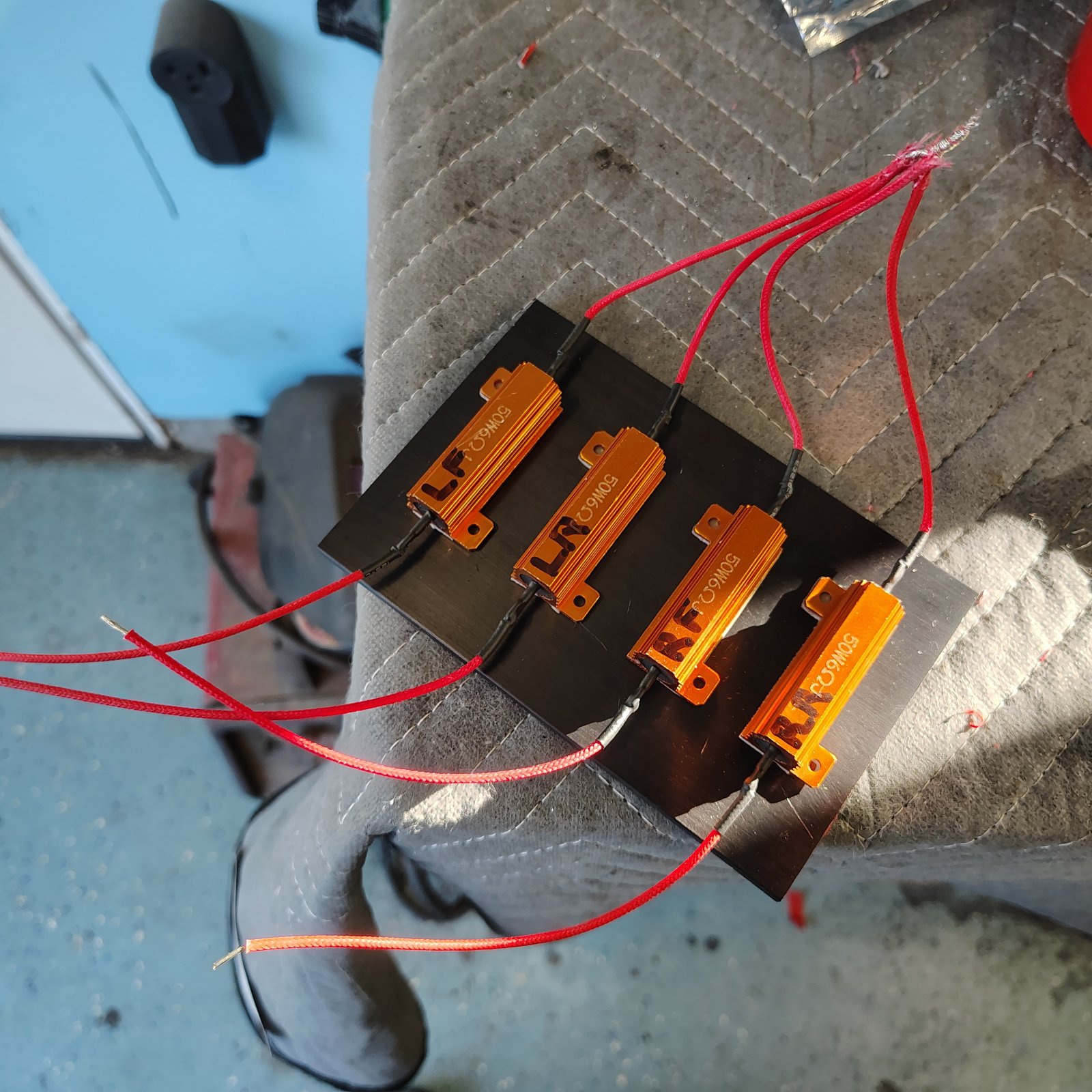

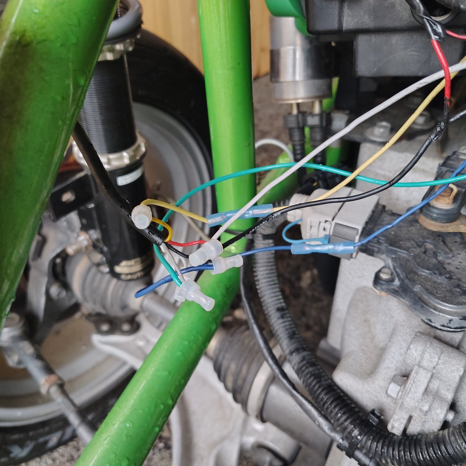

I also got rid of the hyper-flashing turn signals! I completed it the same way one of the members on this forum did his, sorry, I forgot who it was...? I'll try to look for them tomorrow?
52871
52872
52873

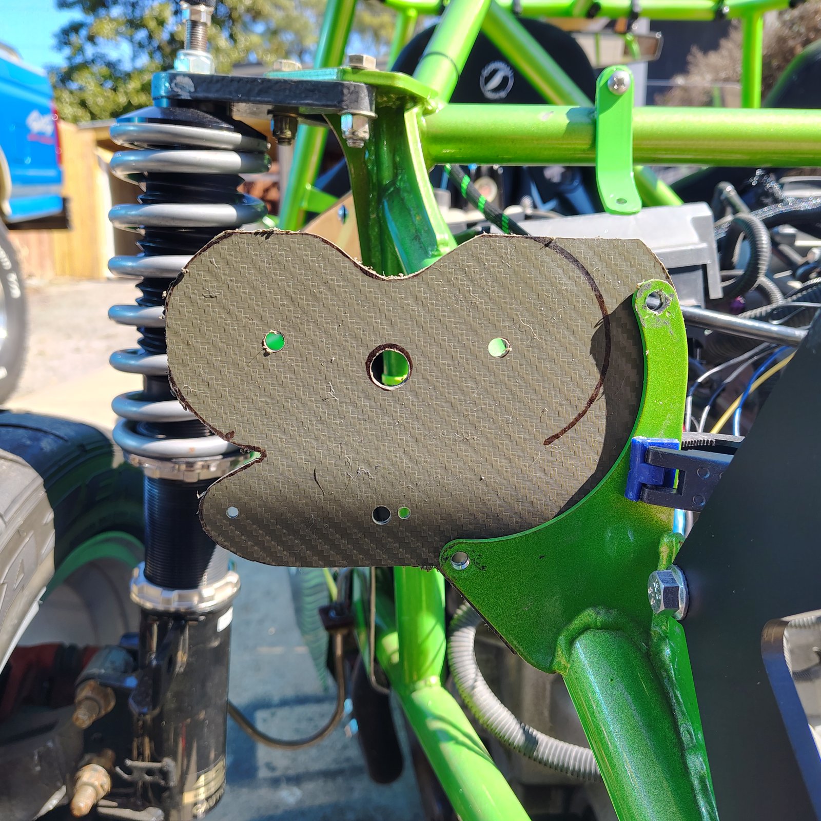

Made a slight modification to the rear hoods

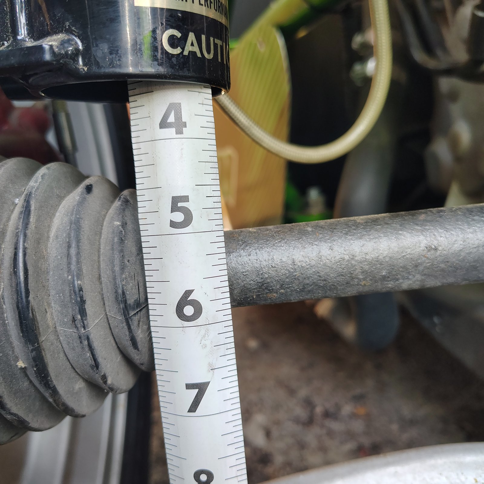

Installing DF Steering Rack Limiters, as my new tires/wheels were making small contact with the front control arms...
52876

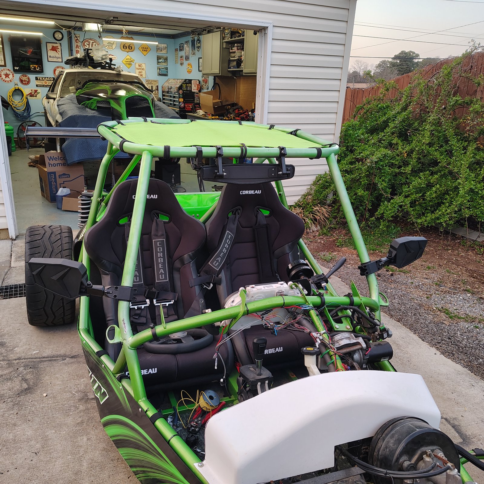

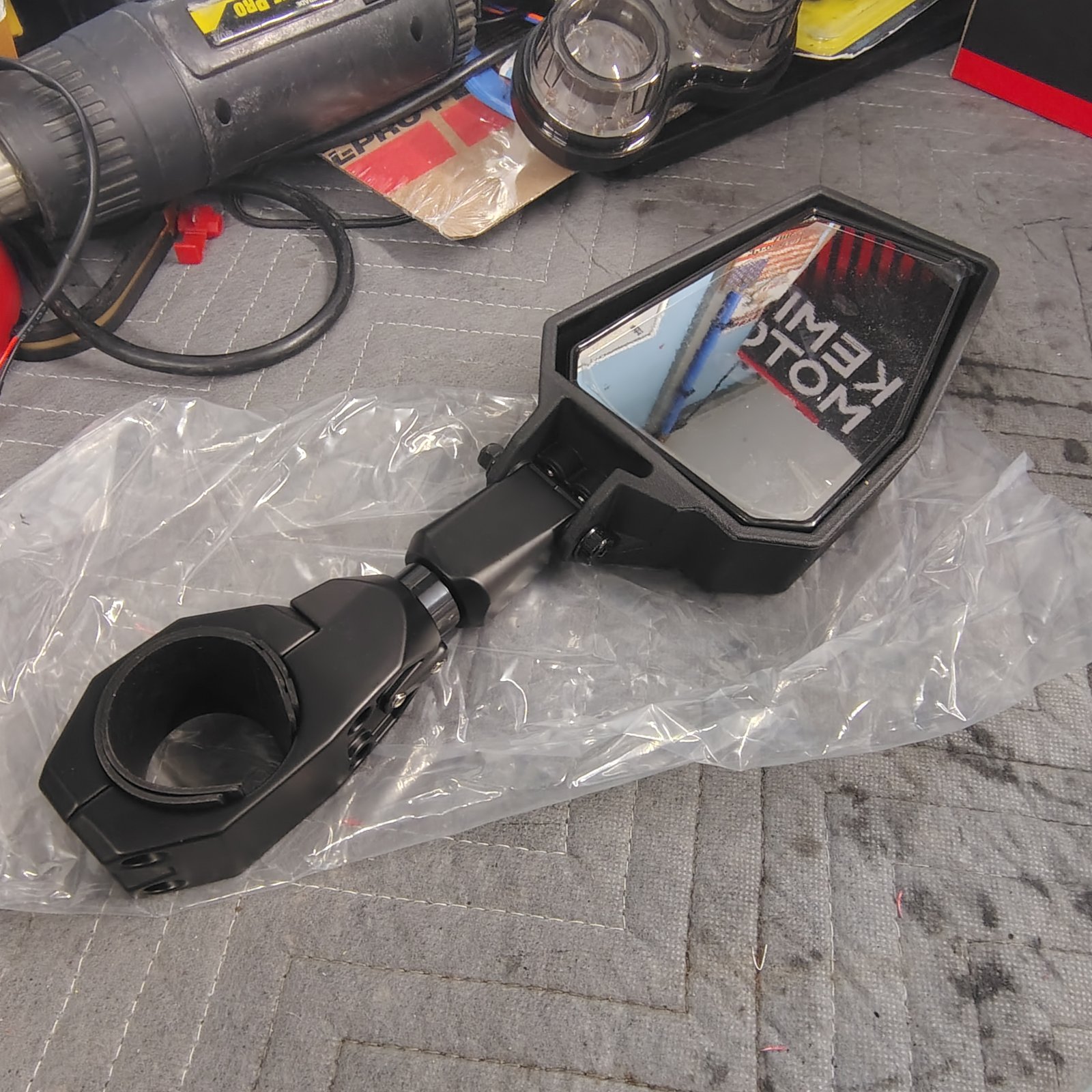

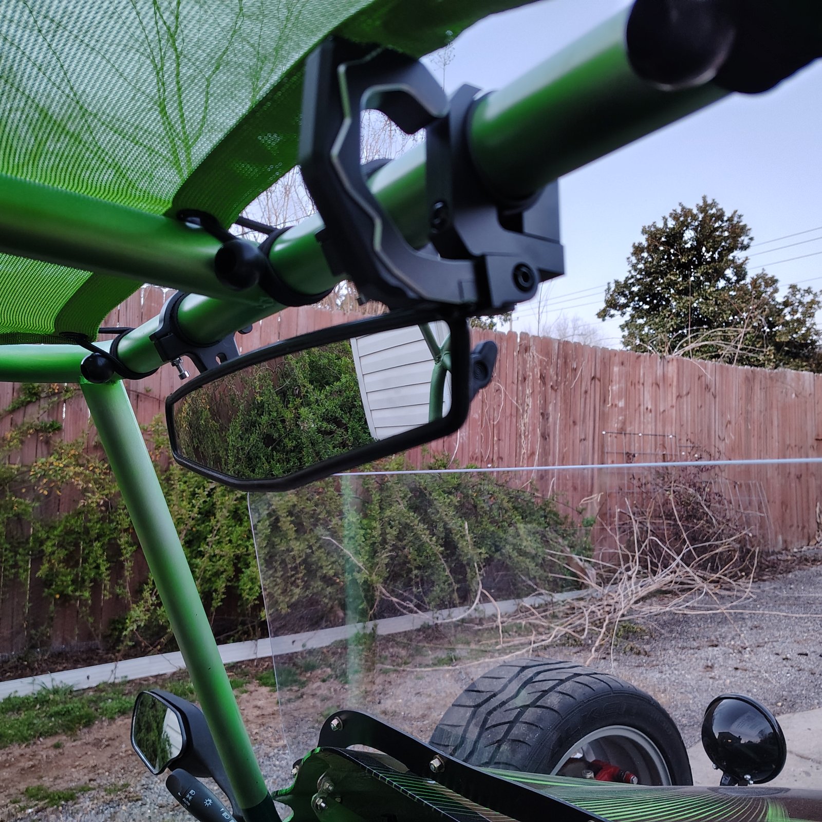

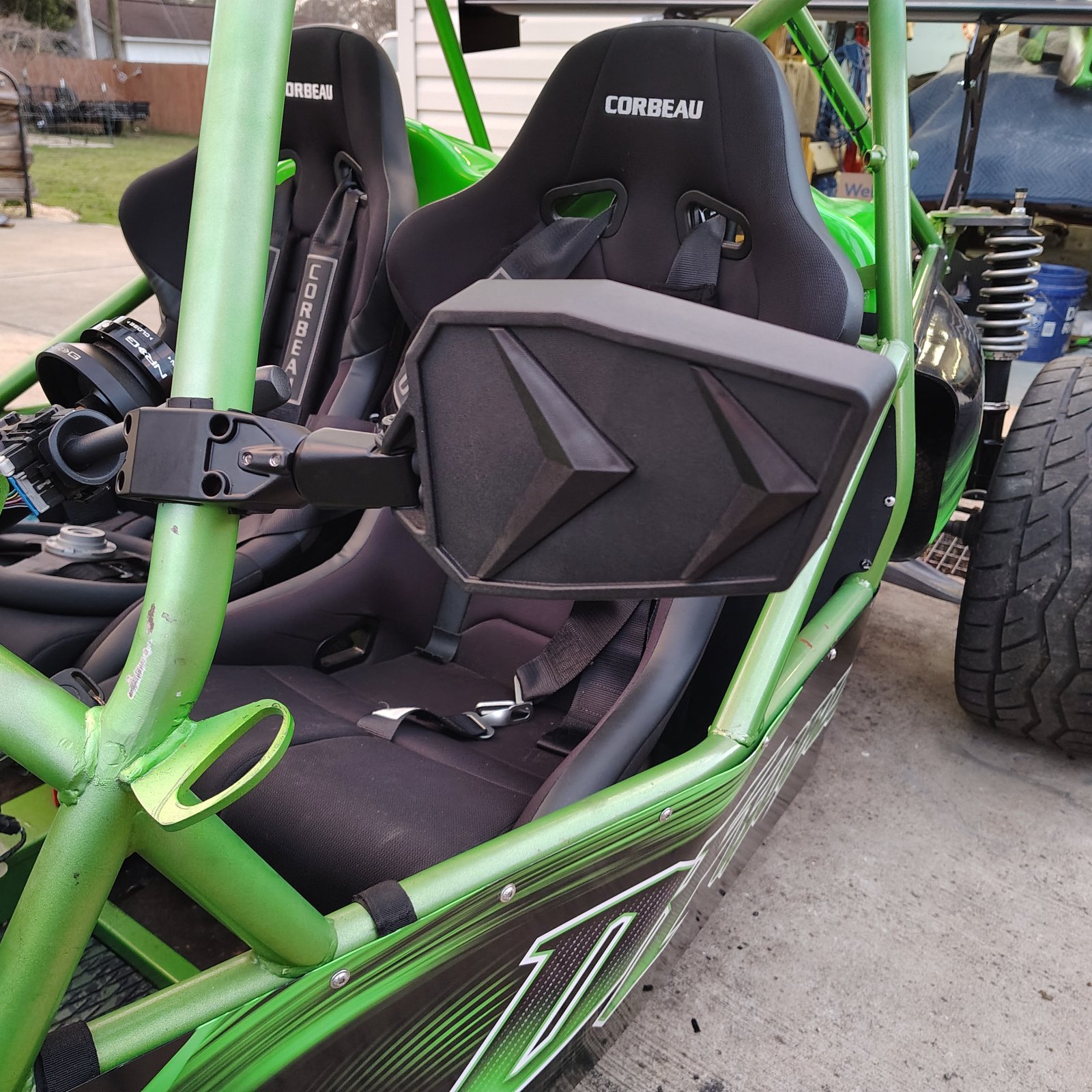

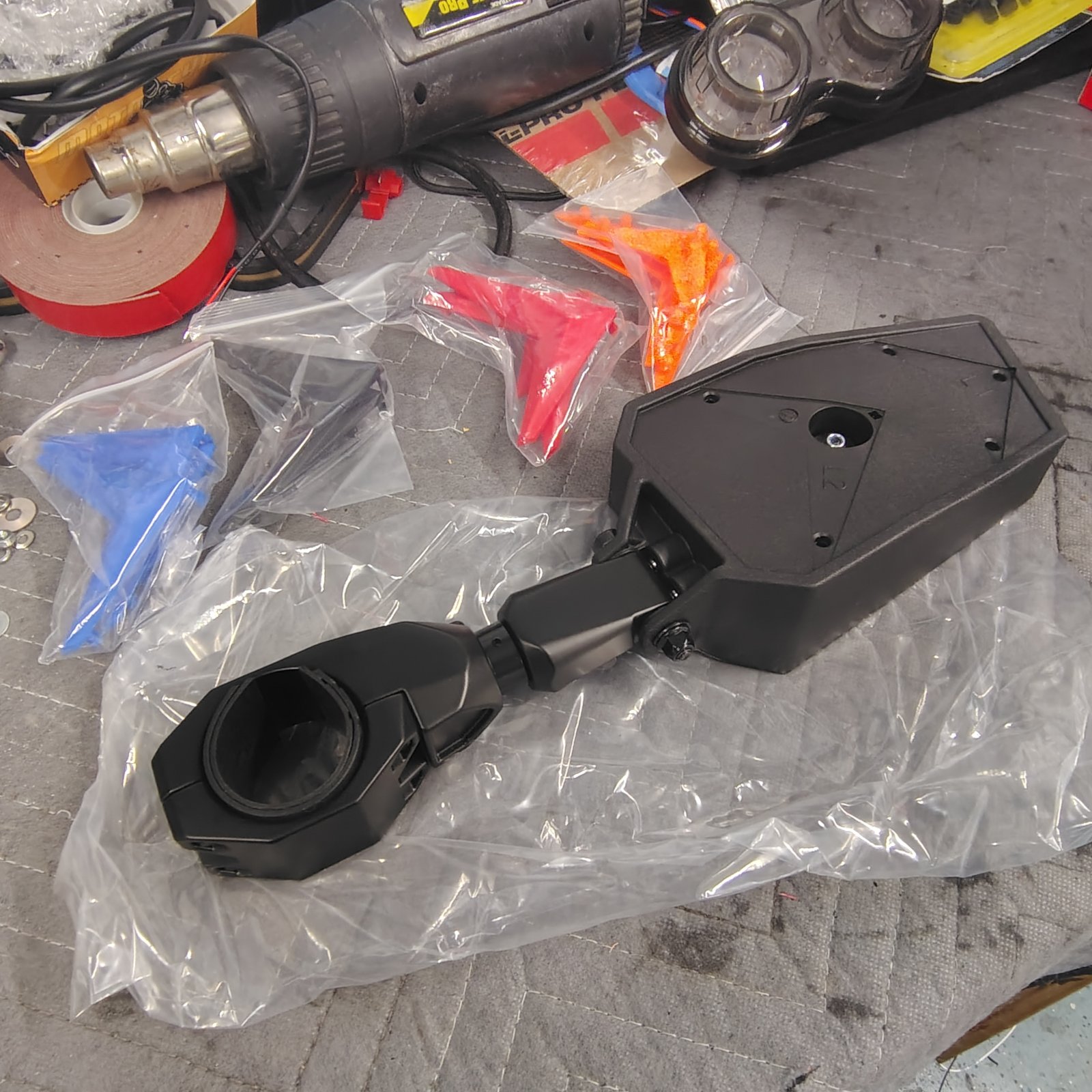

New Roll Bar Mounted UTV Side Mirrors installed, from Amazon! These are super nicer than those CBR mirrors!
52879
52880
52881
52882

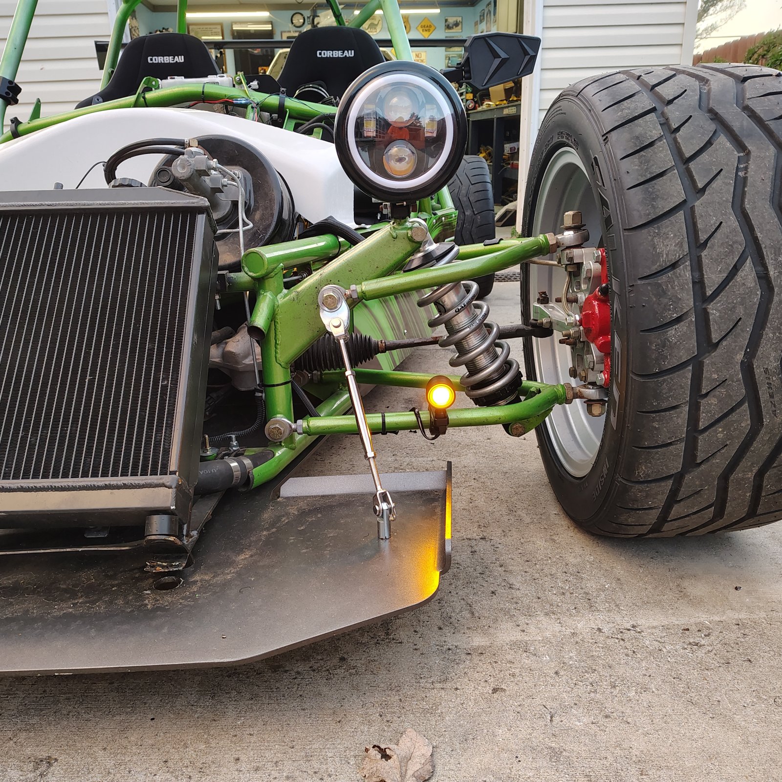

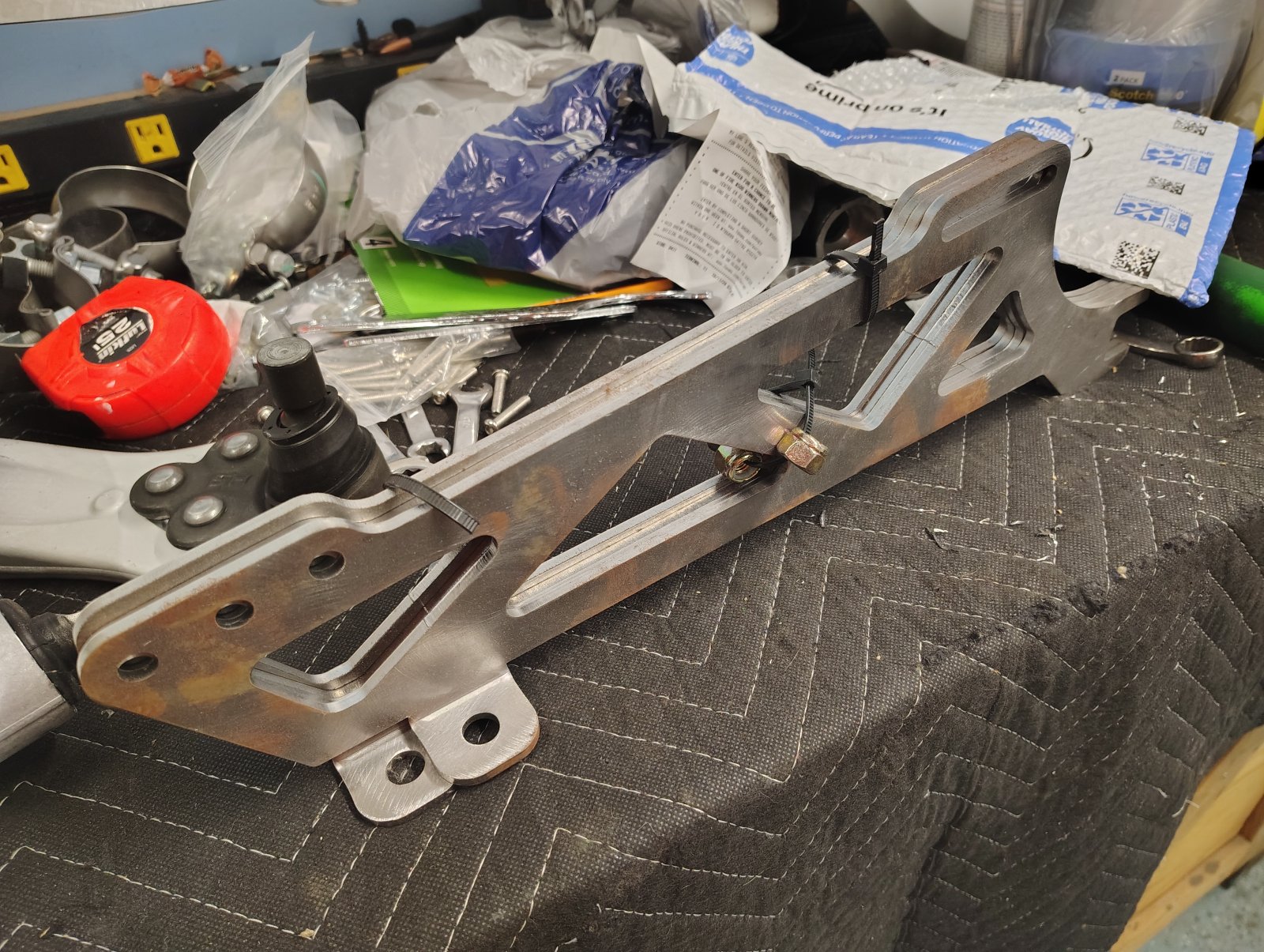

Installed my custom built adjustable splitter support arms
52884

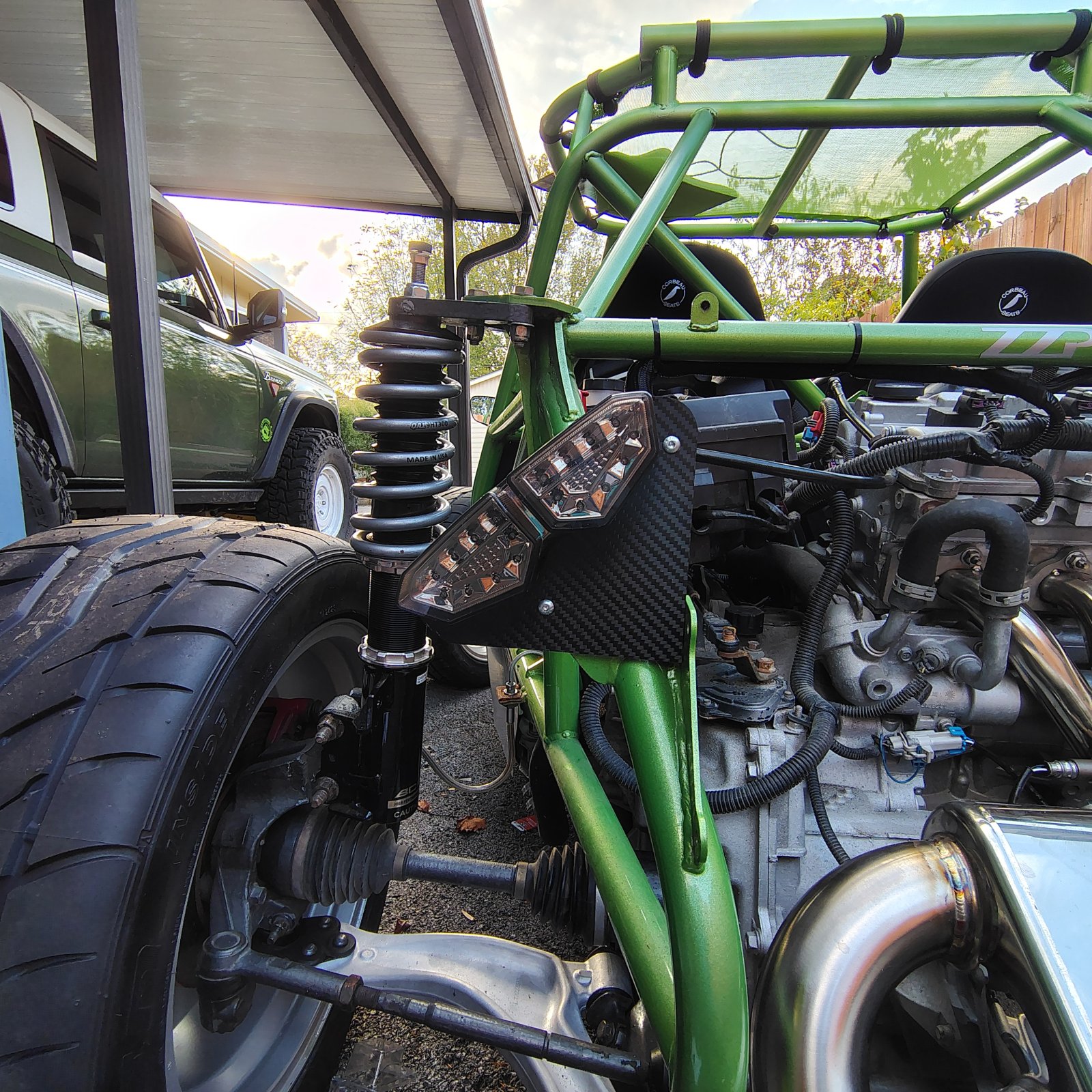

Small bullet style LED running lights installed on front lower control arms. My blinkers are in the halos of the head lights.
52883

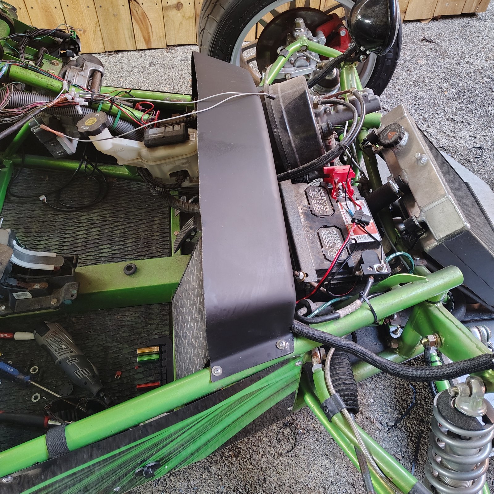

I upgraded the negative terminal, so I could install things easier on it. The OEM positive side can already do this, but I have a new terminal for it, if I ever want to change it out too?
52896
I also installed a trickle charger weatherproof plug into the side panel and wired to the battery.

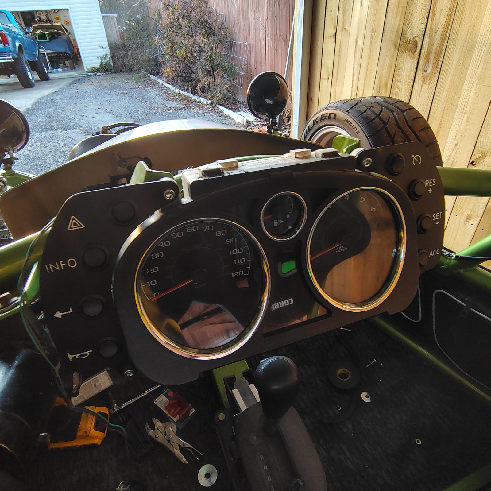

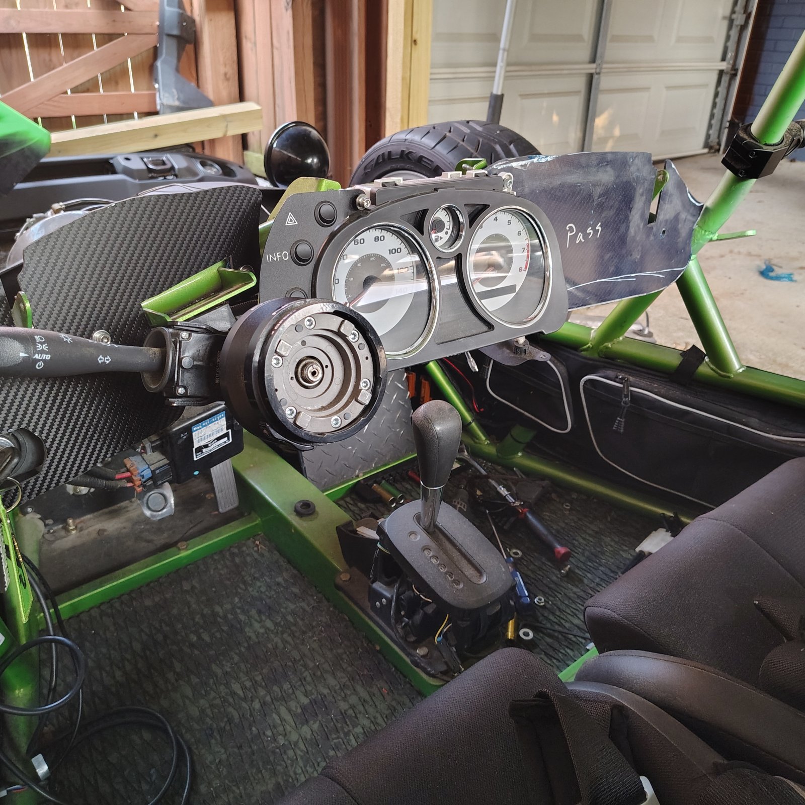

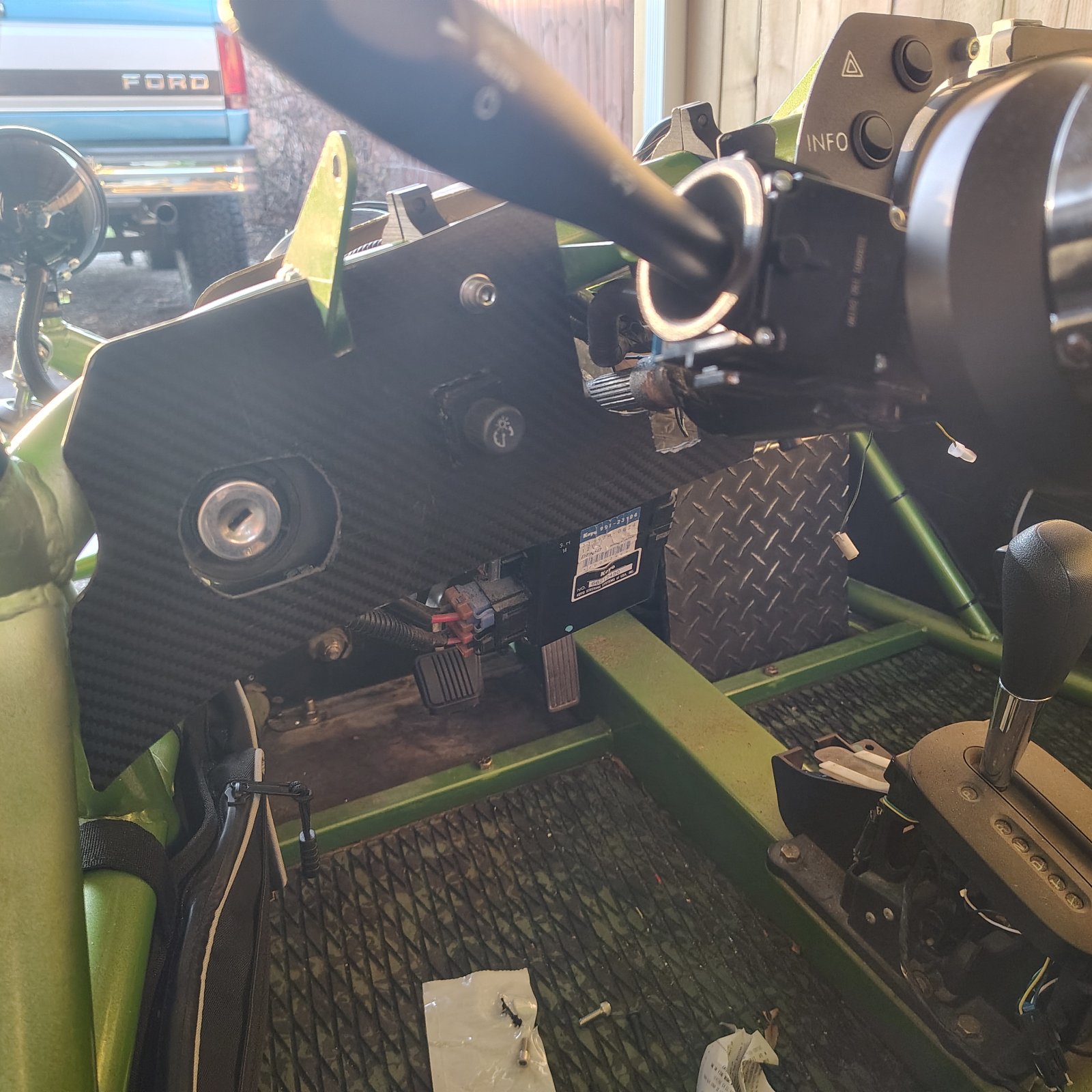

Also, during this time, I redesigned my Carbon Fiber dash (2nd version) and installed it. I installed a BOSS Marine Radio with rope antenna and some Rockville 6.5" Tower Speaker Pods under the front hood! I also installed a white faced SS 140mph cluster.
52889
52890
52892
52894

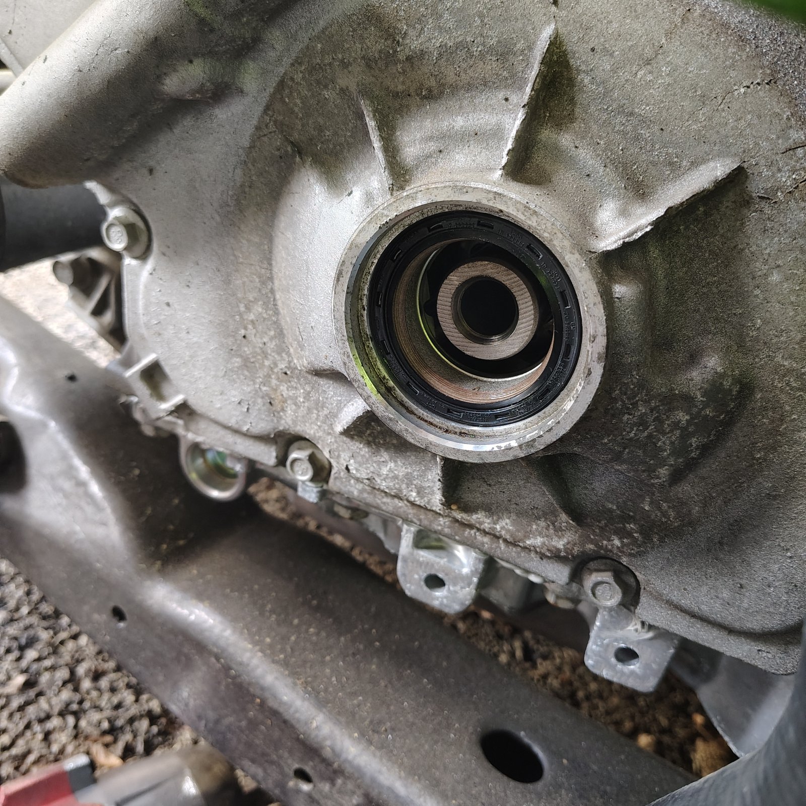

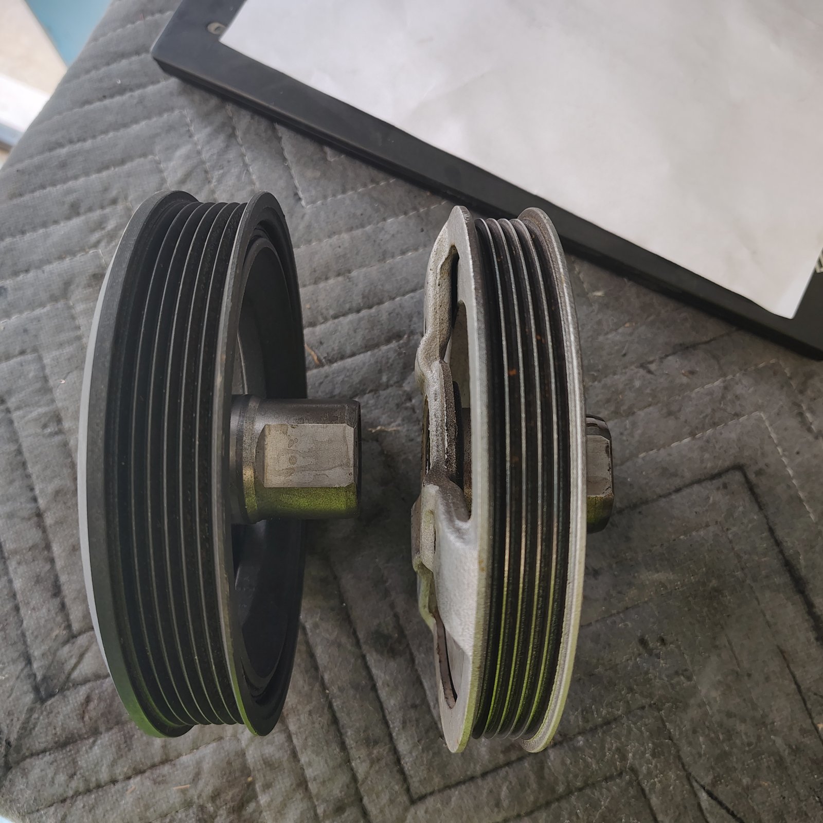

I replaced the crank pulley seal and installed a new 6 ribbed LSJ crank balancer.
52901
52902

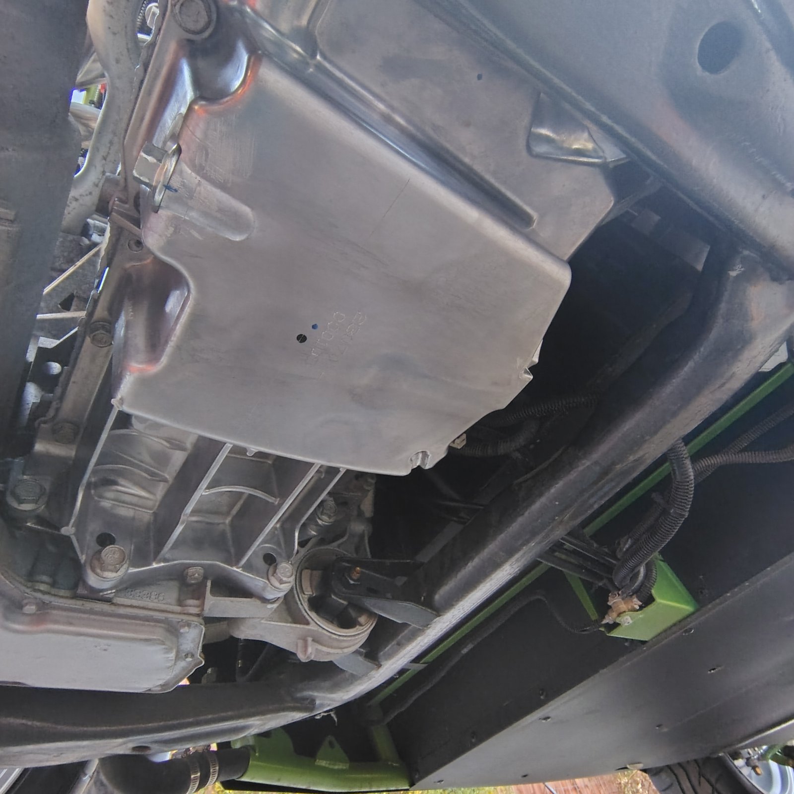

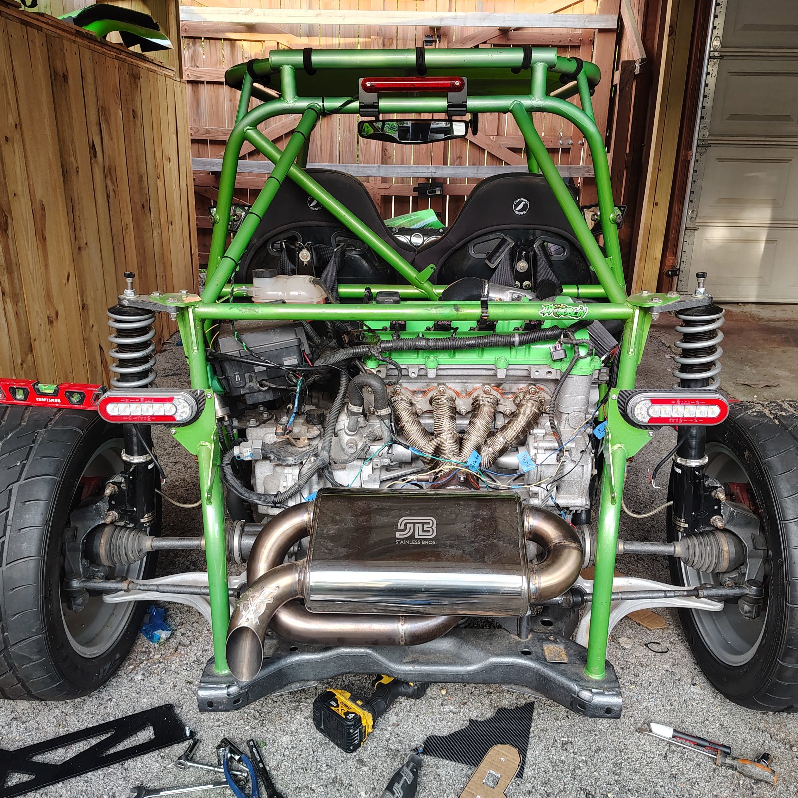

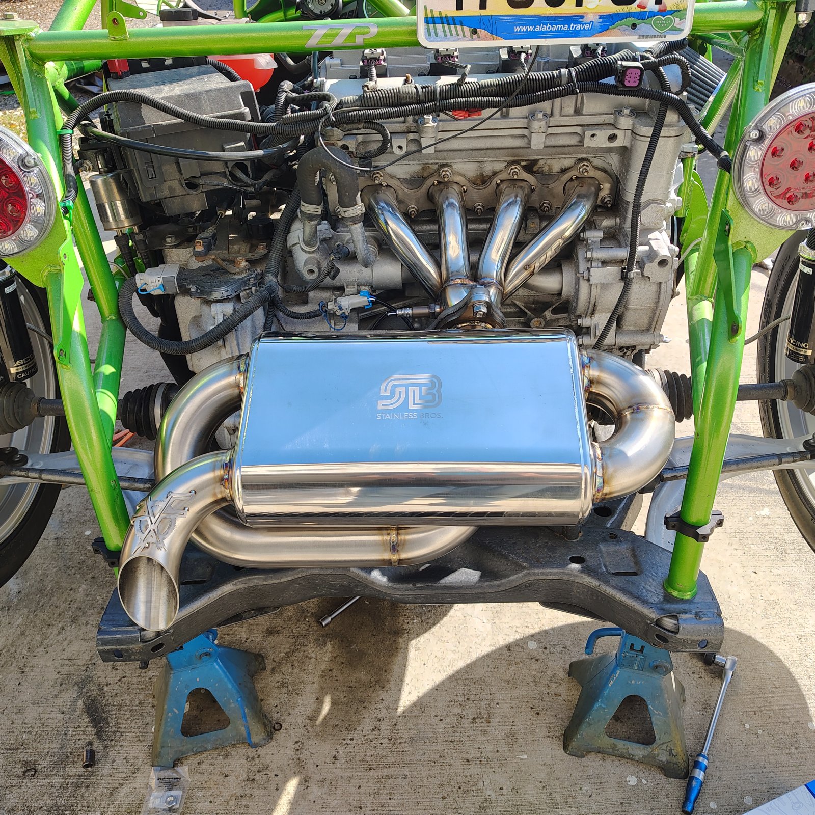

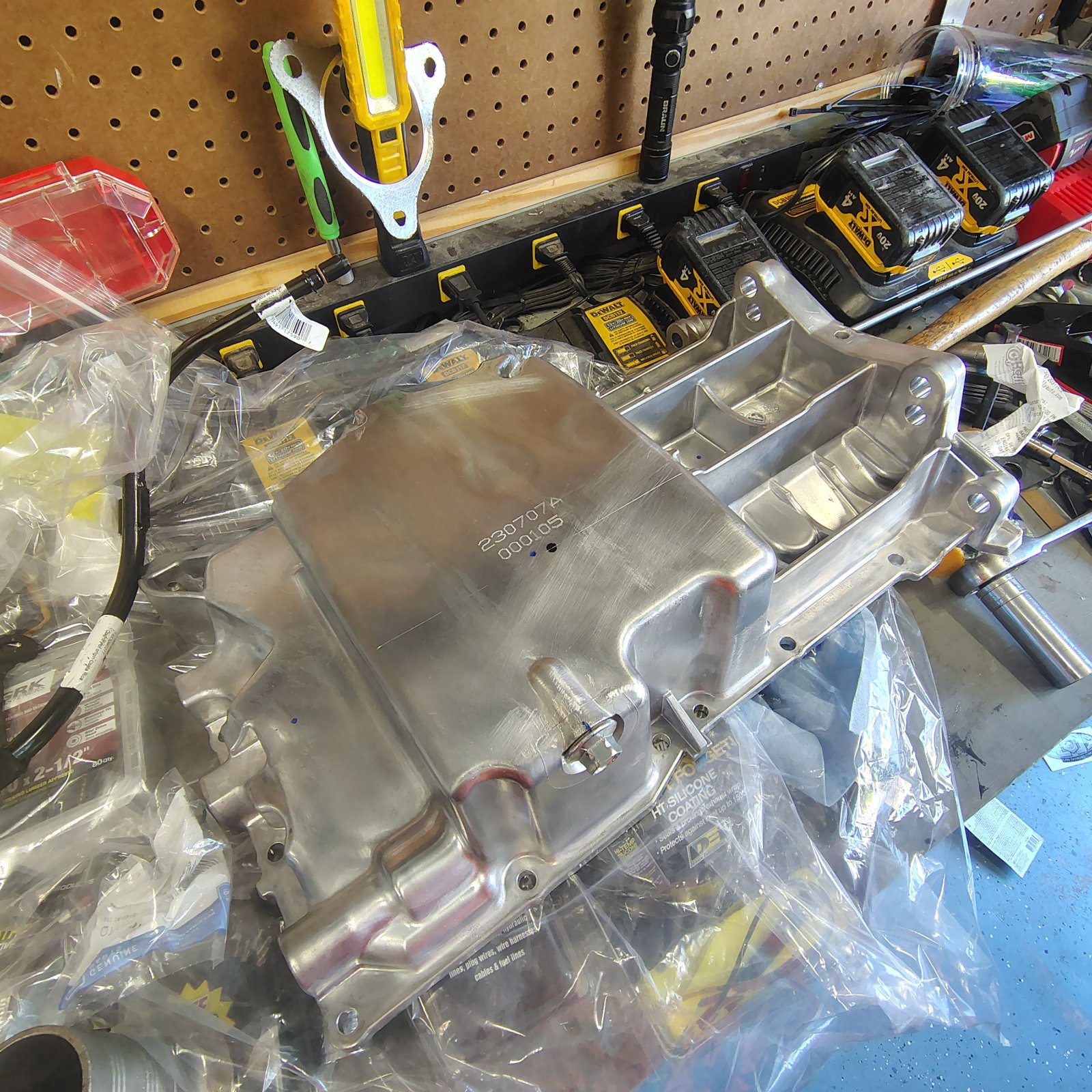

I pulled the muffler off, to install an extra O2 bung. While it was removed, I pulled the header, cleaned it and wrapped it with Titanium Exhaust Wrap. I also used some Orange Exhaust RTV sealer along with the gaskets.
52911
52912
52913

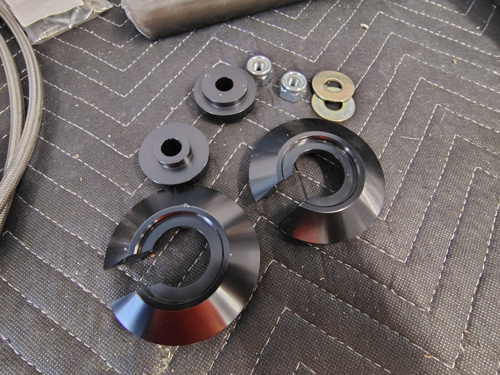

I also readjusted my rear coilovers. I honestly didn't know how to do it properly the first time... It's done correctly this time and rides much nicer now! There's just a tiny amount of preload on all 4 corner springs now and it handles great!
52914
52915

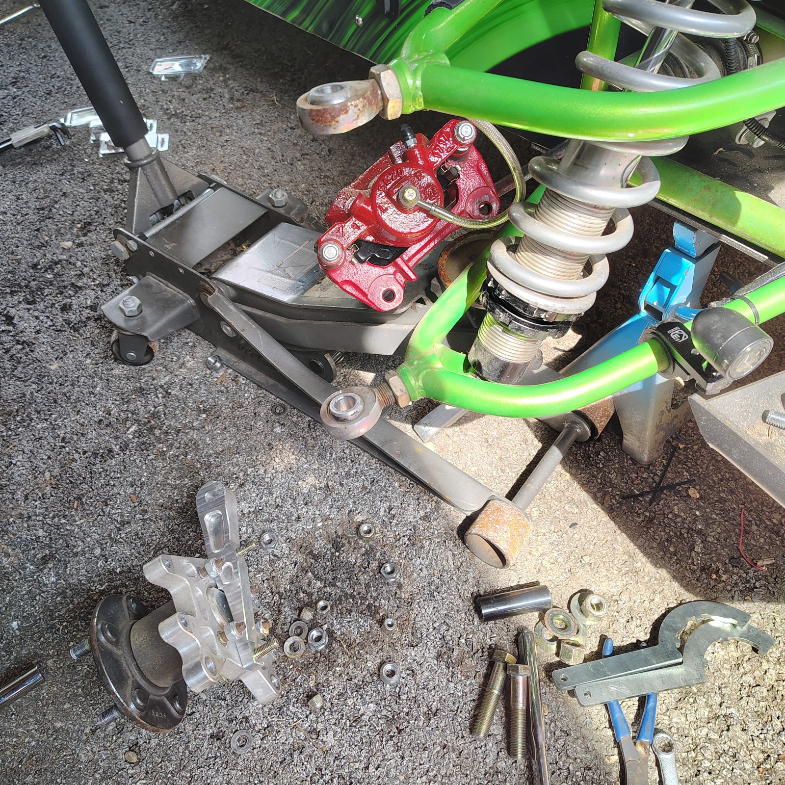

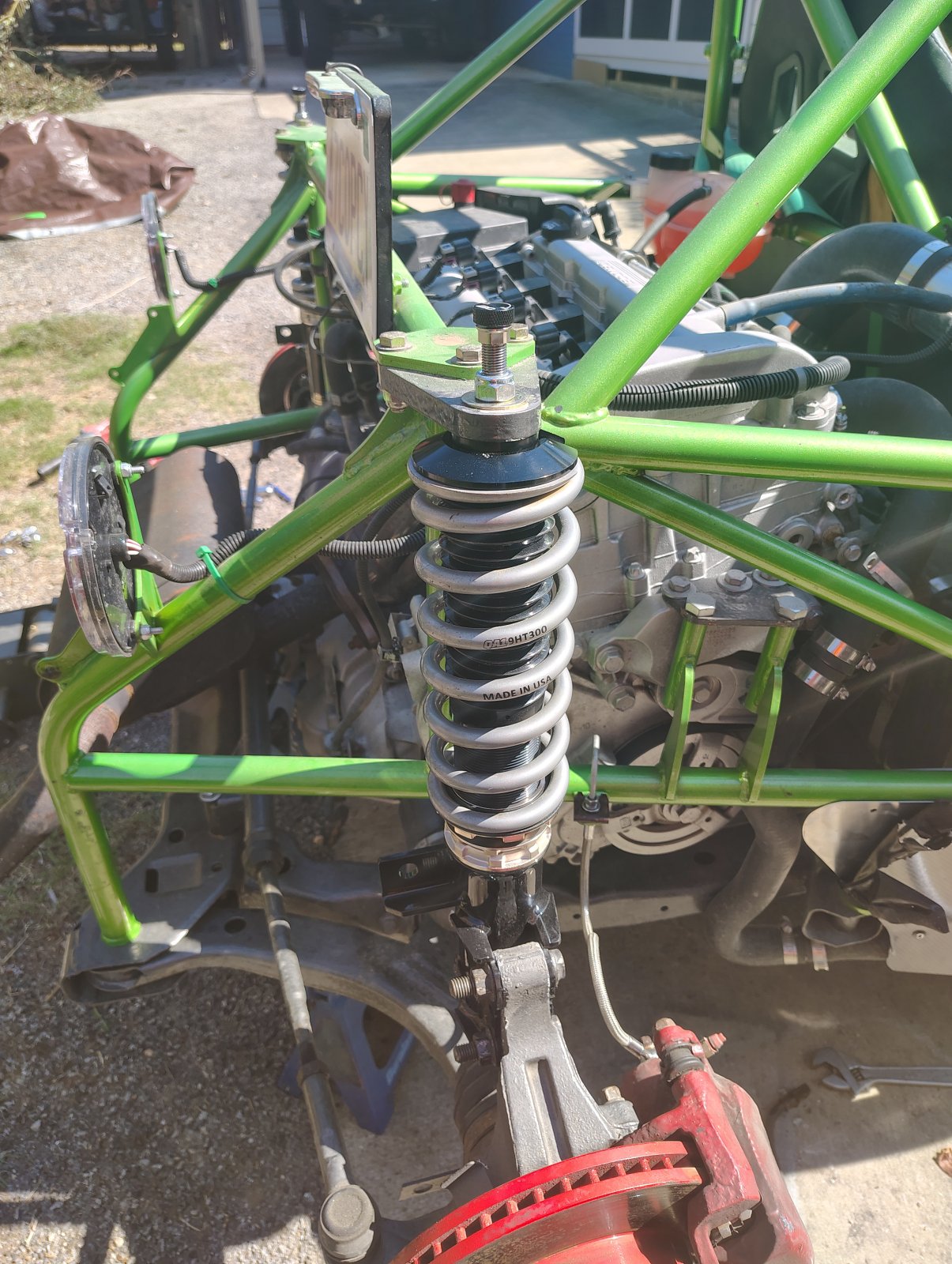

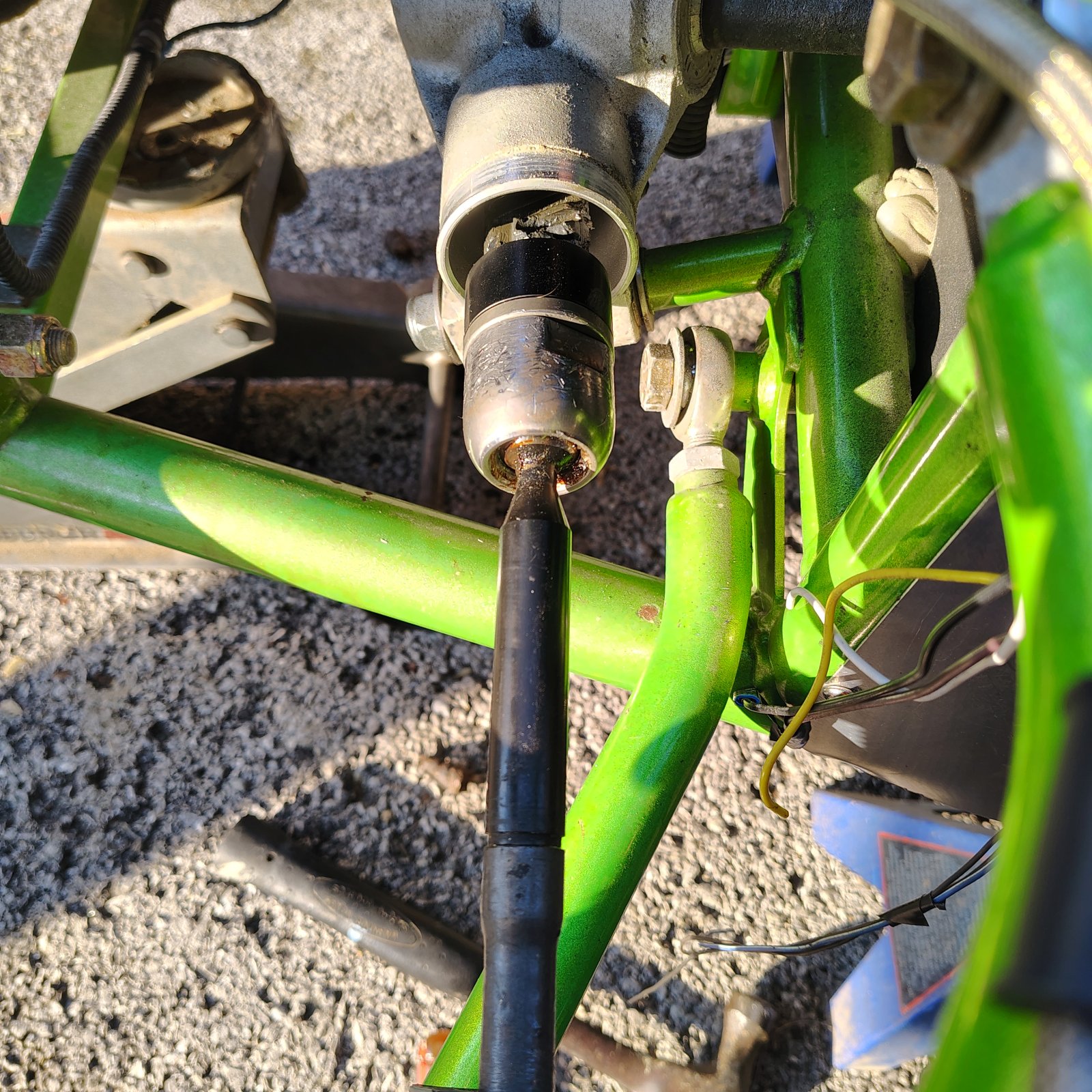

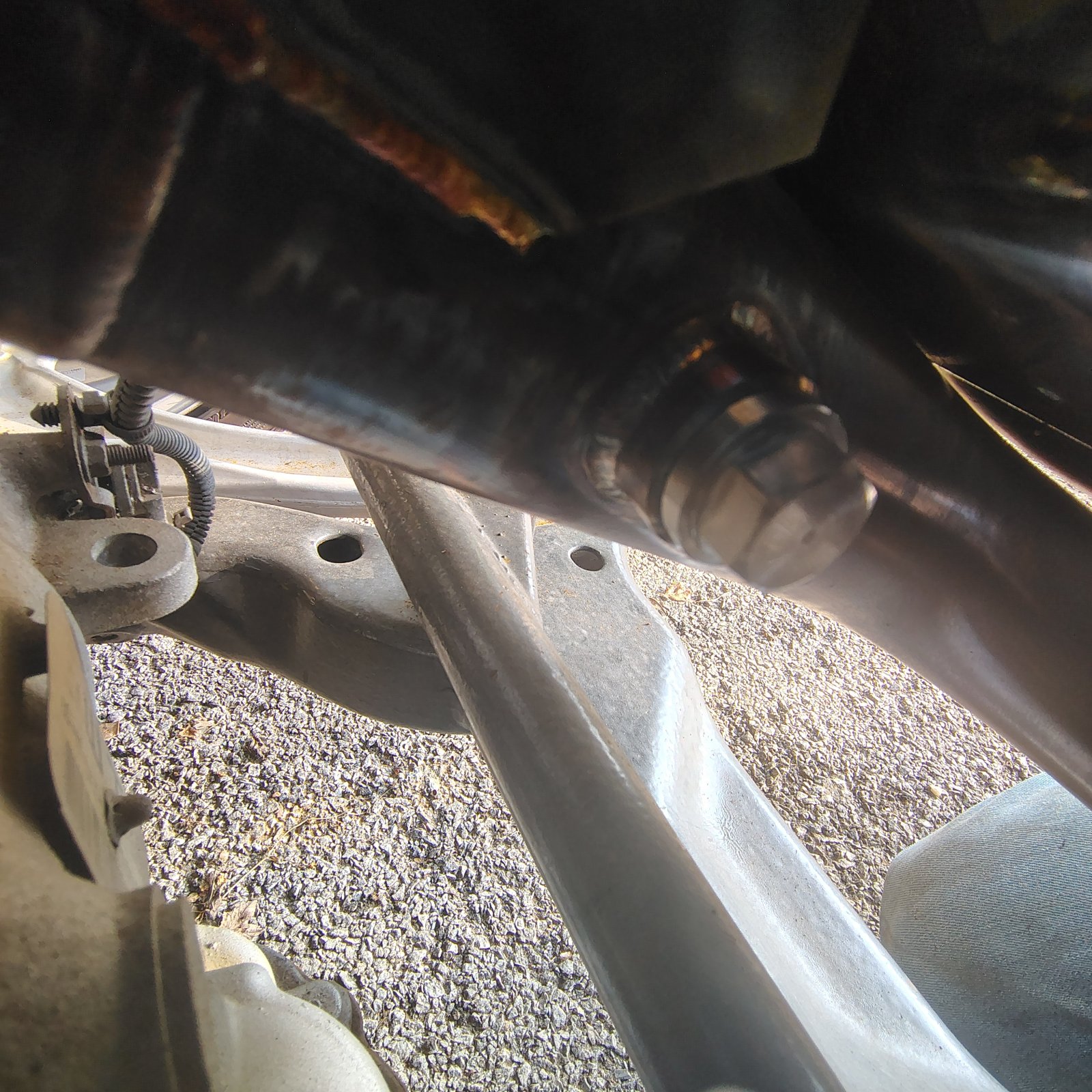

I also finally upgraded the front steering parts and readjusted the front coilovers as well!
52916
52917
52918
Mirage775

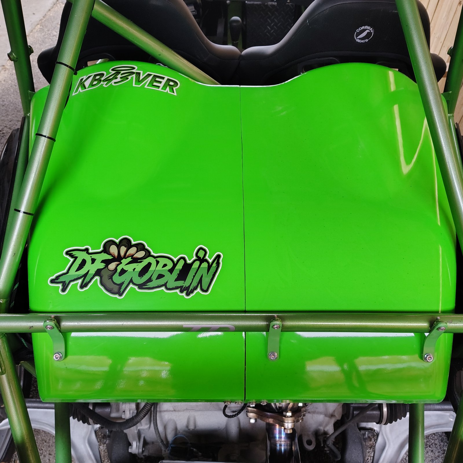

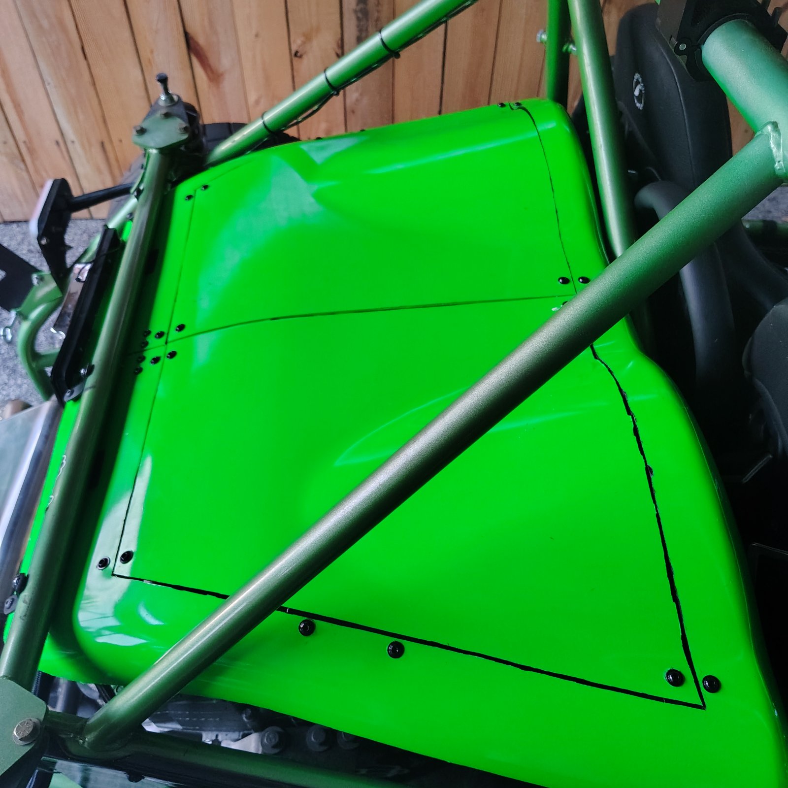

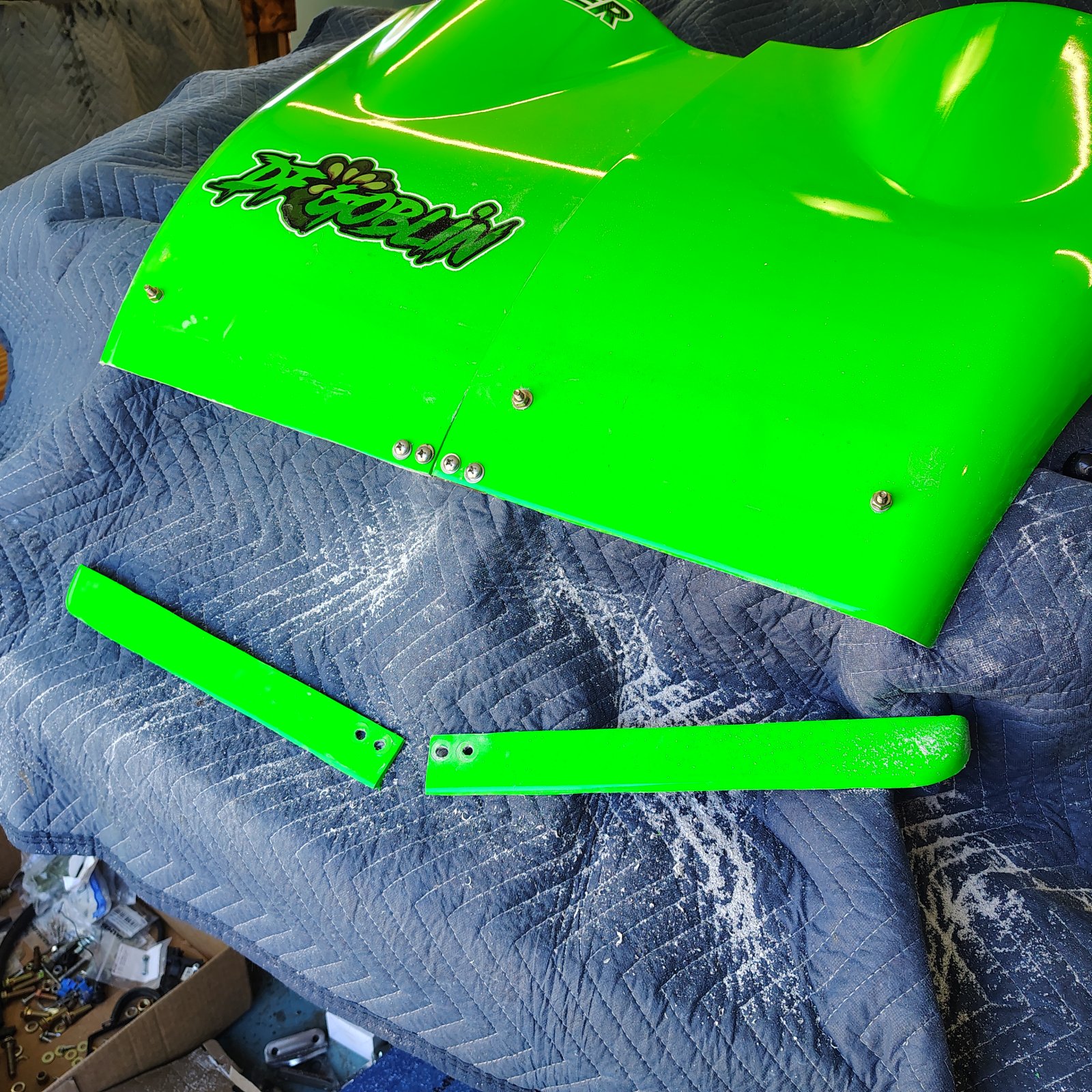

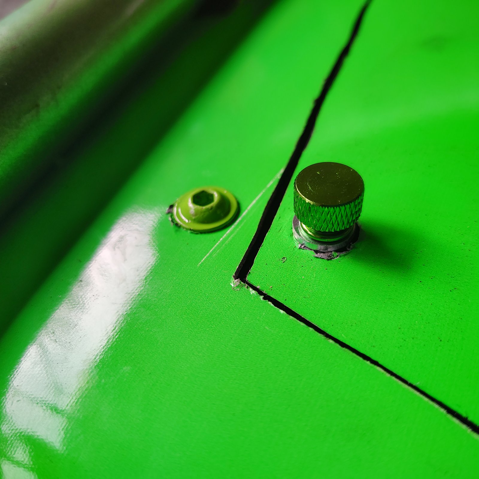

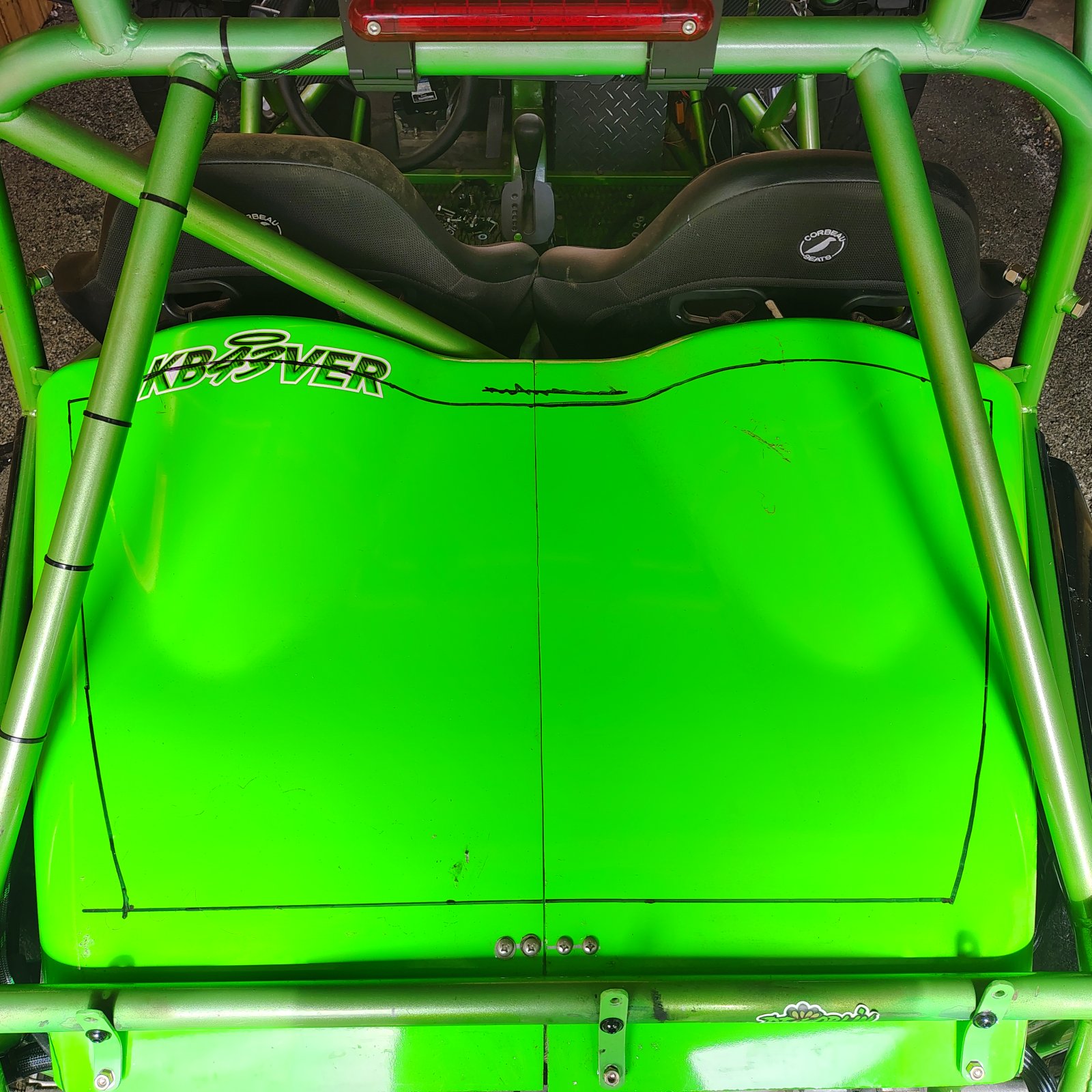

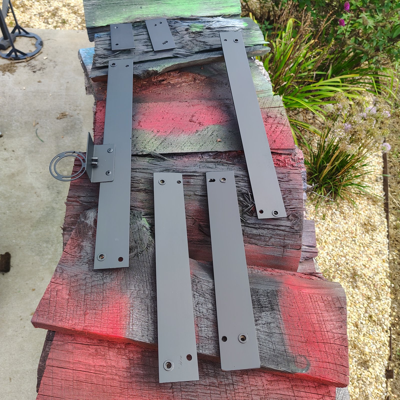

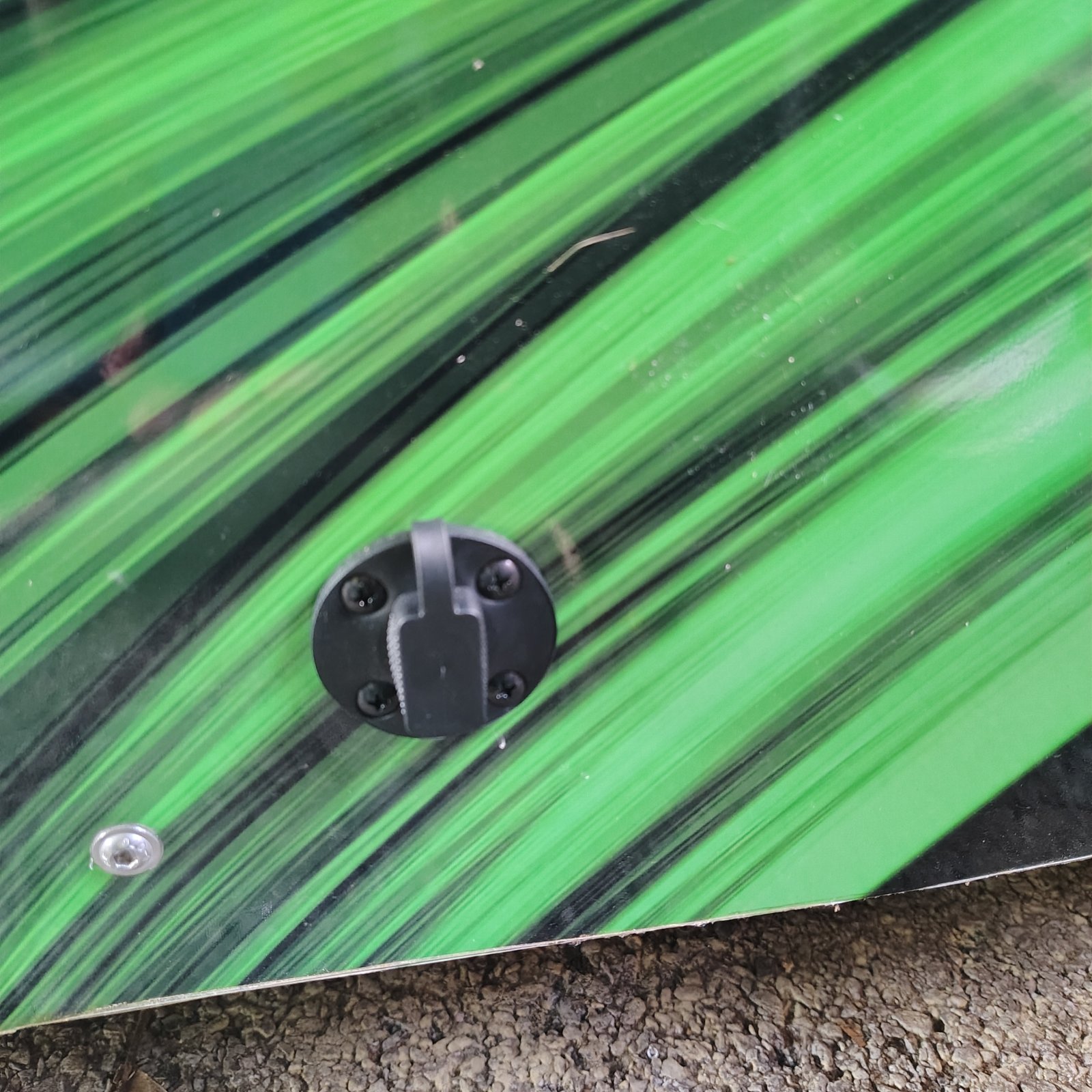

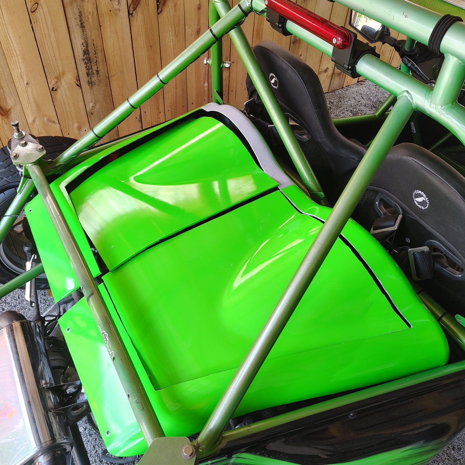

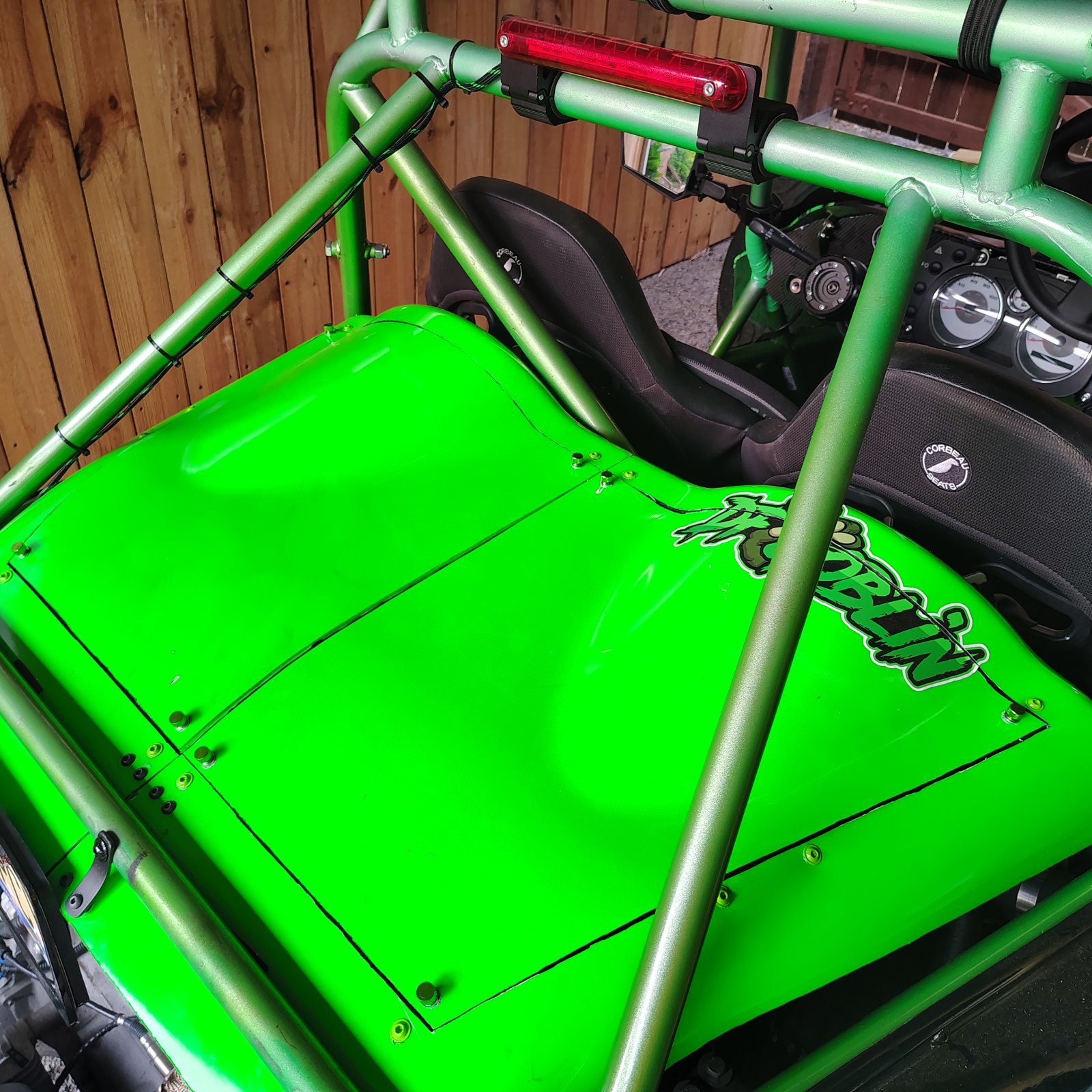

I liked what Josh did with his quick release rear hood panels and I wanted to do something similar. I don't like to use fiberglass, like he did with his hoods, even though it looked amazing! I did something much different, but with the same (more or less) affect!
I eye balled this and used a sharpie on it. I then used a diamond tip cutoff wheel on my angle grinder and cut them out!
52921
52922
52923
I used some 1/8" thick aluminum flat bar stock and bolted it to the outer hood pieces. I then drilled through the detachable hood pieces and used M6 Rivnuts. I used enamel Black paint and a brush to paint the alloy pieces, but changed that today!
52925
52928
52929
52930
After doing this, we drove to a random car show, (wife's first ride in it!), didn't enter, just took a pic of it in the shade:
52937

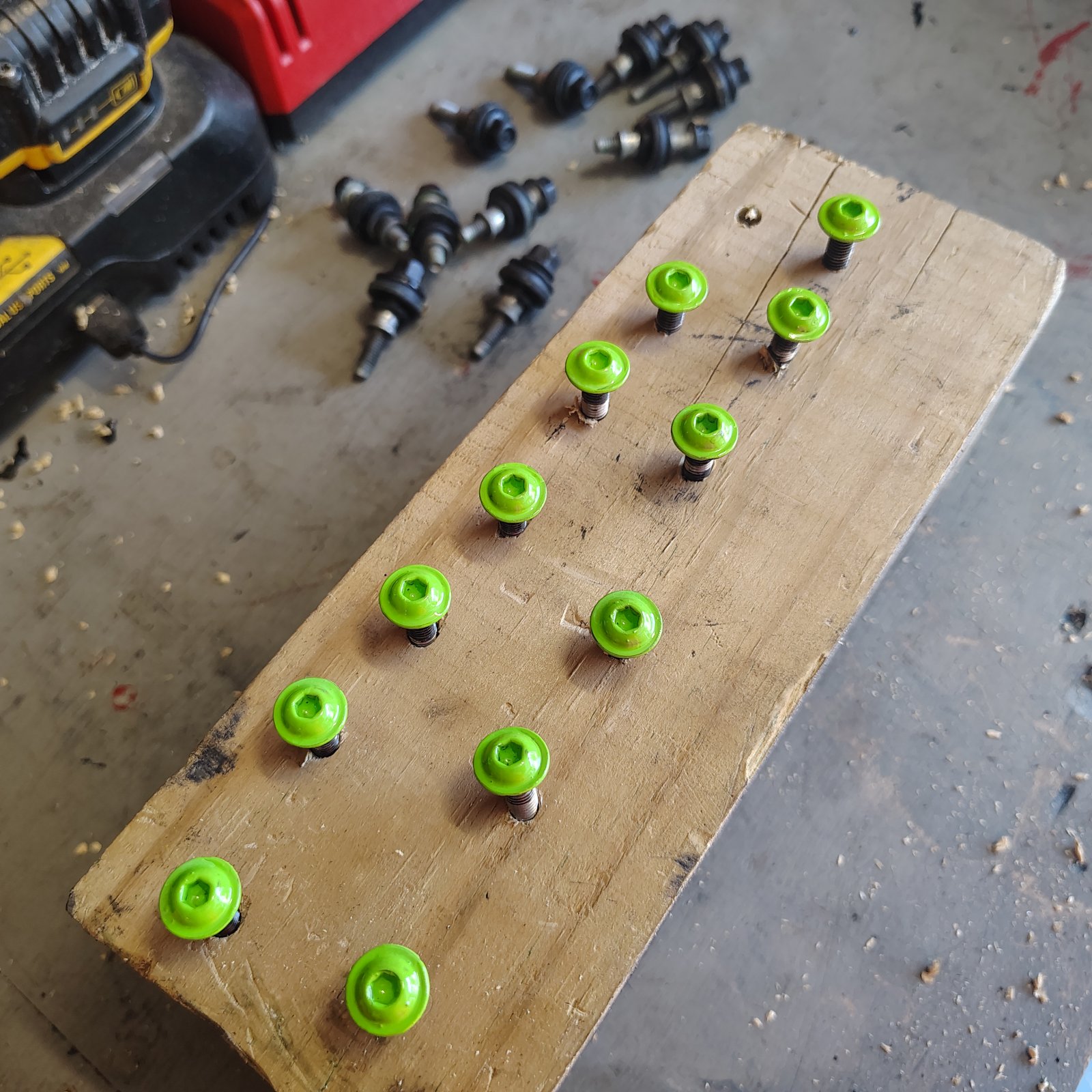

After the car show, I didn't like how there were so many Black Allen head bolts on the rear hoods, so I ordered some Green M6 thumb screws and used some Testors Lime Green paint for the hood bolts to blend them in a little better! I removed the alloy pieces and sanded them this time and sprayed them Flat Black. I used the thumb screws for my "quick releases". I still have some work to do on these hoods though.
52931
52932
52933
52934
52935
52936

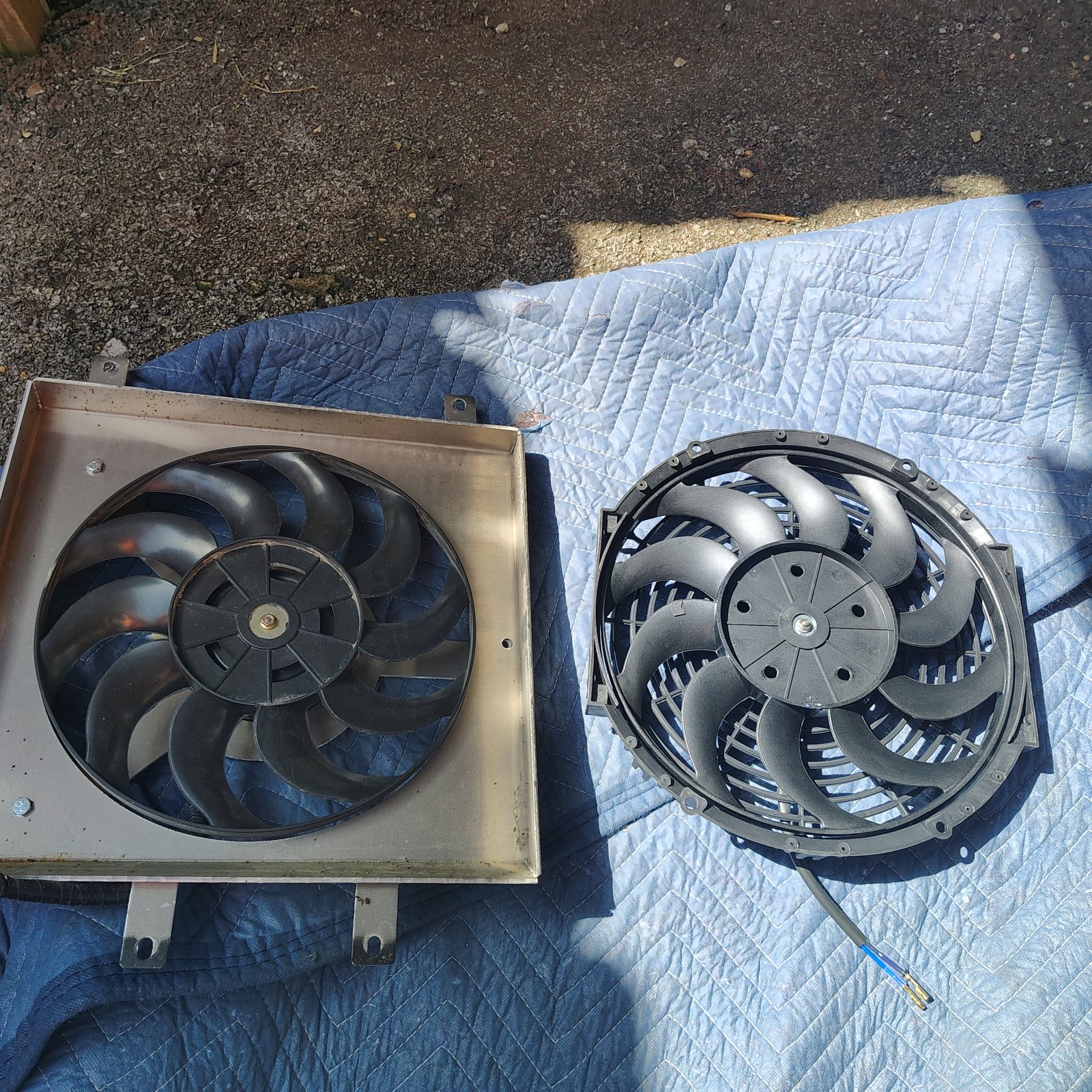

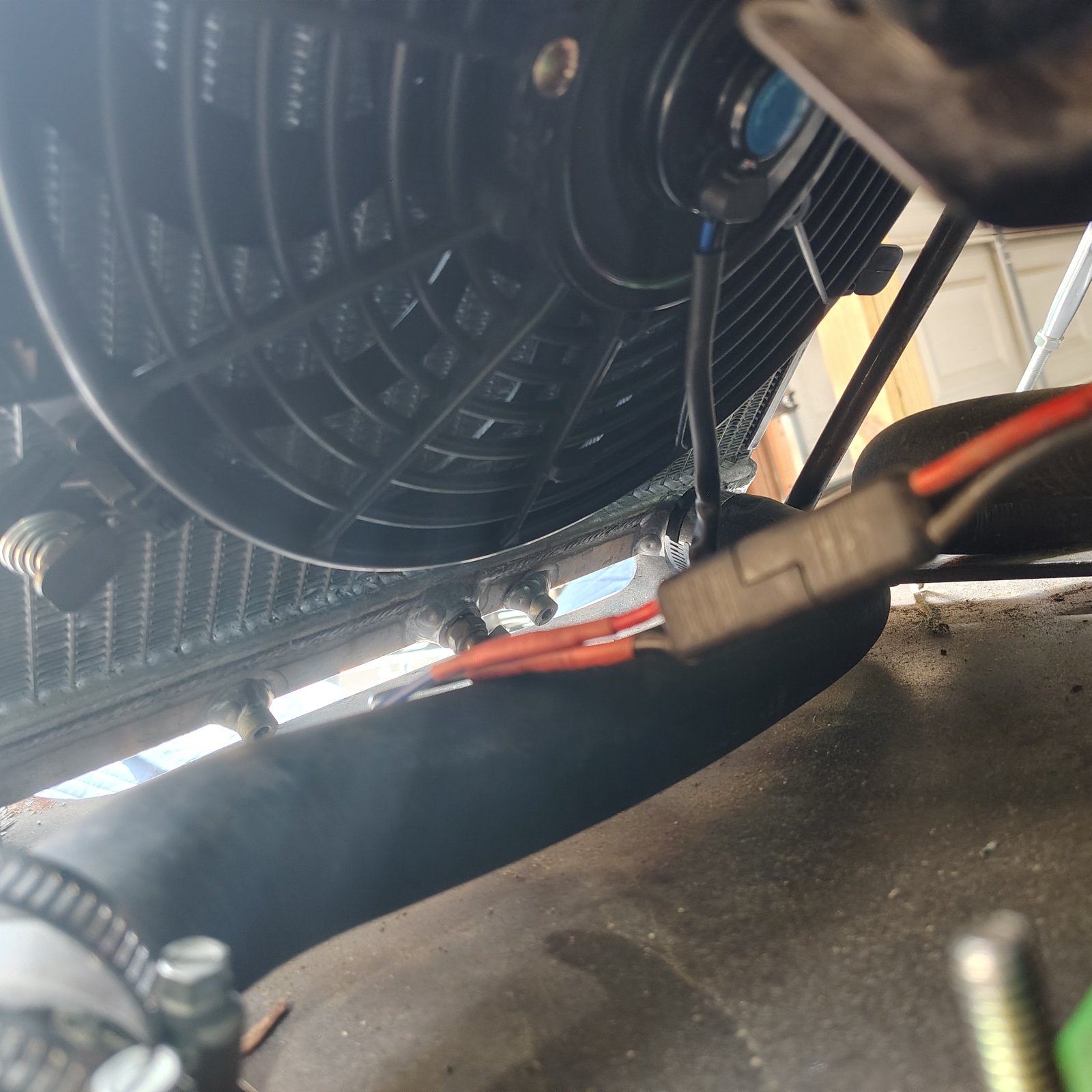

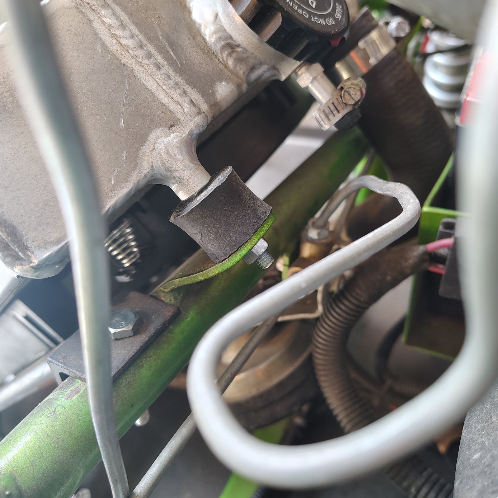

Yesterday, I replaced the old e-fan (left) with the correct DF one (right), since someone installed the one with that shroud, after Rich sold it....
52938
52939
52940
Upon removing the fan with the shroud on it, I was able to finally be able to attach the top of the radiator to the frame!
52941

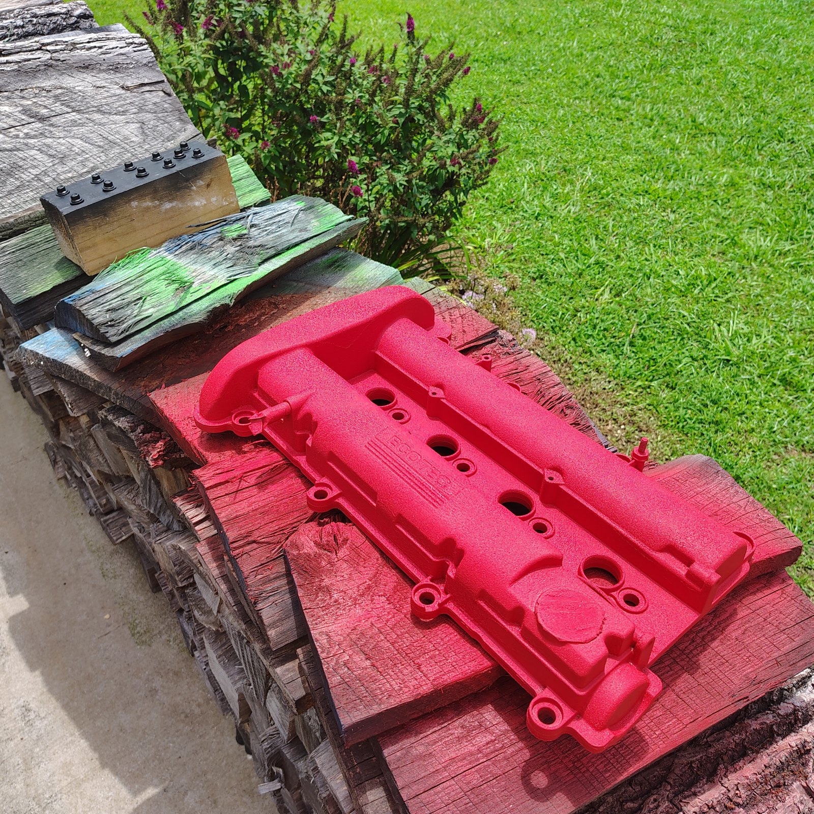

I had just enough Aircraft Paint Remover to remove the awful Green that I had painted the cam cover a couple months ago!
52942
52943
Thoroughly cleaned and sanded it, then sprayed it with Red Wrinkle Paint
52944

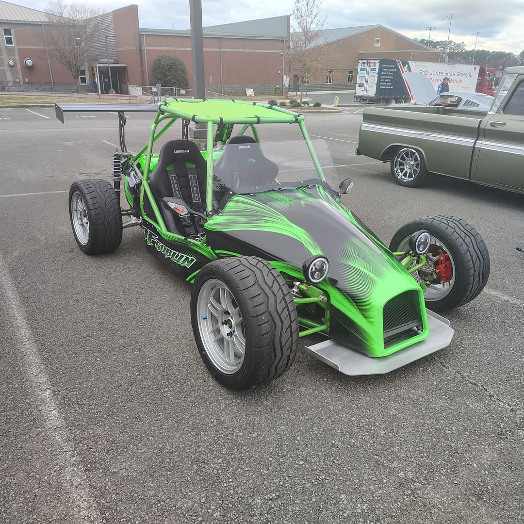

So, the latest pic of what it looks like finished is from last Saturdays' Cars & Coffee.
52945

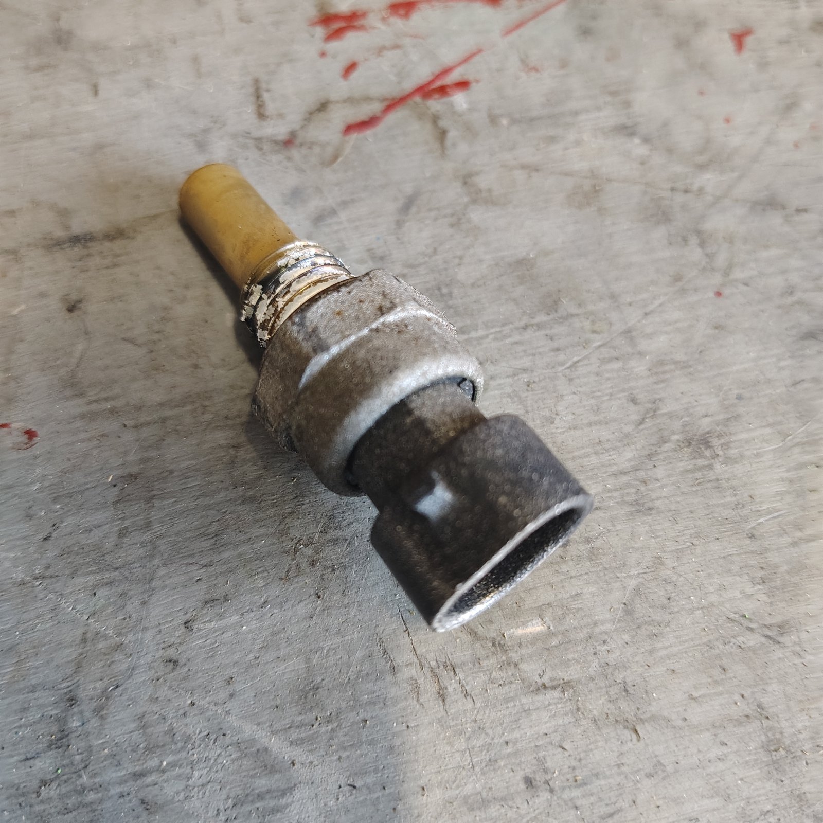

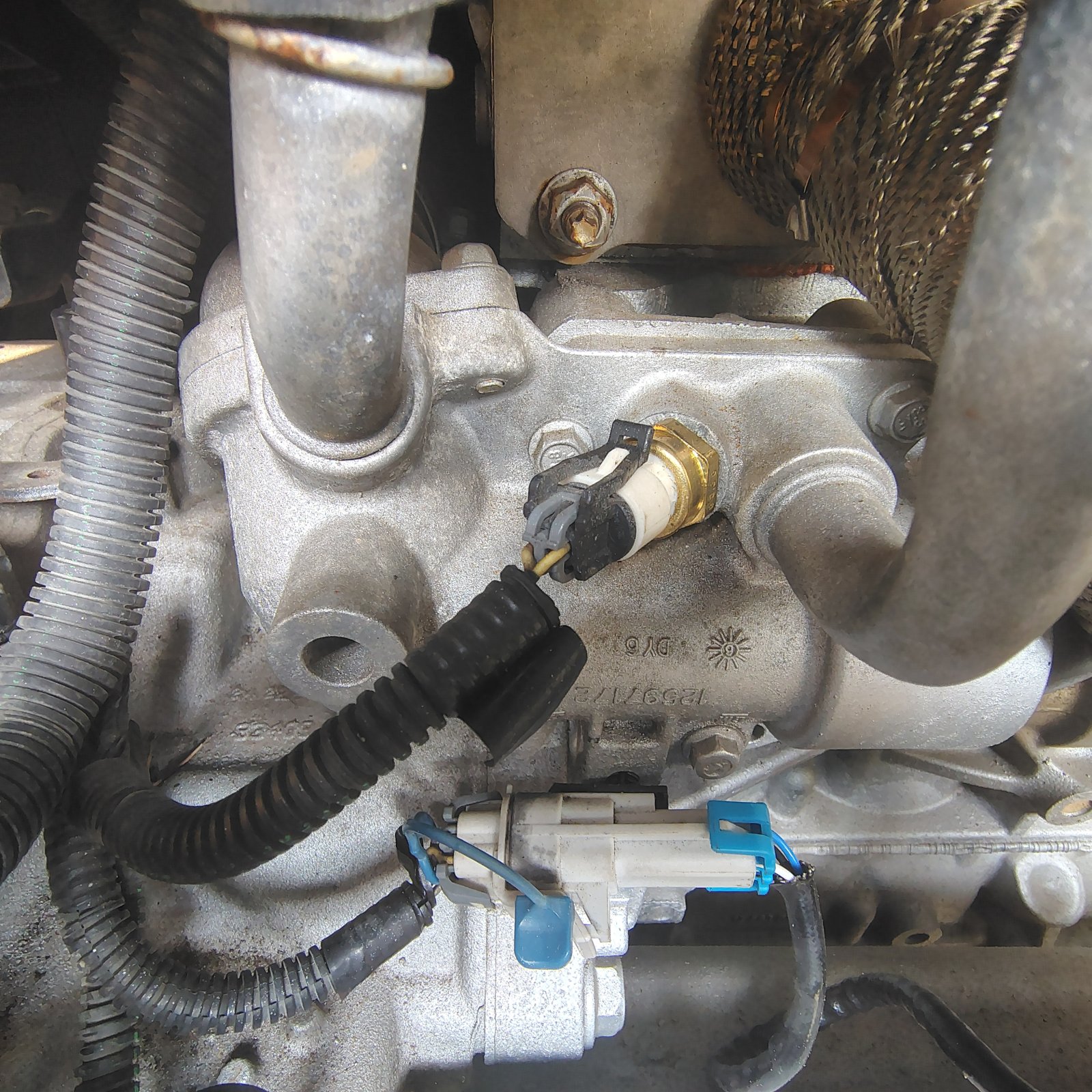

My dash coolant temp sometime works and sometimes says --- I ordered a new AC Delco Coolant Temp Switch, which should be here in a couple of days. Maybe that will fix that issue?
Mirage775
Friday, (a full week after it was supposed to be here), thanks to the awful USPS here...., I got my new AC Delco Coolant Temp Sensor installed and that was the issue with the --- on the cluster! Thank goodness!
Old OEM sensor with 50-60k miles on it
53056
New sensor installed.
53057

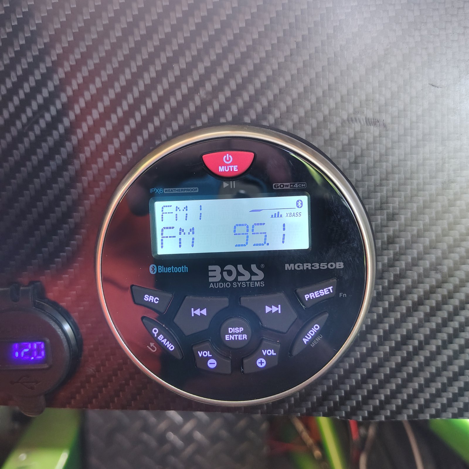

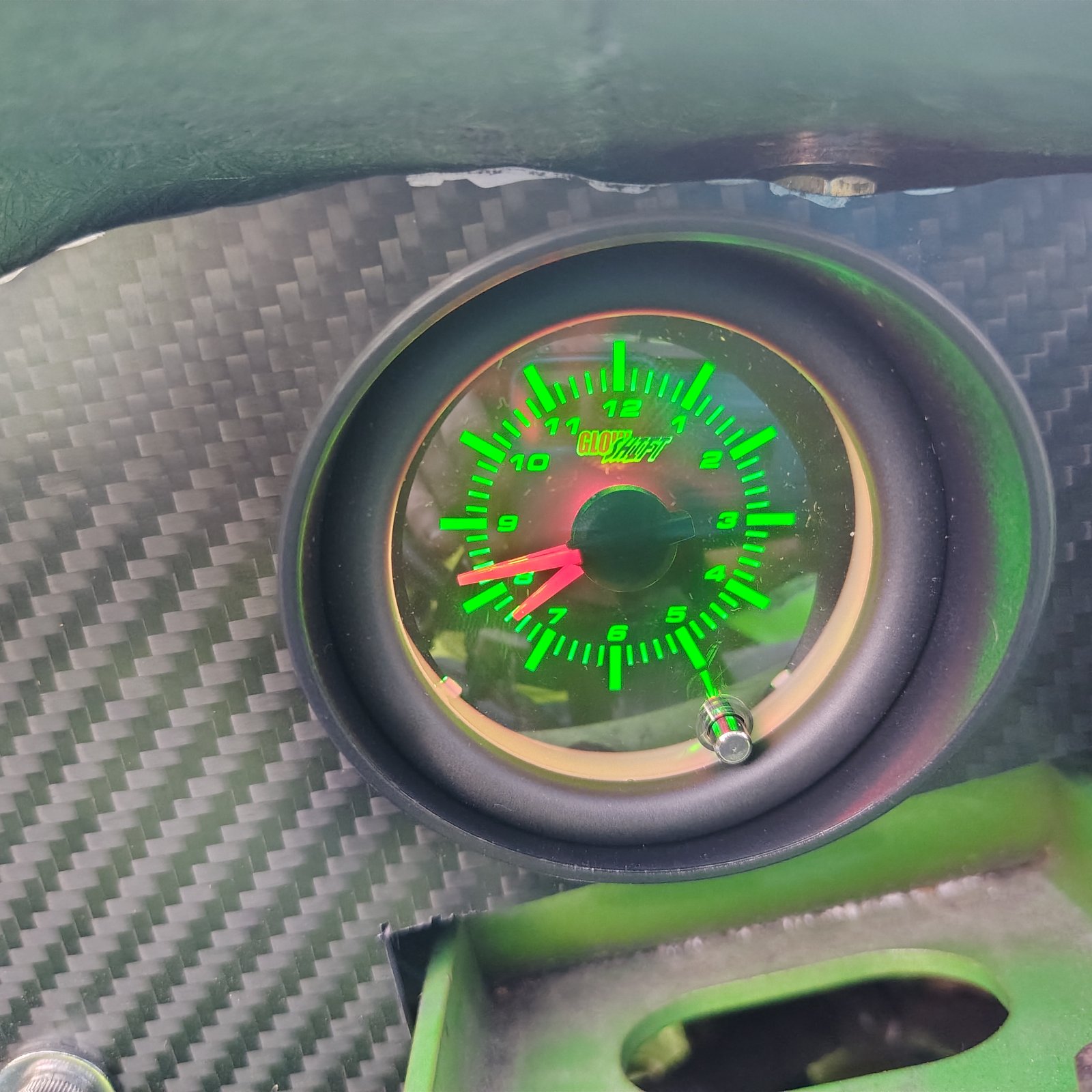

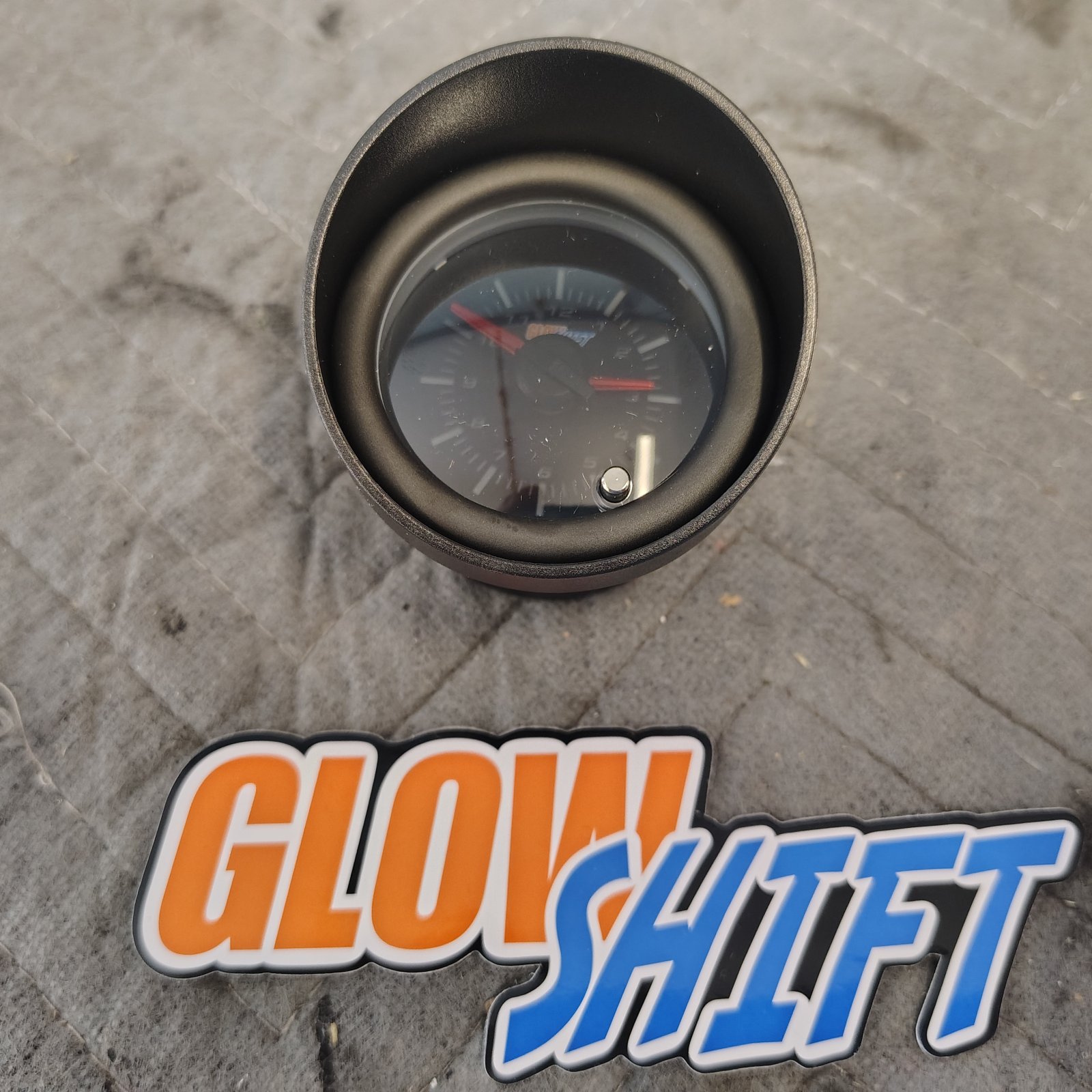

Since I had a 2.25" hole in my new carbon fiber dash, I decided to order a cool analog clock, since my phone sits too low to see it, I can keep an eye on what time it is :) I was going to put a temp gauge in here, if my coolant sensor didn't work...
53059
53060
Didn't get a chance to install it today, too many storms around. I will install it soon though.
