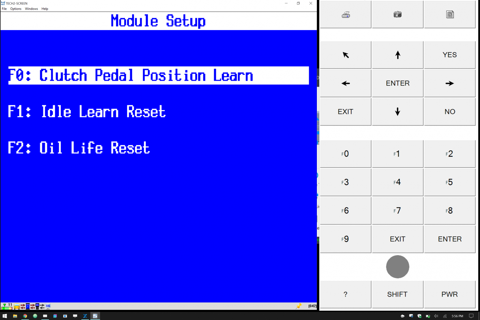

We got it fixed :)
(clutch relearn via vxnano/tech2win and a bad relay)

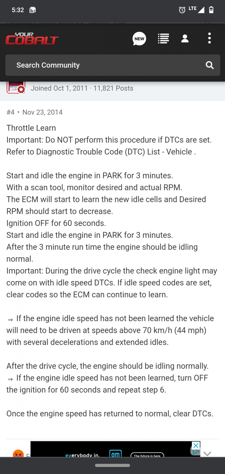

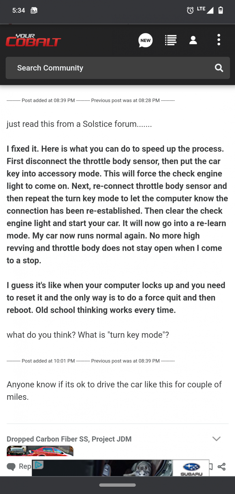

Is there an "learn" or adjustment for the throttle? Ours seems like either idle or 1200 and above. There is no way to slowing depress the throttle to ramp up from 800 RPM to 1200 RPM. Makes cruising slowly difficult.

Edit: To actually answer your question, yes there is an "idle learn reset"
