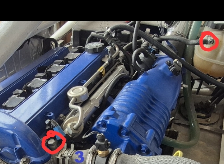

A At4Connor Member A At4Connor Member May 23, 2026 #1 Can anyone show me where the coolant return line hose goes on a supercharged engine?

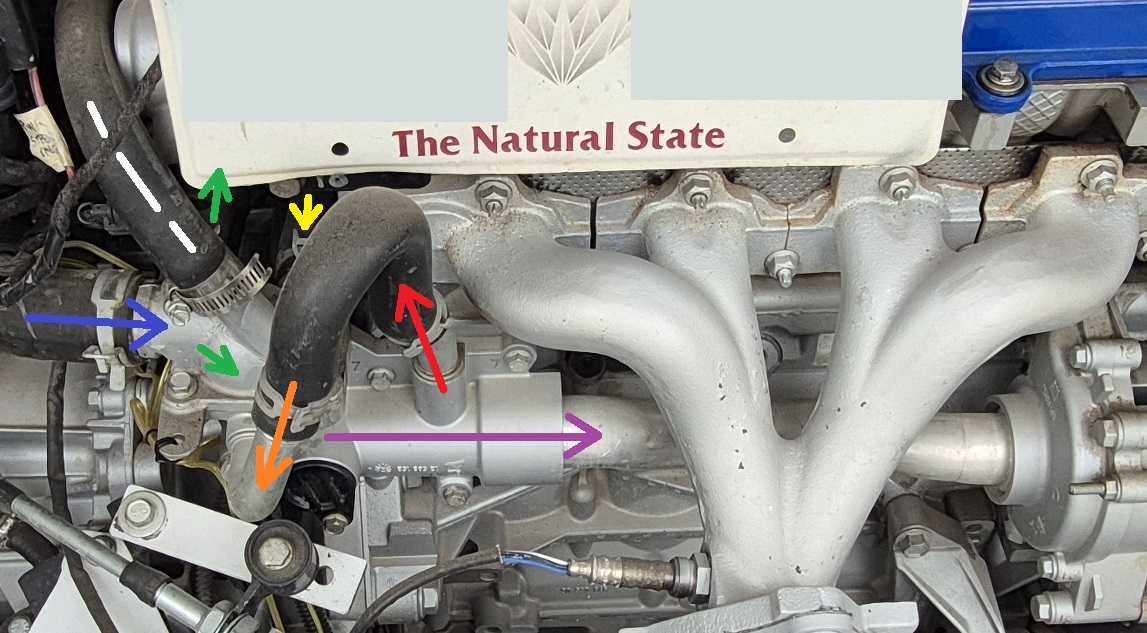

Ross Goblin Professor Ross Goblin Professor May 24, 2026 #4 The white dotted line goes to the coolant overflow tank. It is off of the top of the thermostat cover. Pic 4 in this post.

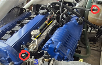

A At4Connor Member A At4Connor Member May 24, 2026 #5 This is the line I’m referring too Attachments IMG_2683.jpeg 144.8 KB · Views: 33

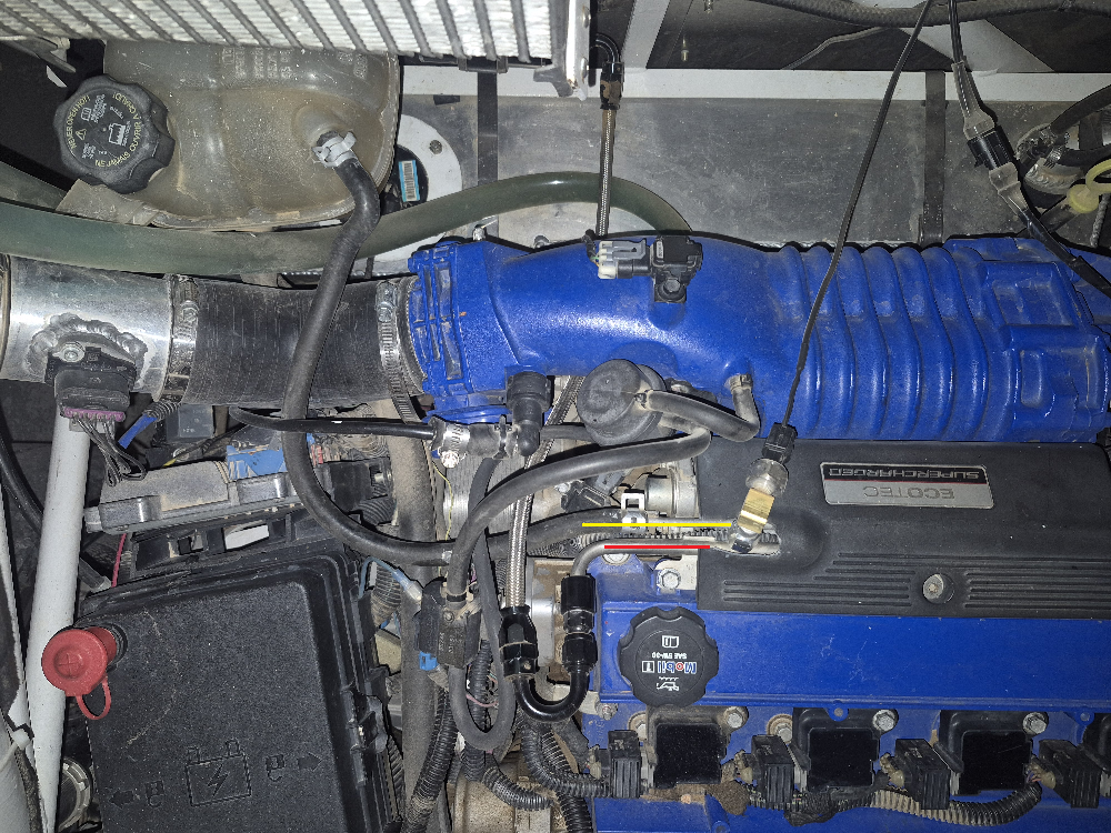

Ross Goblin Professor Ross Goblin Professor May 24, 2026 #7 That little line goes to the metal tube I put a yellow line on. It is below the fuel line, that I put a red line on.
