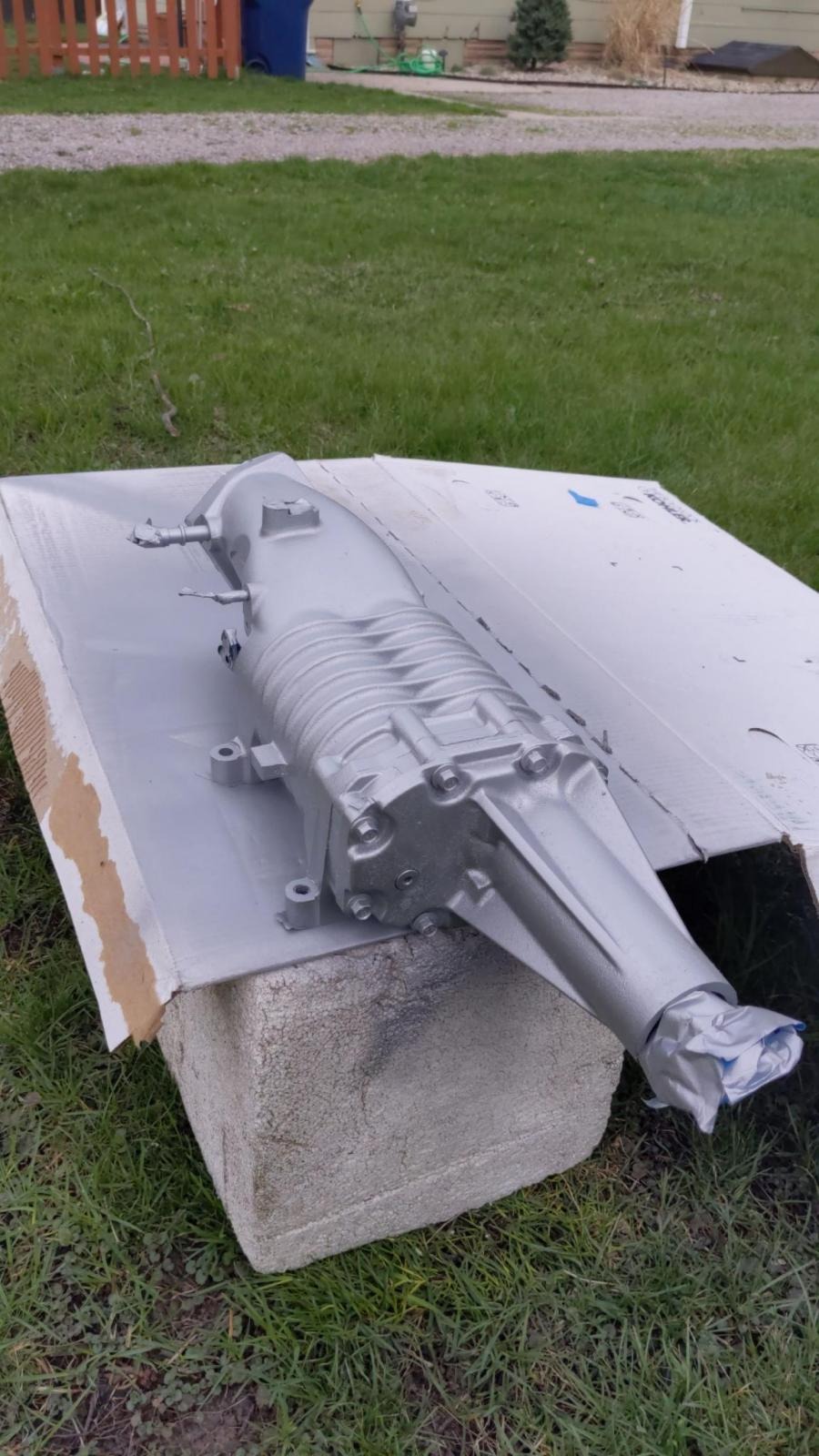

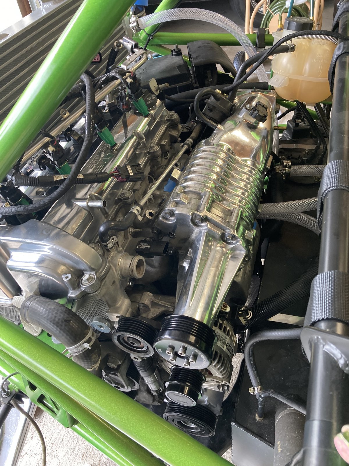

I vote polishing.
Joe
TheAnesthetist
I cleaned mine w/ Dawn Power Wash to degrease then used Lume Bright to remove the aluminum oxidation. You will need some form of protection to keep it from oxidizing again. I used Sharkhide.
I sprayed the whole engine bay with purple power and got pretty good results. I'll do a much more thorough cleaning when the powertrain is free of its cobalt prison

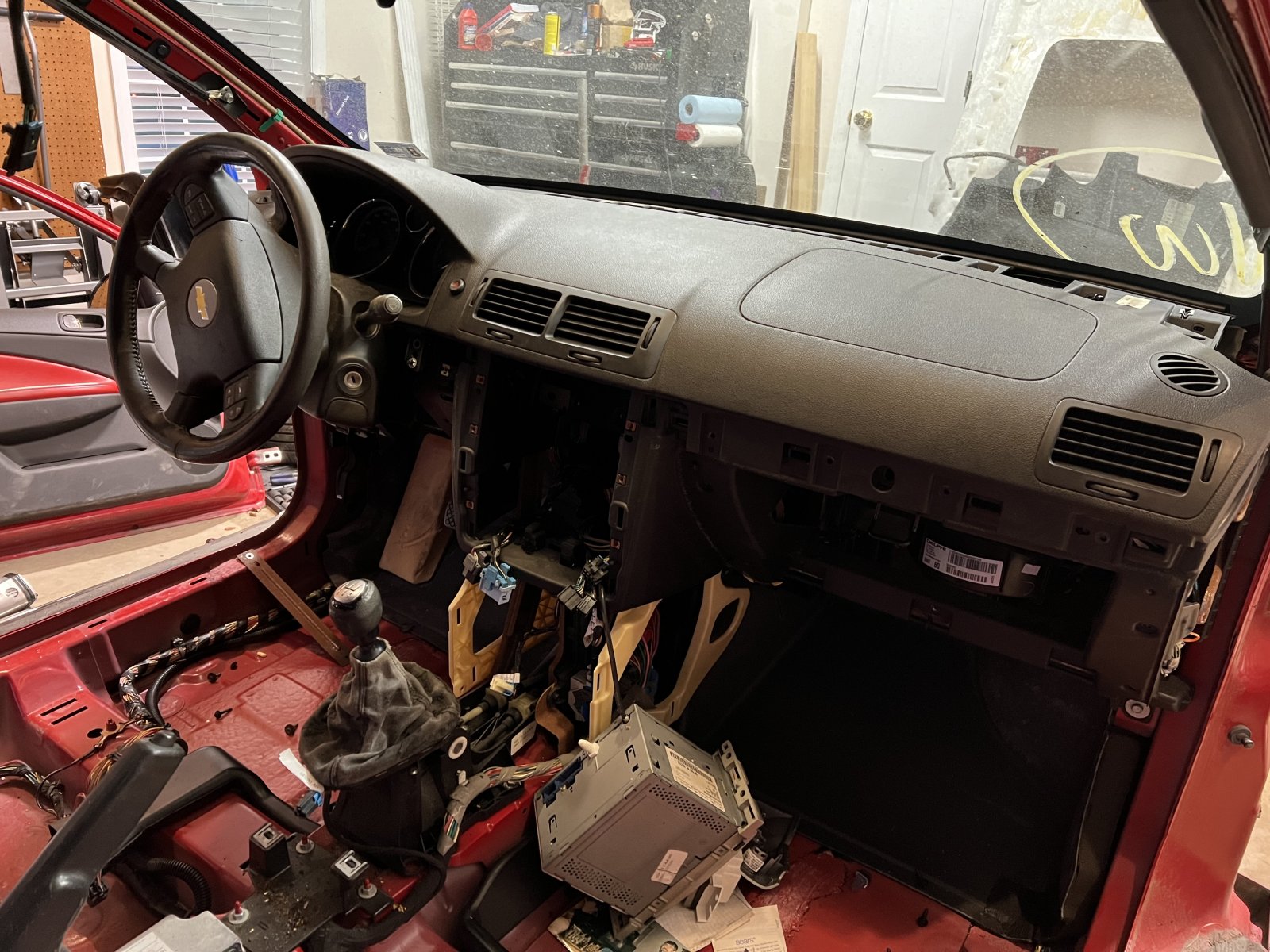

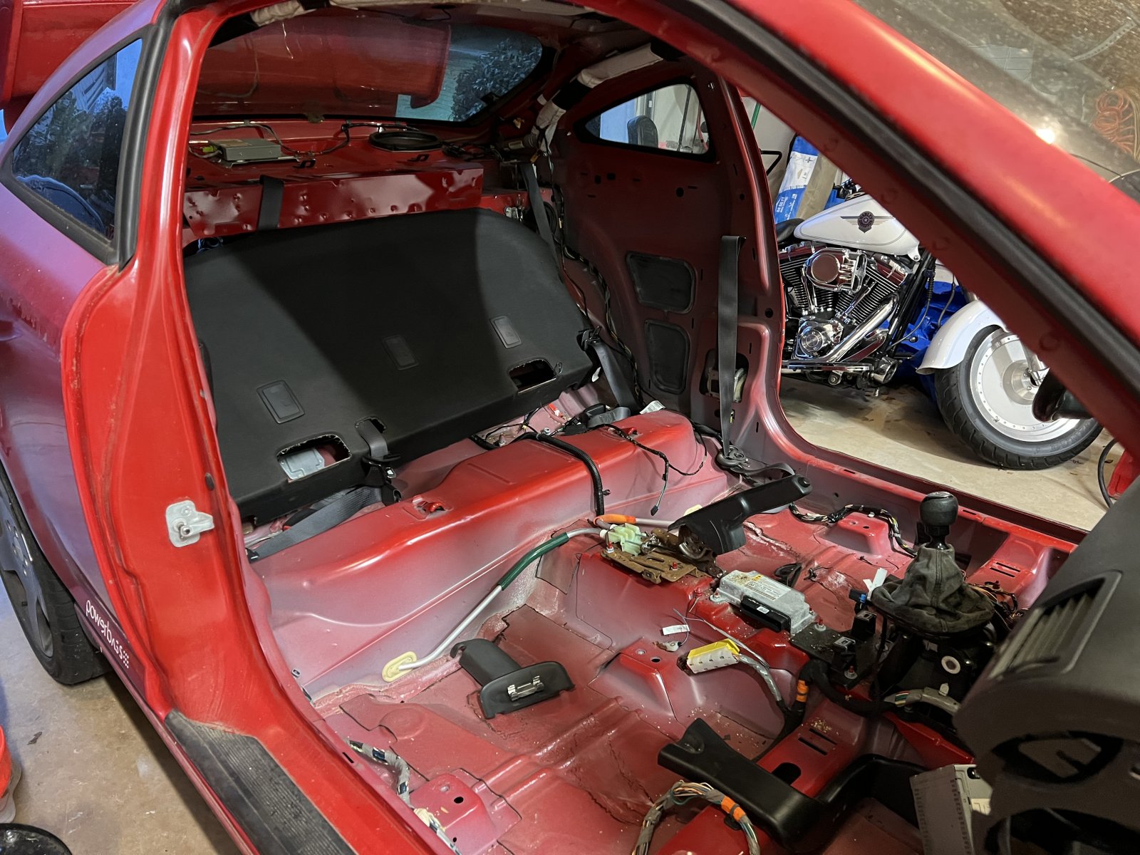

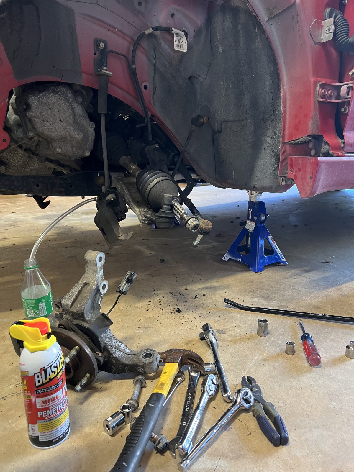

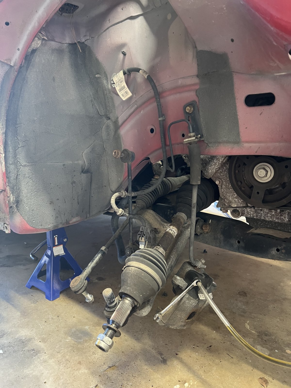

Had a productive weekend. Got the front suspension out without a ton of drama. One of the axle nuts was pretty stuck but it was no match for PB blaster and a 6' breaker bar. Stripped most of the interior, got the fuse box out, and started on the dash. Next up will be the subframe.

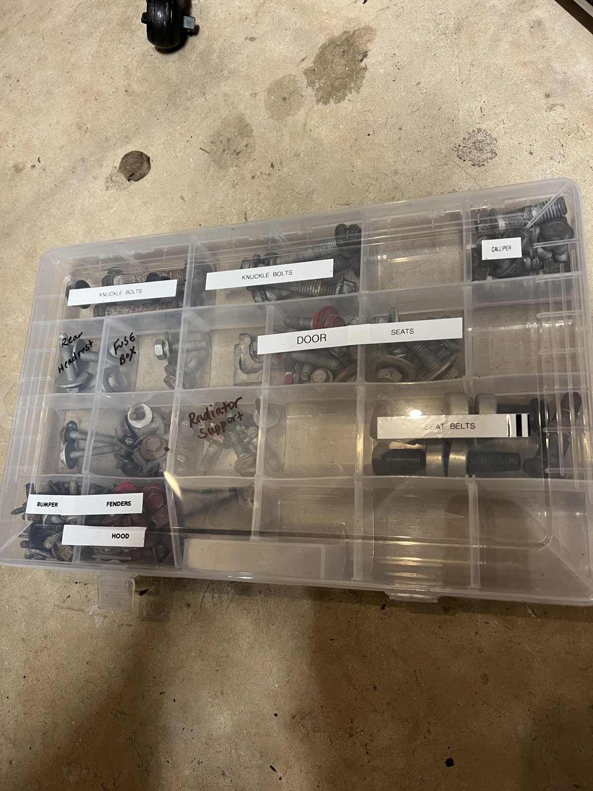

I bought a couple of these tackle boxes from harbor freight to keep my fasteners organized. Already gone through a roll of label-maker tape.
I'm not sure there is a problem with too much organization! Too little though is common. A few thoughts for the builder, there IS a fixed number of fasteners that make up these donors, though it may seem like that number is beyond a billion, rest assured it probably barely crests 40,000. Fortunately I imagine each lost bolt has about a 50-50 chance of being needed! There are plenty you will not use! and others you will use all or most of the stash! That is why i offer to find those missing bits for a reasonable price. It's not a Money Maker for me but gives extra worth to my junk yard visits.

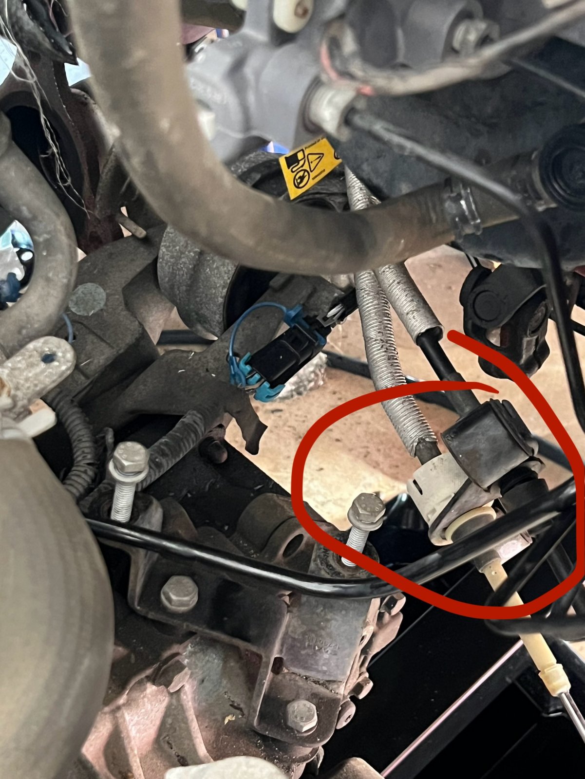

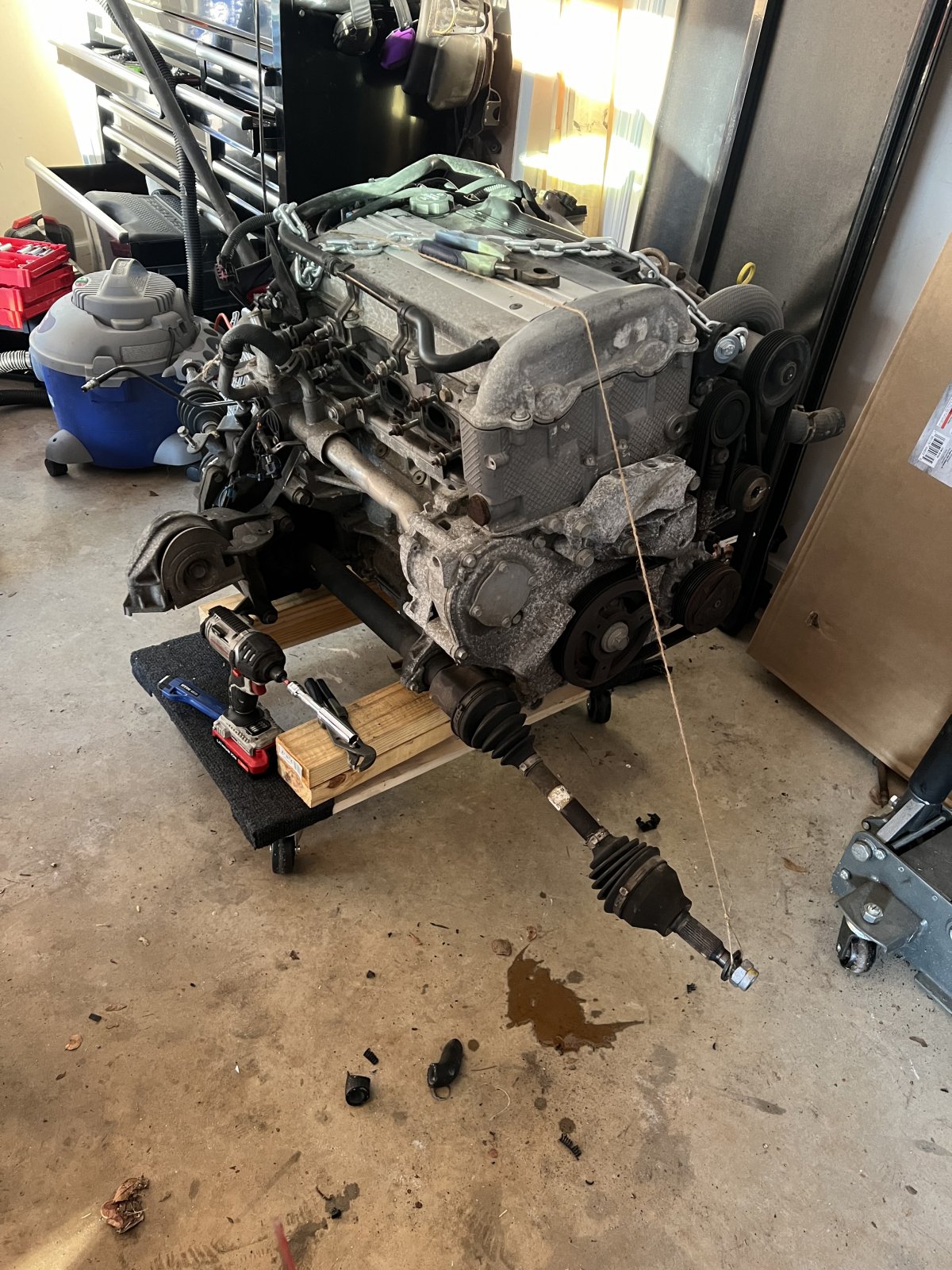

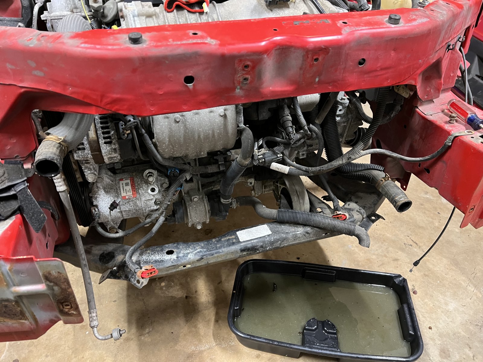

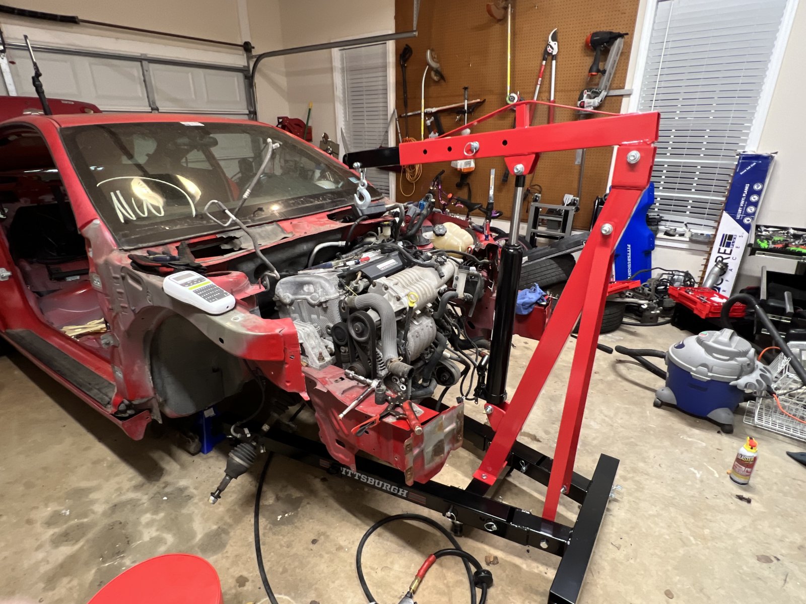

Subframe and engine are out. One of the rear subframe bolts was rust-welded to the LCA bushing so I had to destroy both the get it out. I'll order the Moog replacement bushings and have a machine shop press them in for me. Engine came out with no trouble but I haven't been able to free the shift cables from their bracket on the trans. Looks like they should slide right out but they're on there really tight. Soaked them with wd40 overnight so hopefully that will help.
That's pretty much standard for these vehicles. I think the passenger side through the arm bolt was the one I had to cut out.
You don't reuse the shift cables so those can be cut off (unless your trying to sell them). Just be sure not to damage the shift arms on the transmission though, you DO need that! I think mine were super tight so I had to essentially pry them off with a long screwdriver.
