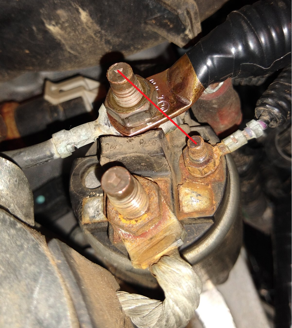

Verified it is not the starter. Jumped it again and the motor turned over.

Jumped the starter and it whirrs real loud but doesn't turn the engine over. Maybe bad starter?
That is unusual but how are you jumping the starter?; jump 12V to the connection for the purple wire. The big battery wire to the starter should test 12V all the time. If there is not 12V there all the time we have other probs.

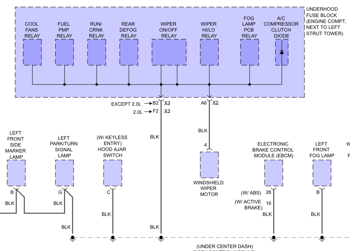

I'm leaning toward a missing ground. Verified I have no power to the fuel pump. I have 5v at the sending wire, like Thad said but no voltage at the hot wire. It looks like the fuel pump relay and the crank relay are on the same circuit.
In an earlier post, I was confused when the wiring video said to combine the "fuse box ground" with the fuel pump wires. I never found any kind of fuse box ground, but according to the schematic, there does appear to be a ground (or does the "X3" mean three wires?) at the F2 pin. Anyone know where F2 might be? I've opened up every multiplug and don't see any pins with 3 ground wires.

X3 is a connector number. I would expect there to be more than 1 ground on the various fuse box connectors. The later models have several. Any black wire is most likely a ground wire, but this should be confirmed for your model.
