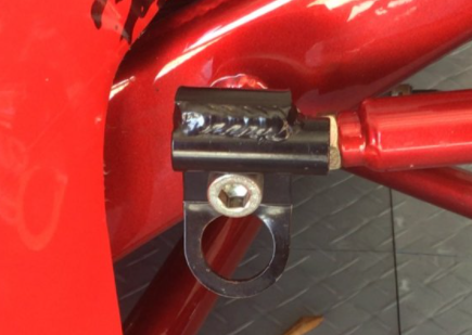

What are the specs on the socket cap bolt to mount the brackets on the frame? I see that style in Zoom Zoom pictures and I think also in Ark's picture. I'd rather use that style bolt than a hex cap bolt that came with my early tow bar kit. I don't have a way to get a wrench or socket fully on the hex head mine came with, I can only angle an open end wrench off barely grabbing the faces of the bolt (which frequently slips off). Changing to the socket cap style would make the alignment easier to adjust.
I know it's 1/2" diameter and 4" long but haven't checked the thread to see if it's -13 or -20. I also don't know the grade but I assume grade 8.
This image shows the bolt I'm talking about:
20 thread pitch from mcmaster but I don't see a plated option:
13 thread pitch from mcmaster:

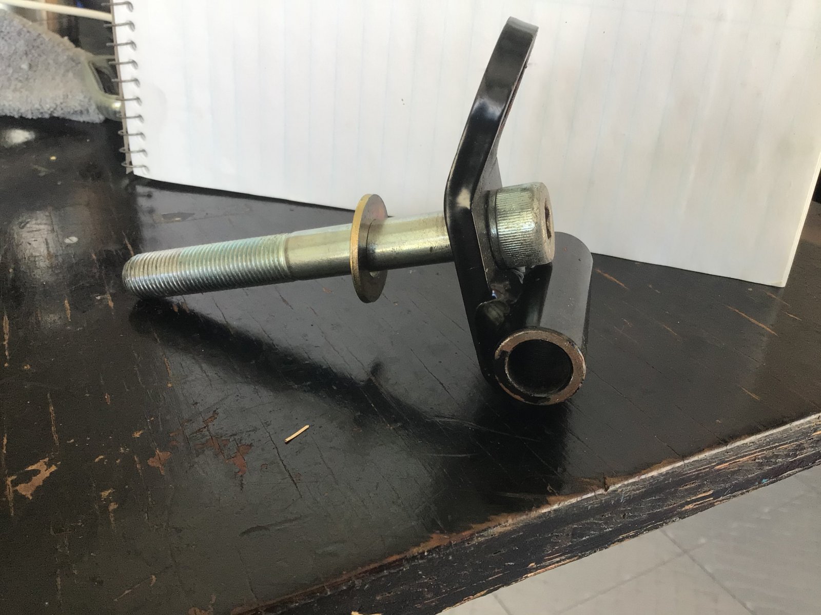

Here’s a picture of bolt, Adam will probably sell you 2 of these bolts 4 1/4 inch long with a 3/8 Allen head
Email Adam and we can get a set of to you. Our original plan was for the cross tube to keep the bolt from spinning. That was a failure. So we switched to hex head cap screw.
