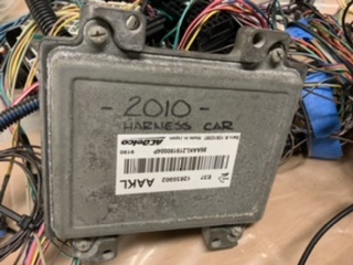

Good Evening,
Both of my cars 2008 & 2010 are running the E37 ACDelco (Delphi)? Anyway with those?

If you can get the VATS disabled (I know HPtuners can do that with many of the Delphi ECM’s) then it should be no problem. Talk to ctuinstra. I think some time back he was working on eliminating his key switch and adding a push button starter. It might even be in his build thread.

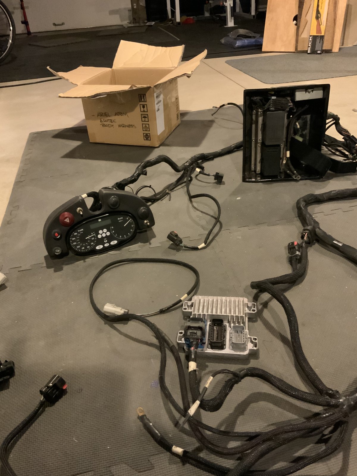

BAR-AIR
Good Evening,

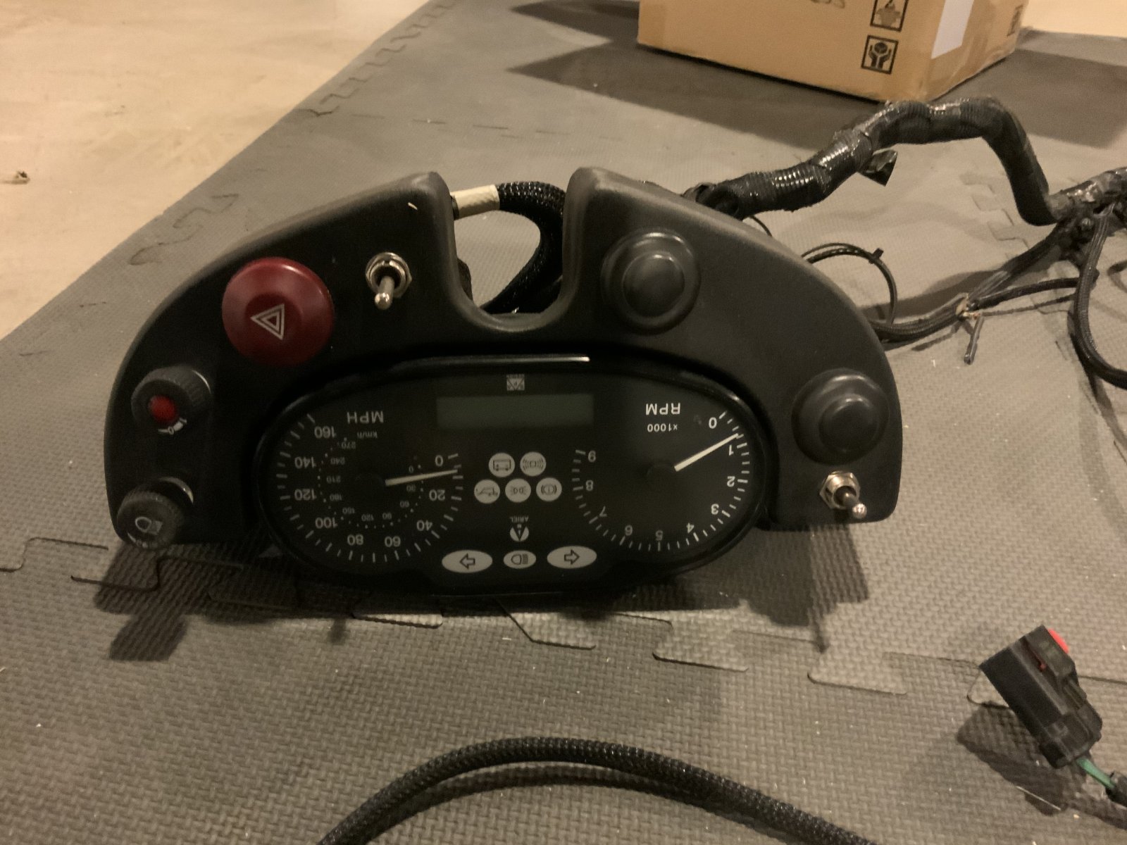

Just got back into Buffalo and wanted to post the pictures of the Ariel Atom body harness. Should be a 2006 Ariel Atom 2 it’s the only one that came with the 2.0L Ecotec that was supercharged.
The dash with the gauges, lights and start push button. The other nice thing is about 80% of the plugs have the factory labels showing where they go.

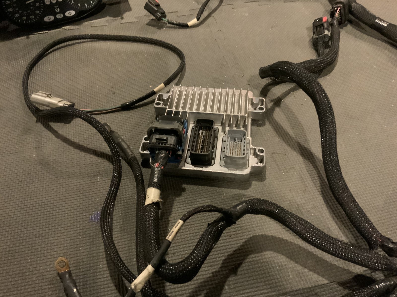

Which ECU is this obviously not the same as on my 2008 or 2010. But I do believe this is the same one that is used on the 2.4L...
This is what I think is interesting about the harness I believe all the fuses and any required resistors for the entire car are contained in here both body and engine. (Also note the motorcycle battery for the car was stored here also)!!!!!
So the questions begins with was a stock engine harness used and if so this should be able to be plugged into any 2.0L supercharger Ecotec and with possible tuning we should have a blueprint (Basically Russian reverse engineering) Complete stand alone harnesses for the Goblins. Without any of the BS most of us are trying to eliminate.

That PCM looks like the same one in my 2006 Cobalt SS SC (and now in my goblin). It is a P12 PCM.
I would be interested in a HP Tuners download of that P12 PCM. It is easy to turn off VATS on it.
Ross.

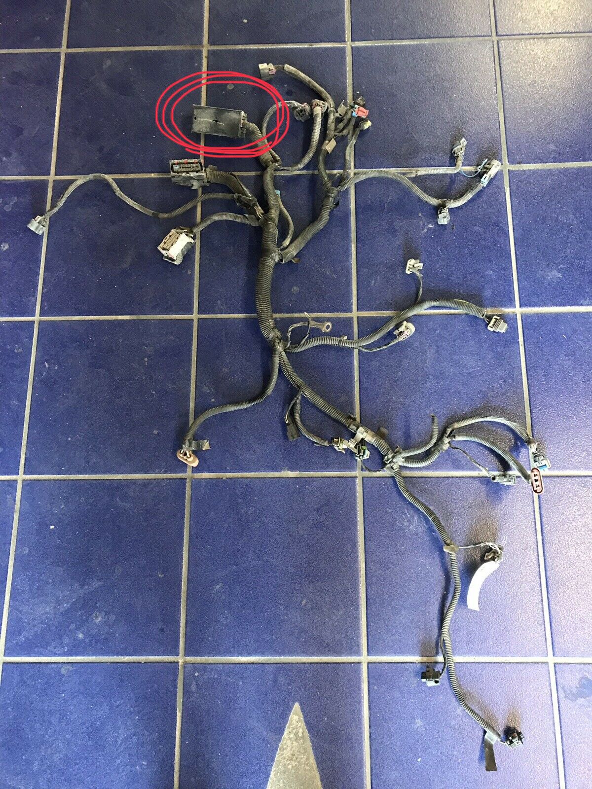

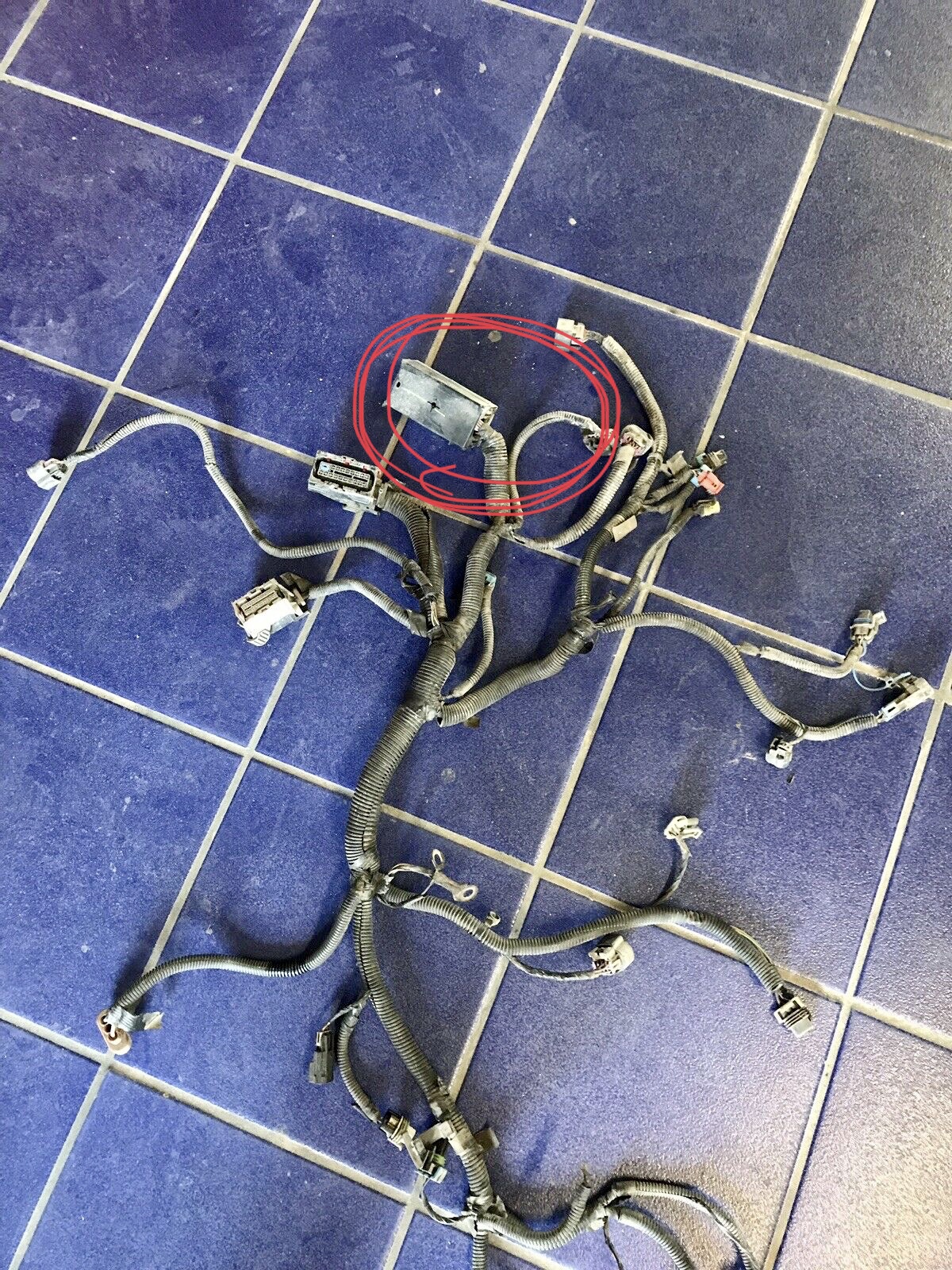

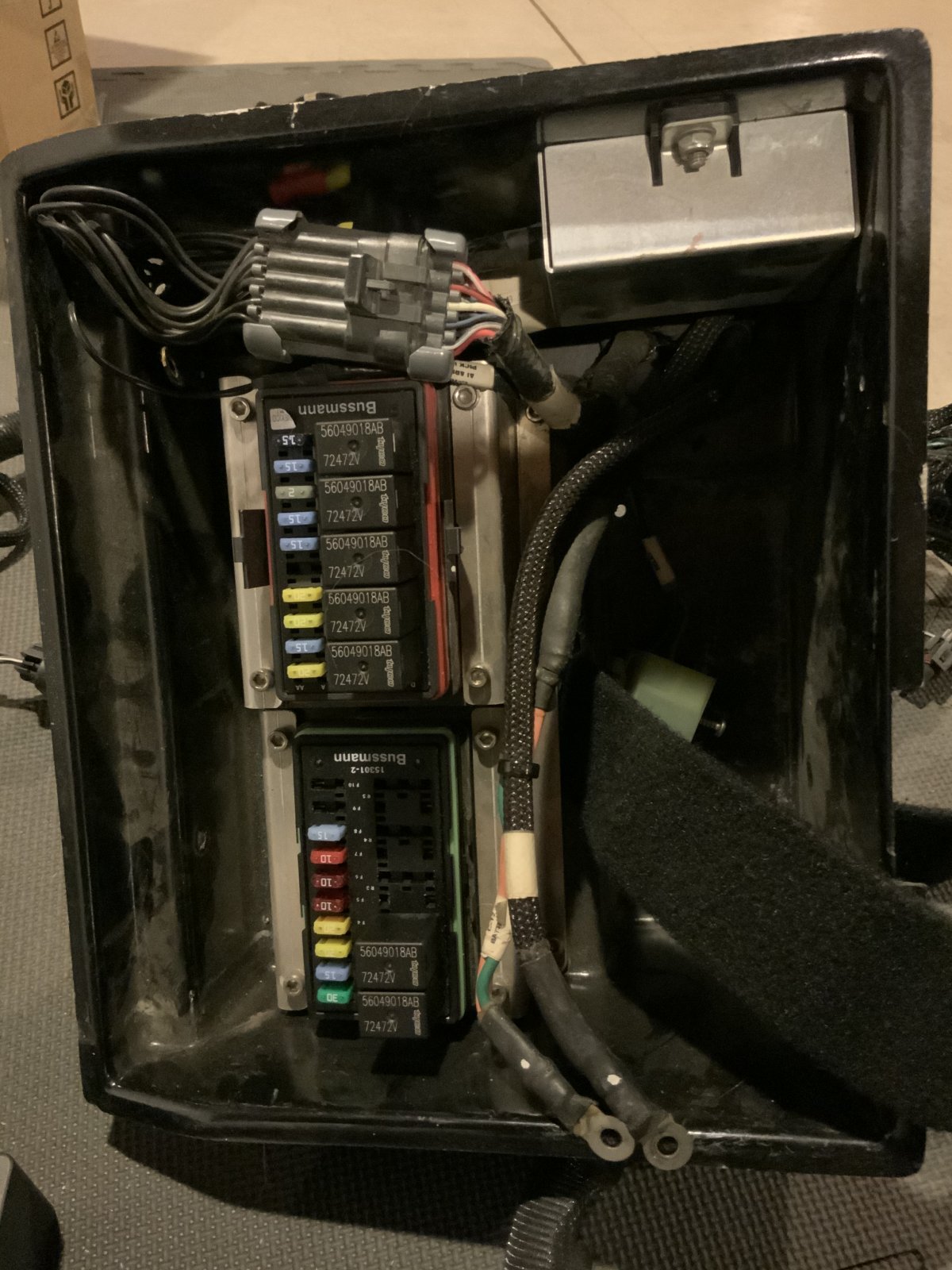

BAR-AIR
Aright was just looking at supercharged engine harnesses on eBay for the Cobalts. The OEM harness does have a fuse block along with the two additional plugs that go into the ECU. So how is that deleted on the Atom harness???

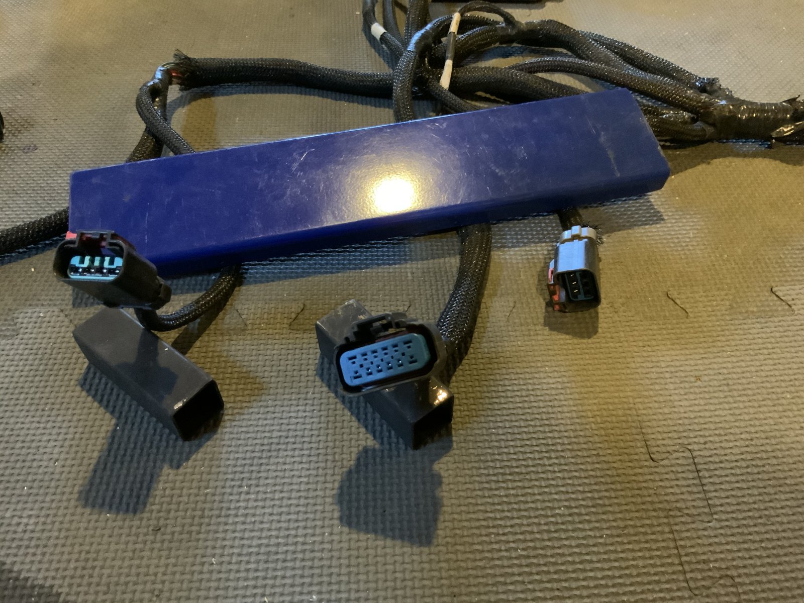

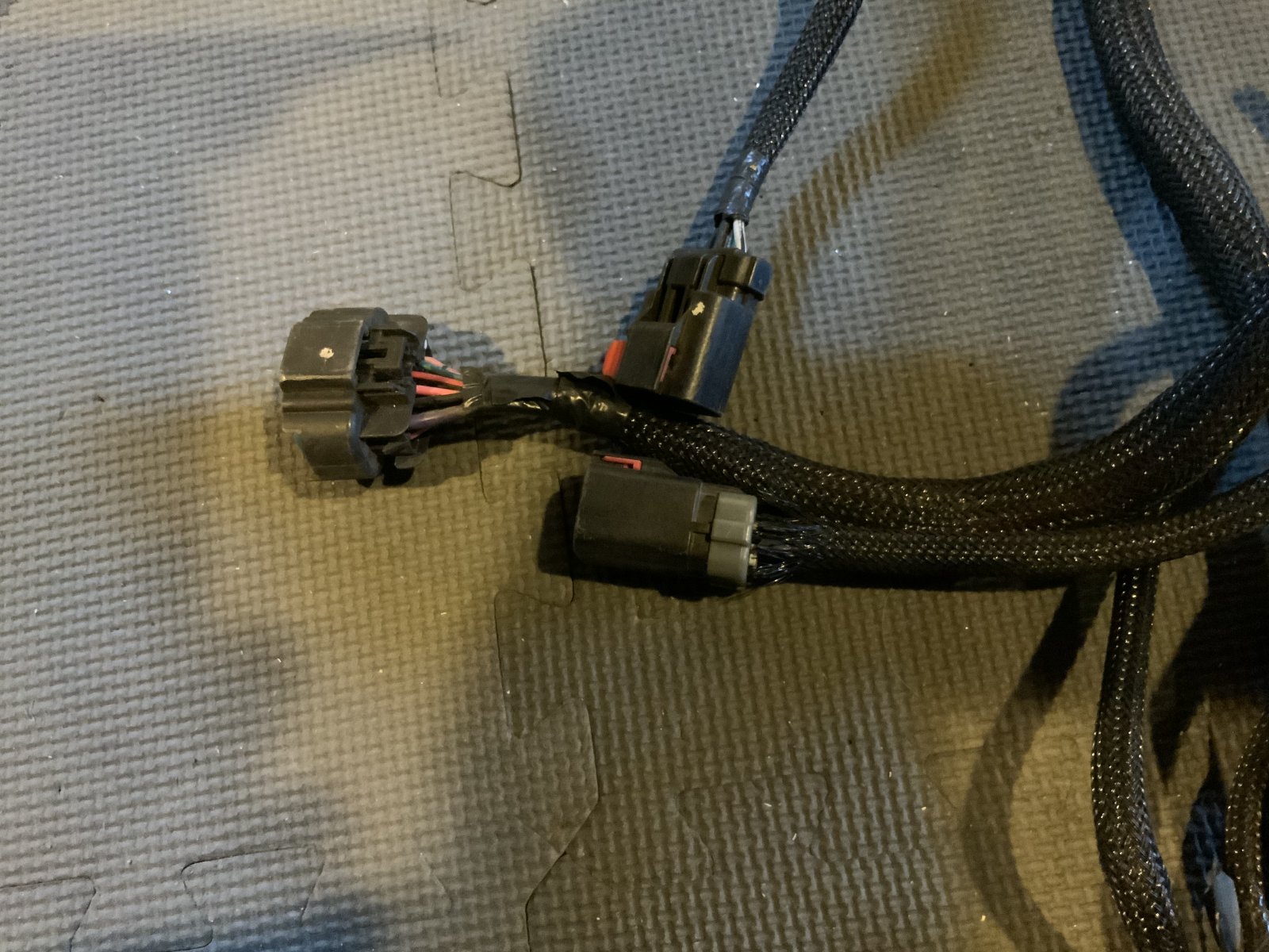

BAR-AIR
Good Morning,
Theses are the three plugs that are not identified on the Ariel Atom harness. So I would image this is where a stock engine harness is spliced into it. (As in the fuse block)...
