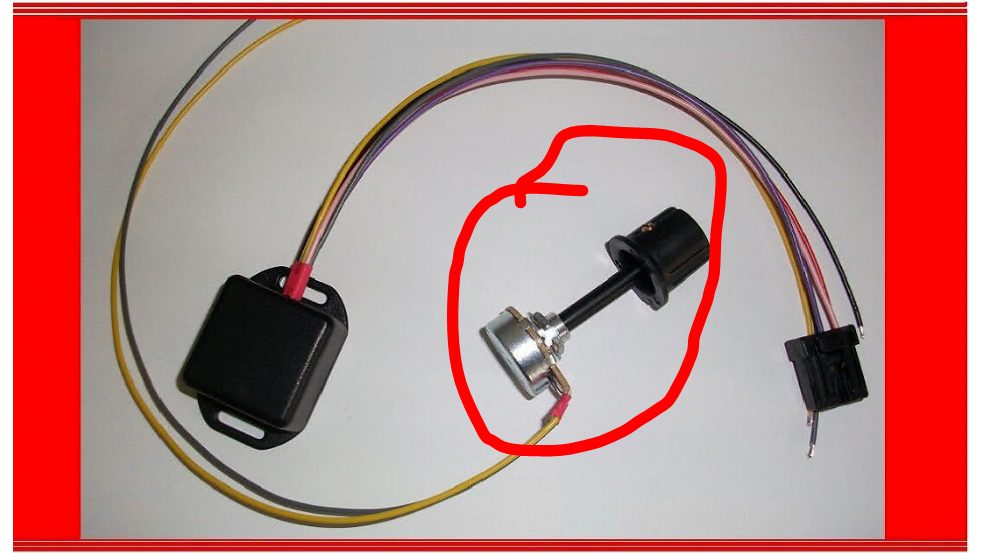

My EPS controller failed this weekend. The cheap potentiometer that is used to adjust the resistance failed. No part number on it but it labeled A100K which seems to be an audio (non-linear) 100k potentiometer. No listing of wattage one in. I ordered replacement on ebay rated at 1/2w so we'll see how that works. My original might not have been just right in the beginning since it would only turn down so far.
Failure was to full assist, which is better than no assist.
I may try setting the "pot" to where I like it and try getting a resistor to match.

The version of the aftermarket controller for the Saturn EPS that I have came with a manual knob to adjust the level of the assist. It's this "pot" that failed and I am replacing.

Oh, that's not good that failed. Just glad it's not in the EPS controller board! From the photo it looks like a 1 watt pot, but this circuit shouldn't be carry much current, only a few milliamps.
New potentiometer from eBay seems to have fixed the problem. We’ll see if it lasts.
The original started reading correctly while comparing old and new. The original had been mounted it a spot that got bumped a lot after I changed my seat mounting so it could have been abuse on my part that caused the issue. I had already relocated it so it will probably be okay.
