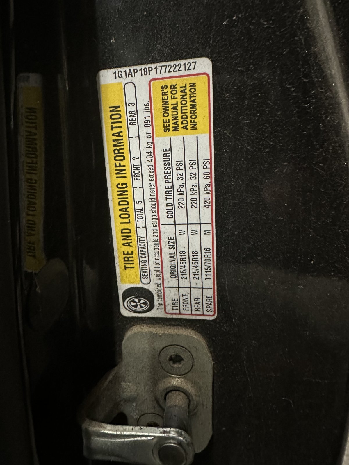

And looking at tirerack.com, they’re saying OEM is a 215/45R18, which is 25.6”. Oh what do I believe?? lol
When in doubt, consult the doner. You know, one of the 10000000 pics you should have taken. :D Less than 1/2” diameter difference from stock to a 245, which is probably 3 mph or so
. Not a real big deal, you just need to be aware you are off a tad.

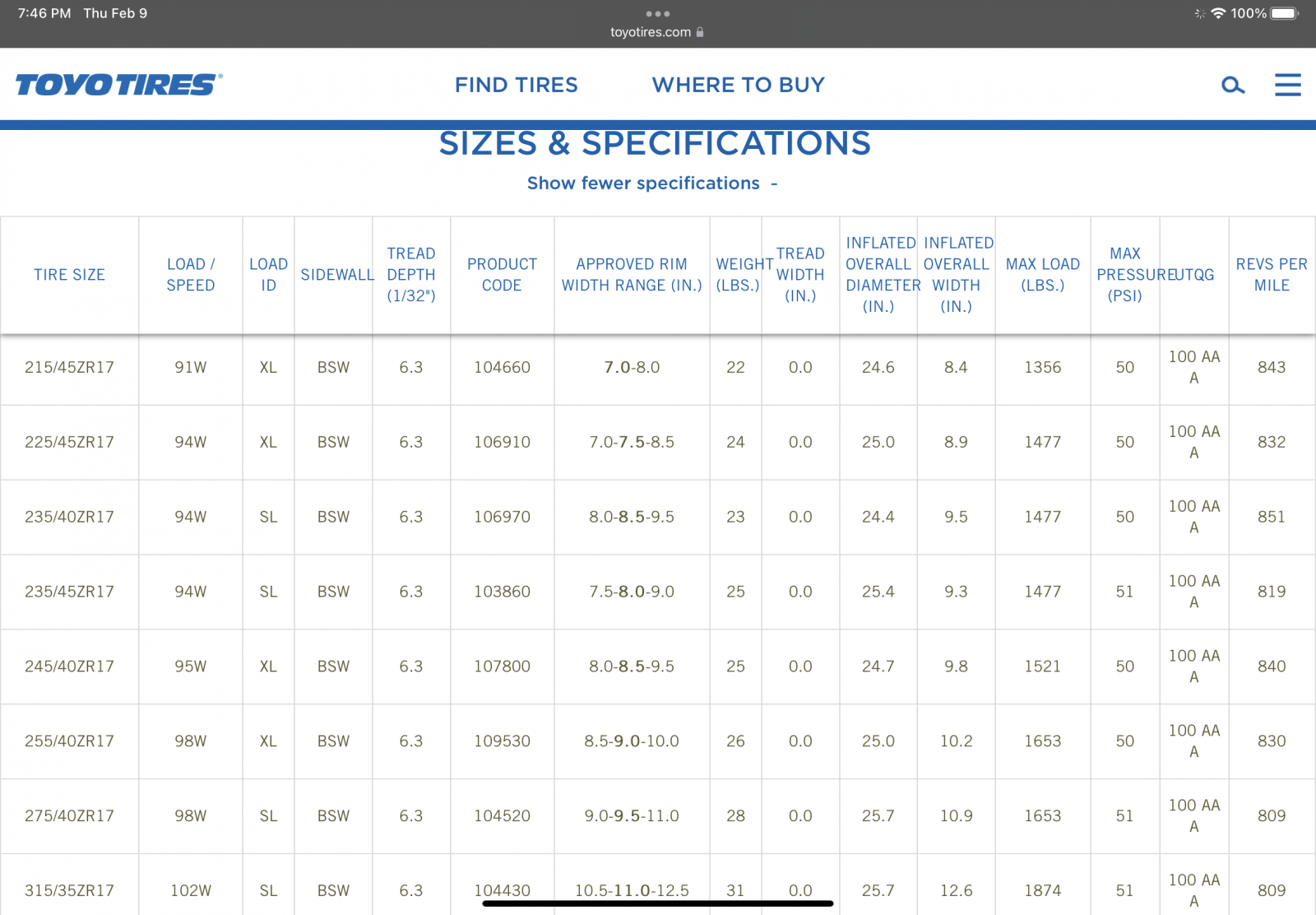

@Rttoys Thanks for the great info. I've got several 17x9 wheels I'm looking at, and for tires I'm looking at the Toyo R1R.
Based on your feedback, I'm currently considering 275/40R17 on the rear and 245/45R17 on the front. Both tires are 25.7" overall diameter, which is the same size as the factory Cobalt (which is also a 245/45R17 I believe). Speedo should still be accurate.
The 275 is ~1.2" wider than the 245, so that means I'd gain ~2.4" width in the rear, which I think makes it close to the same overall width as the front. In theory it seems like a good setup, yeah?
Mostly correct. That’s how I played it. You have to remember, it’s easier and cheaper to go with a common tire too. Plus, the 275 are 1.2” wider, but that will only gain you 1.2 in width overall. Half of the width gain will be inside and the other half outside. Either way. There’s still a 255 in between there if you want to add that to your equation.

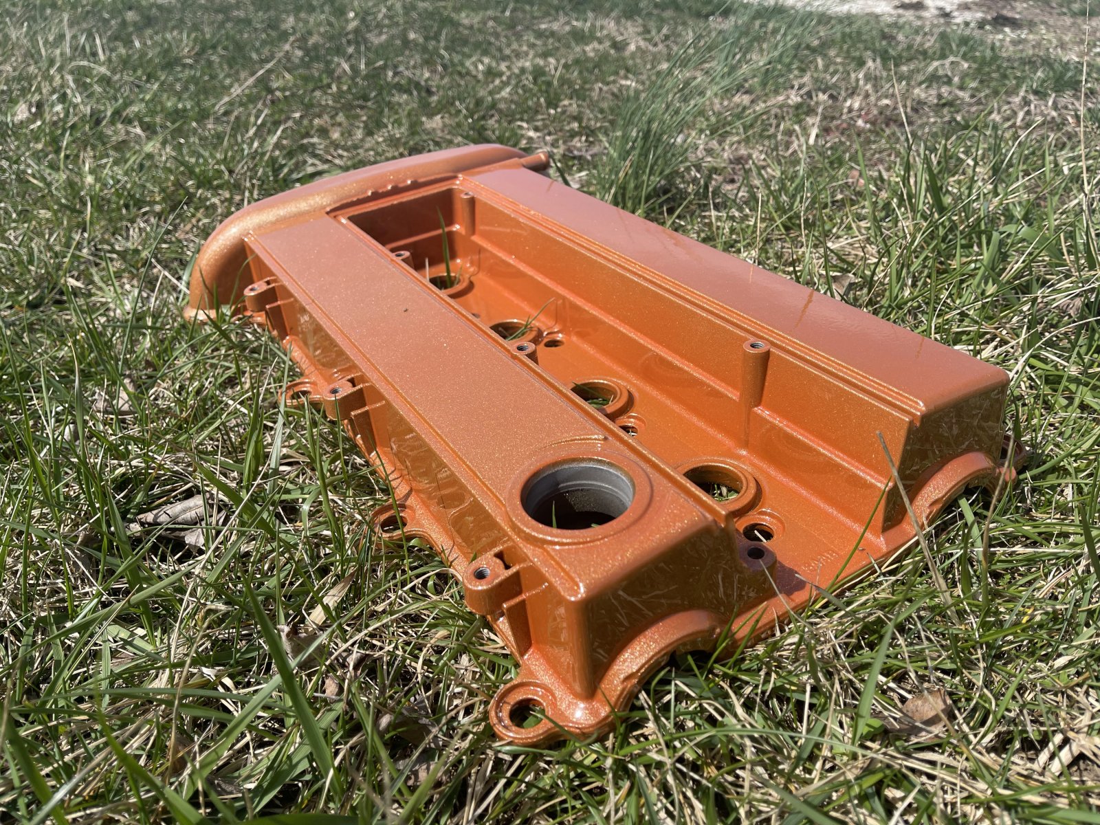

March 06, 2023

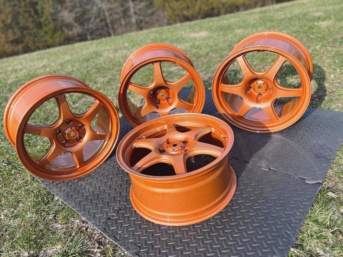

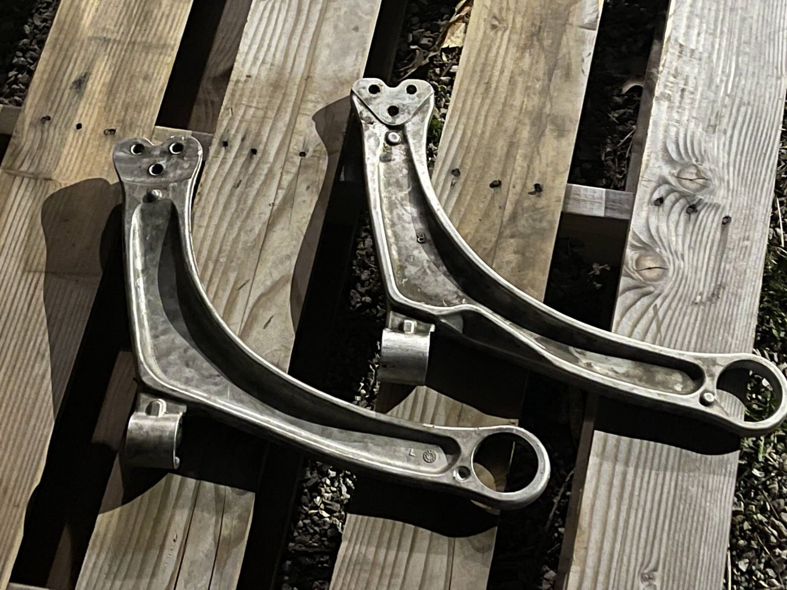

Another small update; got my wheels and valve cover back from powder coating, Columbia Coatings Illusion Blaze color. Absolutely love how they came out. I also stripped my donor control arms (FE5 suspension, with the aluminum arms) and ordered new bushings and ball joints. Went with the OTTP leading and spherical bushings, and Mevotech TXMS50510 ball joints. Control arms, coilover springs, and coil pack cover plate are all with my powder coat guy and I expect I'll go get them this weekend. Control Arms will be in the same Illusion Blaze color, springs and cover plate will be matte black. No work done to the actual car though, but I expect to get back into it very soon.
First up will be to get the engine harness back installed (took it out to thin it out and fix a connector). After that, I need to get the sub-frame in and ready for control arms to be put in. I THINK after that, I'm officially done with my stage 1 and will be starting on my stage 2 (A-Arms, hubs, suspension, and brake stuff to start). Part-wise, the main things left to order are my tires and seats. So at this point, unless I'm forgetting anything, the only thing not new on my Goblin is the engine, trans, PCM, BCM, dash cluster, gas filler neck, pedal box/pedals, steering rack, and wire harness. The cluster will one day be replaced with a AEM display, but that's an enhancement project for another day.
My goal is to be able to move her under her own power before the end of April, and start my registration paperwork sometime in April as well!

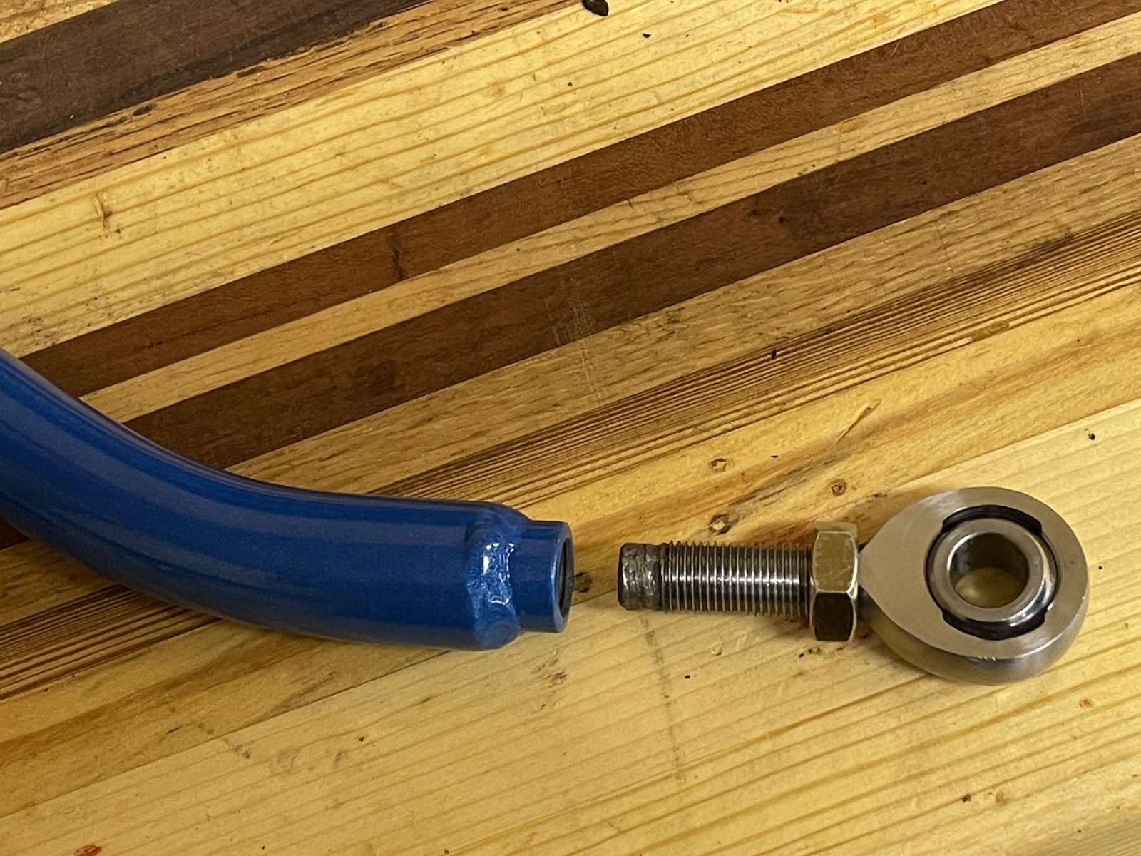

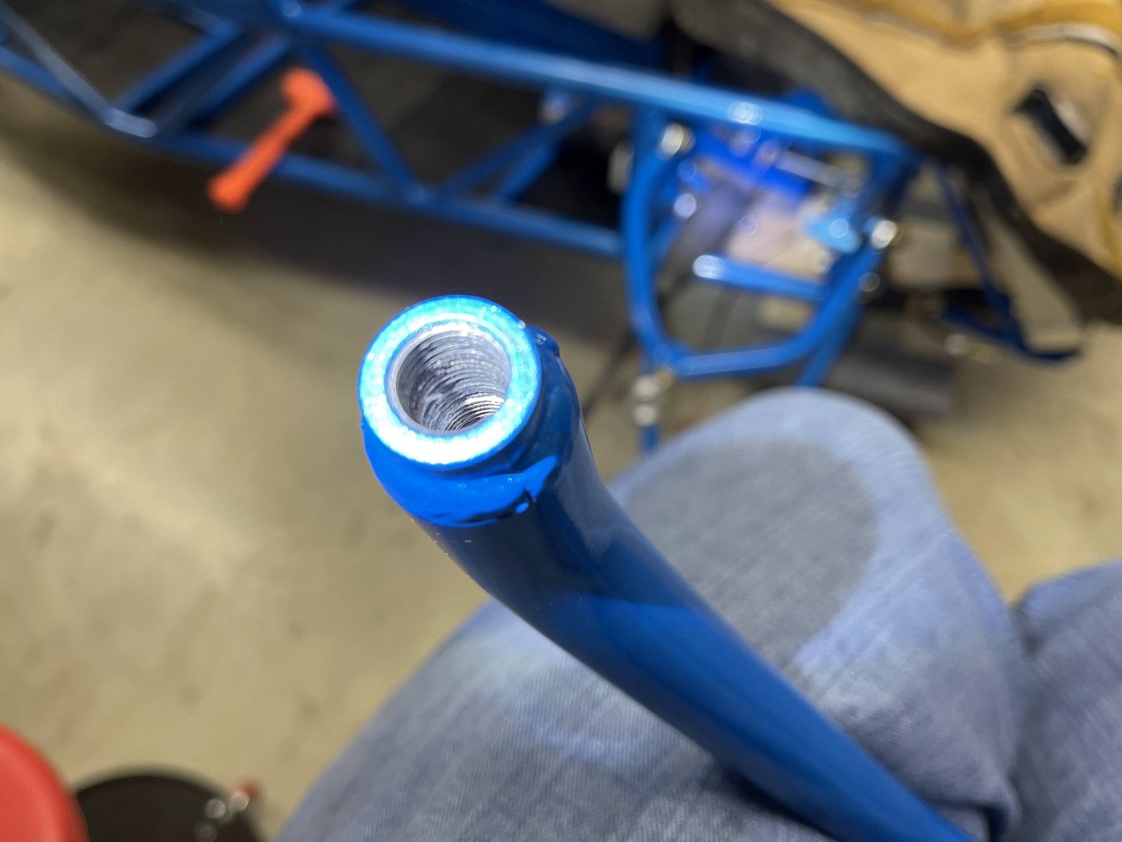

DFKC Quick Attach Steering wheel installed, picked up LCAs, coilover springs, and valve cover coil plate from powder coating. Started work on front control arm install, but one of the front upper control arms had messed up threads and I destroyed one of the small rod ends. Got a new rod end on order, and a helicoil kit to attempt replacing the threads in the control arm (1/2-20 threads). Pressed in the OTTP spherical trailing bushing into the LCAs, and got the OTTP leading bushings installed as well. Discovered I trashed my steering knuckles, so I can't assemble the front or the rear wheel/brake/suspension yet. Found a pair of knuckles on Facebook, should be able to get for under $100 shipped...just hope they are in good condition. Also, updated my costs table (second post in this thread) and officially hit the $20k mark. Pretty close to having all my parts though, just missing seats, harnesses, mirrors, and lights, I think!
Forgot to snap photos of the LCAs or steering wheel setup, but I'll add them on the new post. Here's a couple photos of the oopsie I had on the front upper control arm!
