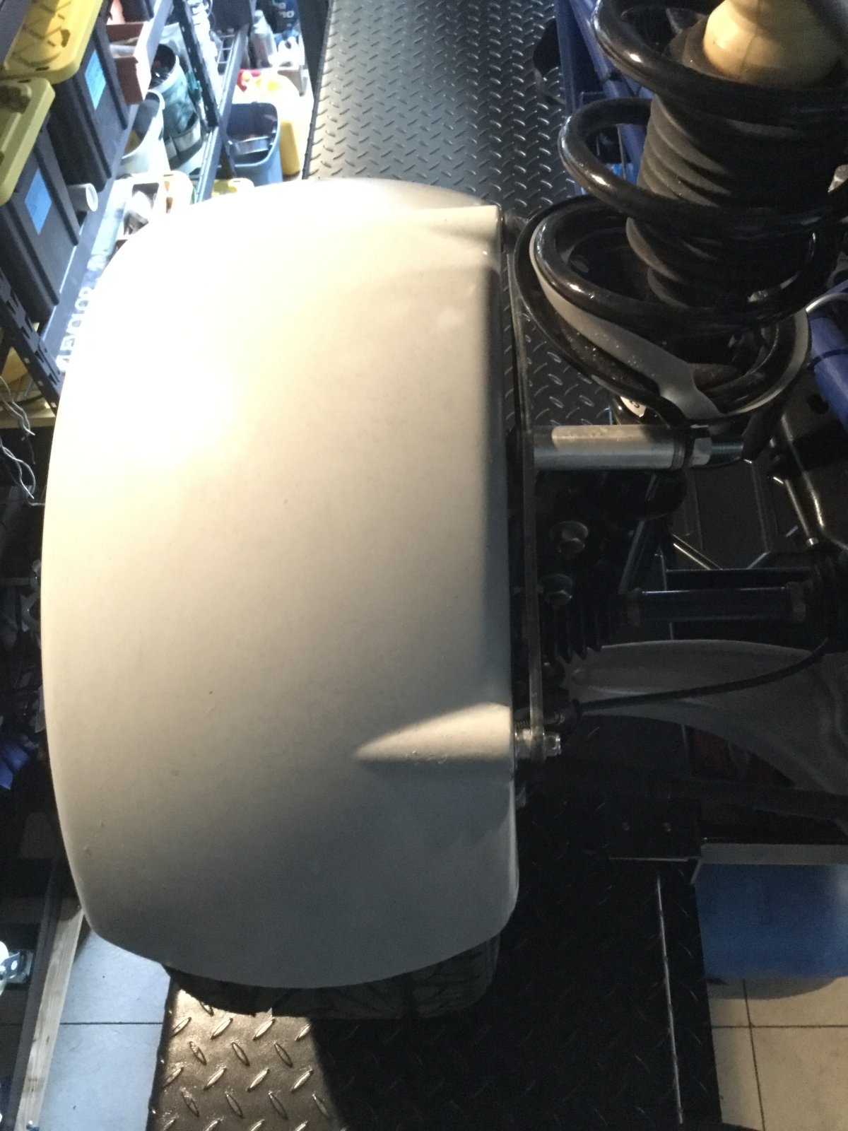

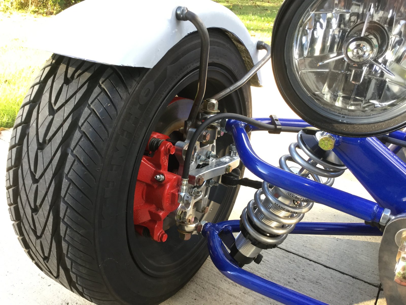

Anyone have an image of how the front fenders mock up? Obviously they connect to move with the tire while turning, I'm just not seeing anything that looks right.

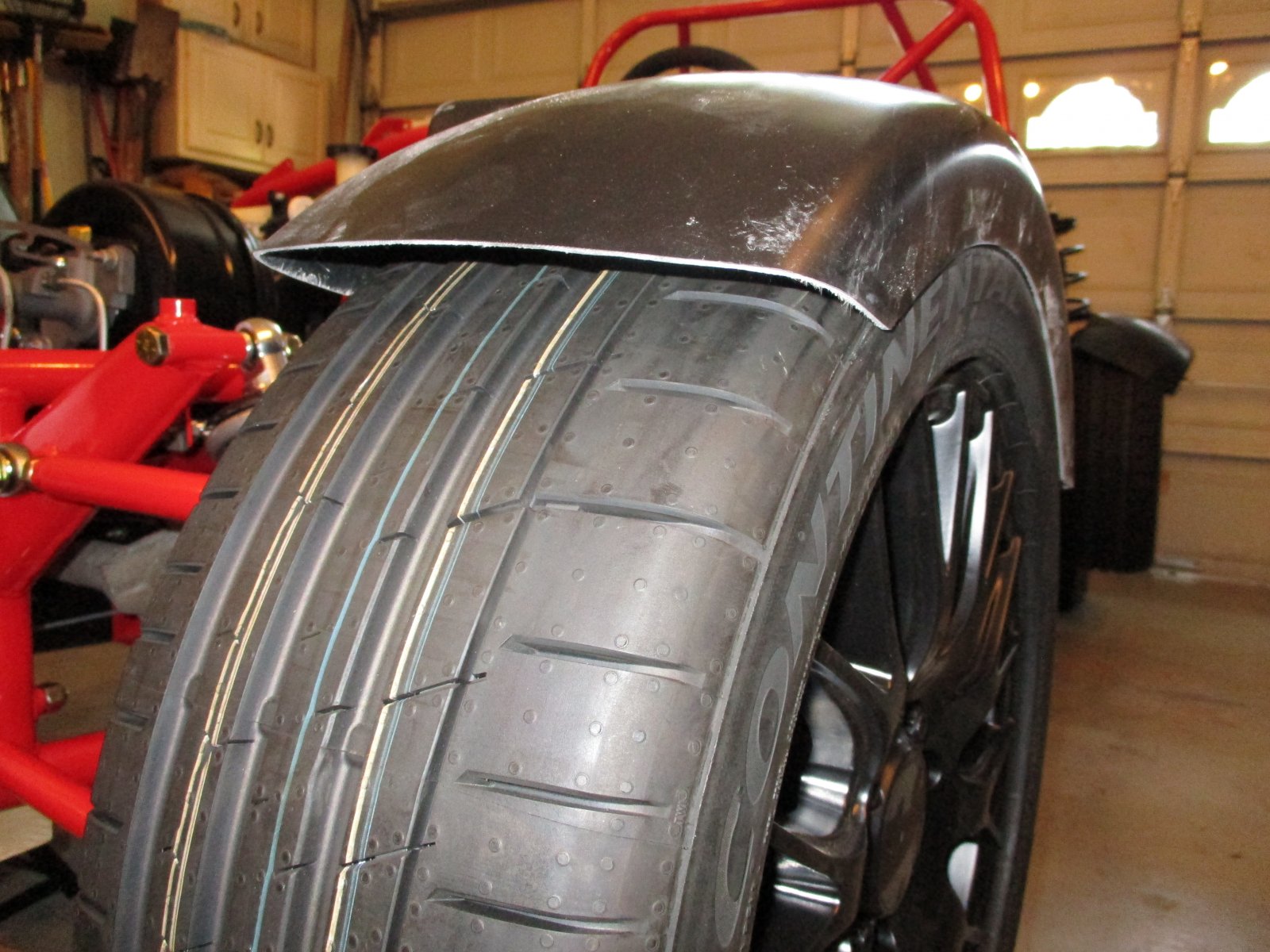

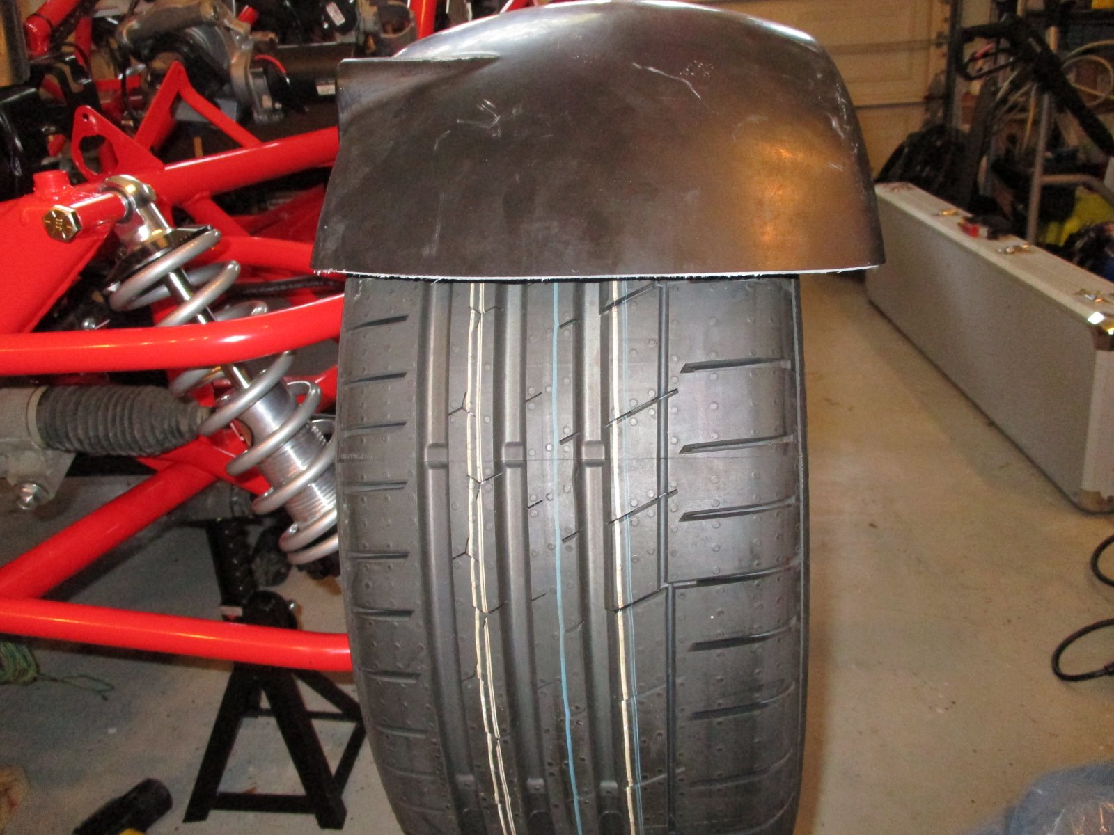

From http://www.dfkitcar.com/forum/index.php?threads/wheels-tires-and-seats-list.521/post-6635 it looks like the fronts are 195 width tires. Ours are 205 width and the fender doesn't quite fit as well and the wide fenders look too wide. I guess we could cut the sides down by 1/2" - 3/4" to get them closer to the tire... Any other ideas? (these tires don't come in 195 width)
