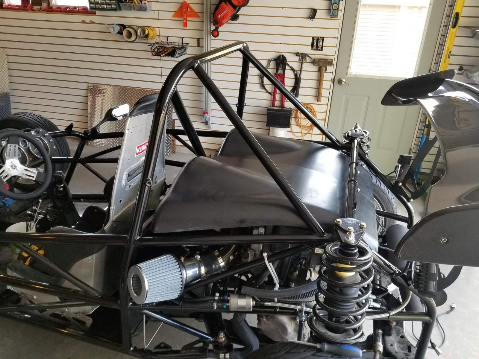

I sliced off the stock Plastic lines and swapped it out for black braided fuel line with fuel clamps off the pump and installed the QD fittings direct to the other end.
Edit here's the post: https://dfkitcar.com/forum/index.php?threads/replacing-the-fuel-pump-hoses.567/
You can see the qd ends of my hoses here, my goblin is in in storage or I'd take u a better picture
