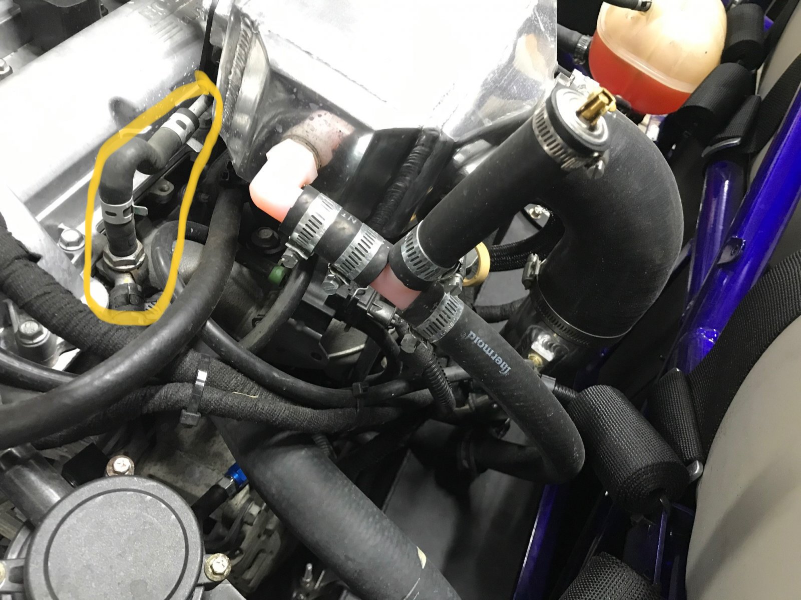

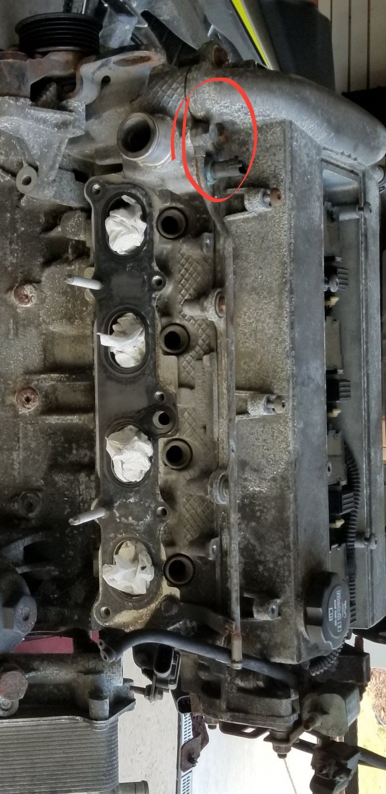

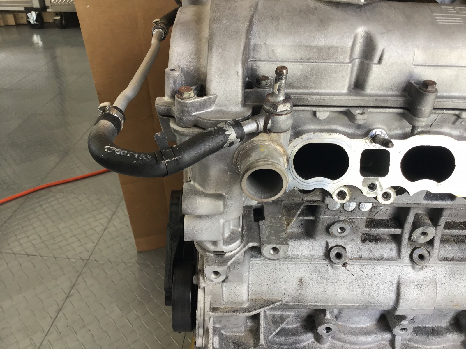

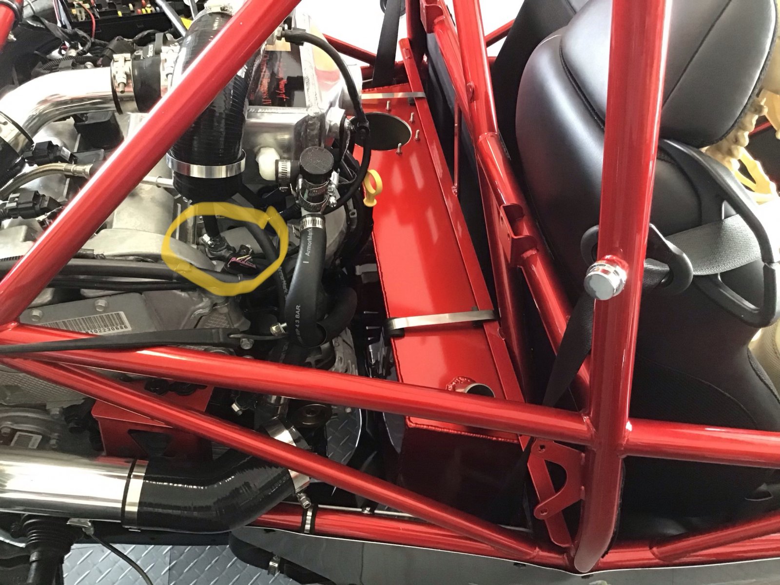

Here's where it is on the SC head. Found a picture lol, that lets u leave that coolant hose hooked up, and it'll fill everything from the radiator back and let all the air out on that side if u have it in the same spot on the tc
Hook up a blow gun to this hose with 10 psi. and blow coolant threw system until coolant comes out of hose connection then that means you have coolant in entire engine, keep a close eye on coolant tank because it will sink down quick if you need coolant in engine, you don’t want air to get in coolant tank,
THIS IS HOW LONNY EXPLAINED TO ME HOW TO DO IT.

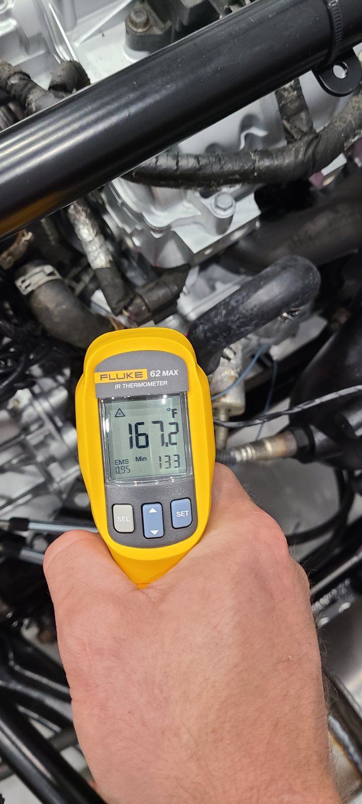

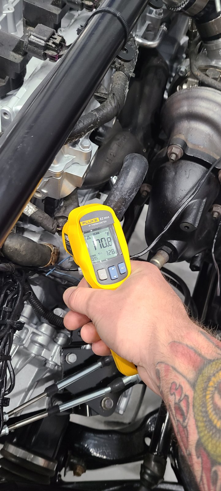

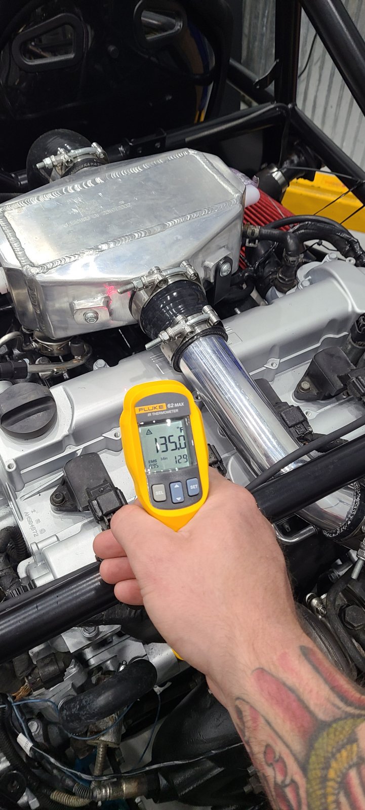

Hey guys I have tried everything I can think of to bleed the radiator and lines. I have used about a gallon and a half of fluid. Reservoir is half full I have massaged the line going through the frame and run the car to try and get the new thermostat to open but so far I haven't had much luck. I feel the heat coming off the engine and I can feel the radiator is really hot but the line from the thermostat housing to the radiator and the passenger side hose feels cool to the touch. What am I missing here?
Unclear if you have resolved this issue yet or if i am missing part of your concern here however when I first allowed my build to fully get up to temp I was surprised about how long it actually took to warm on both sides of the radiator hoses. 10-15 minutes to finally cycle the rad fan if i remember correctly I was concerned about air pockets also, finally I borrowed a cheap obdll monitor from a friend to monitor coolant temps. I think he said they were like 19.99 on amazon. My rad fan kicks in around 202-205 and brings it down to 195ish then shuts off. Others on the thread seemed to think this number was to high however I owned a 2009 cobalt for 5+ years and the fans did the same. Going on two years with zero issues. I will say that i rarely hear the rad fan kick on unless i am really beating on the thing! ;) temps stay 170s-180s cruising

Working with my son on his goblin. Used Bluetooth OBD2 to watch the engine temp. Got to about 210 and the fan never kicked on. We shut it down. Tested the fan directly off the battery and it worked fine. OBD readout showed the temp gradually rising so I think the sensor is good. Any ideas how to troubleshoot?

You can jump the radiator fan relay and see if that will turn on the fan. (Like the way we jumped the fuel pump relay when we emptied the gas tank) That would have helped find PyroGuy923's issue.
If the fan relay is working, then the only thing left is to get a signal from the ECM computer, which can be switched on in HP Tuners to test your ECM.

Turns out we had not connected the blue wire near the fuse box to the old radiator connector blue wire. Did that and the fan kicked in around 205. All seems to be working well now.
