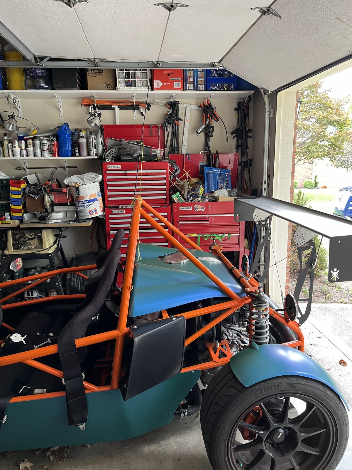

So I decided to see if my 9 Lives racing wing was truly working. I set a small experiment to check the airflow to the rear wing. I used a flexible drill bit used for fishing wiring as my measurement tool to see what height was needed to get airflow to the wing.
Let me tell you about my car. It is an extended chassis with the higher rollbar. The windshield is stock DF at 10” high and raked at 8*. The top of my roll bar is 50” high from the ground. My ride height is approx 5”. My wing stands are DF at 41.5” and the top of the wing currently sits at 47” high. I used yarn that extended to the front of the wing.
I started testing at 40-60mph. See the videos for visual evidence.
55” - complete mess. The yard flew back into the cockpit and became a tangled mess.
No video.
57” - tangled
58” - yarn moving a lot in all planes.
59” - yarn starting to straigten but arching downwards.
60” - starting to straighten more.
61” - better
62” - better yet
63” - Yarn straightest yet and moving mostly left to right.
Now note, the height of my wing is 47”. This tells me my wing is functionally useless. From this quick afternoon test - I need to icrease the height of my wing stands 16”. WOW. Here is a side pic of the car and where the yarn is denoting the needed height of the wing.

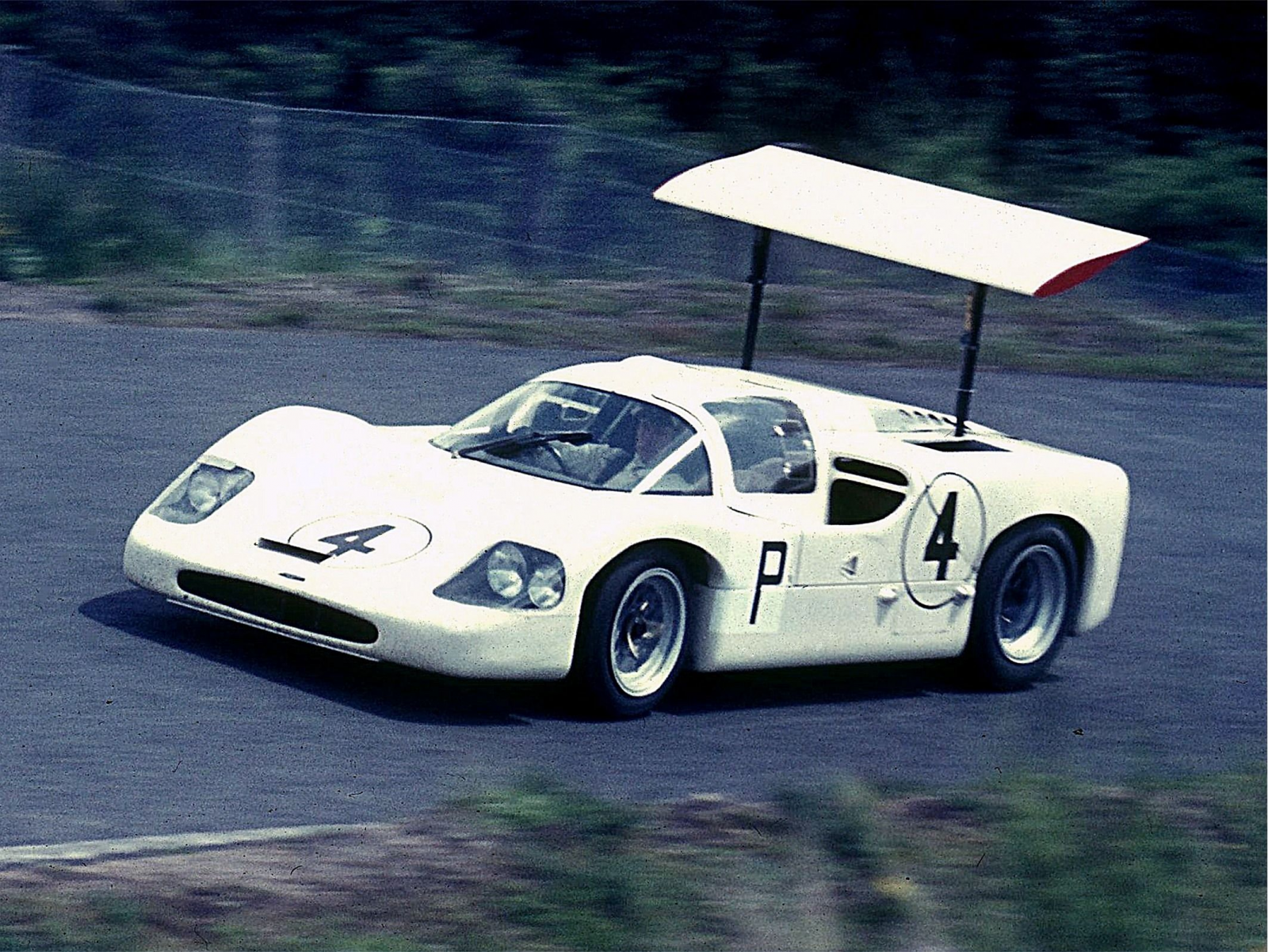

Good experiment and telling results. I would have to assume that angling your windshield more may help with a little less turbulence over the top of the b-pillar - maybe have straighter air an inch or two lower. But having passengers with heads and shoulders in the airstream, along with the round frame tubes top and sides, there will be turbulence within the nominal area that a rear wing will be mounted. Add to that the chaotic air in and around the engine bay and there is little airflow that can create downforce at legal street speeds. Maybe the outside 6-12 inches of your wing might be clean enough? But yes, to find clean air would raise your rear wing very high - ala Chaparral:
