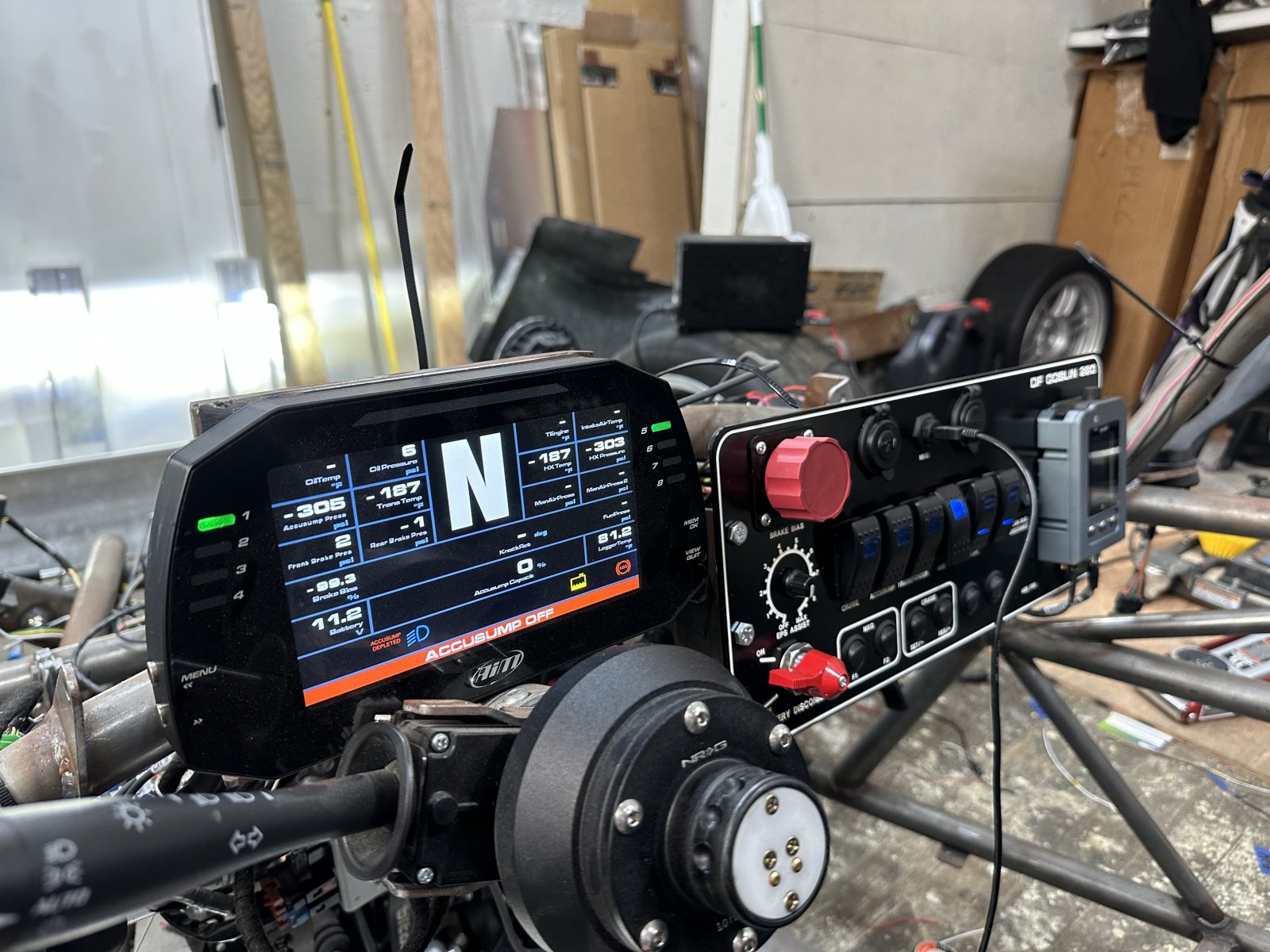

How hard was that to wire up? I'm thinking of going haltech dash when I turbo my car.
I guess it’s a bit relative.
Getting the ECU data is pretty straight forward, you just tie into the CAN BUS.
Getting all the other lights like turn signals and high beams is a bit more complicated as they are on a different CAN and AIM hasn’t made a program for them. So you need to individually tap into each wire.

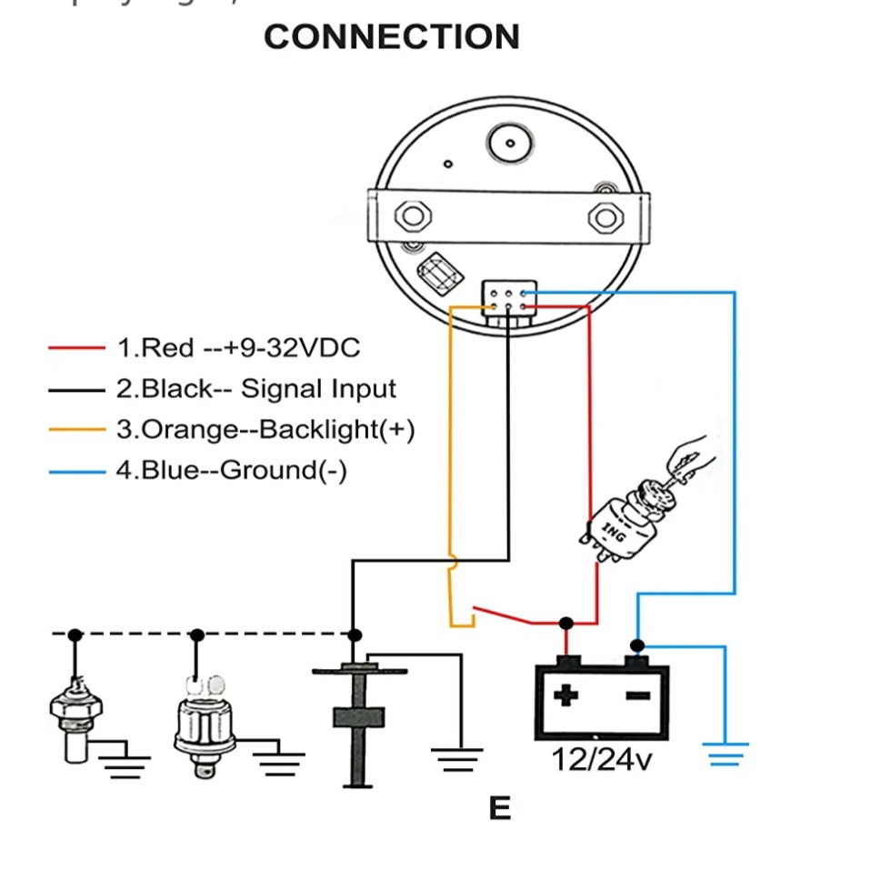

After staring at some wiring diagrams I found a fuel level sensor signal wire (purple) going from the fuel level sensor to pin 36 of the ECM. Can I just tap this purple wire to get the fuel level signal?
I am speculating here... but doesn't the fuel level sensor go to the PCM, get converted to digital, and sent via the high speed can bus to the BCM, then transfered over to the low speed bus to the instrument cluster? Taping into the fuel level signal would not be the same as the instrument cluster is expecting for fuel level signal.
P
I believe the signal type the gauge is looking for is actually ohms. Here is the wiring diagram for the gauge. They make it look like you connect directly to the sensing unit.
Newer models at least use variable resistance sender. Purple wire will be one side. The other side is grounded through the ECM and is a shared ground on the LNF. I would find the diagram for your donor and if it’s not a shared ground, I would try just the purple. If it is a shared ground through the ECM, I would probably isolate the sender ground and chassis ground it. It will probably work without the isolated ground anyway though.
