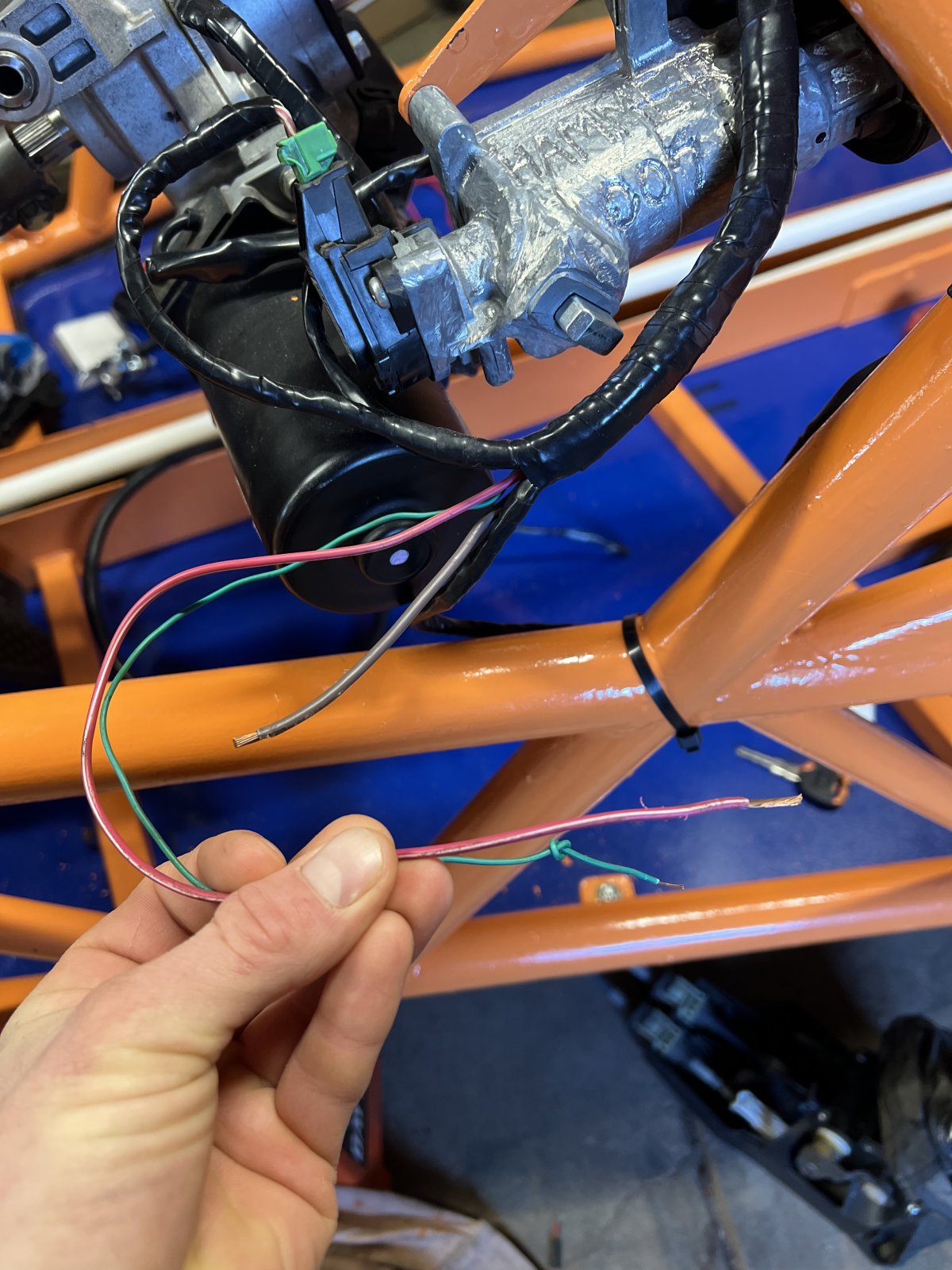

I have a 2008 TC harness and there is a thicker gray, thicker red with white stripe, and thinner green wire coming from the dash harness near the ignition, anyone know where these come from or go?

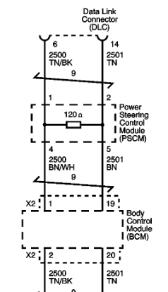

Pretty sure those wires have nothing to do with ABS. I don't recall what they are, since I did my harness almost 4 years ago now, but I believe they are addressed in the wiring videos.
No throttle body movement means no data flow to the ECM. Trace your data wires (tan and tan/black twisted pair) from the OBDII port all the way back to the ECM, check continuity. Note, they change to brown for one step of the way, for some reason.

Do those go to the little sensor around the key hole?
I'm going by some old photos and I have a red or pink, br/wht, and gr coming from a bundle heading toward the ignition switch. I can't see where it connects going by the photos though. I can look later after I get home from work.

Two wire colors match up, but not the grey. Grey is used for the cruise control wiring, and dash illumination, but those would be smaller wires. That's not a brown wire is it?
escapepilot
That grey wire has me stumped. The color seems wrong - too dark - and it seems to be a different strand than is typically used in auto wiring. It may just be the pic, but it reminds me of the typical spool of wire you get at Lowes.

So if it's brown....
45273
One of the CAN wires is 0.5 brown (odd the rest are TN and TN/BK). And is at the power steering module, so in the ball park. If that's it, could explain the no start, as the network is incomplete.
Thanks for calling out the tan to brown pair change. I had seen it but didn’t really notice what I was looking at. I thought the twisted pair browns were doing something else. Good to know.
It looks grey idk man I just can’t believe I can’t the thing to fire just stumped at this point
Idk it looks grey to me it’s looks too light to be brown. Idk what else to check at this point I’ll take all the wiring off and inspect it and see I can figure something out outside of that just confused on if I did something wrong, all good I’m sure I’ll eventually figure it out or I guess I’ll have to get another harness thanks for your help everyone.

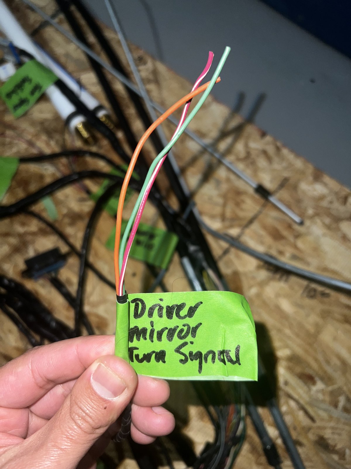

I have my harness in the basement somewhat unwrapped. I have the green and pink with a white striped pulled near the ignition like you do and labeled “driver mirror turn signal” I have an orange wire with them though. I’ll try to watch through the wiring harness videos again and see if I can remember pulling them together.

Yeah thanks for checking I have the turn signal wires squared away but unless I was supposed to cut the others in my picture out I’m not sure where they go
