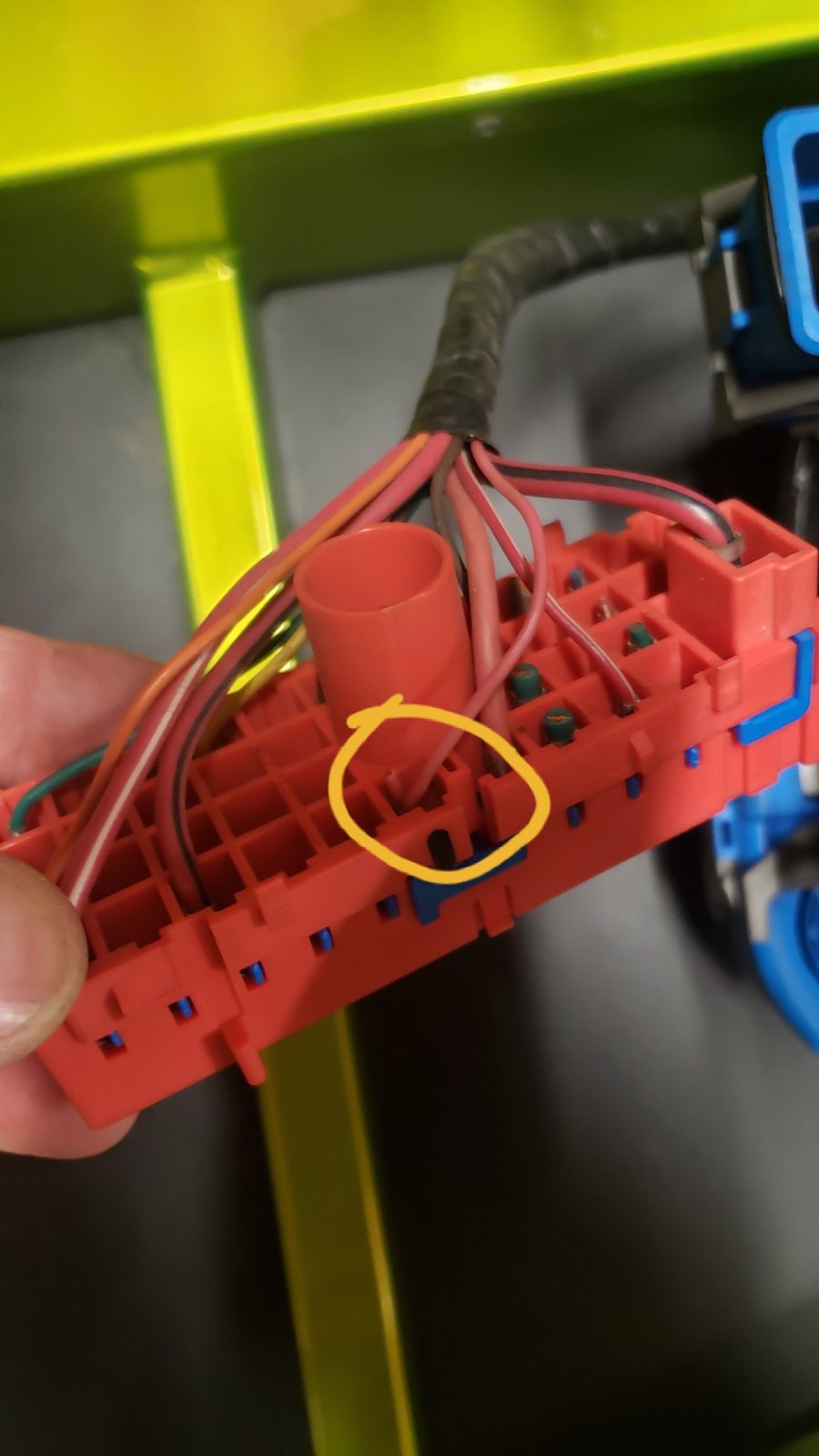

Wiring is definitely not my strong suite. I'm trying to wire up a heat exchanger fan for key on operation. Lonny has laid out where to tap into the bcm plug to get power. It is 2 wires that get wired into one. But one of the wires in the terminal in my BCM plug appears to be used on something already. The second one is cut. The harness was assembled by DF, so I don't know what it goes to.
I'm running a heat exchanger in the engine compartment, so I will be running it to the back of the car. Is there a different terminal I can tap into that will be powerful enough for the fan?

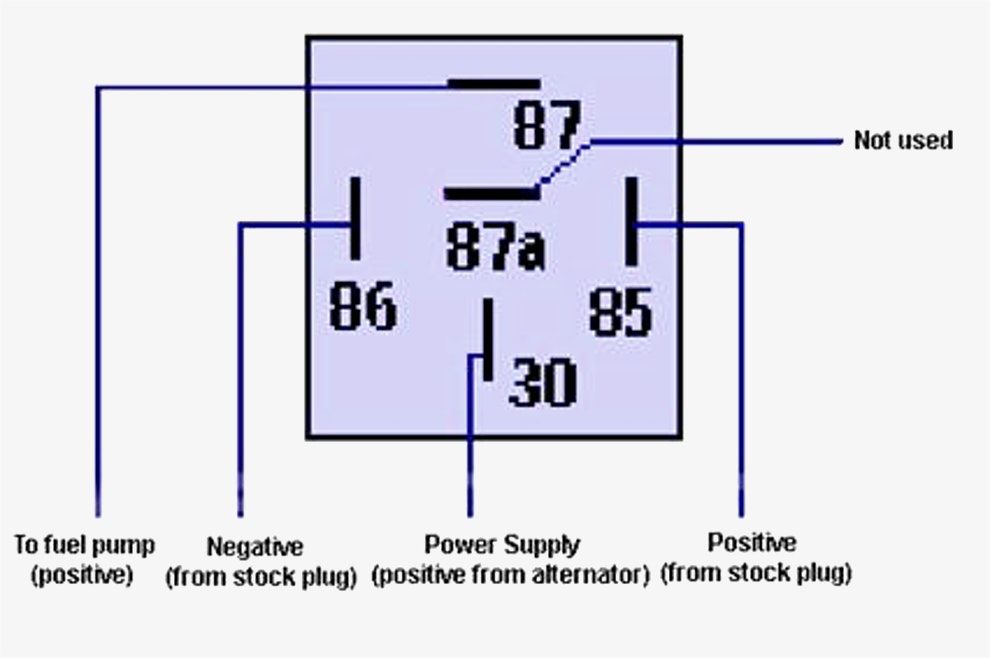

You could build a relay, and use the ABS circuit/fuse as the trigger to activate it since it is still being powered when the key is turned on. My heat exchanger pump and fan were a slight after thought when I had built my Goblin.
Yes. That can be a trigger for a relay. You can use a “Bosch” relay or a 4 prong. I need to find my little tutorial I made years ago, but basically you have 12v power in (from batt). 12v power out to fan (when triggered). One ground and one ignition positive to trigger the relay. Don’t be afraid of them, they make life simple.
Here’s a diagram for a bosch relay.

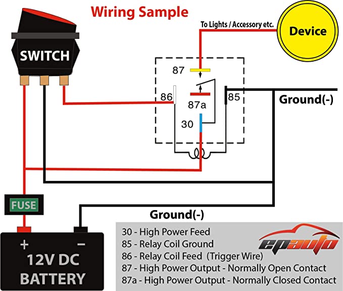

The relay will power the fan and pump when activated by the trigger, which would keep the amperage draw on that wire down. You can easily buy a small 'add-a-fuse' plug at Autozone to tie into the ABS fuse. it help keep all the wiring in the back without needing to run it through the tunnel, or worrying about where that one wire goes to. Building the relay is a very simple process.
If it was a low amperage item being added (like led lights), just adding the wire would be fine, because the bcm can handle it. Adding a higher amperage item like a fan, it’s best to add a relay so it handles the load and the bcm is nothing but a trigger. I did the same thing to mine because I added a larger inter cooler fan than DF provided.

I'm not sure that the work required to rewire it to try and use the existing relay is worth the effort. What is your control scheme for cutting on a heat exchanger fan. I have mine set up with a 5 pin relay to come on with ignition power on the normally closed portion of the relay, and a switch to open the relay if I don't want the fans to be running (with a bright red light on the dash as a reminder that it is off). You can get a (5) x 5pin 30a relay with pigtail for less than $12.

On second thought, I think I ran the ignition on positive through my switch NC contacts and used that to close the relay, and did not use the NC portion of the relay. Push the switch and it swaps to NO contacts killing the relay and powering my warning light. I don't remember what circuit I used for ignition on power. I used one of the OEM circuits that closes aa added relay that then feeds a mini fuse box to power to several circuits. The load side of the relay is powered directly off the jump post at the fuse box with an inline fuse.
