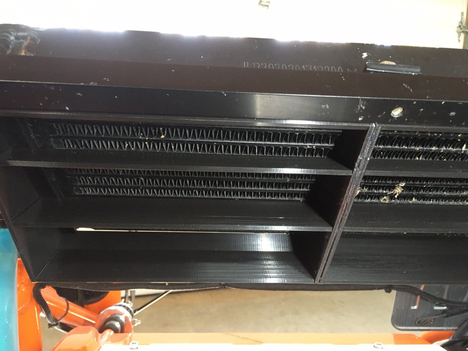

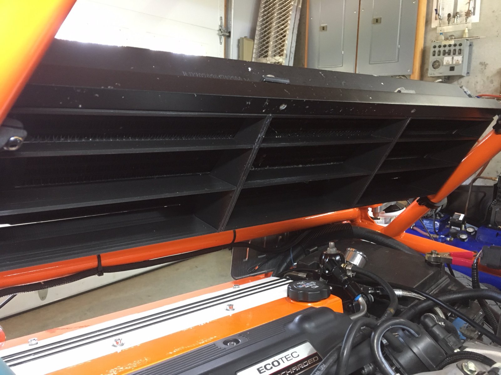

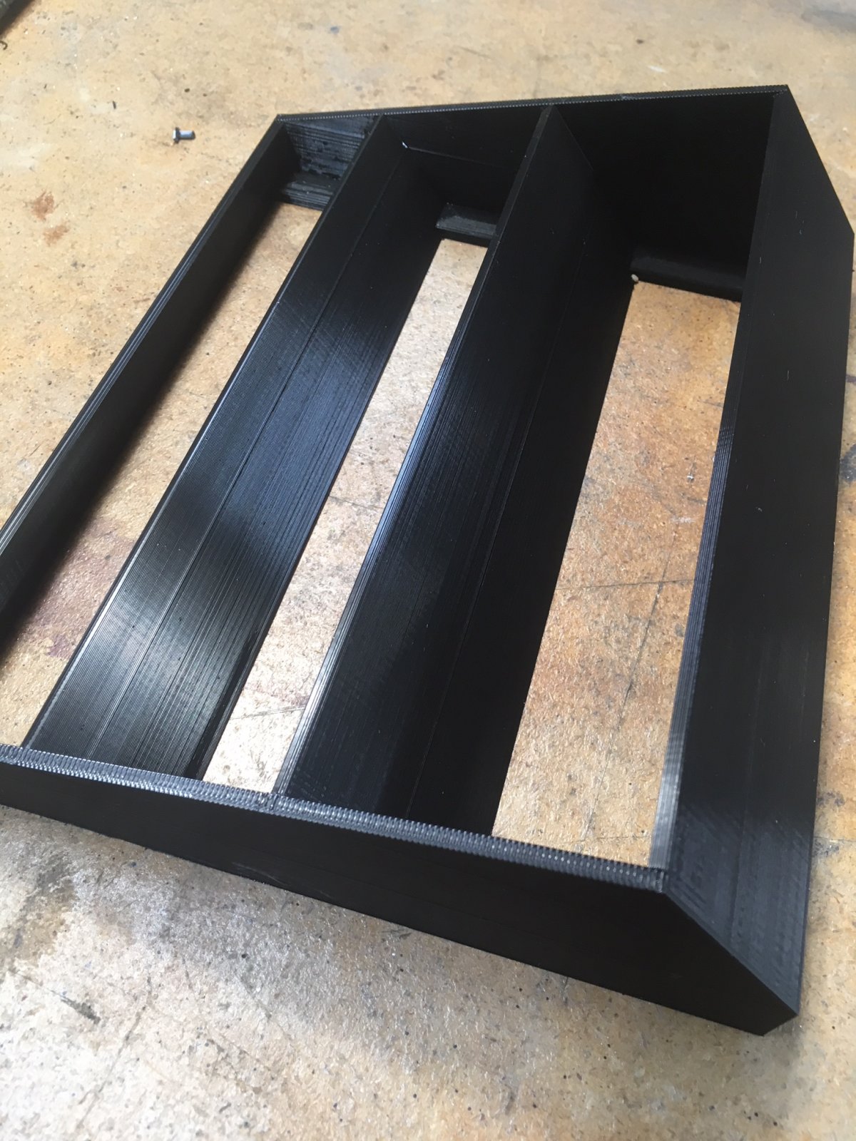

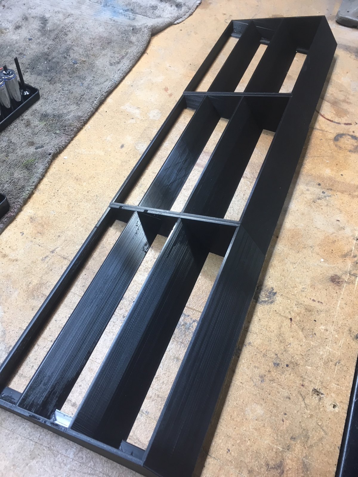

Since we lowered and changed the angle on the heat exchanger, I wanted to make sure that we weren't loosing out on cooling. Kaleb designed and 3D printed louvers to catch the air from blowing under. He printed them in three sections and I epoxied them together and installed. I really like the way they turned out. Once again, the 3D printer to the rescue!
Pay no attention to the bugs, they weren't part of the design.
