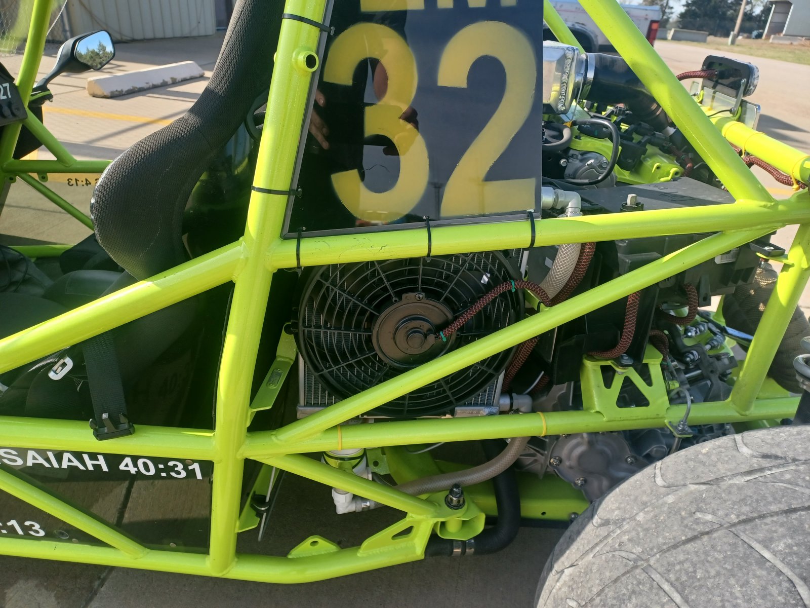

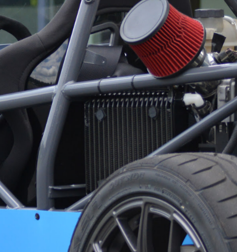

I don’t think this guy has posted much here but saw this on Instagram, looks like he may have these mounted on each side?
pnv87SeJj
I suspect that Goblin 231 from Cicio Performance is running an oil cooler on the sides. You don't want too much cooling on those lines... but maybe not, as those lines go up front rather than towards the engine.
OK, side exposed and susceptible to physical damage from anything kicked up by the front tires - how about a big hunk of metal that you couldn't avoid? Takes out the tire and your coolant lines too. Running oil through those lines is not good, shear one off and you have seconds to get the engine turned off before it no longer has any oil pressure. AND you now have oil all over the rear tire(s), being sprayed at 60psi, and that is very dangerous if braking hard is required in the situation. At least with cooling fluid you have a minute or so to shutdown before the temperature starts to shoot up. My inner engineer sees too many bad things doing cooling/HE in this manner.

If you hit something that was going to take out those HX's, you're already in for a bad day.
What doesn't make sense to me is, assuming those are for oil, why run oil all the way to the front of the car to run those little coolers? Seems about as silly as turbo piping pre-coolers.

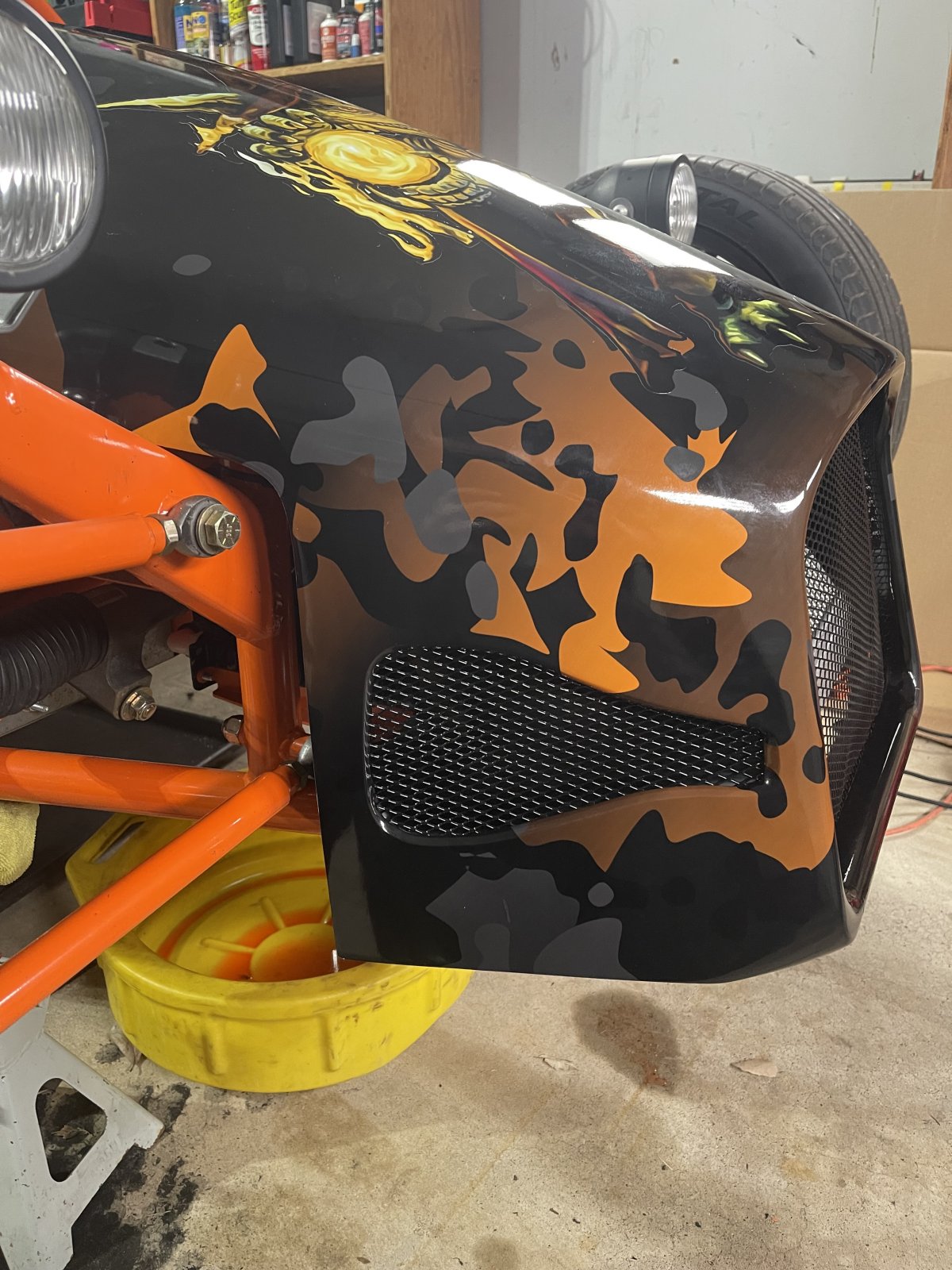

Figures - So now of course I'm brought to the question of: Which option is more effective? I don't particularly love the look those nostrils in the sides of the hood, but I also feel like the area where the heat exchanger will be mounted will harbor quite a bit of heat from the radiator...and then you just have a fan blowing hot air over the heat exchanger. Thoughts?
I mounted mine in the inside and blended them. I love the look

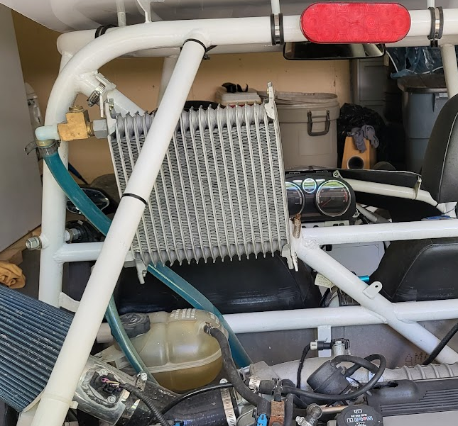

Permanently temporarily installed with zip ties, been there over a year. I am working on a 3d printed mount and duct combo piece, but it's not been a high priority for me lately.
Did you end up making the "3d printed mount and duct combo piece"? I am thinking of mounting mine on the side like this as well.
If you ended up making this, how has it treated you? Do you find it brings in enough air to the H/E? If it does, could I purchase one off of you?
