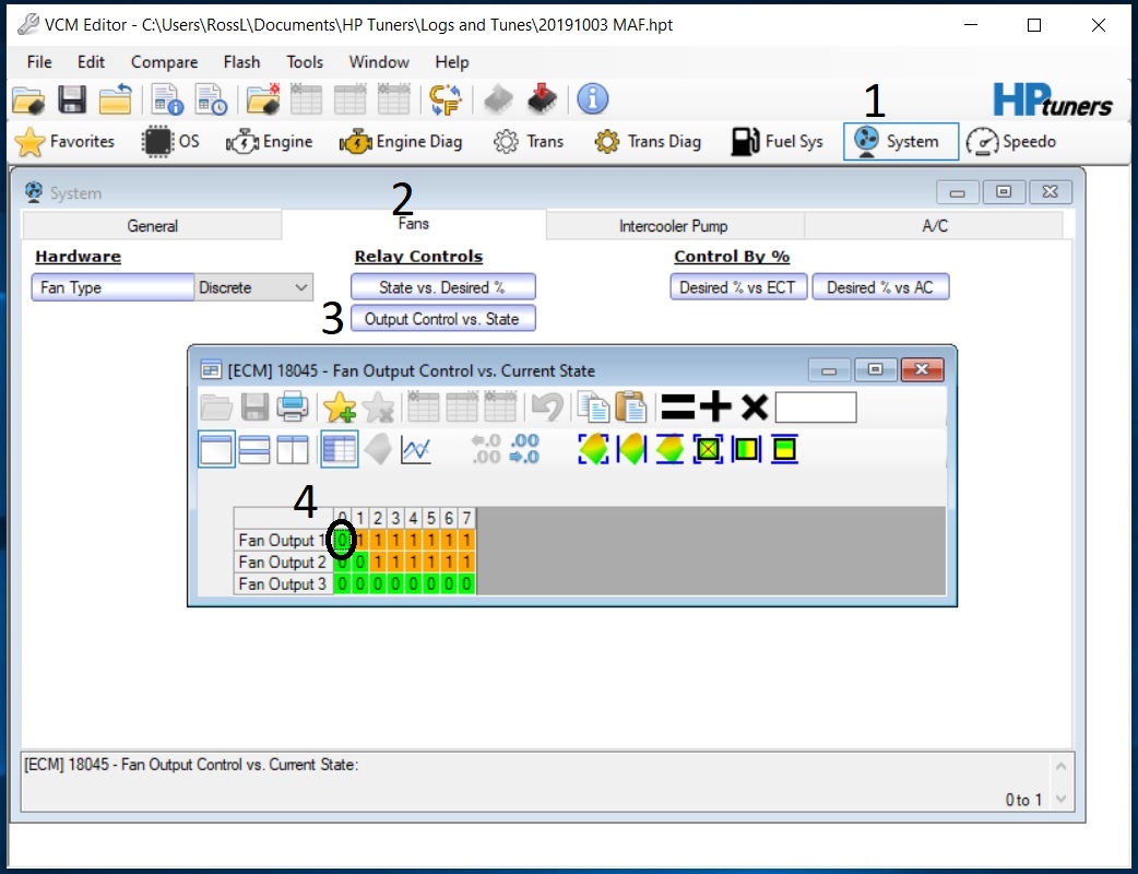

My radiator fan has never turned on by temperature.
I tested the relay, and it turns on, so the motor works.
Then I was playing in HP Tuners, and found that I could turn it on by changing the Fan Output 1, Current State 0, to 1 (step 4 below).
Fan Output 2 & 3 did nothing to the radiator fan.
10251
Once it turned on, I tried to turn it off by changing tables 1, 2 and 3 to "Fan Desired %" to zero..
but nothing I changed would turn off the fan. I had to go back to step 4(above) to turn it off.
10252
So HP Tuners can turn on the fan if the fan output is set to 1 for the current state of 0.
The fan turns on 100% full speed, no matter what...
Weird.
I don't know what to do next to fix this.
I don't understand what the "states" 0-7 are.
What does HP Tuners use to determine that the state has transistioned from 0->1?
My car doesn't seem to change states.
The front dash knows the engine temperature, and watching that, I have succeeded in getting the engine temp up to 210F, when the car is left idling while parked. Driving it brings it down to 180F. So the car isn't overheating, but it doesn't try to use the fan.
Any ideas?

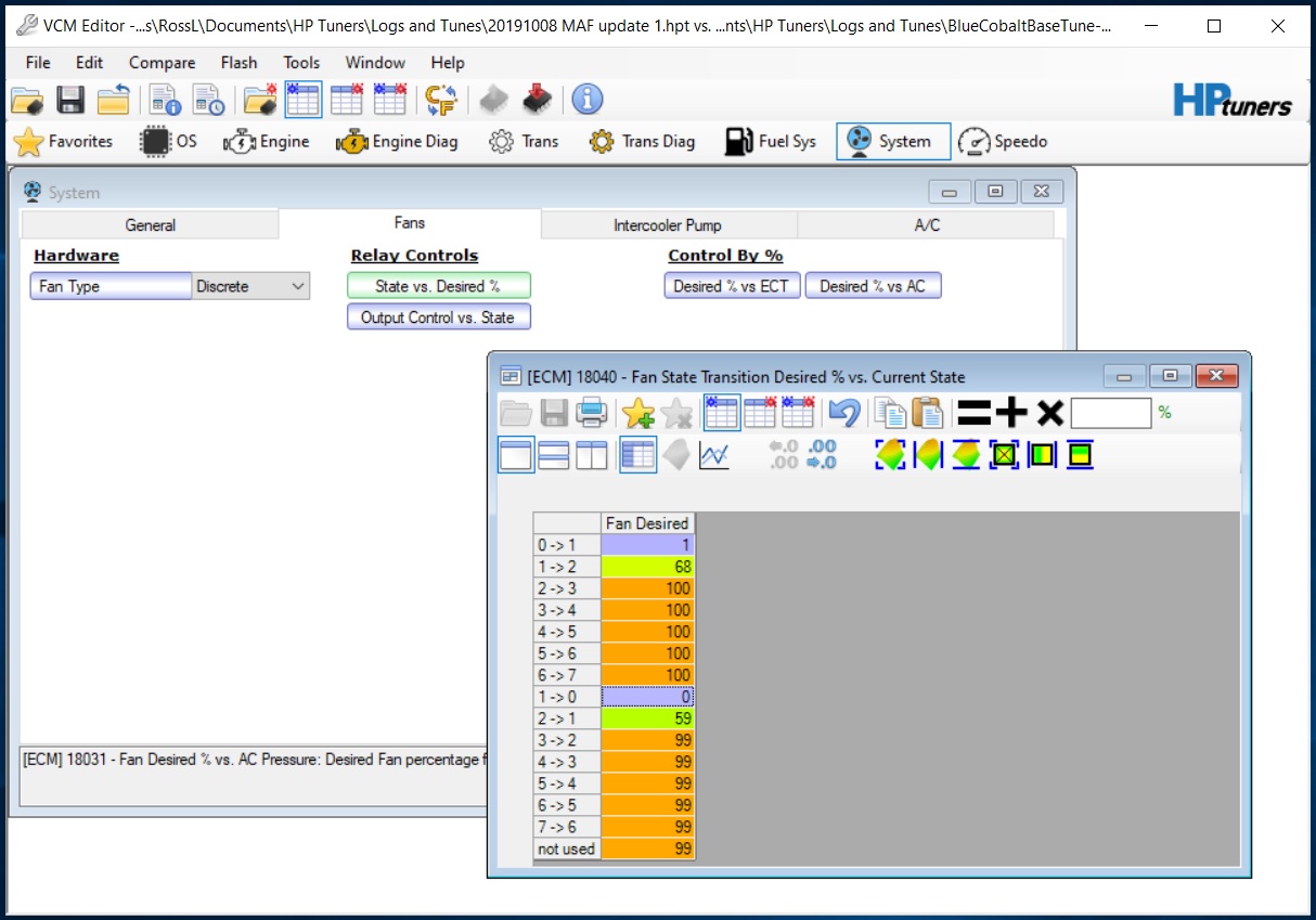

I could be wrong but I don't think the states 1-7 do anything. I think the fan is either on off. I only say that because the turbo fans are put into low speed mode by putting the two in series with relays. High speed mode is when they are in parallel. There are no other in between speeds.
From what I'm reading the LSJ fans kick on around ~220 F. When the temp gets that high, the fan desired is around 53 which changes the state to 1 which kicks the fan on.

So my "Fan Type" is set to Discrete. I wonder if all the extra tables are for when "Fan Type" is set to Pulse Width Modulation Electric?
I'm curious to know if PWM would even work. It's possible that the software fields are showing options that aren't even supported by your particular ECM. I bet PWM won't work.

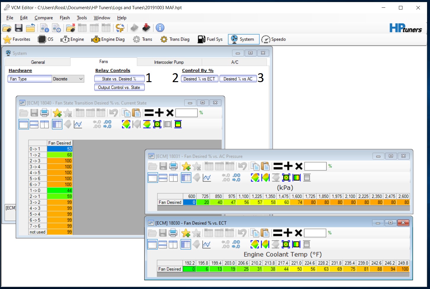

You could probably test your fan coming on with a temp input by changing your 0->1 fan desired from 53 to something like 13. That should make it turn on around 200 F.
Interesting. You correlated the 53 to the ECT table. I'll try setting it to 0, and see if it turns on at 192F.
The ECT table description:
[ECM] 18030 - Fan Desired % vs. ECT: Desired Fan percentage for a given engine coolant temperature.
I was thinking that Fan Desired % was the percentage of fan speed,
but maybe it means percentage of thermister resistance for a given engine temperature.

My fan works!
I'm not sure why Chevy set the stock fan temperature to turn on at 223F, but I was able to reduce it to 192F, and it turns off the fan at 173F.
So my wiring has passed the fan test. It was just a setting issue.
