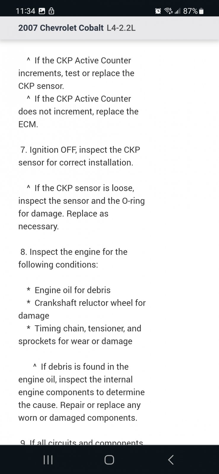

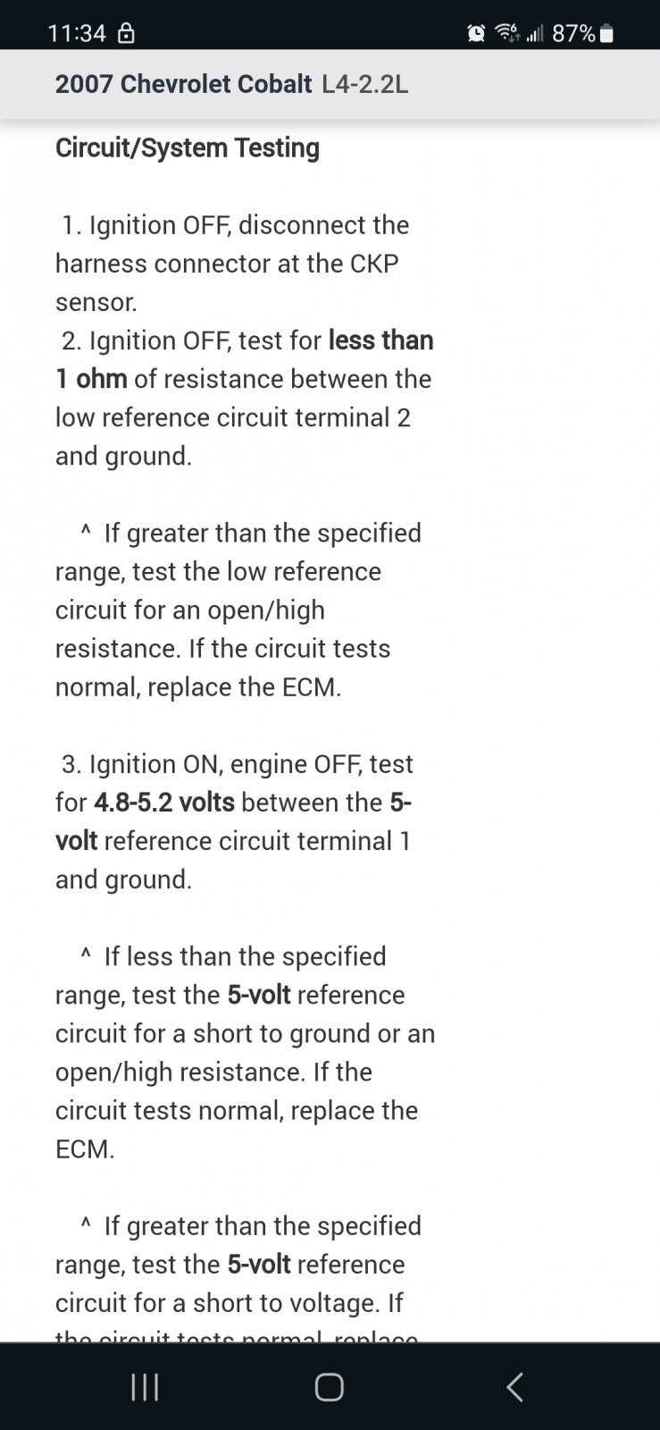

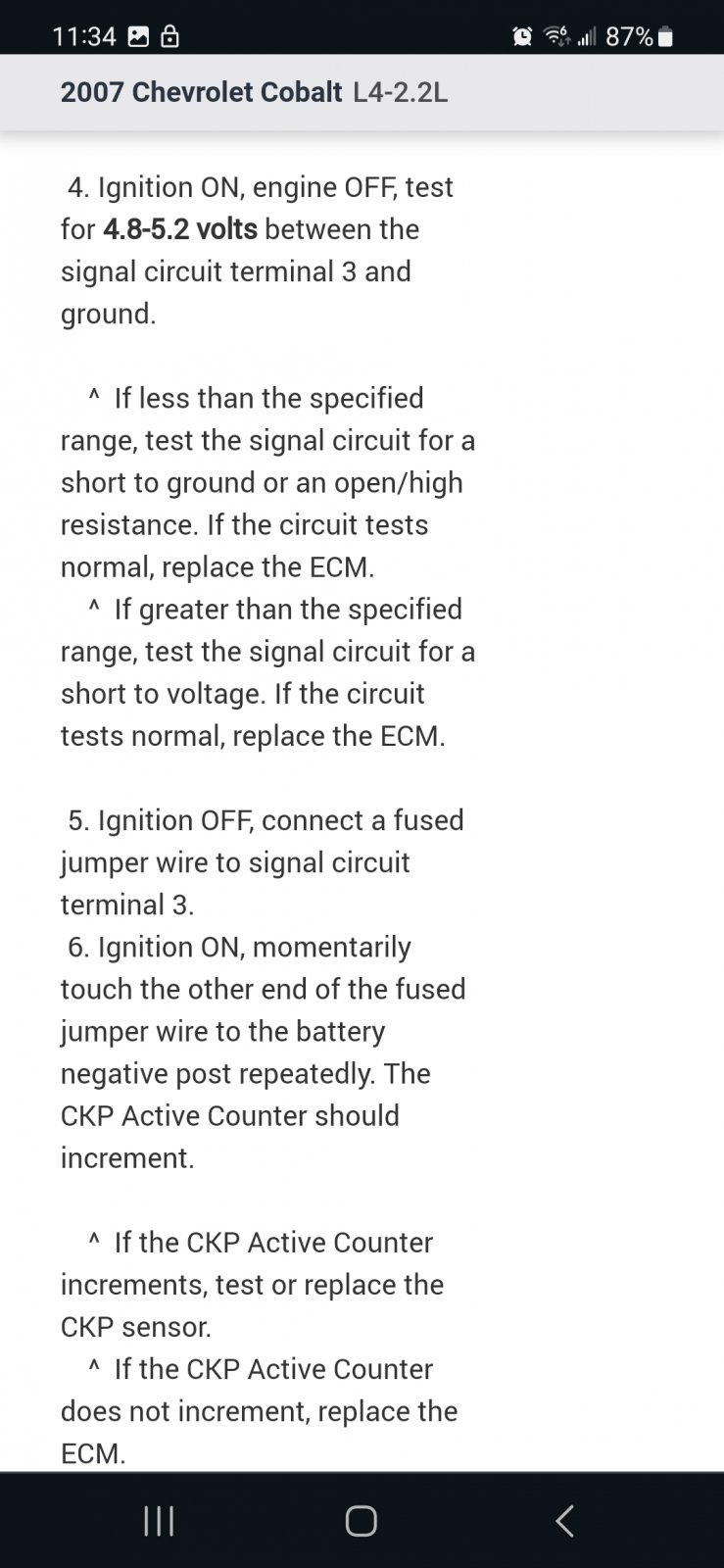

I went down the rabbit hole trying to get this fixed. Attached is what all data mentions to do for narrowing the problem down. I went through this and I'm still not any closer to solving the problem.

Well it's not a hpt problem it seems to be car problem. Not sure where to go from here everything on all data checks out
R
Start over on what your problem is? Is HPT not reading data or is the ckp not registering? Any dtc’s? Tach working?

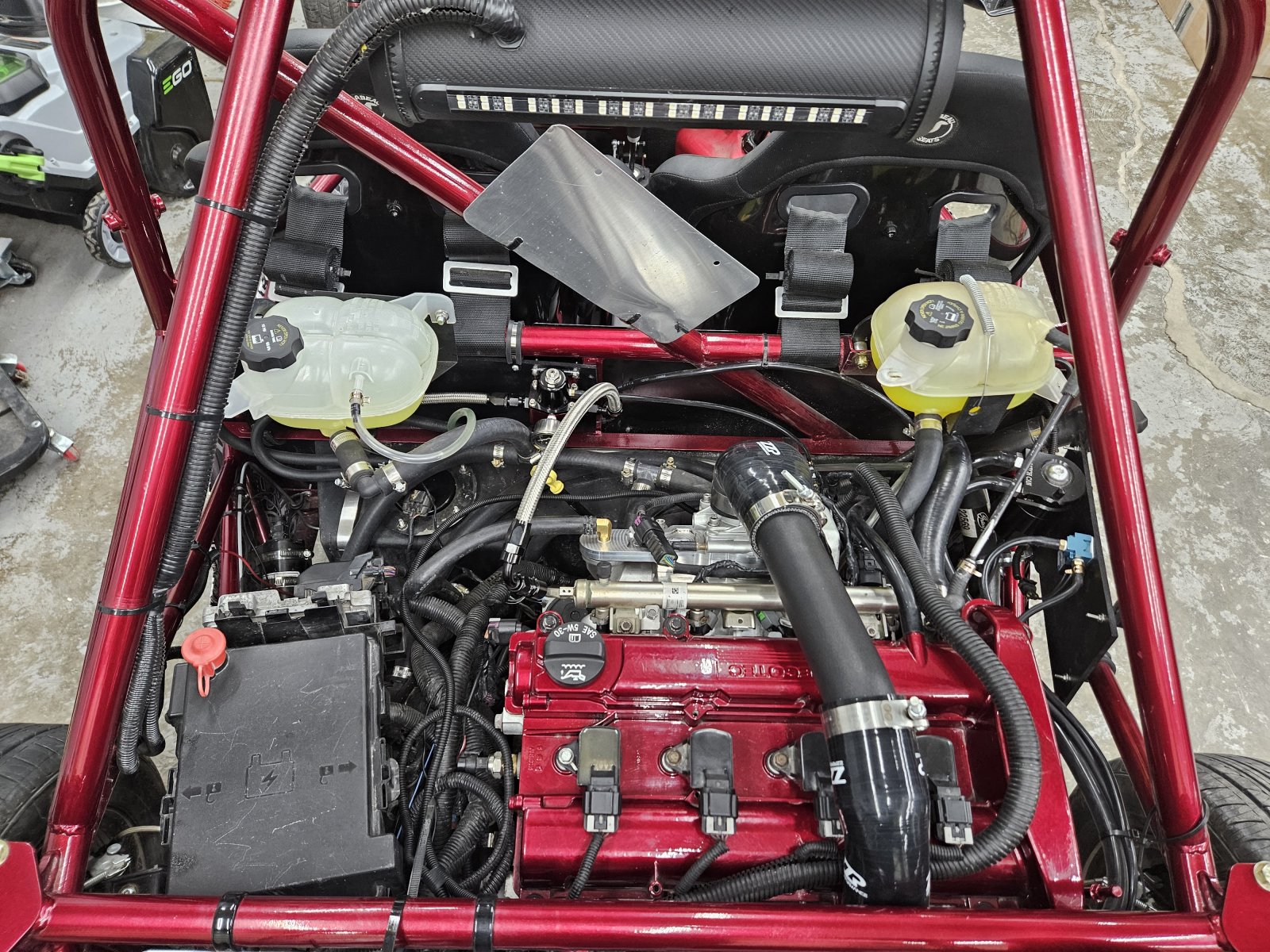

The problem didn't end up being an hpt problem. I wasn't showing anything on tachometer or hpt. Ran down the path of a ckp using all data I checked everything. I ruled out it being an ecu problem. Which was a concern. (I welded on the exhaust with the battery connected) I swapped out the ckp sensor and also noted my maf was flipped around somehow and it started right up. Thank goodness! Time for a dyno sessions tomorrow. Hoping for 300whp out of a hodge-podge setup!
