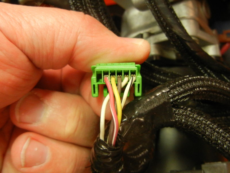

Any have the pinouts for the ignition switch? I have figured out all of them but the YELLOW.
Looks to be identical to my '09.
Pin 1 Not Used
Pin 2 Battery Positive Voltage
Pin 3 Run/Crank Voltage
Pin 4 Accessory Voltage
Pin 5 Off/Run/Crank Voltage
Pin 6 Key-in Ignition Switch

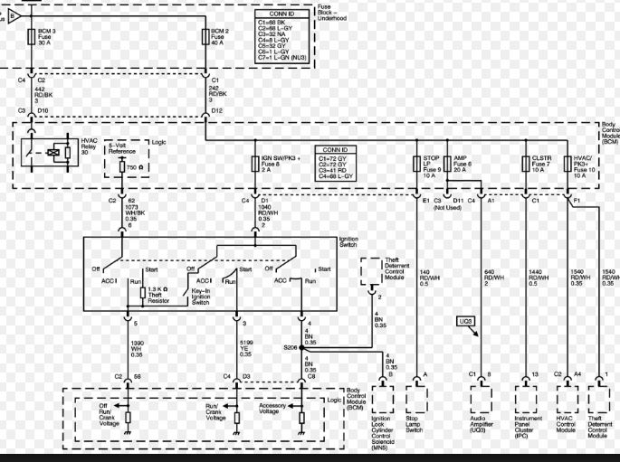

I finally found a schematic on deep on the web and unfortunately there is a lot more to the ignition key system. This is making the push button start system more difficult than hoped. I'll make it work, but it won't be as easy as just hooking up a few wires. The 1.3K theft resistor is getting in the way along with the 5V reference instead of a simple 12V switch.
