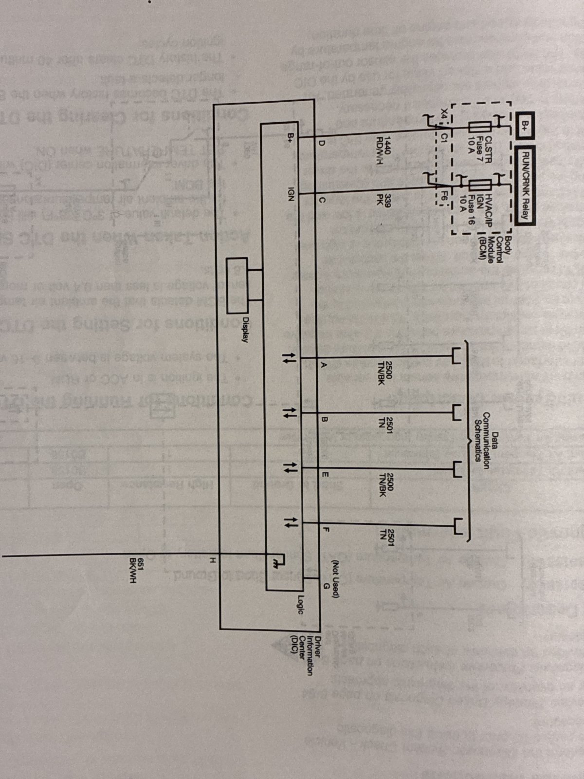

Anyone have any idea about the RPD wiring? Previous owner thought the display was broken, but I was able to troubleshoot and bench test it works fine. I was looking at the power source and it seems to be wired into my headlights? Is this the normal setup recommended by DF or should I rewire it so it’s ignition on instead?
Wiring diagram
