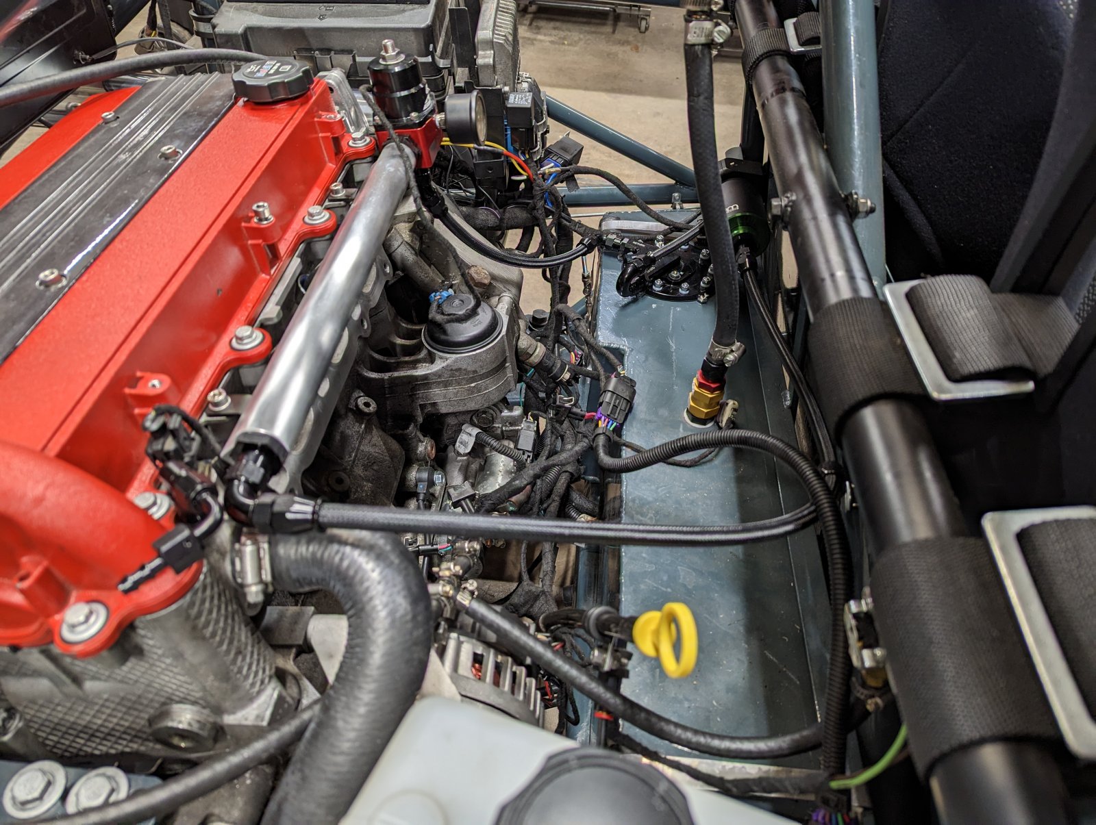

I have a boost referenced fuel system. I'm not running 80# but I am running 60# injectors. This is my tune at the moment (for the most part). You should have to tune the VE table and the MAF from here. You'll run a bit rich with this tune, but should be a good start.
