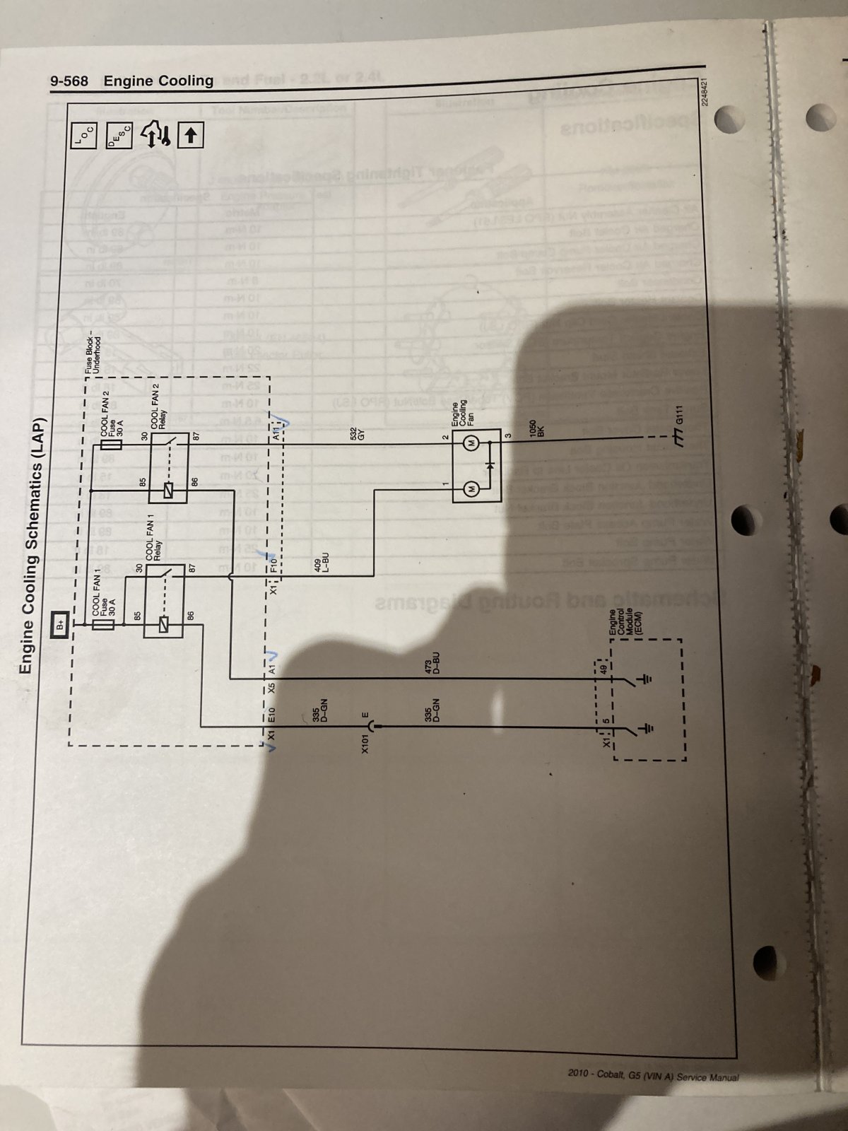

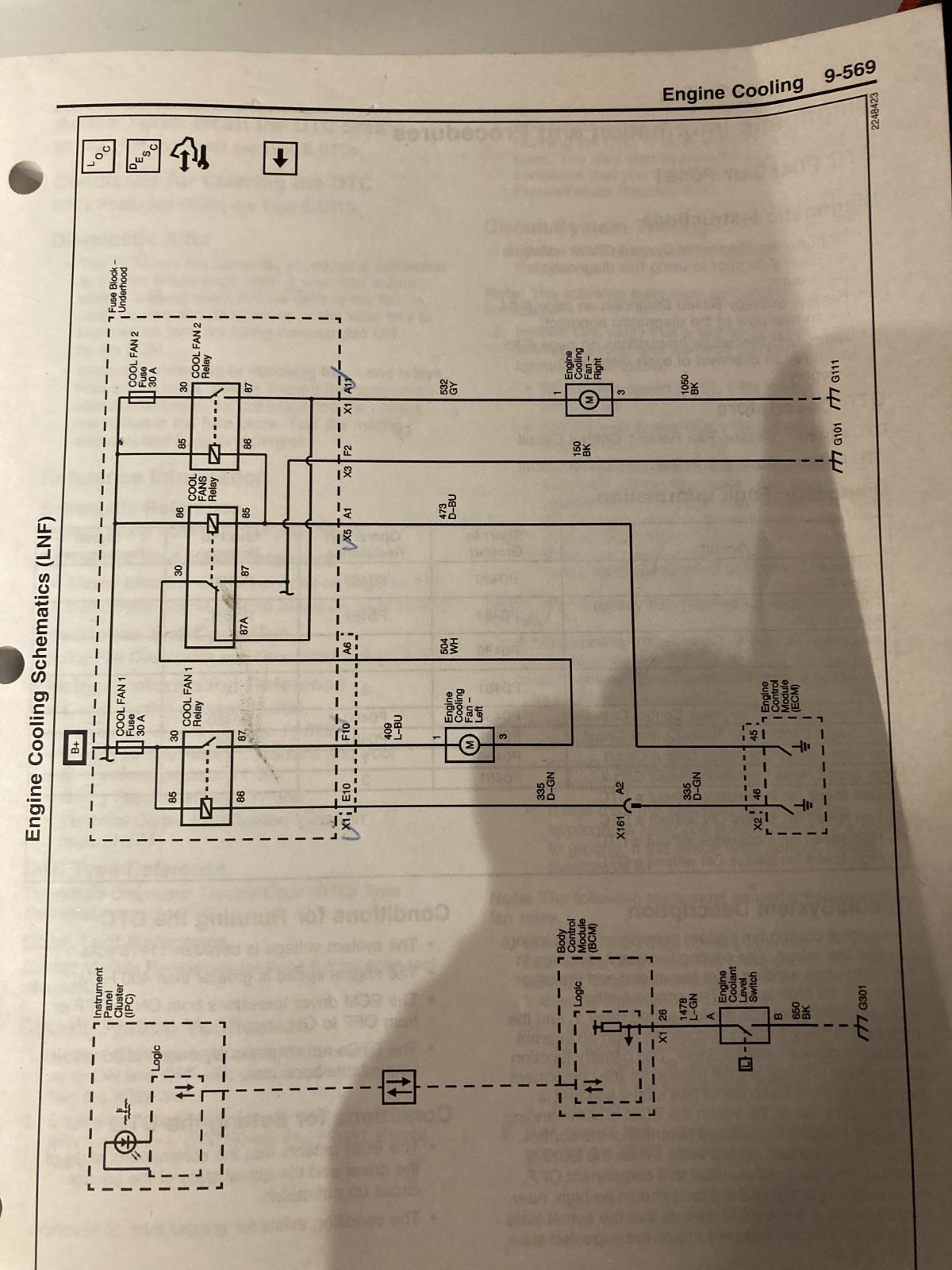

Wondering if it would be okay to wire in the intercooler fans to the second radiator fan plug or if this is a bad idea?
The wiring to make the two fans function at high and low fan speeds is sort of complicated, at least on the turbo. It might not be as simple as wiring it and go. You will have to make sure the 2nd ECM ground is still in place, and it might take an adjustment in the tune to make sure it cuts on early enough.

Yes that would be easier. You probably can find an unused accessory relay/fuse circuit already on your car, and repurpose it. The stereo amp maybe? Maybe fog lights? Rear window defroster?
jayrolls
Does the fan have to be controlled by a relay? I am still working on trouble shooting my radiator fan not turning on. But will if I jump the relay. I am thinking about just running a switch if I can’t get it figured out.
Check and see if you have the ground on the control of the relay running to the ECM. If you are jumping the relay, and it works, the hot side of the relay control probably has power and then it can either only be a bad connection on the ecm or a bad relay.
