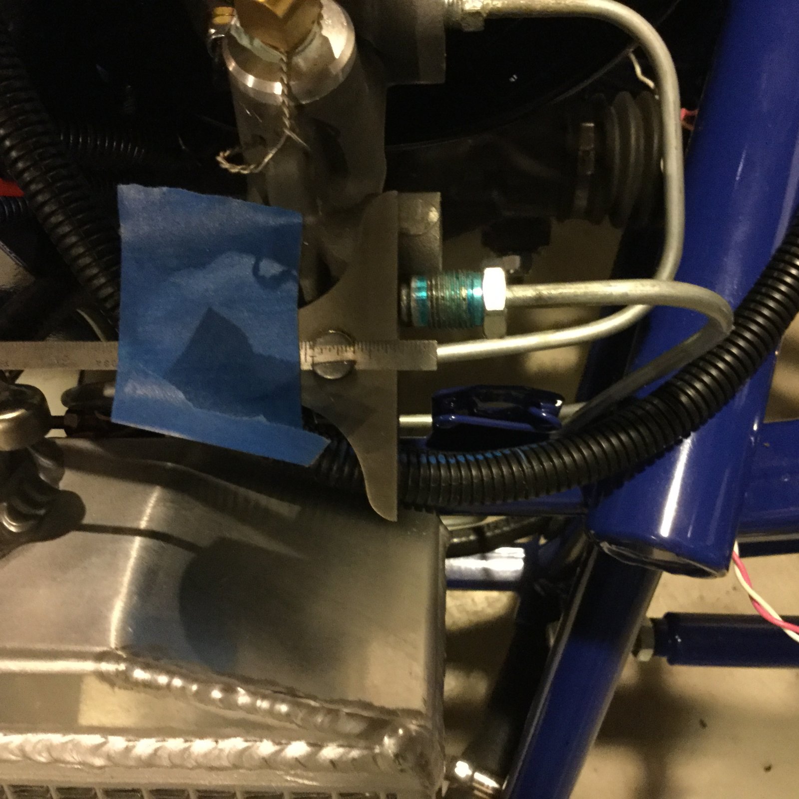

So here are somethings to look out for... photo below is a 2008 master cylinder and the supplied brake line. The connector is a M12x1, the brake line has an inverted (double flare). Problem is the brake line connector is a bubble flare connector not the inverted flare connector simply will NOT work you only have about 9/32" depth in the master cylinder you catch a thread to a thread in a half. The connector you will need is a BQ9180 Brakequip. So OK I just got unlucky and the wrong connector was used. So I find the correct connector (not available at auto parts stores) cut off the flared end and reflare with correct connector.
Fill brake reservoir life should be good again.

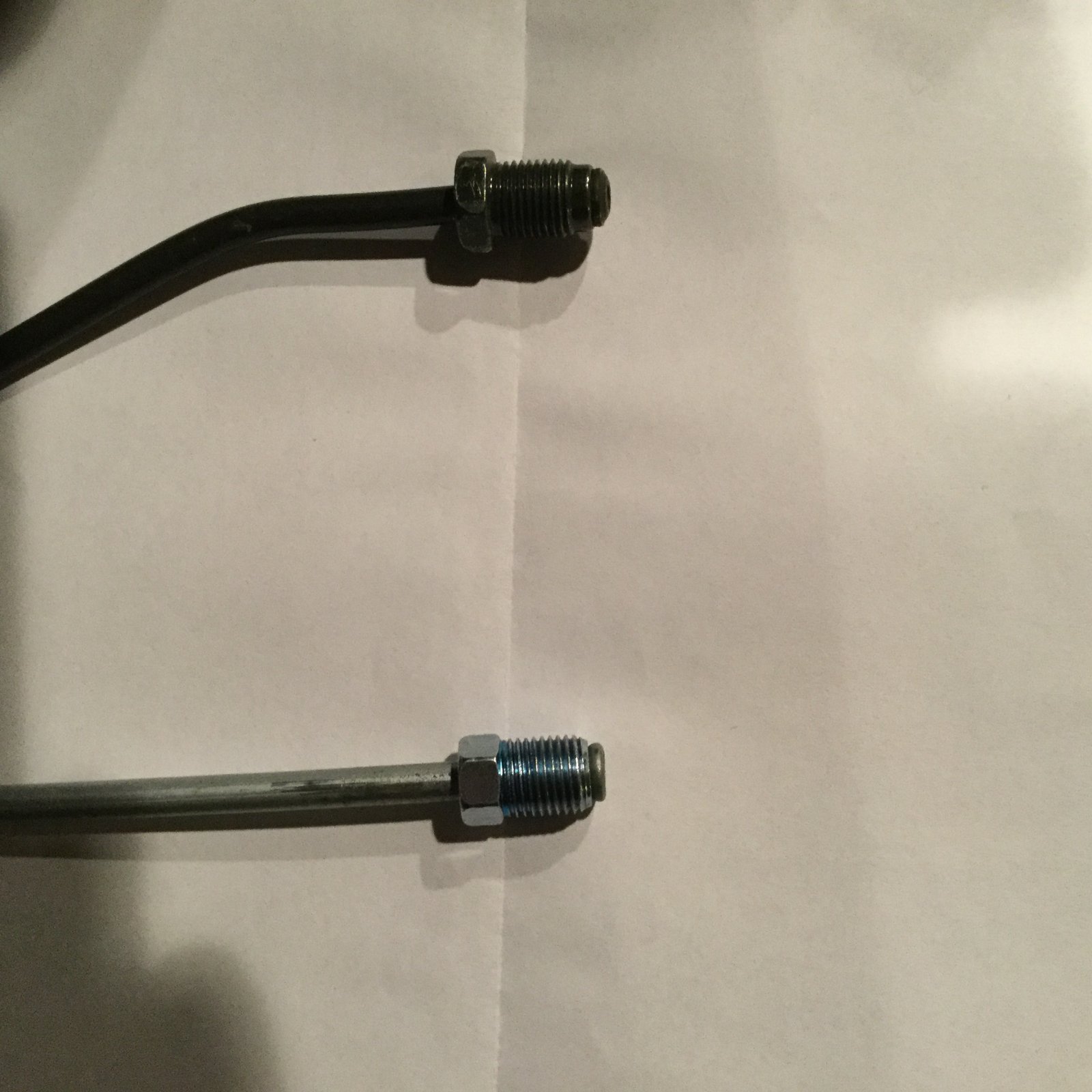

Below is a photo of the supplied line the bottom one you can see it is threaded to the flare (that same connector was used on both inverted and bubble flares). The upper connector (not the right size just what I had for photo purposes) the connector has a step back for the threads so that even if the tees are not completely threaded the lines would still be seated.
After talking with the guys at DFKITCAR just snug the lines as tight as possible to see if you can get them to seat none of the supplied lines at the tees seated (even using tube wrenches stripped two connectors) and they still leak. The only one that did not leak was the replaced bubble flare connector with the step back.

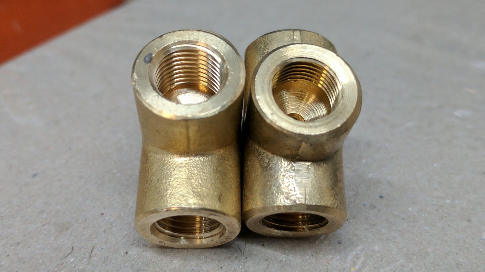

Thanks for the additional information. During our phone call with you yesterday we mentioned that the problem lies with the brake tees.
Here's how this basically happened:
When we first decided to supply brake lines instead of reusing the donor lines we went to the local VW shop and picked up two brake tees. We tested on our car with bubble flares with a 45 backside with a brake tube nut with a 45 seat. Everything worked well.
After we delivered the first 4 frames and started assembling the three kits here at the shop, we noticed that some of the brake lines weren't tightening up. That was when we found that some of the brake tees that we ordered in a larger quantity weren't universal like our original ones. The universal tees are tapped deeper, have a larger undercut and a shallower seat.
We immediately sent out an email to the first 4 guys letting them know to check out their tees. The problem occurred when we packed your kit a little bit later and the wrong tees were packed. That is why yours isn't working but others are.
We've since switched to a DIN bubble flare (flat back side instead of 45) and a bubble flare fitting with the non-threaded shoulder. We did this just in case the wrong tees end up in our order again. The new style will work with either tee.

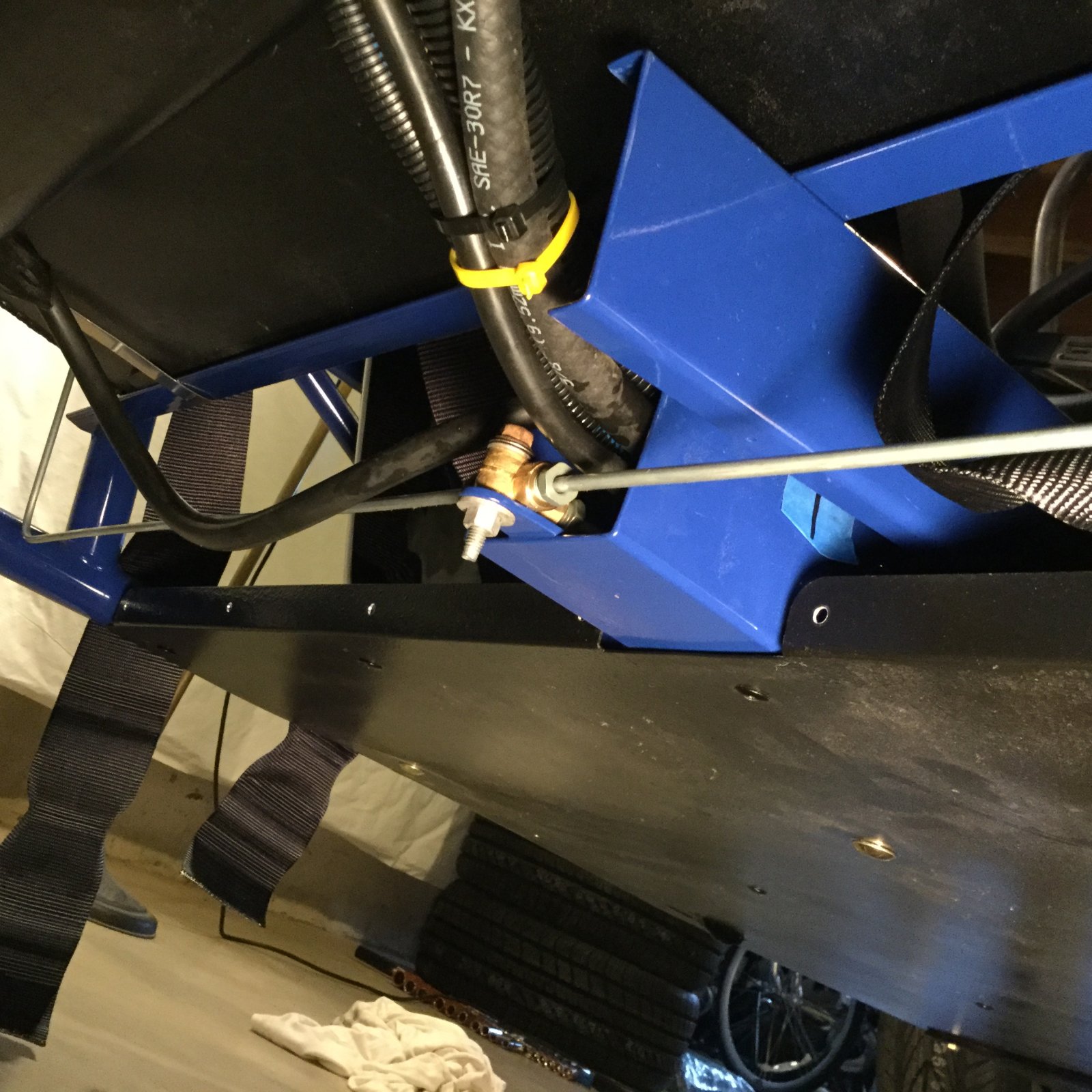

Just a note - I usually try to put the head down on all underside bolts to keep rocks from destroying the threads and making it difficult to remove. The rear brake tee bolt is a rock catcher.
Thursday we shipped you six new lines and two new tees. You should be getting them soon.
BAR-AIR
THX,
Bolt is a temporary when I changed the line I reformed it over the cross member thus removing the spacer. In the aircraft world the bolt is always down so if you loose the nut you still should keep the connection for a time.
It should have deep threads like the one on the left.
Using you fingers you should be able to screw the tube nut in far enough to start clamping on the brake line flare.
