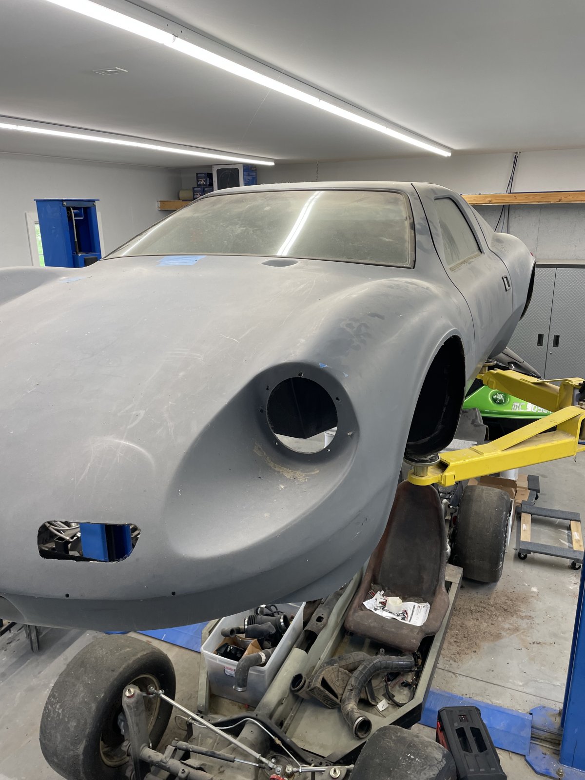

I will attempt to document the build of this new never assembled early 80’s Kelmark GT that was originally designed to go on a vw beetle chassis with a whopping 40ish horsepower. I have decided to build it using the center section of the vw pan that has optional tube floor pans already in it from 3 decades ago when my dad and I started on the car. The plan is to build dom front and back clips and run an ecotec engine with an F40 6 speed. Dad and I never got to finish the car before he passed and it’s been stored away for many years. So this one’s for him. I just ordered a goblin kit as well. I put a post over on the build logs for that.

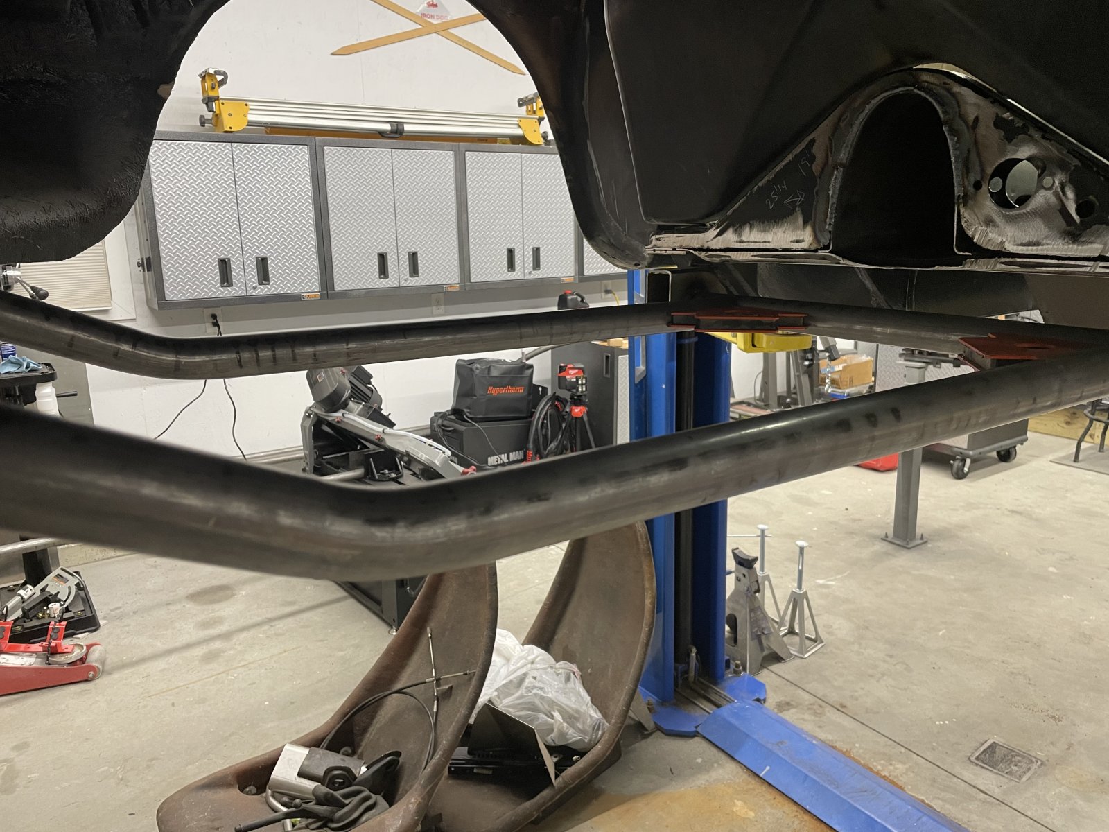

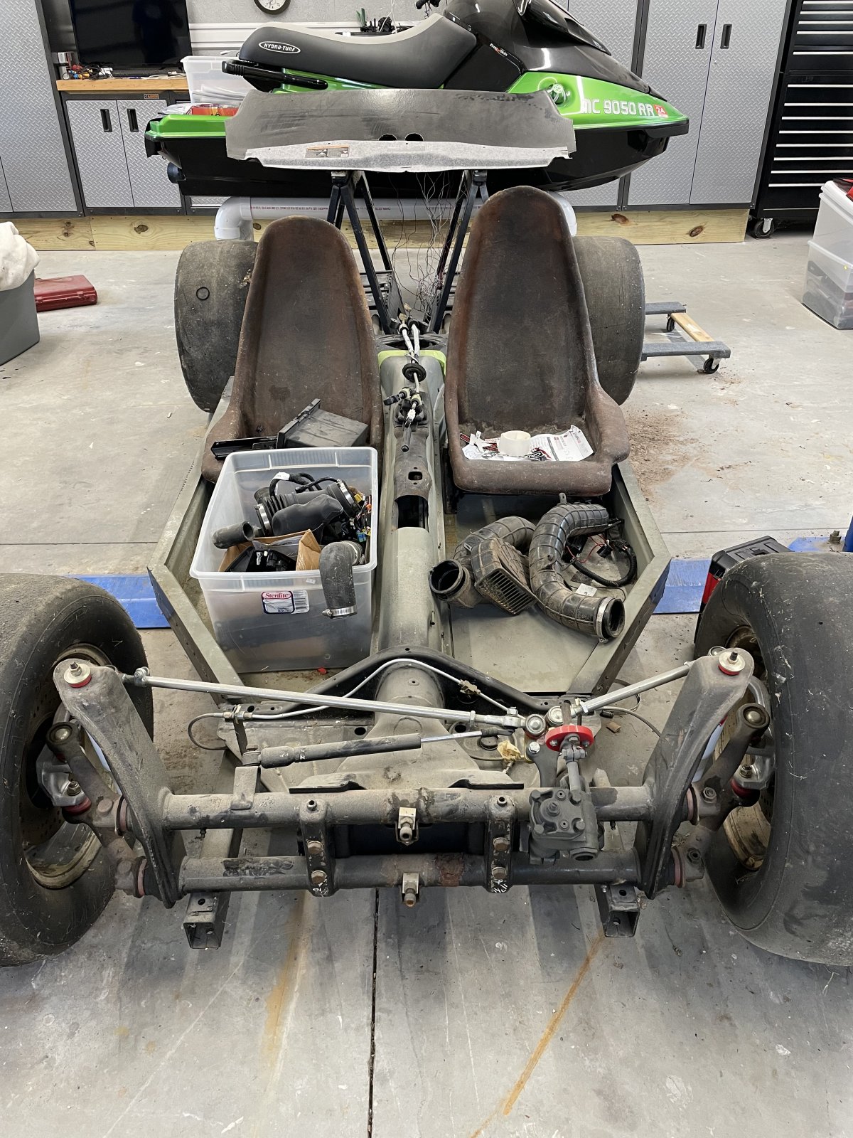

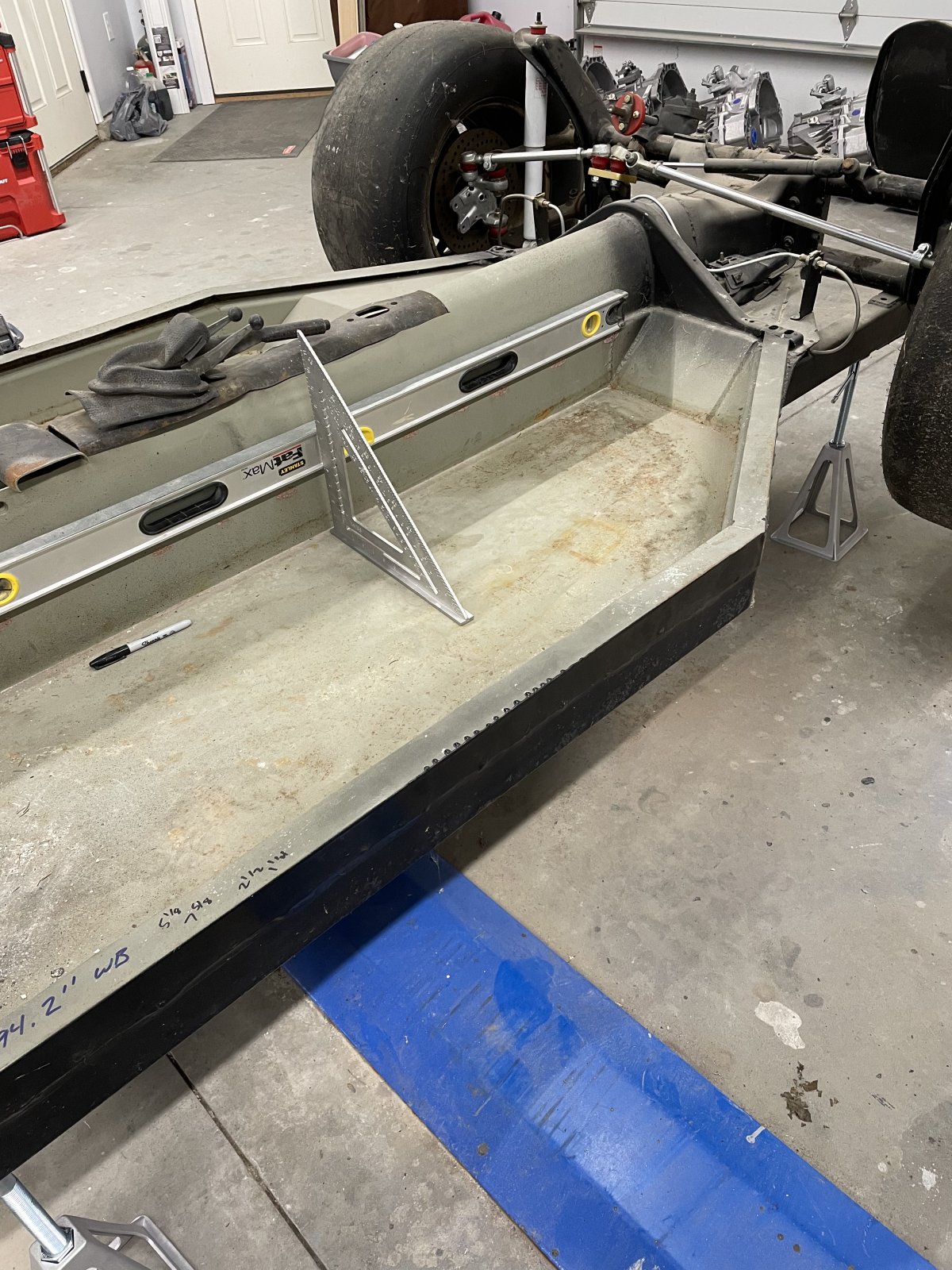

Worked on getting car leveled about as redneck as it gets lol. No chassis table here. Anyhow going to start enclosing back of vw pan and taking off with DOM tube to start the subframe build. Wish I had my Goblin so I could copy some stuff. Also need to figure out if I want to be able to take engine out bottom or if it will need to come out the top. I really want to do dual A Arm suspension so that may effect the sub design. Not much really to look at but here are a few pics.

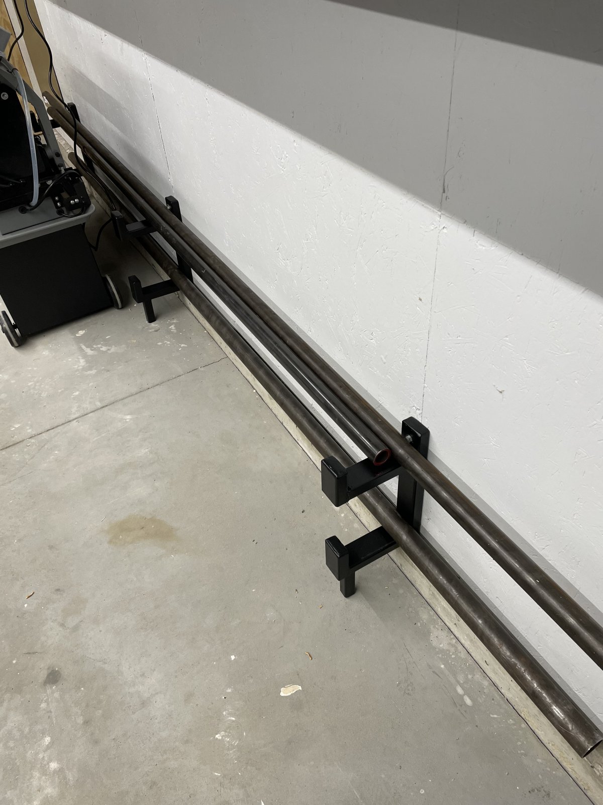

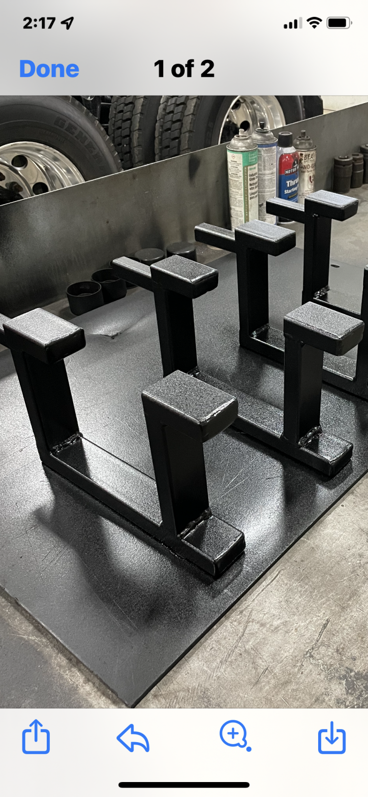

Built a small steel rack to keep the Dom stock off the floor. Fits nice behind the tools on that wall.

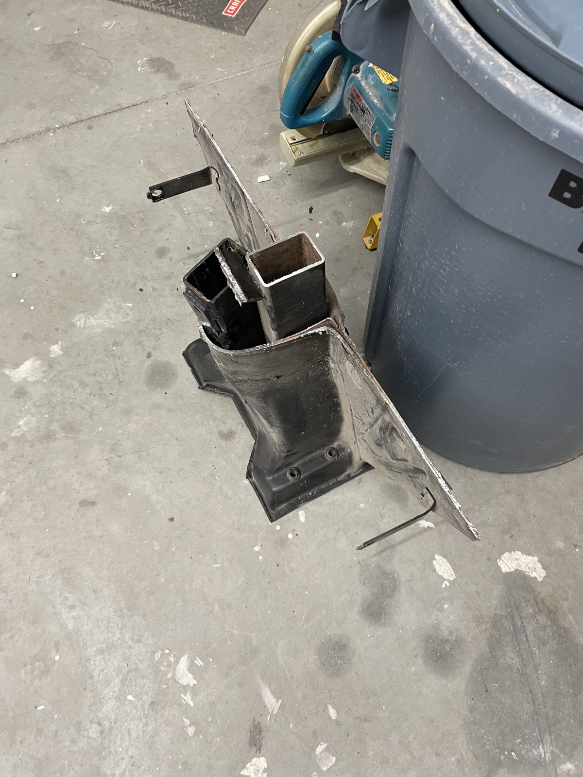

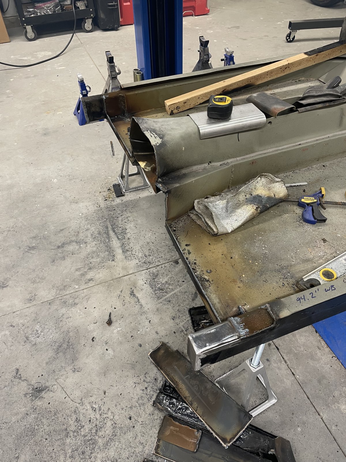

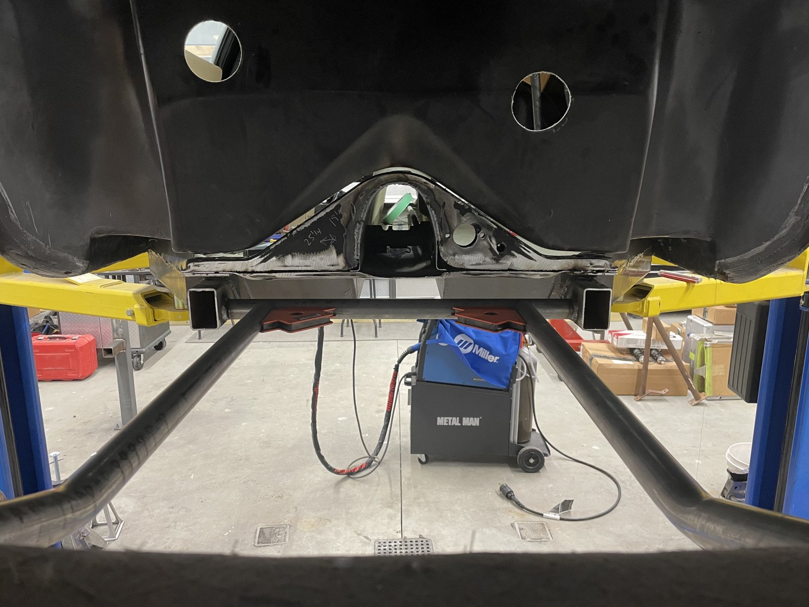

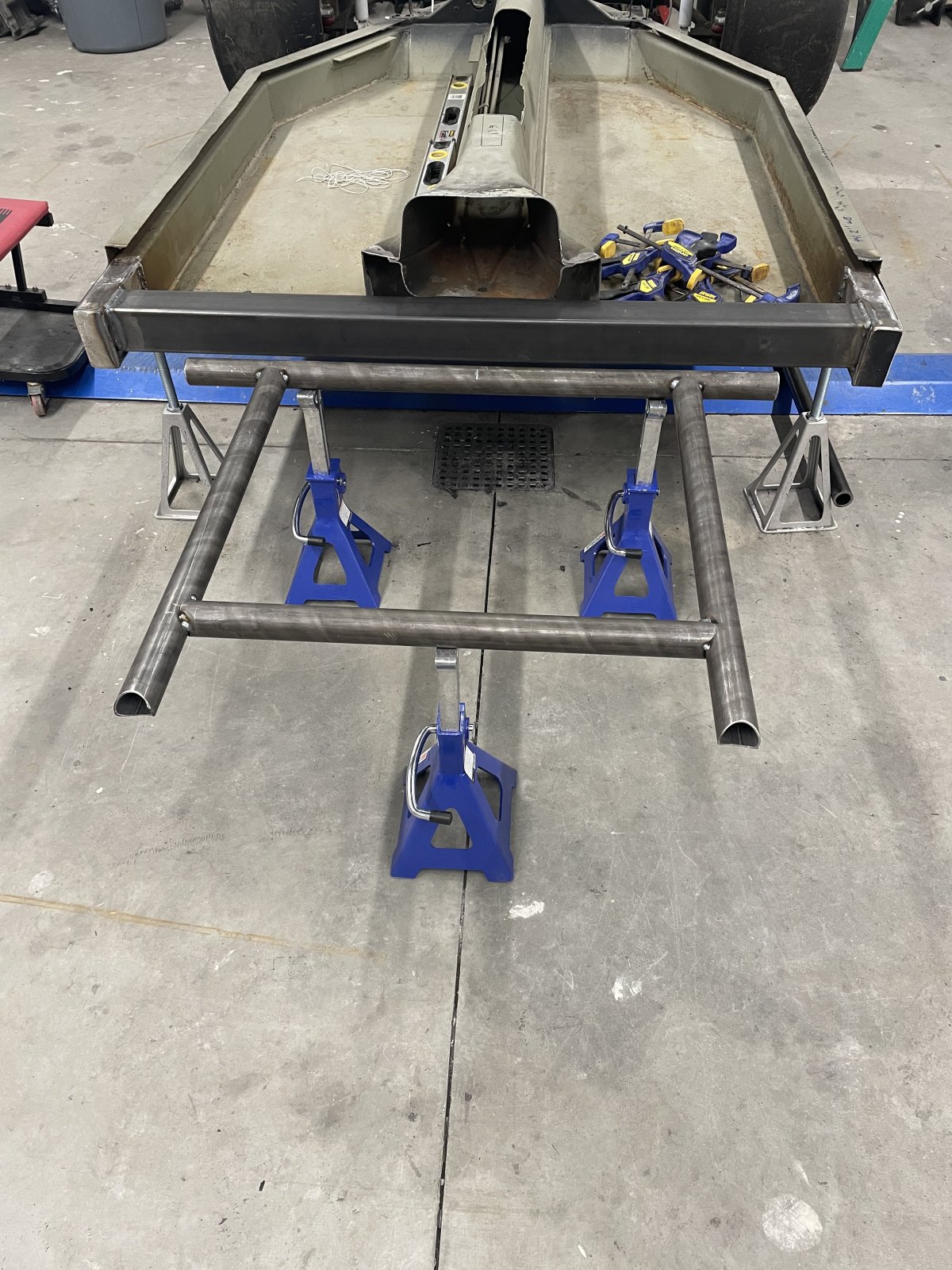

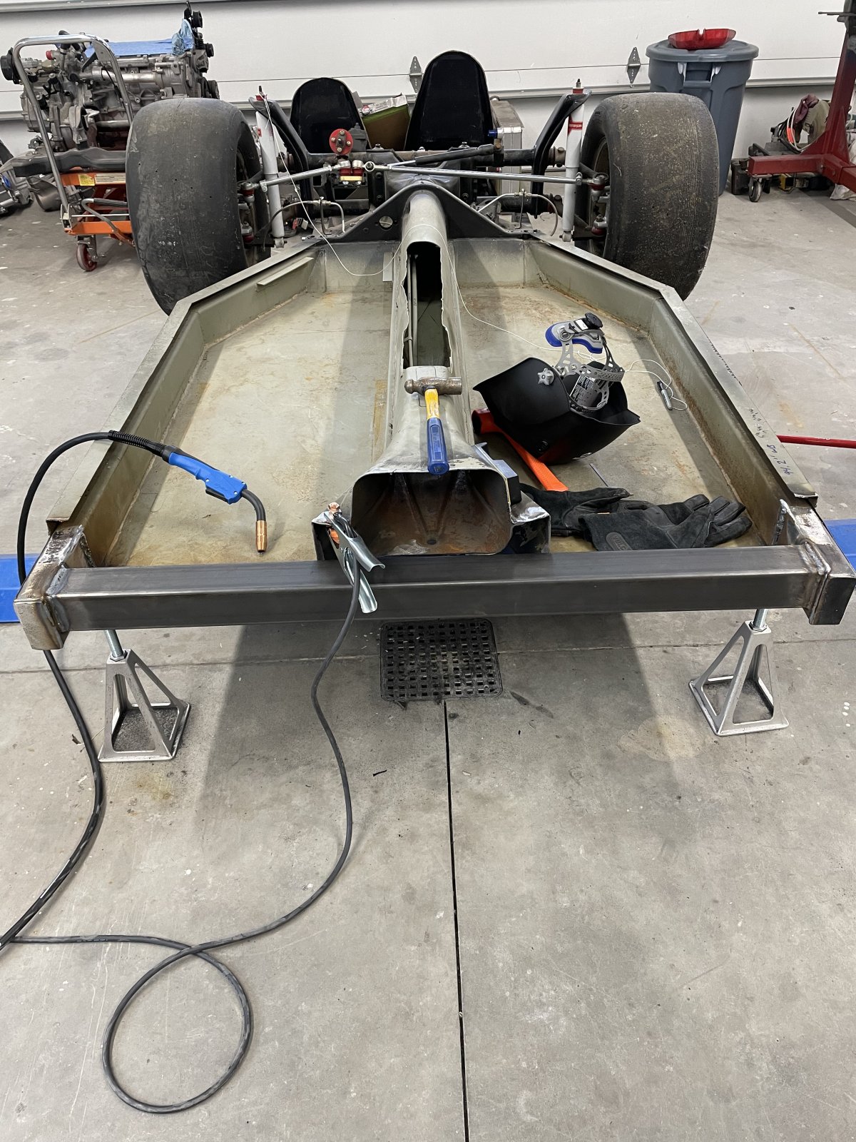

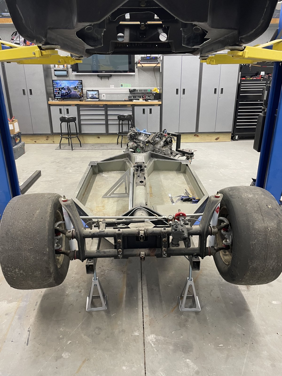

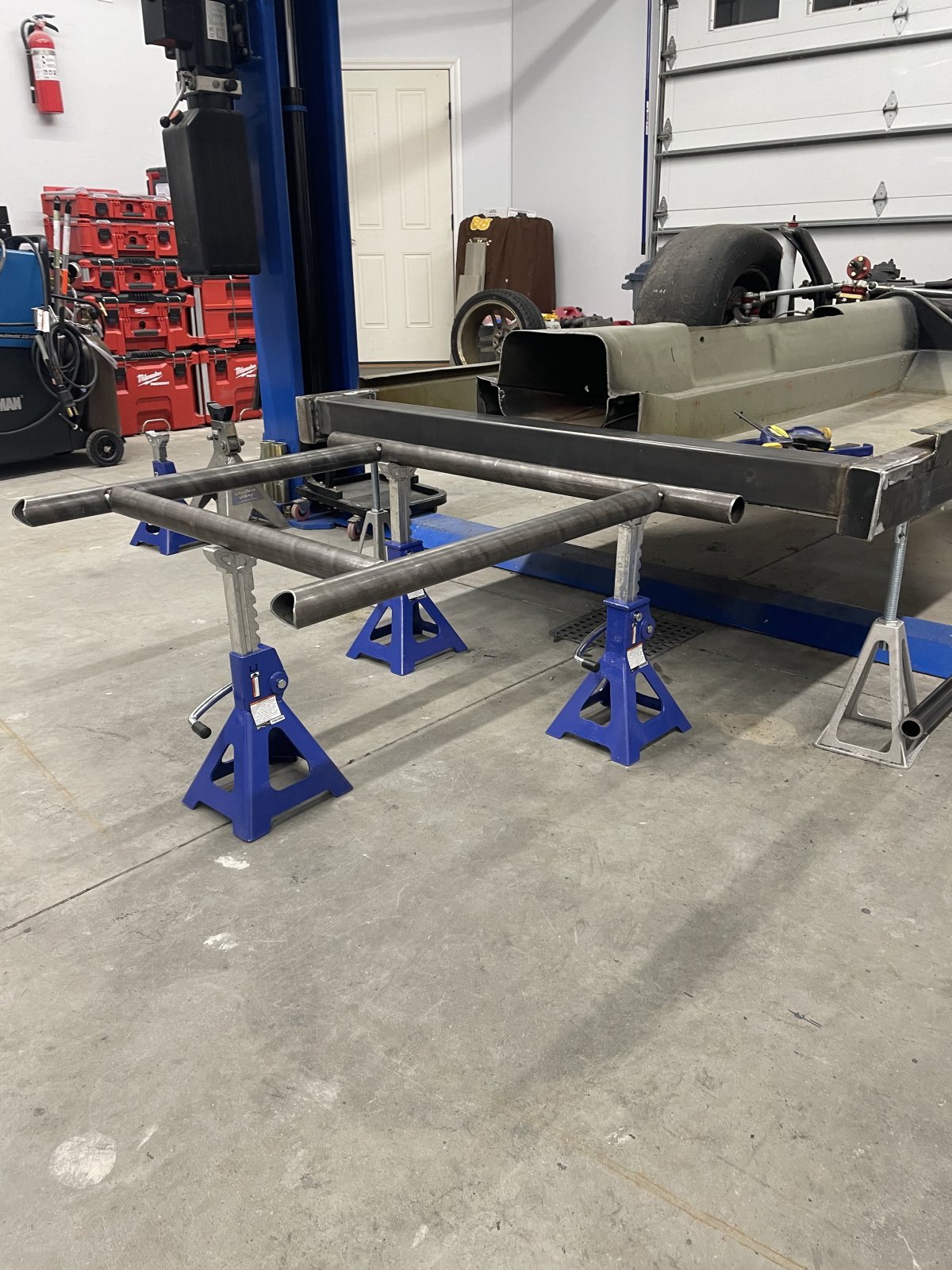

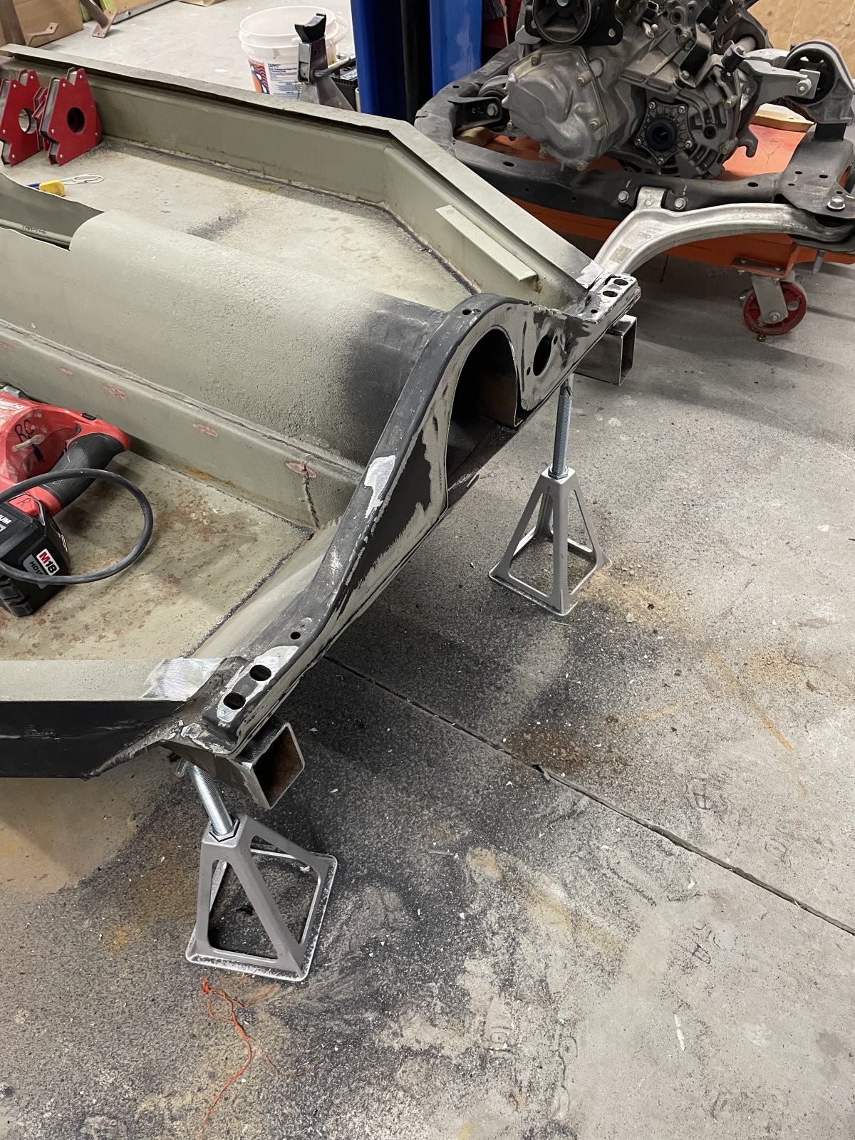

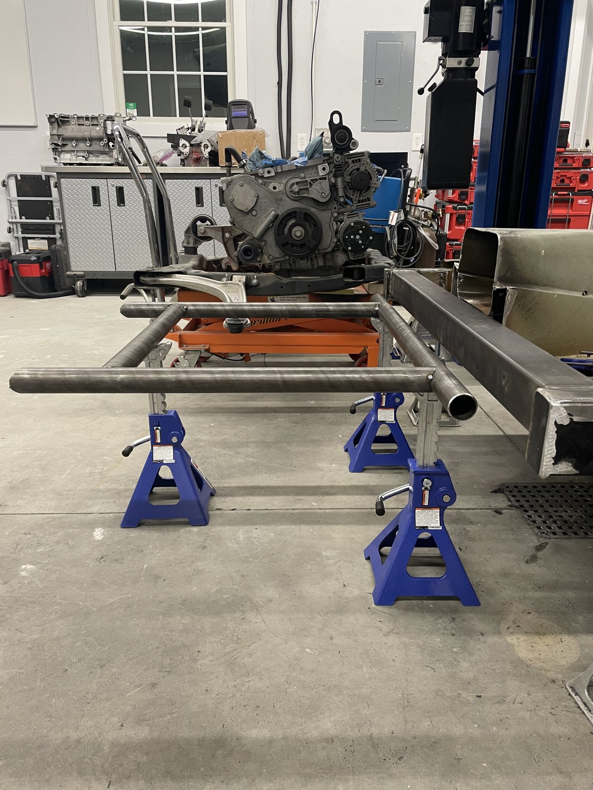

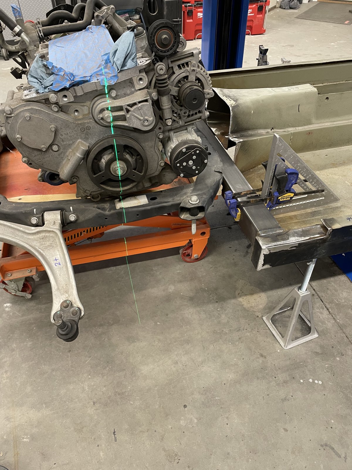

I worked on the Kelmark this evening after work.

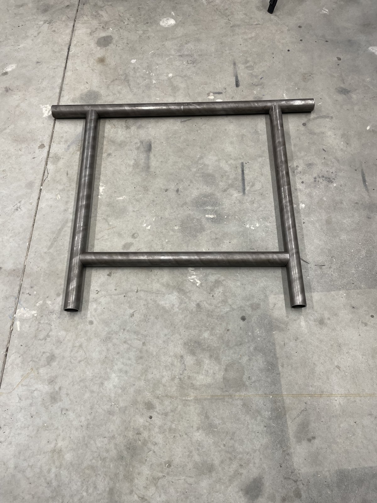

I was able to get all the optional vw sheet metal cut off the center section of frame and installed my main crossbeam to tighten up the center of chassis. I used 3x3 3/16 square tube for this.
I located many of the critical dimensions from the cobalt drive train and sub.
I roughed in a tubular subframe from
1-3/4” 090 wall DOM
Here are some pics.
Next agenda is to finish weld sub and finish braces, mounts, ect.
then on to dreaming up how to build dual a arm rear suspension.
maybe vette?
Maybe build my own?
Thanks Have a good new year

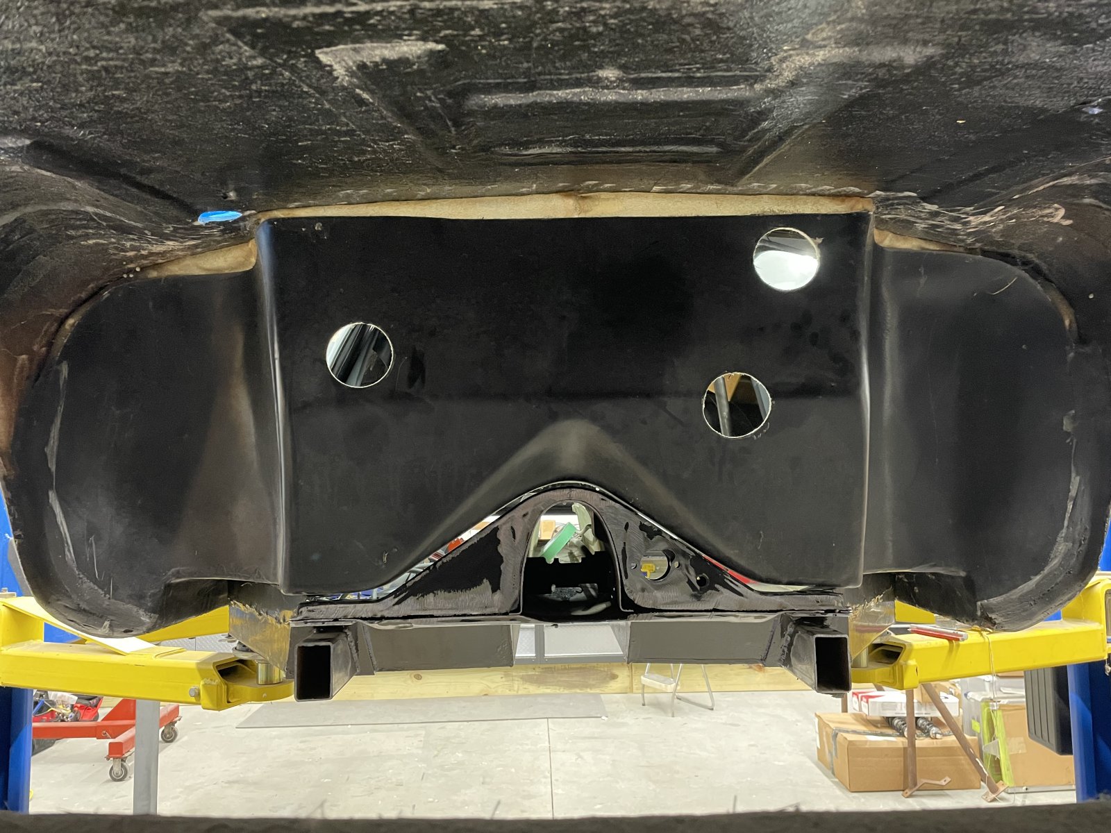

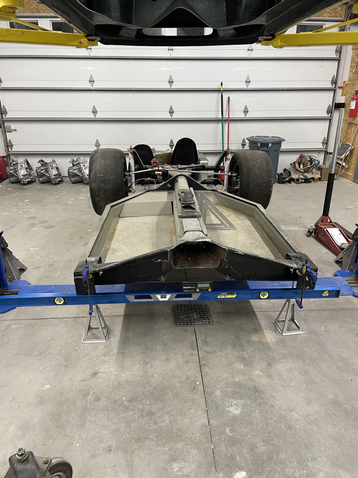

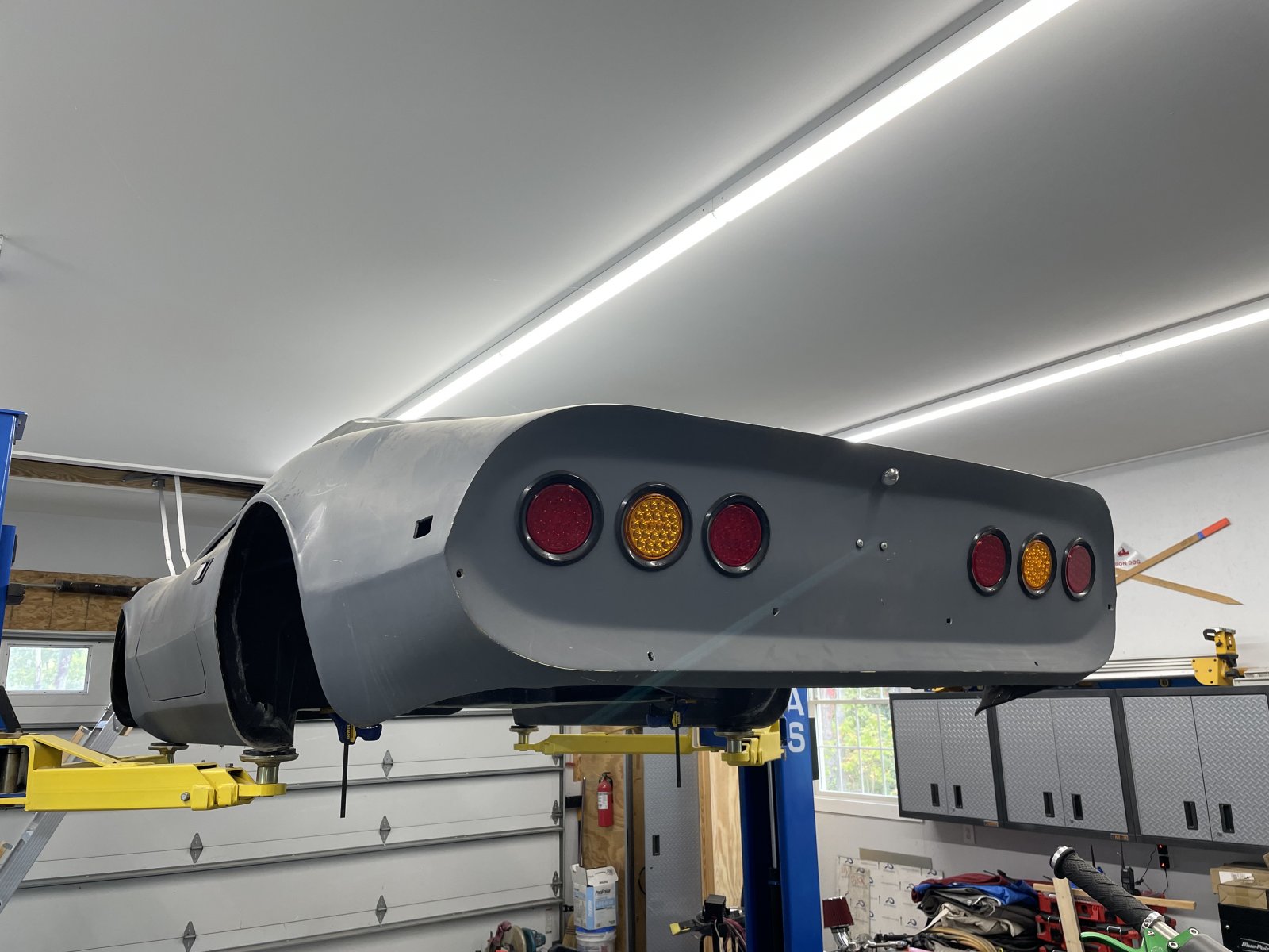

Few pictures of Kelmark for an update. It’s been a while since I’ve worked on it. Chassis 387 is also in my garage now lol.
