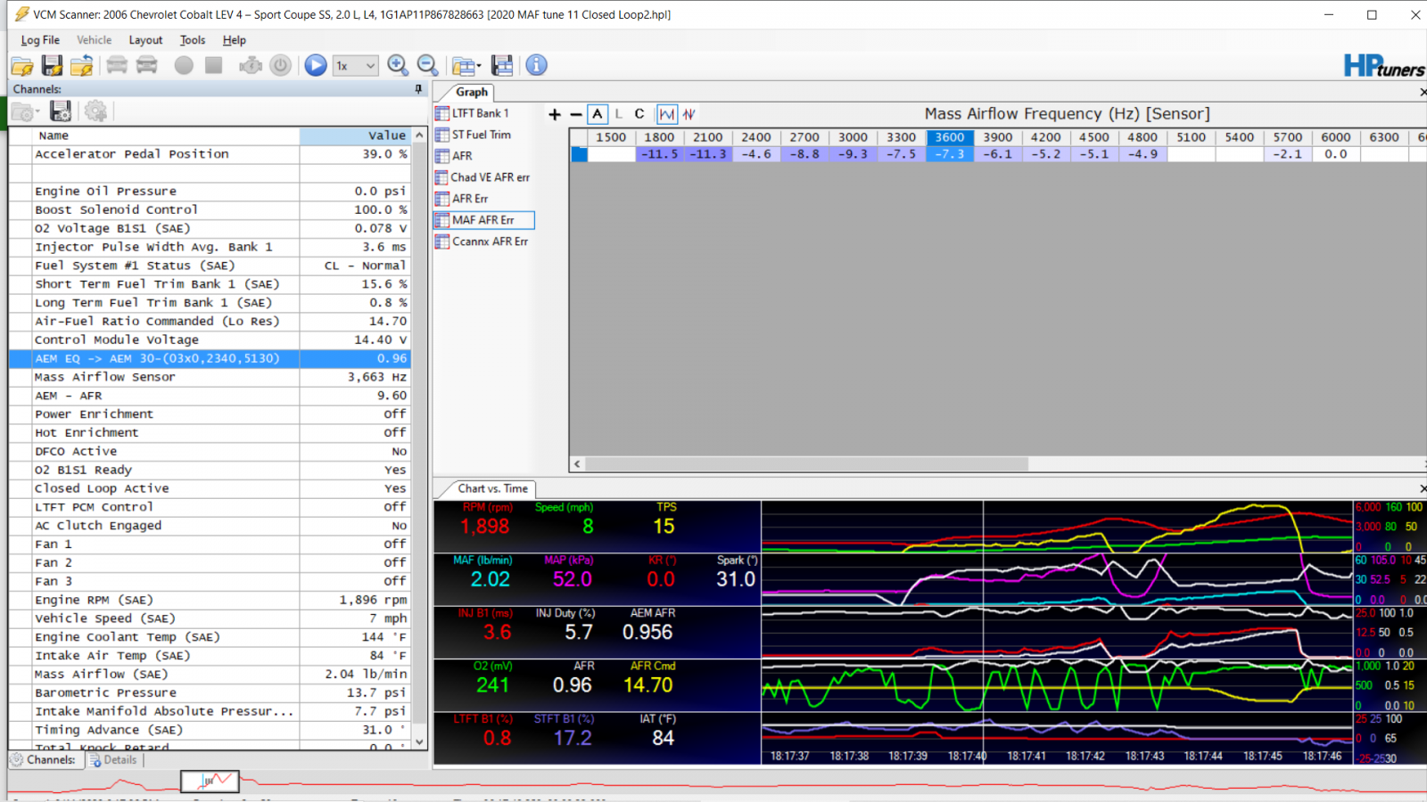

To do MAF (mass air flow) tuning, you are going to need to set up VCM Scanner tool and the VCM Editor tool for your engine.
The high level concept to MAF tuning is:
- When the engine is up to temperature and running, use the Scanner tool to log the wideband's observed AFR (air fuel ratio), compared to the ECM's requested air fuel ratio. The difference between these two is the AFR error.
- Once the error is collected from a test run (driving 5-15 miles, or maybe just near idle in the beginning), then you apply an error correction to the ECM MAF table, based upon the AFR errors collected.
Here is a VCM Scanner log file of mine.
The left window has the parameters that I was logging. The highlighted line is my AEM wideband, showing a .96 lambda at the moment. 2 lines above that is the AFR commanded by the ECM, which is 14.70 at the moment. 14.7:1 is equal to 1.00 lambda, so my engine is running 4% rich in AFR at this moment.
The top right window has a chart of the collected AFR errors, broken down by the closest Hz reading from the MAF sensor.
The highlighted cell is showing -7.3% error (running rich AFR) at 3600 Hz MAF frequency. This is my average error at that frequency during this test run.

- Connect the MPVI to the OBDII port, and your laptop, with VCM Scanner running. Does the software connect to your car? Can you start logging data?
- Add your wideband to the parameters on the left that are being logged. Also add the AFR Commanded by the ECM. Maybe some other useful info, like RPM, Throttle position, speed, etc. Try to keep it under 20 parameters logging, so it doesn't get too slow at logging data. Can you find your wideband O2 sensor? Is it showing valid data? (mine needed to be divided by 10 to get lambda)
After you get thru these first steps, we can talk about setting up VCM Scanner math parameters for calculating error percentages, and VCM Editor stuff to put the engine in open loop and settings for MAF tuning.

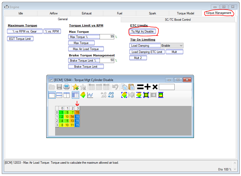

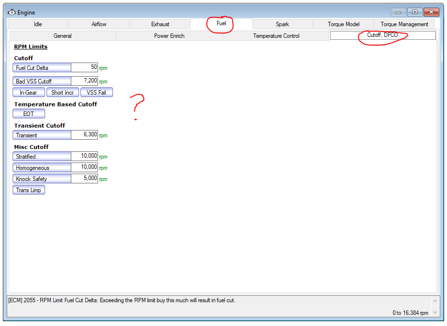

I'm having a hard time finding out where DFCO is disabled in HPTuners for the LNF....
I've read a good bit and one or two posts mention setting the Torque Management > General > Tq Mgt Inj Disable > last column from 15 to 0 to disable DFCO... but I have little evidence to back this up other than a very limited result set from googling.
The Fuel > Cutoff / DFCO section for the LNF only has RPM cutout, not deacceleration. like the tab title says. (It's all RPM based cutoff)

Regarding forcing Open Loop, I'm only seeing info on the LSJ - not the LNF.... so I'm not 100% sure where to go about setting this for the LNF. Open Loop is no O2, but I don't see anywhere in the editor to change O2 settings except heating on/off.
I found the same thing that you found. The LNF has the Bosch E69 ECU, and it is quite different from my LSJ P12 ECM.
Not sure if anyone here has experience tuning this.
What Ive gathered for the LNF ECM doesnt have the traditional settings for DFCO.
Under torque management - ETC Limits - tq man inj disable is what i found that controls DFCO
Set to 0 to disable cylinder cut.
To test if this actually works on your engine, look at your wideband gauge when you are decelerating. If it goes very lean, then DFCO is still active.
If the wideband gauge stays near 1.0 lambda, then you have disabled DFCO. Success!
