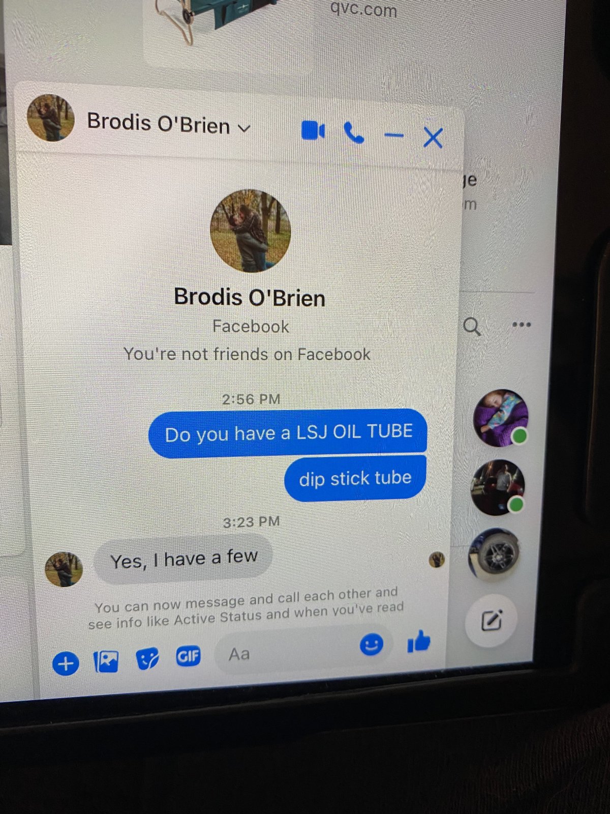

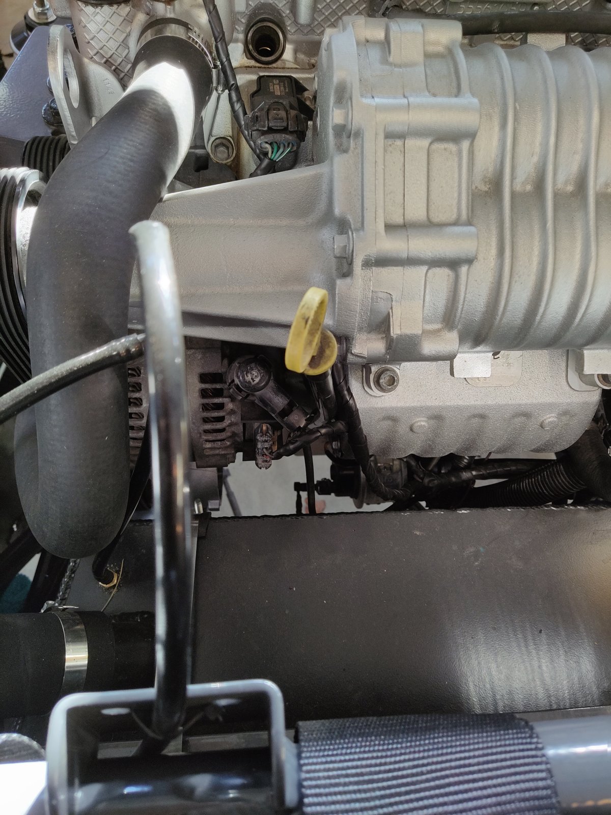

This guy has a couple of LSJ dip stick tube
P
Only the one on the left I complete, the other 2 are broken...look just like mine when I tried to remove it. The last inch or so with the 2 rubber seals breaks off in the engine block. I have been searching for a replacement for months. If I find some I will let everyone know.
Iwanttogofast

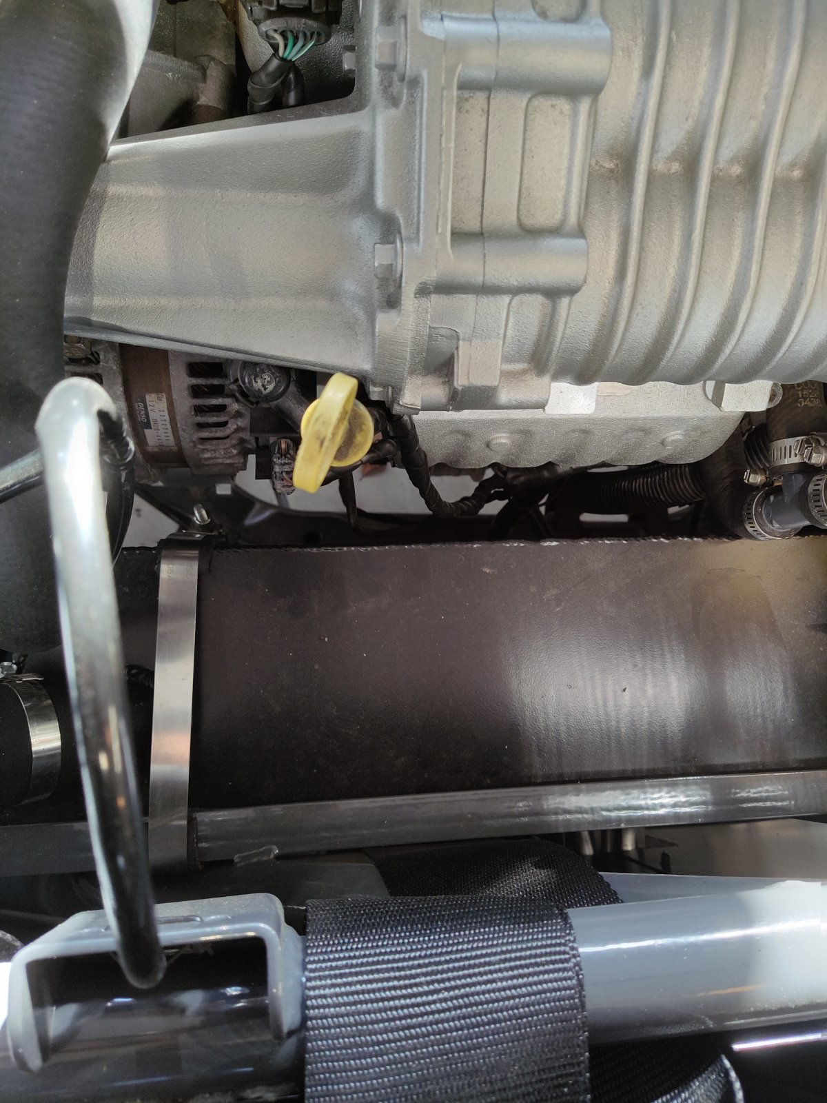

Can anyone with a completed LSJ Goblin advise how much room is left in front of the dipstick before any interference? I would imagine that it would be the gas tank that is closest to the the dipstick(?). Just wondering if the dipstick from the 2.2L/2.4L N/A engines (which is supposed to be shorter - does not clear the supercharger) may still be accessible after the build with an LSJ engine. In other words... If I make the dipstick from the 2.2L/2.4L engines fit, will I have access to the dipstick ring to check my oil level?
