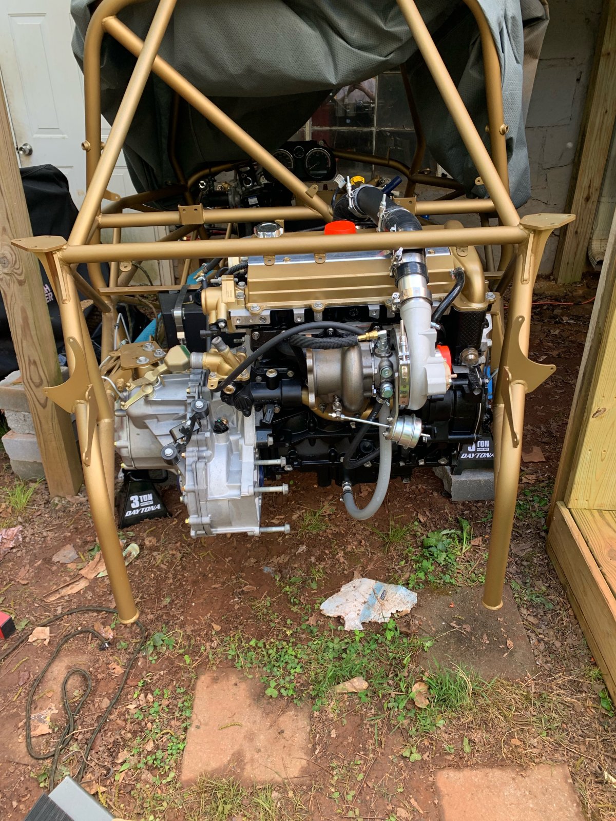

UPDATE: Today I said to hell with it went ahead and got the engine bolted in the rest of the way, mated to the trans, and much to my disbelief, the gap between the valve cover and that rear cross member was somehow larger - It must be because the engine is slightly reclined when the most forward bolt on the engine side is tightened all the way. Either way, here it is and just barely fits:
40018
Thanks for all the help guys - I appreciate it. I guess sometimes it is better to just send it...that is unless your intake manifold is full of debris from a previously blown engine.
"...We just sent it. Live and learn." - @Fozda
F
Intercooler?
Love the 'Oldsmobile' gold color.
Going with a water cooled setup for now (ZZP Entry level stage 2 and a dual pass end plate) - Will likely end up moving to an A2A setup down the road, but I'd already pulled the trigger on an entry level without really exploring the realm of possibilities. So for now the intercooler is just the stock Lamanova cores.
