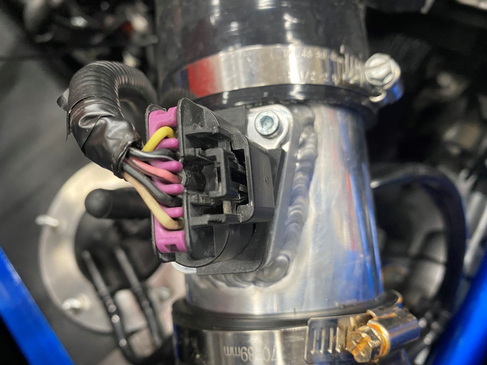

Hi all have a fault code on my OBD scanner for P0102 which translates to Circuit Low Voltage on MAF . LSJ Goblin isn't driving cause I'm doing some work on it but it does idle rough sometimes and hard cuts out occasionally. If I am idling and unplug it there is no change in engine note at all. I've tried cleaning the sensor and reset the CEL but comes back once I restart. I have ordered another sensor but where I live could take a while to get there so I'm trying to make sure it's not another issue with wiring so I don't waste time waiting in vain. I used a multimeter to check voltages and wondering if anyone is able to check what they are getting on theirs I would really appreciate it or has a link to the ranges they should be, tried Googling but couldn't find anything certain.
I found this list of what each wire does but not voltage ranges...
Pin A, wire color yellow, MAF sensor signal. Pin B, wire color black/white, Ground. Pin C, wire color pink/black, Ignition 1 voltage. Pin D, wire color Tan, Low Reference. Pin E, wire color Tan, IAT Sensor Signal
From bottom I'm getting the following reading...
Tan wire - with plug out 4.9v roughly. Plugged in about 1.5V
Black wire - getting continuity to engine block so seems to be a working ground.
Pink wire - .33V plugged in or out. (suspicious about this one)
Black & white wire - working ground
Yellow wire - 4.9v approx plugged in or out
Thanks in advance
