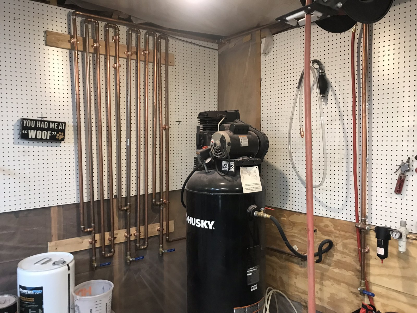

Im running a 80 gallon porter Cable on a 30 amp circuit. Its enough power for my tire machine air operated garage door opener, plus painting, air tools.
If you need help adding a circuit breaker its not too difficult just need 10 gauge 10-2 wire I can show you how.
A husky 60 gallon will run around $500 new they work good.https://www.homedepot.com/p/Husky-6...PIPHorizontal2_rr-_-100083906-_-205389936-_-N
I bought my 80 gallon used for $700 you might find even better deal used.

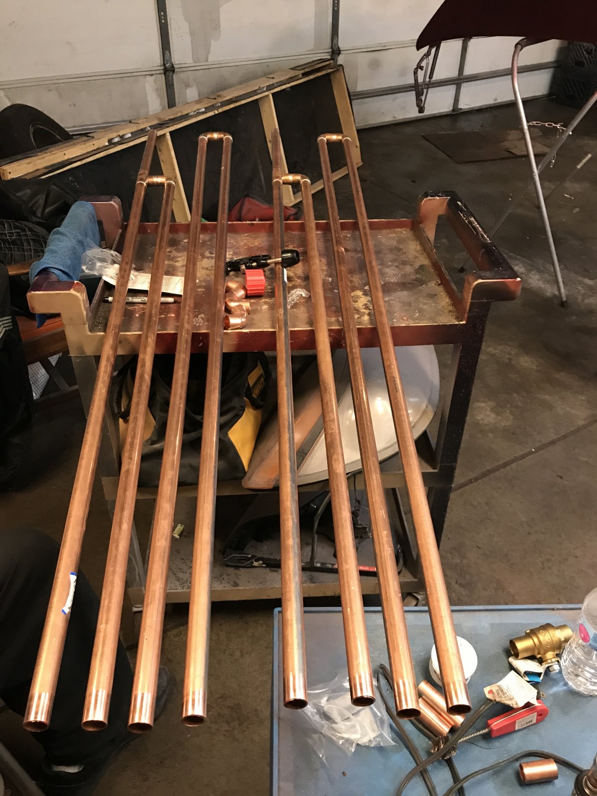

This is the set up I wired and installed at my buddy's house.
