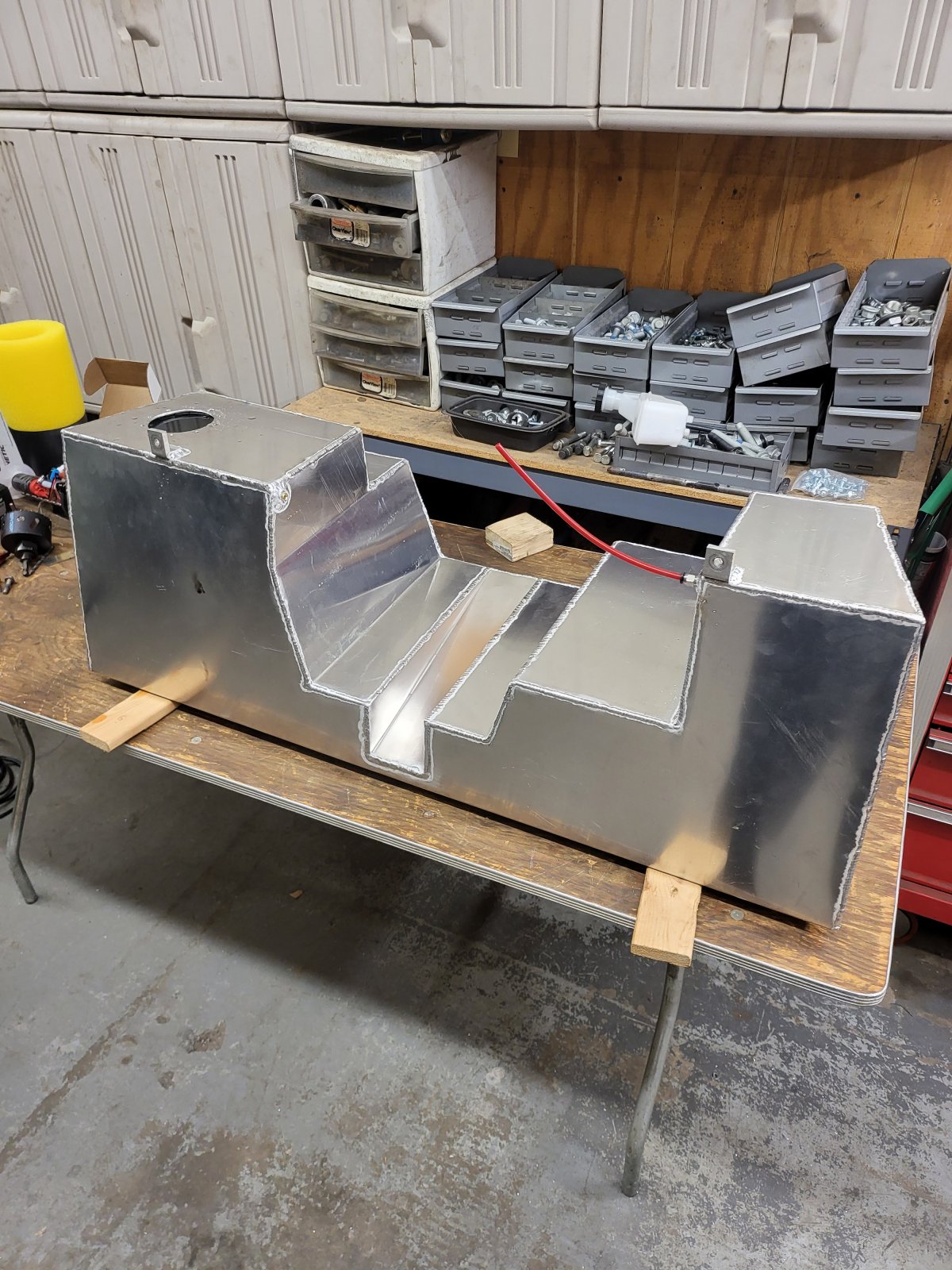

NHTSA prefers the fuel fill on the passenger side to keep a person on the safe side of the vehicle if putting gas into it at the side of the road - if someone runs out of fuel. Automotive design criteria typically has the gas filler on the opposite side from the exhaust, when possible. If the filler has a tank vent it is possible that fuel and vapors may escape and having it on the passenger side may allow for less fumes reaching the driver. Obviously a Goblin has its own (loose) criteria, but Lonny went with the passenger side fill. Everyone has their likes and dislikes, put your filler convenient for you. :D

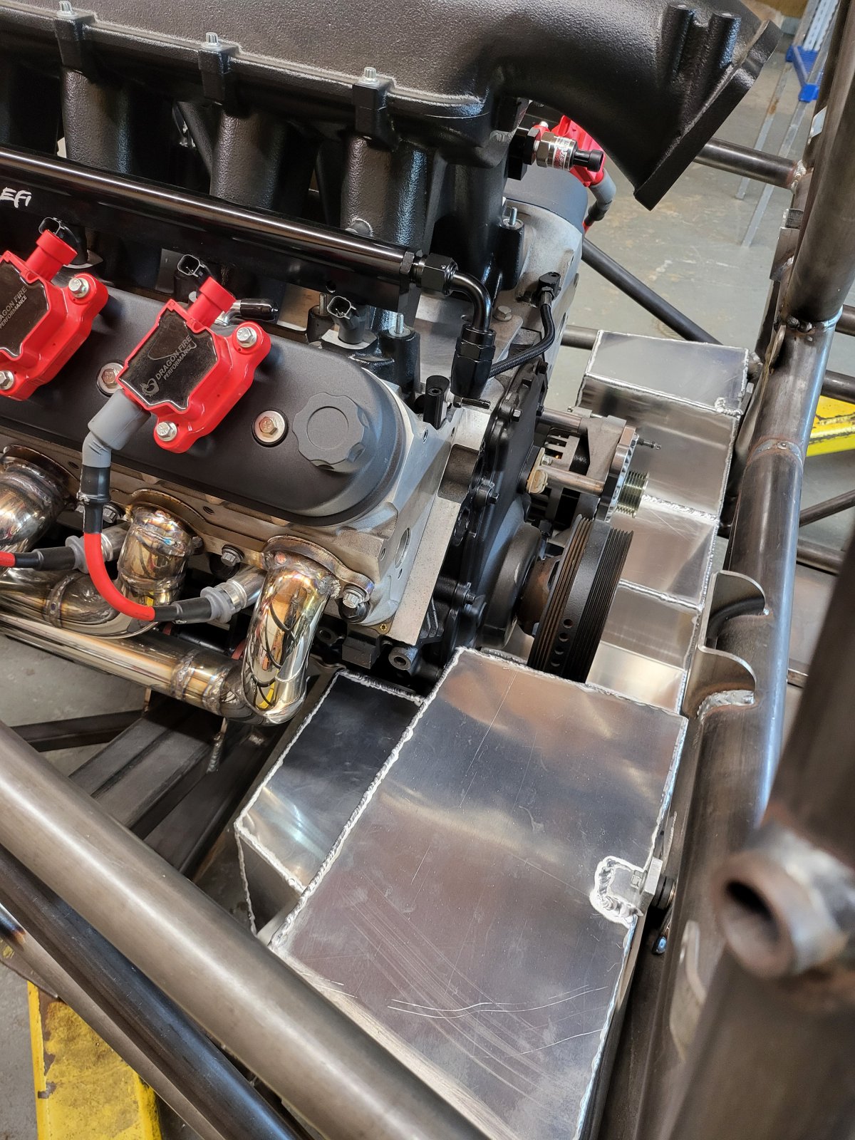

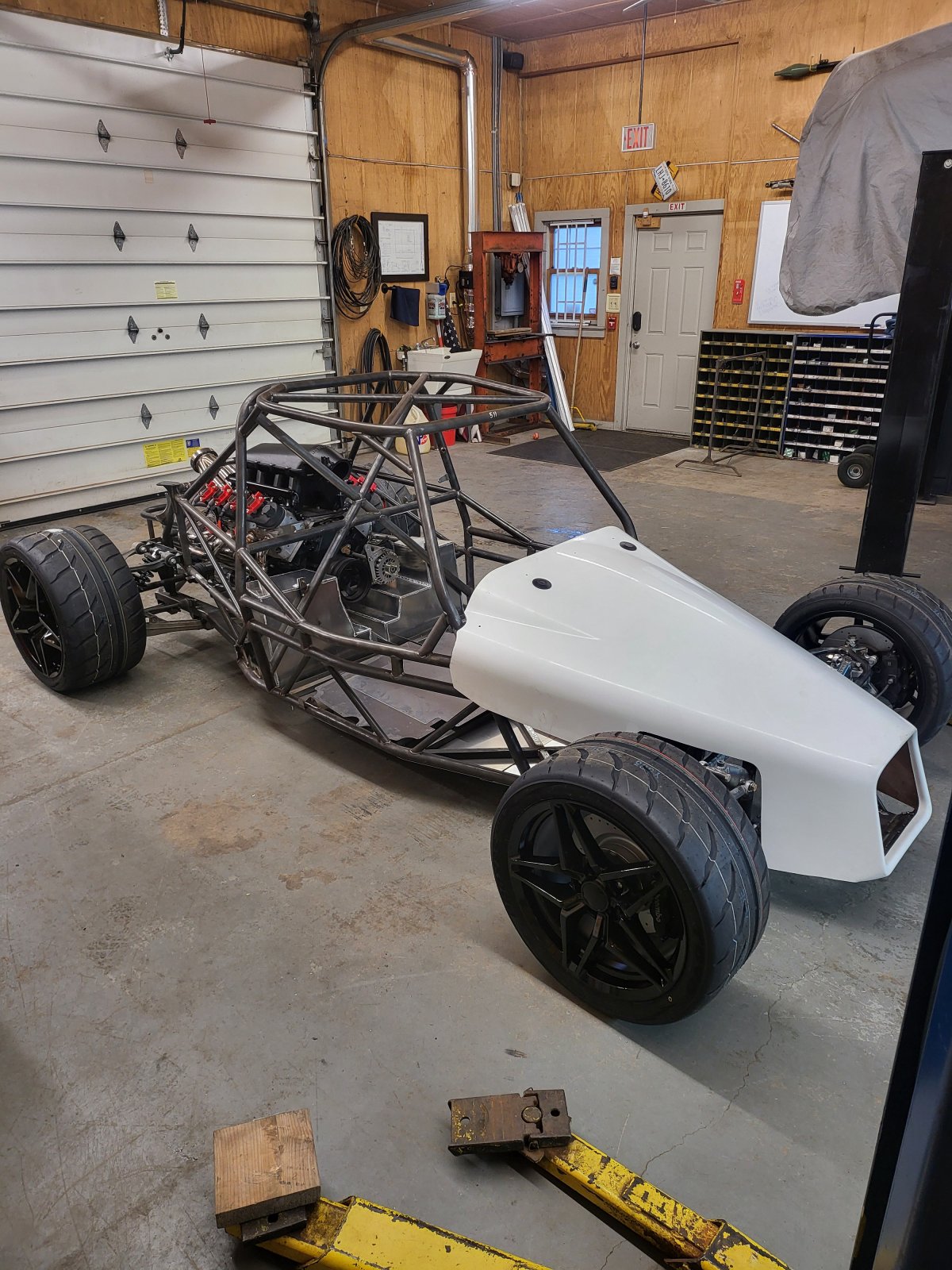

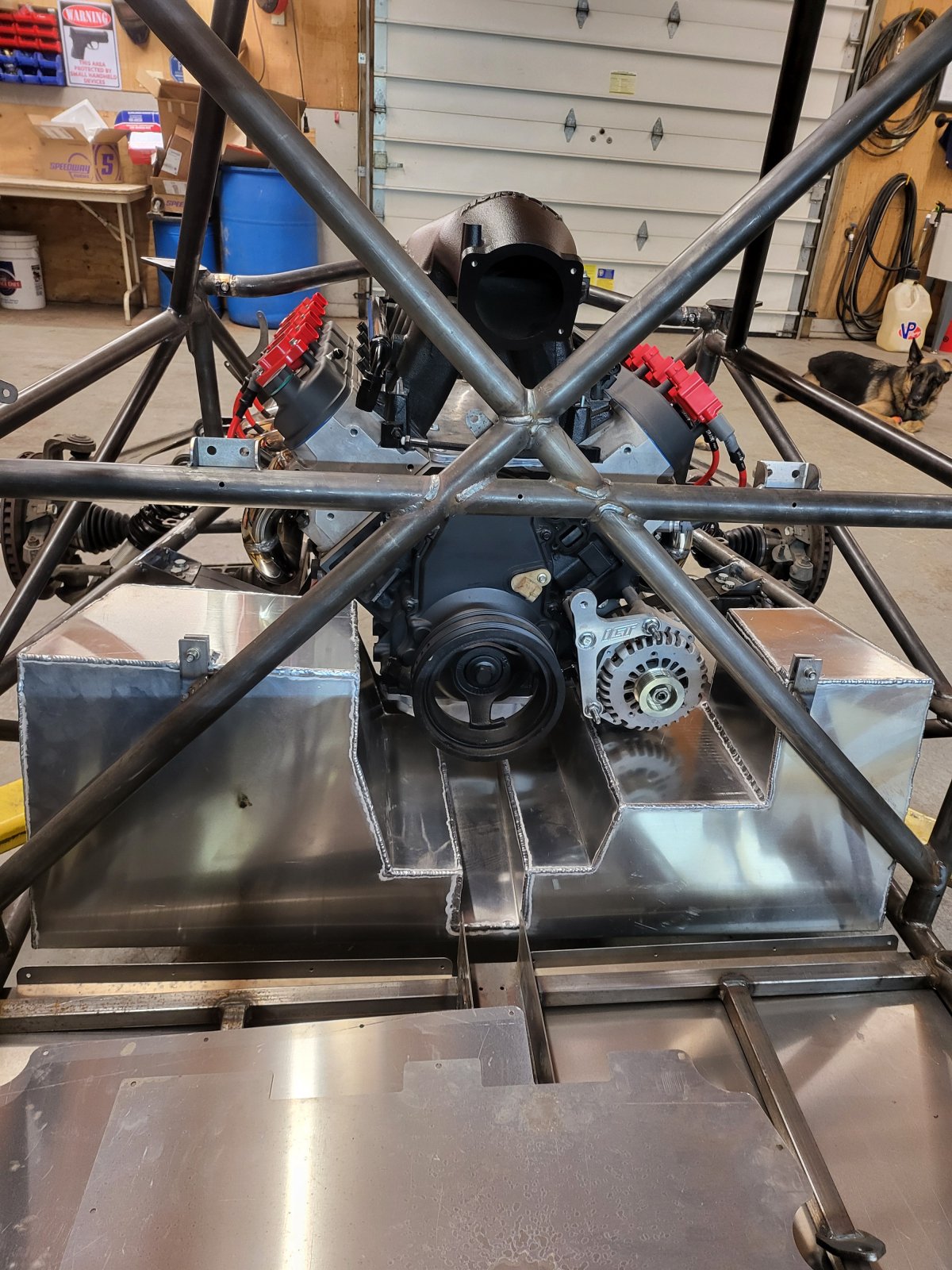

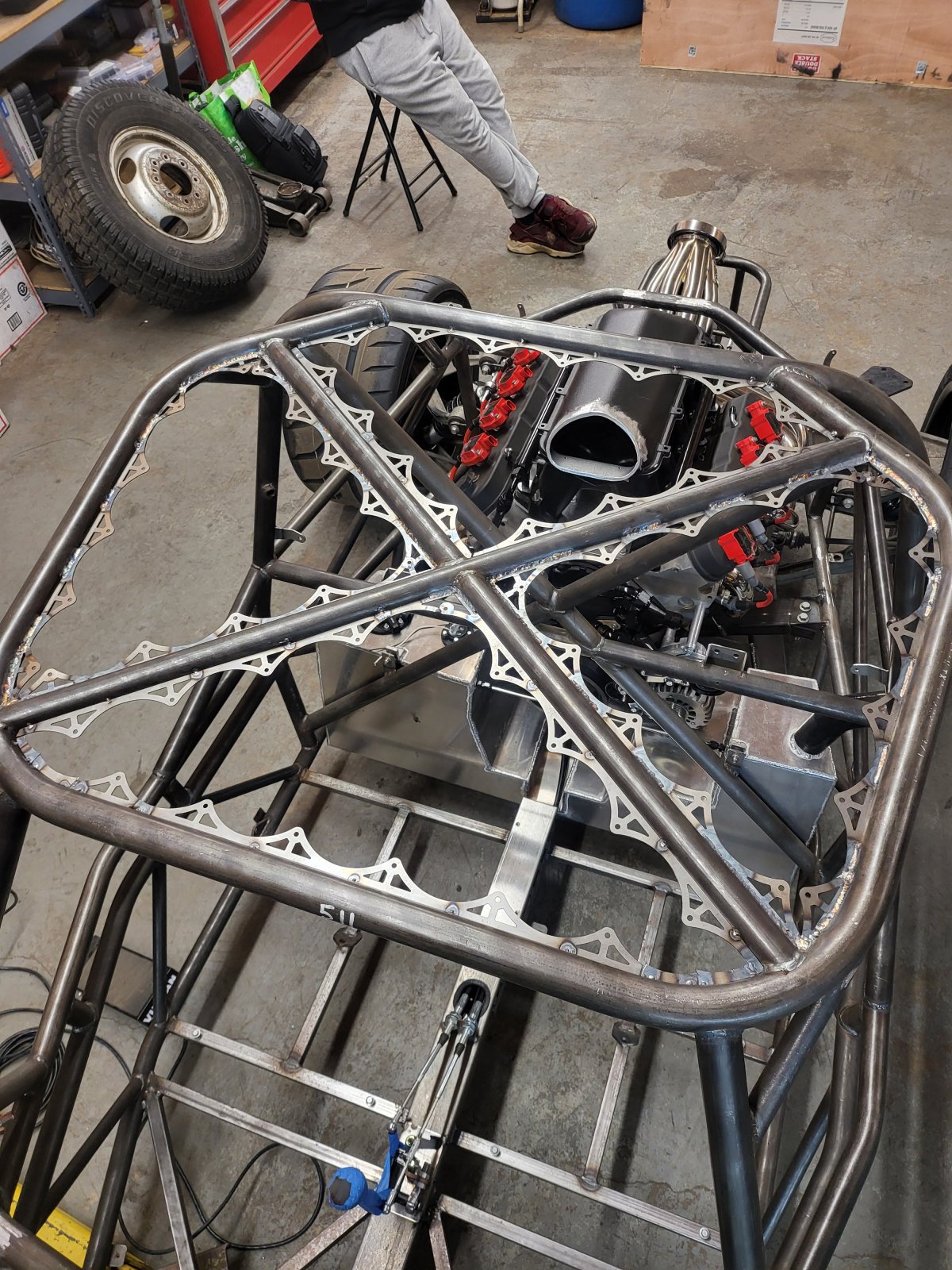

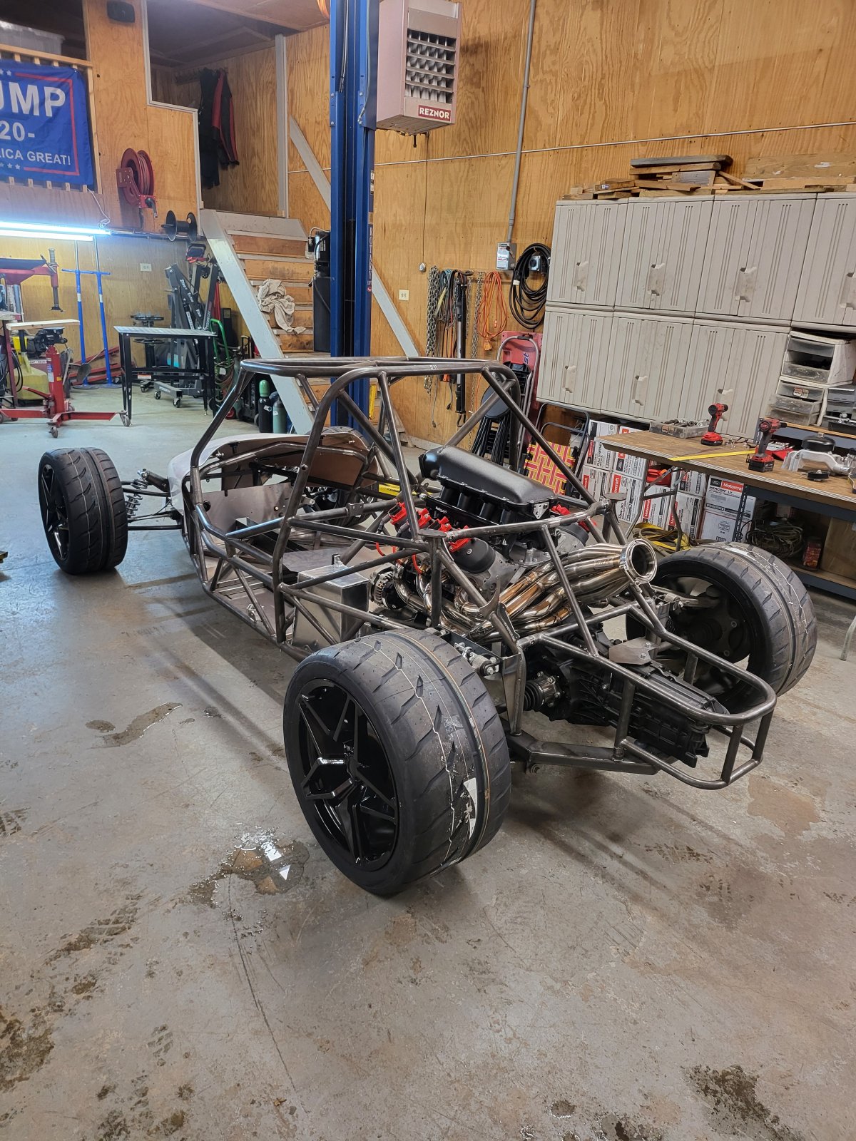

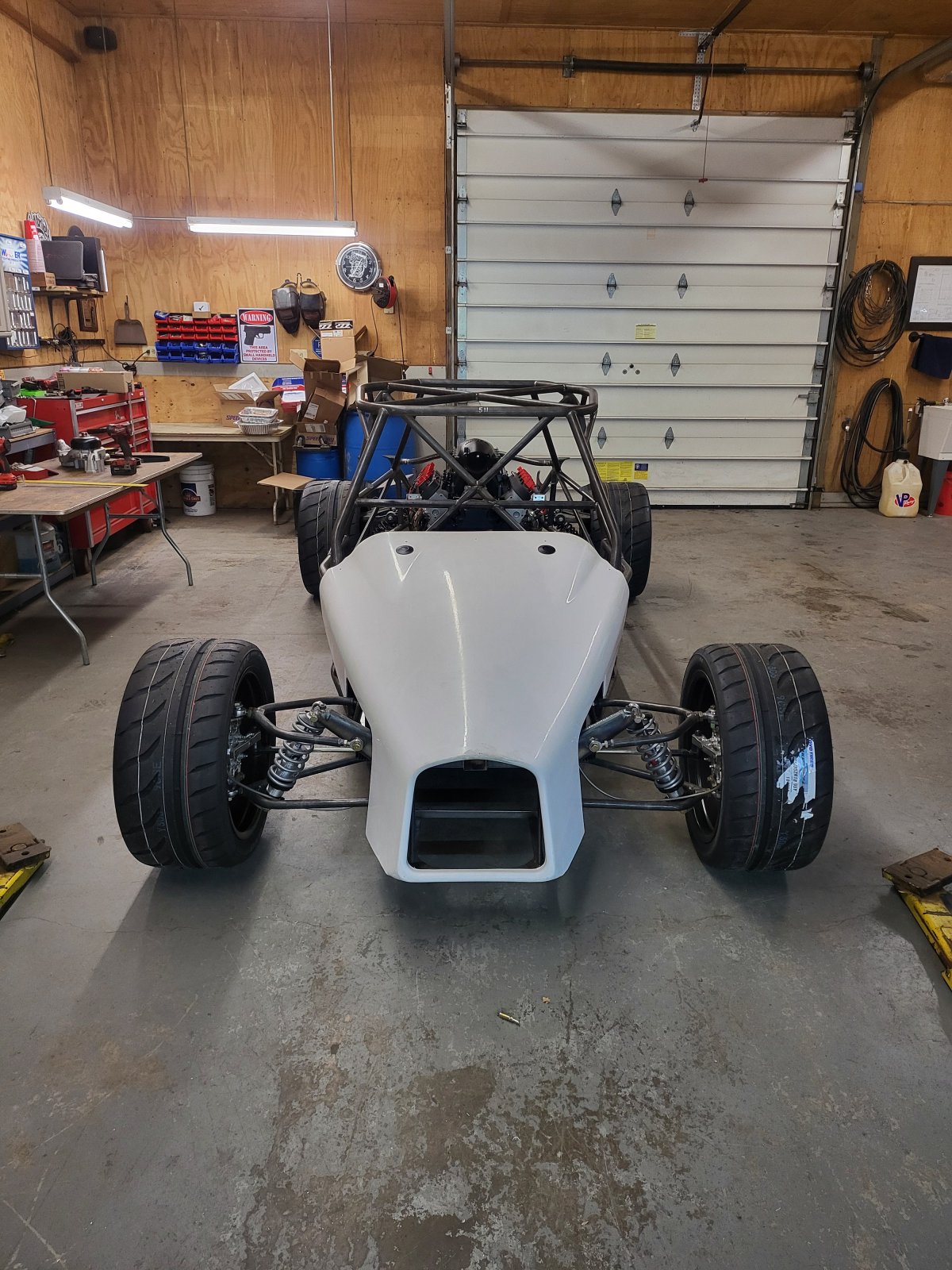

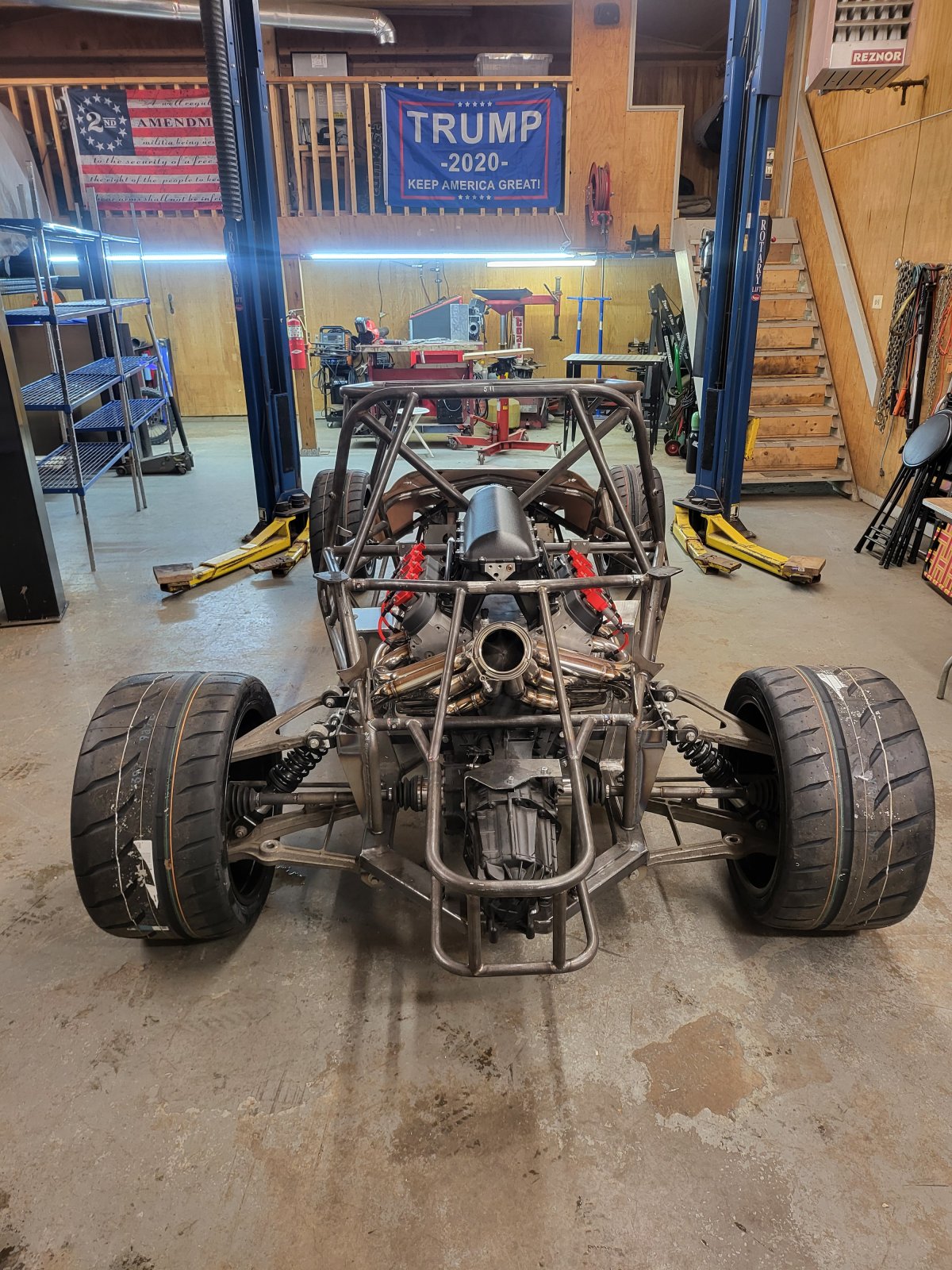

Here's a quick update. Been a little while. Have been busy doing side jobs to fund this crazy project. Fuel cell is mounted. Got a new set of wheels and tires as well.

Cdot
Looks amazing! I've been following your build.
What are the Wheel/Tire specs if you don't mind me asking?

I'm using an electric water pump with custom AN lines. -16an lines actually slide perfectly in the lower chassis tubes. No need to winch them in and out. Also using an ICT low mount alternator bracket.
