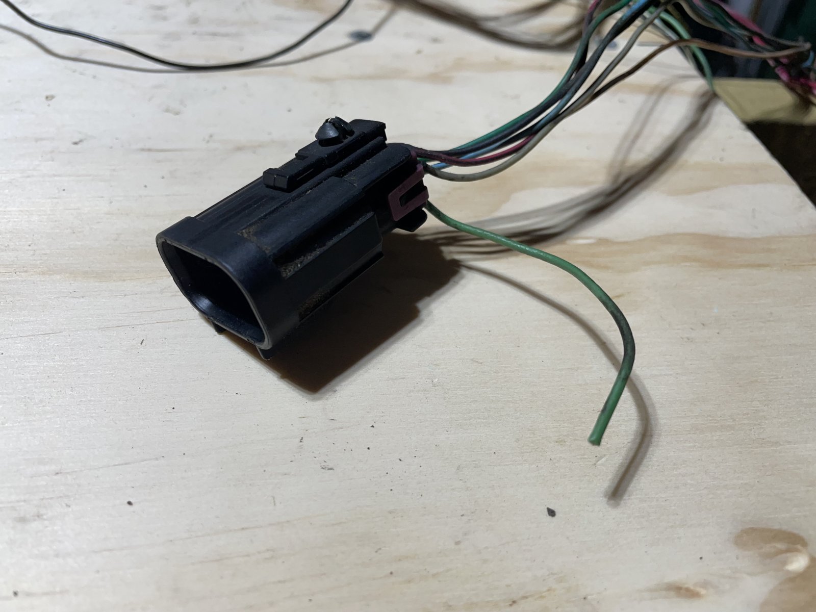

Question #1: What plug and location should the reverse lamp (backup lights) green wire go to? I believe I inadvertently cut it out. A picture would be fantastic!

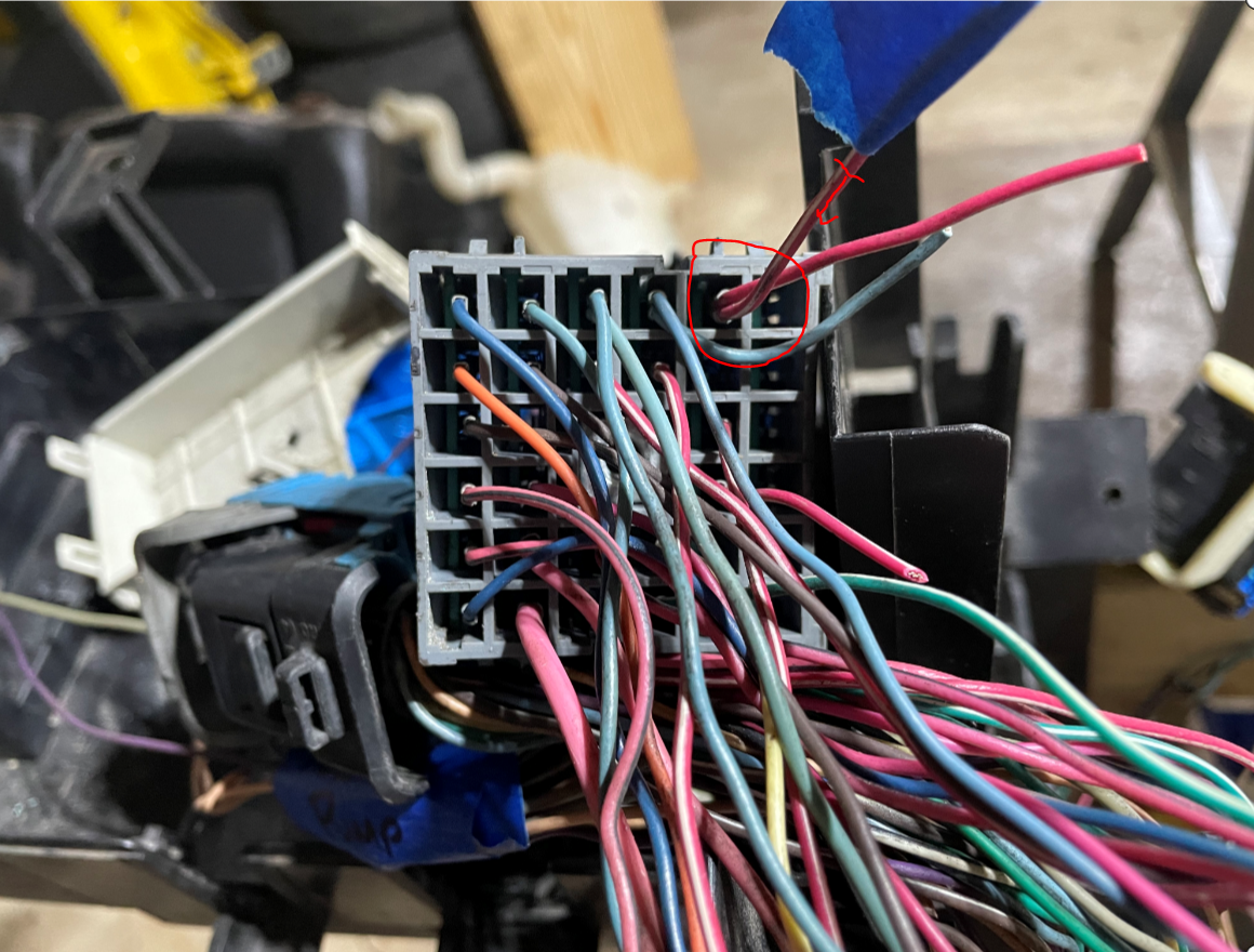

Question #2: What should I be doing with this red-white striped wire?

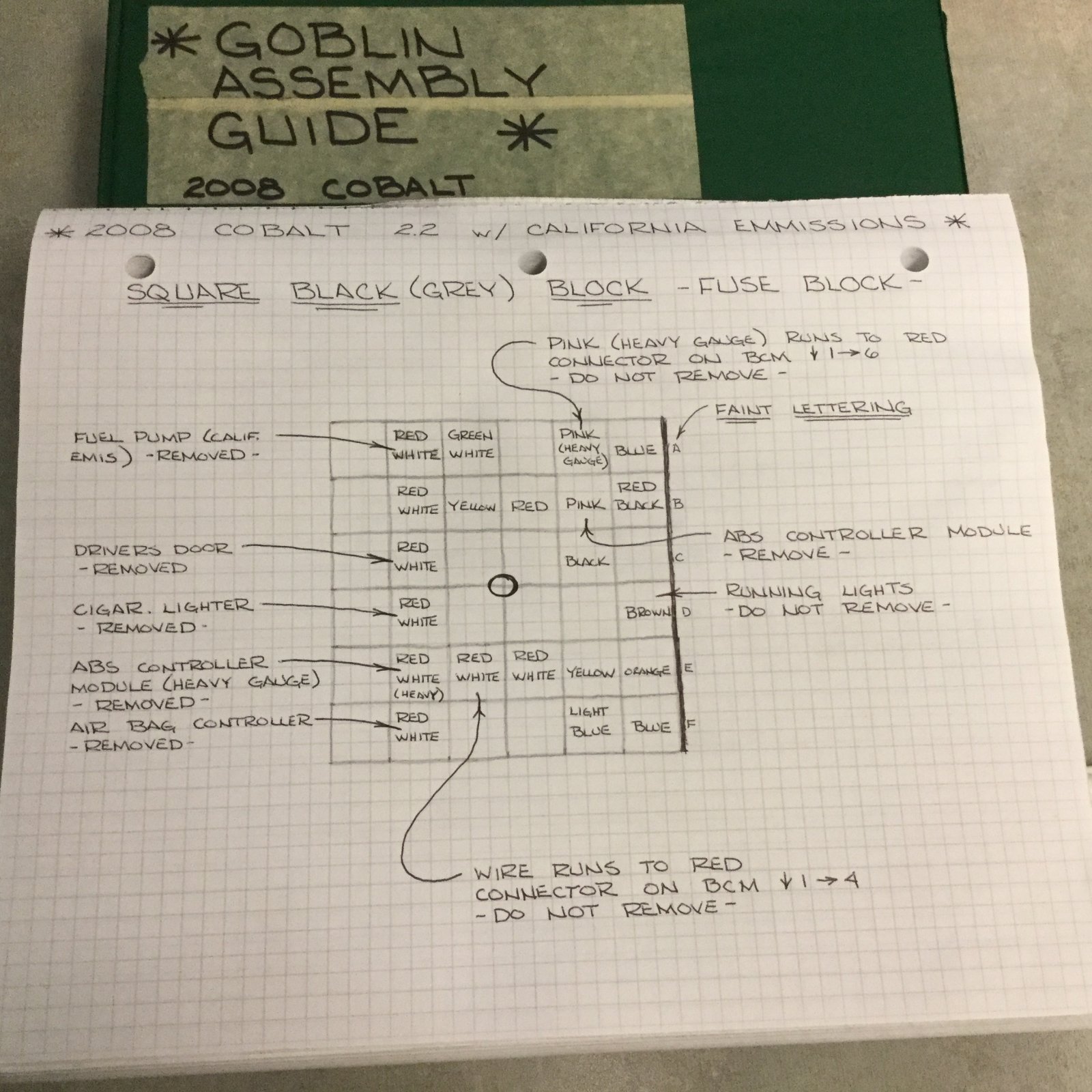

I show for a 2008 2.2L N/A wiring that the taped red/white wire at row F is the air bag controller wire and can be removed

It's "probably" the same but there are occasional differences.
You might want to pick up an month of all data subscription to get you through the wiring. It would probably be easier on you than having to wait on answers.
If you post the wiring diagram we can help interpret them. Likely still faster than asking questions without some documentation. It's hard for us to remember all of the details of the various models especially wire colors and pin locations.

The light green reverse lamp wire originates from an eight-pin connector near your fuse box on SS/SC donors. This connector connects to your engine harness.
