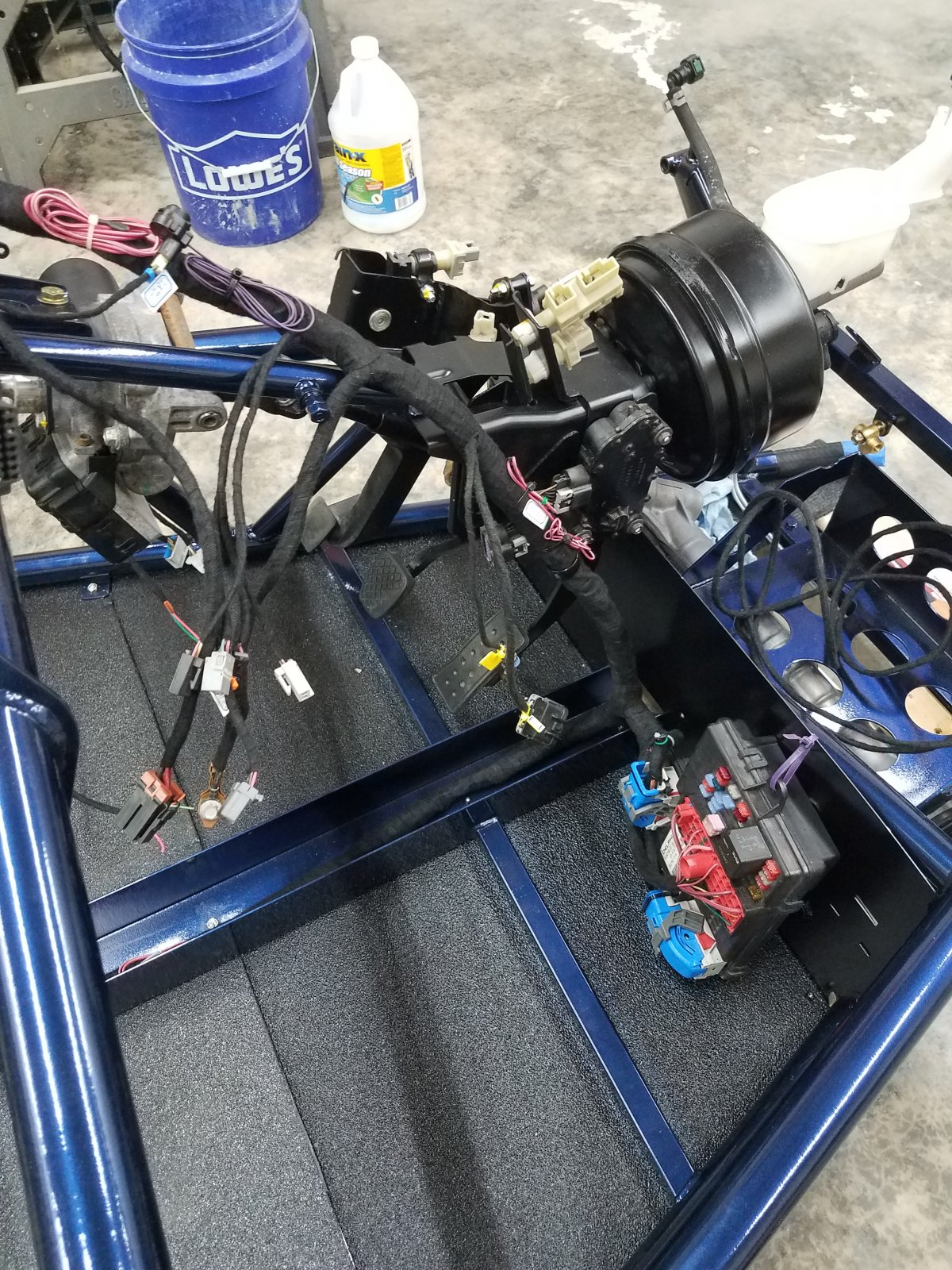

1. - pretty sure the purple wire is one of the fog light wires. It is left in for accessories and not required. You can see it in the pic below.
2. - one of the greens doesn't get soldered to the others. I can't recall which one, but if memory is correct, the big group w/ stays together and there is a stray green that doesn't get grouped. I had to go back and fix mine but I didn't document it in my build.
3. - the turn signals are built into the mirrors so left pair to the switch area mirror mount and the right pair along the dash bar to the right mirror mount.

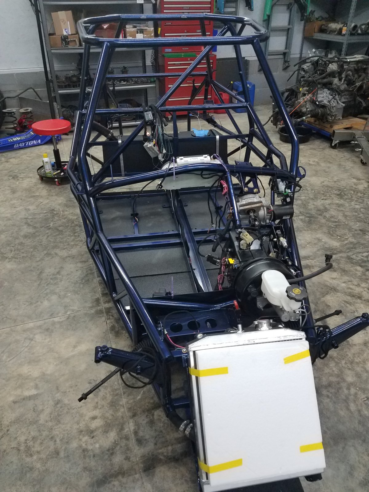

It's hard to see in this pic, but your main bundle after the BCM will run up towards the dash then split off to the left and right depending on where it goes: throttle, brake lights, clutch, grounds, power steering, cluster, ignition, turn signals, anti-theft box.
