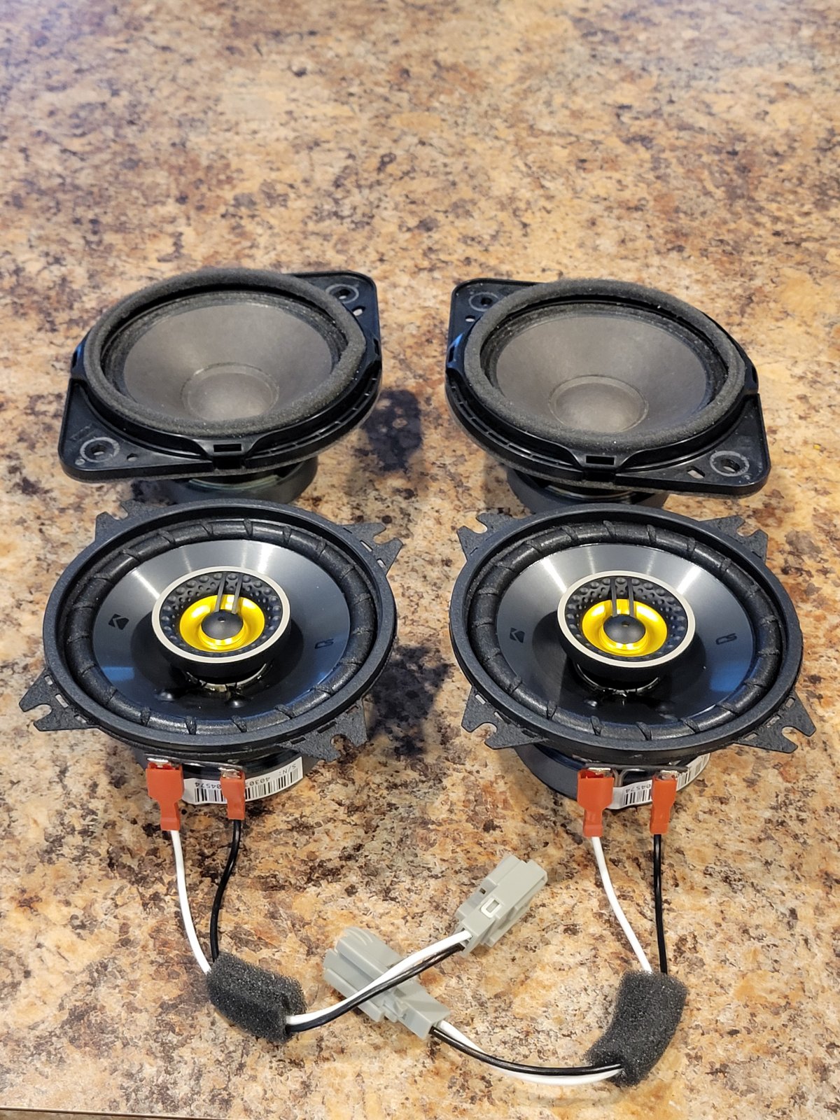

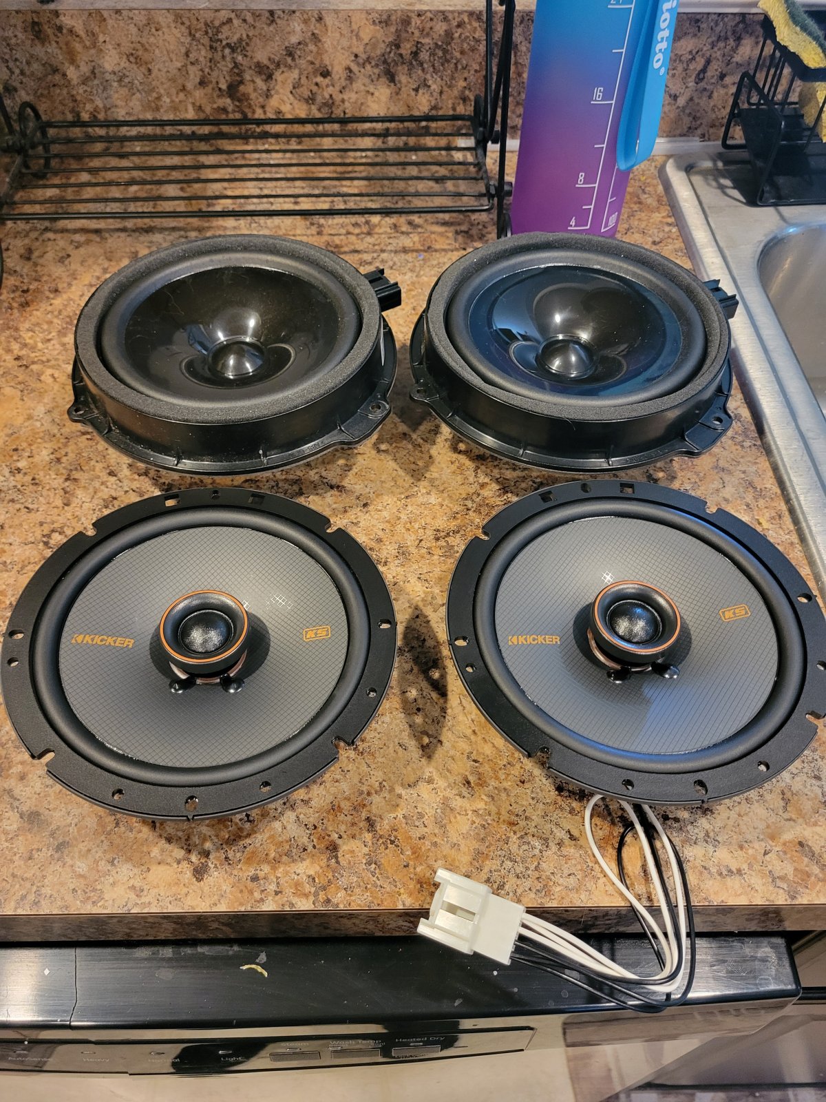

Replaced the door pockets and installed the six midrange speakers, today. Man, I am hurting. Since this buggy is meant to compete with the Jeep Wrangler, the doors come off ... and since the doors come off, Ford designed the door to be as free of electrical as possible, so the kick panel speakers are in front of the doors, well under the dash. I may have been a great contortionist in my teens, but not in my 40's. I'm gonna pay for that sh*t tomorrow.
Anyway. The stock speakers are an abomination. Here are two pics of what I replaced, and what I replaced them with. The audio quality is already MUCH improved, but the new speakers are still receiving a low-power signal from a factory radio that has equalization applied to it, so it won't sound GOOD until I get my wiring and get the amps installed and configured.
Two sets of these, dash and rear seat pods:
One set of these, in the front kick panels:
