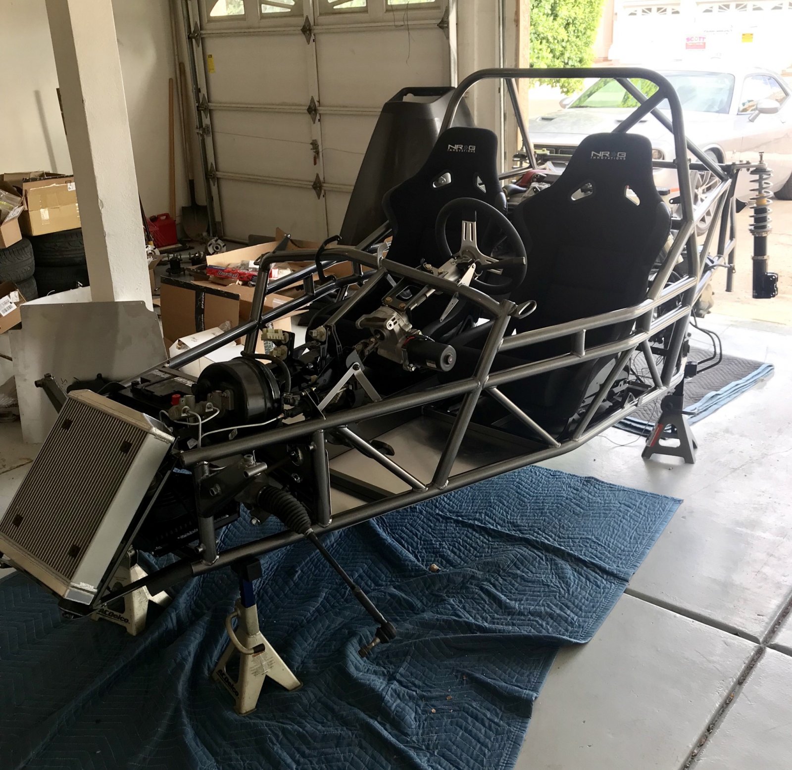

Has anyone used NRG seats? Specifically with the DF seat brackets? Wondering if you liked them an would suggest using them to anyone else. Some pics would be great. Thanks!!!

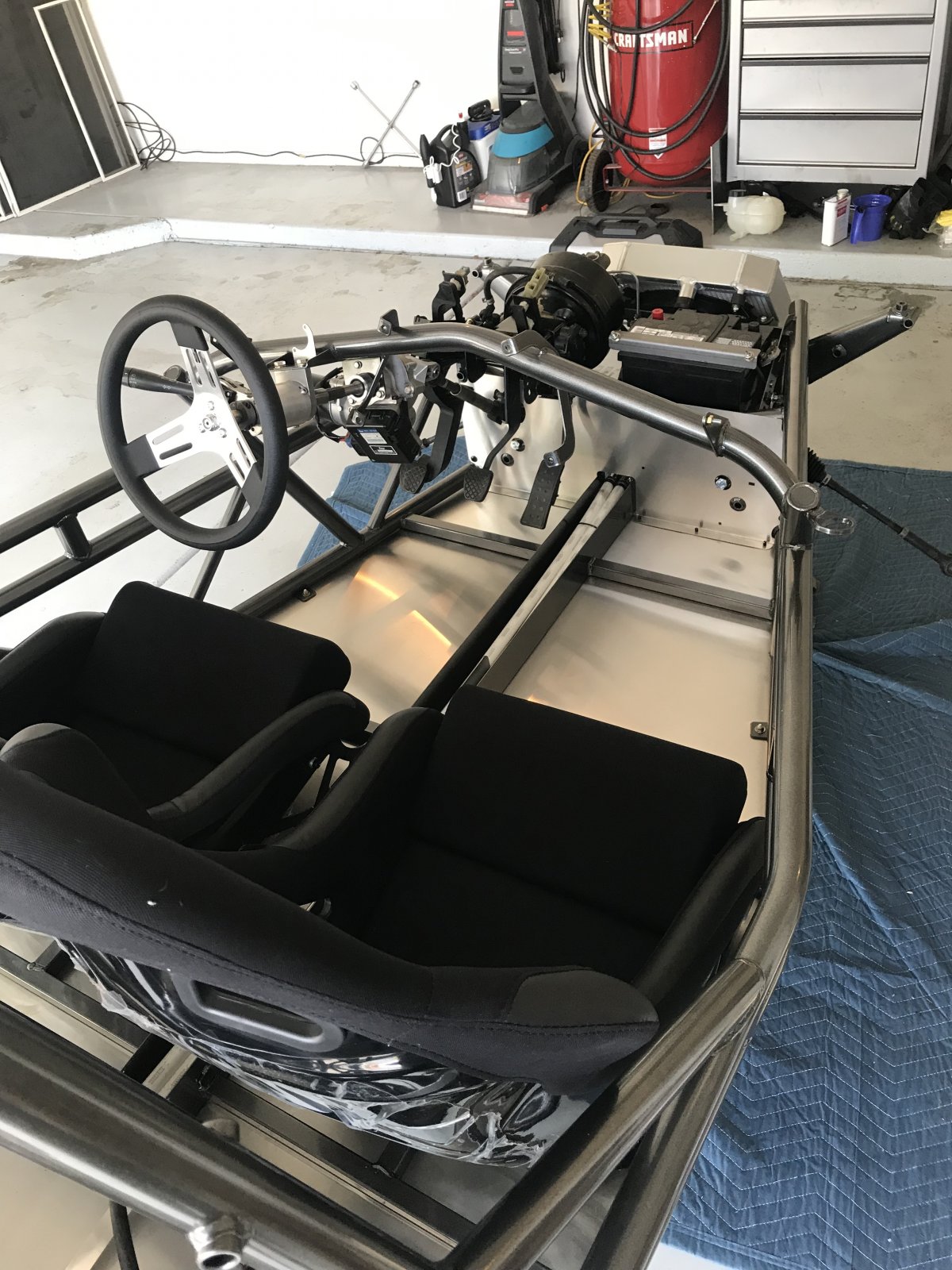

Well, unless something has changed, the DF brackets are meant to be used for the Corbeau's. I'd imagine they could be adapted to be used...but they mount from the sides. so the NRG's would need to be similar. Most of the NRG's that I've seen also come w fixed brackets.
This is my set up. Then the NRG seats below. You may just do some research and see what the distance for the holes are for each.

Yeah I have a feeling the side mount seat bolt pattern is standard, so most if not all side mount seats would probably work. I could be way off base here...but I don't think I am.

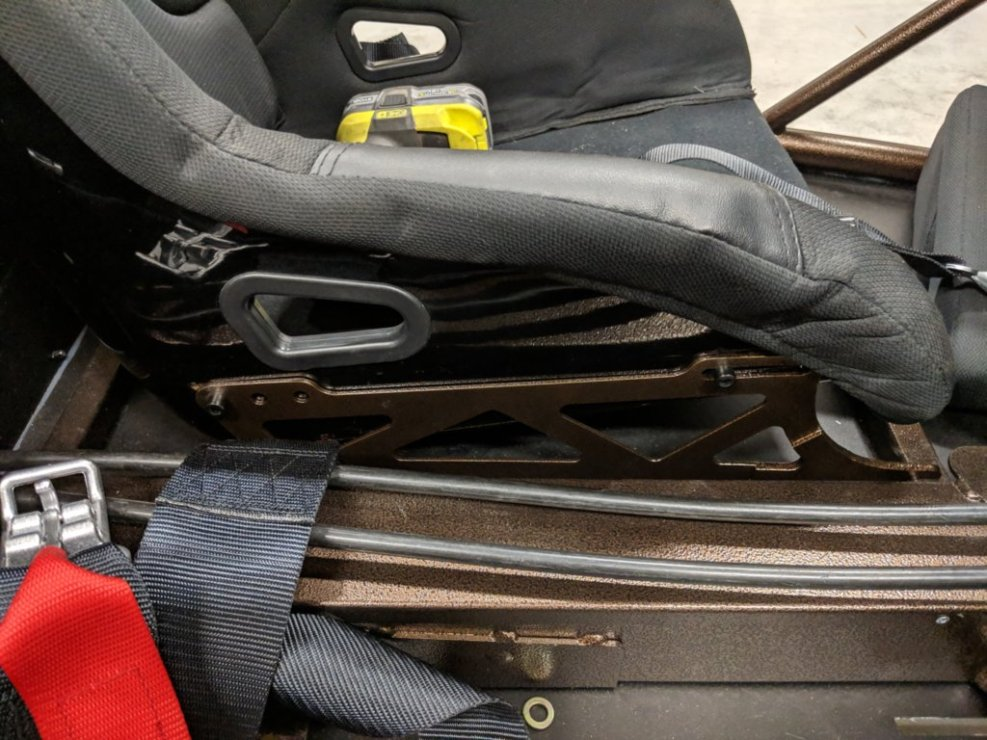

So the NRG FRP-301 seats bolt right up to the DF seat brackets. As I suspected, the NRG seat and the Corbeau are the same dimensions for the most part. I had to figure out the puzzle of which seat bracket goes where, but I am pretty sure I have it figured out now.

Those look good. Good price for seats too

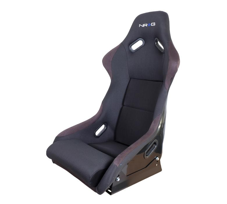

I'm liking your seat choice but prefer suede/alcantara. The NRG website has the FRP-302BK-PRISMA with measurement specs but doesn't list the measurement specs for the 301's so I can't tell if they're based off the same base size or not.
What's the measurement of your seat from the point of where the brackets attach on the side?
The Prisma's sized here: http://www.getnrg.com/image/cache/FRP-302/PRISMA SEAT DIMENSION-780x700.jpg but I can't find anything for the 301.
