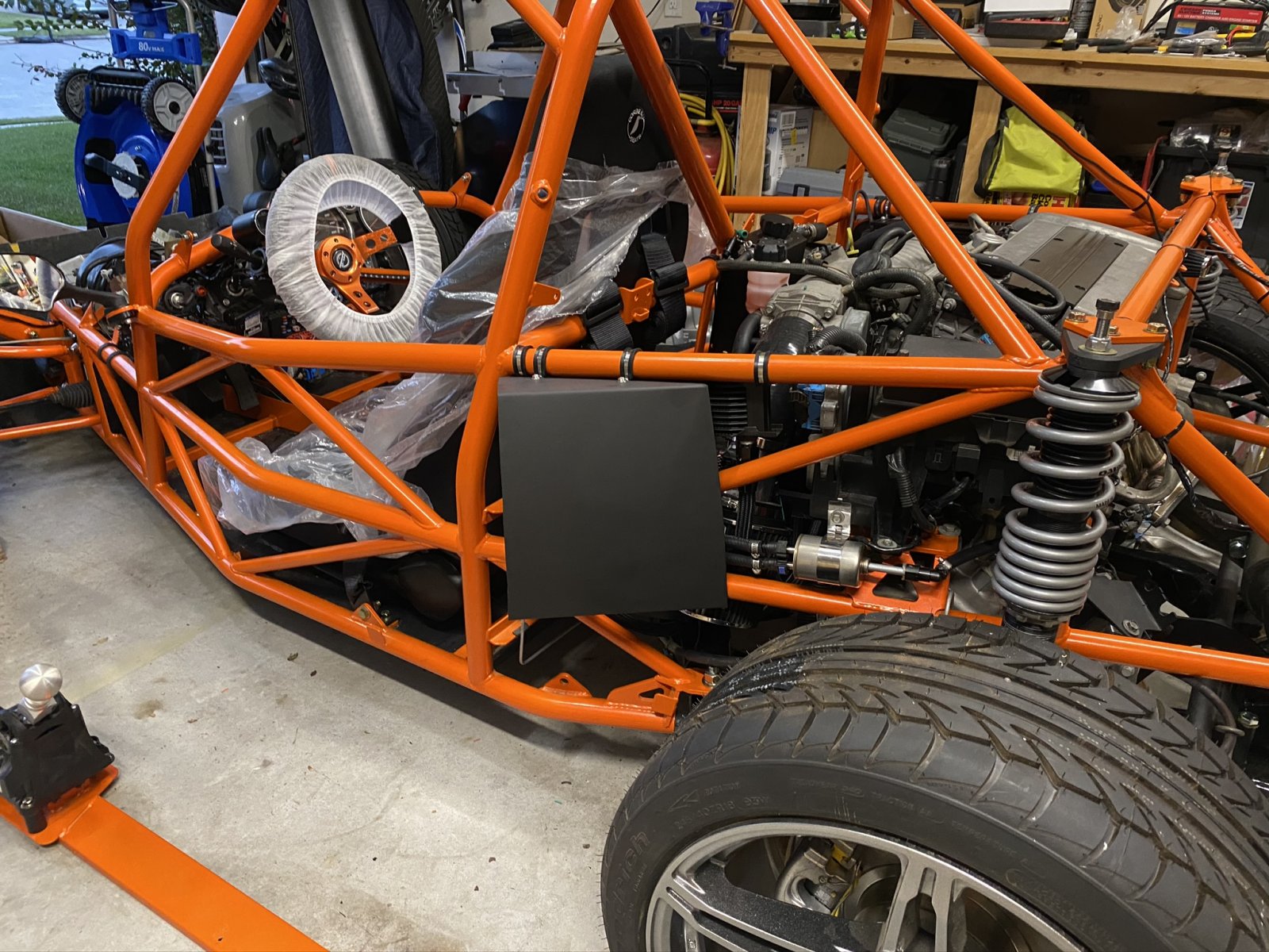

I ordered an oil cooler adapter, and I'm going to do an external oil cooler. I already have the cooler fittings hoses and everything needed. Can I swap the one hose for the coolant tank which comes out of the water manifold upward to one of the old oil cooler coolant lines for easier plumbing next to the fuse box? They are all connected so I assume this would be perfectly fine right?
Getting rid of that cooler in there will free up a ton of space for wiring and stuff to be easier to manage.

I've seen that, I don't need to do that luckily, the housing itself is fine, eliminating the oil cooler is a whole separate part, I just wanna make sure I can cap the usual port we use and use one of the oil cooler ports for the coolant tank. Which I'm pretty sure will be fine. Just wondering if anyone else has done it
P
I looked at the spare water neck section I have. I definitely will be able to use one of the oil cooler lines for a better routed coolant return from the expansion tank. I'll throw up more details and pics when It's all done.

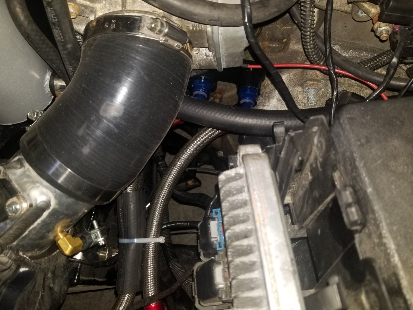

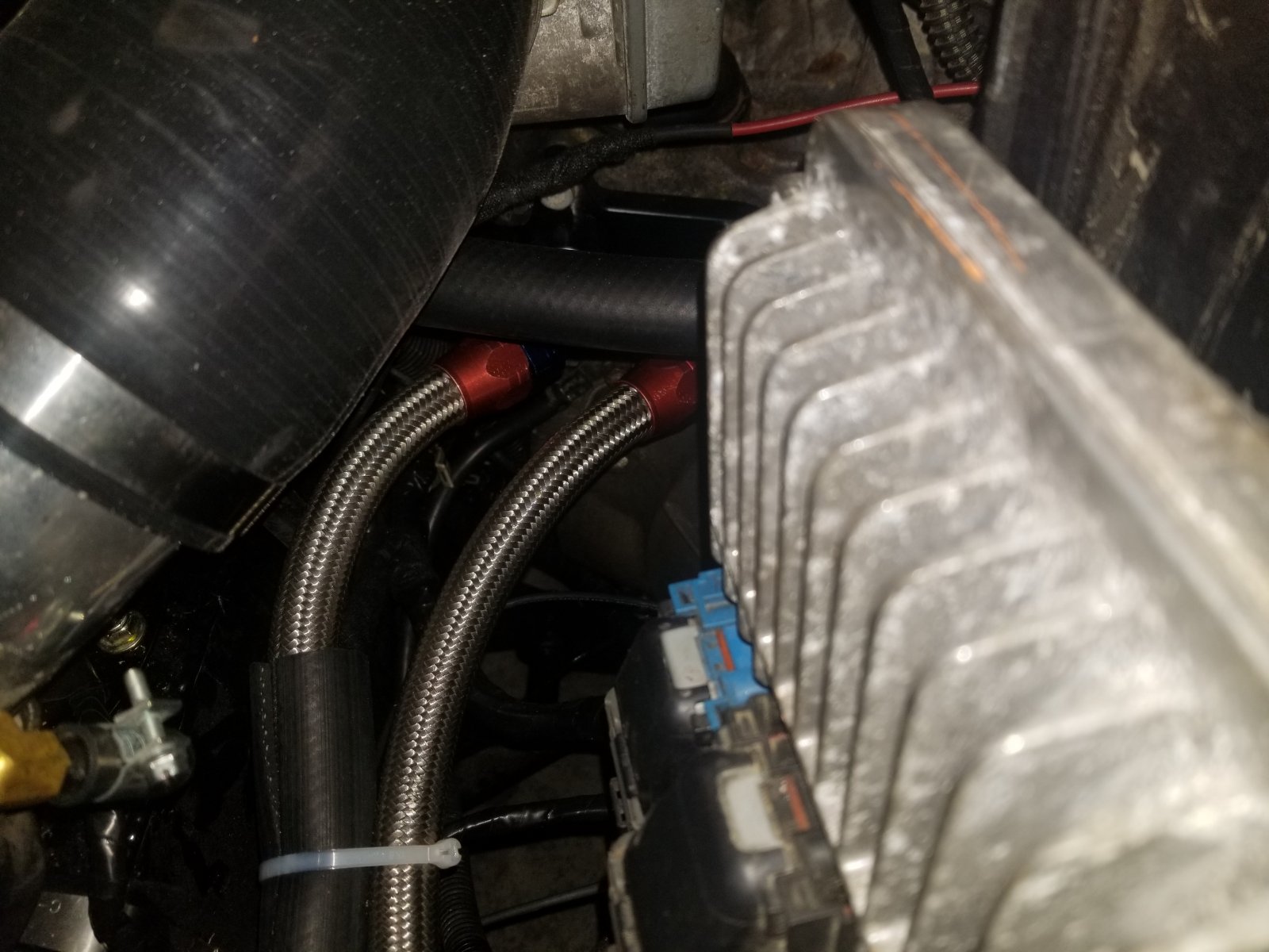

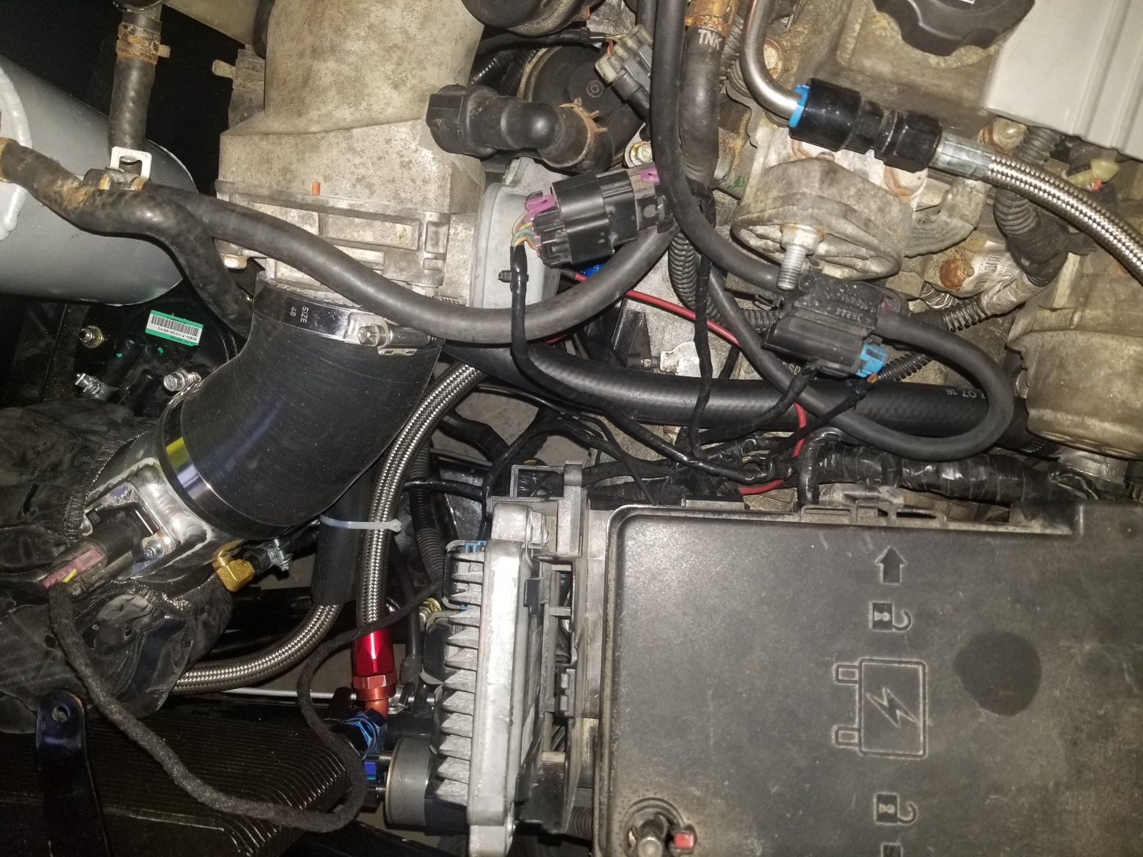

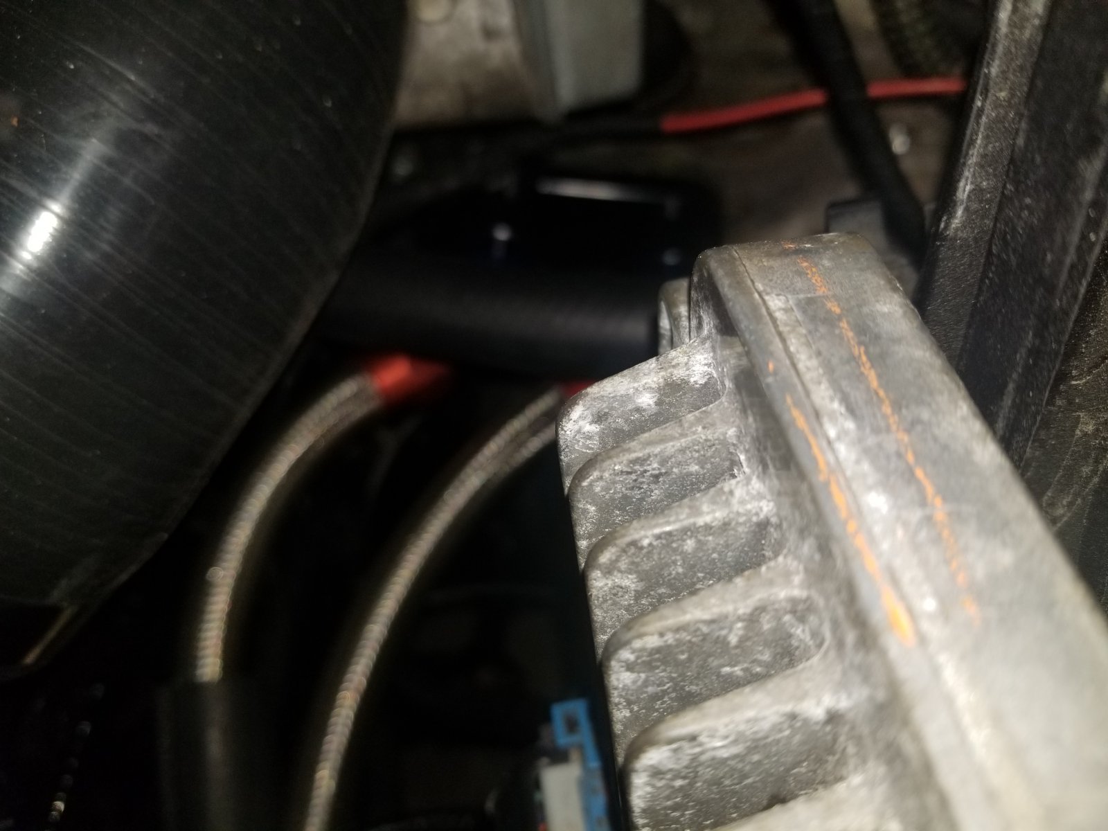

Here's the pics, it was hard to get a good angle that showed the space, but it makes a HUGE difference, I can full palm a basketball, huge hands and there is now a ton of room for me to fit my hands there and reach anything. Once I relocate my fuse box, that entire side of the engine bay will be completely empty.

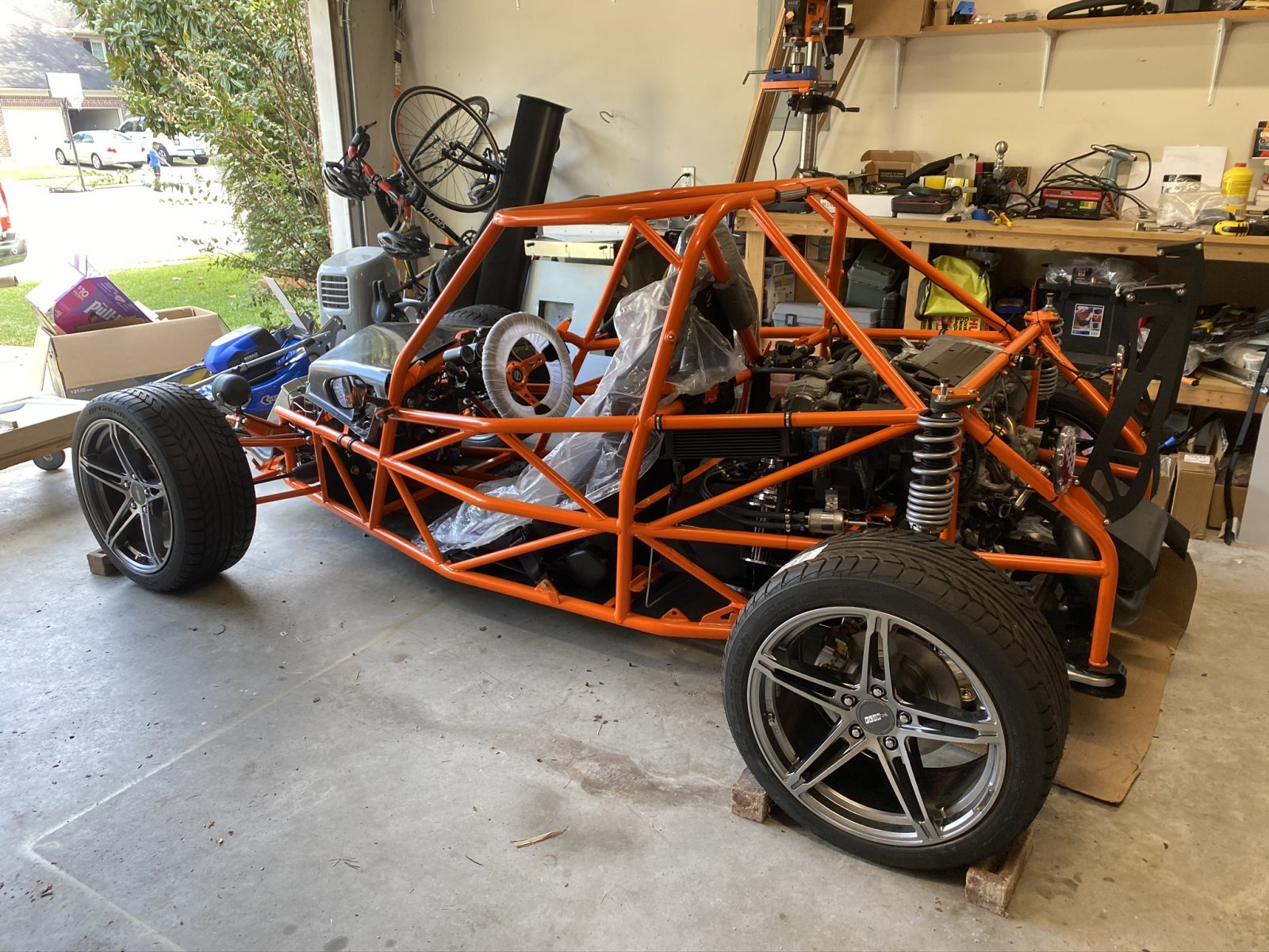

I've been playing with the idea of adding a swirl tank behind the passenger seat in the upper radiator hose in order to eliminate the need for a coolant tank but I haven't come to a conclusion whether it's possible to completely eliminate the tank or not.
SACTX

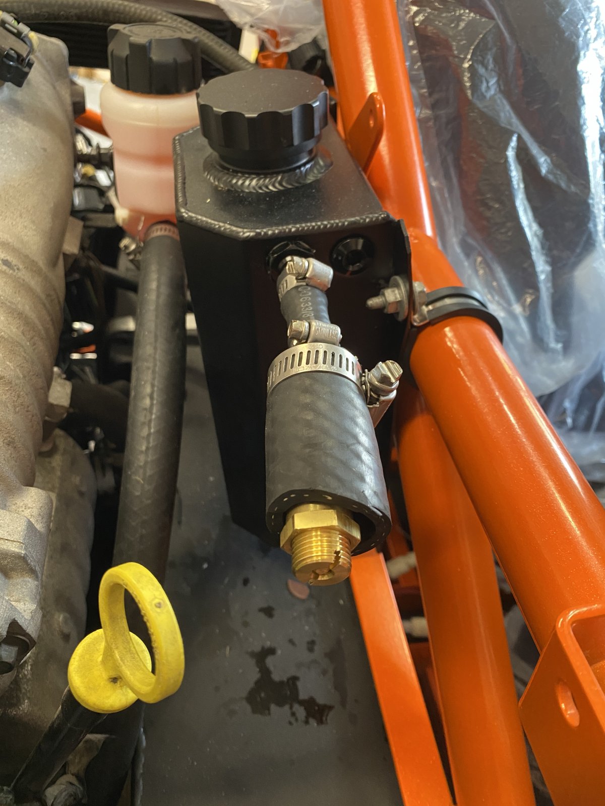

I did the same thing. Both the oil cooler and the tank but I used a different tank for both the coolant and a small tank/filler for the intercooler.
I have dual oil coolers on each side behind the scoops.
The expansion tank I got wouldn't work with the coolant tank cap so I used the overflow with a pressure regulating valve at 15 psi to pressure the system and not over do it. I started it out as a swirl tank/overflow (non pressurized) only but I changed it after some talks with Russell and Jason.
Like this, my coolant temps never even get above the 160s while driving in 70-80 degree weather.

I am about to install my oil cooler. The (2) coolant lines from the thermostat to the factory oil cooler did you just loop these at the thermostat since I am assuming the new cooler is air cooled?
devianteng
That's exactly what I did, just looped them like you do the heater hose connections.
