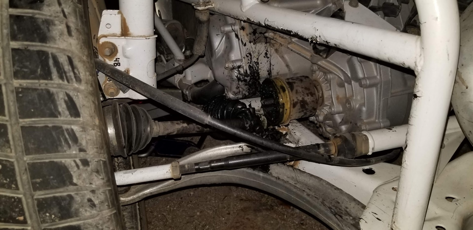

The axle pulled out, spreading grease everywhere. I managed to coast off the side of road, and walk home. I got my van and I wanted to tow the goblin home, but the axle was flopping around, as it was only attached to the wheel. So I used a ratchet strap, did one lap around the axle, and secured the 2 ends. The grease prevented the nylon strap from overheating, and I was able to tow it 3 miles home. Next time Ian says "T bet you can't get air over the railroad tracks", I will not try, as success is sometimes messy. The goblin got cleaned up, and new axles, once the parts arrived.

Looking back, well that was a pretty dumb thing to do... yes a goblin can accelerate quick up a hill, but I spun up the rear wheels as we flew over the tracks, and when we landed, the sudden stopping of the tires is when the axle popped out. I wonder if the AT version of the goblin has limiting straps?

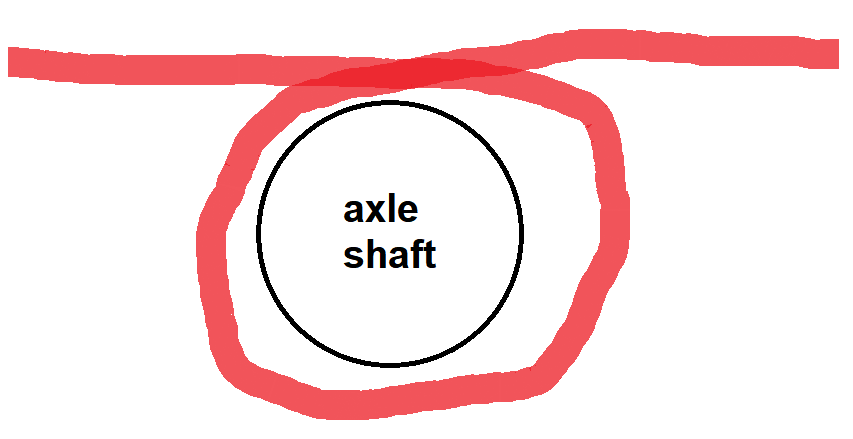

Did you strap it like this? How confident were you that it would hold? Were you able to watch the axle spin in its new home for a few feet before you started rolling down the road??

Also, watching Stadium Super Trucks taught me you never keep your foot to the floor when airborne, I'm pretty sure your grand scheme would've gone off flawlessly otherwise.

I wasn't very confident it would work, so we walked beside it when being towed, and it seem to be working. I knew not to keep it floored in the air, but still it did wind up a bit on liftoff. Of course the axle angle is pretty extreme when the suspension is at full droop, so I was taking my chances. It ended up being pretty good father/son time, as walked 3 miles home, then got the van to rescue the goblin. We got to bed at 3AM, but had a story to tell.
