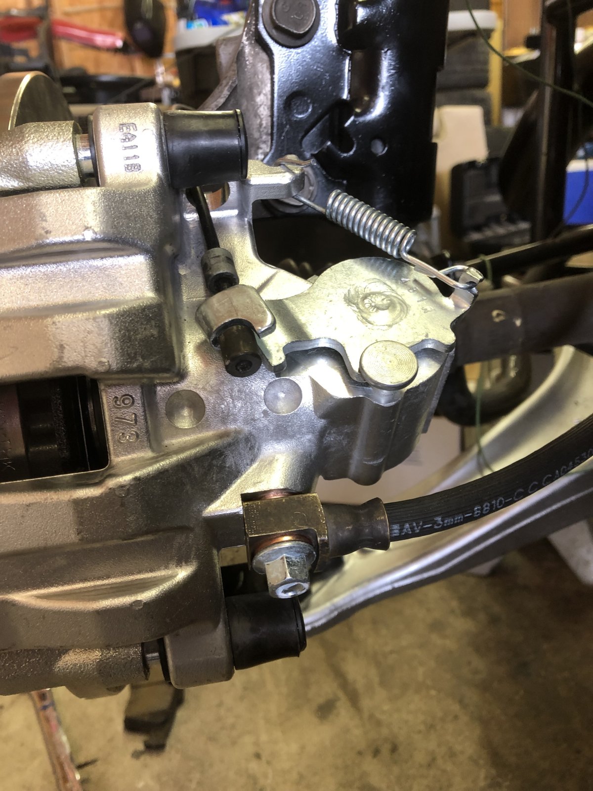

I purchased the solstice brake caliper kit from DF.. I simply was over looking things and the supplied bolts appeared to long but in the end it all fit.. I could not complete it cause it was late and had to go buy some brake pads.. I will post some pics. I know there were others that installed the parking brake kit but could not find any pictures.

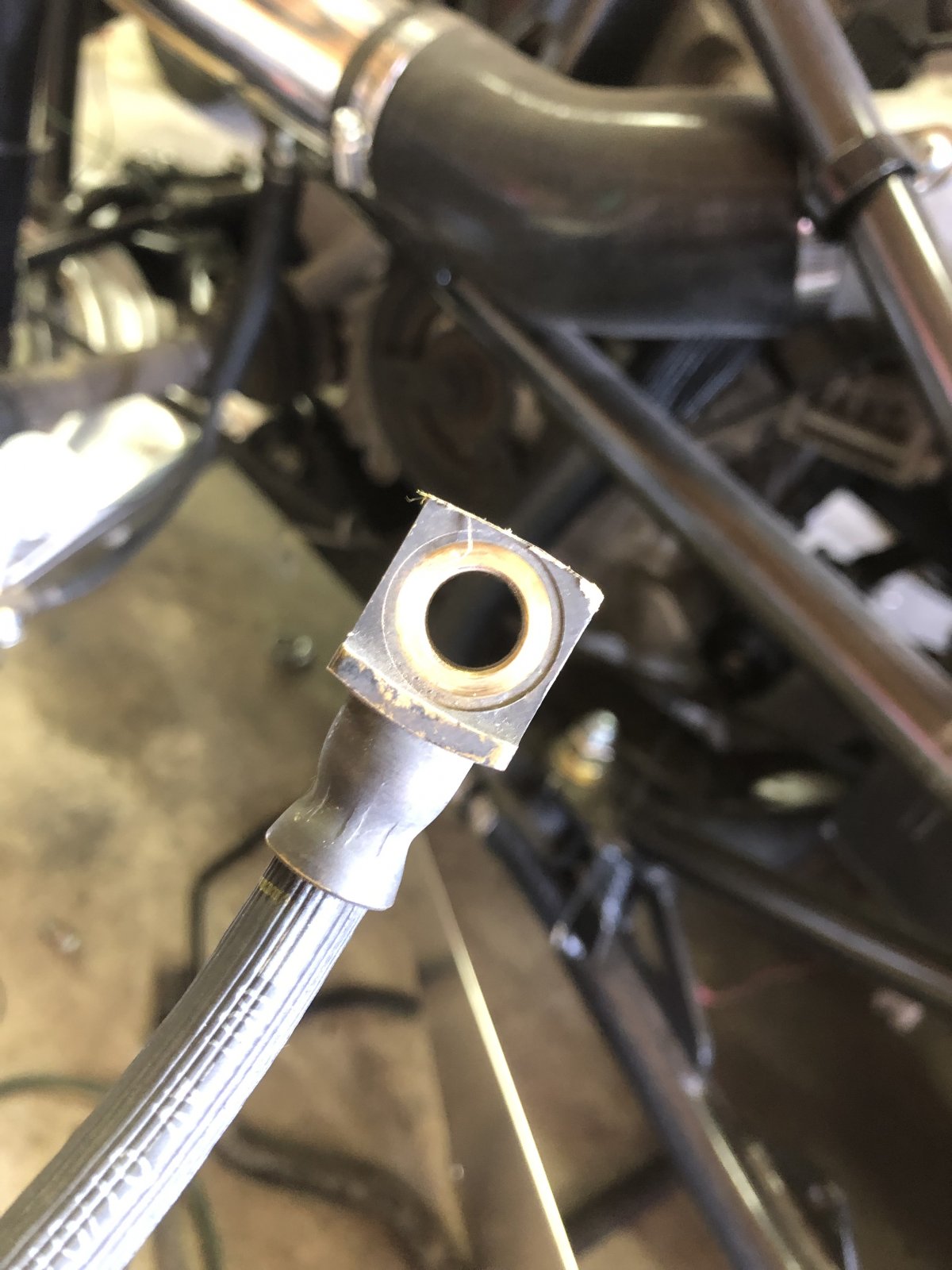

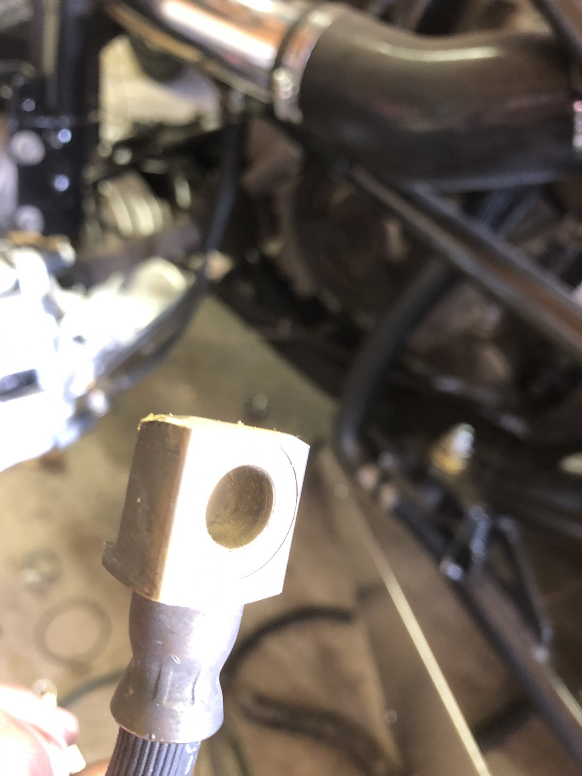

Thank you for the link, it helped a lot with routing the cables! I did however run into issues with the brake lines.. did you have to grind your brake fitting or was I supposed to buy a different brake line?

I personally only had to modify the brake line connector itself.. as shown in the pics I had to shave/grind the ends of the banjo fittings.. then the factory “front” brake lines fit fine.. I am unsure of what you are referring to with the other issues but I will check out the pictures when you post them.. and can snap some from my setup in the AM if you need them.. let me know
