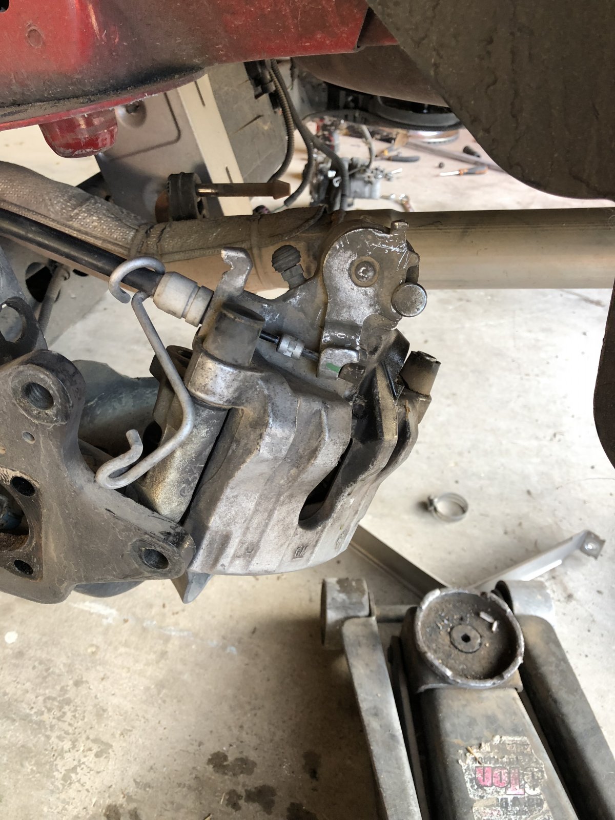

Anyone know of it the parking brake guide tubes are the same in an SS as they are in an base? The part is discontinued and so I'll have to pull it from a yard, I cant seem to find any SS's around.
Can't believe I just noticed this thread. Damnit.
Is there a finished e-brake/parking brake kit for the Goblin at this point in time? I still have my donor until Saturday morning so I will make an effort to pull the e-brake mechanism and lines out before then.

Absolutely, pull all of your parking brake setup.. DFs kit only cost 200-250 extra and bolts right up. From my research it is by far the most cost effective route
jirwin
So, if I'm reading this right, I'll need to pick up 2 of these since I have a 2010 LS?

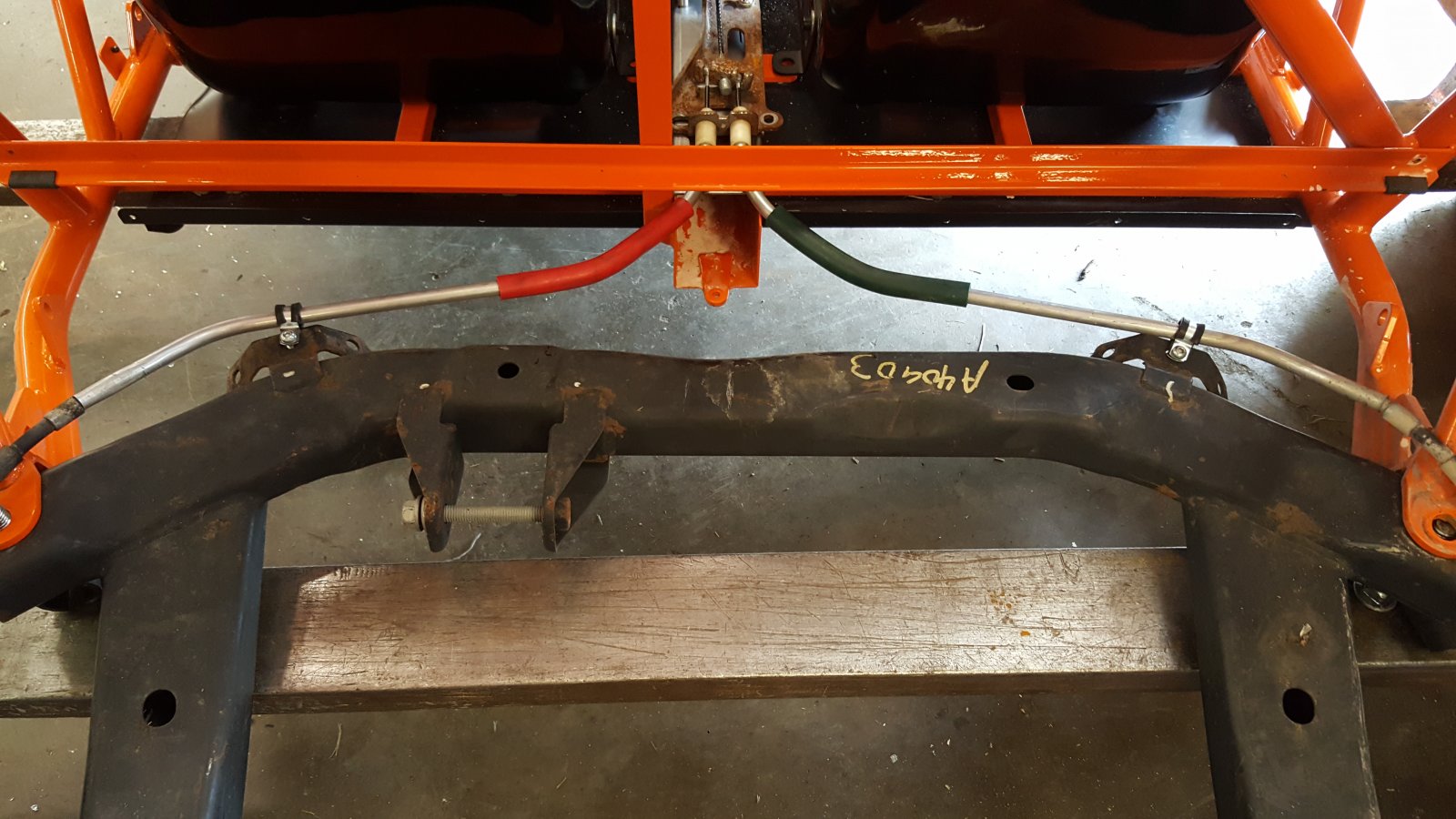

10199
But I can keep the red/green tubes for them?

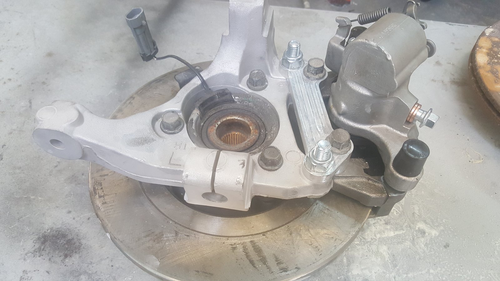

This may be a dumb question, but how did you guys fit the wire onto the caliper mount? I cut my stock lines cause this was such a pain and thought it'd be easier putting them on.... Halp

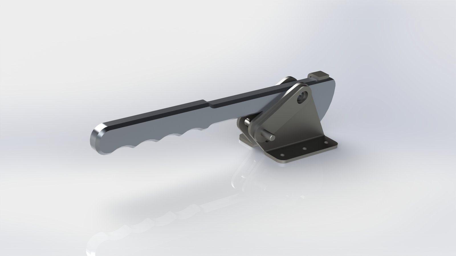

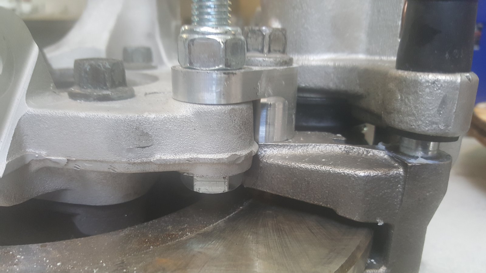

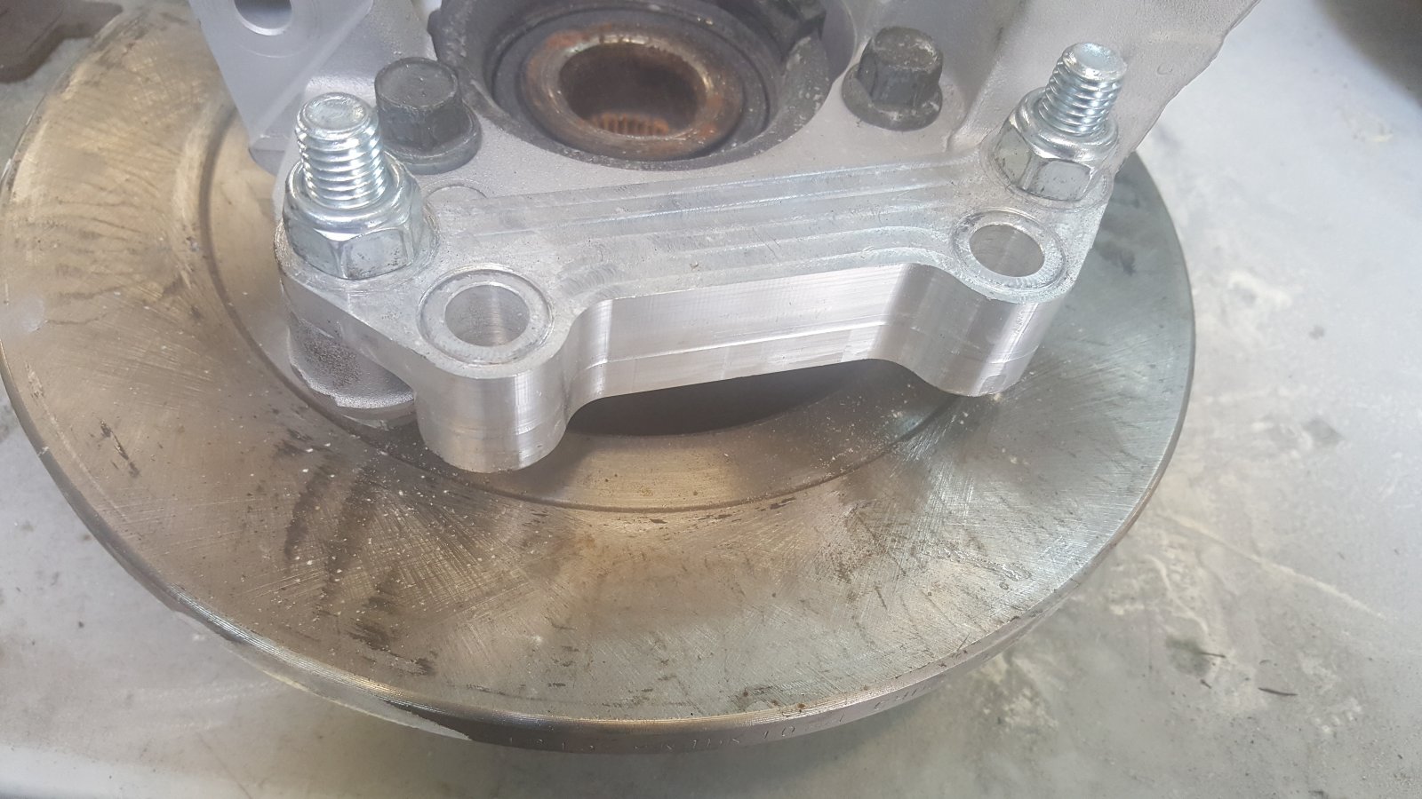

This is the prototype bake handle. We are fabricating one in house to test travel and function.
Then we will set up production. It is still a few months out.
The calipers and caliper mounts are available now for anyone with the ability to fabricate their own parking brake handle and cable system.
Hi @Lonny Did this ever get tested and go into production? Would like to know more about it please.
