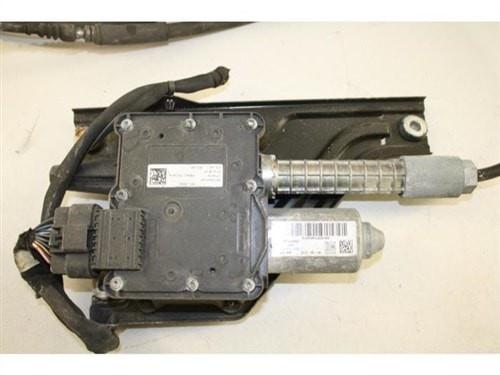

I bet the electric actuators car companies are using are lead screw so they are self locking. That way without power it holds.
I've used the link below model at work on a few projects. One in the link will put out 400 pounds of force at almost an inch per second in theory. Real world date gave us 32 seconds to full extension on a 24" stroke, and 52 seconds to full retraction at 24", running the actuator at 12.8 volts with 200 pounds hanging from it. These linear actuators are acme lead screw and will not move without power. Not astronomical in price either.
https://www.progressiveautomations.com/linear-actuator-ip66
Karter2026
This system would be good if you could hide it in the tunnel but it is too wide. https://www.americanshifter.com/cat...SCPB01/power-remote-mount-emergency-brake-kit
Here is what the Malibu used along with a few Buick's, and Nissan's. I think there was one fro each wheel on these.

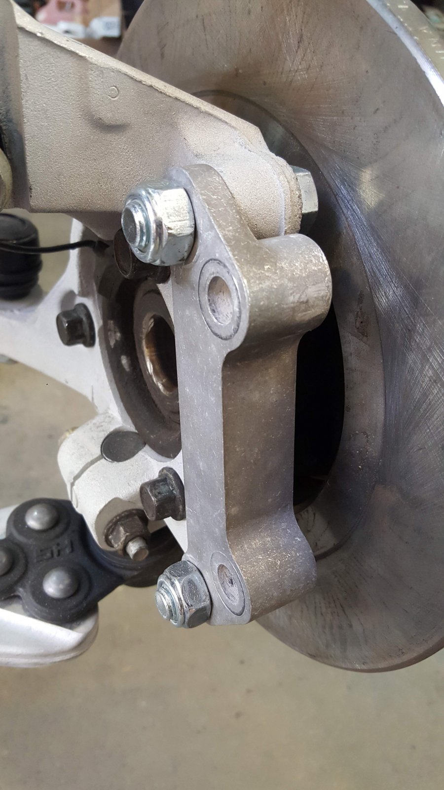

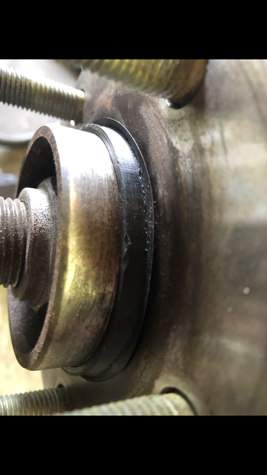

The Solstice rotors wobble on my Cobalt rear hubs. Is there suppose to be a centering ring to adapt these parts?
Christopher Sanchez
They should be in your kit. Mine were in a small envelope.. they are small 3D printed rings.. I have to lightly sand my hubs for the rings to slip on.

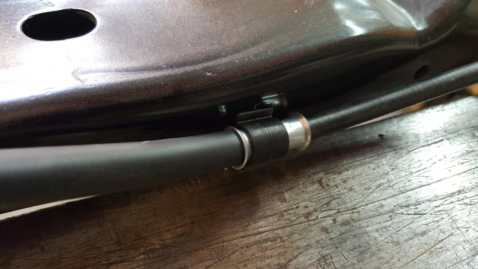

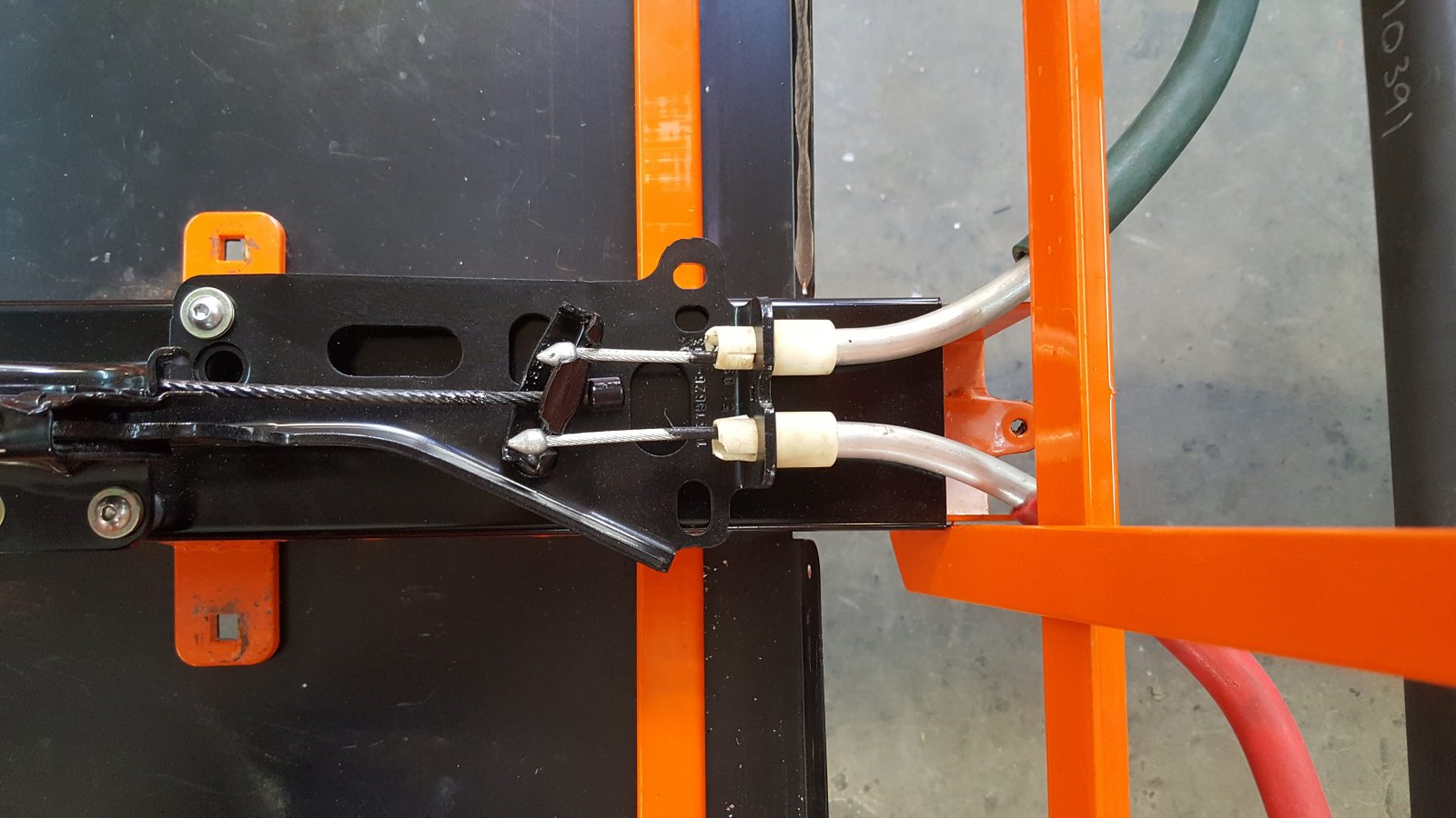

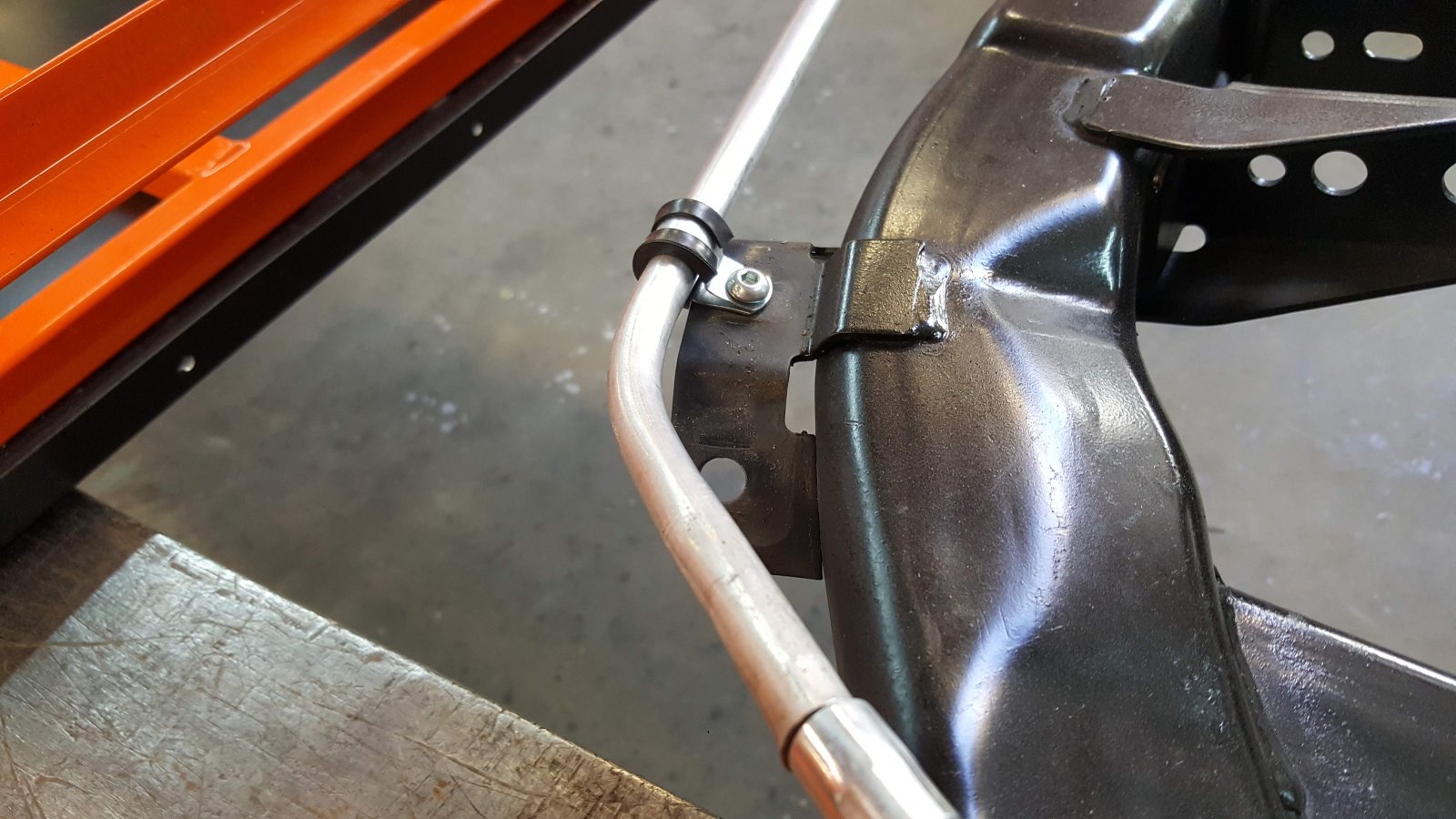

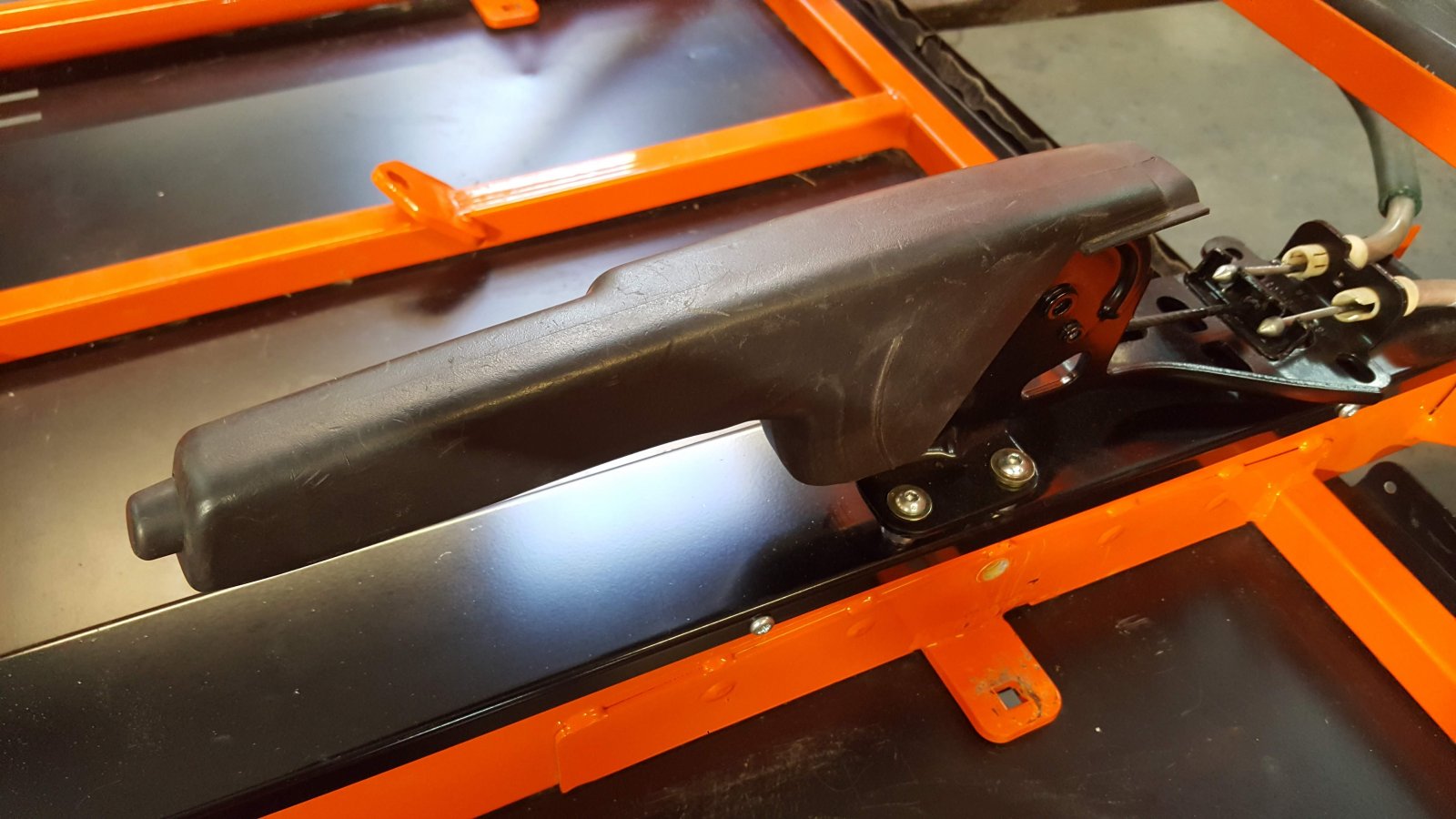

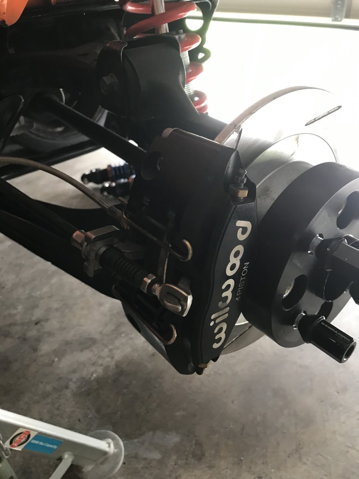

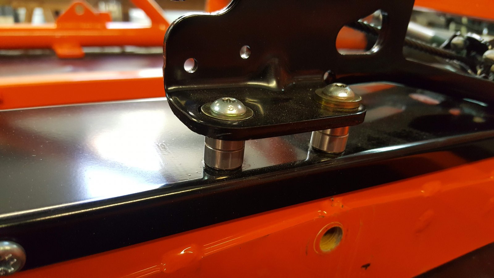

These are some images I took while test fitting a set of parking brakes.
Cobalt to solstice adapter
If you have chosen to remove the original radiator mounts you may be able use self drilling screws and attach it directly to the subframe.

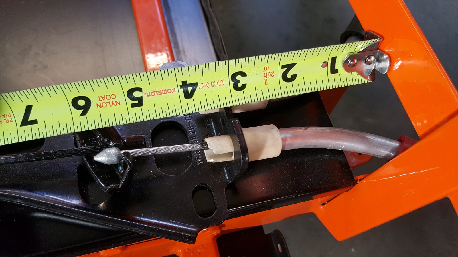

I had to bend the aluminum tubes a little to get them pointed straight into the parking brake handle. Be careful not to kink them.

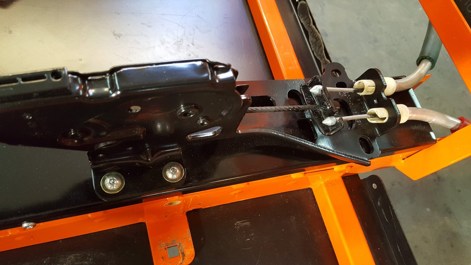

I ran the the shifter cables over the the parking brake. One on each side.

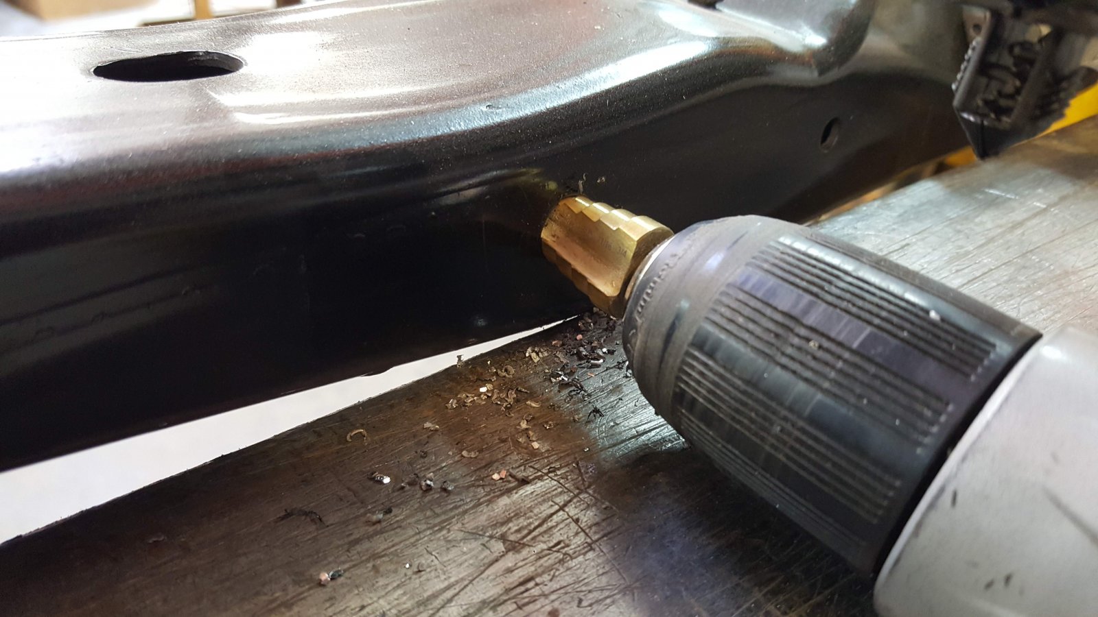

Use a step drill to resize the existing hole.
I used the original plastic cable support and pressed it into the subframe.
After everything is installed you may need to adjust the cables. With the parking brake handle down there should be just a little slack at the splitter.
You will need to drill three holes in your tunnel cap to locate the parking brake handle approximately three inches in front of the lower tank mount.

Thanks Lonny. I'm having trouble visualizing where you're resizing the hole for that press clip, can you show a wider shot?
I don't have that assembly anymore, I took those shots November of 2018. I knew I had them but thought I might have lost them when I switched phones. Luckily they were uploaded to Google photos.
