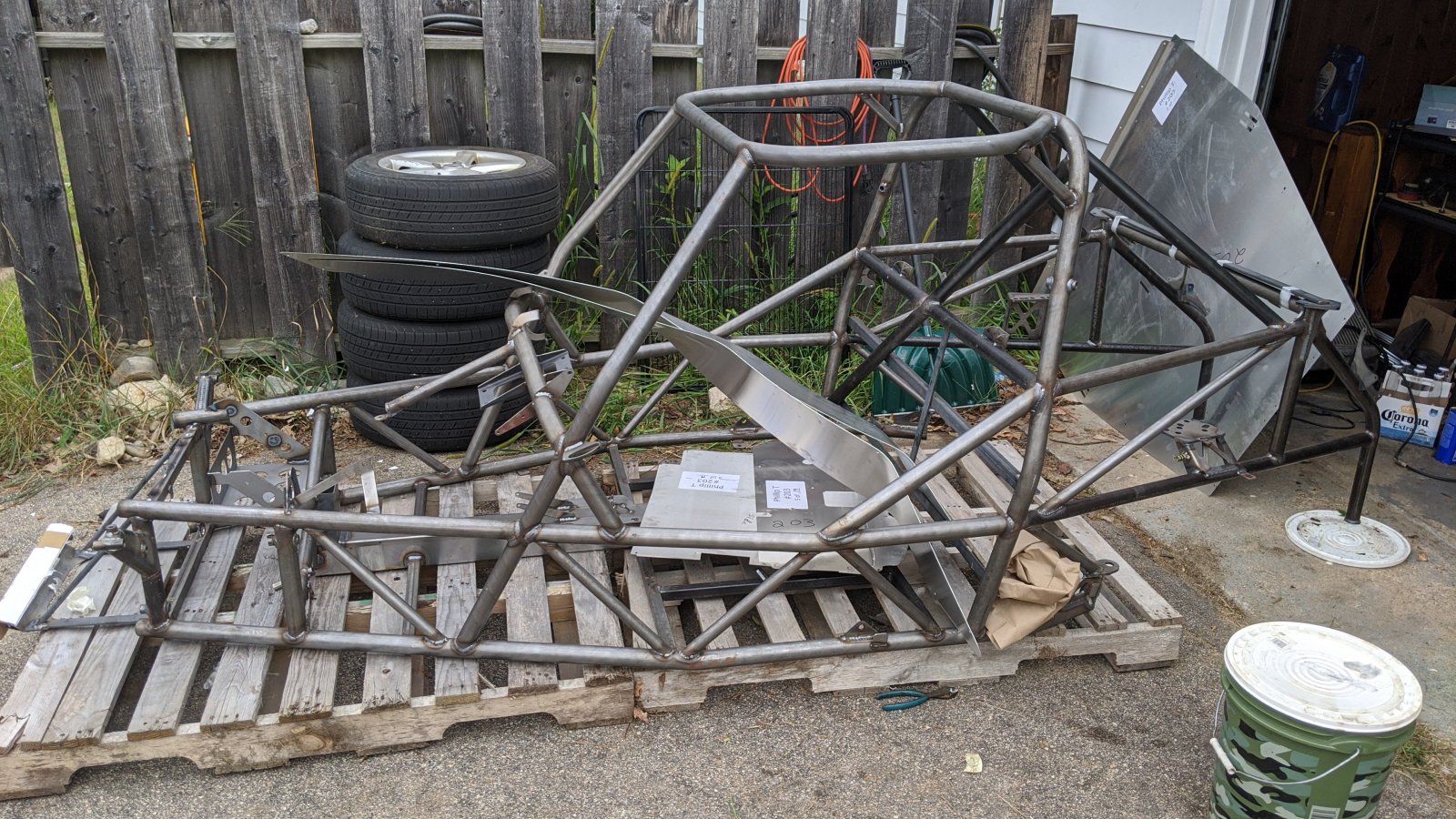

I stumbled across the goblin. I ordered (4/17/2020) my goblin as something to do as a had a possible pandemic furlough coming my way. Of course it never happened and I have been sitting on everything for almost a year. I plan to street drive my goblin
I have been lurking the forums for while now, I even met @RichN , as I also live in NH.
I have been doing quite a bit of work on it before I started this log.

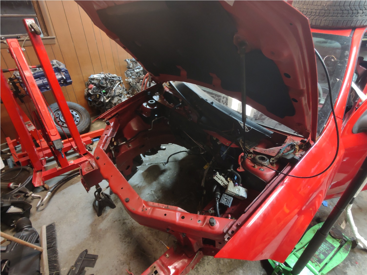

My donor is an XFE which stands for Xtra Fuel Economy. it is the most stripped version of the cobalt they made, didn't even have an arm rest. I didn't take any pics of the car before I tore into it. I am not using the 2.2L L61. it will be replaced with a forged 2.4L LE5

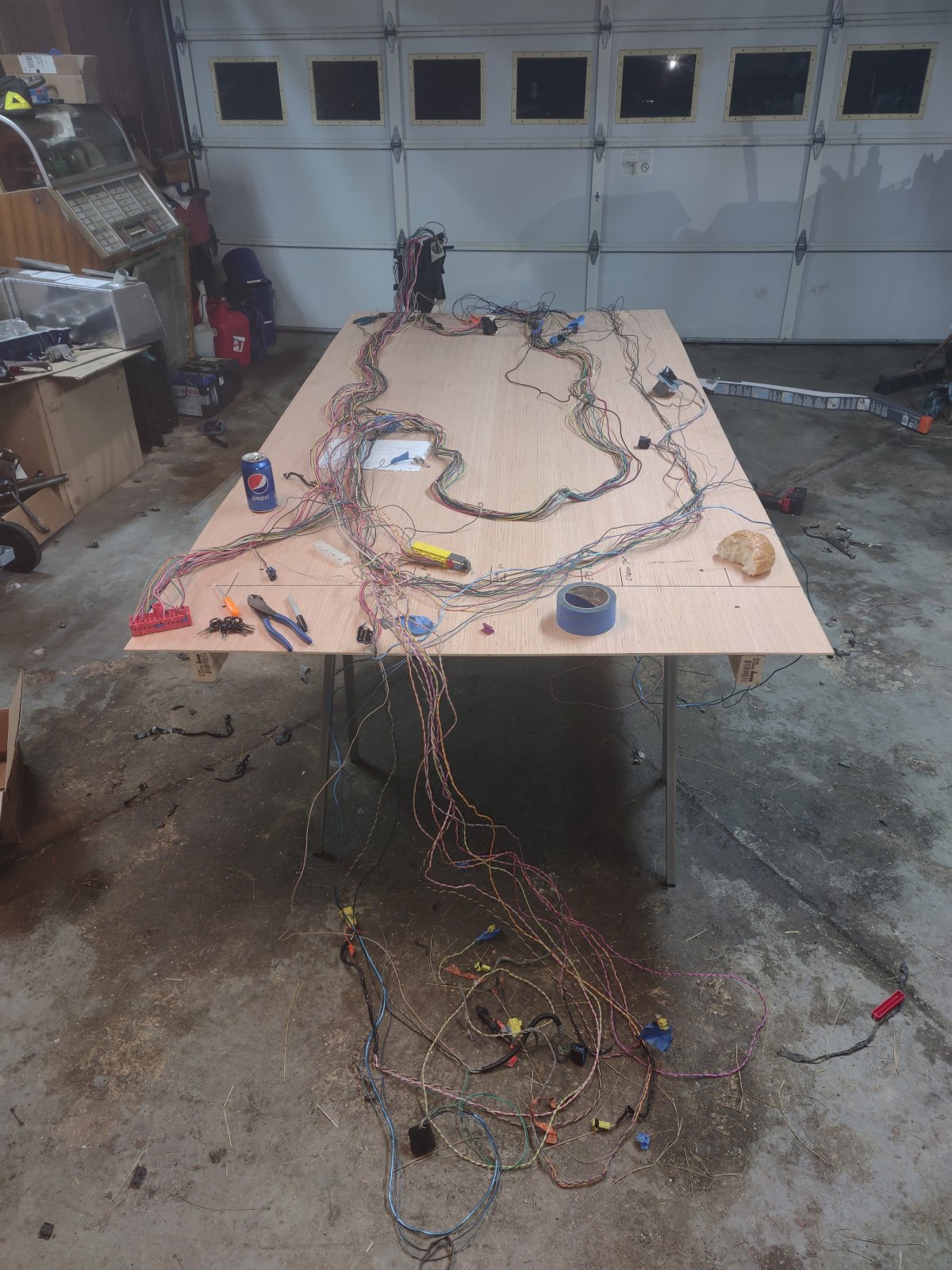

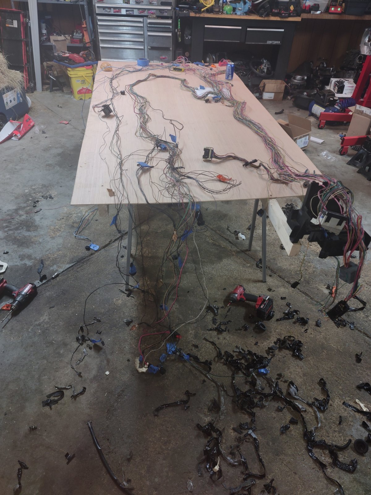

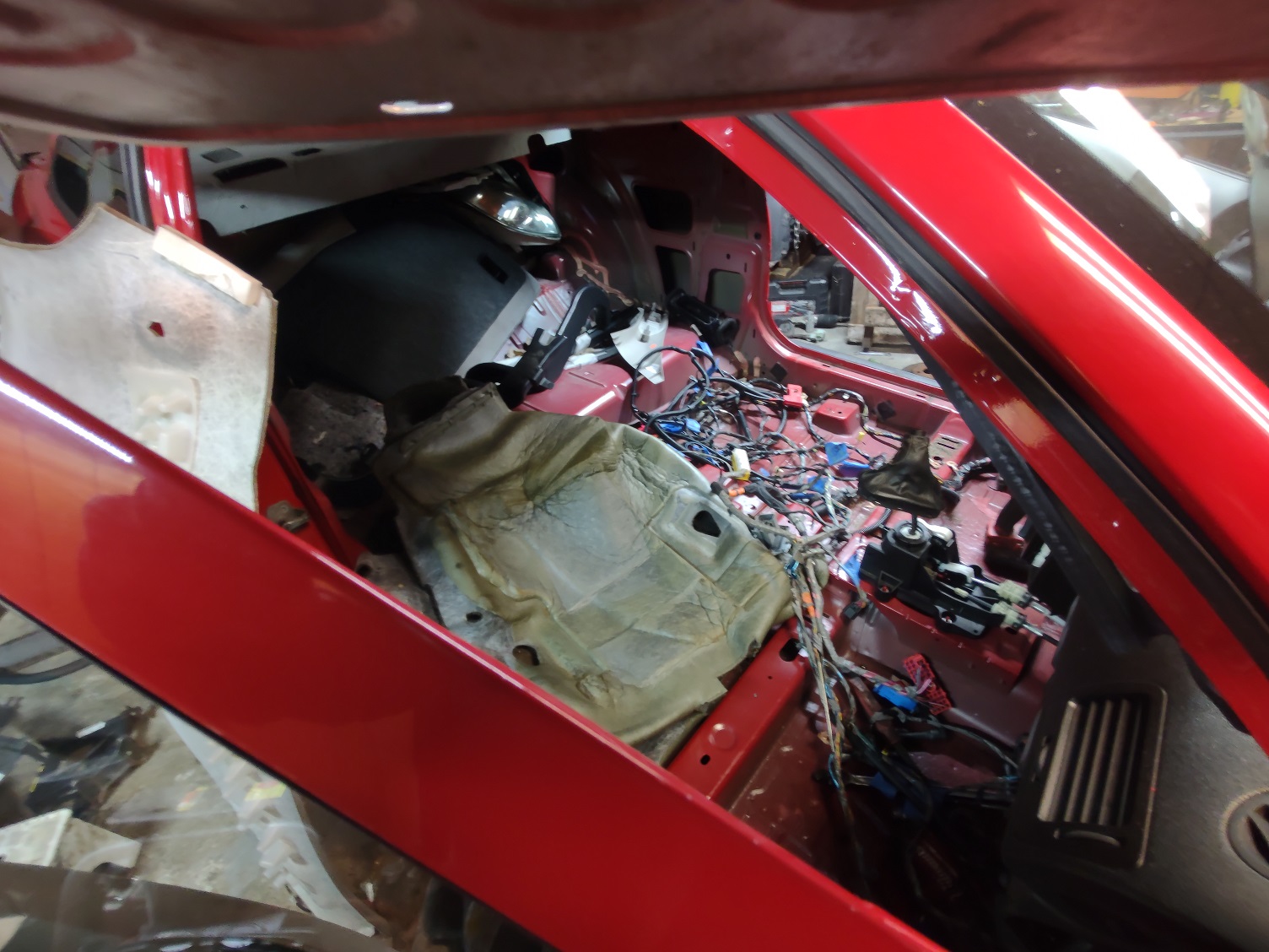

I spent a lot of time looking at the wiring diagrams for the cobalt before I started to rework the harness. I used thin insulation motorcycle wire sourced from 4rcustomswire, they are fairly local to me, but they do free shipping to lower 48 on most products and they do striped wire
I made some modifications to the original design.

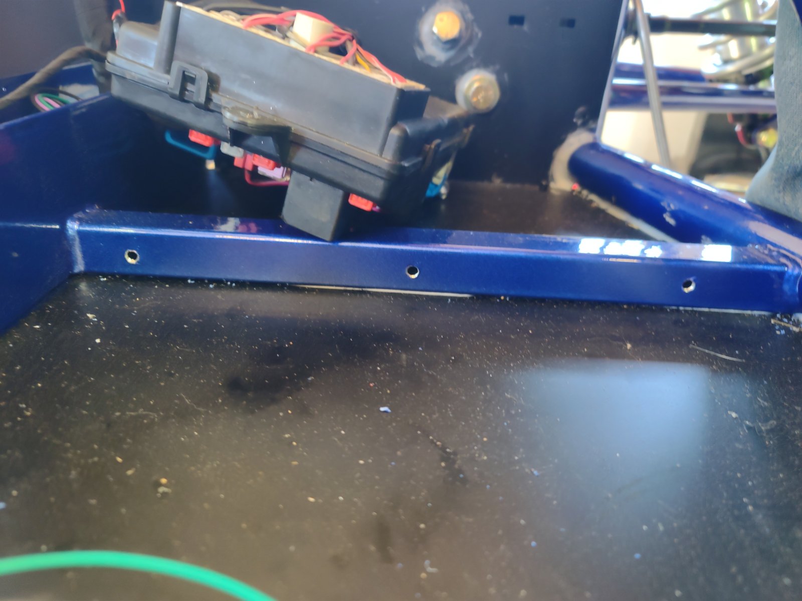

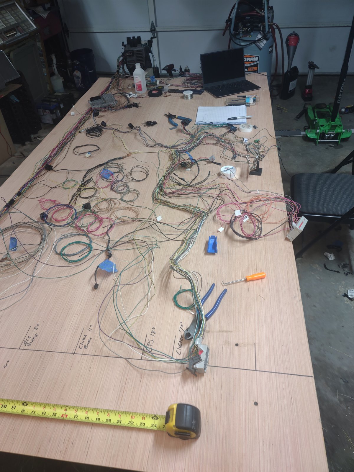

View attachment 21779View attachment 21780View attachment 21781

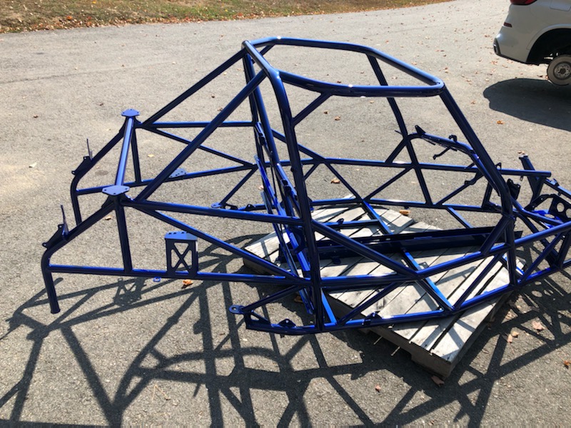

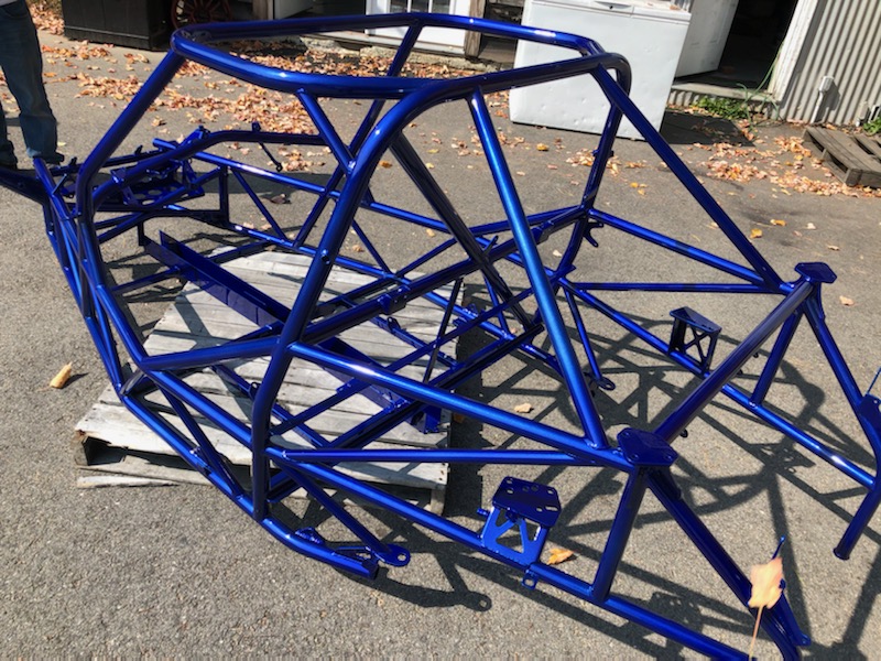

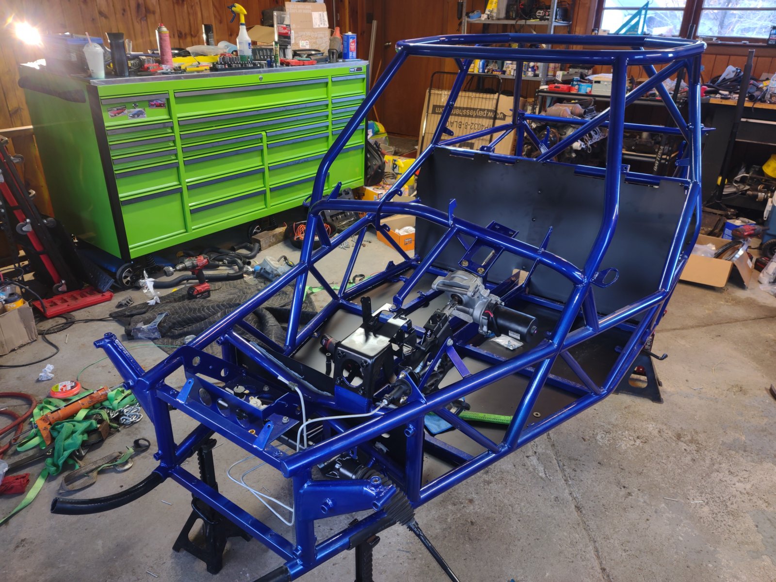

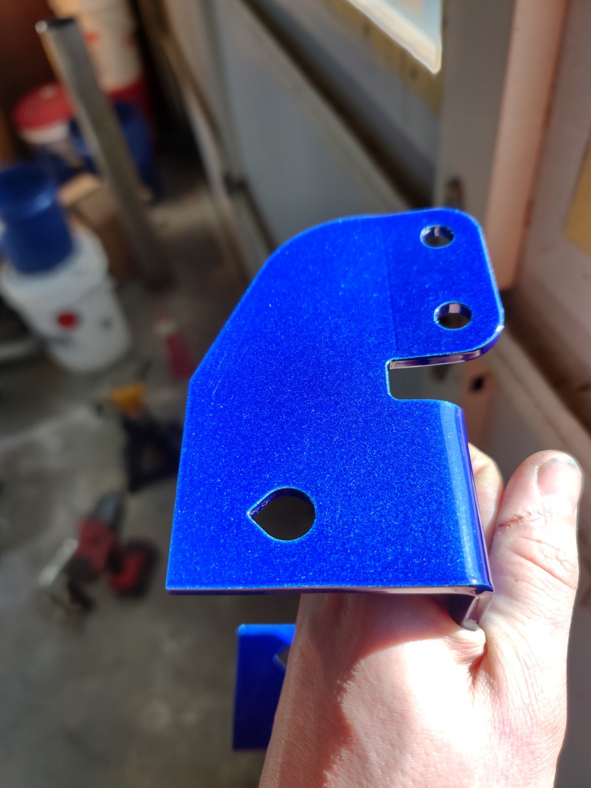

The color is illusion royal from prismatic powders. It's zinc primer, 2 coats color, and then acrylic clear. Those pics don't do it justice. I had everything I could powdered. Cost about $1800. Even the sheet metal was done.

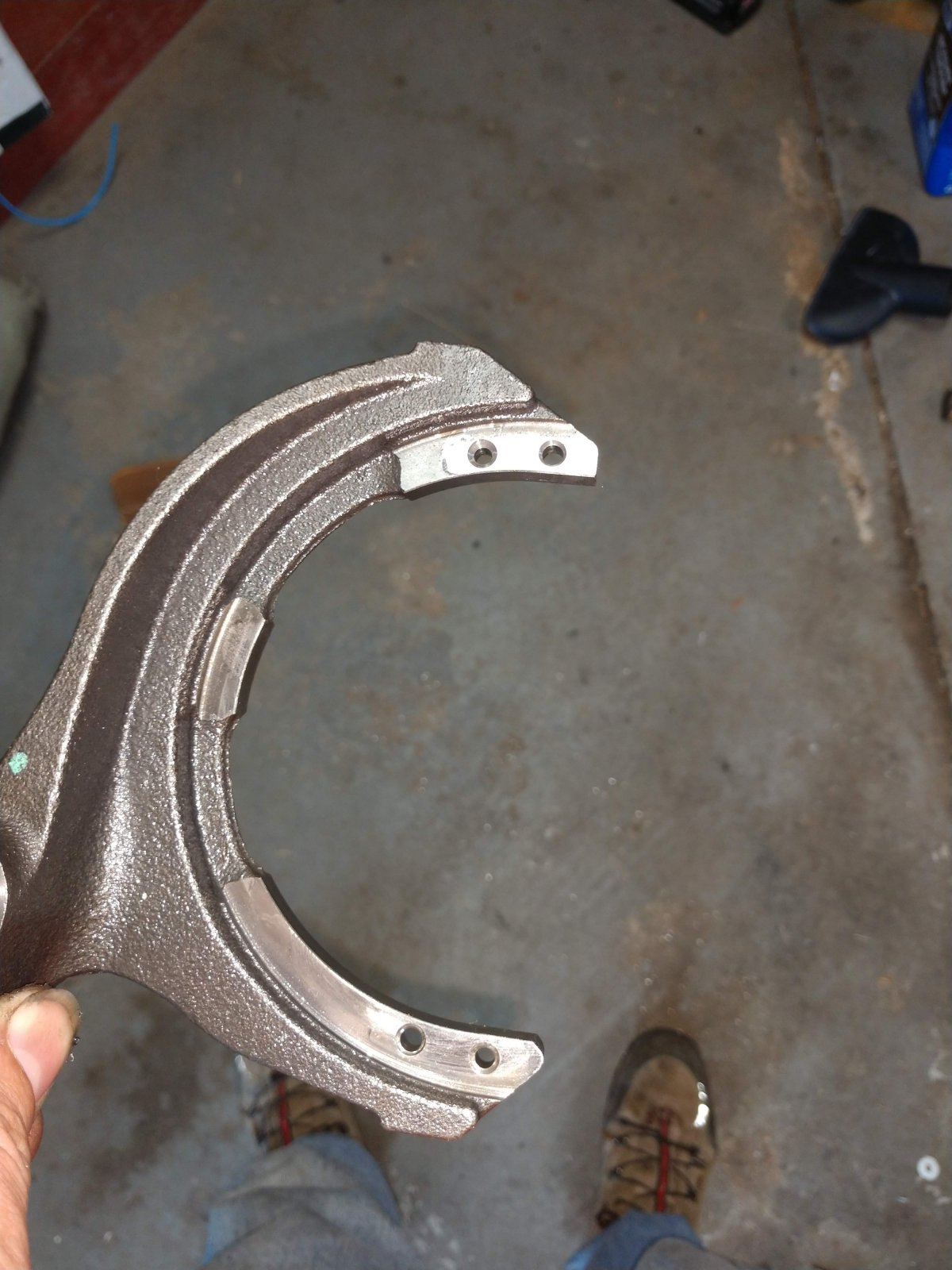

As for the ms6... I grenaded one trans. It was @ new England drag way. I was racing Justin from freaktune. Took the pads right off the fork
Since then I had brass pads machines and brazed on the forks. And I had the final drive gear raised. Stock trans rev limits at 80mph in 3rd, new trans 108. I did this There are 2 final drive ratios one covers 1st-4th, the other 5th, 6th, and R. It's a strange motor. It's held in time with "friction washers" no pins, no keways, no splines.

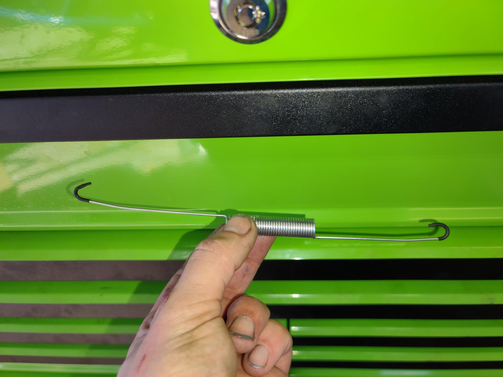

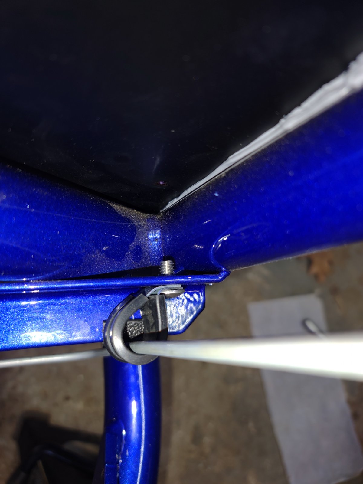

I didn't like the thought of the coolant tank spring scratching up my finish, 1/16 hear shrink on the ends

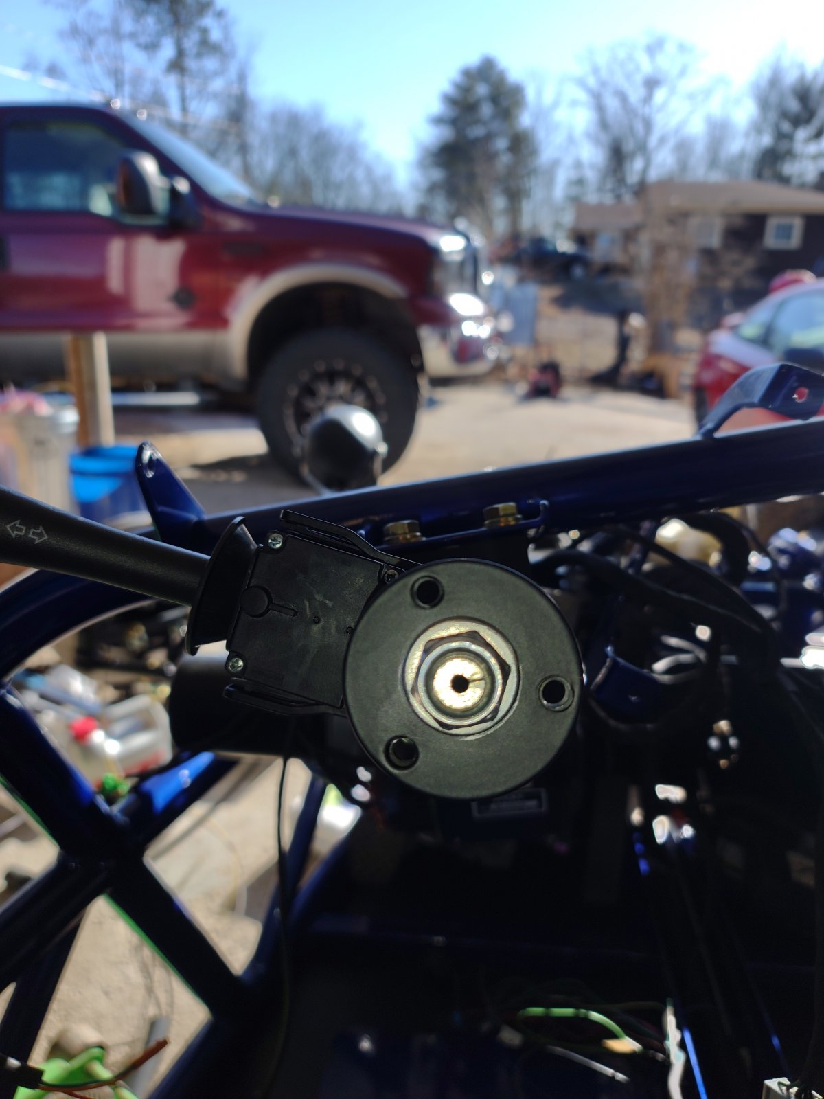

I didn't want to risk the steering wheel nut scratching the adapter, 14mm stainless washer

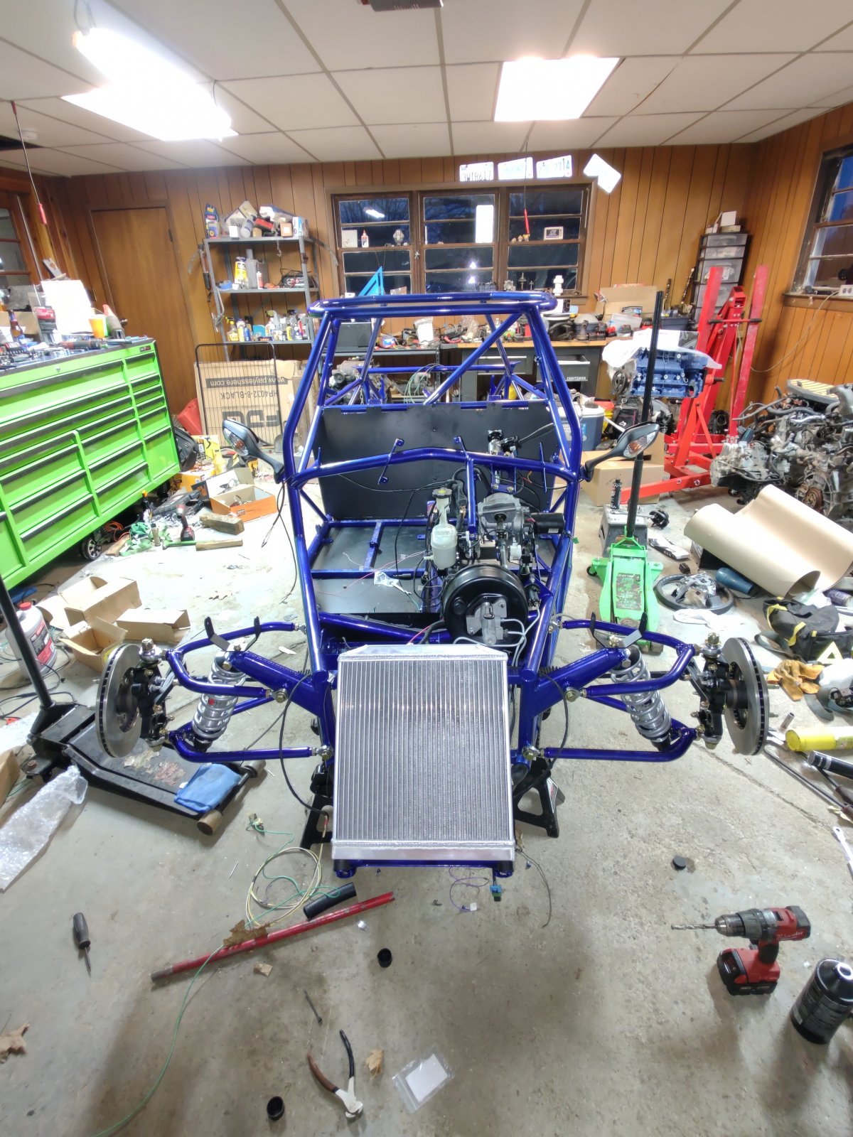

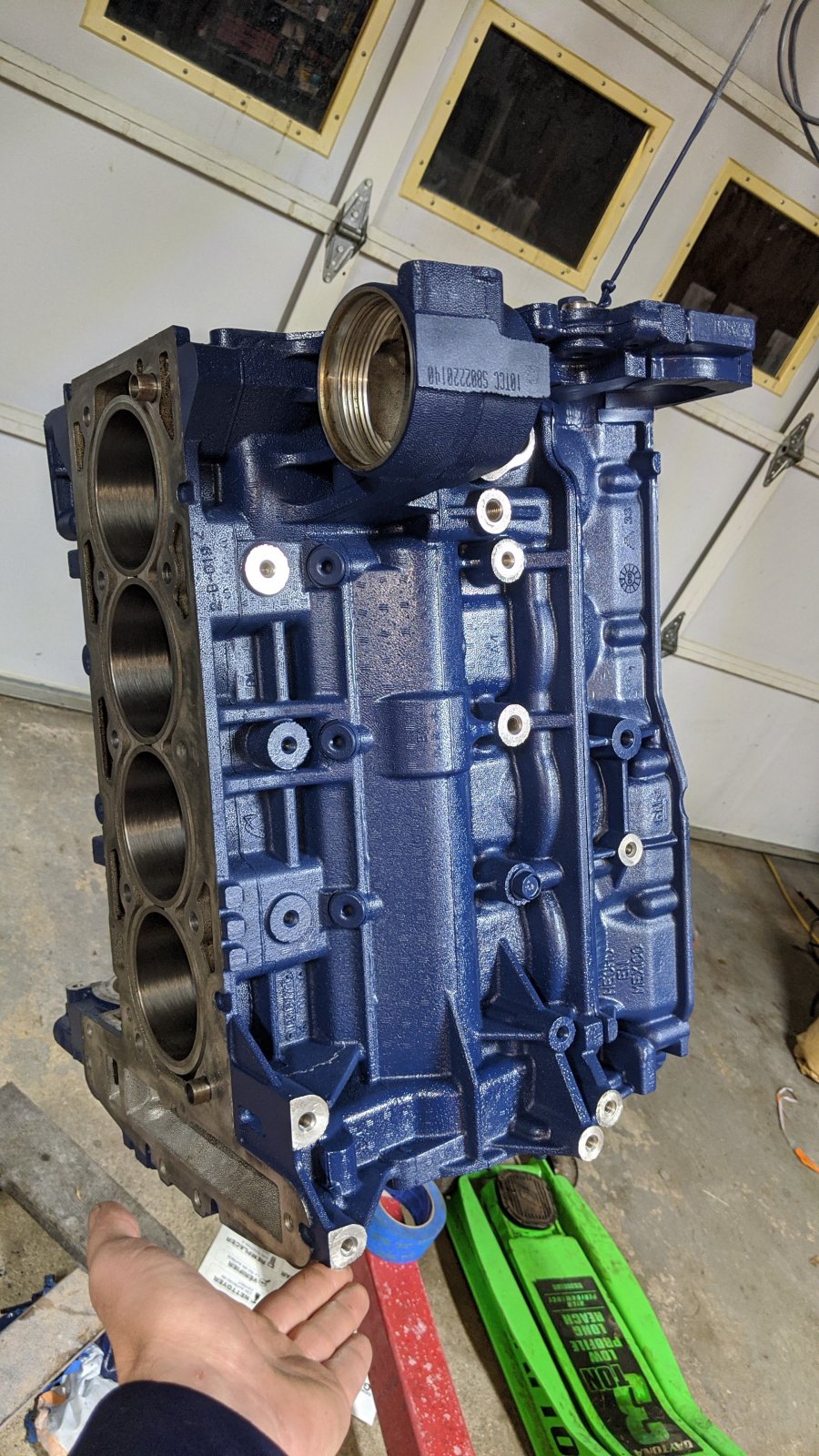

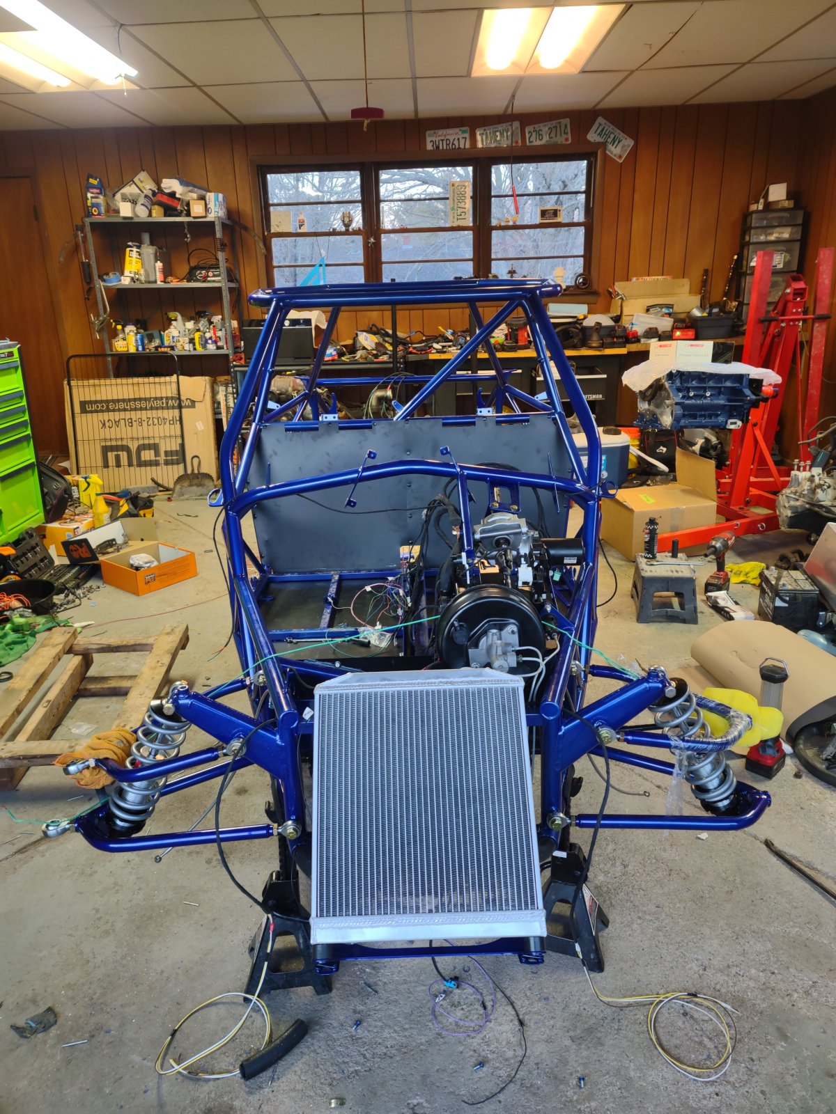

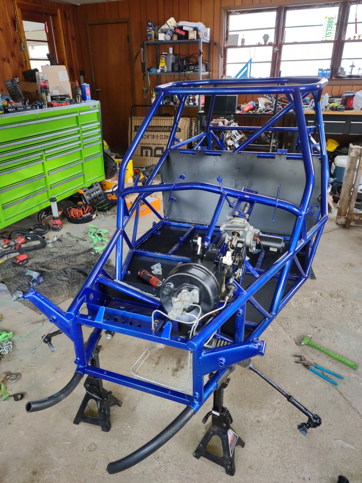

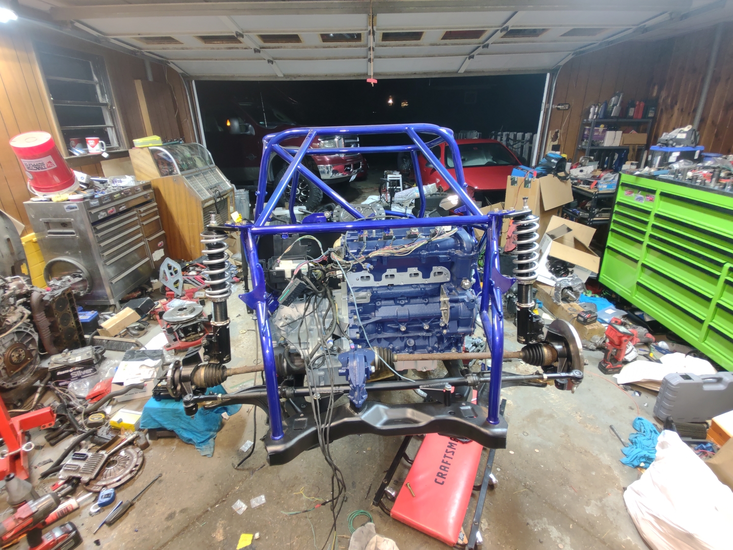

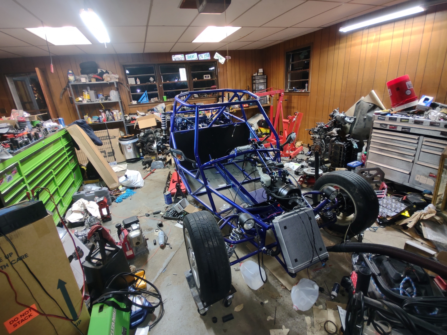

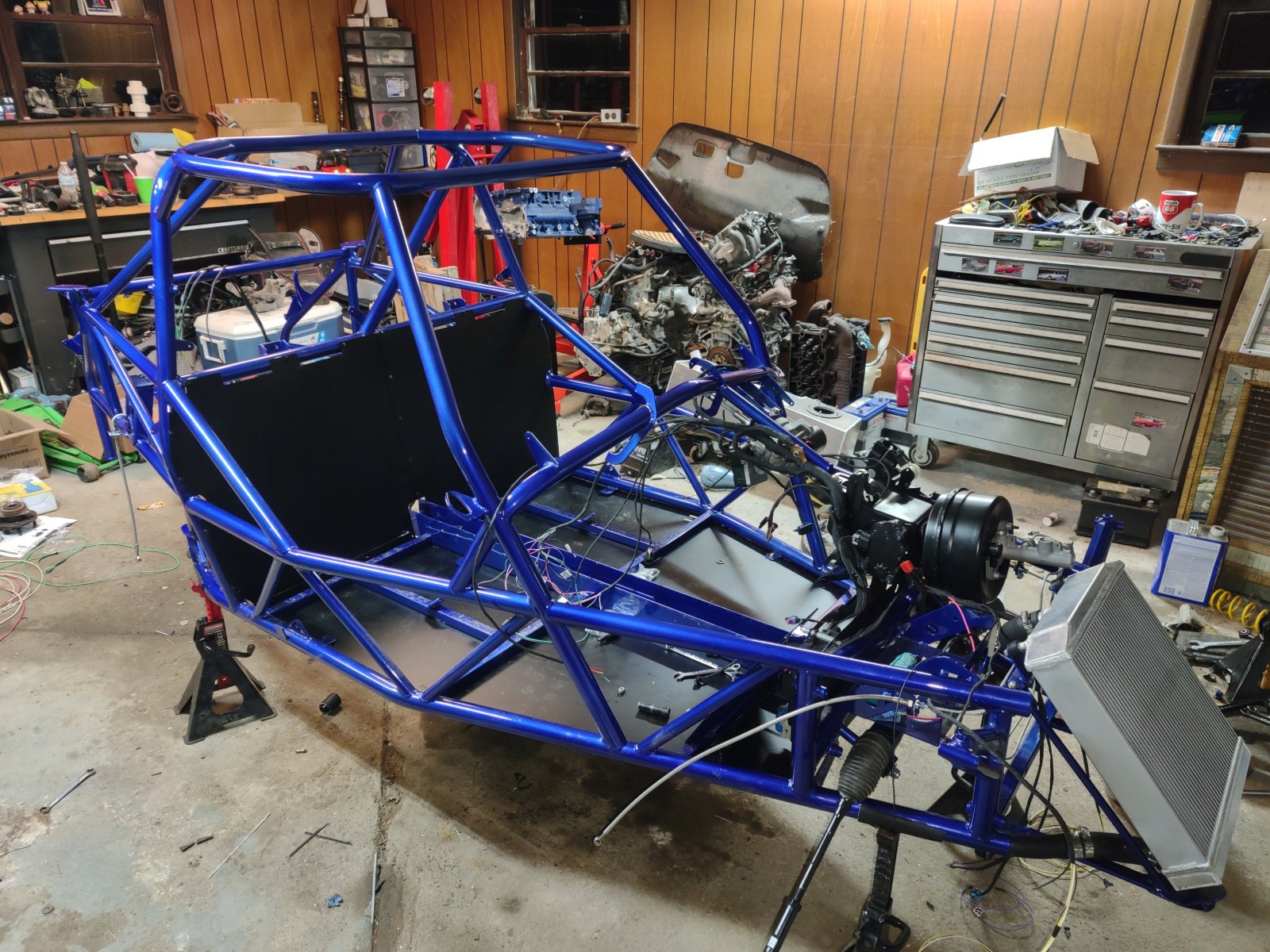

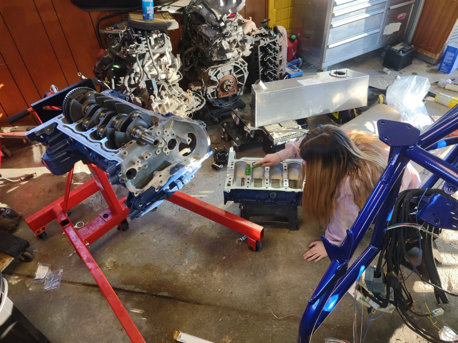

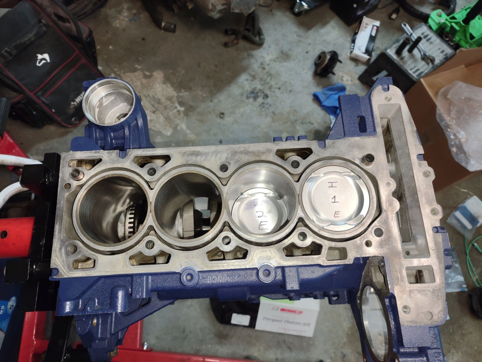

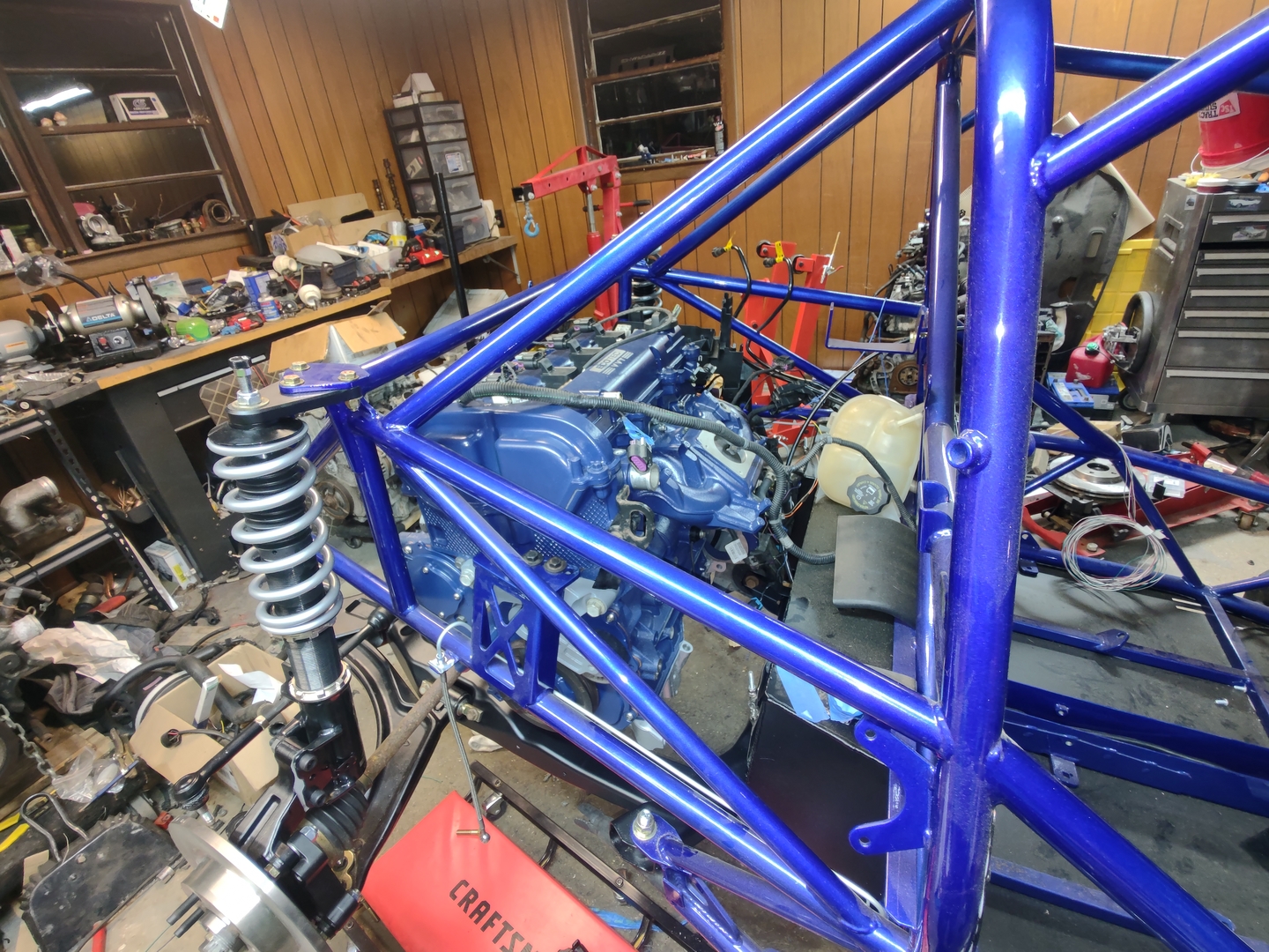

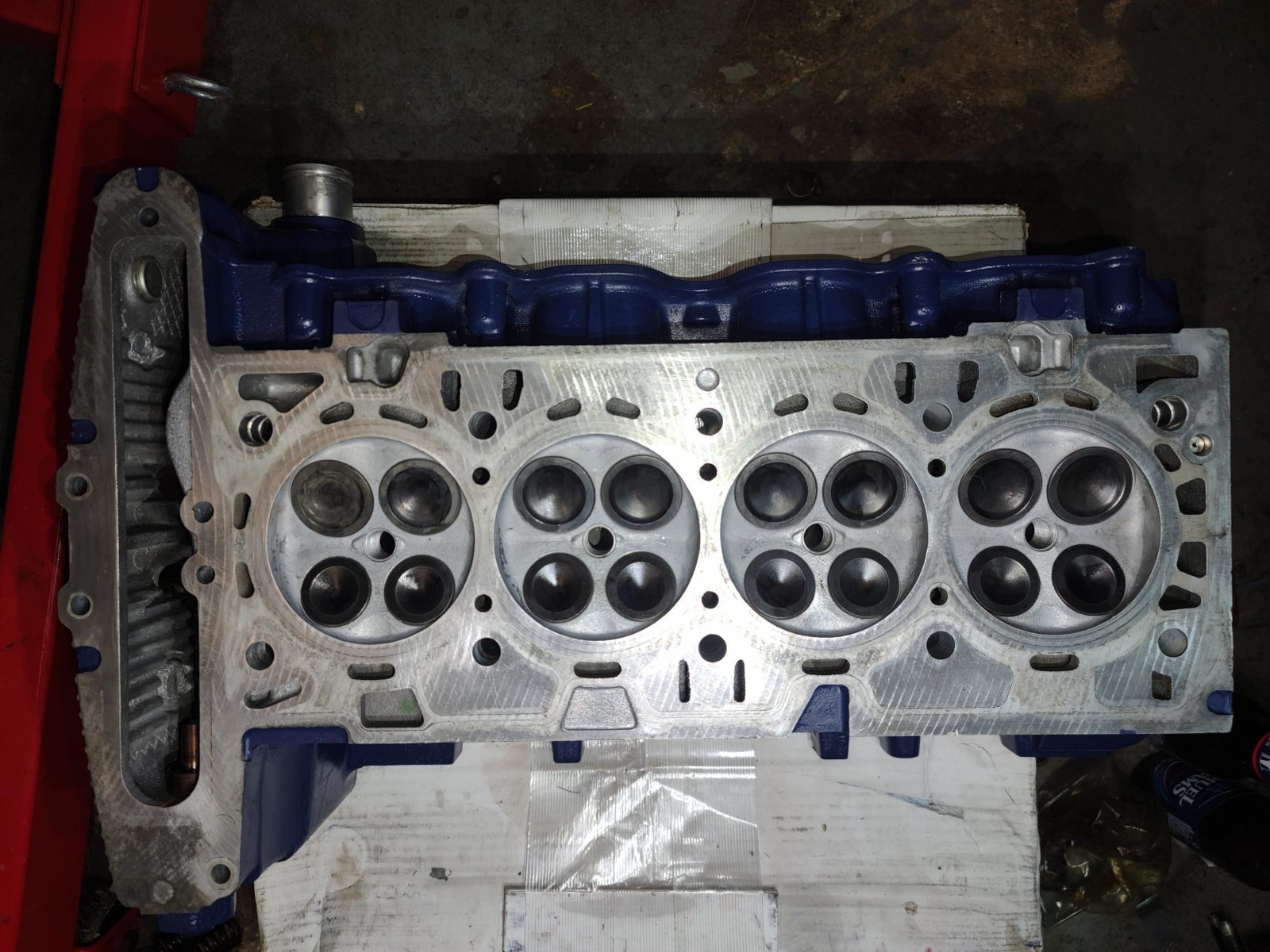

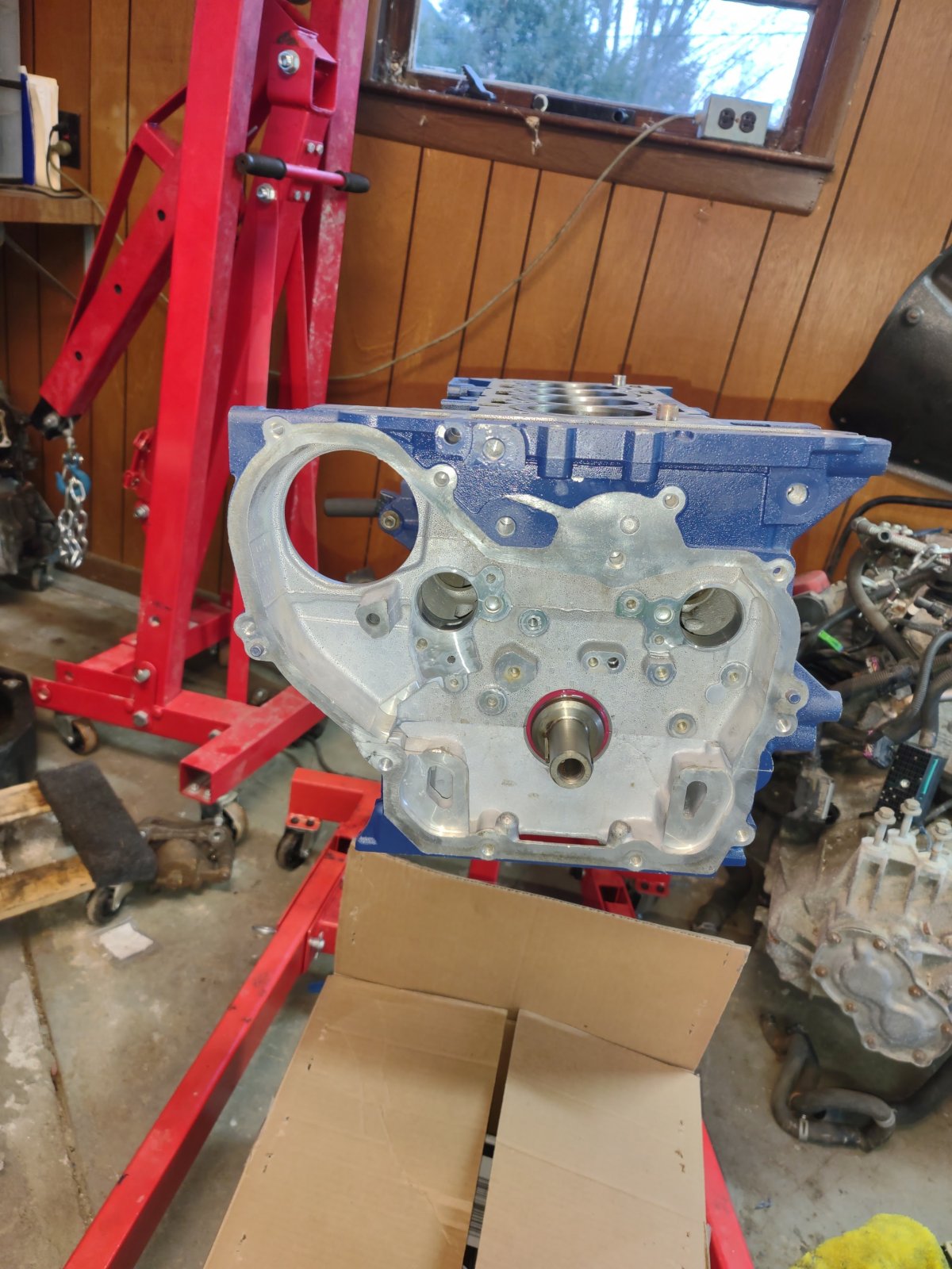

Plenty has happened. I built the motor (LE5). Molnar rods, Hahn (wiseco) Pistons, balanced to 10K RPM, Balance shaft delete, Davies Craig water pump with pump and fan controller.
Motor/Trans is in, rear subframe, control arms, knuckles, toe link, cv axles, Rear brakes.
Because of the XFE donor it came with a 2.2 w/smog pump. I got a running 2.4 out of a junk yard with harness for $300.
The motor was from a Malibu. A Malibu is very different layout. I ended up getting all the engine wiring diagrams for all 3 layouts (cobalt 2.2 w/smog, cobalt 2.4, and Malibu 2.4) I re-pinned the 2.2 ecm connectors to the cobalt 2.4 Pinout.
Here are some pics, please excuse the very messy garage.
