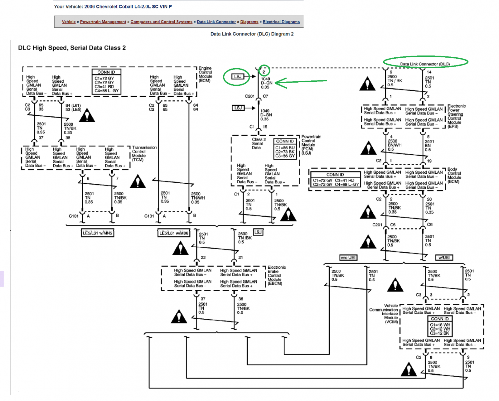

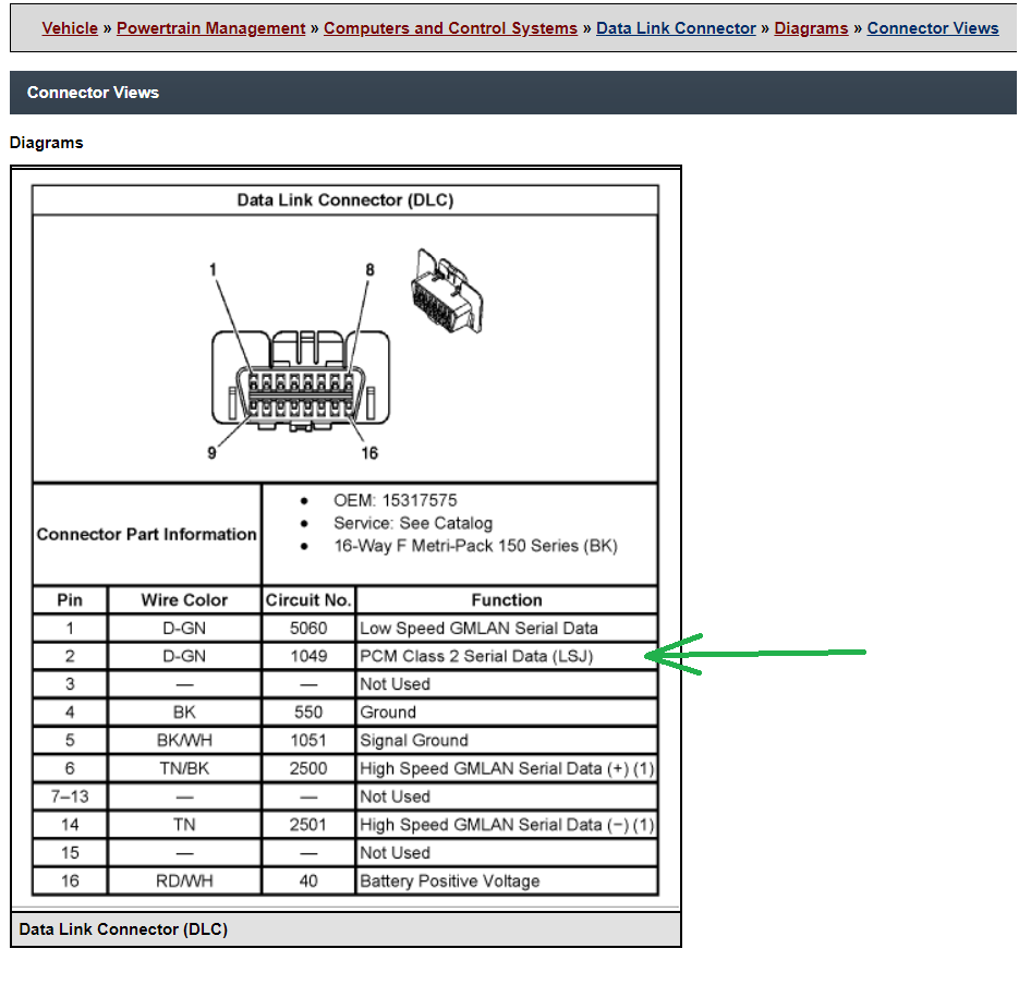

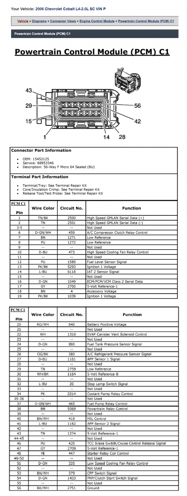

The dark green wire that you aren't supposed to cut is only on our LSJ engine. It goes from pin 2 of the OBD2 port to the PCM connector C1, pin 16.

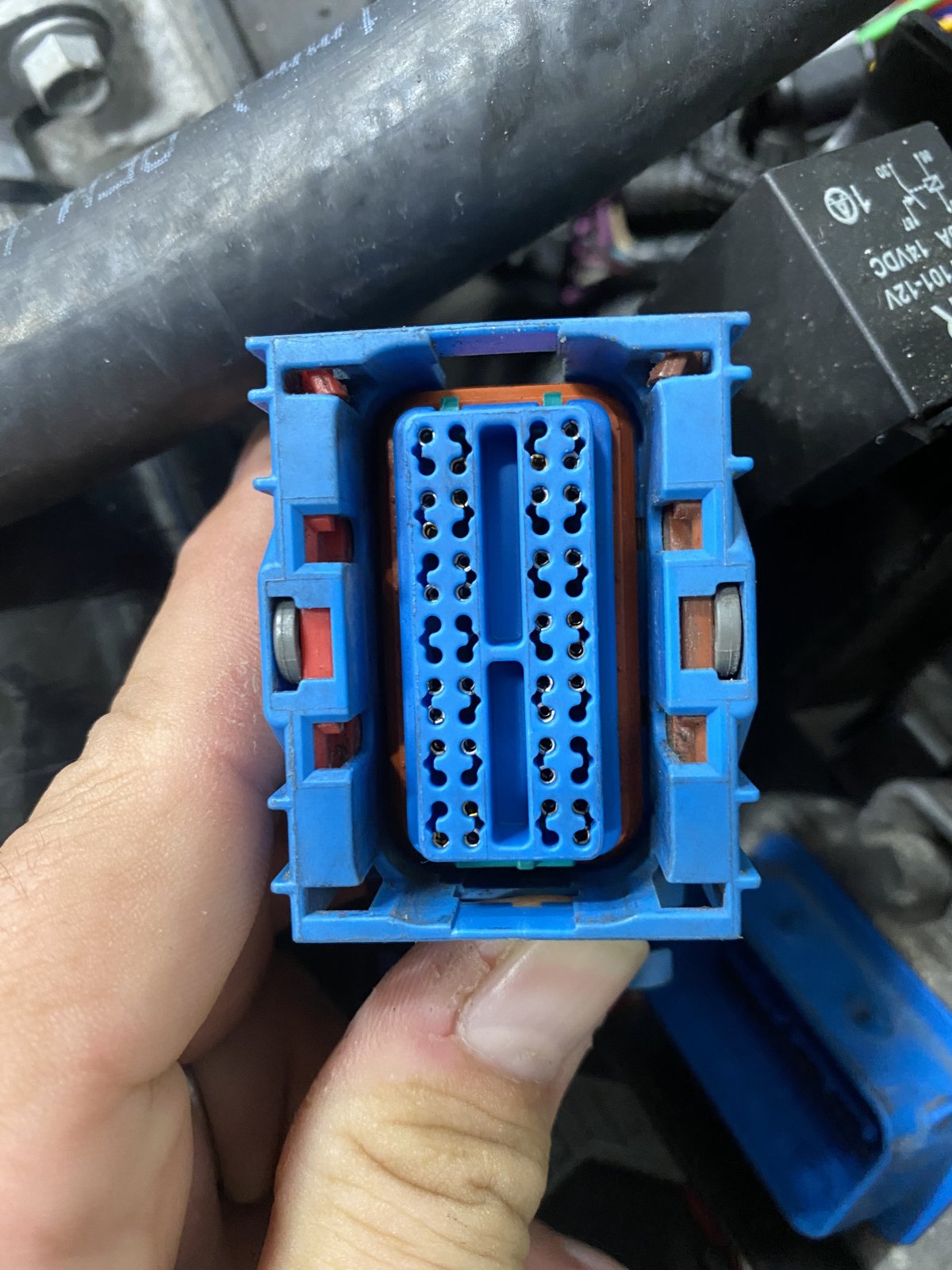

So in trying to diagnose another issue I pulled my pcm and took a look at my C1 harness and it’s definitely not the same pinout. It’s the same P12 and the same connector in the bottom right of the pic above but the number 2, 7 and 19 points aren’t even pinned so clearly it doesn’t match up. If anyone else has an 06 LSJ and gets the chance to take a pic of theirs to cross reference would appreciate it.
My connector ….

I see pin 2 is in your C1 picture. It is on the lower right. Or do I have your C1 upside down? The left side (below) of the C1 block is longer...
Pin 1&2 are both part of the GM high speed LAN, so pin 2 will be on all 2006 LSJ Cobalts, no matter the options.
Pin 19 is ignition voltage - also on all LSJs.
You do know you have access to the wiring diagrams for a 2006 LSJ, right? (If you can see my signature at the bottom, it has a link to my index, go there and it is on Line 16: AllDataDIY Login )

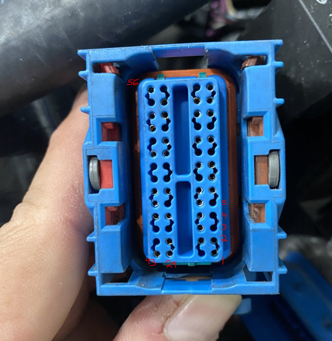

When looking at the pinout chart Ross included and the image from GoblinGuyZ. It looks like pin 1 is in the lower right of the image. Pin #s are added here:

Yea the first pic with the chart I posted is the back of the plug where the wires come out that you can see when the ecu is plugged in whereas my harness pic is the female end that plugs in to the ecu so everything is basically flipped
