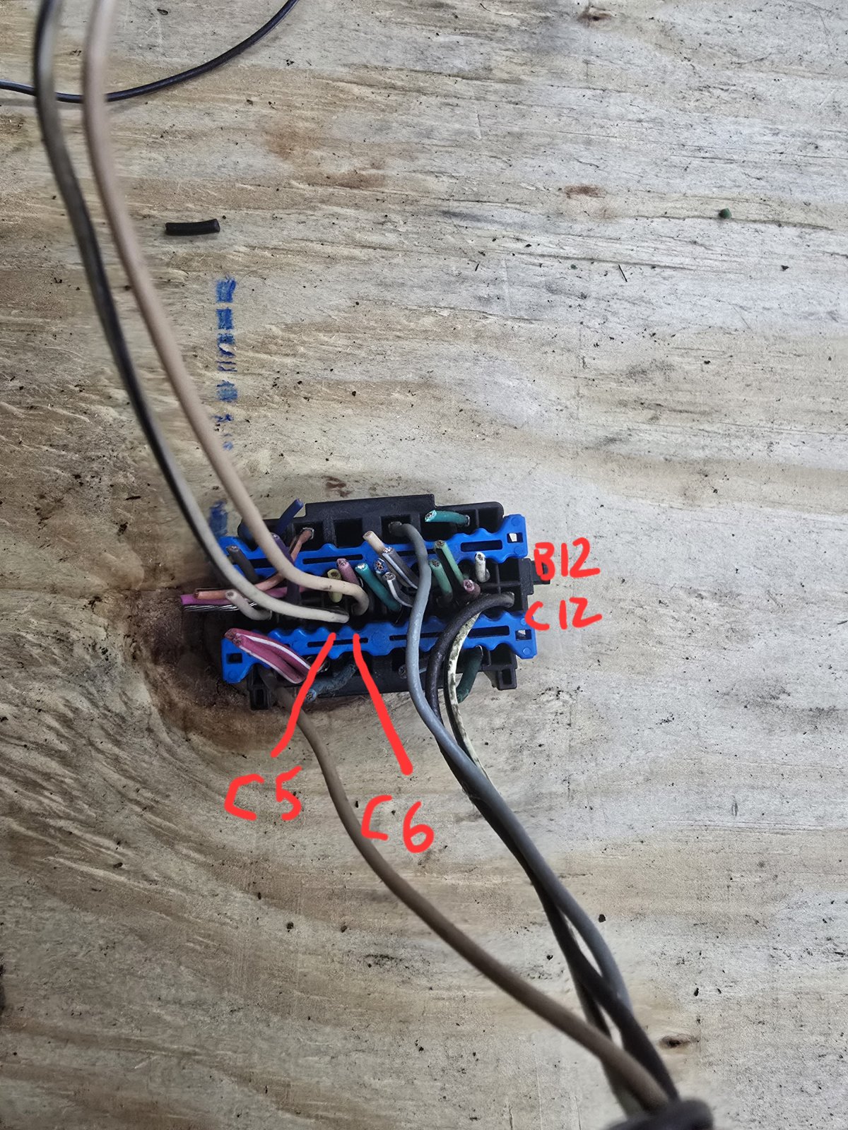

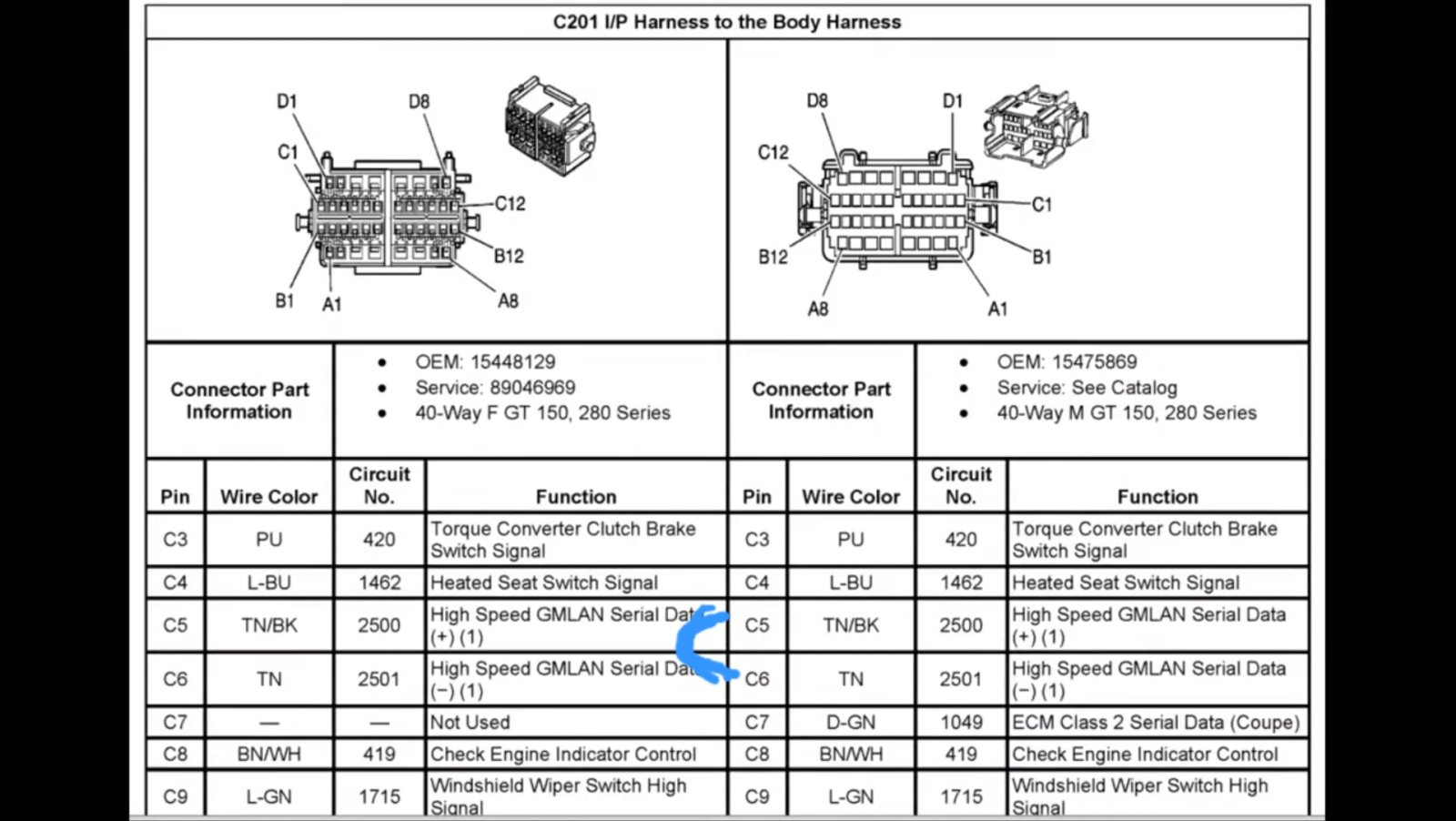

I beleive I may have missed a step in thinning the harness. Going through the dash harness there are the 2 high-speed data wires (C5 and C6) that are still connected to the dash to body harness connecter. In the video at 2:14 the wires are still in the harness, but at 2:27 the wires are gone from here on out.
If i cut these do they get soldered to the 2 data wires coming from the fuse box?

I've not done a Goblin rewire but I believe this connector is just being eliminated and you just match each to it's mate across to the other side of where you cut out the big multi-connector........ Tan and Tan w/ stripe pairs are the Hi Speed LAN and their circuit must stay complete even if some of the computers in that circle(paired circuit) are bypassed. Tan to Tan, Tan w/ stripe to Tan w/ stripe. I know, that sounds deceptively simple. Sometimes ya get lucky? (Luke: I got one!, I got a tie fighter! Han Solo: Great! Don't get cocky kid!)
High Speed Data should look like this with the exception of no auto transmission control module for manual transmissions.
